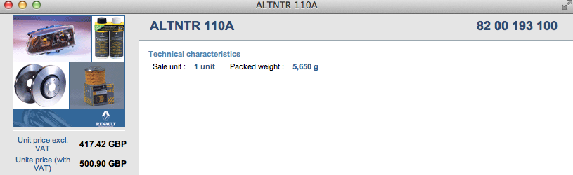

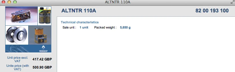

That part number and Veleo number is 110Amp

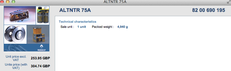

What i have done is show the OP what renault have quoted him and said its wrong. If you look you will see i have listed the 75AMP alternator below the 110AMP alt in my first post which is the correct NON EXCHANGE OE 75AMP for his car. (8200690195 @ £253.95)

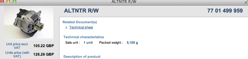

You have then listed the EXCHANGE one with the correct part number of 7701499959.
And i have said you are correct with the part number and i posted 2 pictures of the them one being non exchange and exchange.
NON EXCHANGE OE 75AMP (8200690195 @ £253.95+VAT = £304.74)
EXCHANGE OE 75AMP (7701499959 @ £105.22+VAT = £126.26)

(NON EXCHANGE OE 75AMP 8200690195 @ £253.95+VAT = £304.74)

(EXCHANGE OE 75AMP 7701499959 @ £105.22+VAT = £126.26)

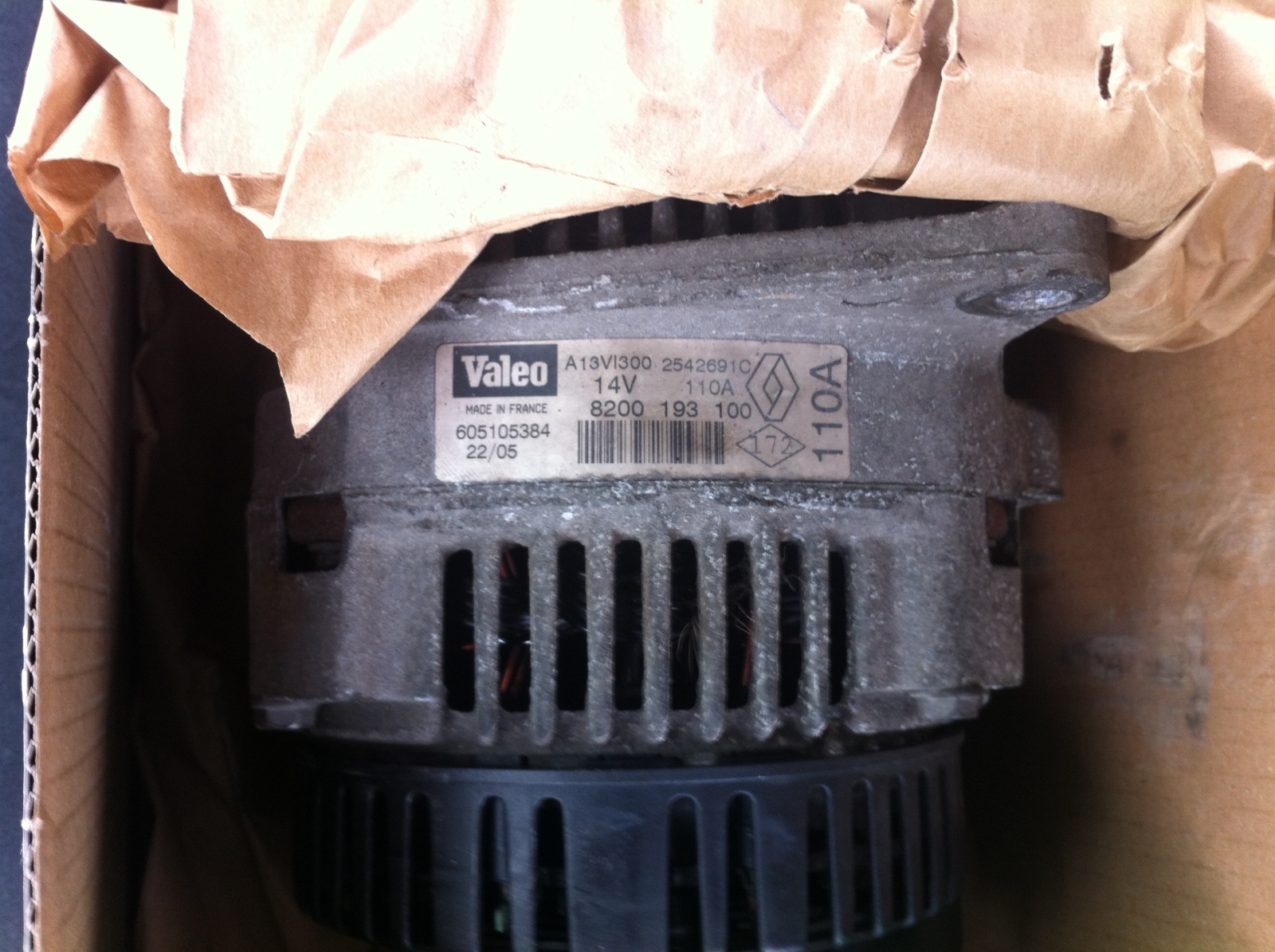

Here is my clio 182 with A/C old unit with OE part number of 8200193100
110AMP - OE Non Exchange Part Number - 8200193100 = £336.87+vat
110AMP - OE Exchange Part Number - 7711134267 = £192.80+vat
