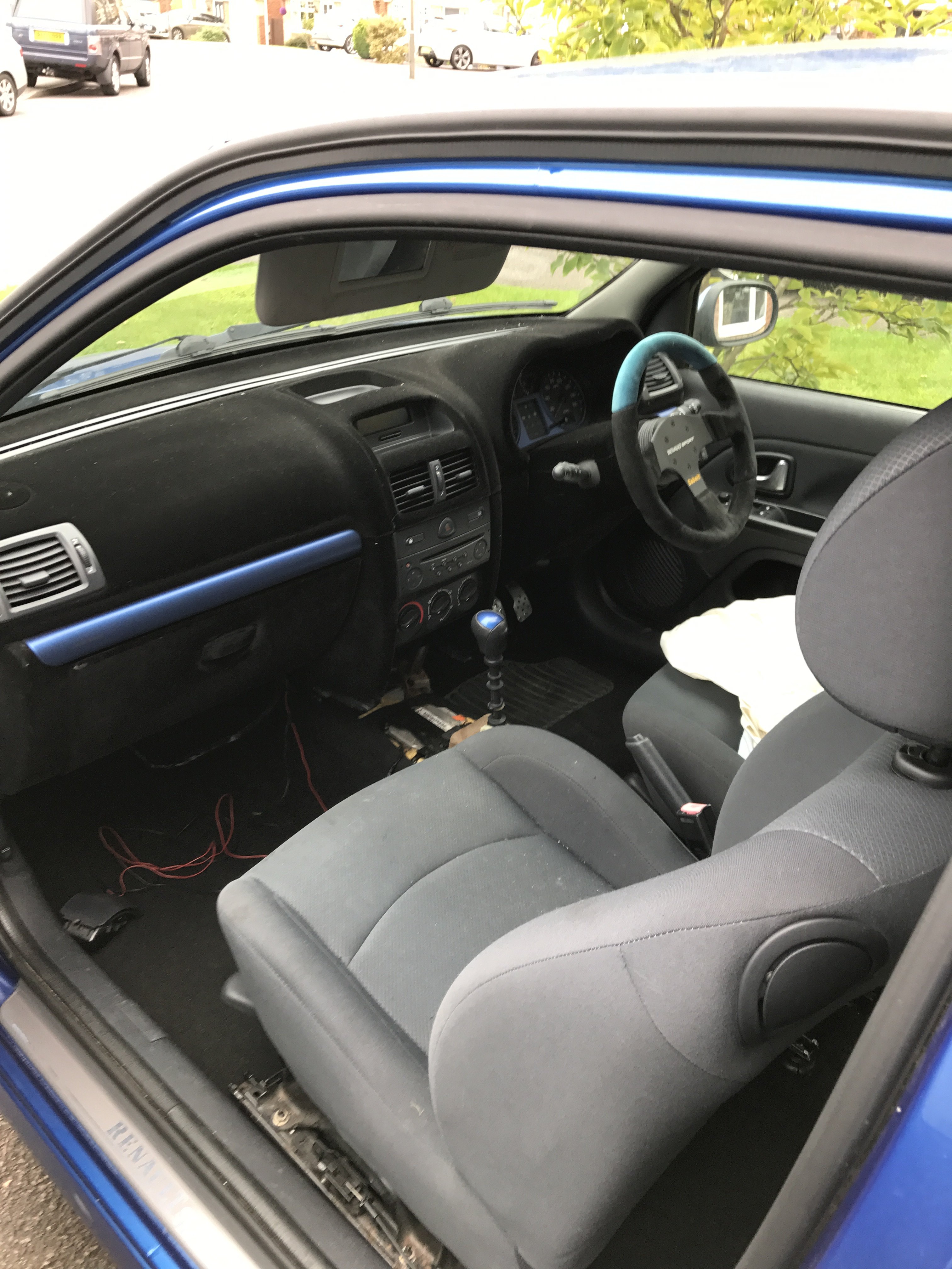

. Flocked dash

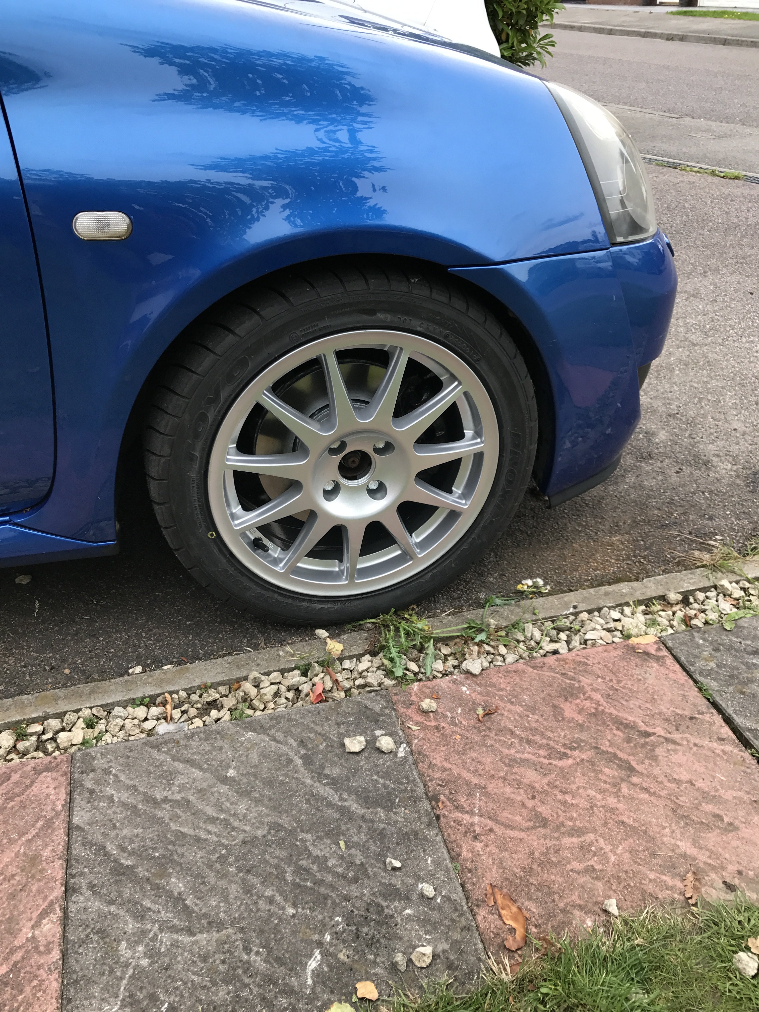

. Speedlines re-done in silver with NS2RS (and spare one for the boot)

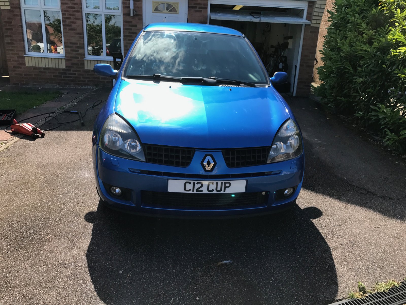

. Front bumper painted, and a decent two stage polish.

Thanks! I'm not hot enough on Renaults to know what's what yet, is there anything else that looks modified/missing?
The side strips look awful.

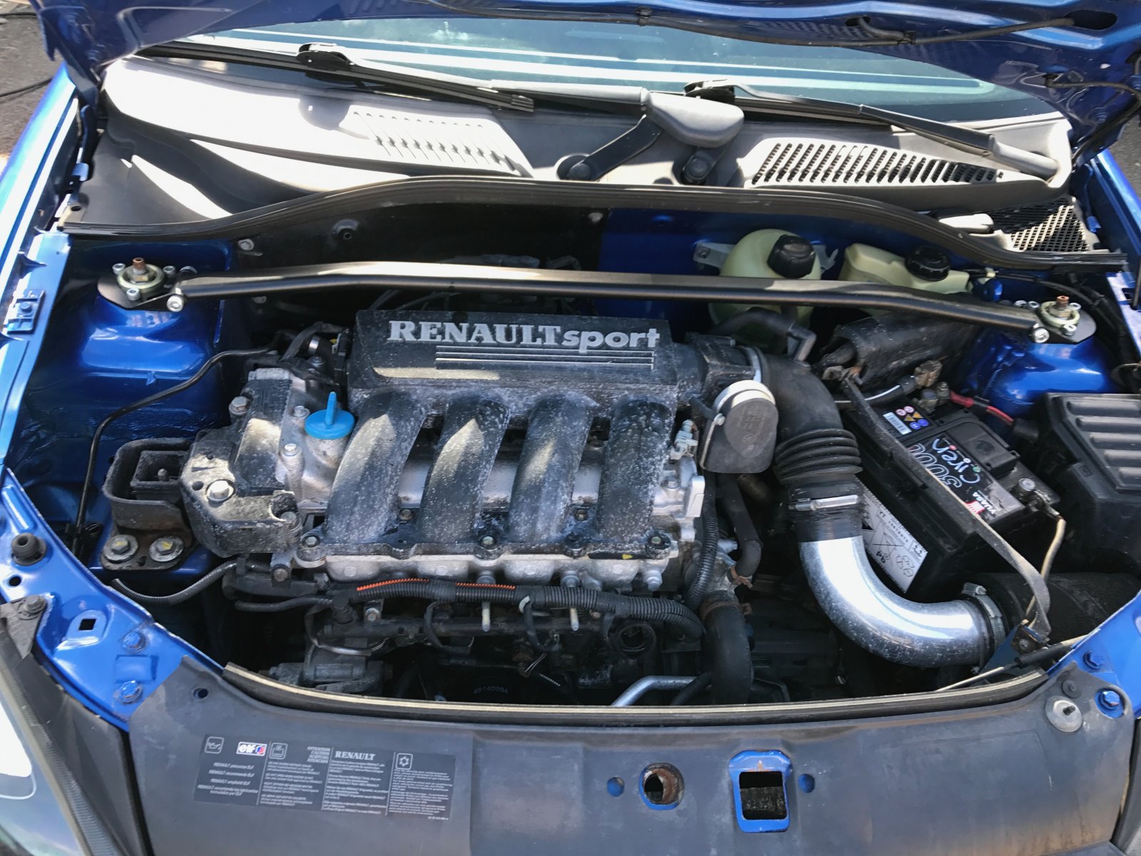

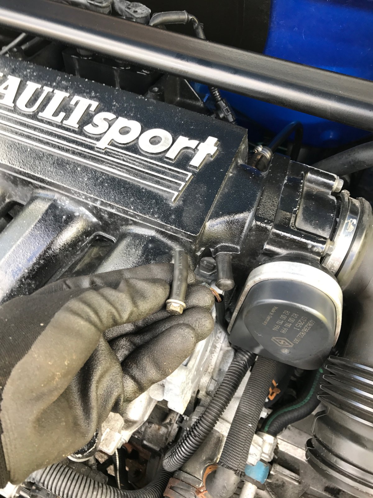

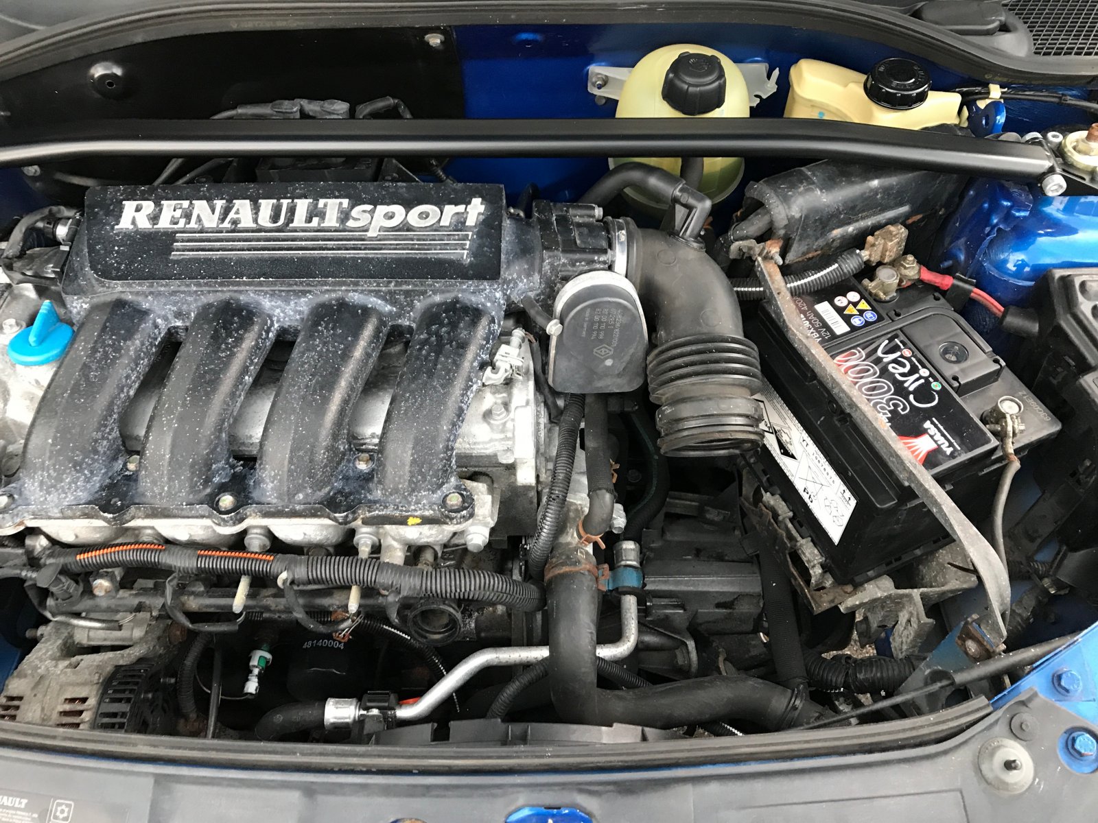

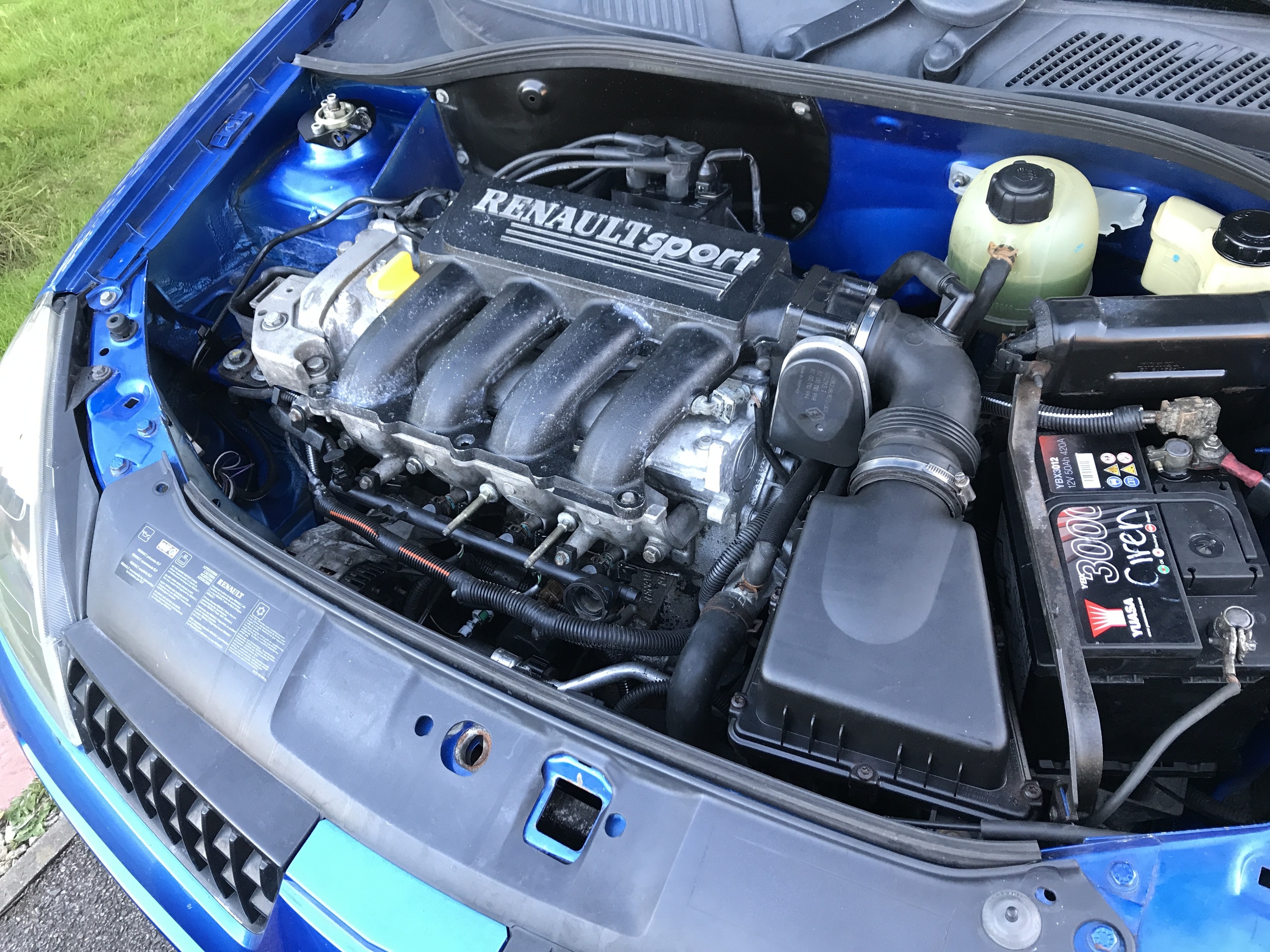

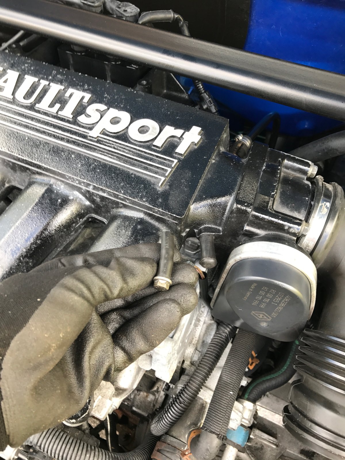

Does anyone know where the hose should run from the inlet manifold, next to the throttle body? Not sure why it's blanked off.
Looks a great base for a project that :up: Future plans returning a few things towards standard again sounds good too!

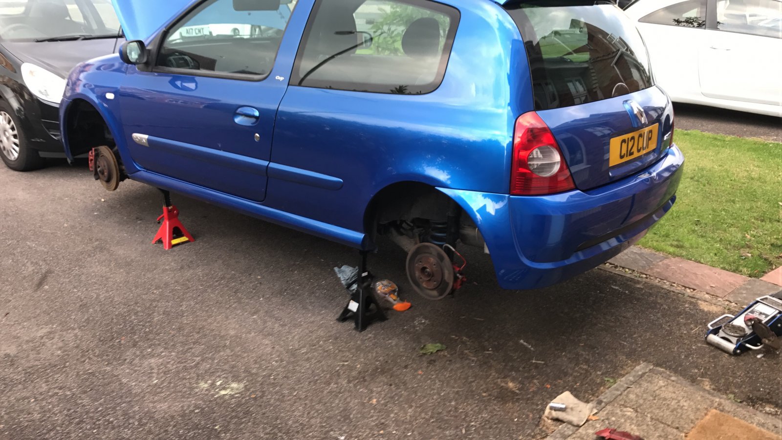

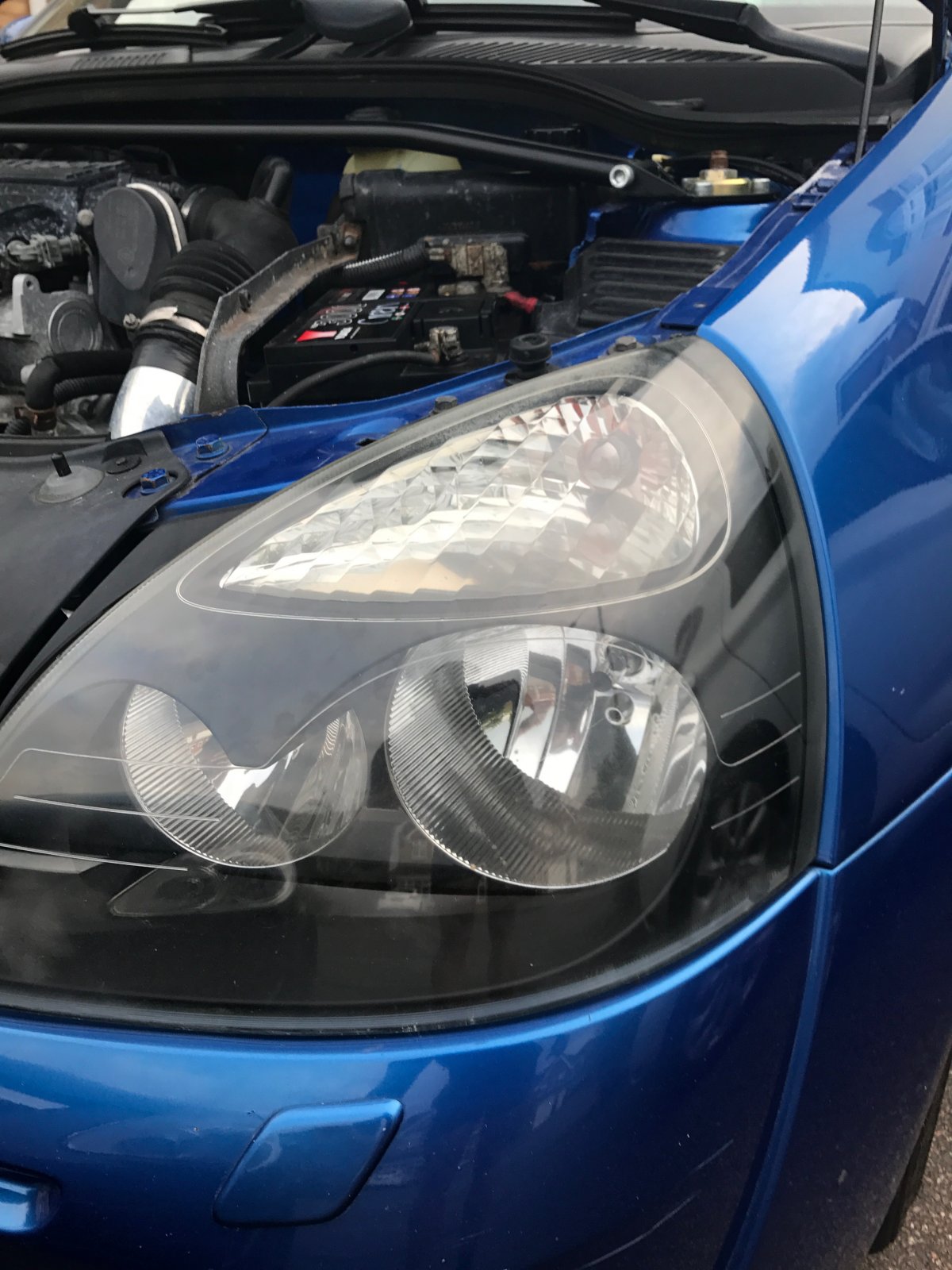

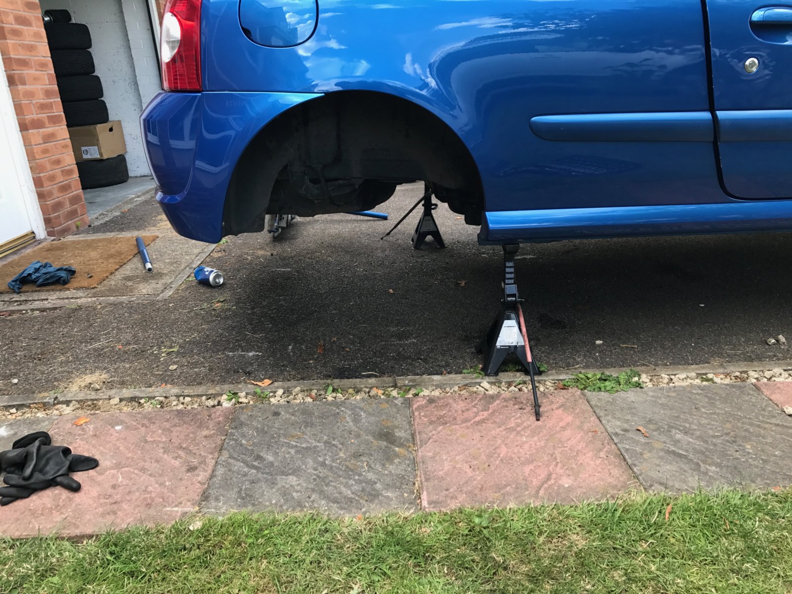

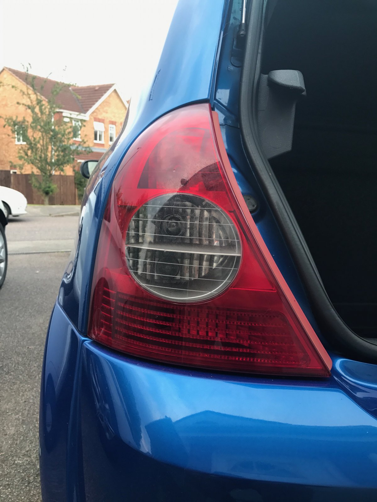

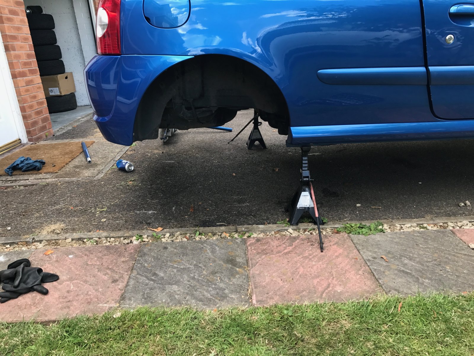

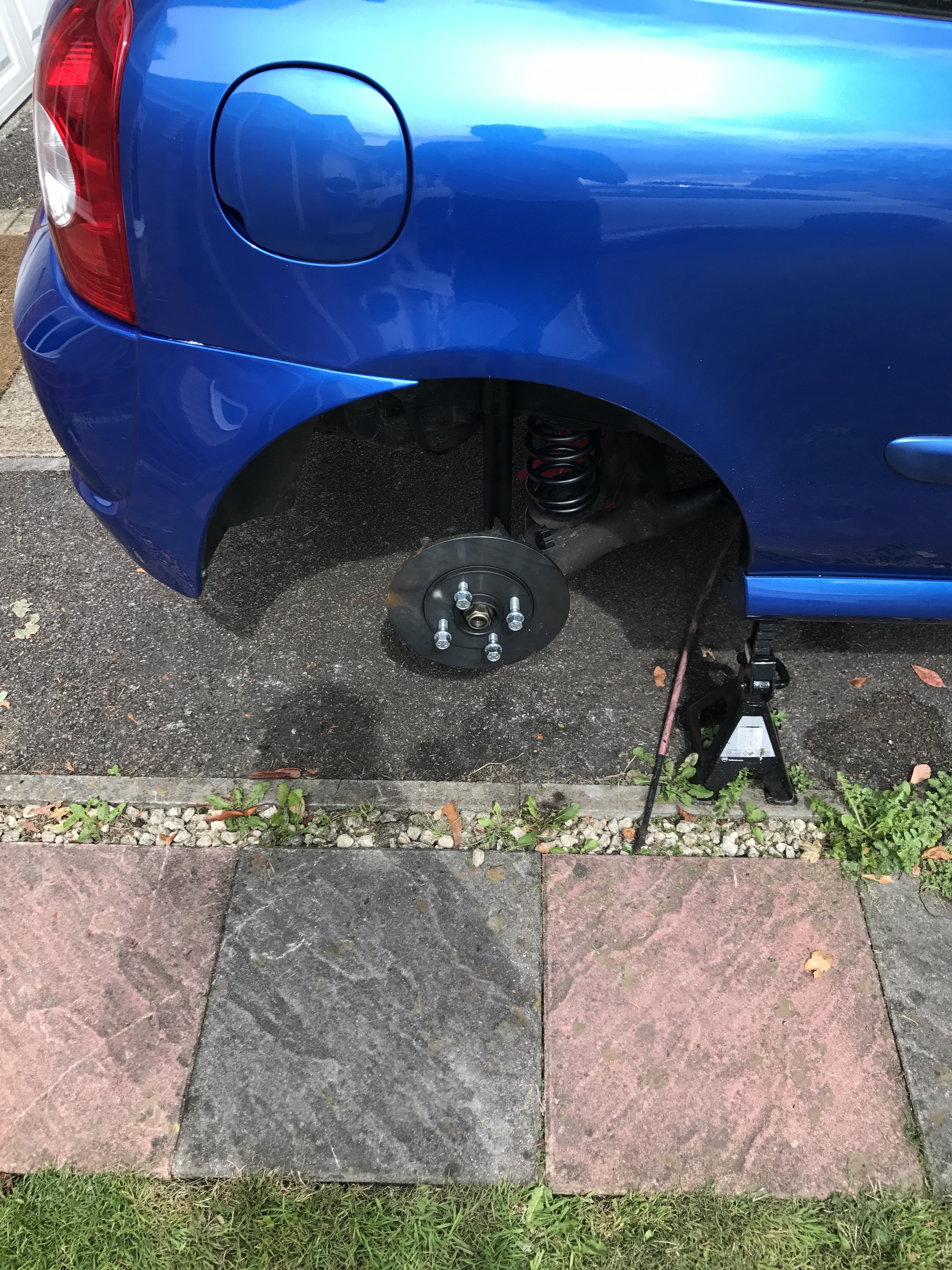

So did a bit a work on it tonight, dechavving, and removing brakes/cracking the suspension bolts so I can remove when my bits come.

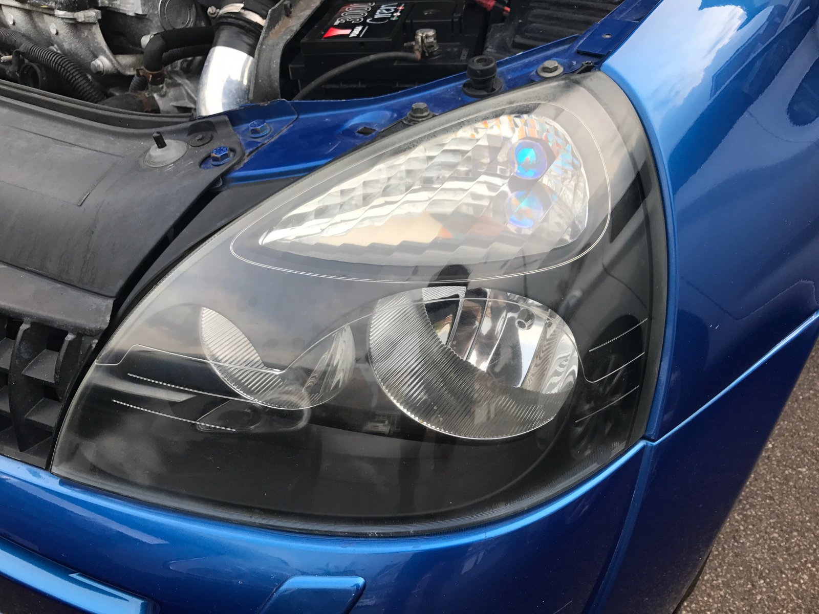

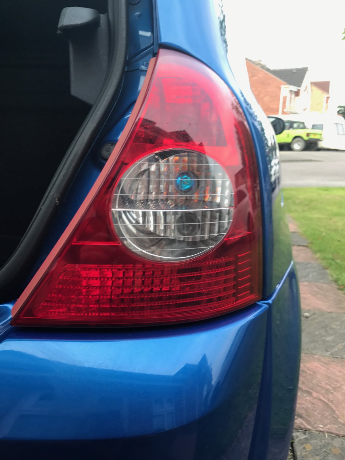

Bulbs look a lot better now!
After jacking car up, I've noticed wheel arch trims are missing along with under tray, so some more bits to add to shopping list.

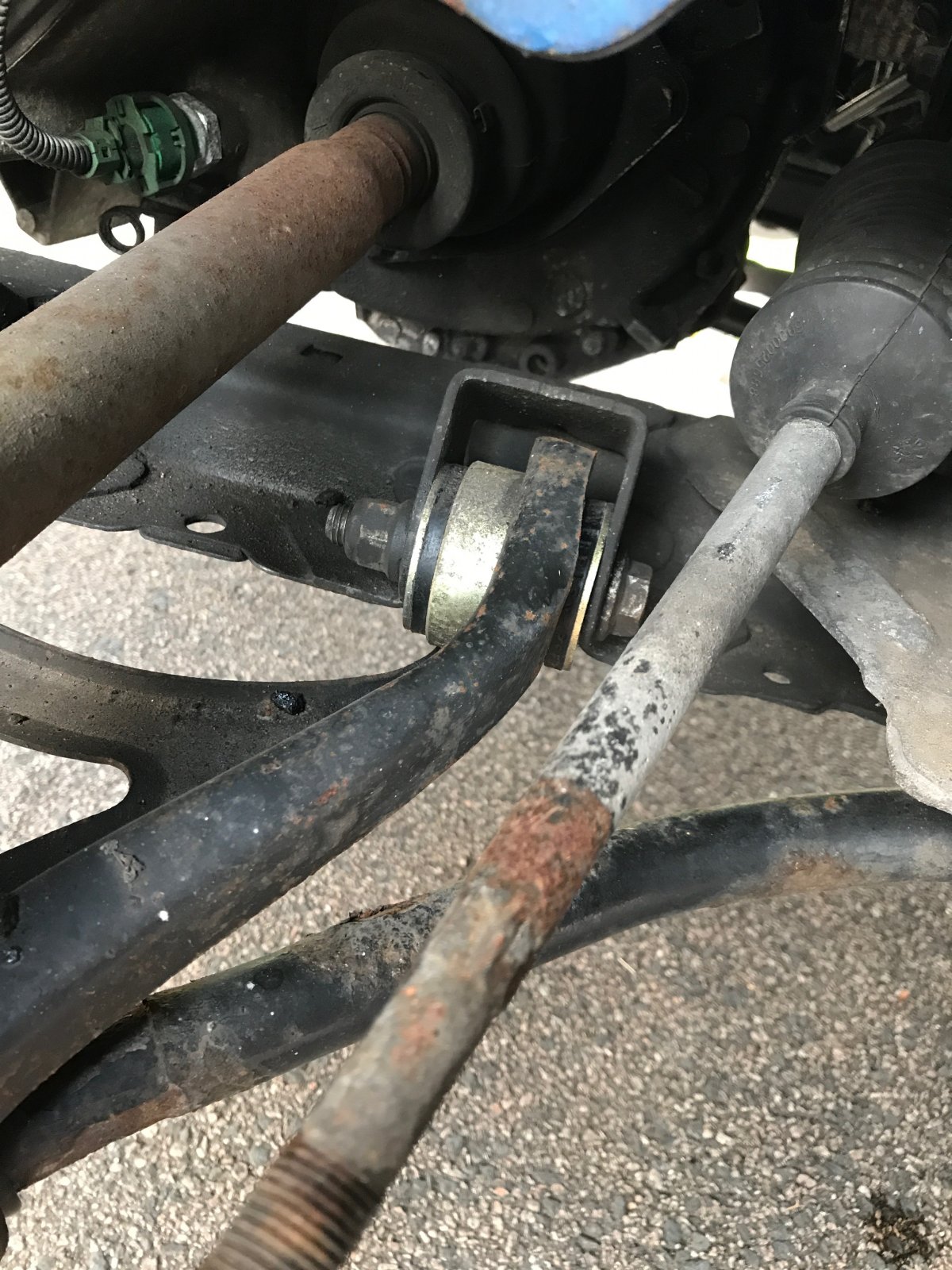

It looks like it's black series wishbone bushes! But then again aren't all Powerflex wishbone bushes black now?
It's usually red for road and black for track with the Powerflex I thought but not 100% on the wishbone ones

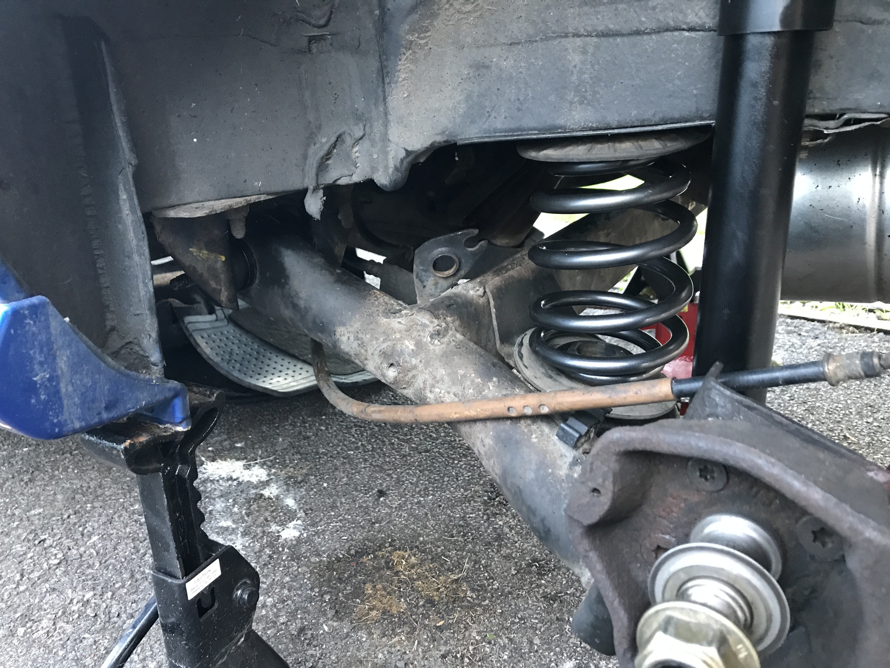

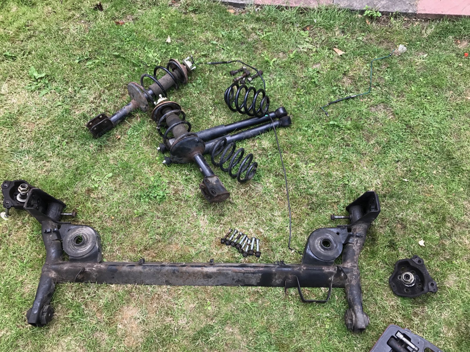

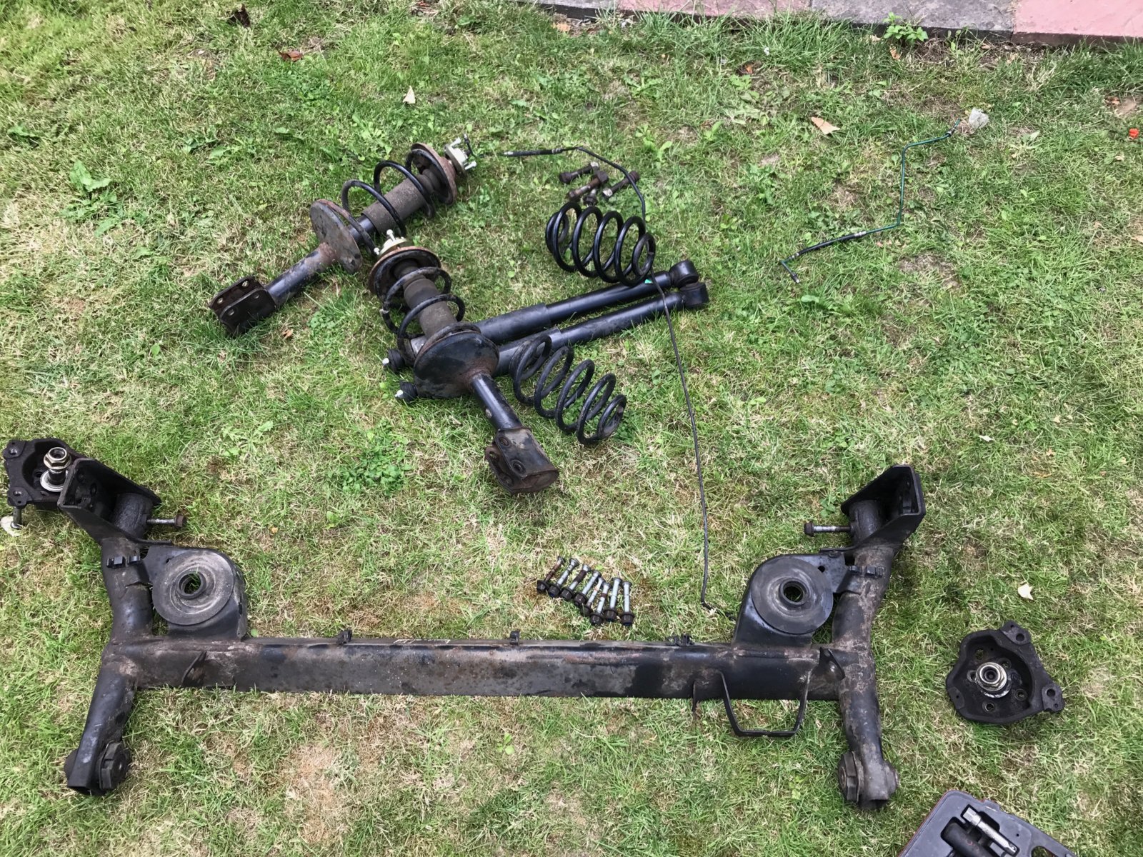

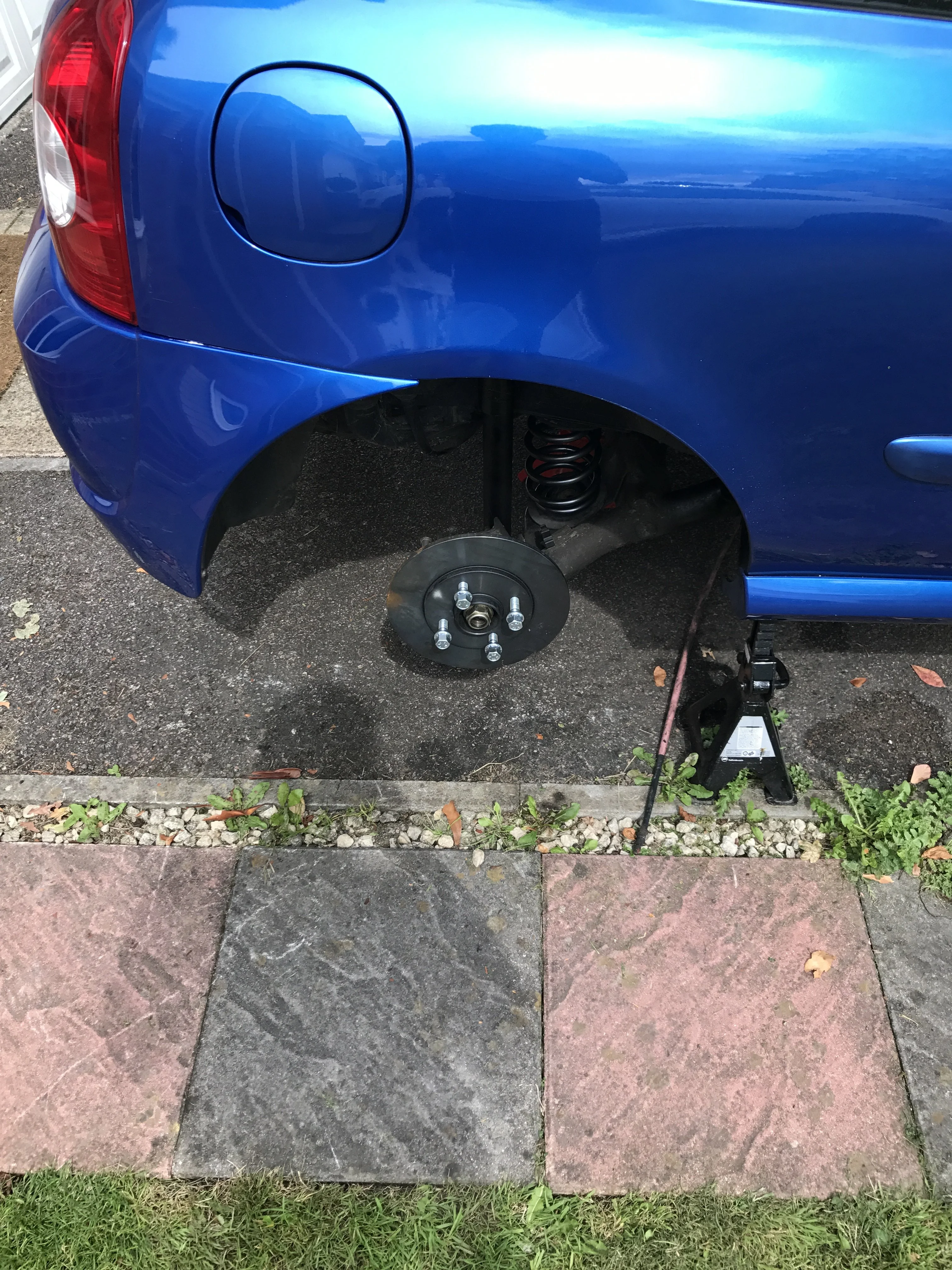

Did a bit more today, finished removing all suspension, brakes (bar one disc!), and rear beam. So far, no naughty nuts/bolts so it's been easy to work on!
Fitted a proper blank on the inlet manifold as the old pipe and bolt looked horrible. Changed spark plugs too (Genuine renault ones).
My little pile of goodies is building too. Still waiting on an email from RPD, and I'll order more bits and bobs.

Bit of a mare, bought a 182 upper and Lower inlet....fitted them, and it idled like toss, circa 4K! Read a bit that the upper inlet doesn't fit around the breather nicely, so removed it temporarily.... I am going to get the upper inlet and throttle body sand blasted back to standard colour. Air box on though, along with yellow cap (PMS brace off while dicking around).

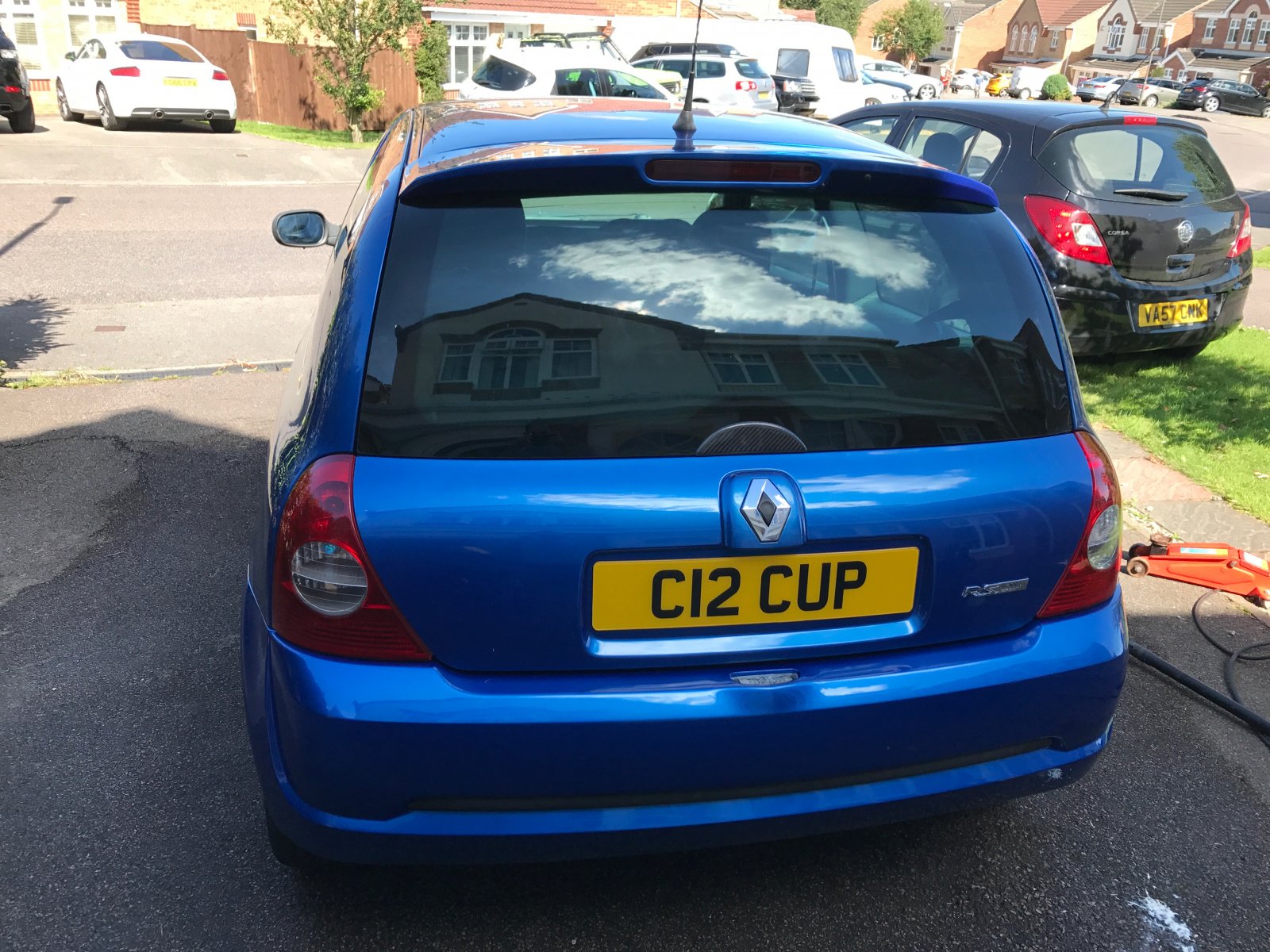

Rear wiper on now! Silly blank removed

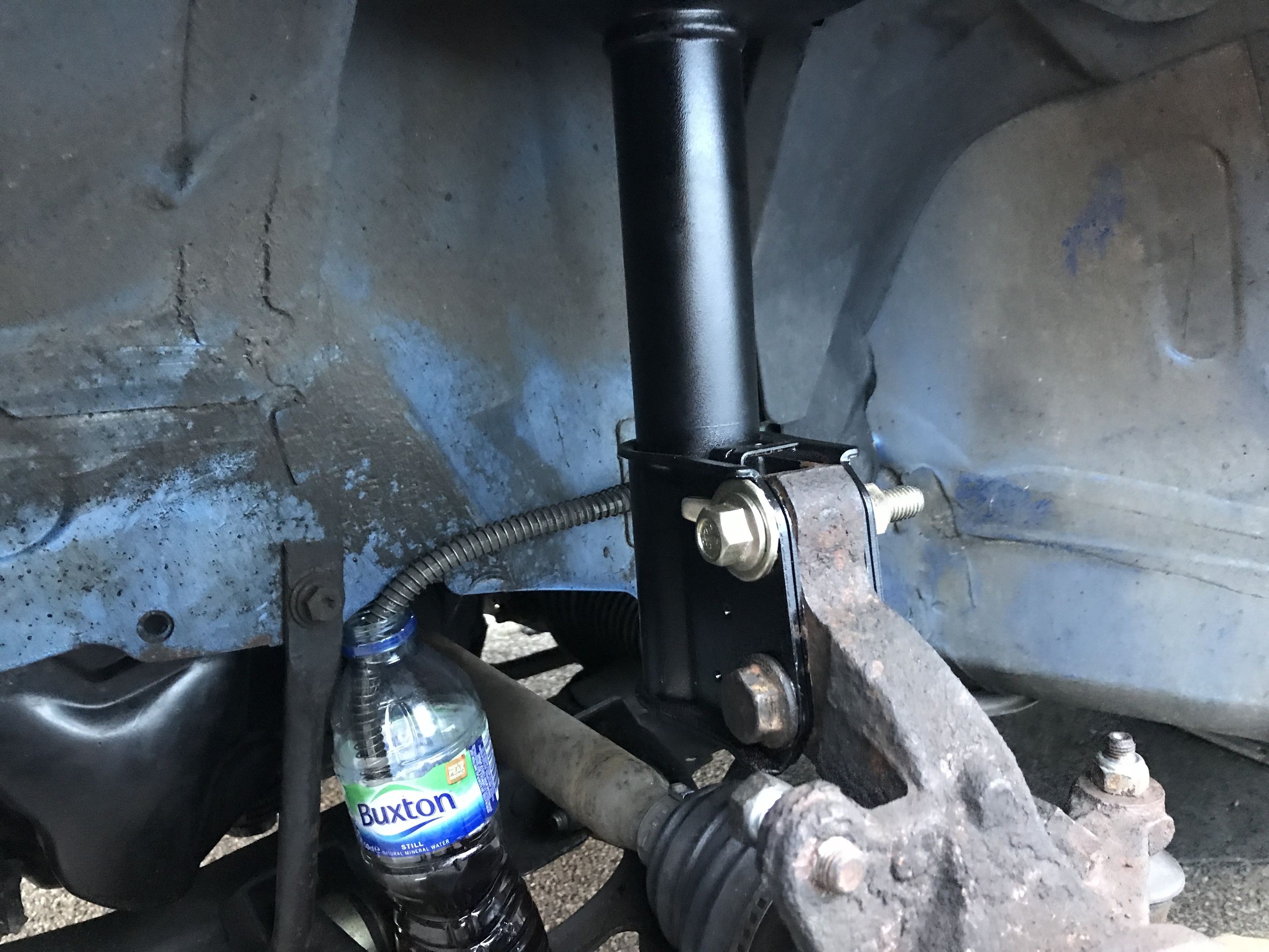

Suspension on now. I've gone for cooksport springs, cup shocks, powerflex camber bolts and KTEC camber shims. Got Powerflex black series beam bushes and upper shock bushes too, to match the wishbone bushes.

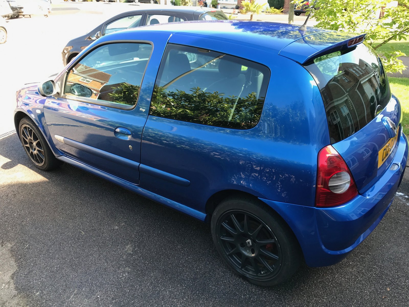

Nice work. Will look so much better with silver turinis back on it.

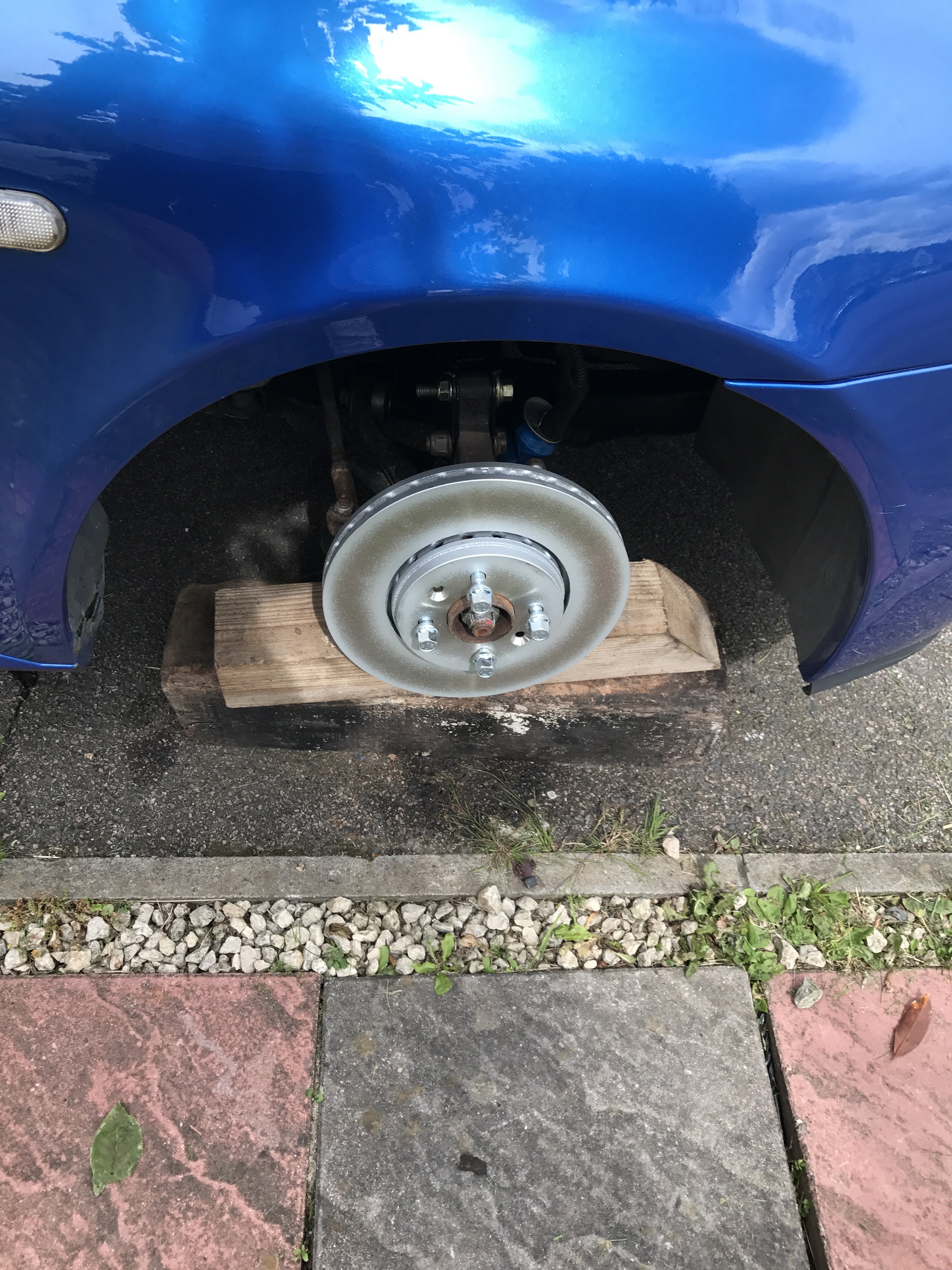

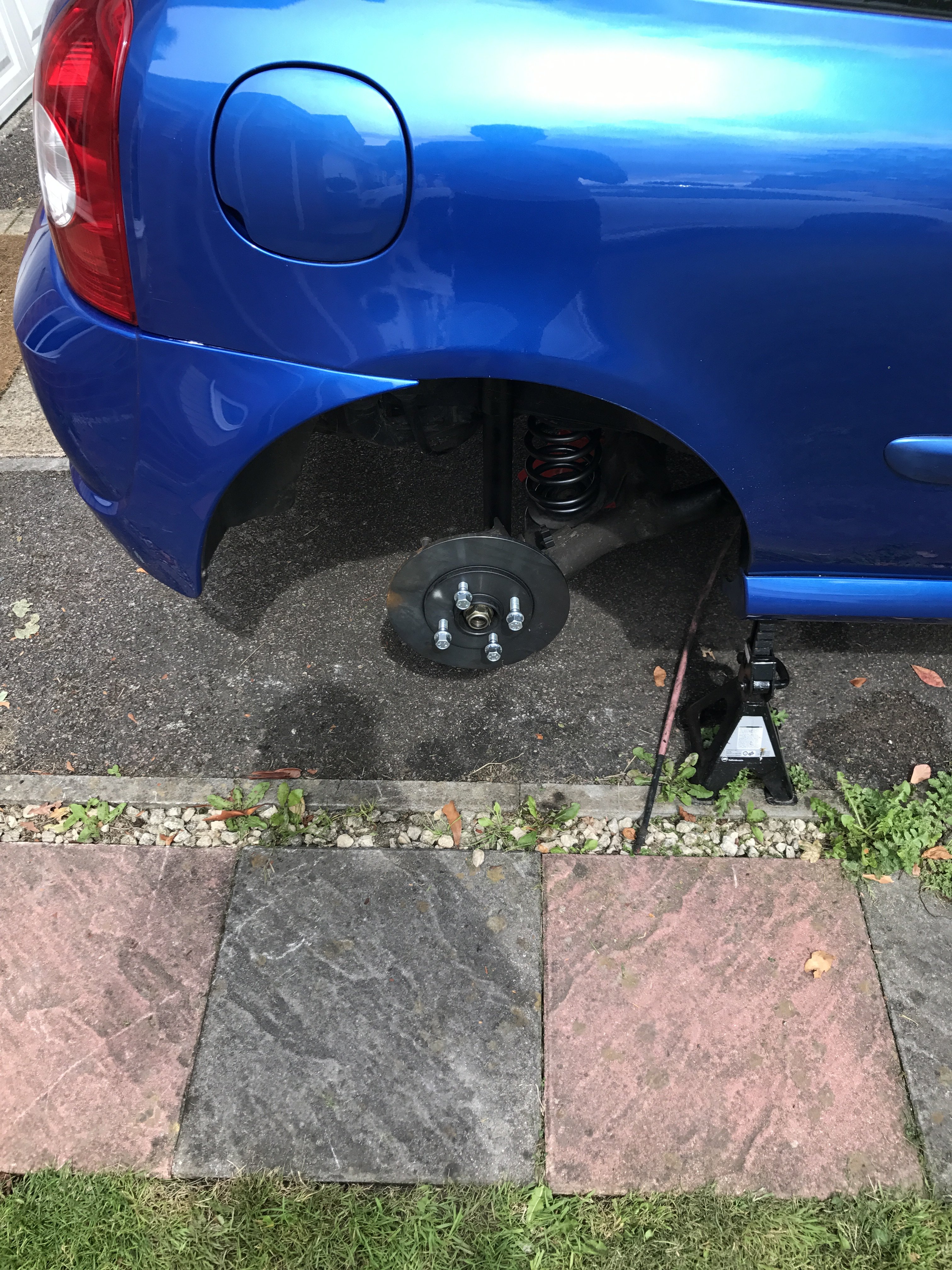

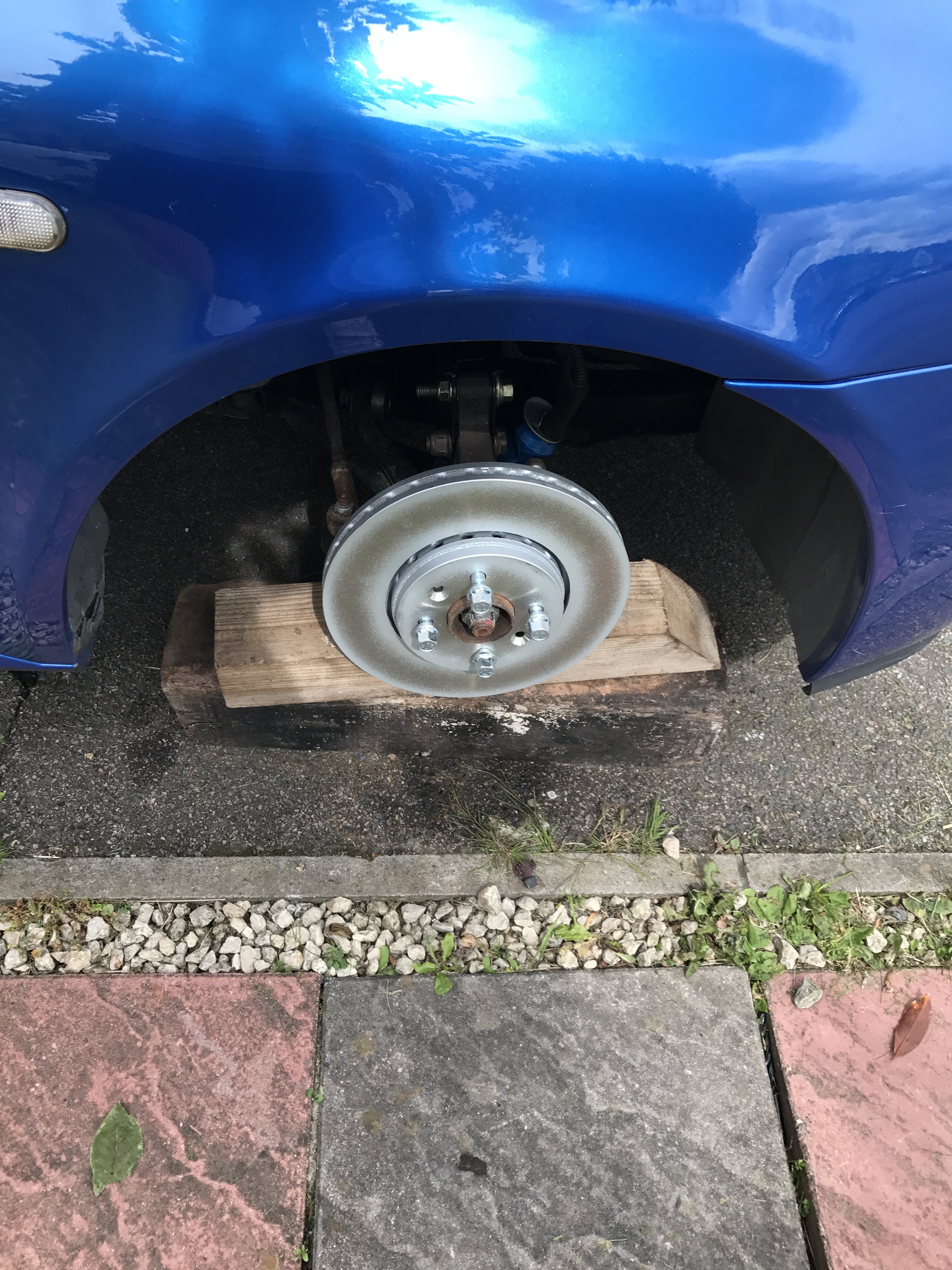

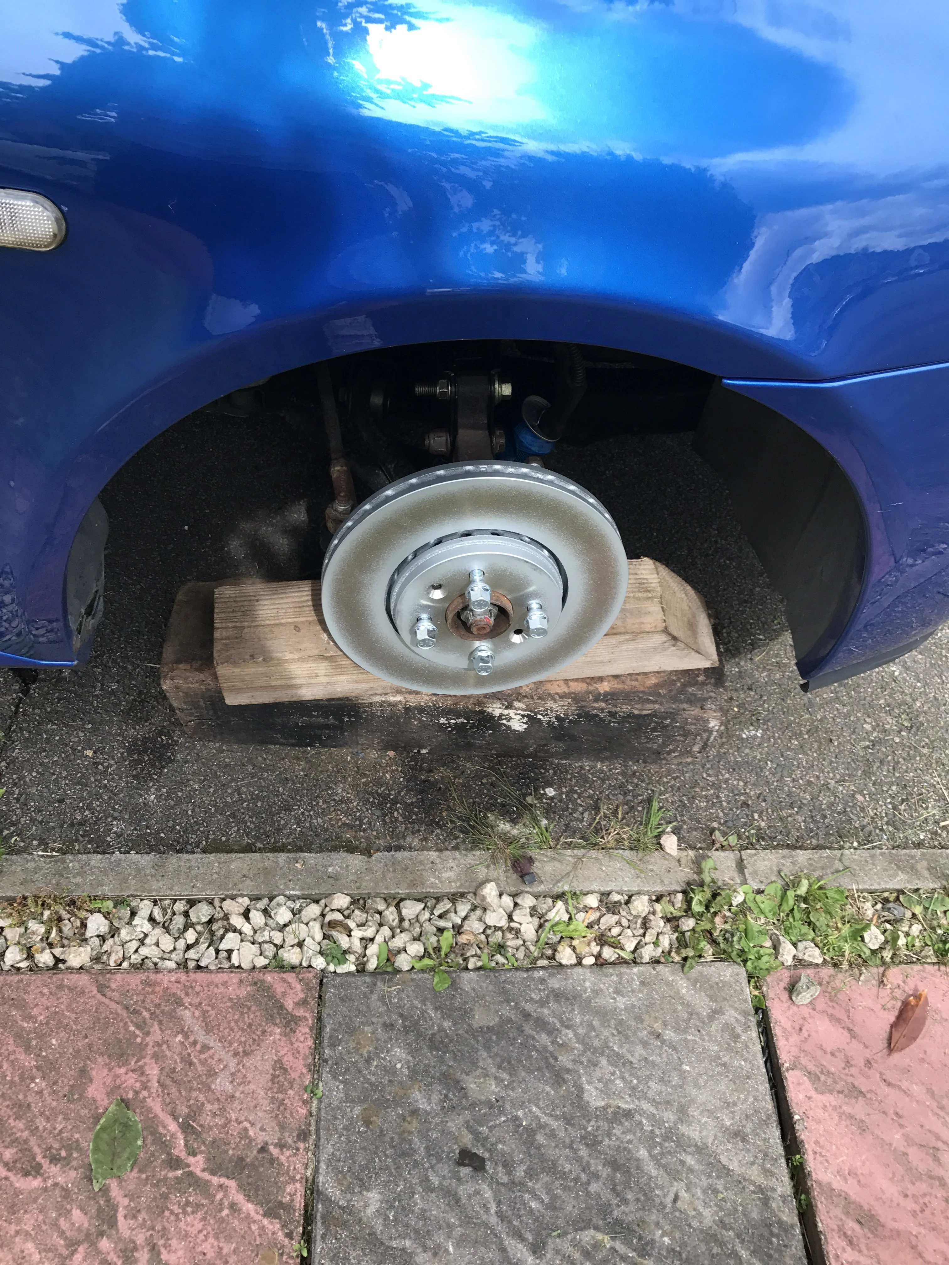

Fitted calipers, brake lines, discs and pads today, then did a quick bleed with my dad....pedal feels fine at minute, but I'll bed pads in and gee if I need to re bleed with some pressure.
Fitted wheels and dropped it off stands, the extra degree of negative camber all around is very clear, and it isn't too low.
