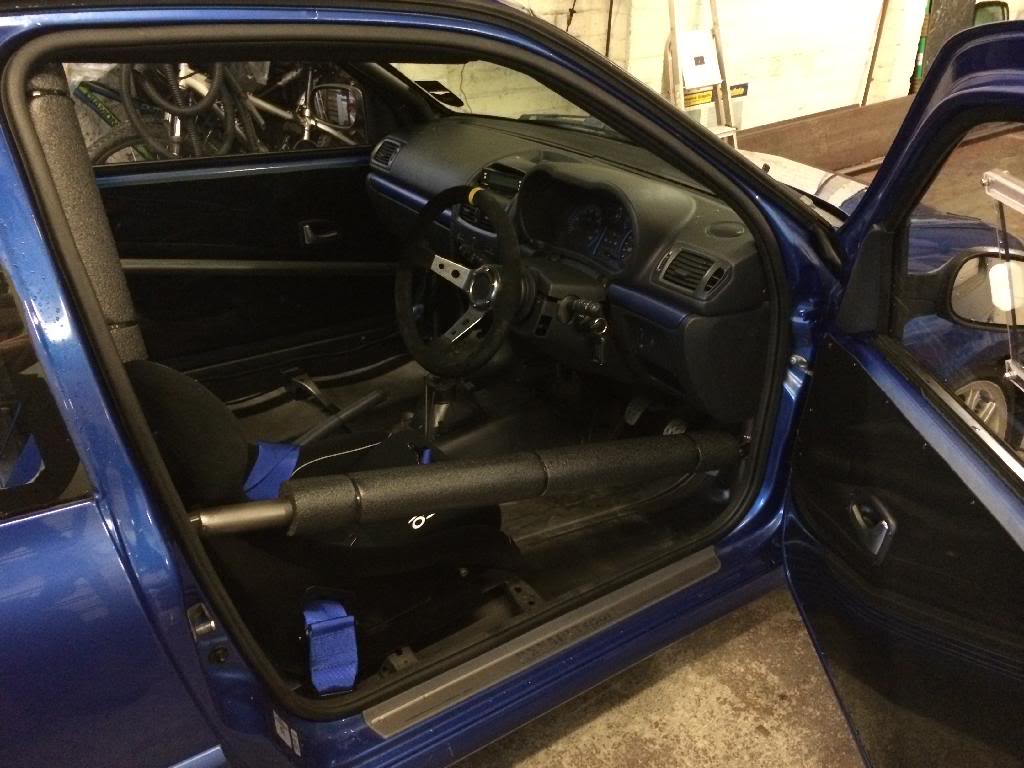

Really liking the interior and how the door cards and windows look together, this will be my next task..
Did I miss it, what did you use to paint your interior, rattle cans or a proper spray gun?
Yeh door cards finish it off well, inside is painted with a spray gun!

Rollbar padding!

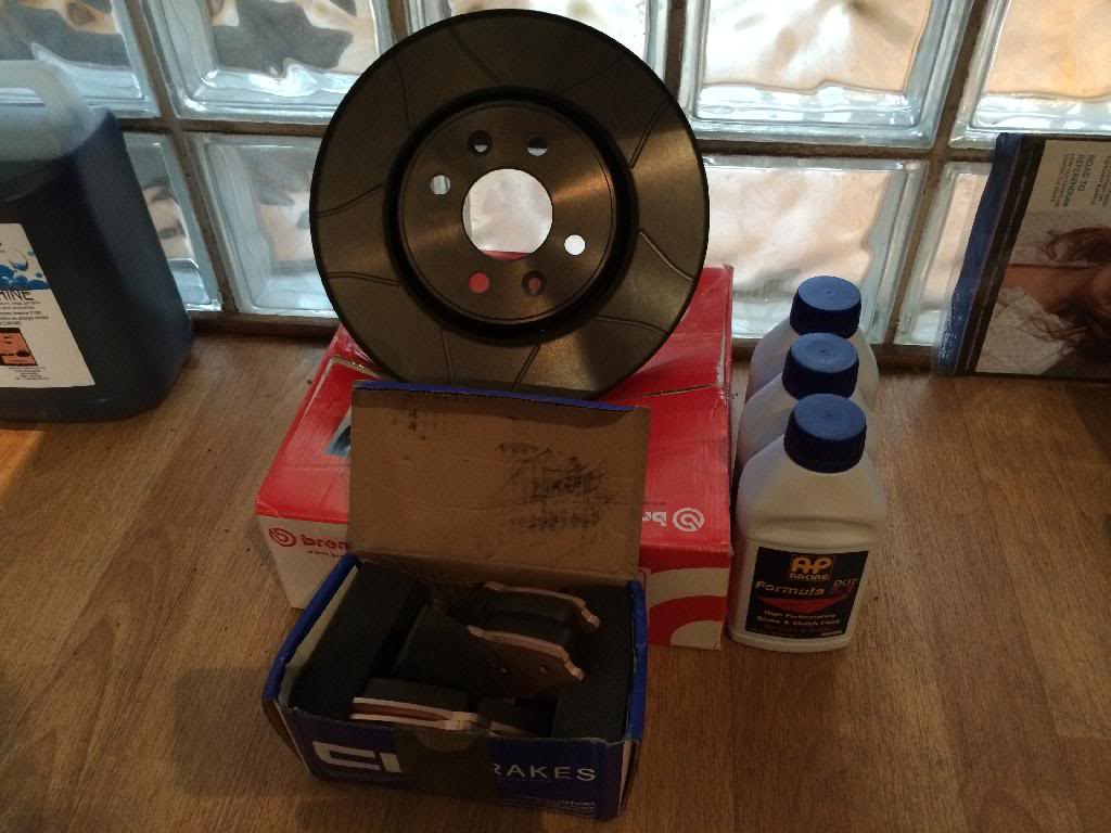

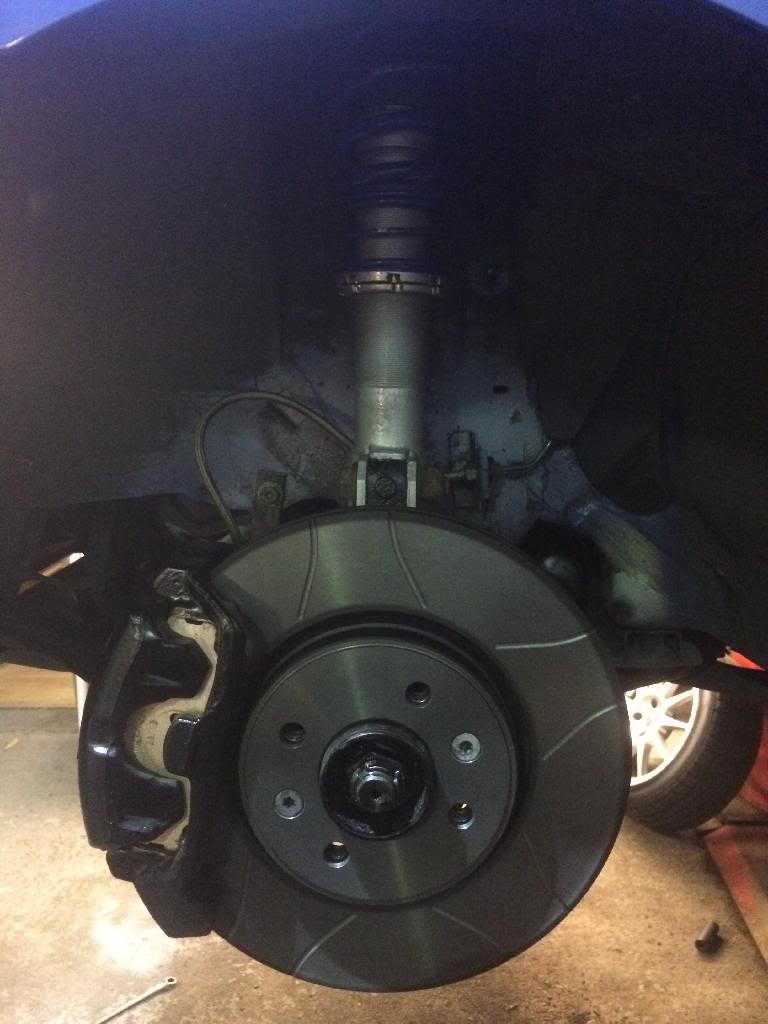

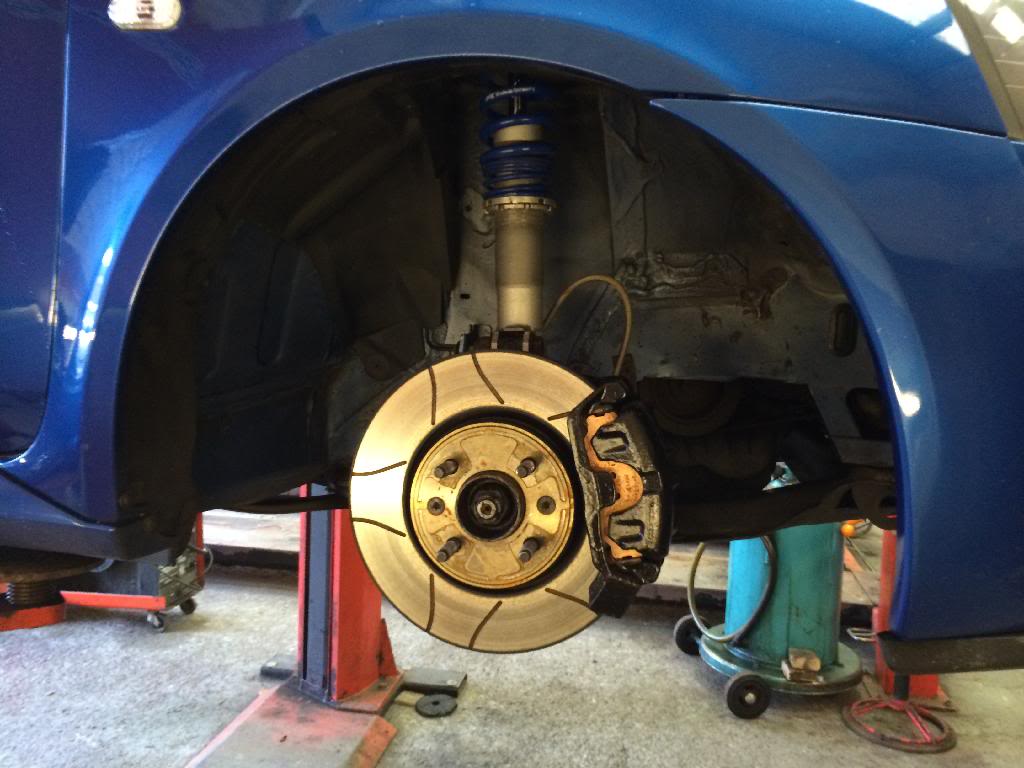

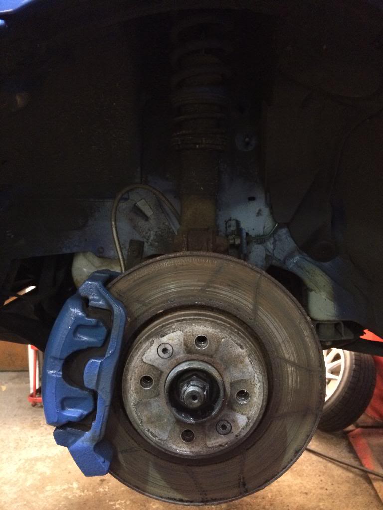

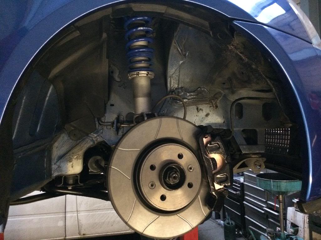

Started on the front suspension and brakes. Got one side done, other side tomorrow!
Fitted Brembo Max discs, CL RC5+ pads, Powerflex inner bushes, new ball joint and track rod end. Gave everything a clean and free off to make for easy adjustments and for when it gets set-up, and a quick paint to freshen up and protect!
not the clearest pictures but gives the idea:
Before (they looked bad- but thankfully it was due to the coilovers being covered in grease to protect!)
After
will do other side tomorrow, maybe rear depending on time and change fluid to AP Racing 5.1. :race:

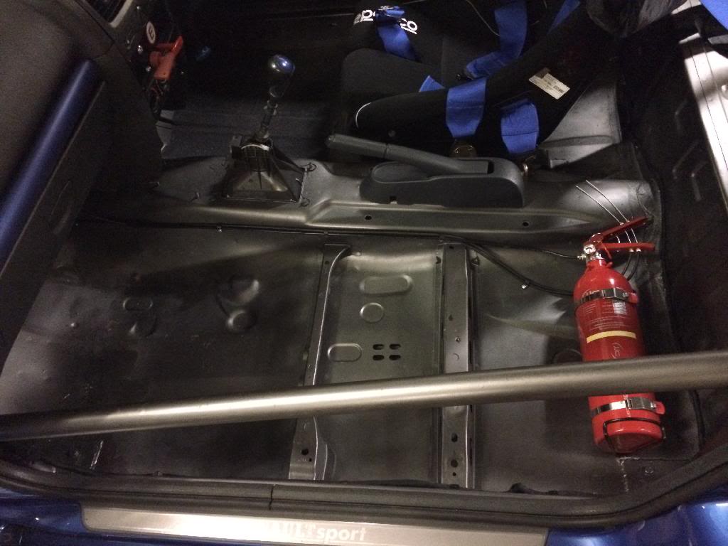

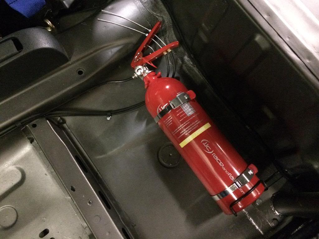

Plumbed in fire extinguisher fitted (time consuming- and needed longer cable than supplied), battery isolator fitted (ign wire still needs found!), rear brakes stripped, cleaned & lubed. Grip tape fitted to floorwell.

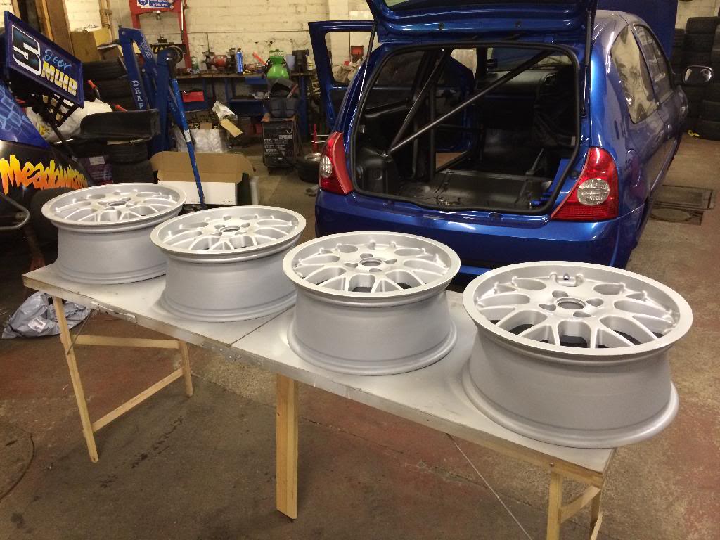

Wheels away to get powdercoated (what colour suit it best?) then new 888s to fit when they return.
Got some spare wheels (BBS RX) and had them stripped then painted them, ive got part worn slicks for summer track days and maybe fit wets if required.

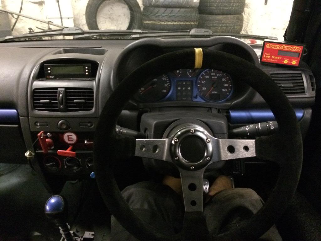

Fire extinguisher finished.
Battery isolator fitted and marshal cut off fitted.

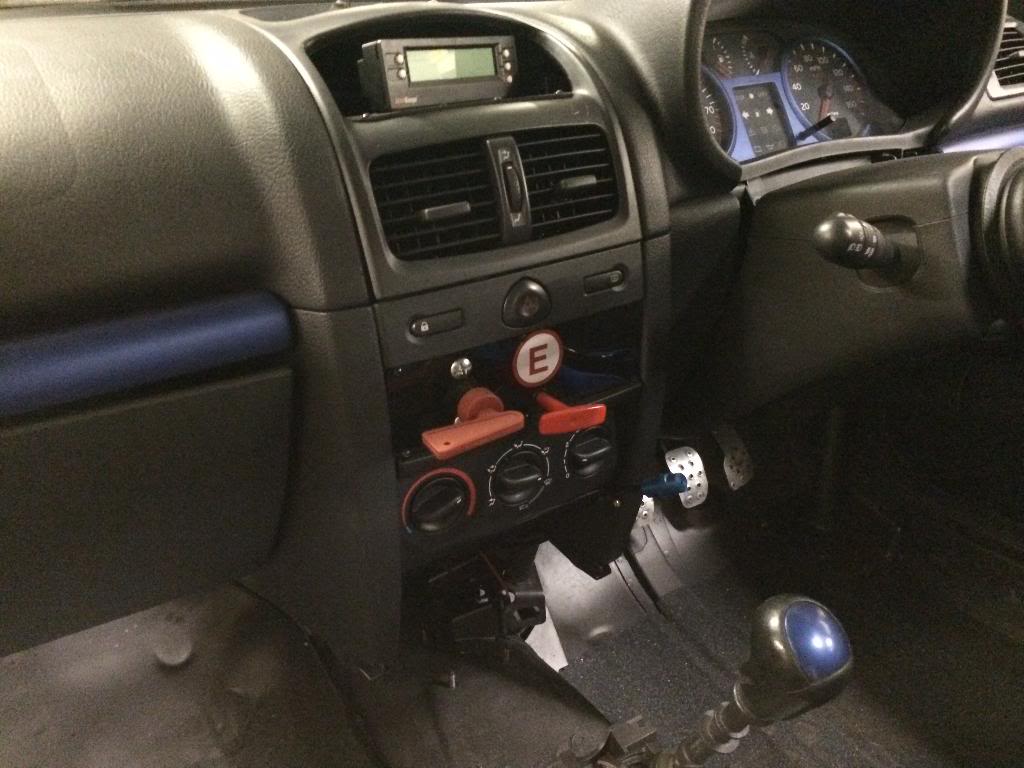

Lap timer fitted.

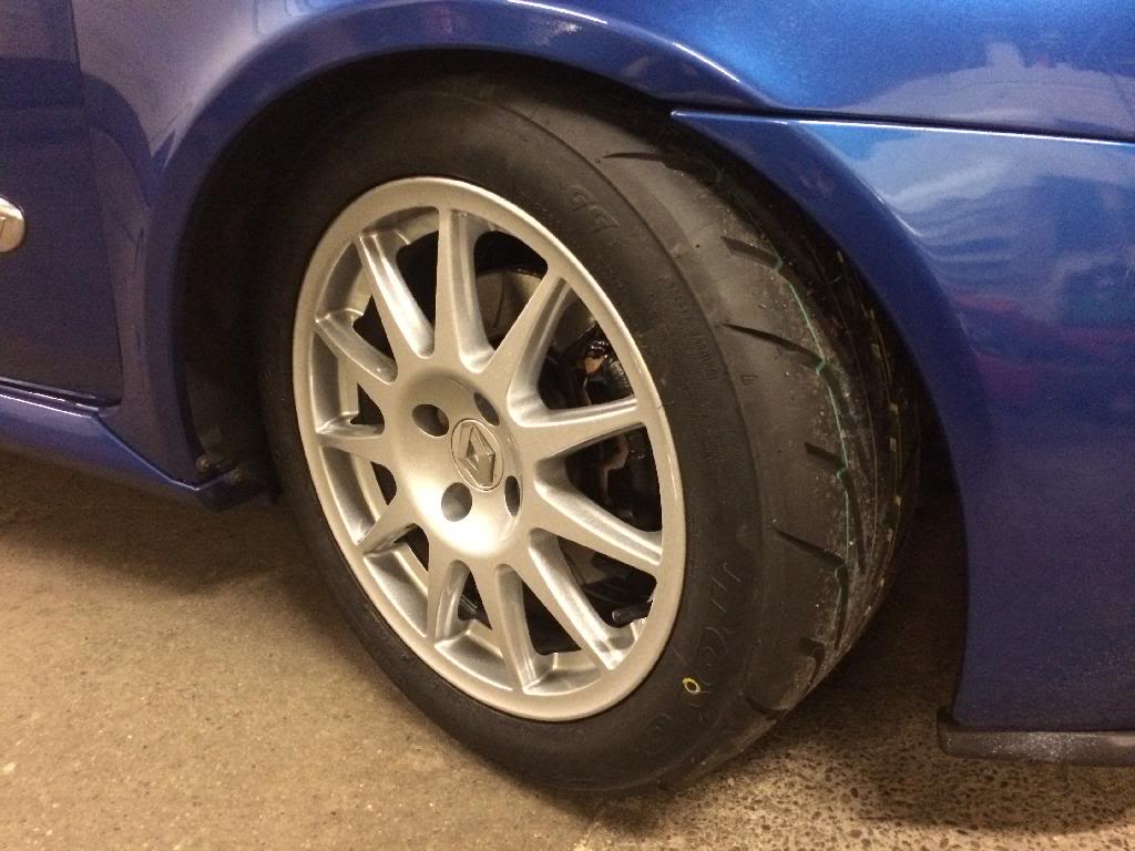

Wheels freshly refurbished and spanking 888s fitted.

Whats involved in wiring the DT lap timer? Do you need a beacon? I'm needing one, most racers run them at KH so they must be okay.
  172 Cup (Track)
Cheers Morgan. Garage is my family business, garage/ MOT station. Helps when im a mechanic/ MOT tester. :clap:
Lap timer is just battery powered and has a pick up i have ran round to the passenger rear on the rollcage pointing out the window to pick up a beacon.
I have a beacon, but im hoping Knockhill have one thats always on to save the messing around placing a beacon somewhere safe and out of view, as i think lap timing is banned at track days etc? If Knockhill dont have a beacon then a beacon will be needed to put on the pit wall.
If your there when i am, my beacon could be used for your timer ( or any amount of timers), its just an infra red beam.
Track day events are not insured to allow lap timing...would be a bonus iff the beacon is left "on" though. Marshals would have a field day with that DT timer if they saw that though at Brands lol

16" although im on the look out for 15" Superleggeras which id prefer size wise. 16s are pretty close in there until its raised a bit, due to 888s only being available in 195/50/16.
  Passat TDi
I was going to ask about clearance's is it tight arch side? I prefer the look on 16's especially the turini! and I doubt I'd notice the difference in handling between a 15 and 16 plus I dont want to go super low due to roll center's etc hmmmm decisions
  172 cup, Impreza P1
As I said on TS, they will rub. 15's are required for track work with lowered suspension.
neil a
My car had 16"888's on when i bought it on track it only rubbed lightly on the near side rear, but switched to 15's and did notice a improvement on track plus tyres are a lot cheaper.

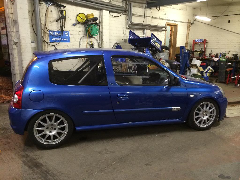

Cars had more done, just havent updated. Its going out for its first outing tomorrow at Knockhill!
From what i can remember ive done since last update-
Drained oils and filled with Fuchs pro S engine oil and Elf synto something gear oil.

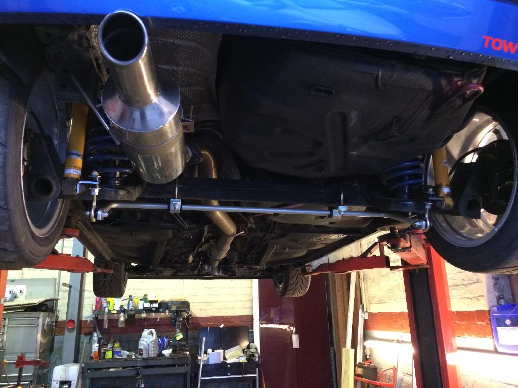

Bought and fitted rear roll bar.
Bought and fitted a sunstrip (sun visors have been recycled!).
Lots of small tidying up jobs!!
Rear antiroll bar fitted and mk4 Golf spring adjusters as mine were seized and needed raising!
Height set at front and how its looking in there

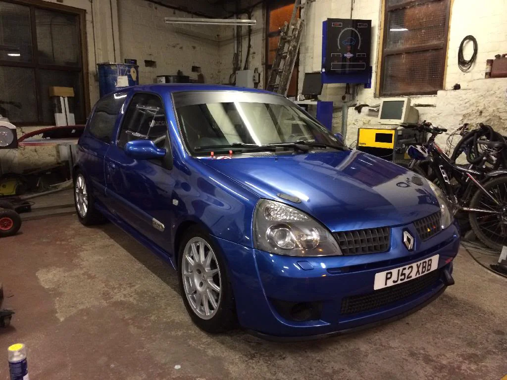

Car all washed and ready to be loaded up. Note the sunstrip
Loaded and good to go, just need rocket fuel in the morning and im set.

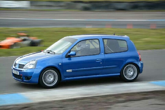

Well first outing was pretty much spot on, never had to touch a thing on the car all day, it was totally reliable and handled great.
Biggest problem is gearbox is crunching into gears. :( Brakes also lost their sharpness after around 10laps.
Heres an onboard of me chasing a Clio 172 sprint car with throttle bodies and a limited slip diff, then an M3.
http://youtu.be/ywbpbFzGApo
And a pic
