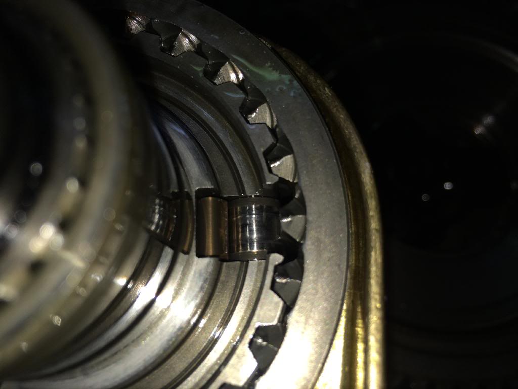

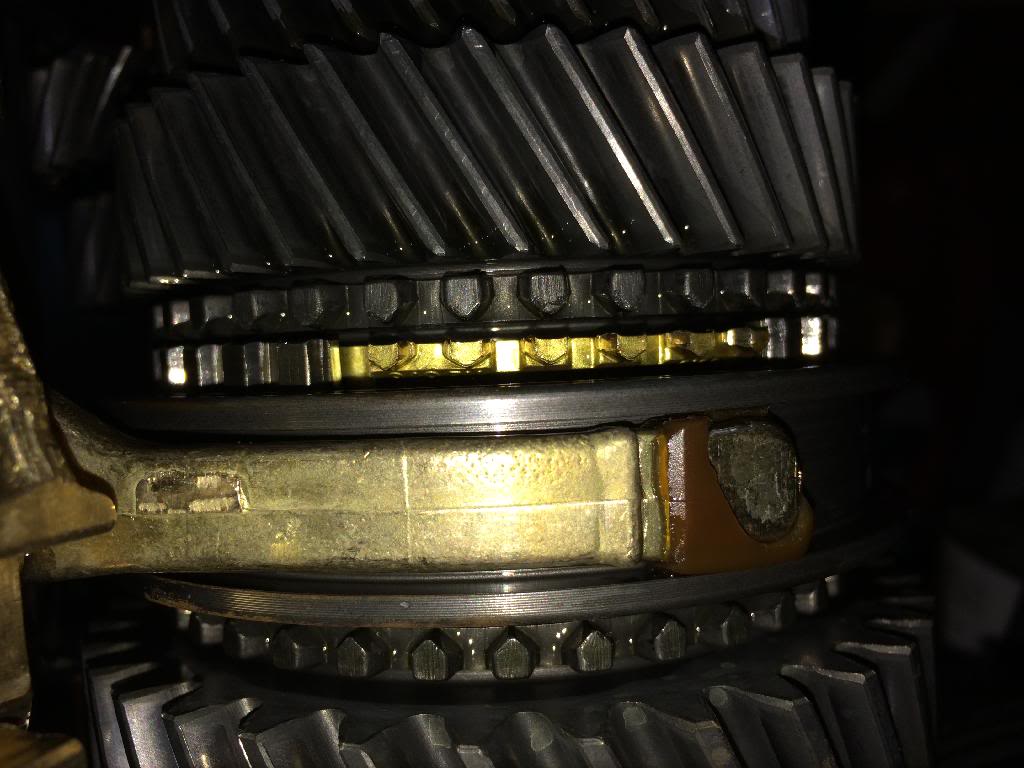

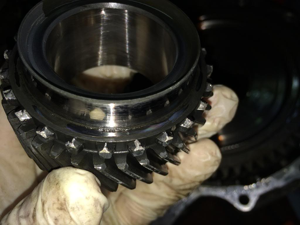

Ok, so got my gearbox out and opened up and the gear edges are rounded and damaged. As are the synchro hubs.
I have a spare box and its no better. Nightmare.
I really need 2nd, 3rd, 4th and both synchro hubs. Surely cost s fortune.
As you can see in pic, the lower gear (1st) looks a lot better condition than the upper (2nd) gear!

I really havent done much with gearboxes, but to me the synchros look fine and the gears and hubs are what have damage to them. Its not crazy fucked but probably doesnt take much when your changing quickly at 7500rpm..!?
See better here

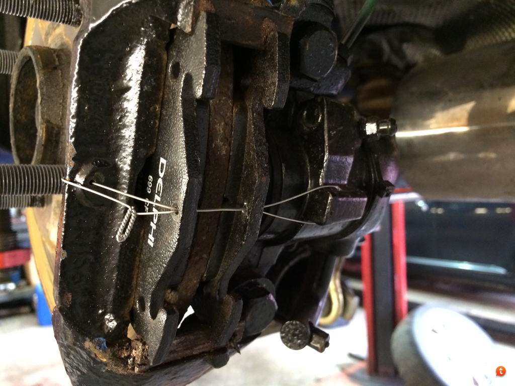

Thankfully got gearbox on time last Friday, stripped it and found it to be mint, changed usual leaking selector seal, rebuilt it and fitted. Ready and on track last Saturday and was going well again. Unfortunately lost a rear brake pad on a warm up lap and missed out on the 6 Clio train session.
That could have been a lot worse, so ive fitted new pads and made sure that cant happen again as ive heard its common! Bought a lock wire kit and done this
Its a load off the mind having that done after having the same bother, the pad fixing is a stupid arrangement anyway.
