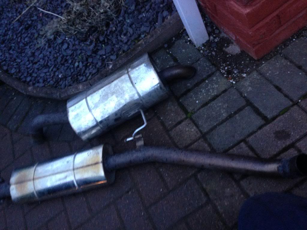

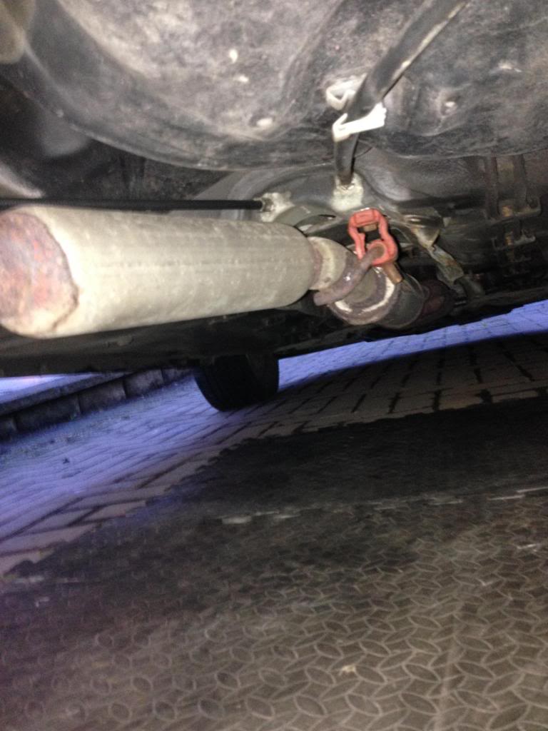

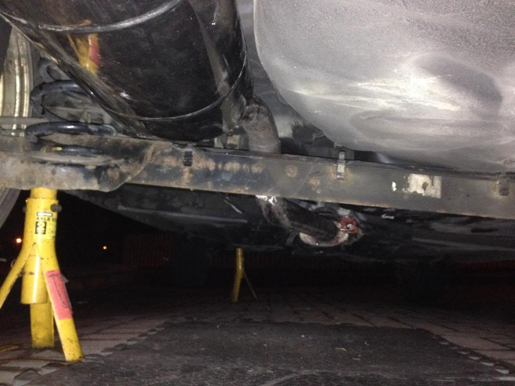

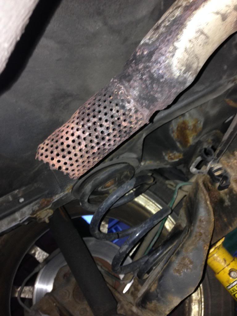

The other fault was a knocking from the back which i thought was maybe a bush or failed suspension part. Then one day last week the back box decided to fall of the car on my way up to my folks! :mad: Good news though the knocking had stopped! :)
This is what was left -

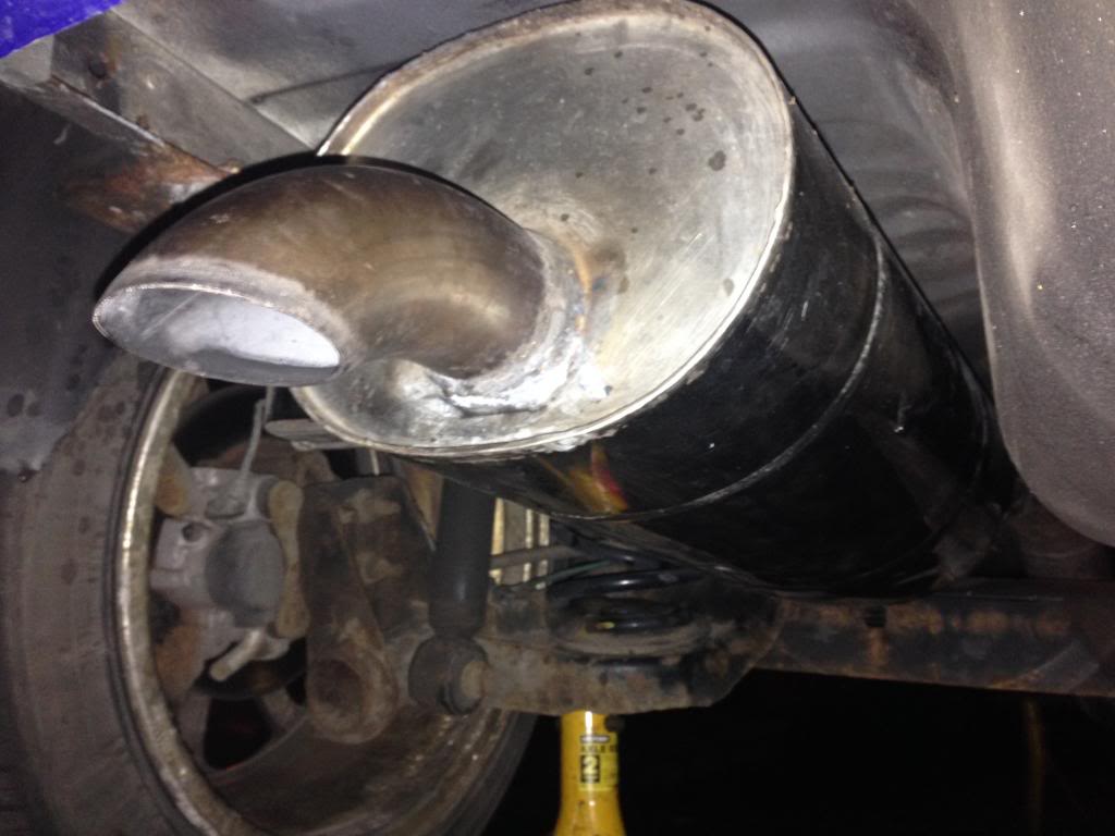

So i bought this ktec stealth cat back from Clio172T (Matt)
Nice easy job and sounds so much better.

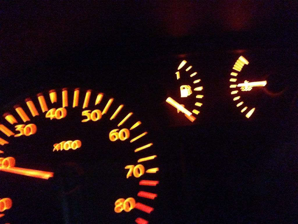

Also meant to ask about the rev limiter. I know the car gives you an extra 1000revs once heated up. The thermostat now goes to mid way but i am still not getting my extra revs all of the time! Any ideas what the cause could be? Cheers.
Car looks good, what was wrong with the exhaust. That strainer tailpipe look is in this season ;)
Your rev issue is the temp switch, get that replaced and it will be sorted. If your not able to do the belts yourself then SWR are not far from you and there prices are brilliant from what I have seen.

I bet it sounded fruity.
Yeah I meant the temp sensor that was a typo, they don't have a temp switch. The sensor is screwed into the thermostat housing on the gearbox side of the engine.

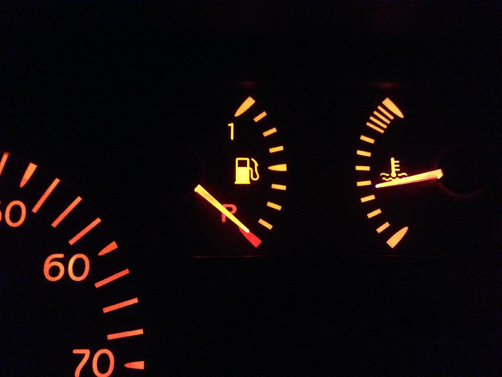

So i replaced the temperature sensor today but still have an issue with the rev limiter
When i sit in traffic for a bit the temp goes up and the rev limiter will go up for a short period until the car cools down a bit after i get moving.
Hear is pic of the temp gauge when i am getting the extended rev limiter
And this is the gauge as it runs most of the time.
Can anyone shed any light on this? Its doing my head in!
cheers.
So finally got to the bottom of it! I bought a cheap temp sensor from ebay and that didn't work it made the gauge read cooler!!!!! So i then decided to buy a genuine one from Renault and now the temp gauge is spot on and i have the extra revs! :D

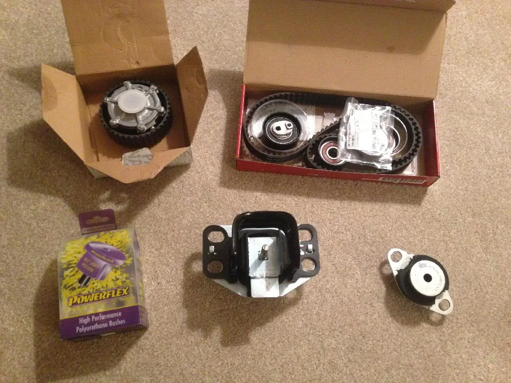

Also have had some new parts delivered!
Cant wait to get them fitted hopefully will notice a big difference.
Next thing to do is get this all fitted and then look at getting some suspension sorted out!

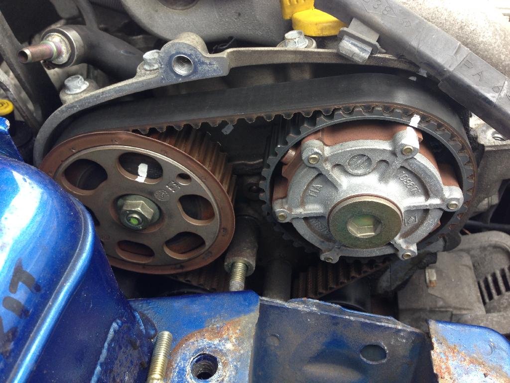

First thing I got done was the timing belt and dephaser pulley.
Wasn't as bad as everyone made out. While I was there I replaced all the engine mounts and uprated the dogbone with the powerflex kit.

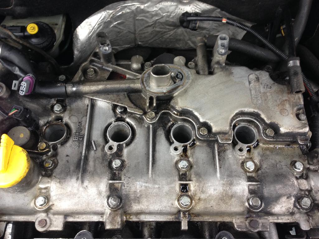

next thing I did was change the plugs. I found that cylinders 3 and 4 had about 10mm of oil around the spark plugs! -
im guessing that the oil has leaked from the top part of the rocker cover! Is this common? Also is it a paper gasket or just instant gasket? Any info would be appreciated!

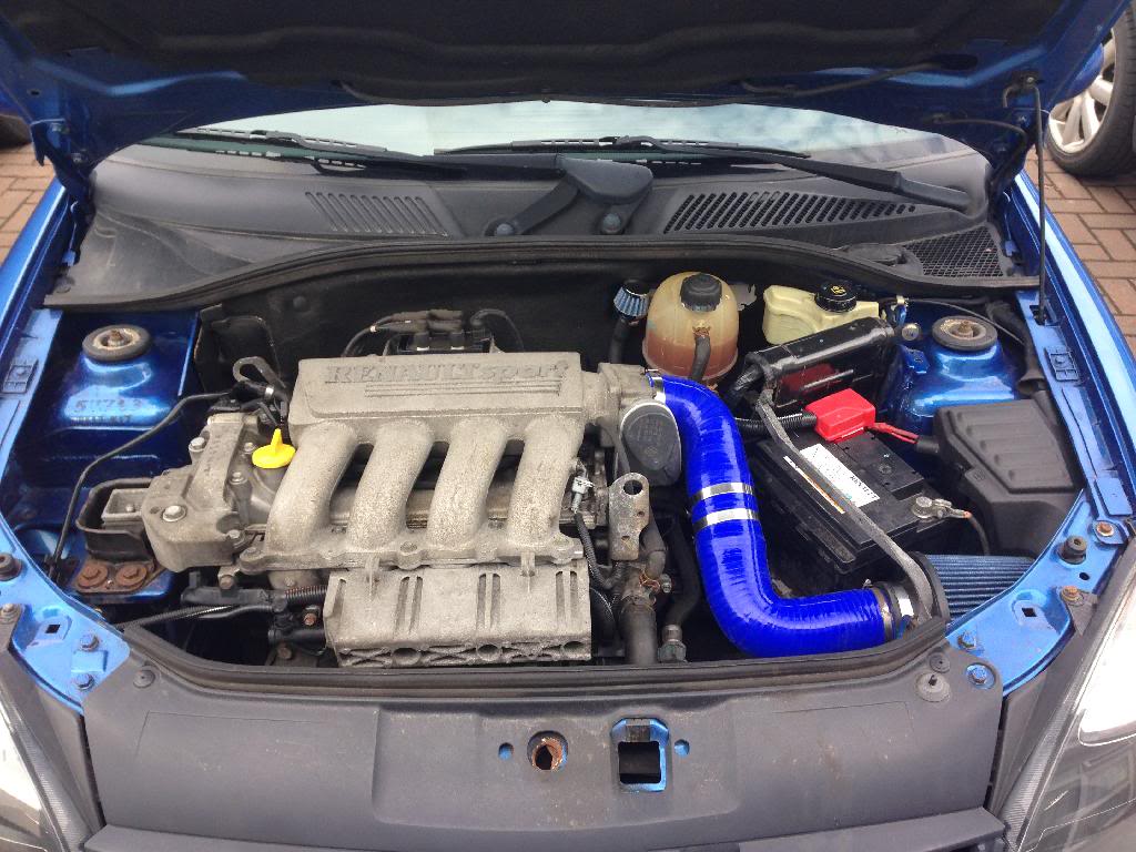

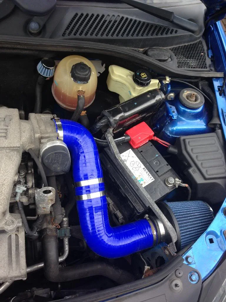

next thing I done was make an induction kit! -
really pleased with how it turned out and it sounds great.

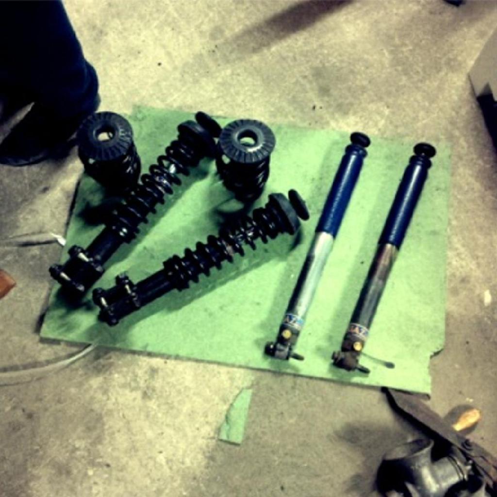

Then it was on to fitting the coilovers that I had acquired!
And hear are a couple of pictures of how that car is sitting now.
has anyone found that fitting coilovers has affected there tracking? Car seems to be a bit jumpy at the front end over bumps!

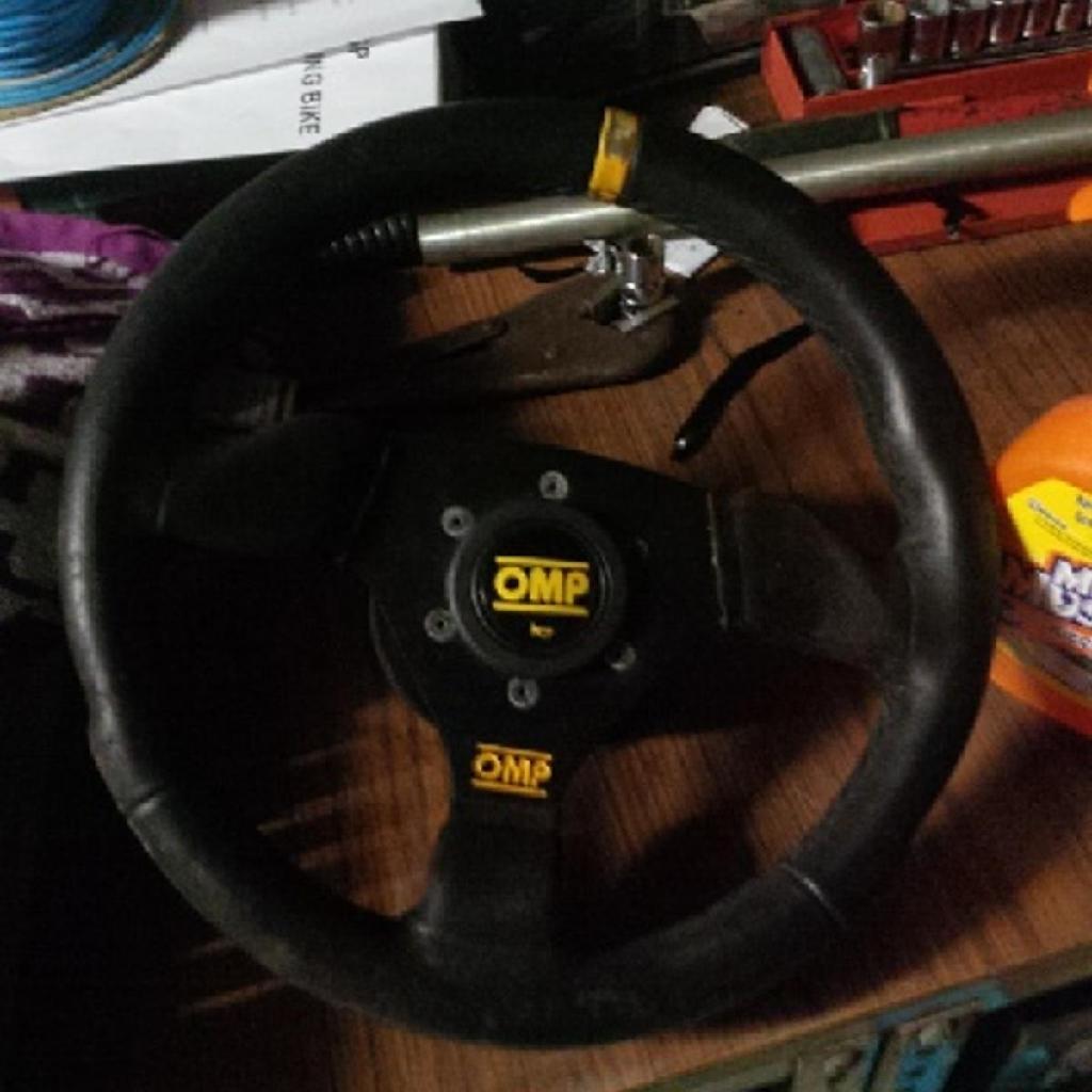

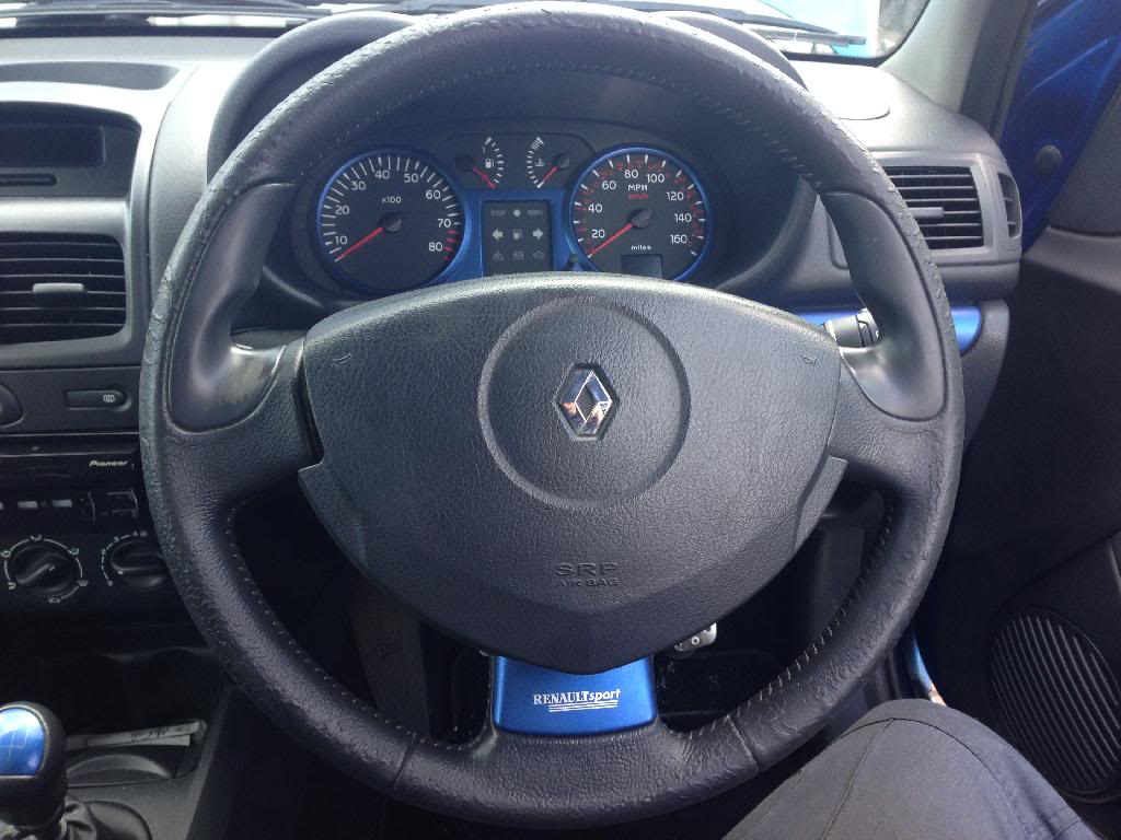

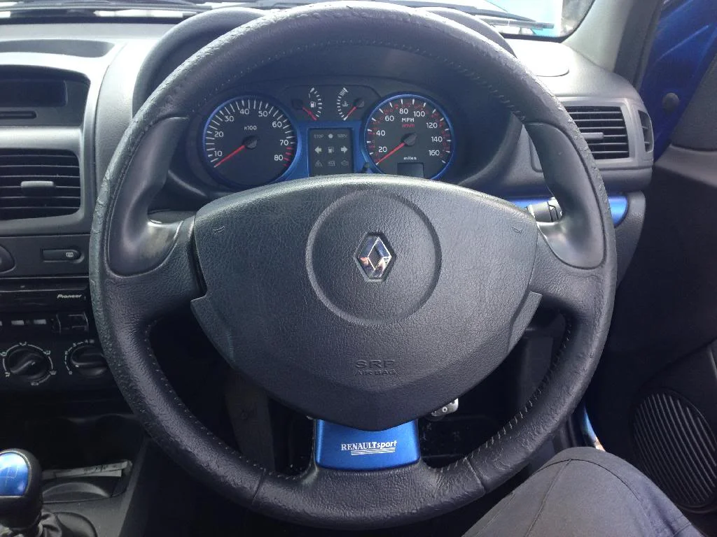

Last thing I had to do was change the steering wheel from this -
to this -

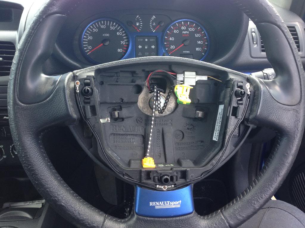

but I only got this far!
i managed to get the bolt out but the wheel will not budge. I have tried hammering, pulling it, heating it, wobbling it. Doesn't seem to want to move!!! Any tips on how to get this off?

Oil could be from leaking rocker cover or even spilling it whilst topping up. It has two gaskets, one is a pre formed thing, and the main cover is just a tube of sealant. (I think).
The wheel probably needs a good wiggling tbh, leave the bolt in a bit and hang off it lol.
Tracking will need done after fitting coilovers. Try CLCM at Hermiston Gait, they done my 182 and it was spot on.
