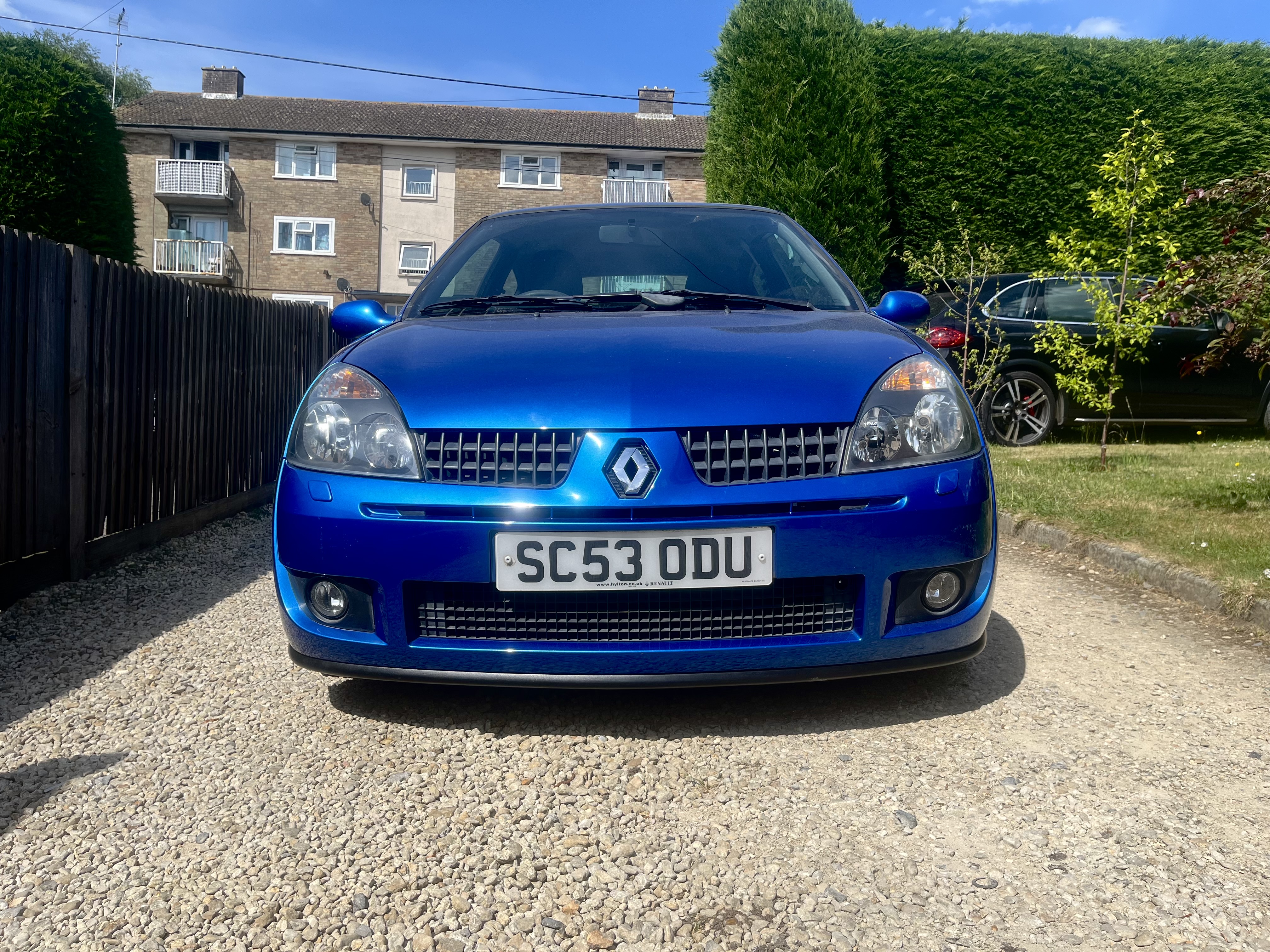

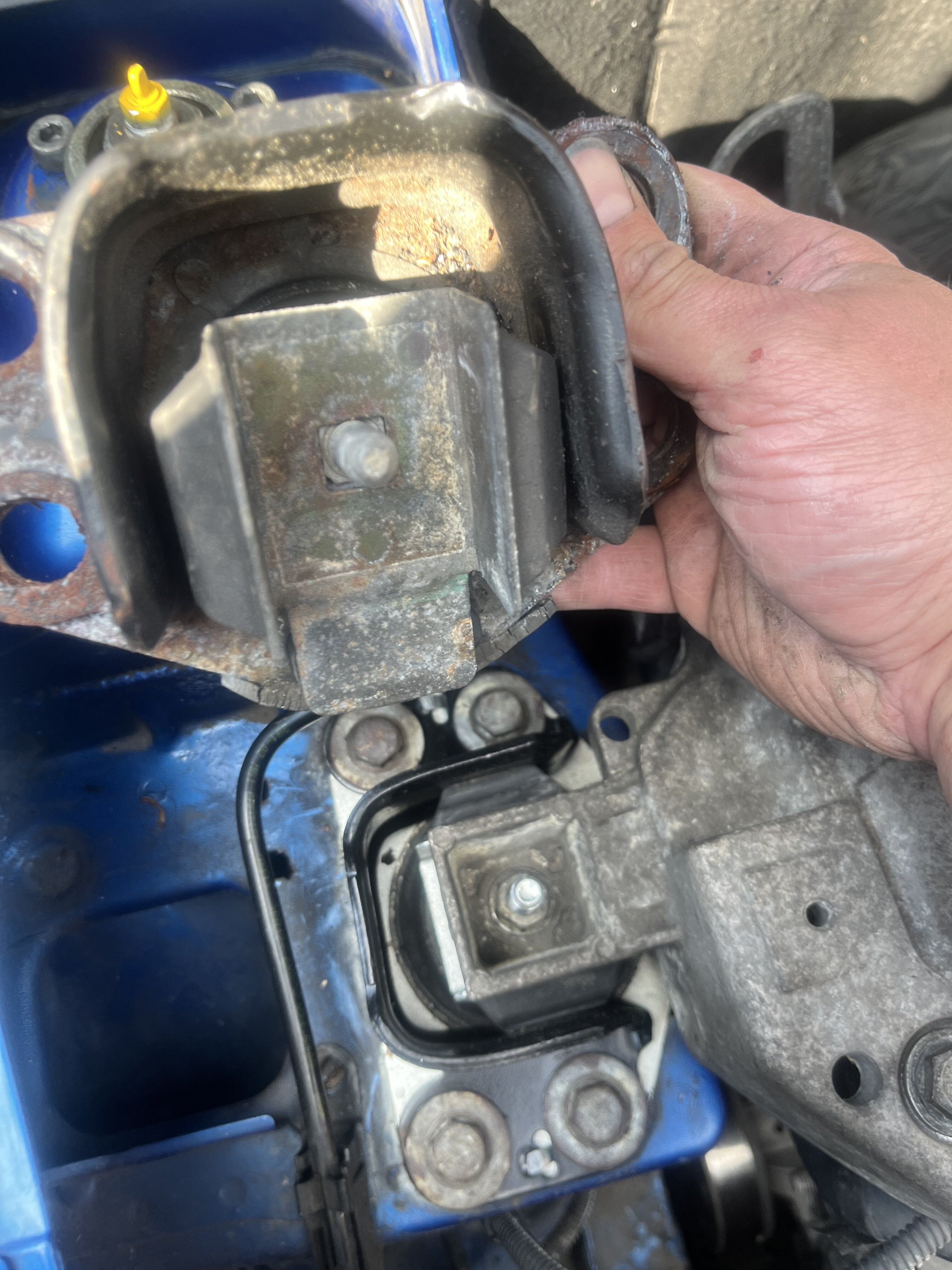

Small uodate.

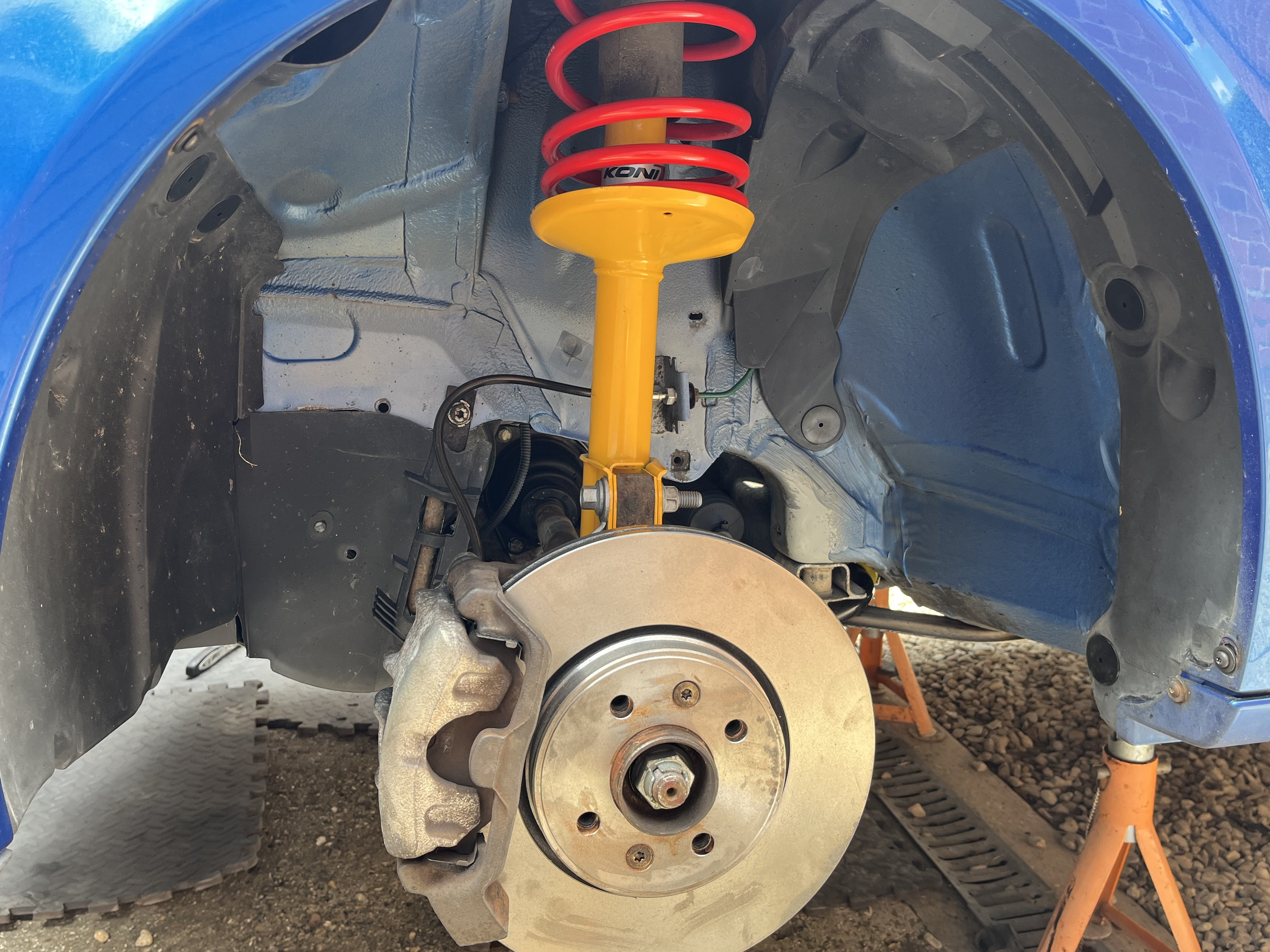

Bumper back on, arch liners fitted, discs fitted (still waiting for pads), brakes bled and engine mount fitted.
Should be back on the ground tomorrow.
Snappy sent me a pic of the steering wheel, will be with me tomorrow.

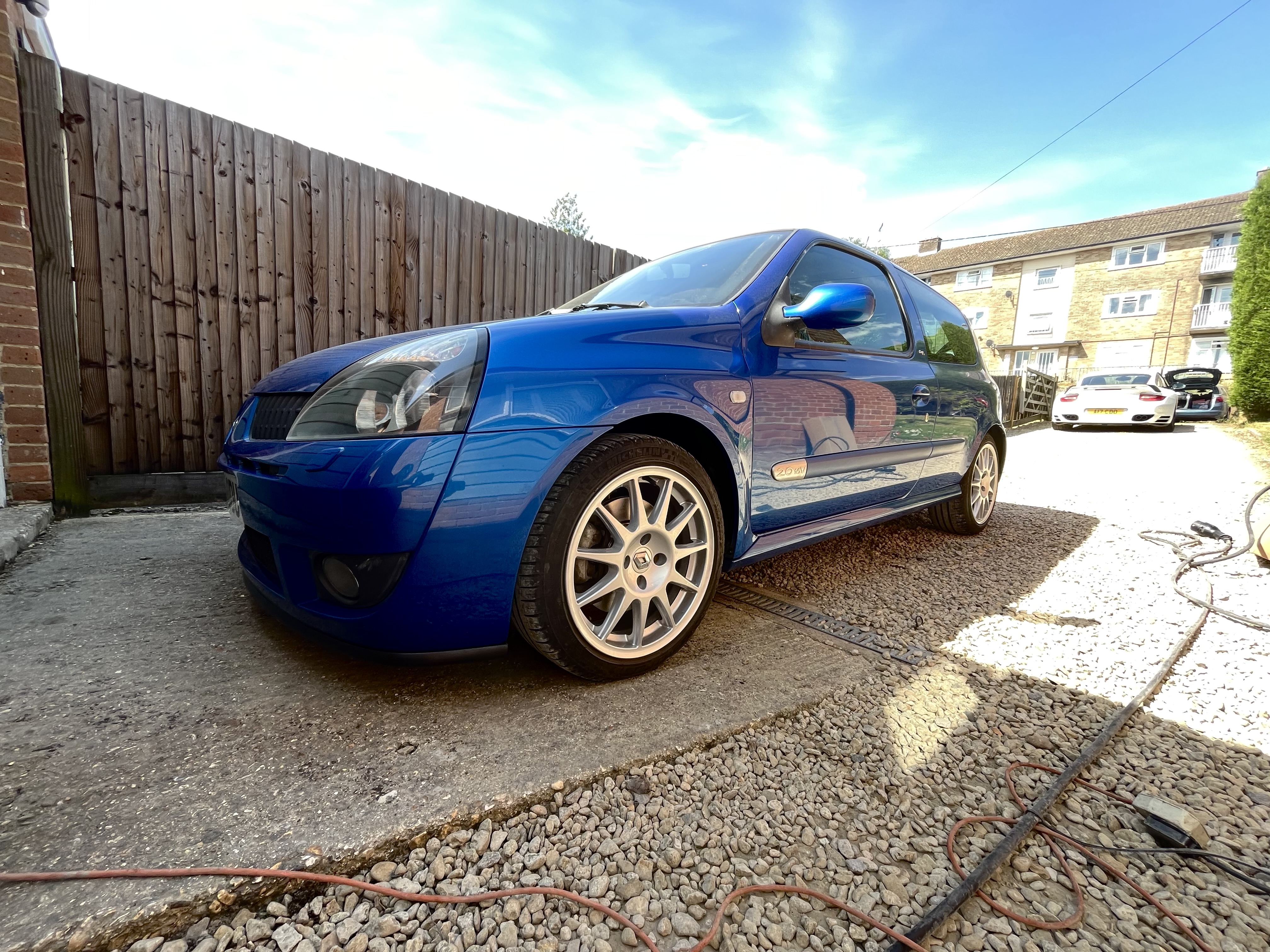

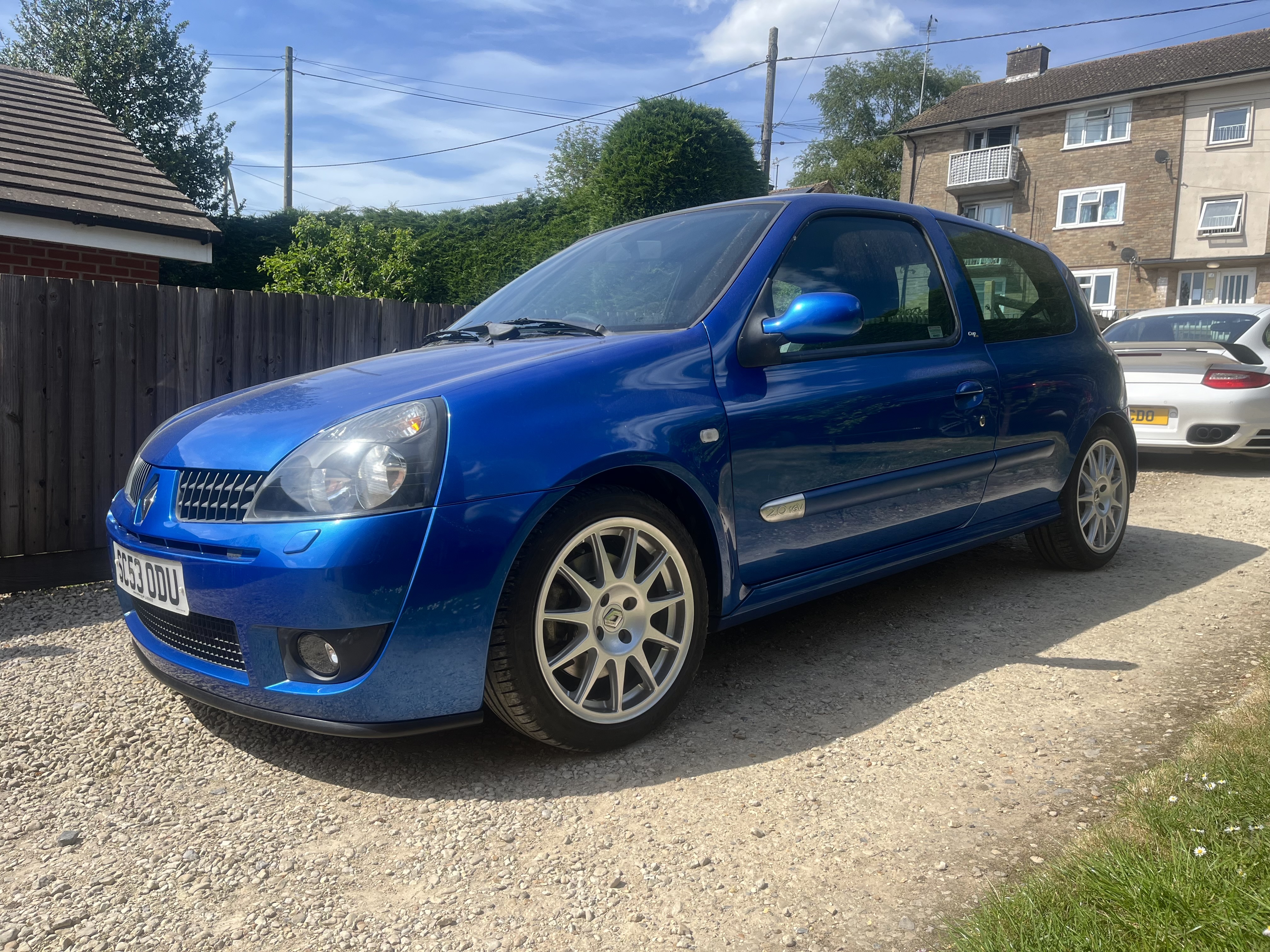

Finally back on the ground.
Drove it up and down the road to check for any untoward noises and all is good.
Suspension/springs will take 24hrs or so to settle.
Still need to do a oil change and check the gearbox oil level, can wait until the weekend.
Friday i will start on the interior :)

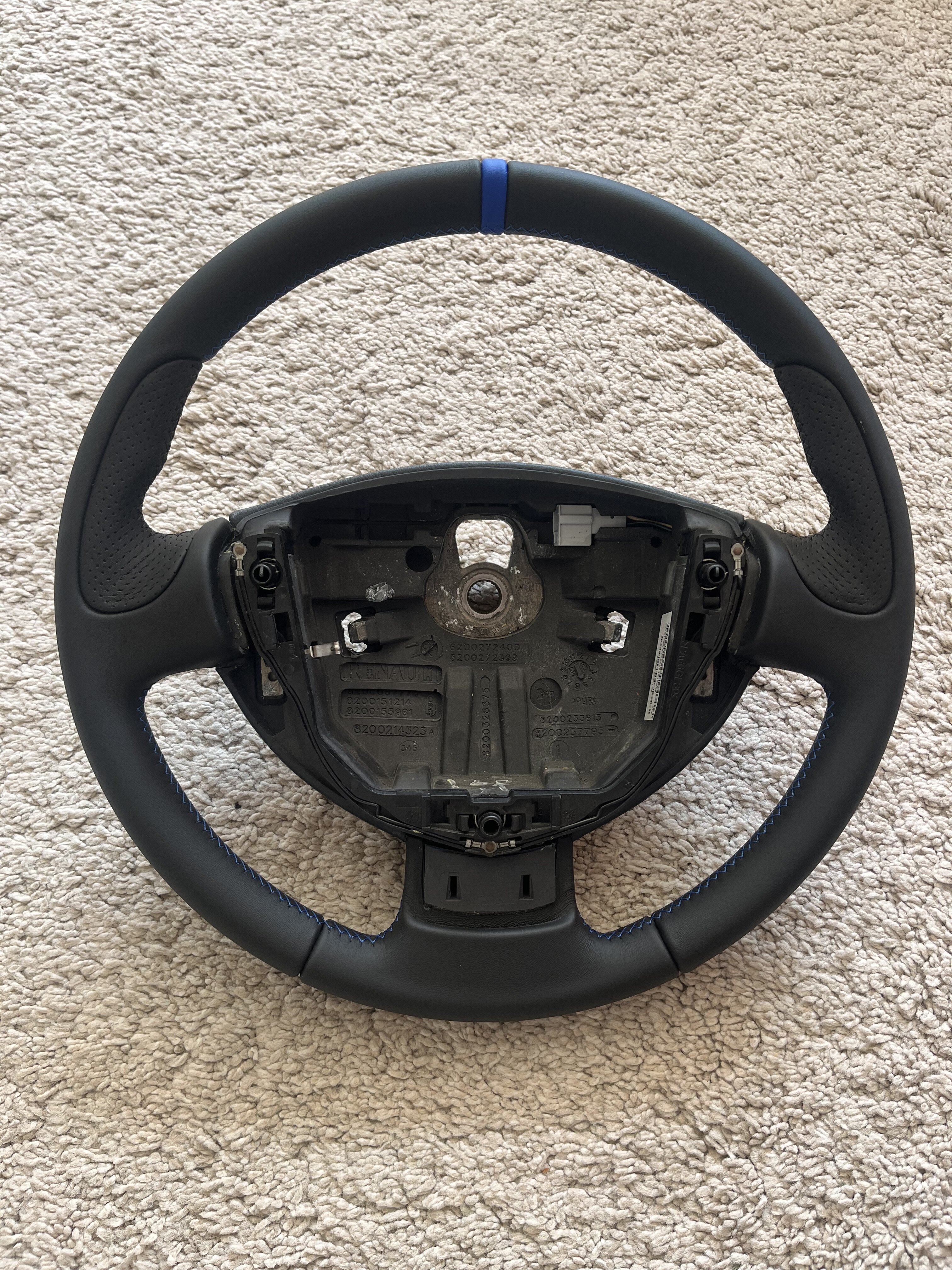

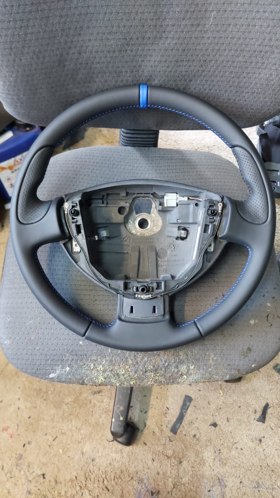

Snappy steering wheel arrived today! Well chuffed.
Fingers crossed it delivers after alignment has been completed.

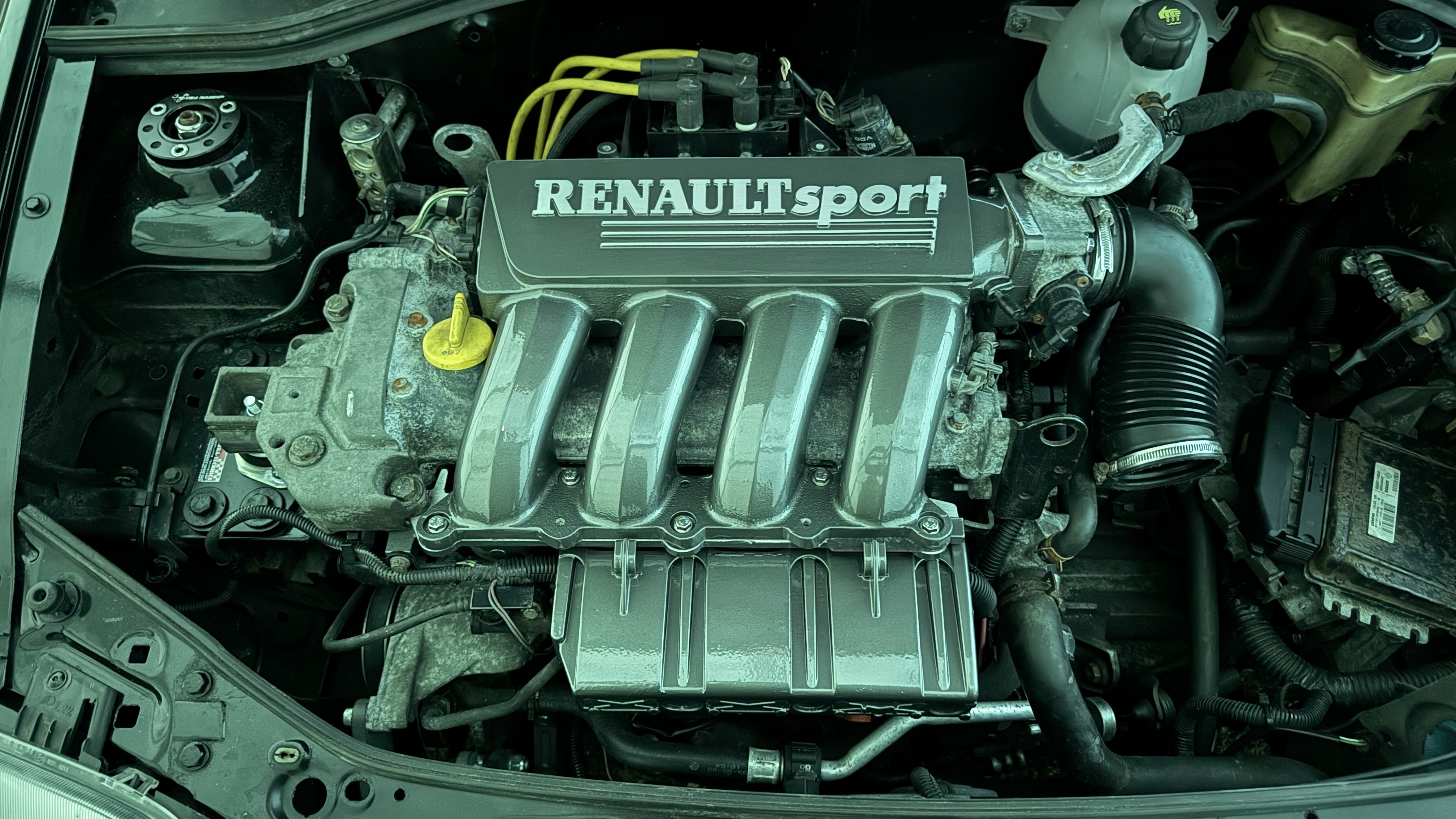

Next decision….
RS2 inlet (if i can find one)
Or
Throttle bodies
Daz...
  Inferno 182 Cup
Remap to sort out the lumpy cold start and make the throttle more responsive, if it doesn’t already have one, then kick its head in.
A Phase 1 airbox gives a nice induction sound if that’s what you’re looking for.
massiveCoRbyn
  Several
That looks lovely. Makes me miss mine. I really would like another one, and probably should before they get too expensive.
As for modifications, 100% change the airbox and map it. They sound great with the right intake modifications. I'd like to drive one with Group N timing to see what it's like.
NorthloopCup
I had a go in one recently with the same setup and went suprisingly well.
I think the only downside is emissions etc, if thats an issue.
Yeah it makes a decent improvement tbh. Back in the day there was a French guy making semi Grp n tools - so it only advanced the inlet. That worked well too apparently, but I never drove one with it.
PerthRS
  Clio 182 CUP
Next decision….
Or
Throttle bodies
I've been sitting on the fence about an RS2 inlet. Has ITB like noises/characteristics without the downside of loosing an electronic throttle (plus no need for bonnet pins).
But the only thing I'm worried about is the loss of torque in the usable lower rev range. Which I've read you can tune out (possibly along with group n). But I've also read the opposite.
In my case. Good luck getting a decent tune. Since I'm in another hemisphere.
Don't want my 182 to feel like my daily FD civic :LOL:
I’ll probably try Group N/airbox and map first.

I second the phase1 airbox idea. I had a carbon itg on a 172 and sold it to replace it with a phase1 airbox, in my opinion it sounded almost as good.
Mr Underhill
I ran Group N timing, an EFI map and an ITG intake on my 182 track car. It transformed its performance on the circuit, although I’d be hesitant to run it on a road car due to how lumpy it was at idle — it used to cut out regularly. Most of the chaps doing TDT have it on their cars.
Darryl_1983
  RB 182 Cup
I removed an RS2 inlet from a 182 a few years ago to go back to the standard inlets. I was selling the car, so it just made sense for the small account of work. Sold it for £1k, and already had all the bits to return it to standard.
Anyway the car was mapped by rs tuning, made 185bhp, and pretty much 150ftlb across the entire rev range as they typically do.
The car felt quicker and more fun to drive with the standard inlets for me. Everything else way exactly the same.
If you want to throw money into one of these engines, I think either group N timing or 197 cams is probably the best way to go. But they need mapping by someone that knows what they're doing and has experience on these setups.

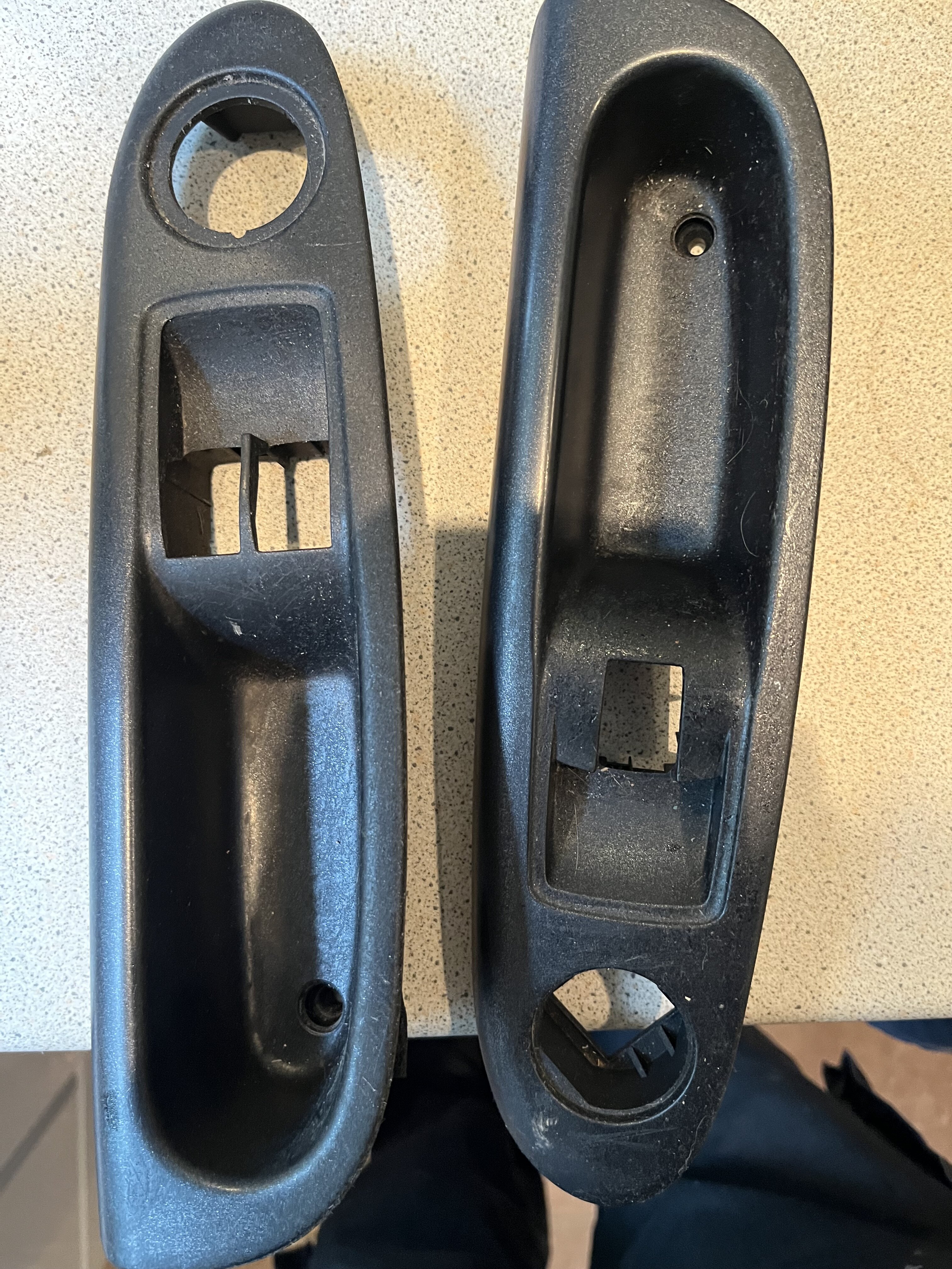

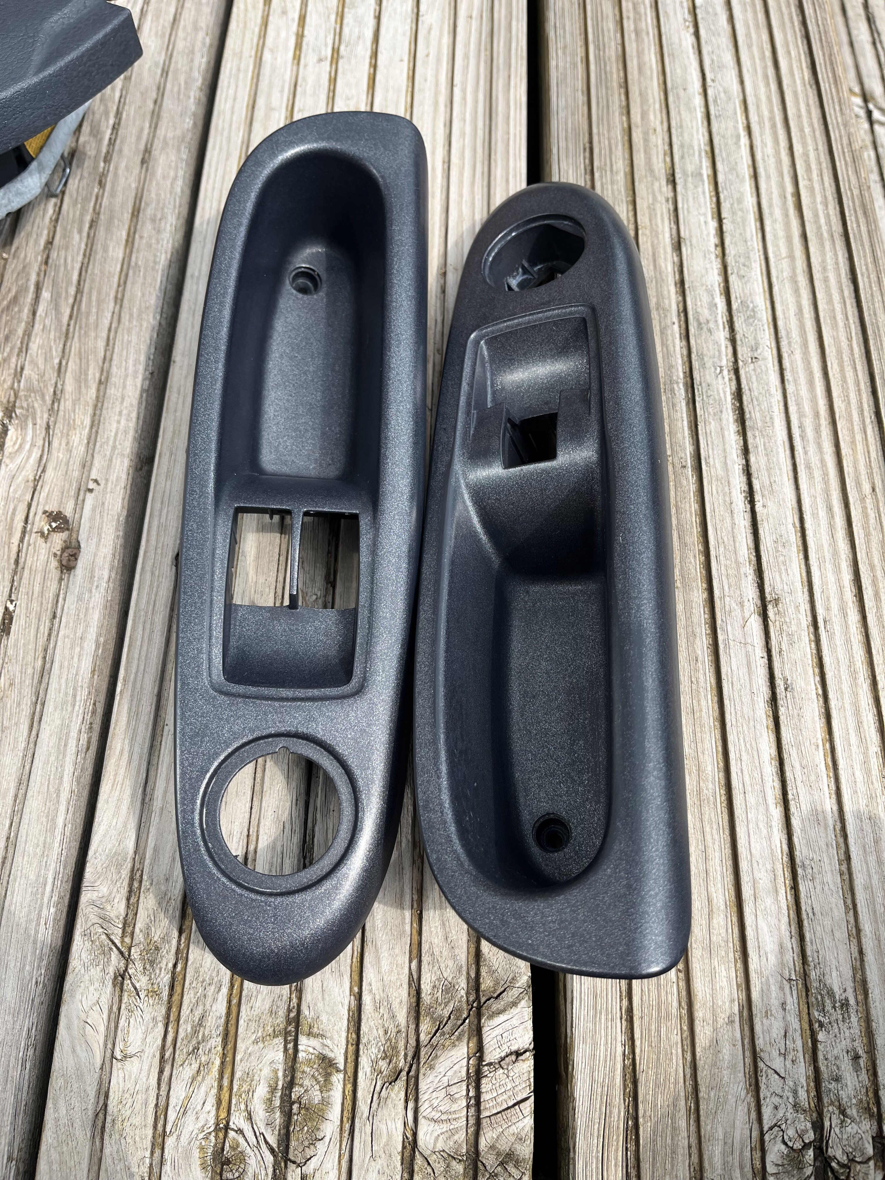

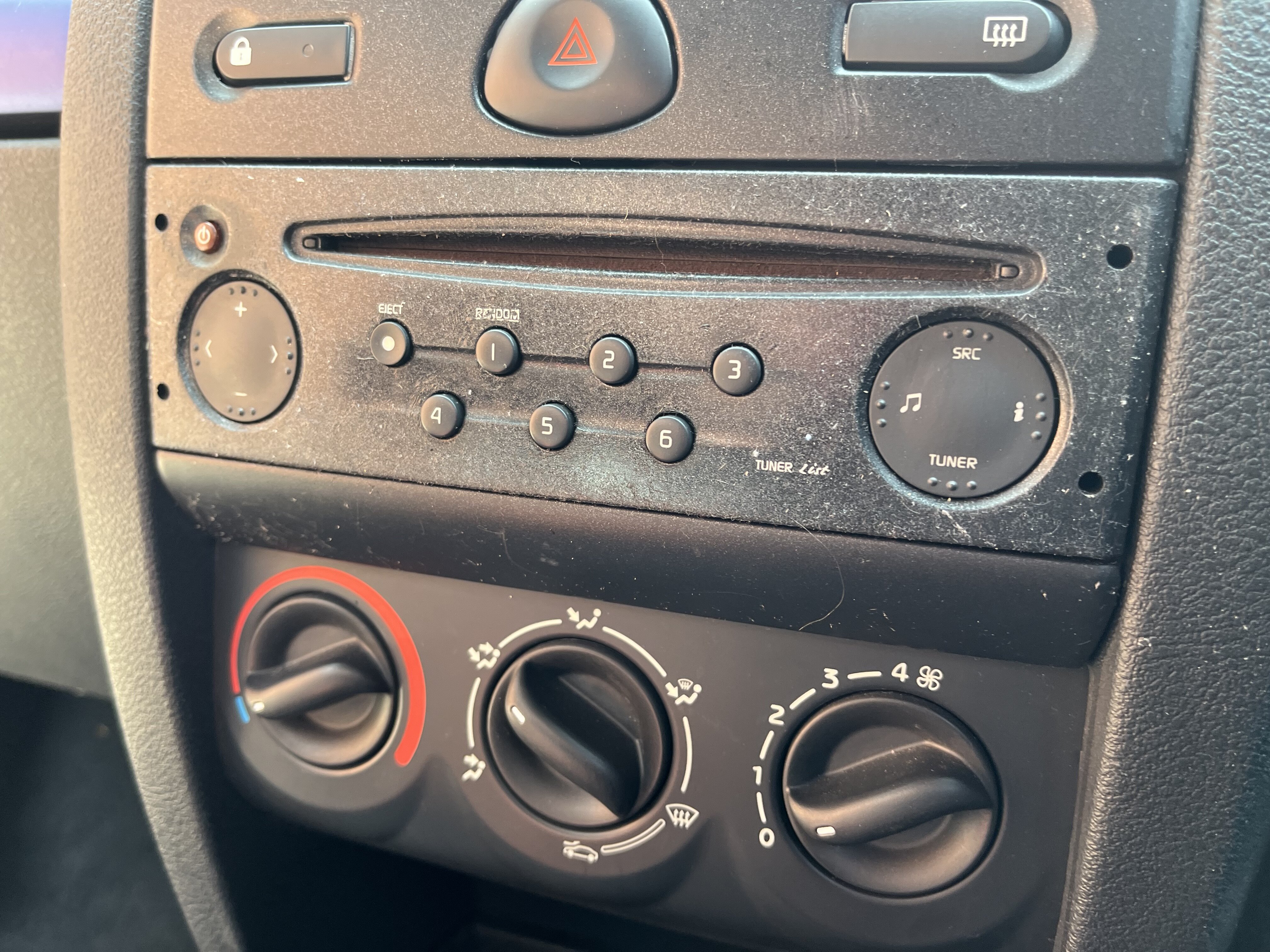

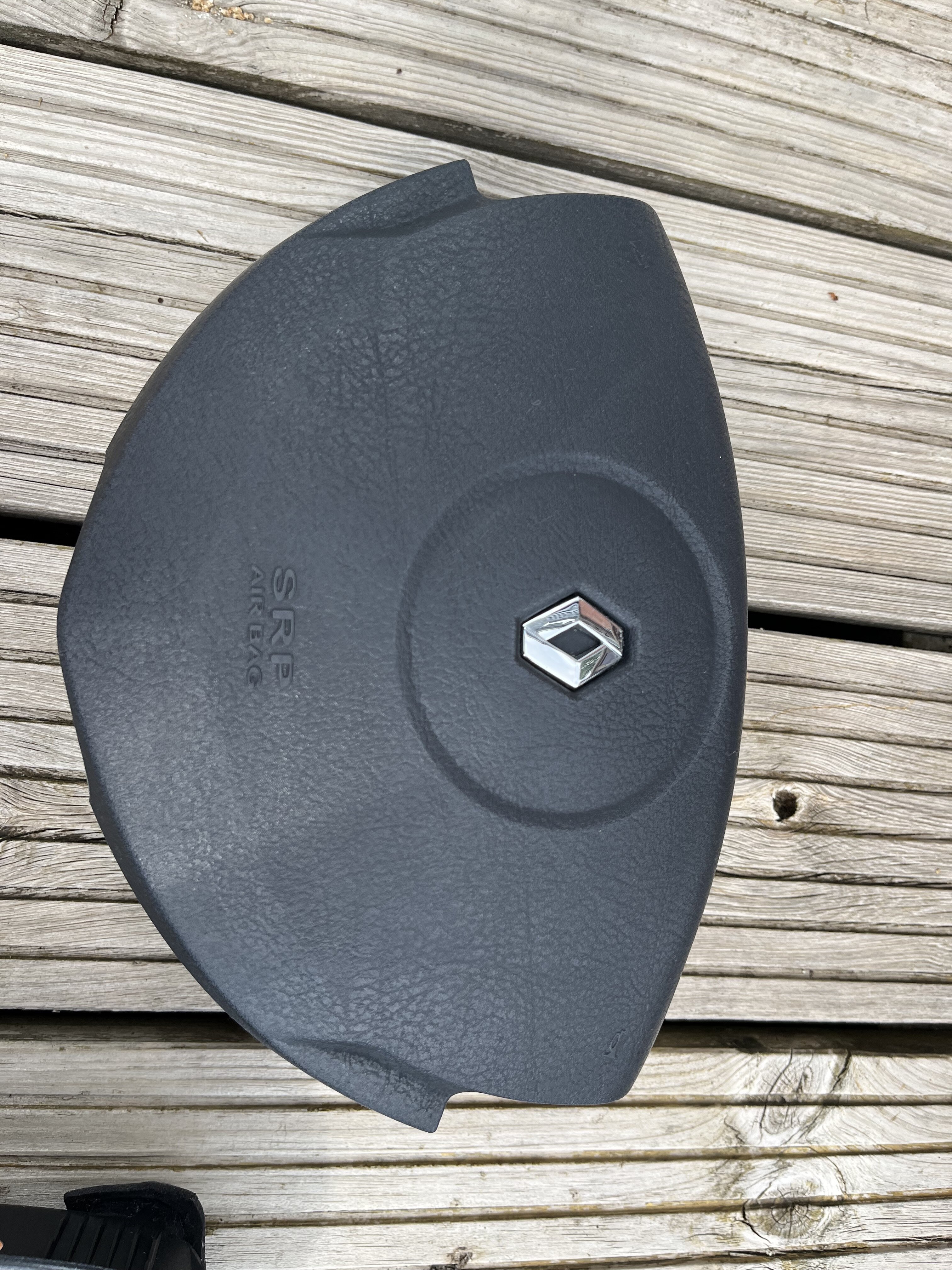

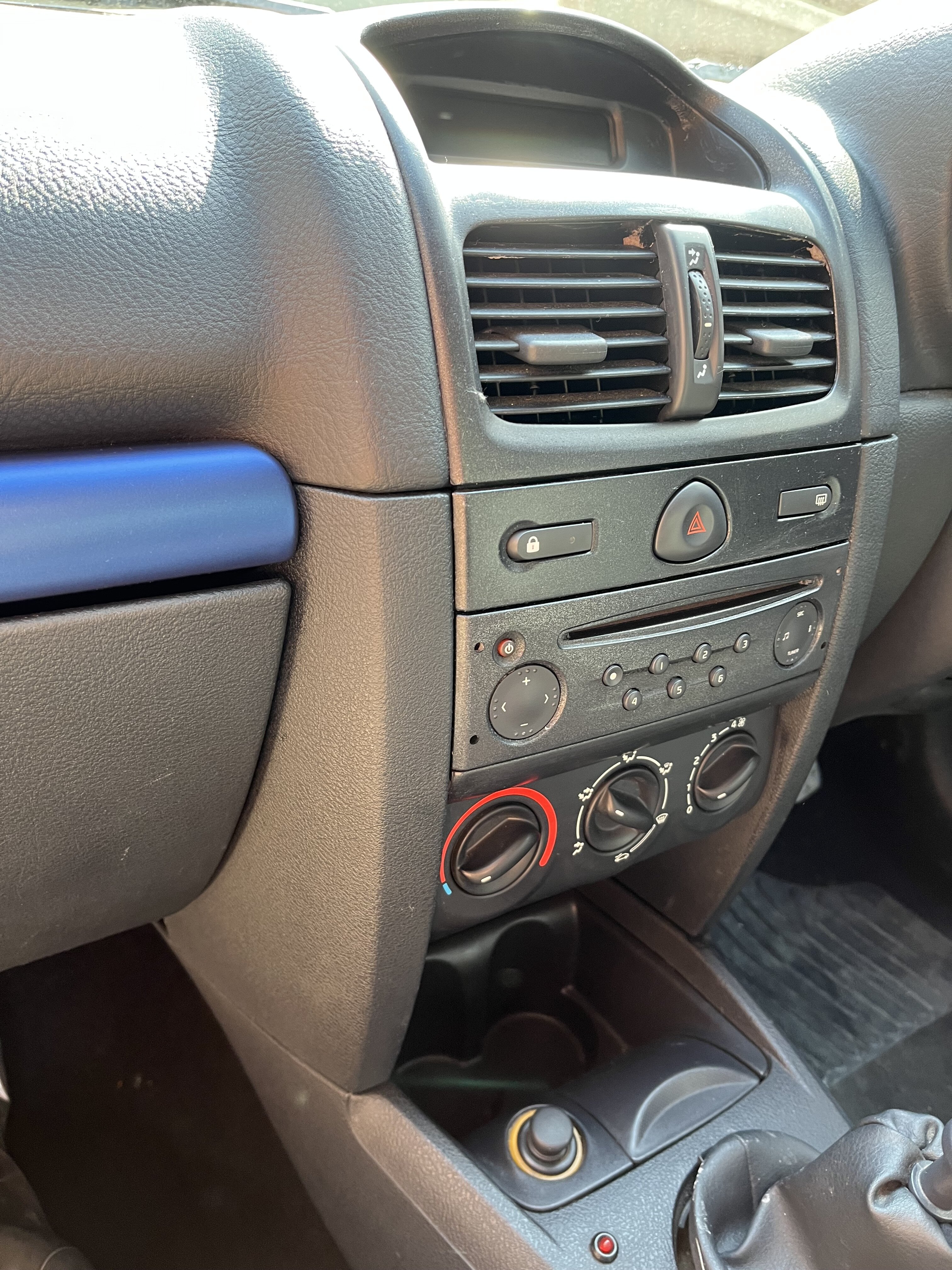

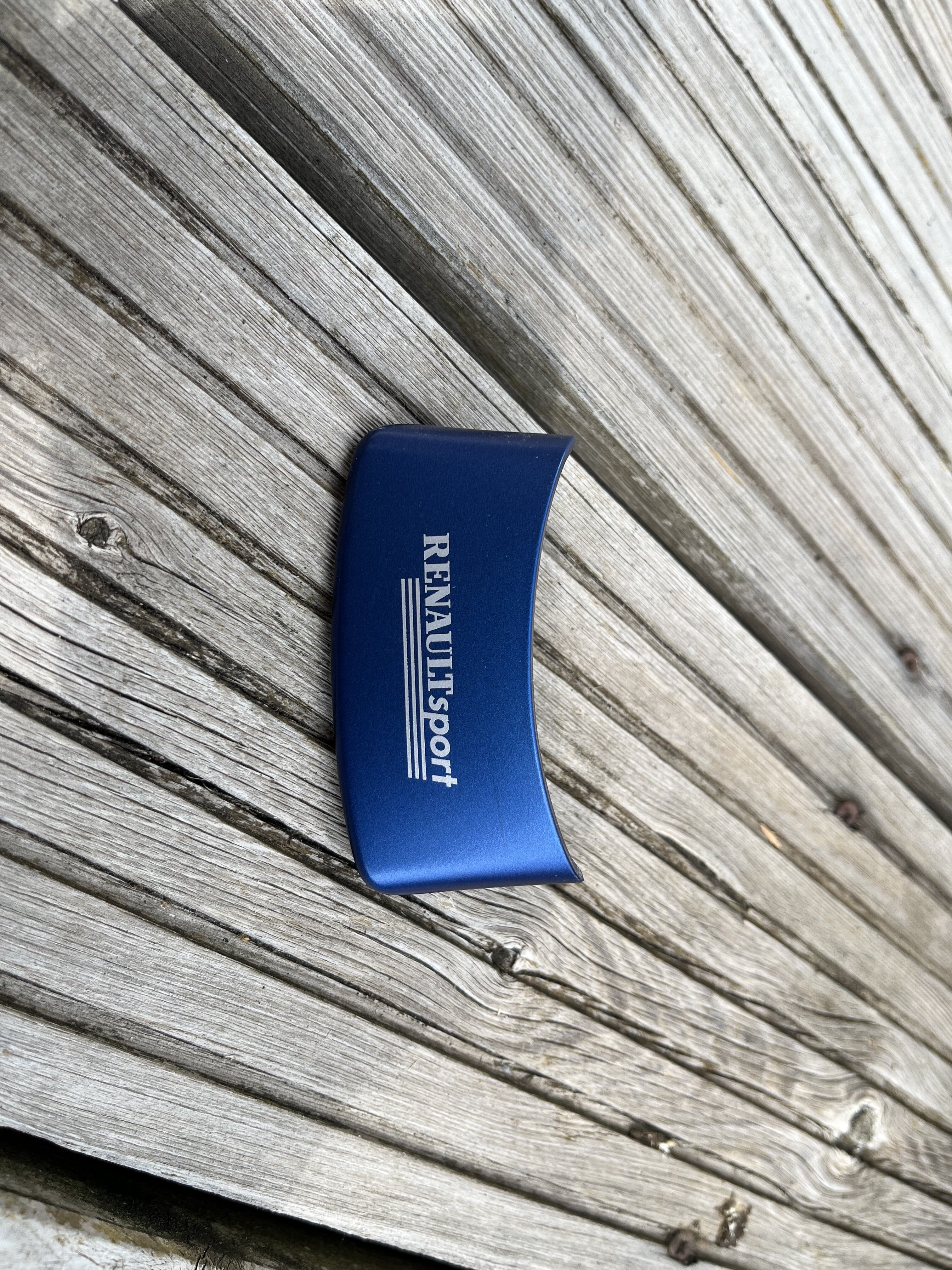

I probably shoulda photographed a few more before pics, sadly i forgot.
Just imagine it was all a sticky fooking mess.
Remove airbag, door card pulls and steering wheel.
Cleaned with a degreaser along with those brillo pads.
Did the same with the dash and headunit.
Used a light cutting compound and cleaned them up along with the blue badge on the steering wheel.
All came up OK. Not the same as a oem finish but loads better than the sticky crap.

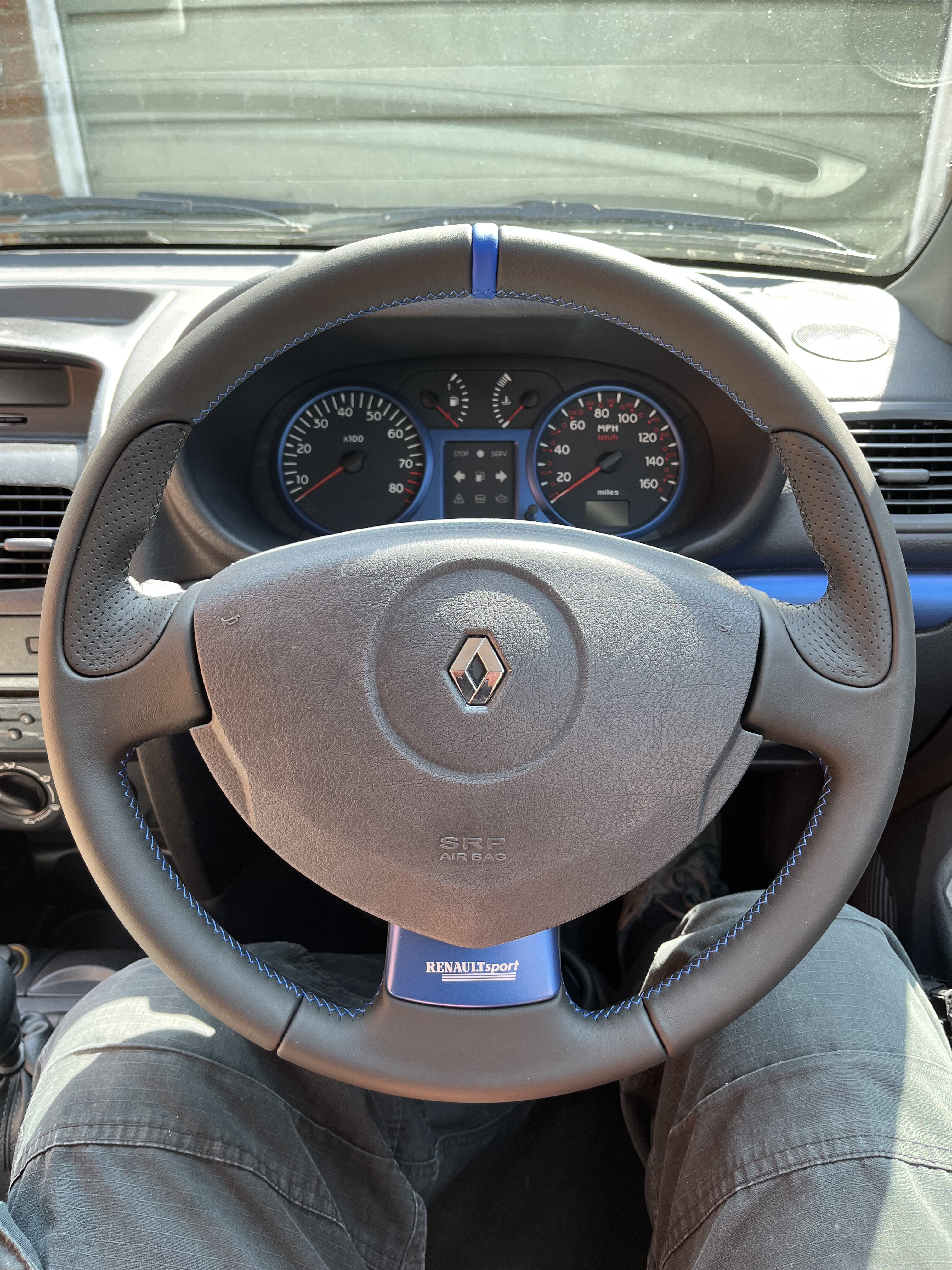

Fitted the Snappy steering wheel at the same time - looks mint.
Before
After
Before
After

Steering wheel looks superb.
Did you send yours off to him or buy another for him to refurb?
