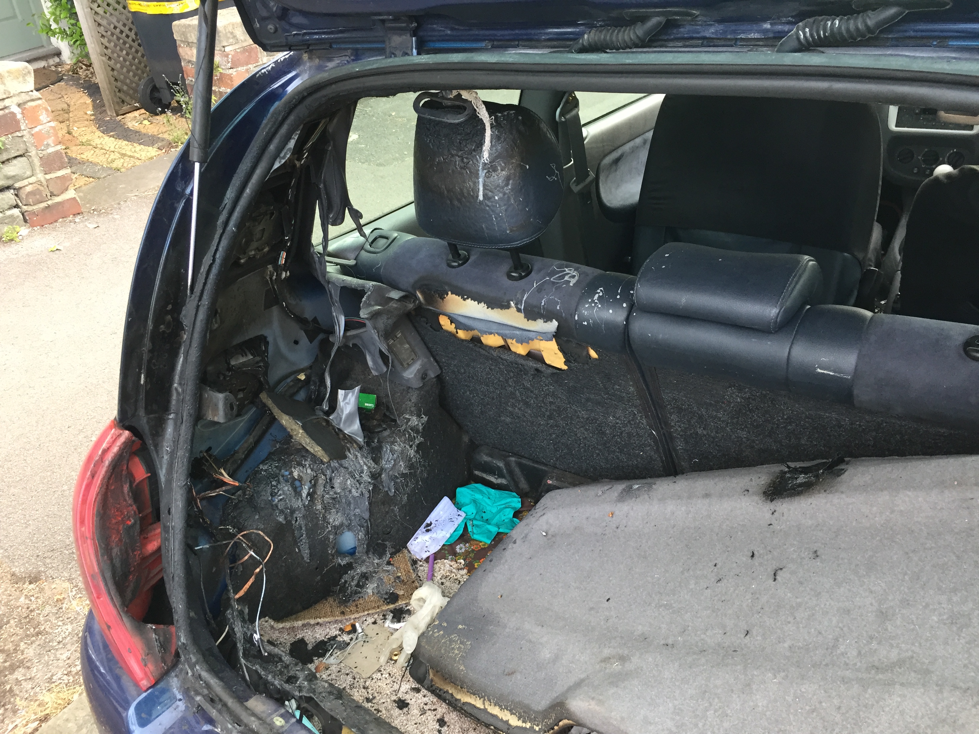

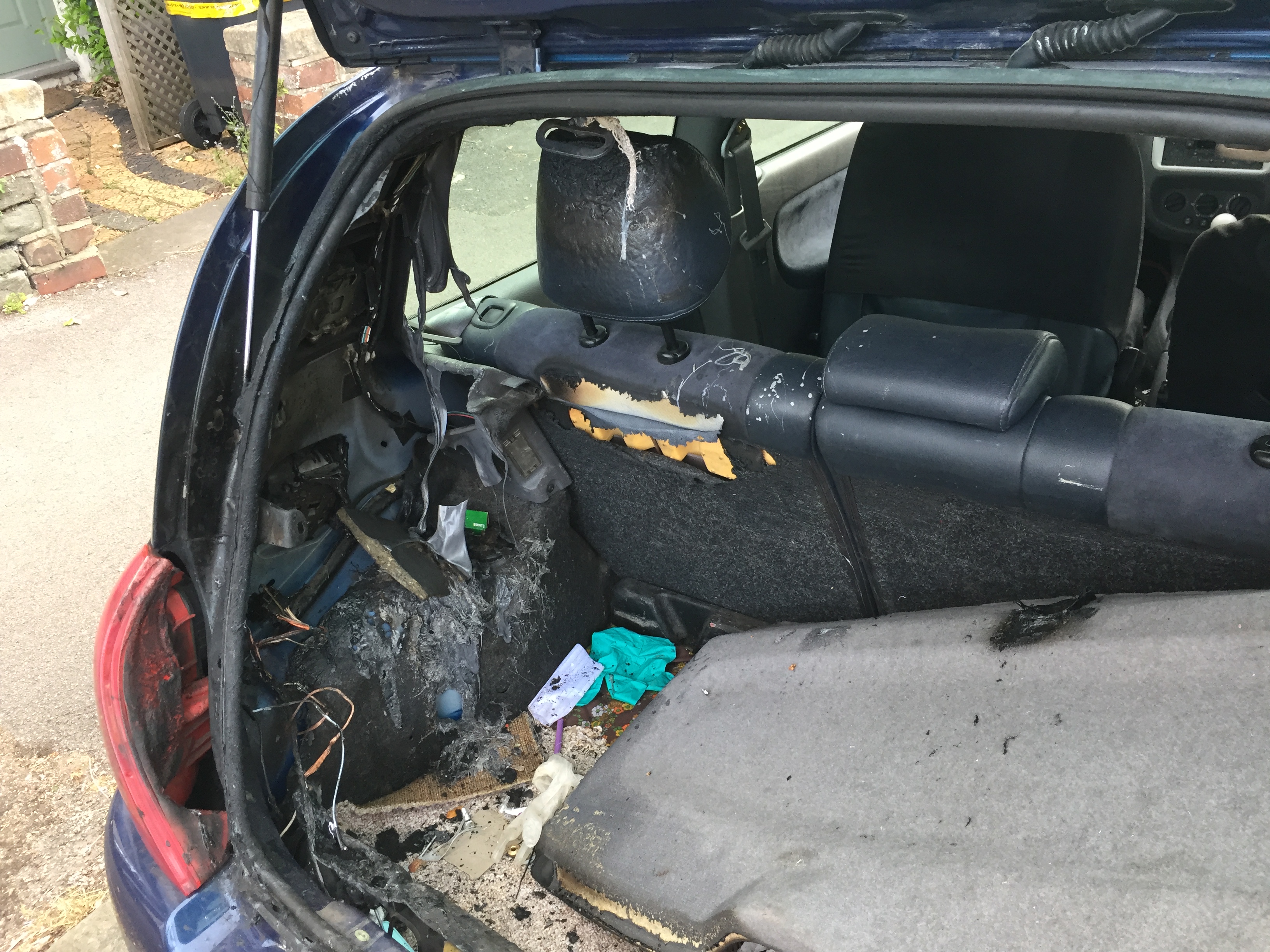

Not yet no - I can manage about an hour of work so just thought Id get some bits as relays are cheap😂 - no difference when I load the battery just runs fast. I dont think the fire in the back has helped mind... When you say light cluster where do you mean?
I mean if there was a fire in the back then that might be your issue 😂
All fixed - many thanks - started at from with the bulb, holder, connector, fuse. All new wiring and two earth leads at the back so that was OK!
Honestly
o_O
yes - a gas canister somehow failed and I think the ignition source was the gas torch trigger that got pushed in when I loaded up with tools and the when I walked away clicked a spark and boom. Door window open so roof is crispy but intact - I got the fire out in about 3 mins but it was a do I run before the tank goes? Got the heart going I can tell you.
