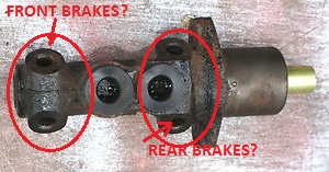

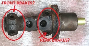

One more stupid question but I lost where connects front brake and rear lines on Cup master cylinder :) There are a 2xM10 and 2xM12 in front of MC.
Front left hand - Drivers front caliper
Front right hand - Drivers rear caliper
Rear left hand - Passengers rear caliper
Rear right hand - Passengers front caliper
vjs
  Clio 172
Did You mean UK drivers - RH, passengers - LH?
or EU drivers LH, passengers - RH?
