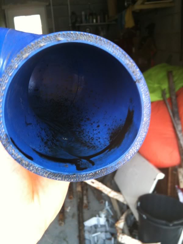

just been and had a poke around under the bonnet (im no mechanic, but have a good idea what im doing!) checked air filter that was ok, but the 90 degree bend was full of oil as in picture, cleaned that, throttle body looked ok from what i can see, but i dont really know what im looking at with them, also checked the oil, that was low (but not below minimum) topped that up, took it for a drive and its still spluttering
heres what the bend looked like

that hose isn't too bad. but consider this, if there's oil marks in the hose, that oil will also be in other places within the air intake system, up until it enters the cylinder head and there's a few sensors on it's way. i can't think of what is where, on previous cars i've had there's been a sensor (MAP i think) in the hose and that can respond well to cleaning. consider pulling the sensors out of the inlet plenum and checking they're not caked in it.
CTS sensor is a prime suspect too.
thanks for both the replies, to be honest i went as far as i dared with the airfilter and bend, as im no expert so have no idea what im doing haha,
