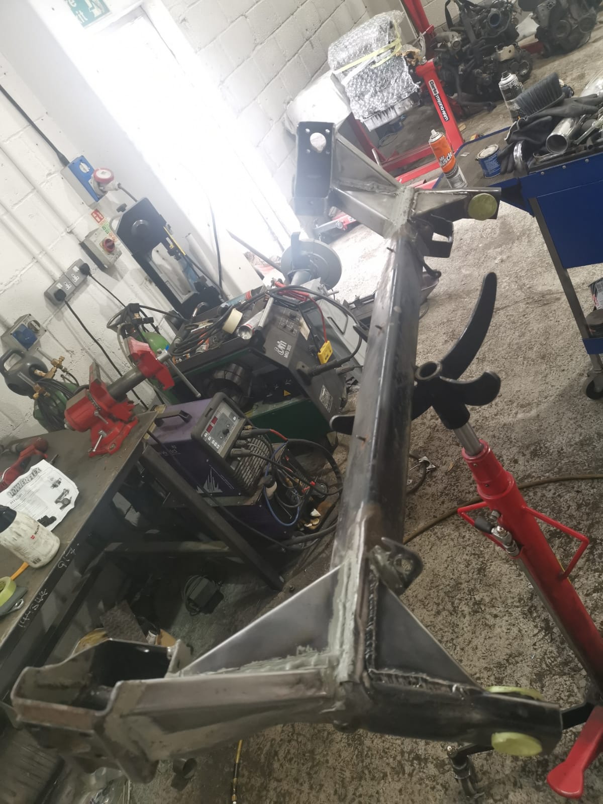

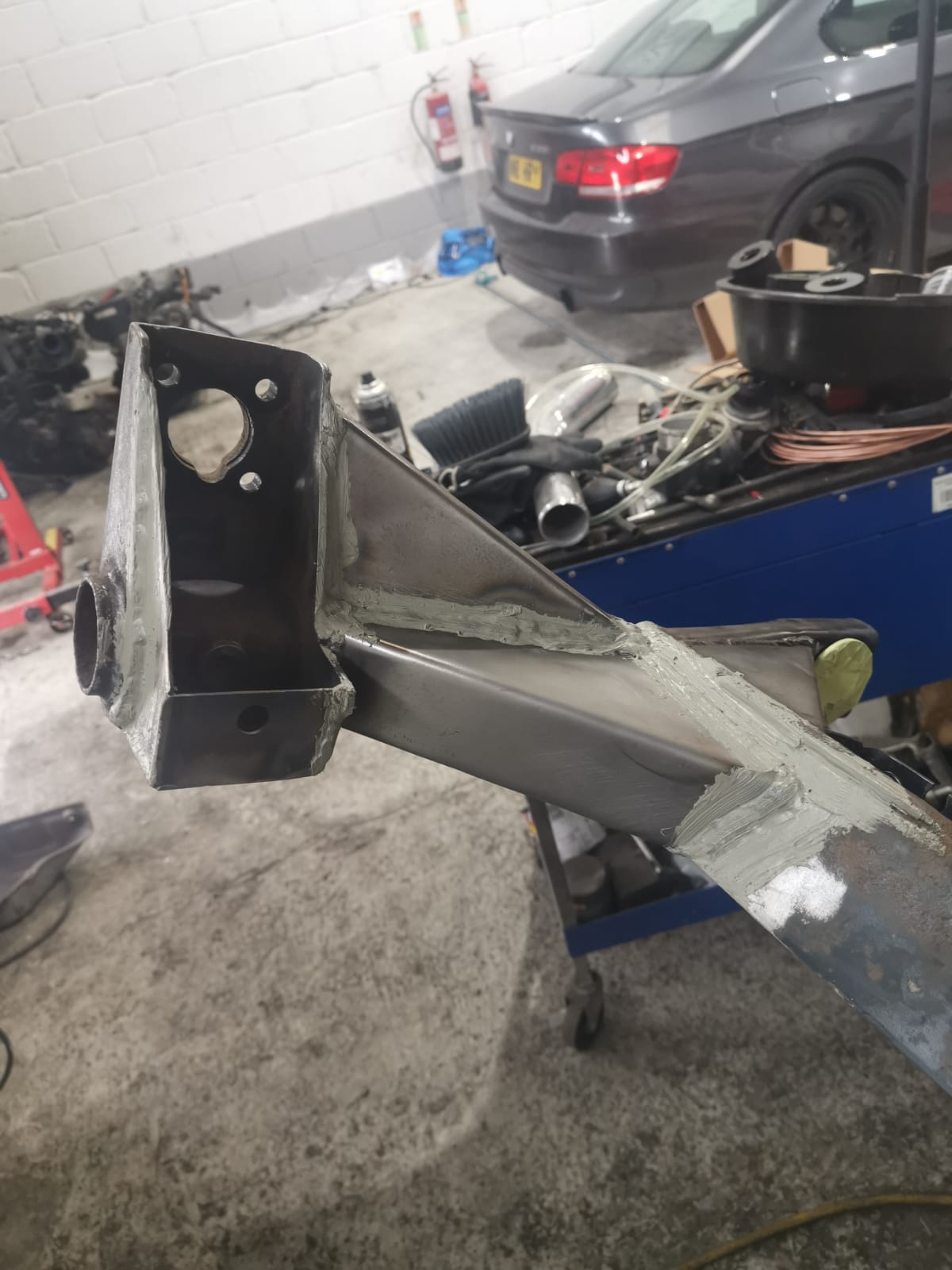

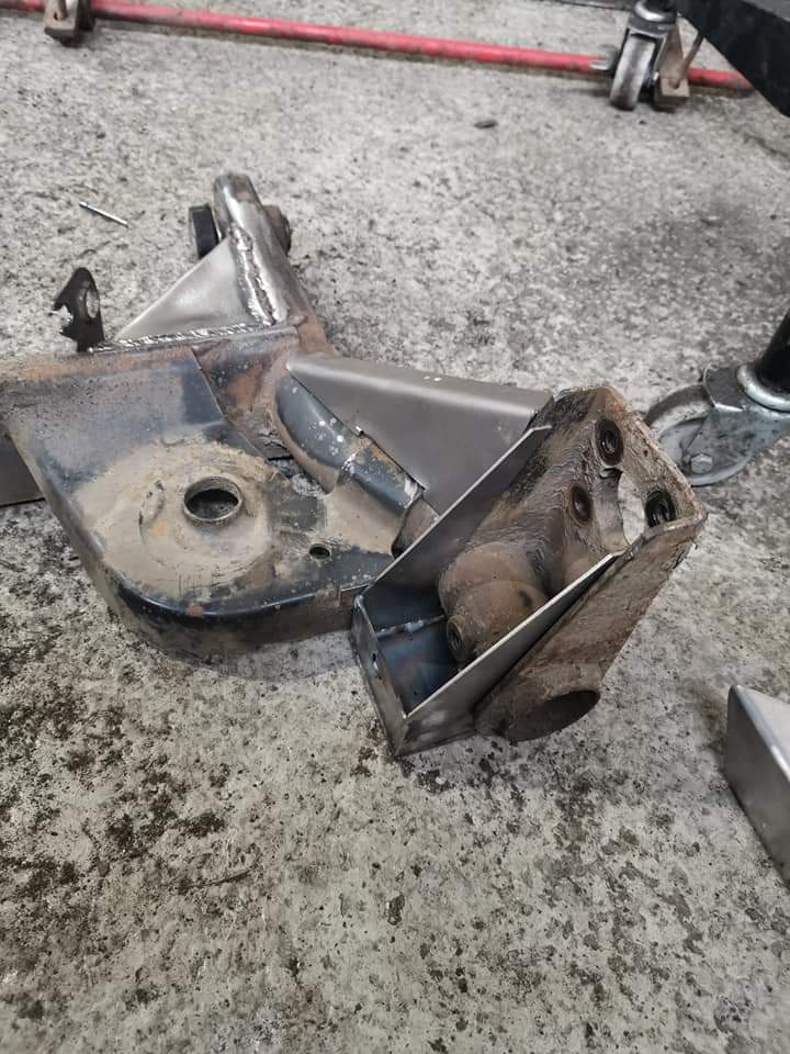

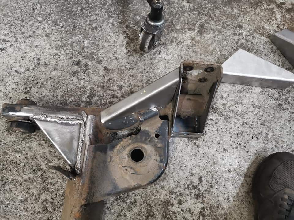

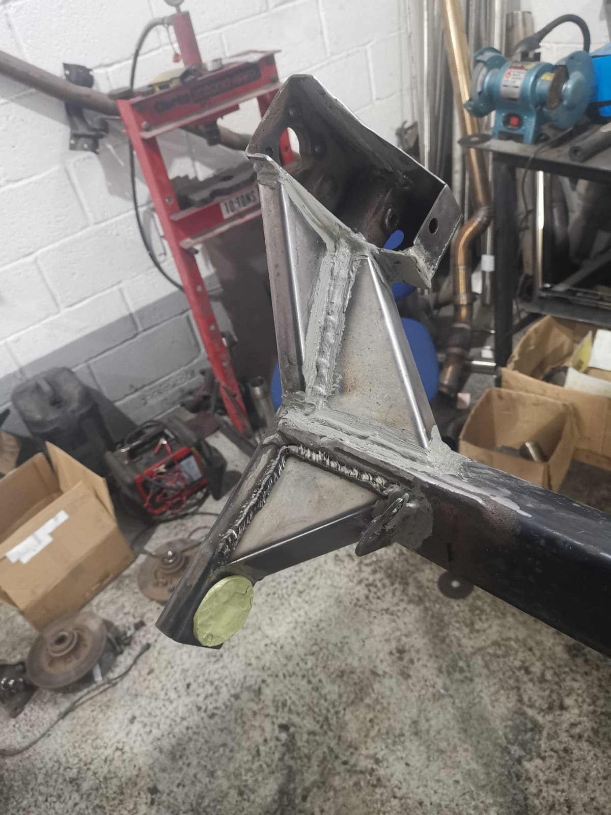

Rear beam strengthening in progress.

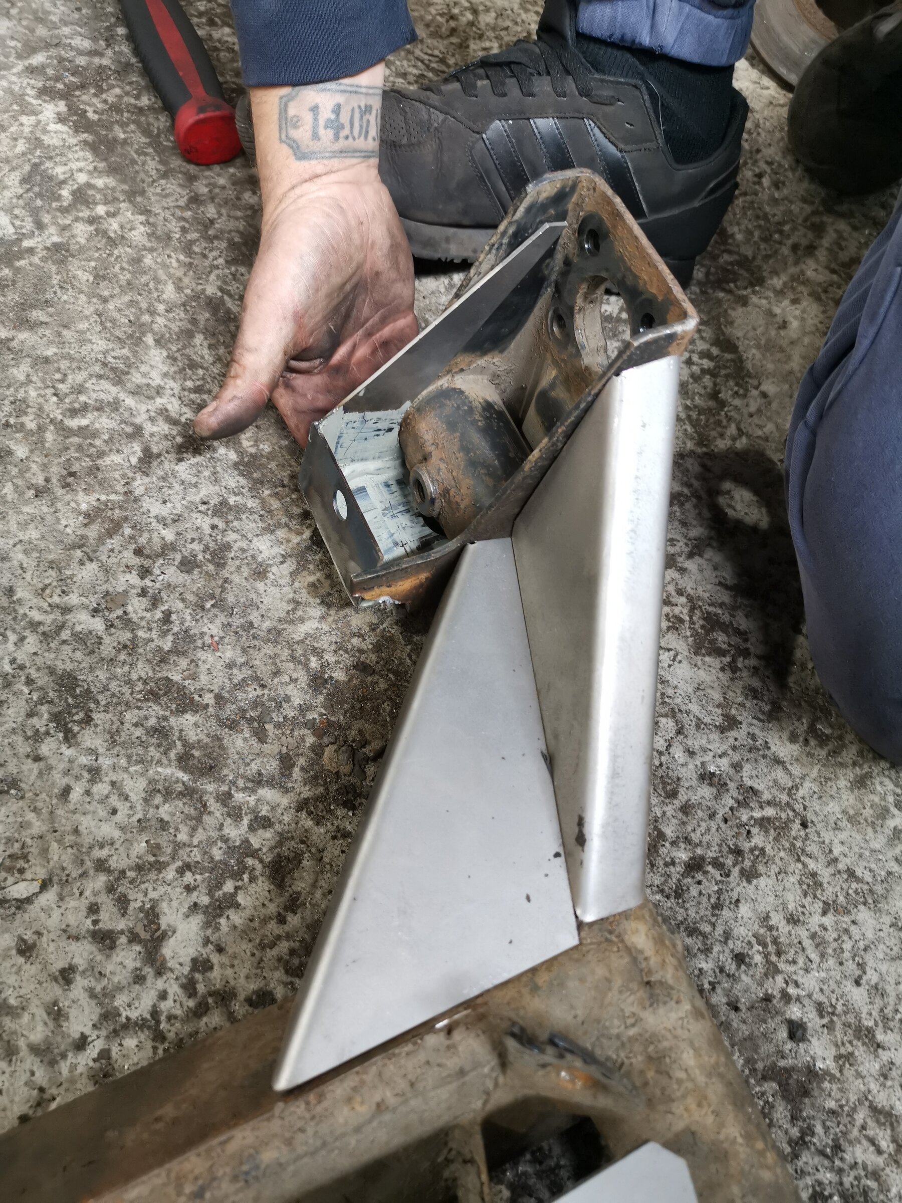

Spoke to AST this morning, they will be dispatching the 4100 series coilovers Monday for delivery Tuesday. So the garage are going to be cutting the spring perch off the rear beam and welding on the remaining pieces to box in the sections.

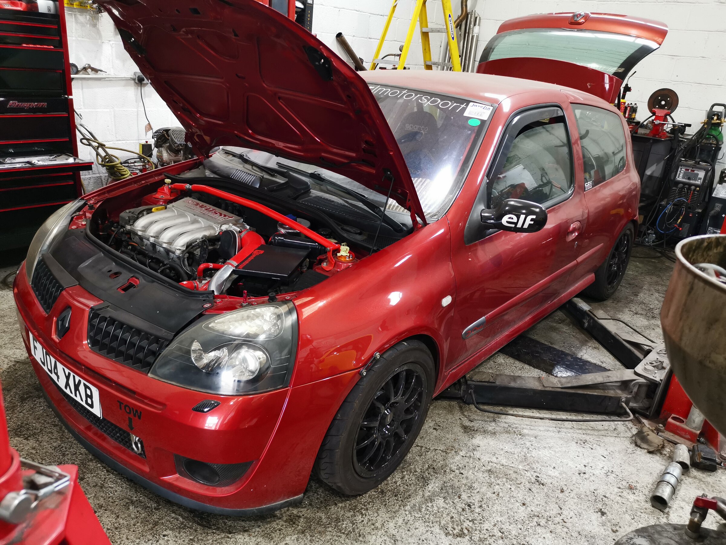

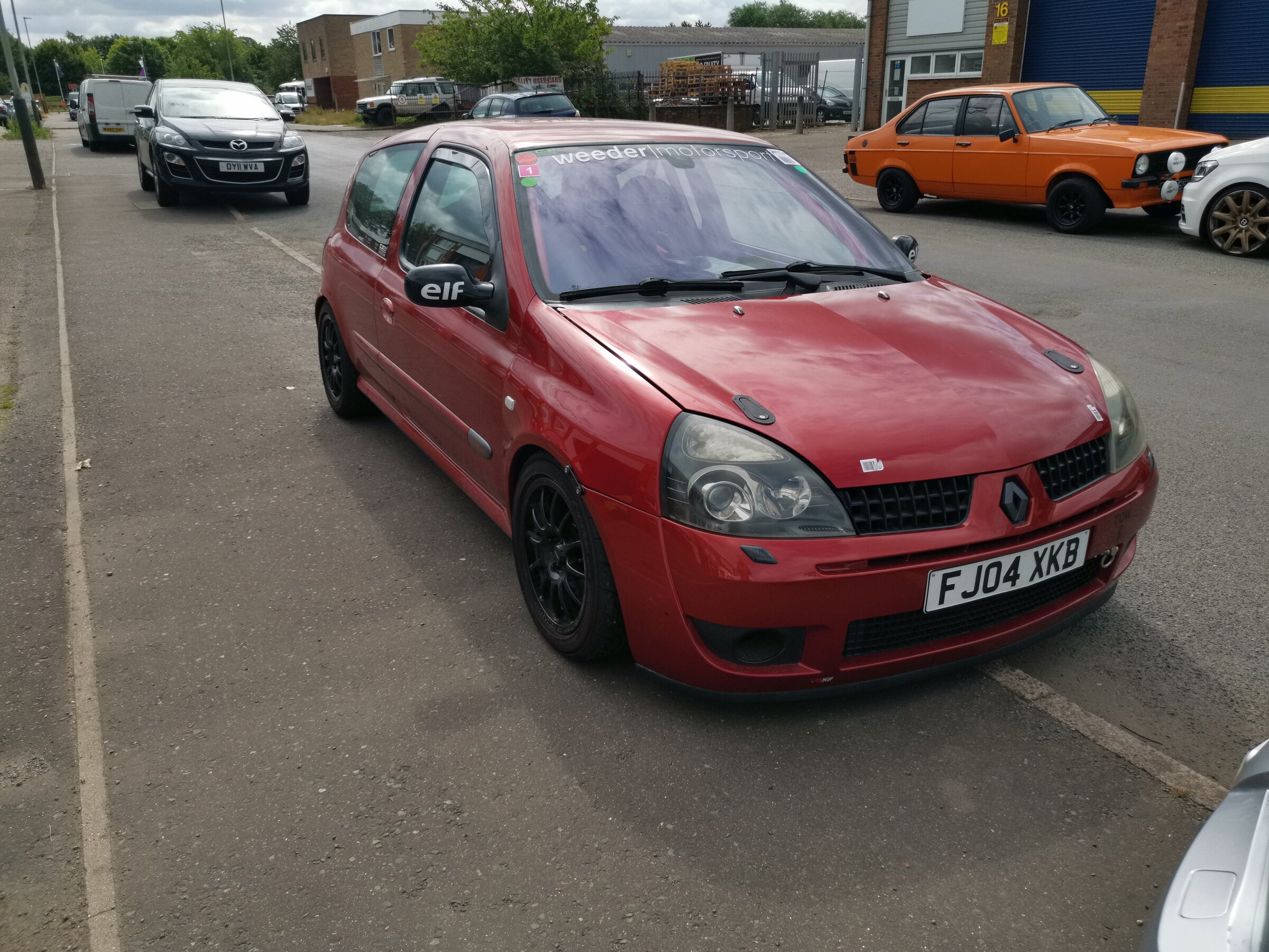

So shes finally down on her wheels after a long time due to waiting on parts. Defiantly needs a good wash after collecting dust in the garage :O

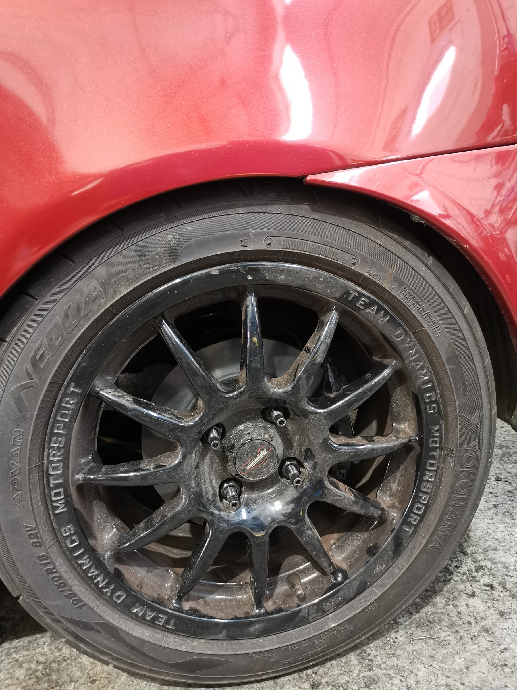

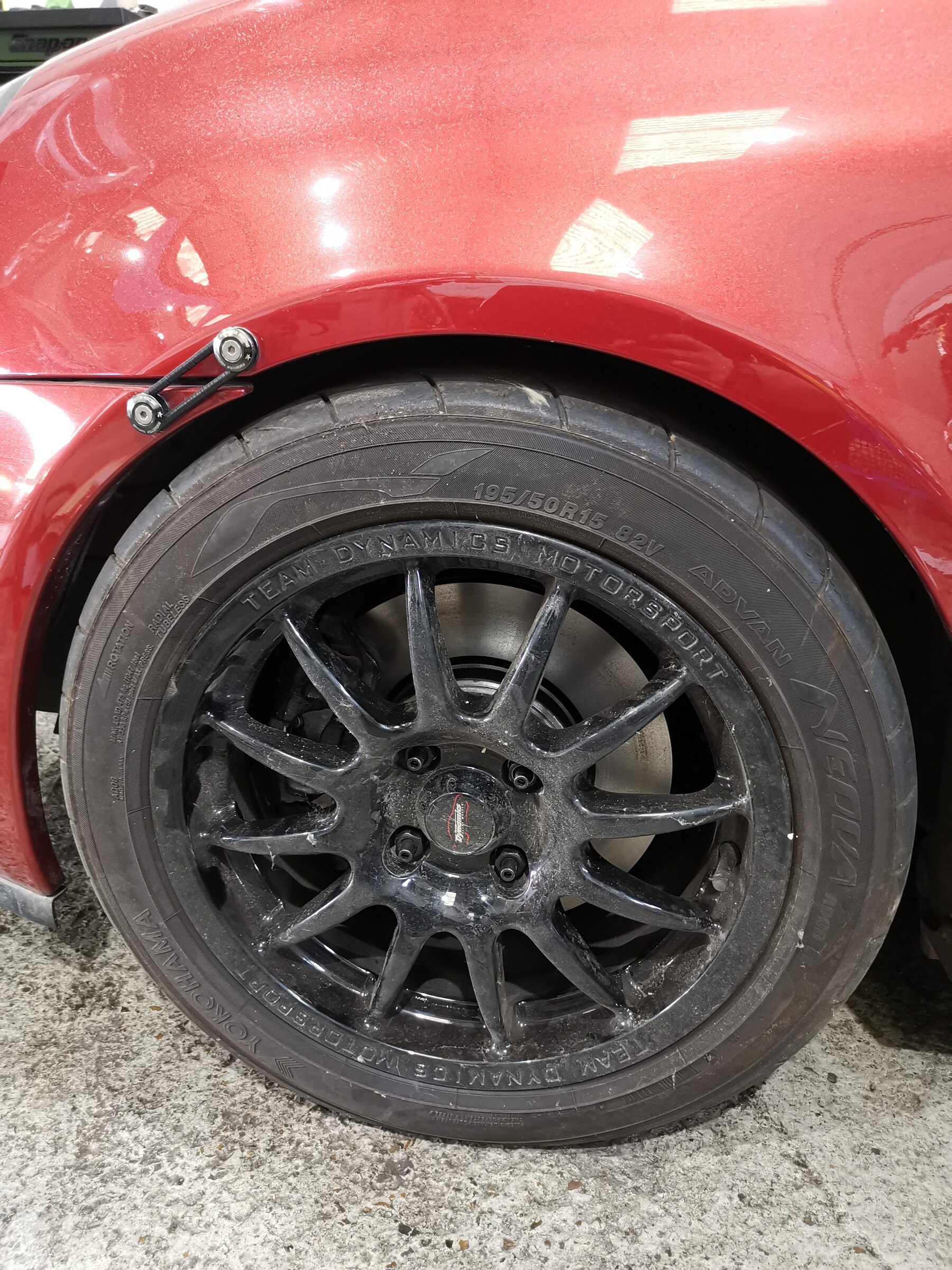

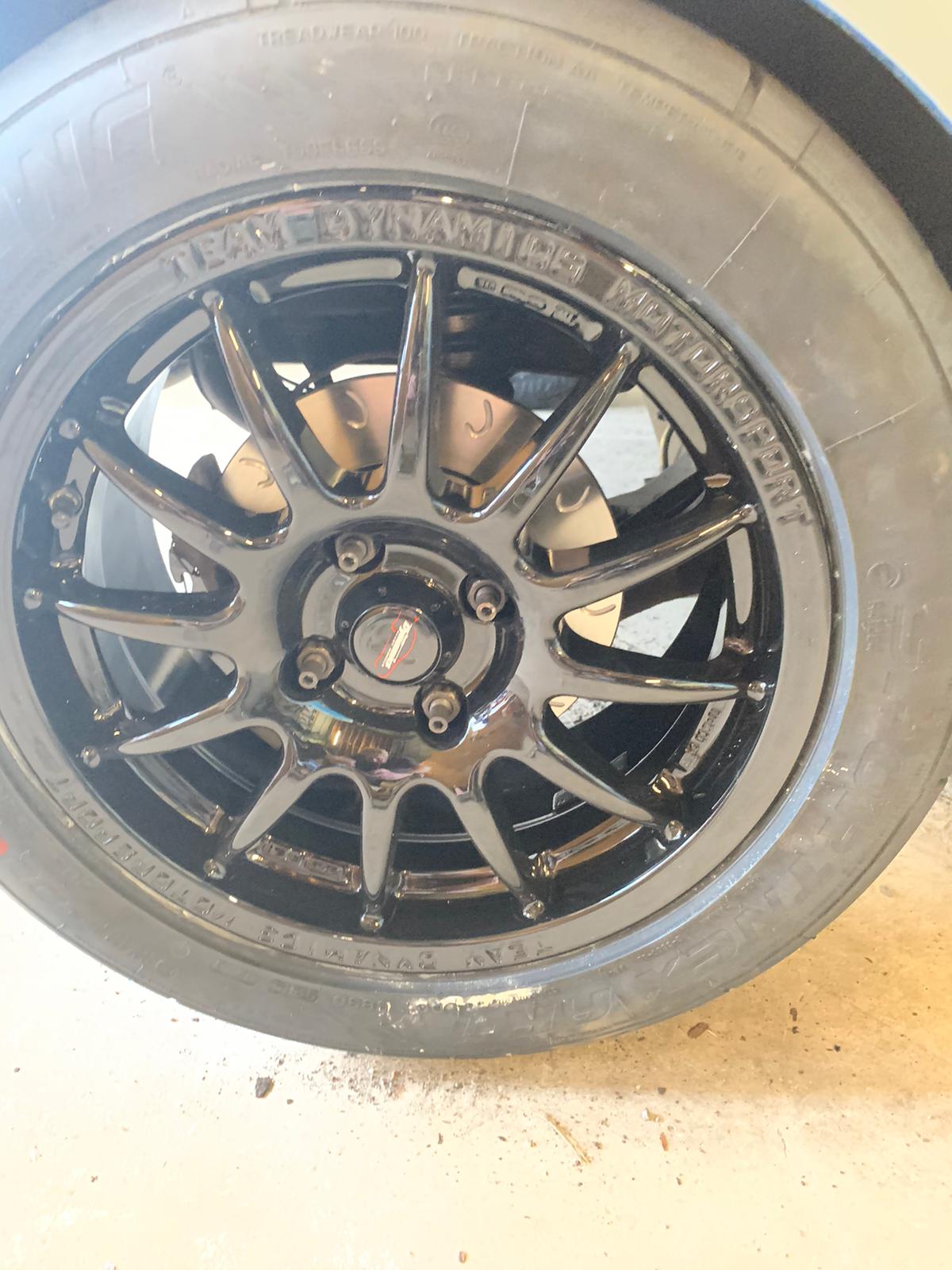

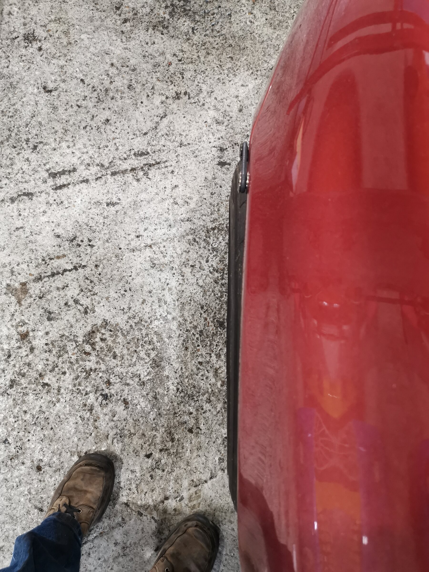

From the top view of the front wheel with the alignment to be done, can see the top of the wheel sits outside the arch quite a bit. Hopefully with some camber it will inside the arch. If not, Ill be looking at swapping the 16mm spacer to a 10mm spacer (the Pro-Am Racing geometry kit gives an additional 5mm width aswell).

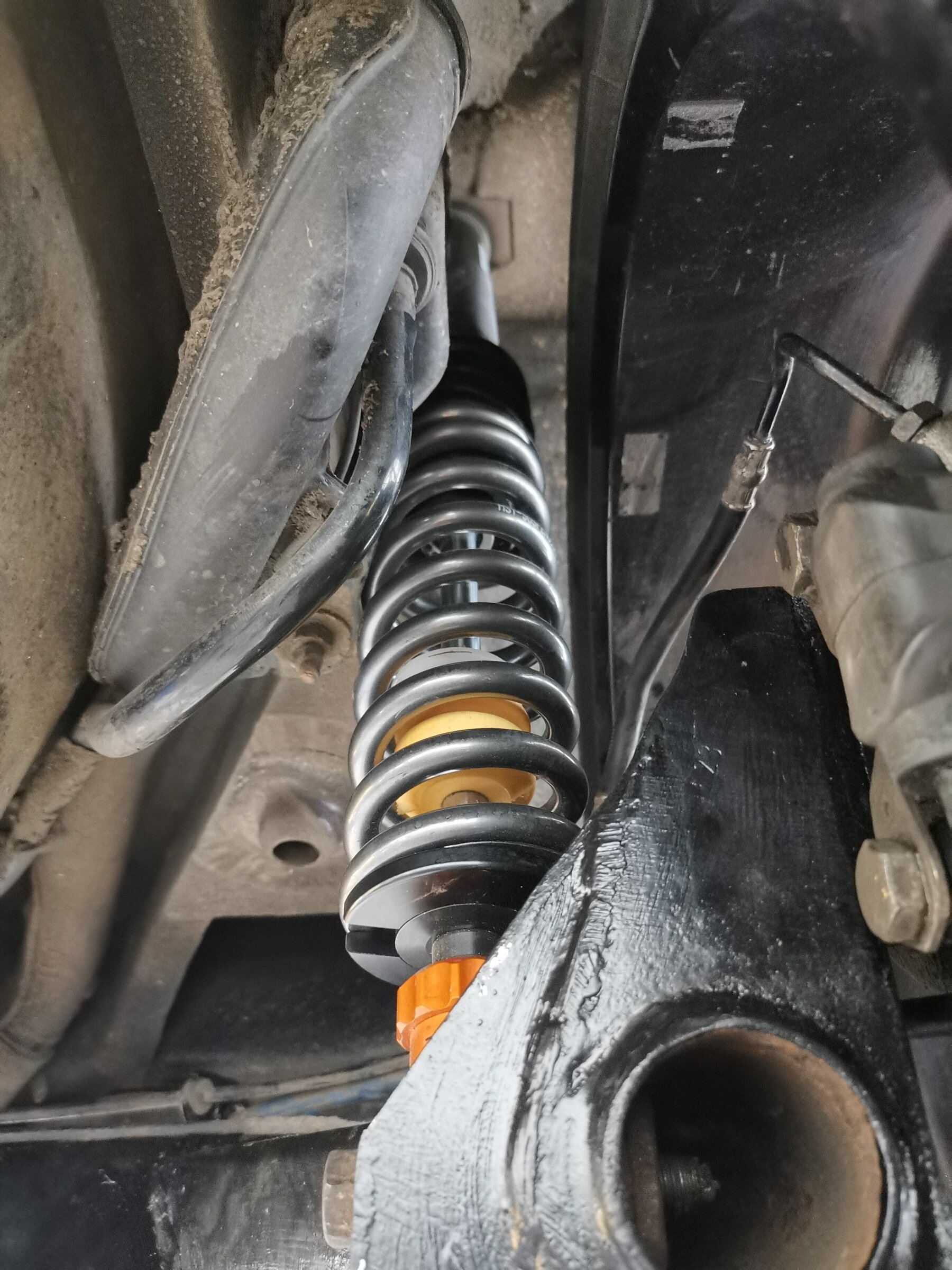

Had to raise the AST 4100 coilovers on the rear quite a bit when first installed, as had that slammed look :P

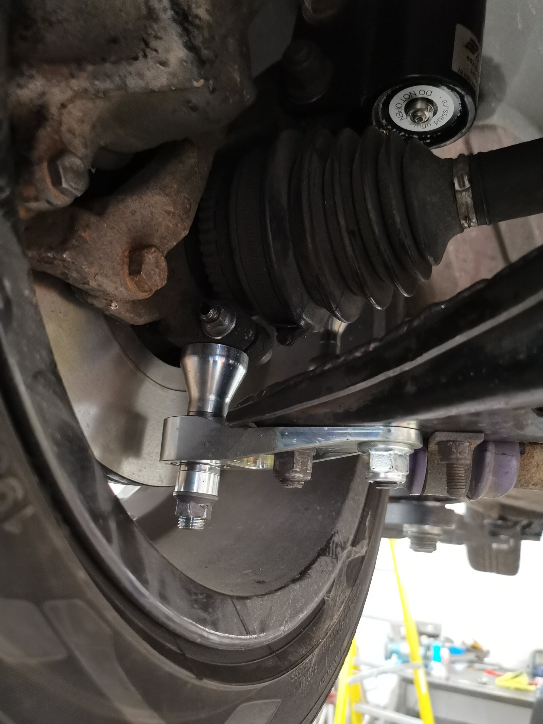

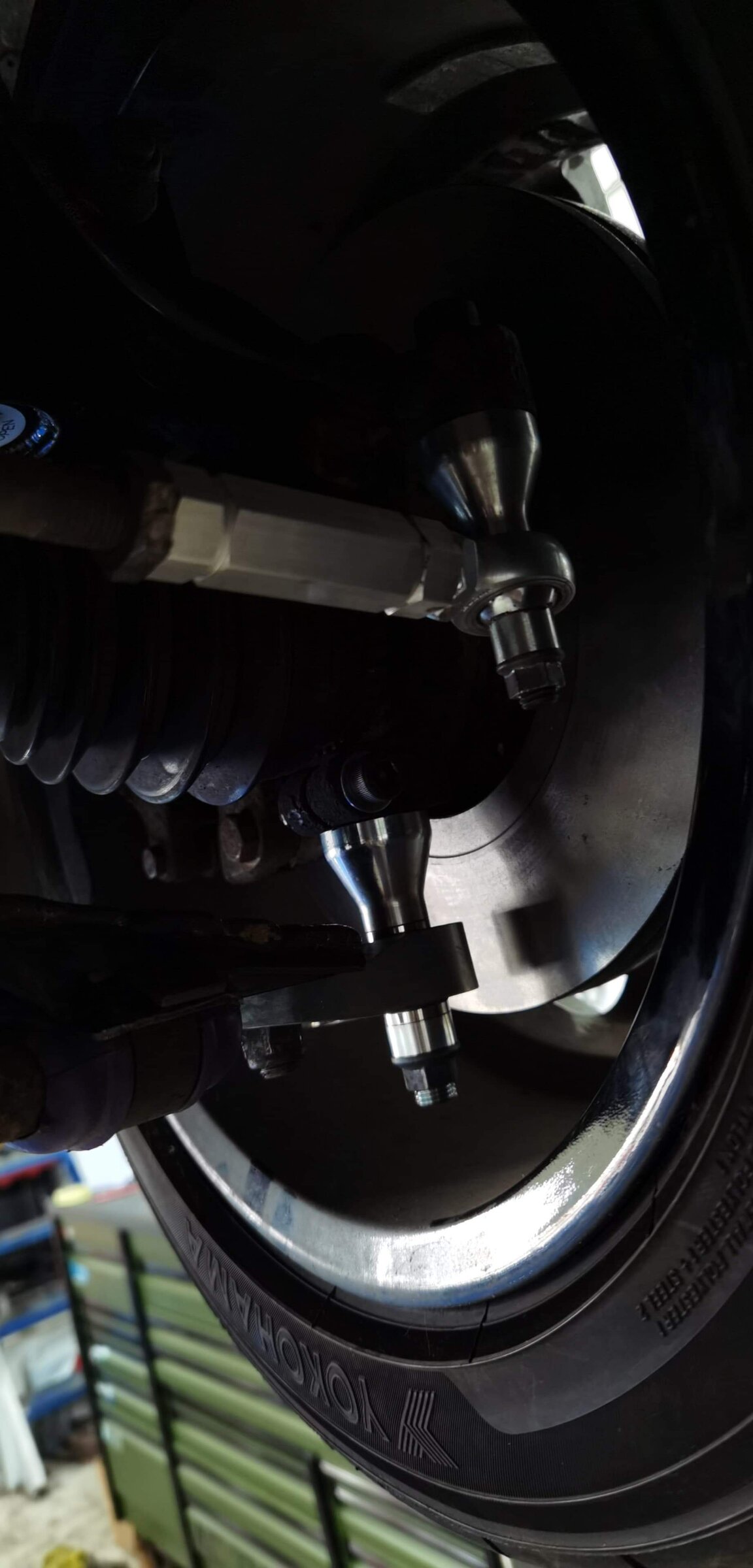

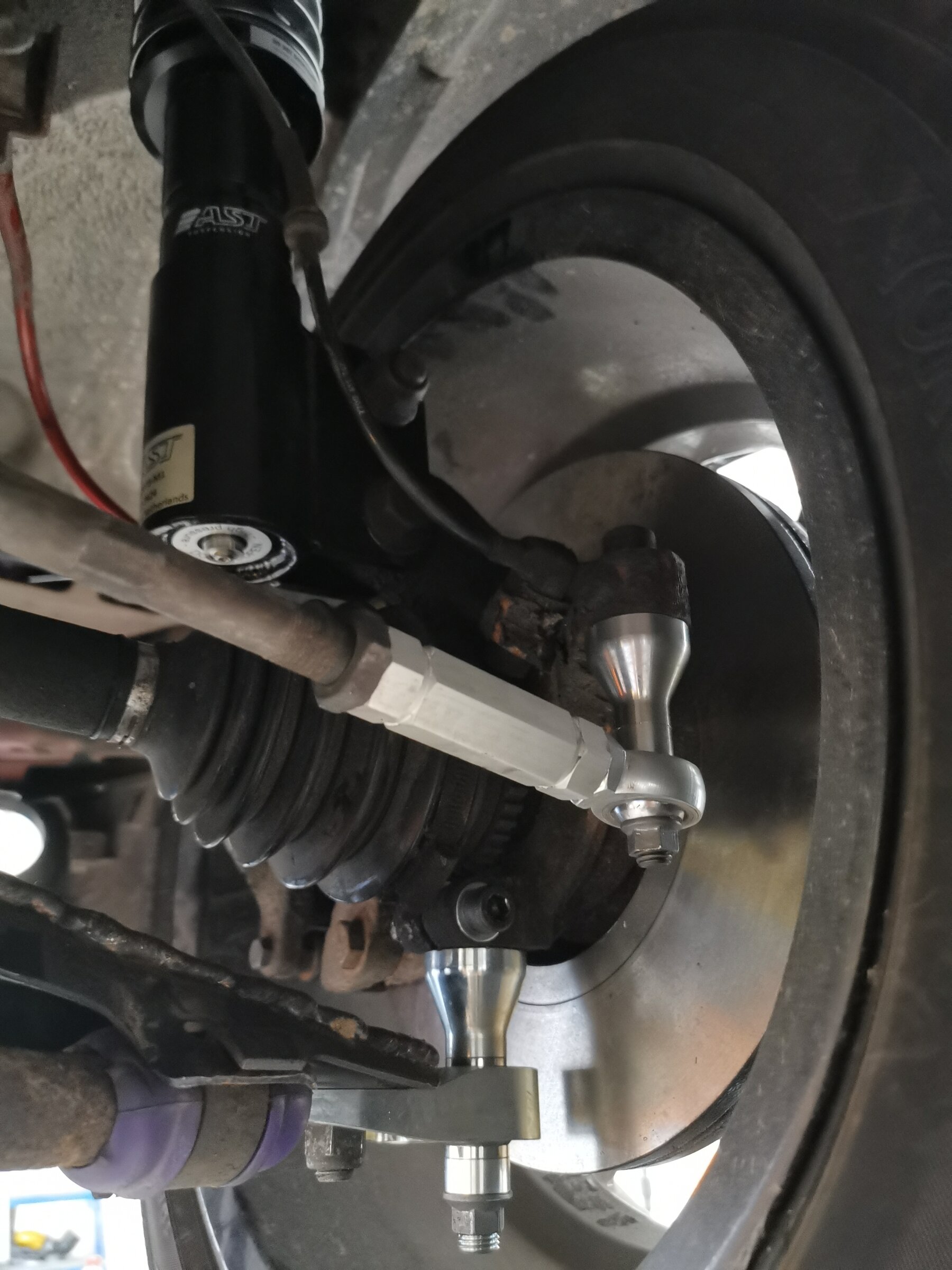

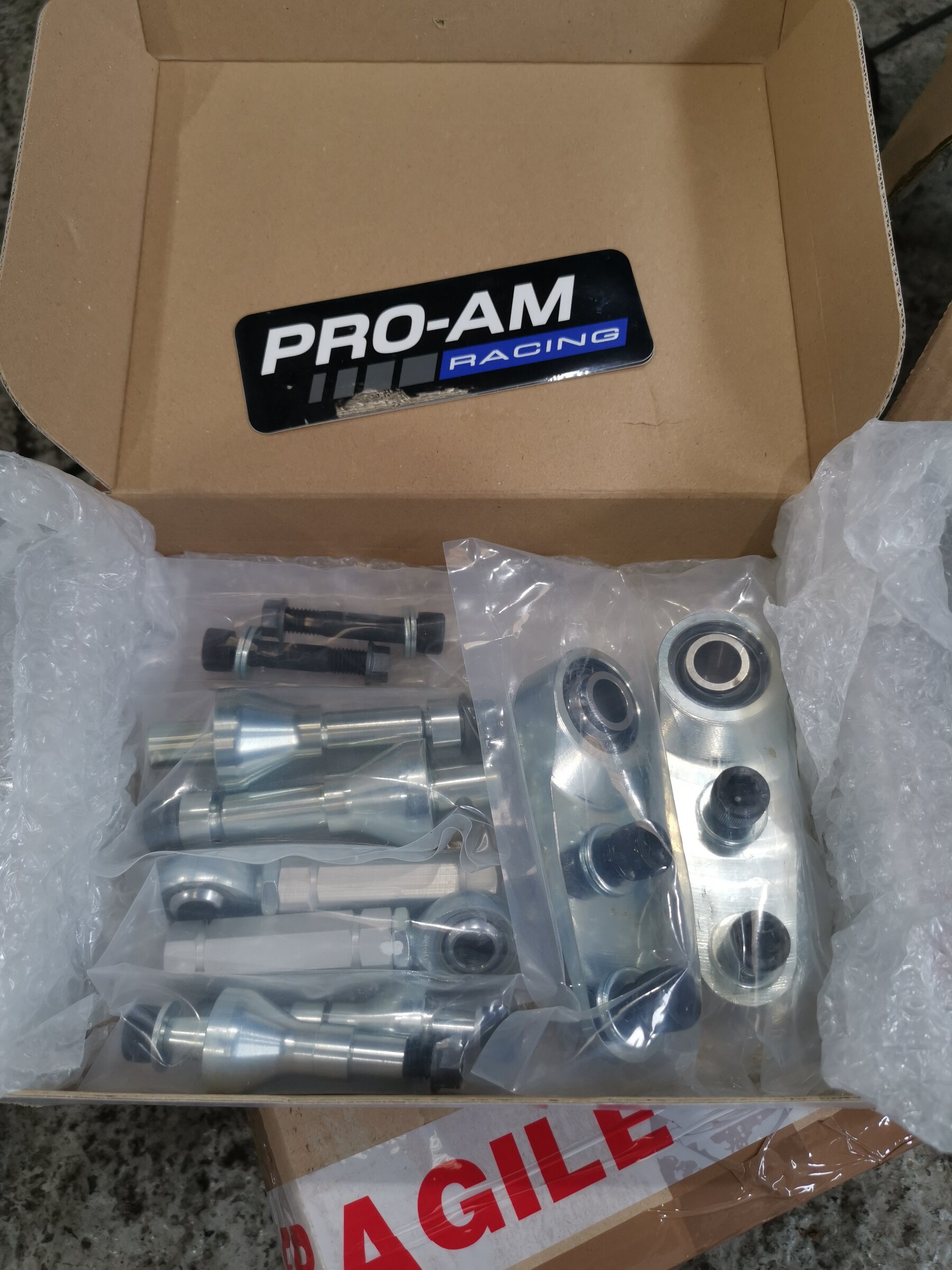

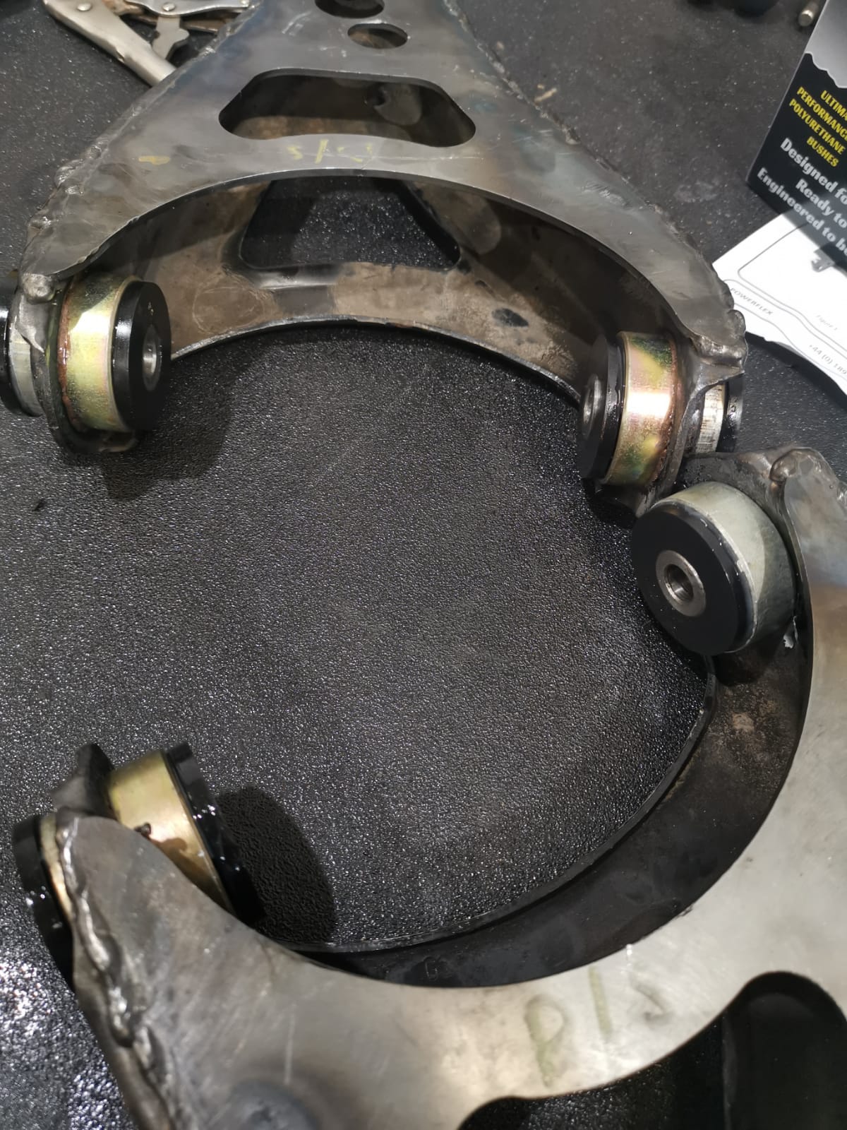

Couple photos of the Pro-AM Racing Roll Centre Kit installed, looks a great piece of kit from @Tomotek alongside the AST4100.

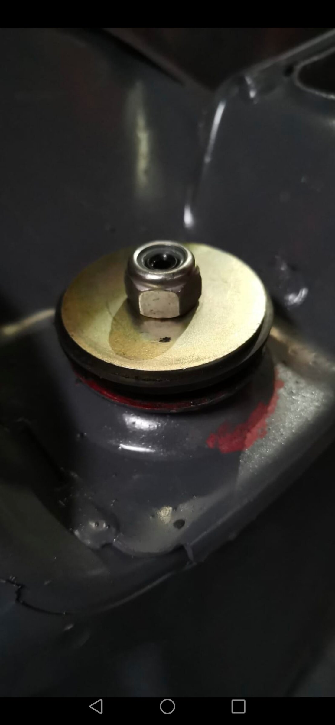

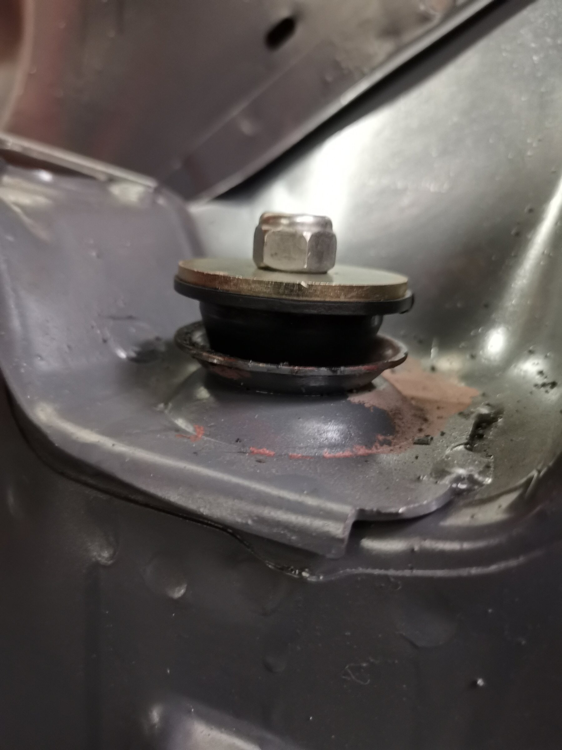

Powerflex black rear shock bush pre-tightened down so looks like there very little thread to able to tighten the nut to.
However, once tightened down looks okay.

- The rear AST coilovers appear to be very close to the inside arch so will require some "percusive" maintenance to give them some extra clearance. Could have been caused by the welding in of the PMS strengthening kit warping the rear beam or the beam is bent slightly.

- Had to order longer wheels studs for the front as the 75mm PMS studs were too short with the 16mm spacer, so had to order the 82mm studs.

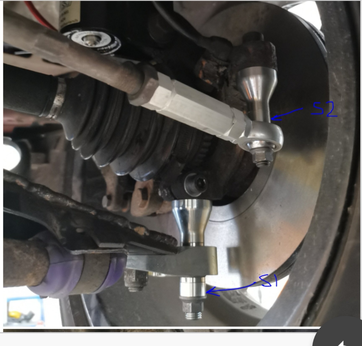

Didn't realise that the roll centre correction had been fitted incorrectly, but @Tomotek spotted it straight away in the picture😅 the track rod end was set at stage 2 and the Wishbone was set to stage 1👀
Spoke to the garage who fitted it, and they have now rectified it😁 so now both set to stage 1

Ordered a pair of each of the rear shims from PMS (10', 20'. 30', 1 degree) along with 10mm spacers to replace the 16mm spacers on the front and a set of new stub axle bolts for alignment tomorrow.
Car has now been aligned with shims from PMS used to rear to set alignment, and spacers on front have been swapped from 16mm to 10mm.

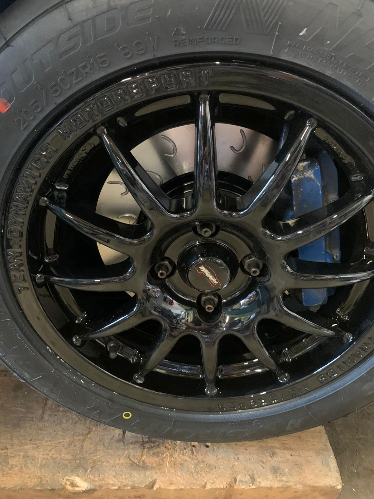

Just out of interest, How much "gap" have you got between the caliper and barrel and have you got wheel weights on that section or had to have them placed on the wider part of the barrel?
Those aren't my brakes ;) they were photos from Russ/ HyperHatch for sale thread:p
