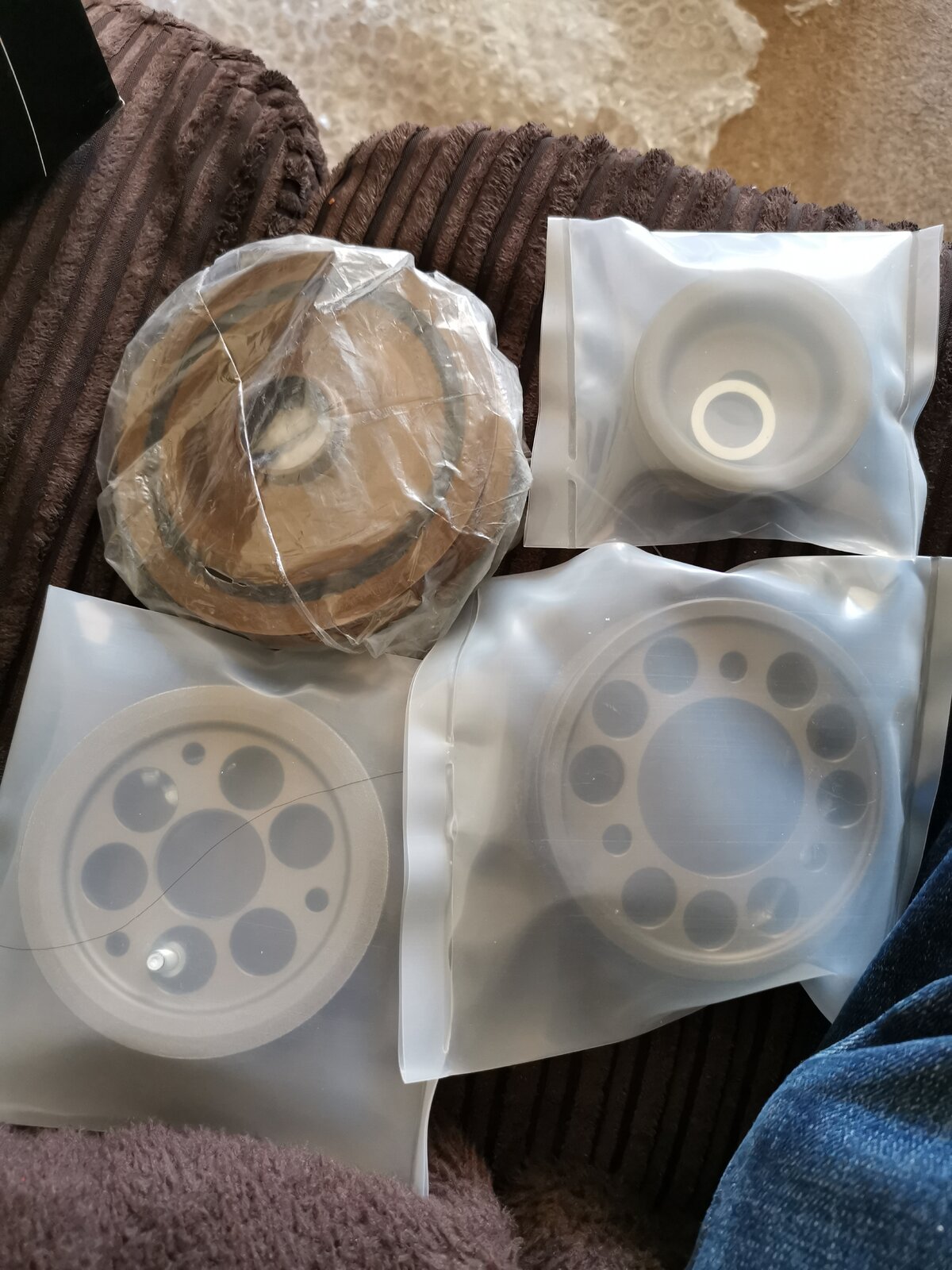

Delivery from @pure-motorsport for the lightweight pulley kit with standard damped crank pulley

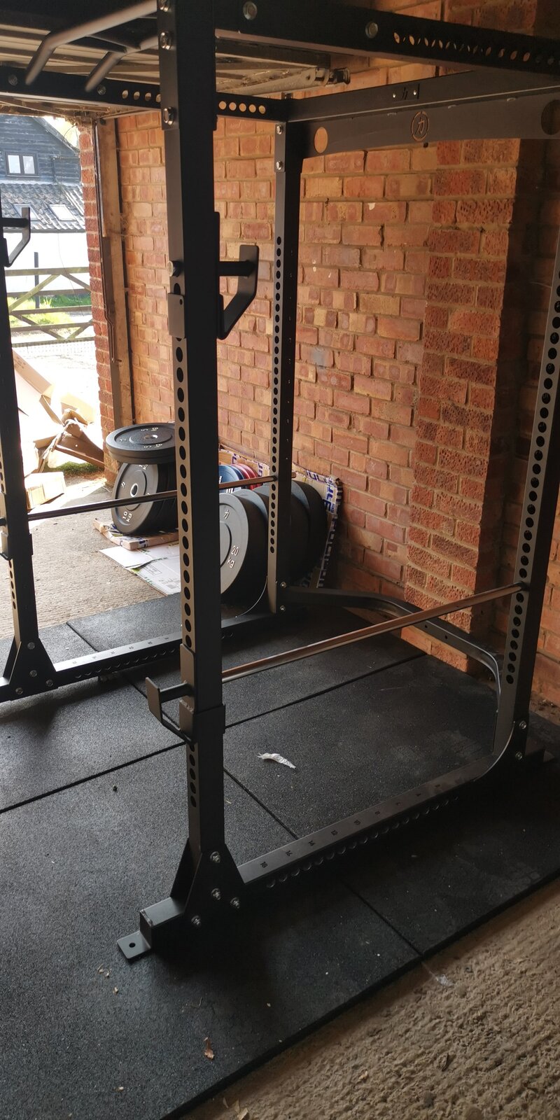

It will however be taking a back burner for a while due to the COV19 as I am also looking at doing some powerlifting competitions so im getting my garage gym sorted :p

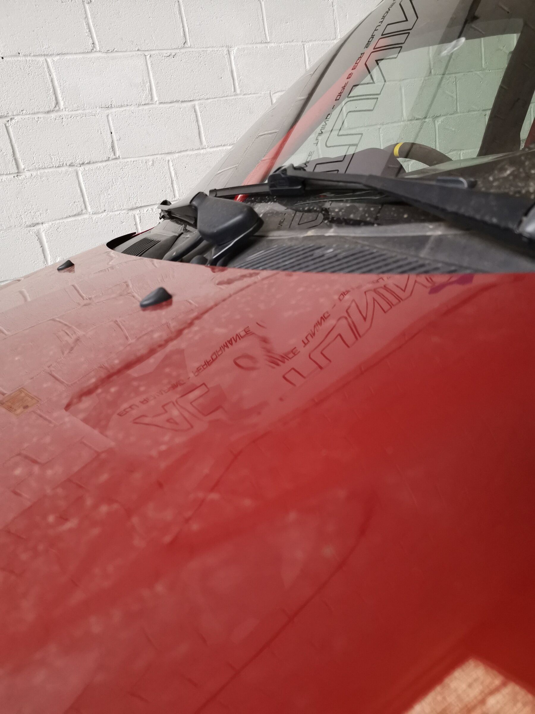

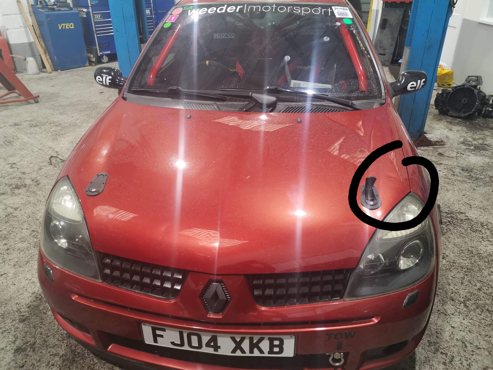

Got a message of one of friends, where my car is currently residing. He moved the car and didn't realise the bonnet latches were not down so as he drove if down the road the bonnet came up and dented it:rolleyes:
A bit annoyed to say the least, He said he is going to get it sorted.
  Clio 172
Spoke to garage today, and they going to be fitting a new bonnet and sorting out the aerolatches on new bonnet.

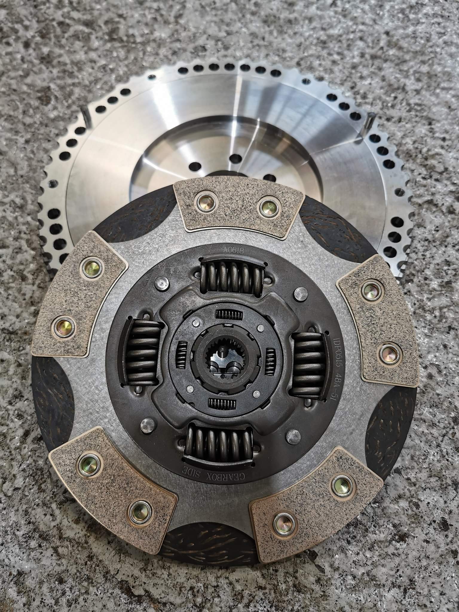

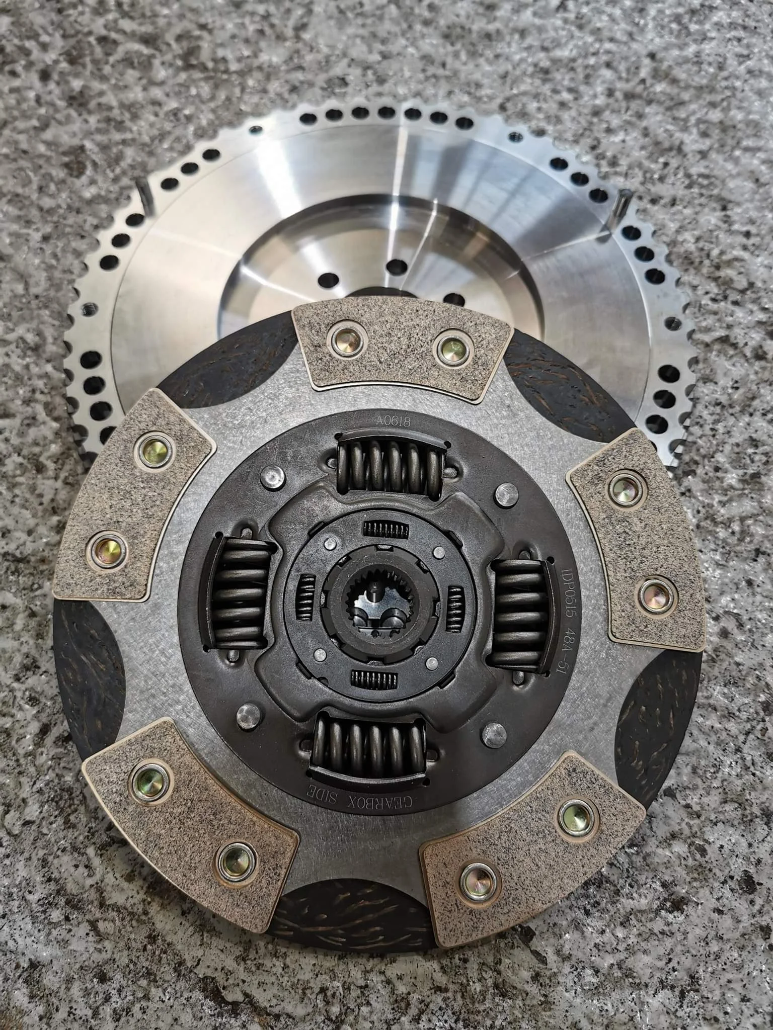

Also, I will getting the gearbox built buy @NorthloopCup, RTS Hybrid Clutch and TTV SMF Flywheel supplied by @Kev@KAM fitted on Monday. Will be using Redline MT90 gearbox oil, as its 75w-90 GL4

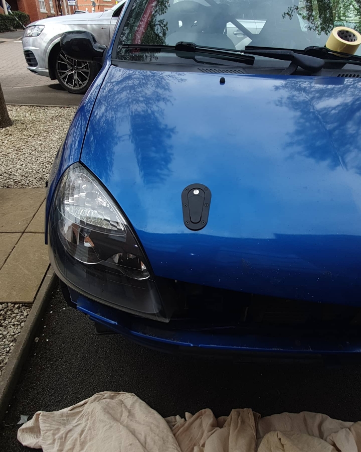

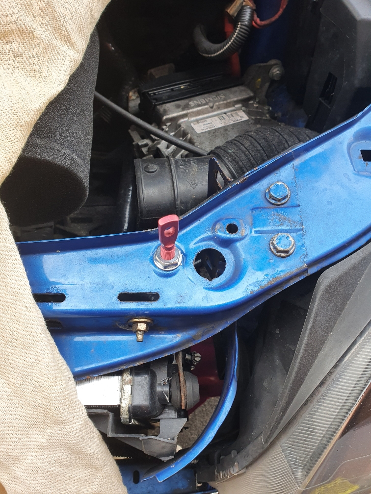

Make sure to tell the garage to fit your aero catches this way round..
Sent from my SM-G977B using Tapatalk
  Clio 172
Make sure to tell the garage to fit your aero catches this way round..View attachment 1469175
Will do :p

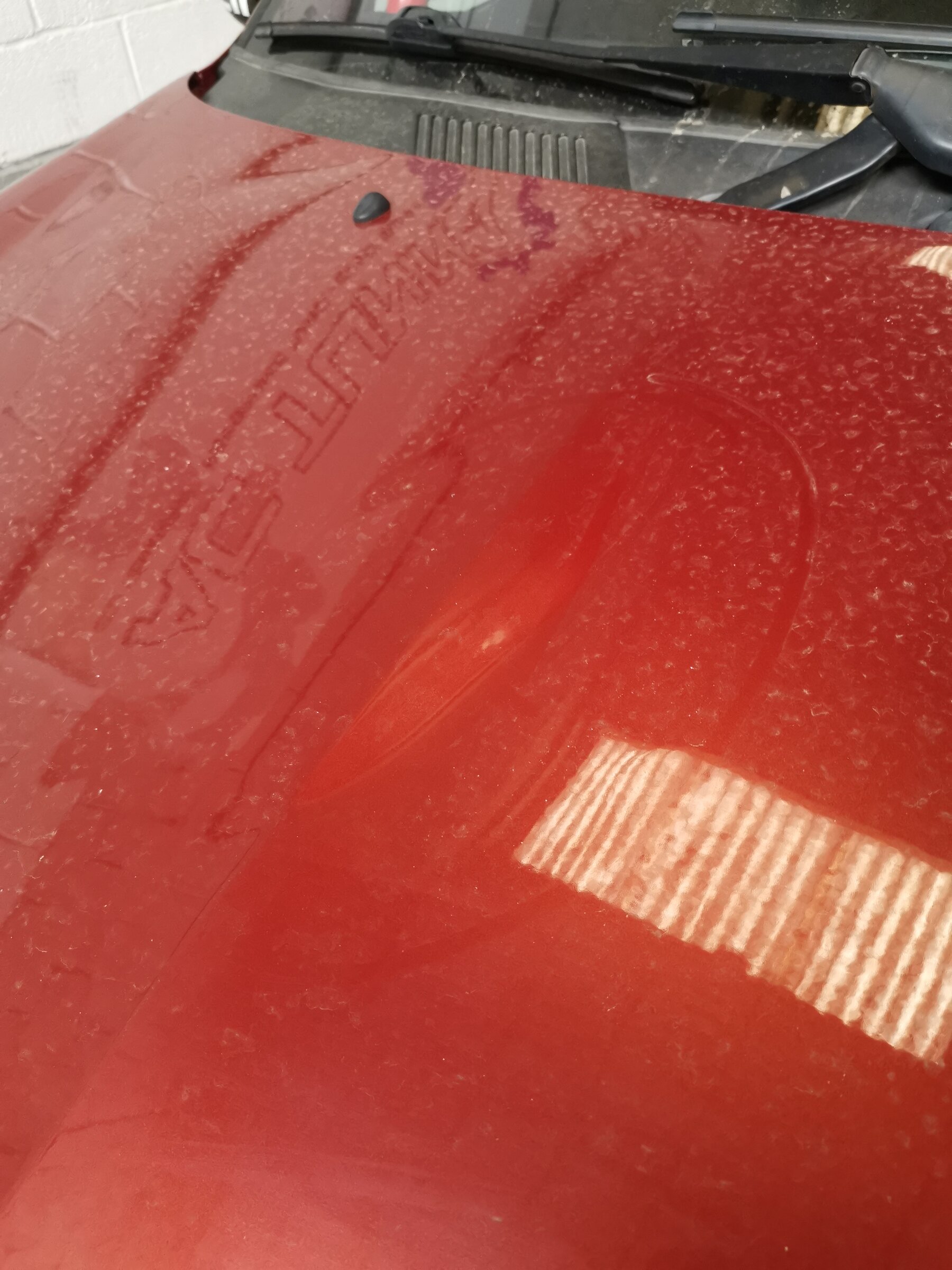

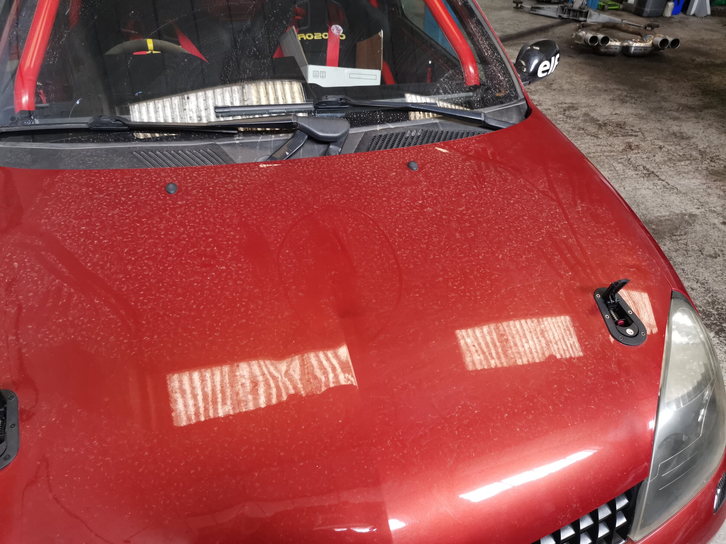

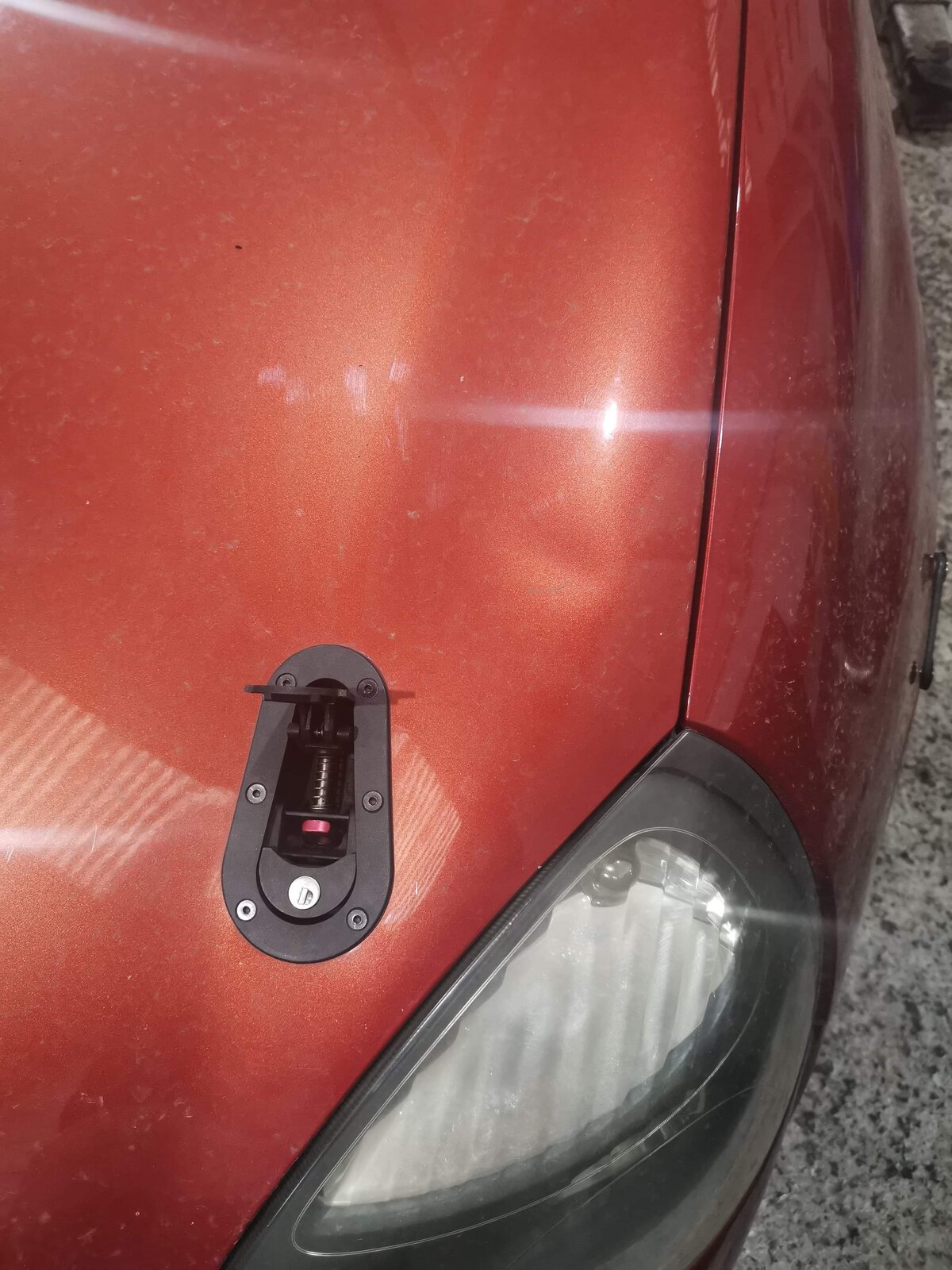

Just at garage now, and looking at bonnet there is more than 1 dent :O
There is also a big one in the middle and another one just near the windscreen.
They have bought a new bonnet which should be getting fitted in the week.
View attachment 1469589View attachment 1469590View attachment 1469591
As they are fitting a new bonnet, you may want to get them to fit the catches a bit closer together towards the middle line. Here is where i have fitted them to the slam panel.

The lads at Autoculture Tuning worked there magic on the Clio today, the RTS hybrid clutch, TTV SMF Flywheel Rebuilt gearbox with Plated Gripper LSD and Gripper 13/59 final drive fitted today.

Some info on what @NorthloopCup done for the gearbox:
- new mainshaft bearings
- seals
-synchros
- improvement to the selector fork on 1st/2nd gear to make them last longer
- selector hub for 3rd/4th gear
-4th gear.

- PMS Lightweight Pulleys (Standard Damped Crank Pulley

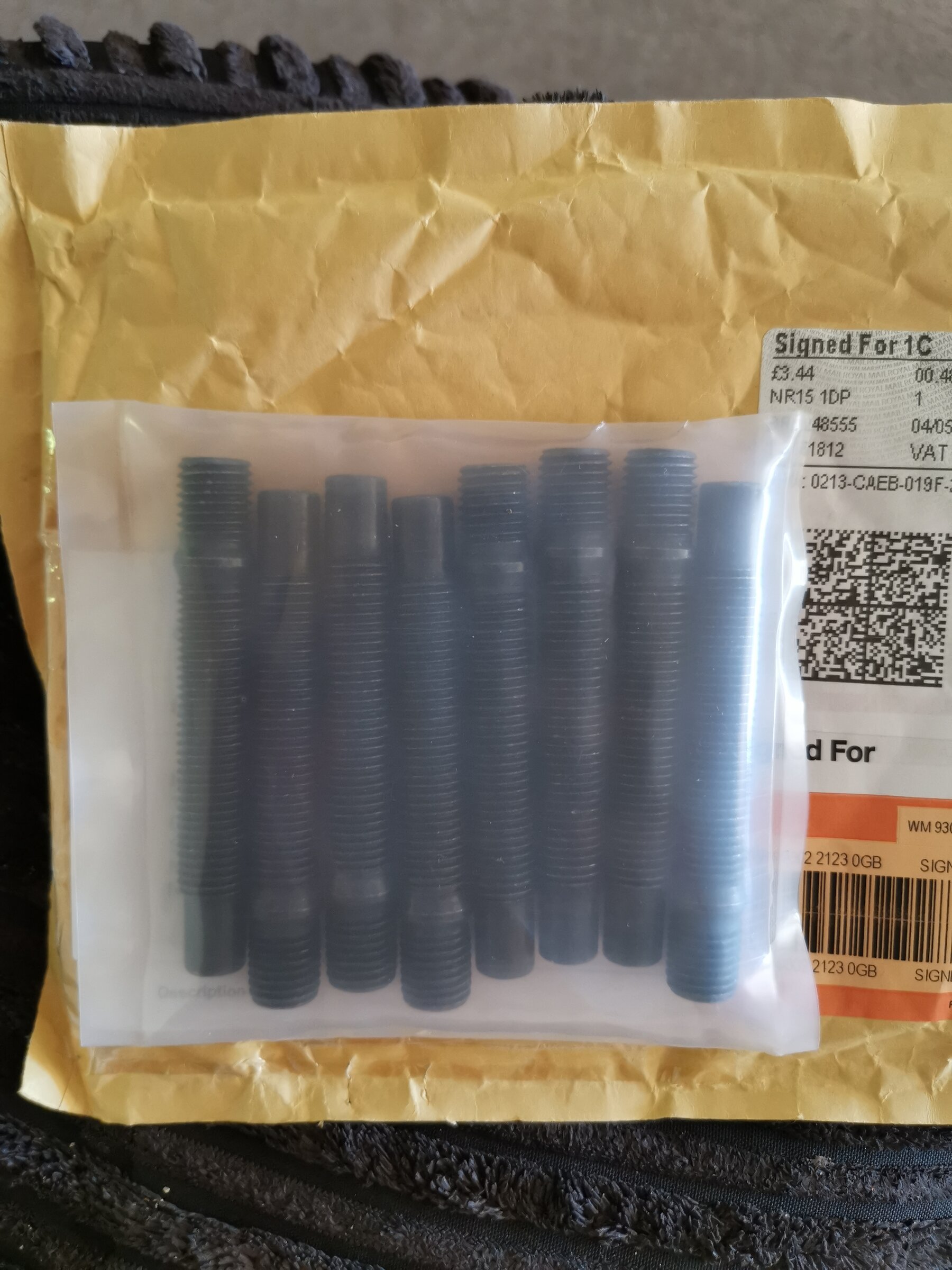

I did some order some longer front studs from PMS as with the spacer on they are too short really. Current ones are 75mm, so have got 82mm at home to be fitted.

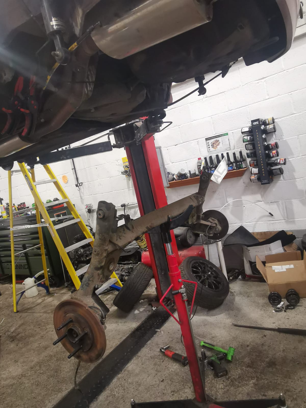

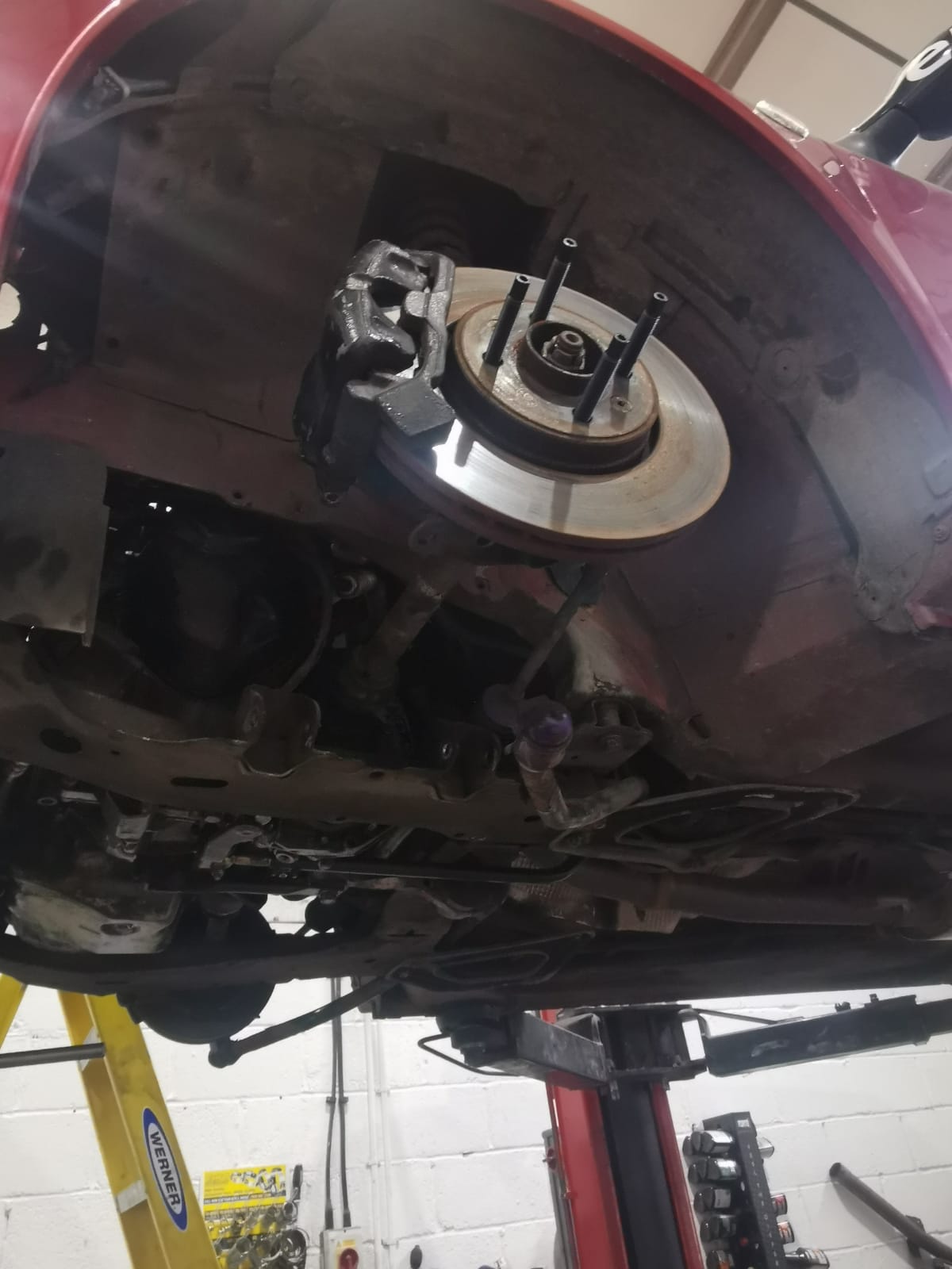

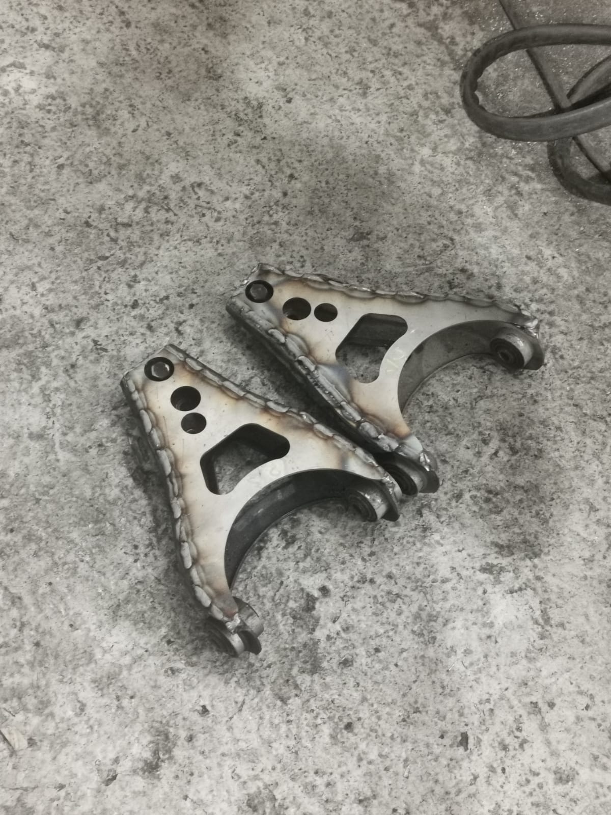

Pictures from my mate at the garage, PMS strengthening plates have been fitted to the Wishbones and rear beam in progress, about to the pressure washed to get rid of all the rubbish it picked up from the road.
PRO-AM Racing Roll centre kit by @Tomotek should be be delivered Saturday😎
Once everything is on, it'll go for alignment/ corner weighting.
