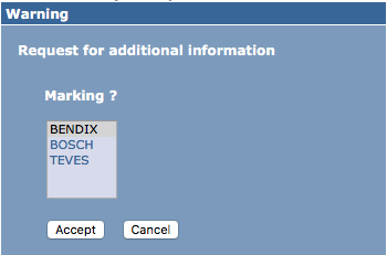

I beg to differ as there is 3 listed for the car.
I know for a fact that the Clio 182 Trophy has the following. -
Make - TEVES
Pt No - 7701207754
RRP - £136.18+vat
The 3 choices for the Clio 182 are as listed from the genuine renault parts catalog

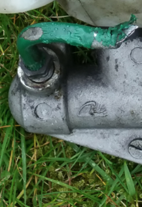

Hi all,
I think I have identified the MC with it still being on the car. It has a round end to it and looks like the one in the attached image (stolen from somewhere on the internet).
Does anyone know what brand this one is?
Is the issue between different brand Master Cylinders down to differently positioned brake pipe connections?

The one above looks like a ATE one but could be totally wrong.
The logos look the same.

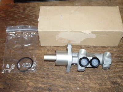

@DickP
Look at the part number above - 7701207754
Just put it into Ebay and a new one comes up but it has the ATE marking on it.

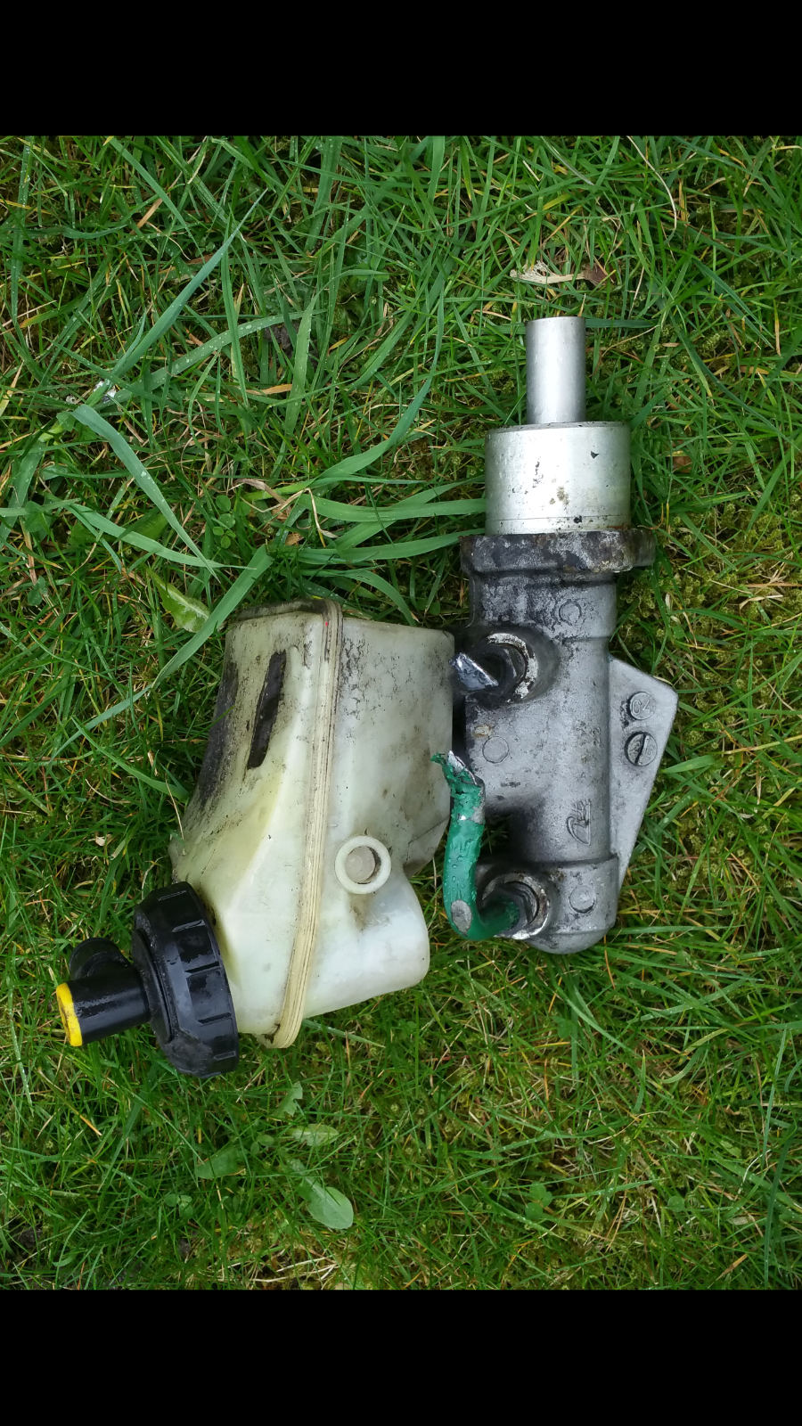

I think I've got one somewhere that was working fine when it came out the car if you want that ?
Typical.
You don't know where I can get all the seals for a master cylinder do you? I'm gonna take a punt off a used one on ebay but want some seals incase it's knackered.
I'll have a gander mate, I struggled finding some for someone last time too. Seems theyve stopped doing them🙄
Yes please, that'd be great. Is it an ATE one? Any chance you can send me a photo just to confirm its 100% the right one? If it is, just let me know how much you want.
The seal kits are all the same for the MC but obviously one is for LHD and has ports on one side rather than the other
This is only one that comes up.

Right, master cylinder arrived today (thanks again @Archtronics!)
I know how to remove and what not, but when refitting, is it just a case of refilling reservoir with fluid and bleeding as normal?
I've got an RS Tuner to bleed the ABS if needed.
