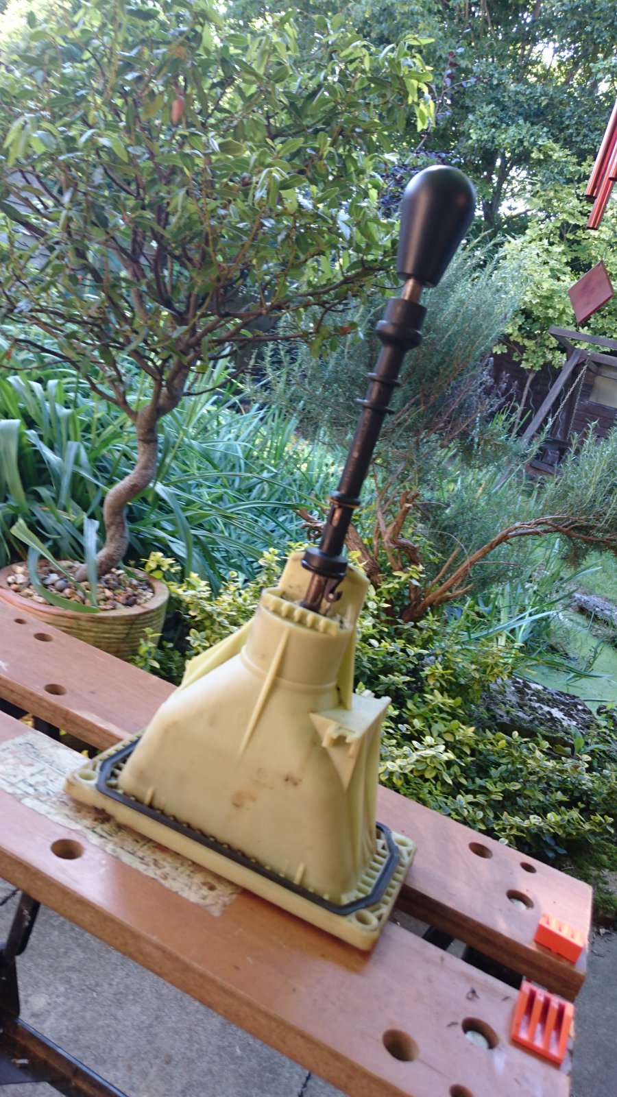

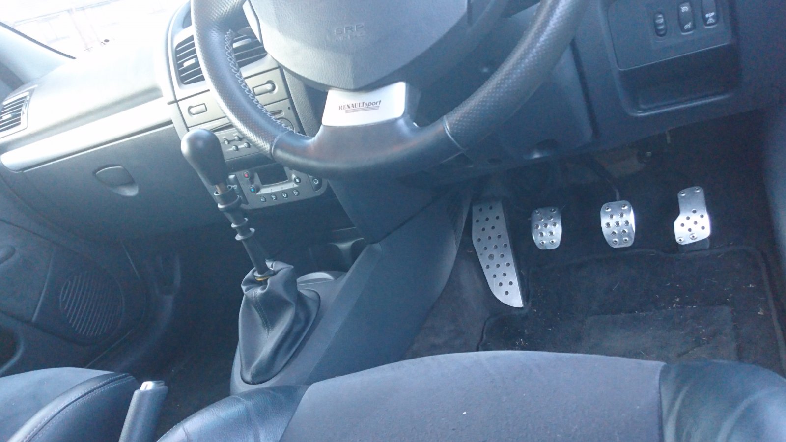

Thought I'd update you! Finally got my shifter in after the modification process and drilling the knob out to size!
Looks great! Only took me three bloody hours to get the cat off due to poor quality copper nuts that were just way to soft for the tension they were under! Think it actually took about 25 minutes to install the shifter it's self what a joke!
All is well now and so pleased with the way it feels completely changes the gearchange experience hahah and is more comfey when driving harder!

Car looks smart with the shifter, get some more pics up :cool:

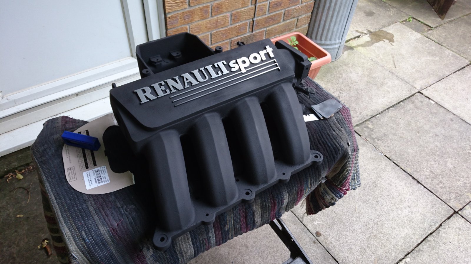

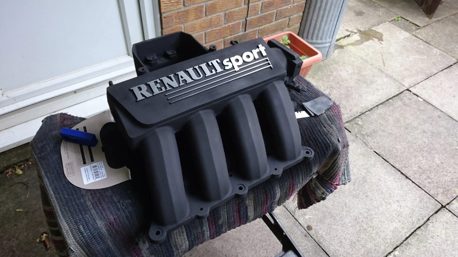

After fitting the Decat I moved on to stripping down and painting my inlet manifold! (also cleaned up my tb) Which I'm really pleased with! Only a little more polishing to do on the RS logo. ( will upload pictures of the process if anyone would like to see) (also planning on Spreying the injector gaurd soon too!!)

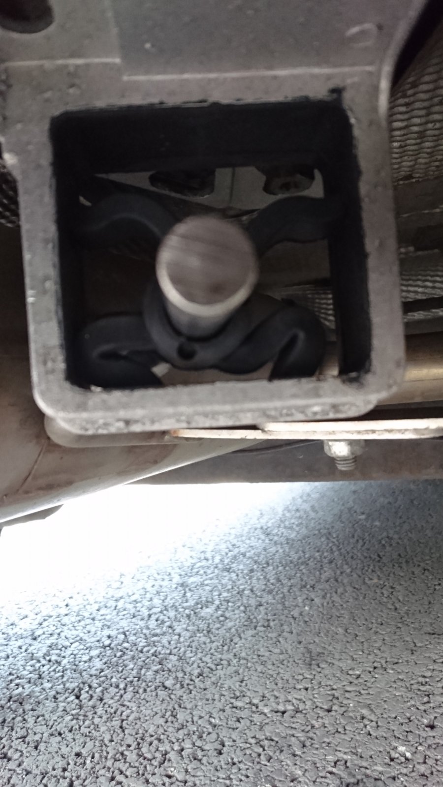

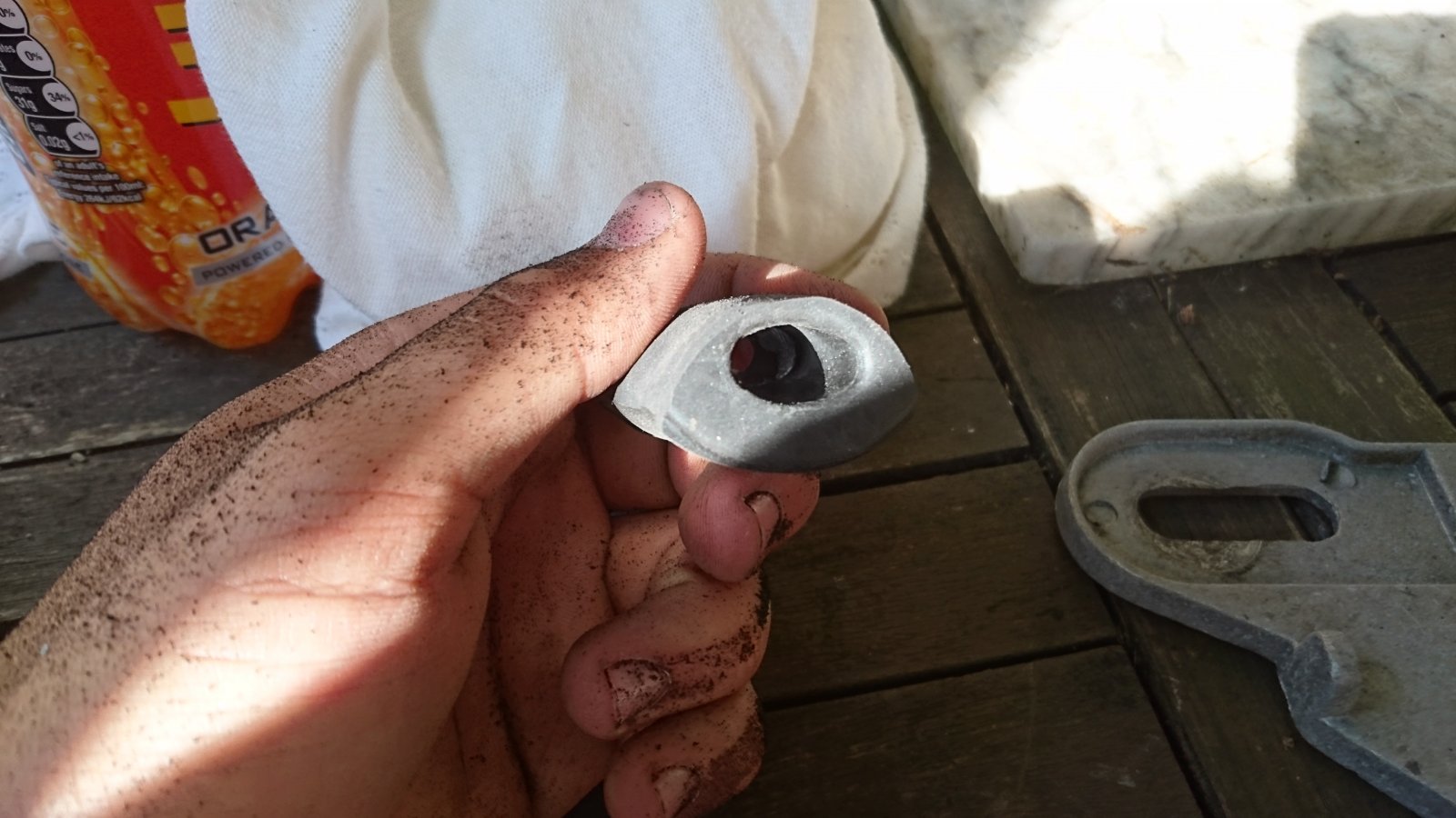

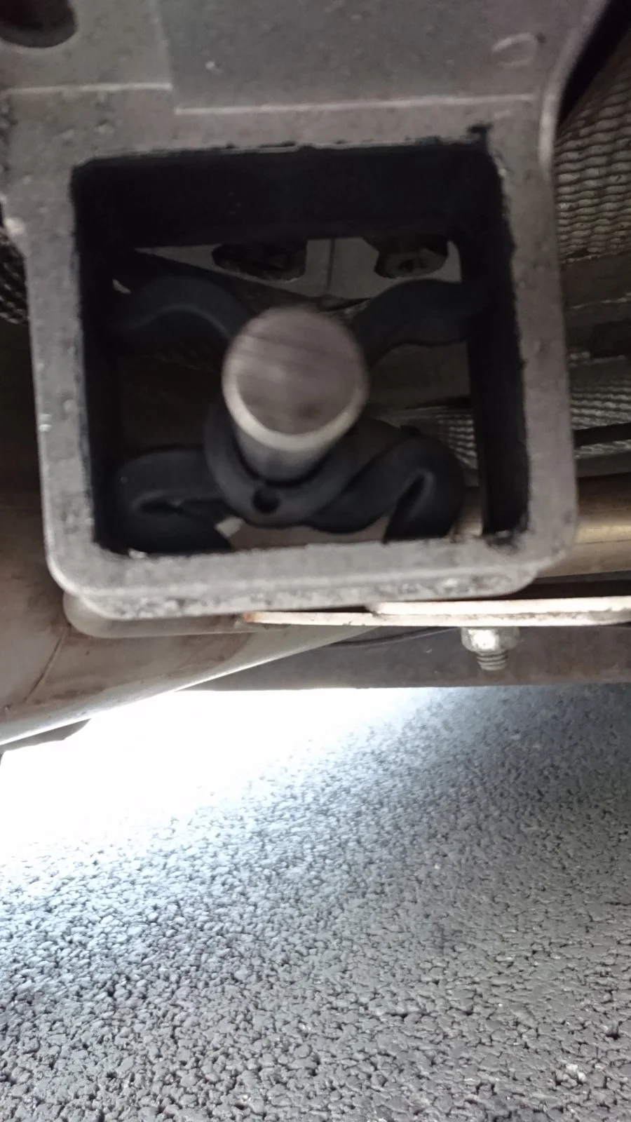

After noticing my rear exhaust hangars had already started to collapse just after two days or gentle driving i decided to contact the supplier and let them know..the customer service team were really good and refunded me for both which was great!:smile:

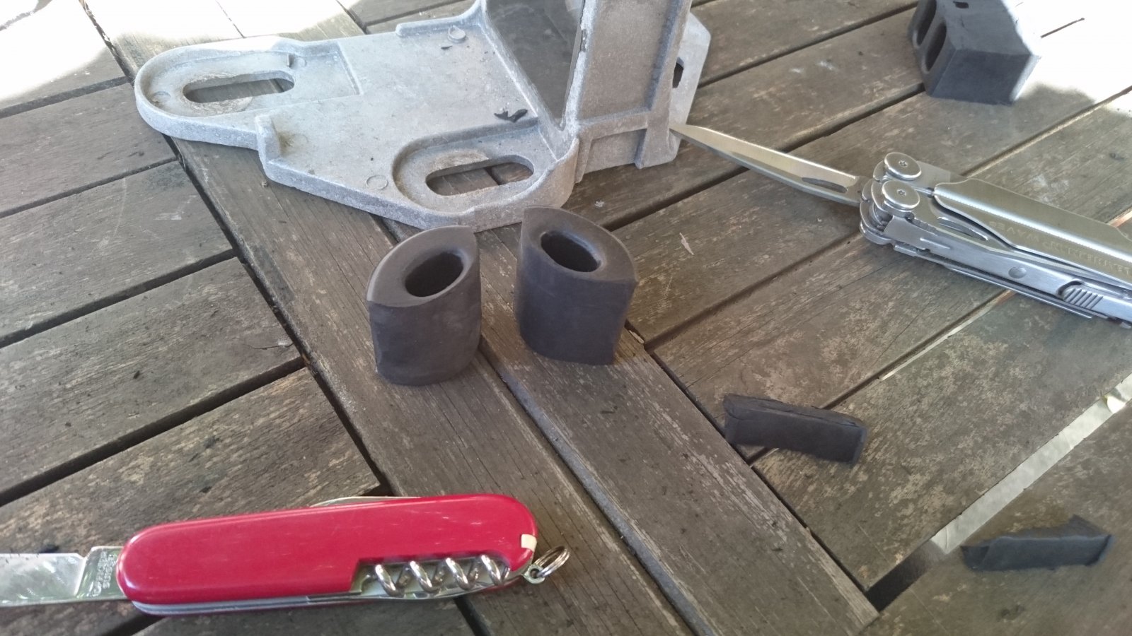

Looking at where the rubber bushes had collapsed I went ahead and made my own very home brew inserts to slide under the bottom two legs of the Bush..
Before pic of the exhaust hanger after just two days:tongueout: -
My simple fix involved buying one generic rear exhaust hangar from Halfords and hacking it up to make two shaped rear inserts that slide in underneath the two bottom legs of the Bush.
After about 20 mins on the bench grinder smoothing and shaping I was happy with the shape and give of the little inserts!:smile: (not a work of art but functional)

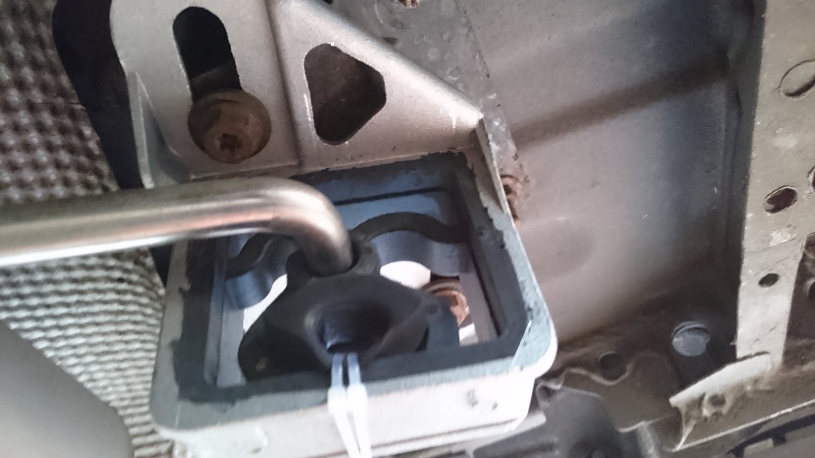

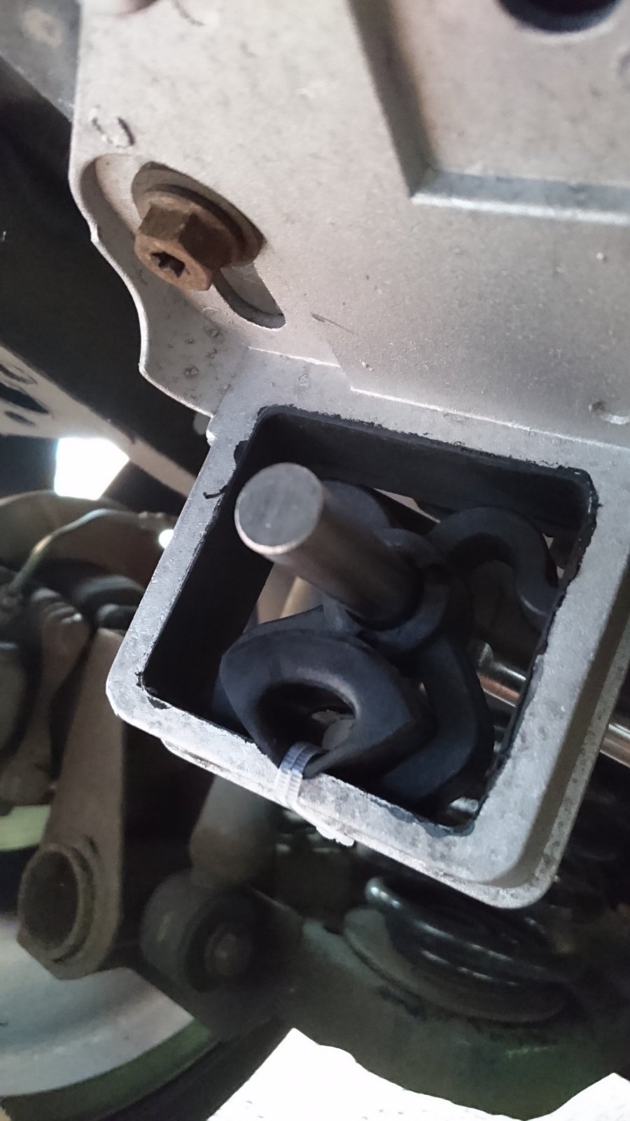

Only thing now was to test fit them to the real thing on the car!:smile:
After test fitting the little inserts I popped a couple of cable ties in to secure it (not ideal but will serve it's purpose until I have time to think of another solution! Until then the inserts have been great!:smile:

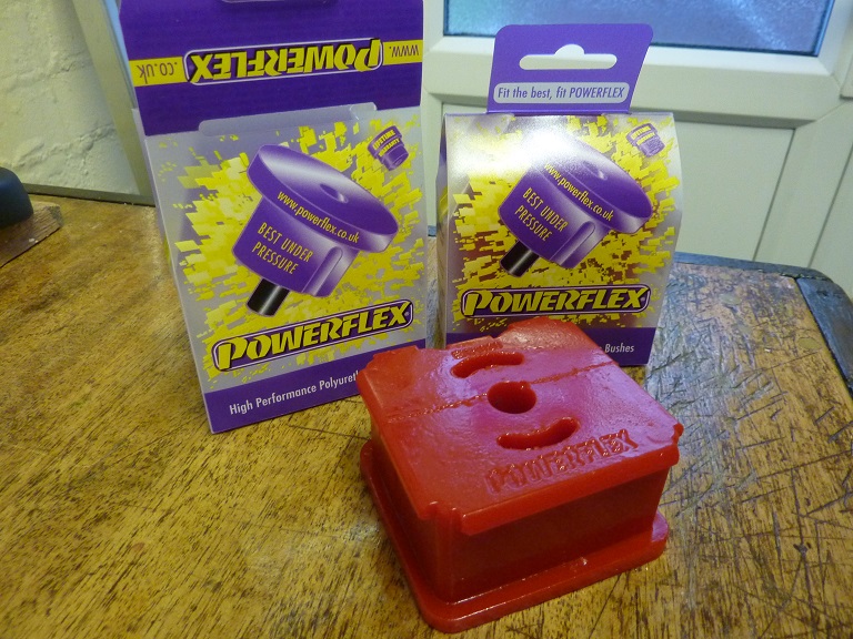

Good idea with the rear exhaust hanger bushes, but I bought these for mine which hold the exhaust nice and tight :up:
Yeah they look great! The little inserts were a bit of an emergency replace mentioned before going of on a trip but still holding out very well not bad for £1.11's worth of chopped up and shaped exhaust hangar:smile:
What's the price of these as they look great!:smile:
Cheers!:smile:
Nice idea on the exhaust hangers, if they sit well now I'd just leave them. I've got 2 sockets in mine to make it sit exactly how I want it.
I just can't get my head around spending £40 on mounts for it to look pretty, when something for a couple of quid will do. Maybe it's just me being a tight Yorkshireman.
Yeah I do like coming up with a cheap alternative that's just as functional it can't be beaten!:) they're still going so strong!!:)
Both are good it just depends on how you see it I guess!:)
The cheap ideas are awesome when they work :up::up:
I just went straight in for the powerflex ones as it was a brand new Milltek and they are rock solid and it's sits perfectly right out of the box
Yeah completely agree, Mines a milltek too with Decat pipe sitting sweet and the tips stick out about 20mm which is what I was looking for..the standard mounts aren't good for anything unless they're either replaced or modified imo!
My little inserts are working amazing atm gonna leave them for now! Always good to have an alternative though!:D
