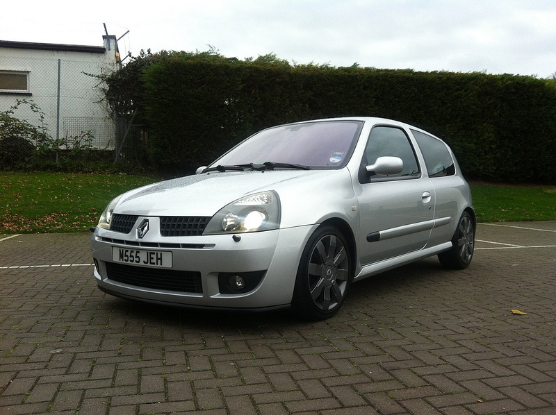

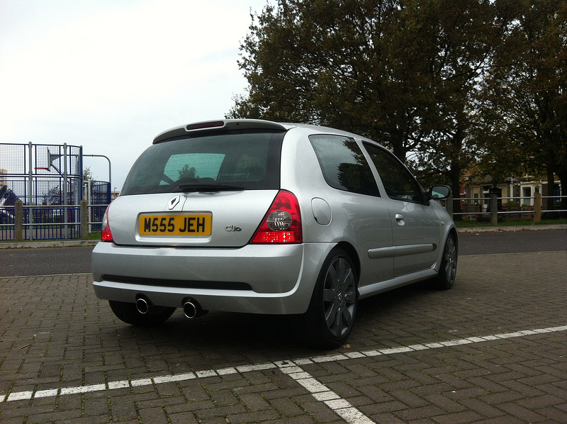

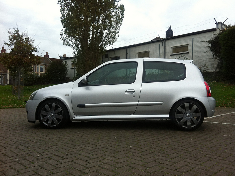

I personally run CookSport springs with Cup shocks and they are excellent. Good drop and very good quality ride. Few snaps of mine here..
Clio182 by lawro06, on Flickr
