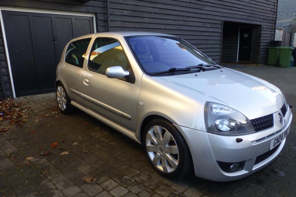

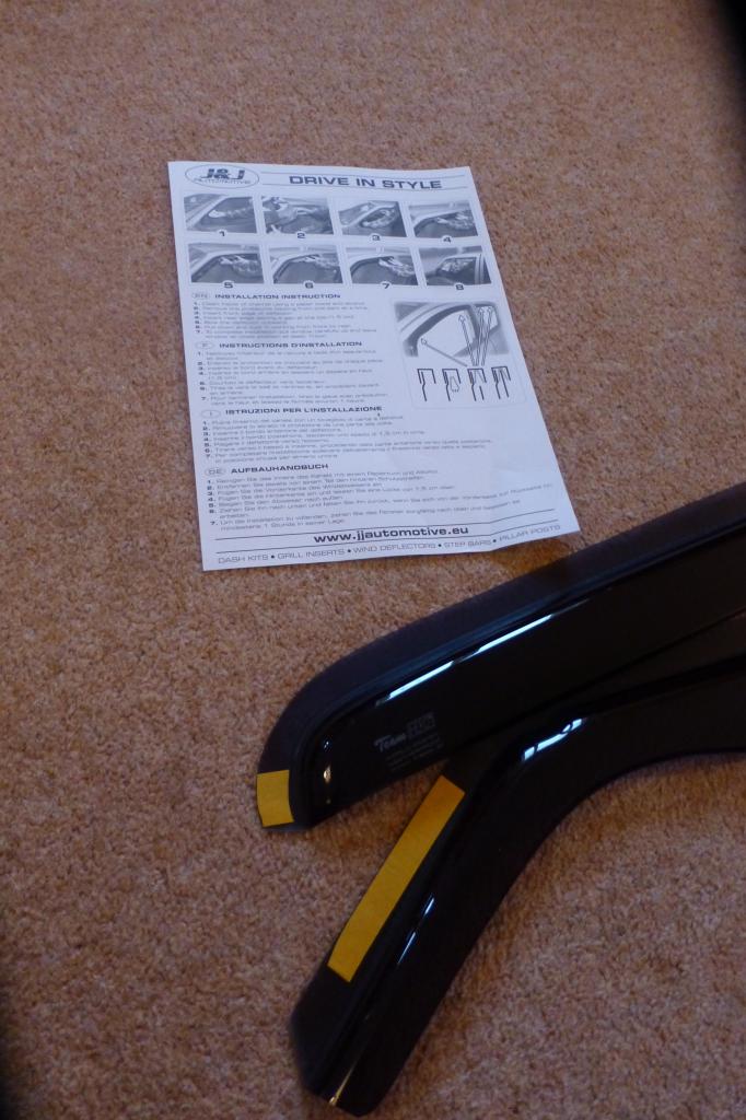

Forgot I purchased these, so little early xmas present:
Washer blanking plates have arrived also:

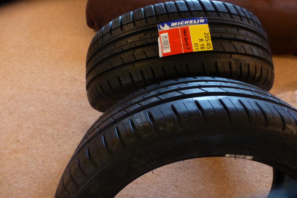

and finally the tyres are here so will be fitting these tonight and getting the tracking sorted :smile:

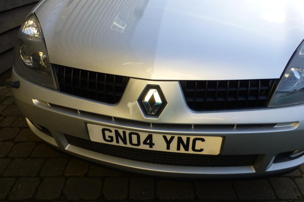

where can I get one of those smaller front plates from??
car looks lovely btw :smile:
Thanks mate, yeah getting to how I pictured it when I started the work.
This is the website link you need to use:
http://www.fancyplates.com/constructor.html
Select Fancy plates, enter reg plate, then remove border, set text to UK standard, then go to step 2 You should see that on the second page it asks you to specify size, leave the width as standard and change the height to 90mm. (standard heigh is 112m from memory)
Delivery can take a few days.

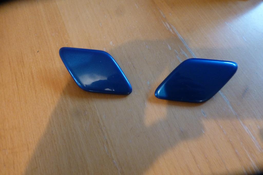

Had a thought about the front washer jets for the head lights, I am going to trial fit these black rubber grommets to see what it looks like, I am also going to get a pair sprayed to see if I can get them in without the paint cracking as I think it might look better than using the OEM covers plates.
http://www.ebay.co.uk/itm/181383615848?_trksid=p2059210.m2749.l2649&ssPageName=STRK:MEBIDX:IT
If it doest look good I will stick with OEM but I think its worth a go.
Not even sure the paint would bond to the rubber grommet in all honesty, I can but try.

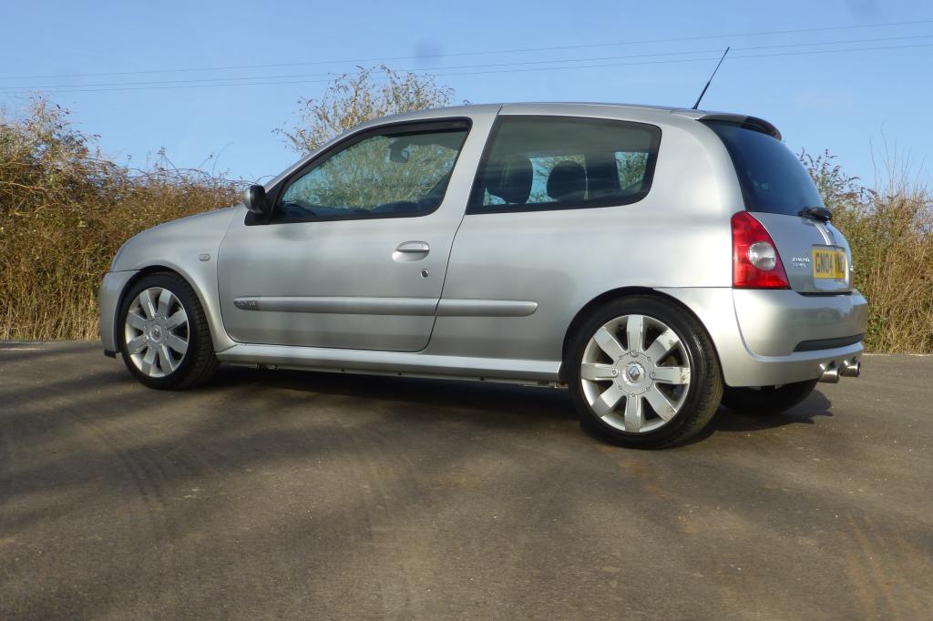

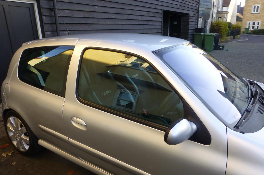

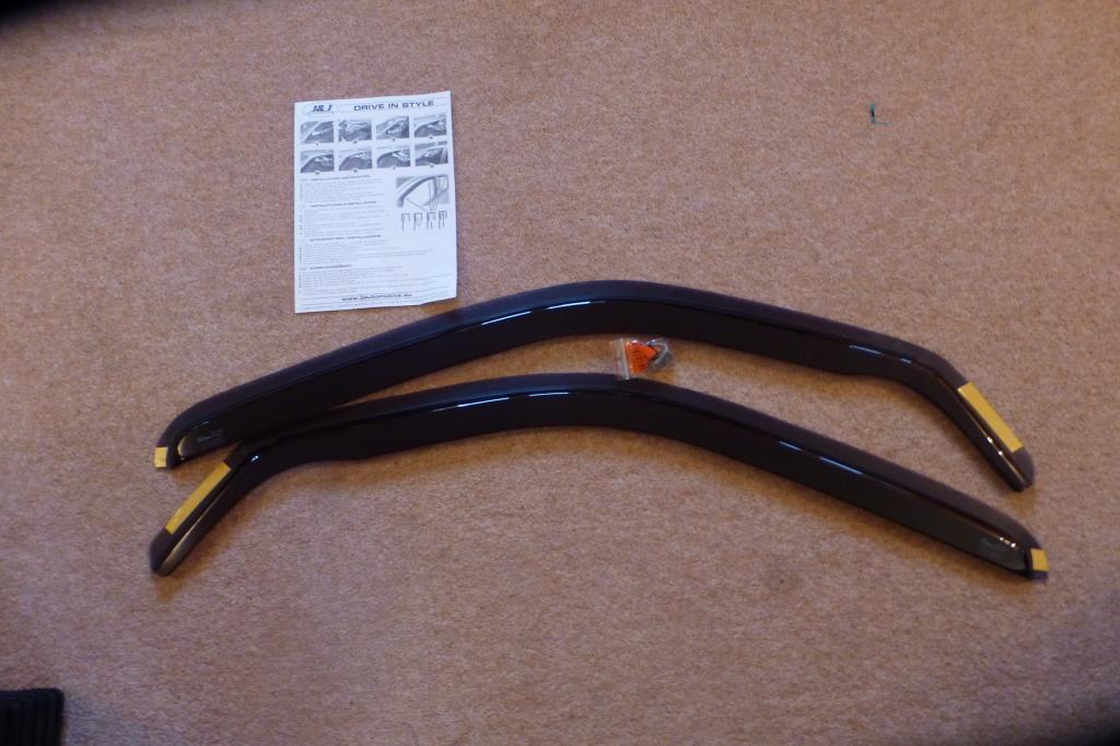

Like the wind deflectors, really suits the car. That car looks amazing, silver wheels on a silver car look stunning.
Ive got one of those Civic aerials on my car, they work really well, good reception - I listen to radio all the time so need good reception. They just screw in . The base is a little larger than the clio aerial but all in all it looks so much better. They are fairly cheap think mine was £13 at a honda dealer a few years ago.

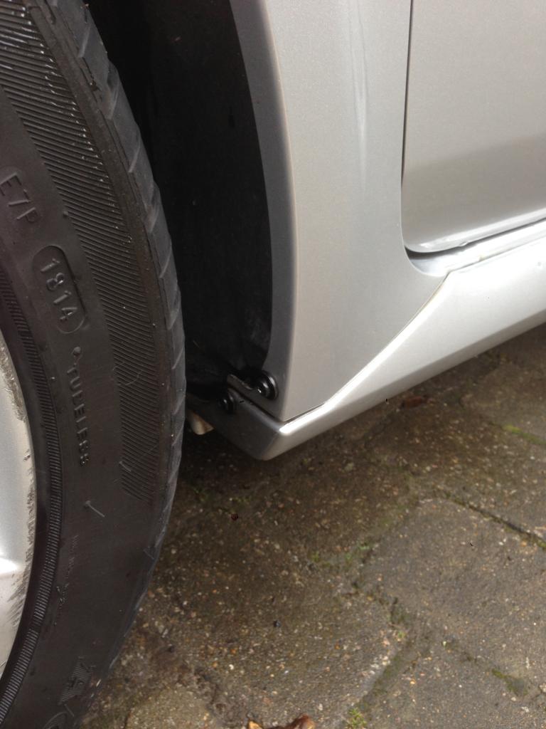

Did you manage to fit the arch liner screws mate? I havnt had a go yet, i might do them this weekend, easy to get out?
This is the aerial you want:

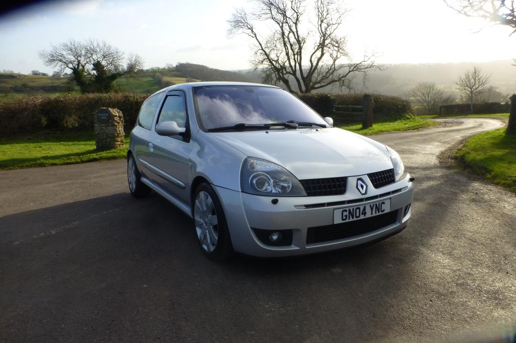

Thanks buddy, yeah really happy with how its looking and especially the condition its in for a 11 year old car :)

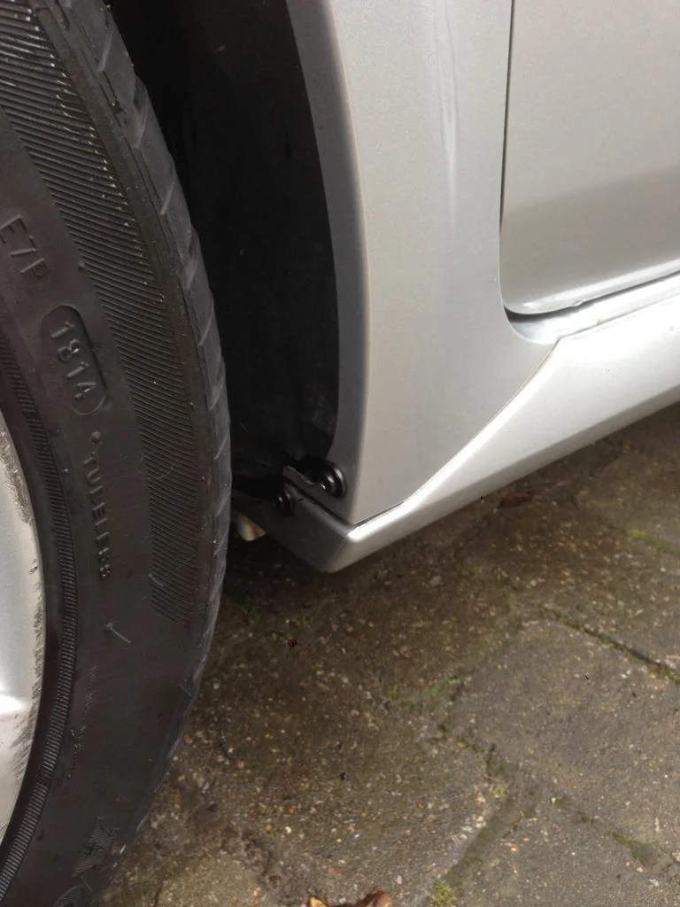

If you are referring to these ones then yes I have replaced them all apart from the two on the drivers side front wheel arch as they where stuck solid, will get them shifted at some point.
Its the little things like this that to me make the biggest changes :smile:
If it is these that you are struggling with and they won't budget, suggest soaking in WD40 or the likes, spray on them every day for a few days then try again, or hammer a star bit in to them to get more purchase.

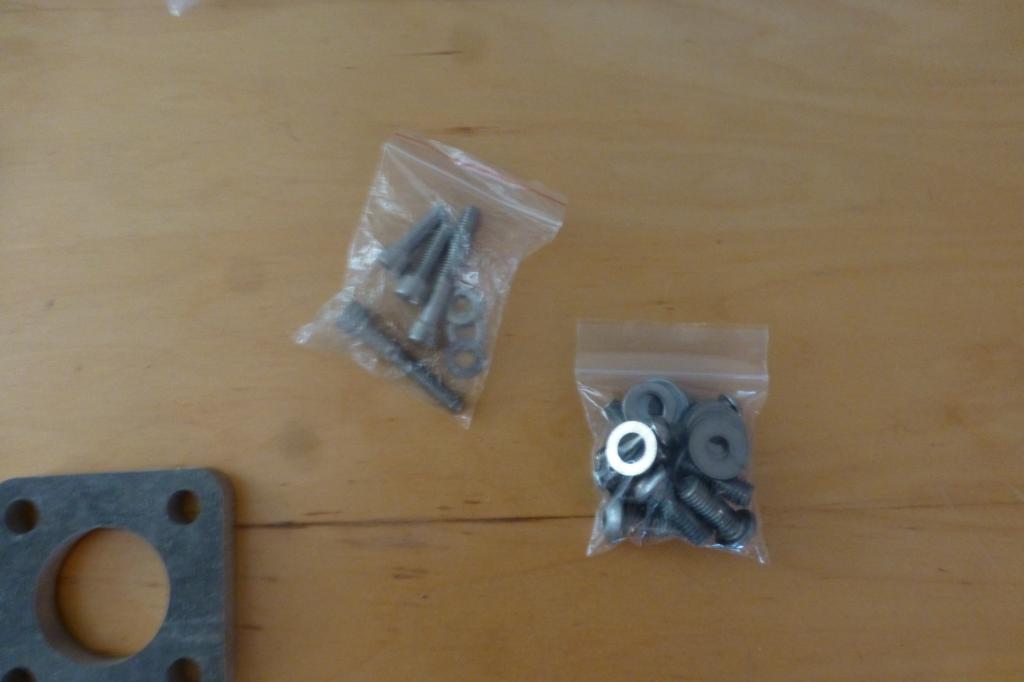

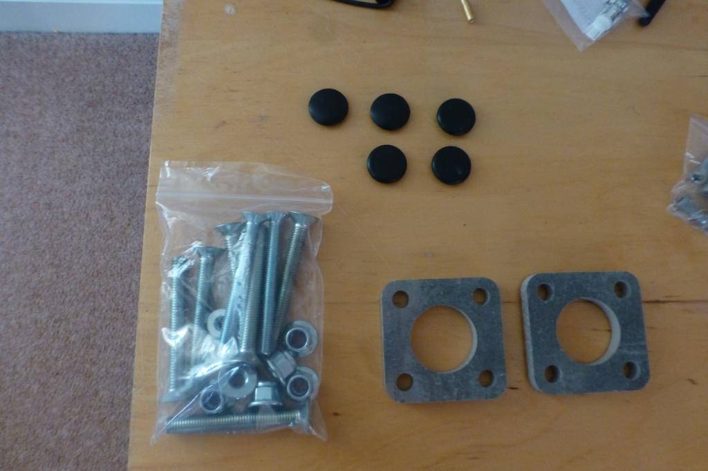

Spacers have arrived, so I can do away with that god awful scrubbing sound:
You can also see in the picture the rubber bungs that I am intending on having sprayed.
Also got new engine cover bolts to replace the old ones and new slam panel bolts to smarten things up:

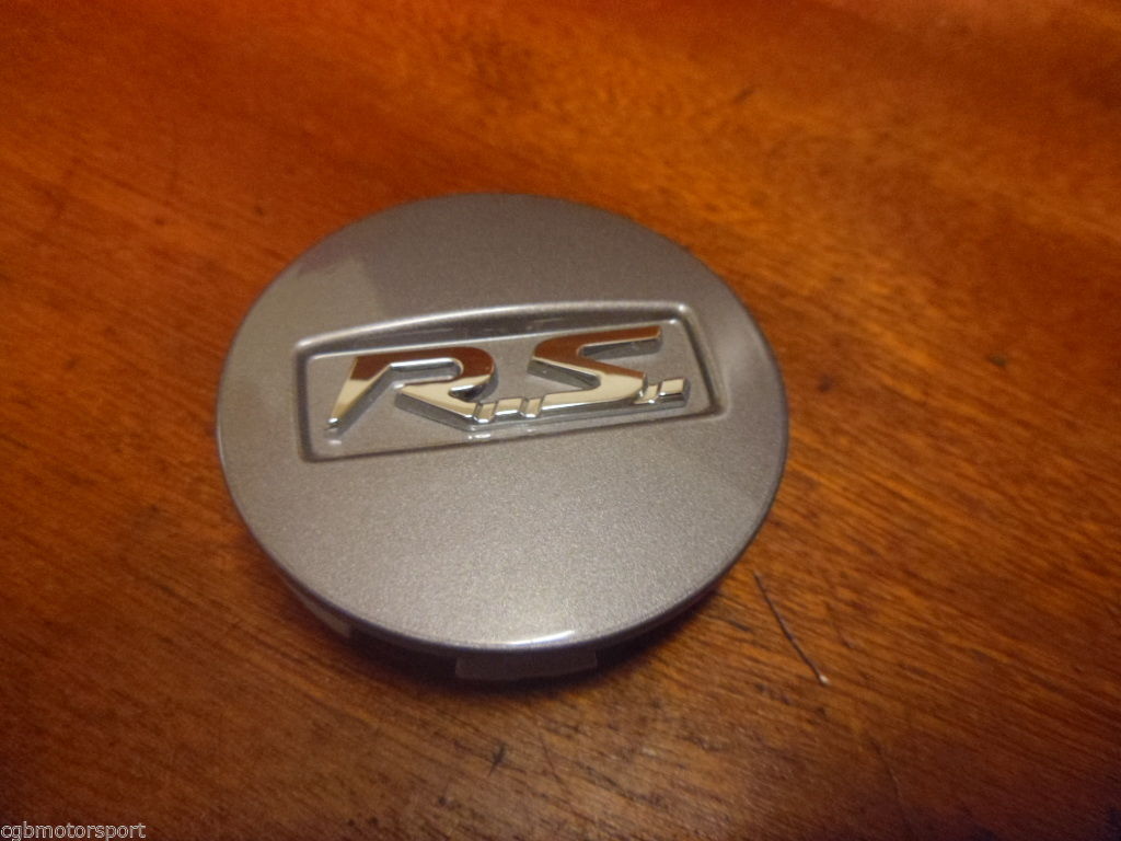

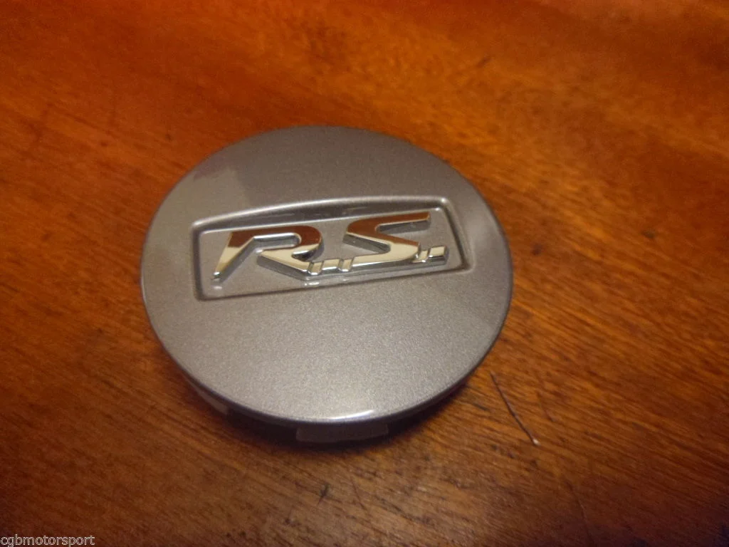

Help required, I am close to getting a set of Turinis, I am usually a stickler for keeping a car standard looking (OEM)
However I have seen these caps for Turnins which I am tempted to go for over the standard Renault Diamond,
if I go for these then I will also be tempted to debadge the boot and go for this badge instead to keep a bit of a similar modern style going.
What we think? My thinking is I can always replace the original ones again in the future if needs be.

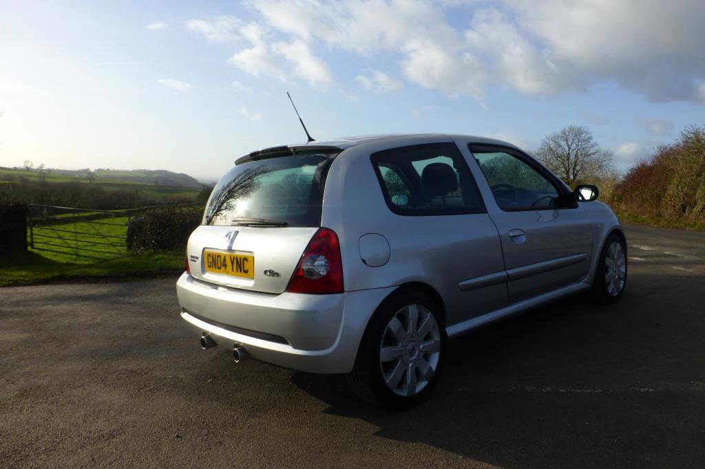

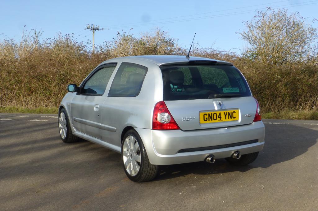

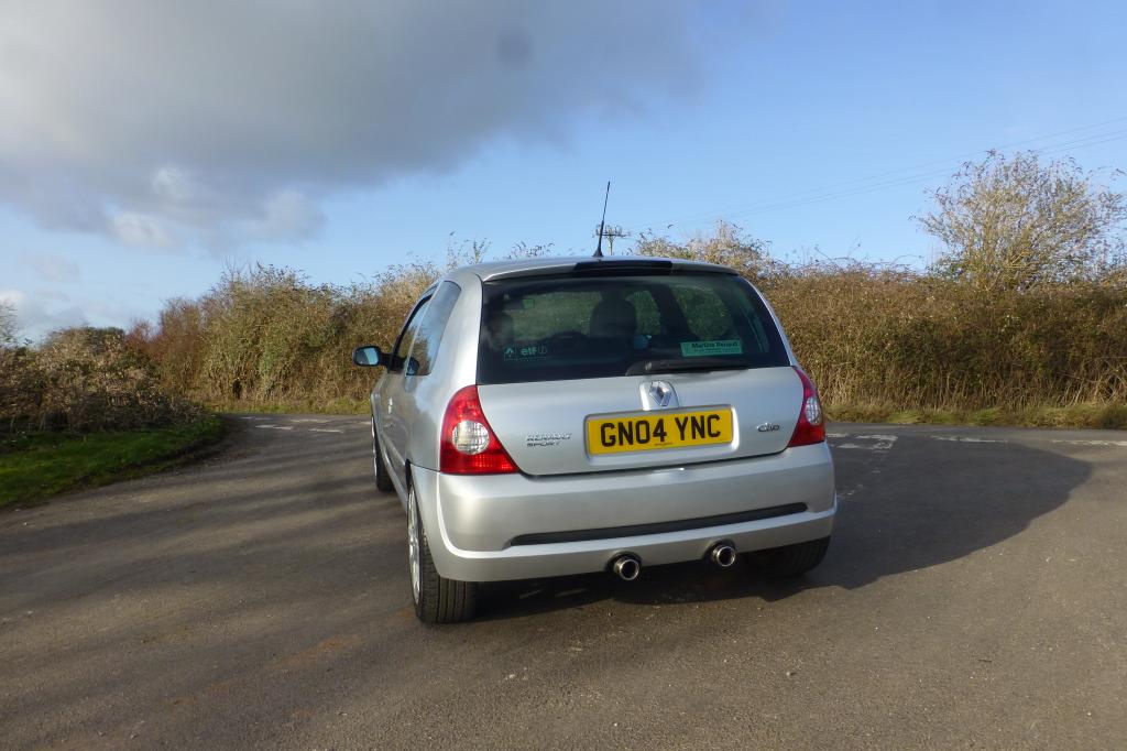

25/01/15

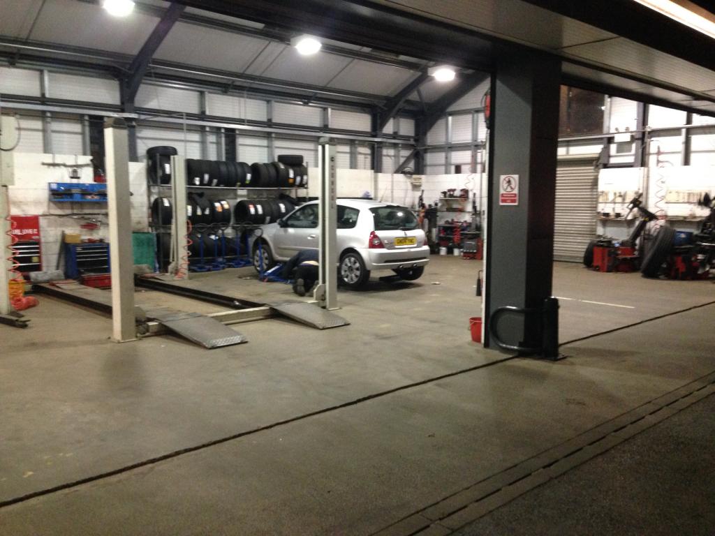

I had the tracking checked and adjusted on Friday as it hadn't been done since fitted the new tyres.
Car was a disgrace and was due a really good clean as hadn't been washed for over 3 weeks.

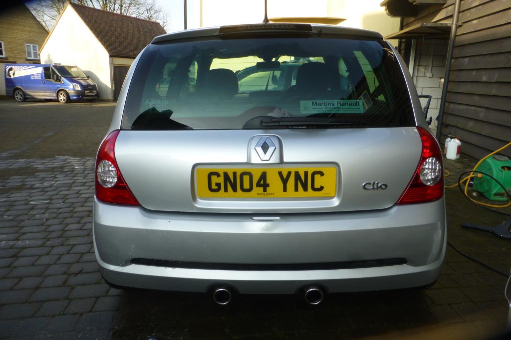

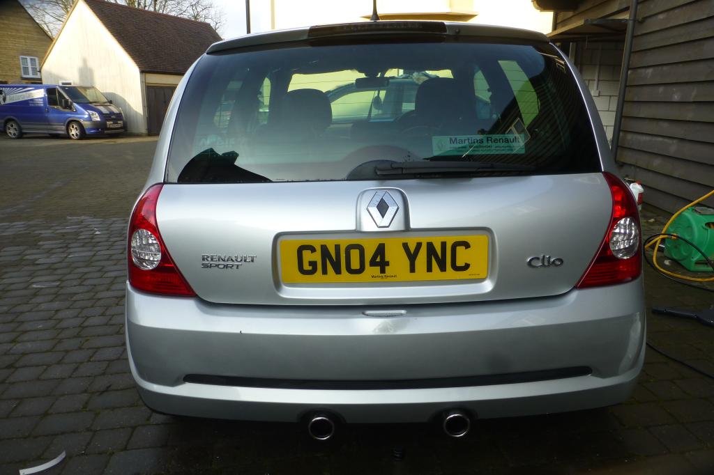

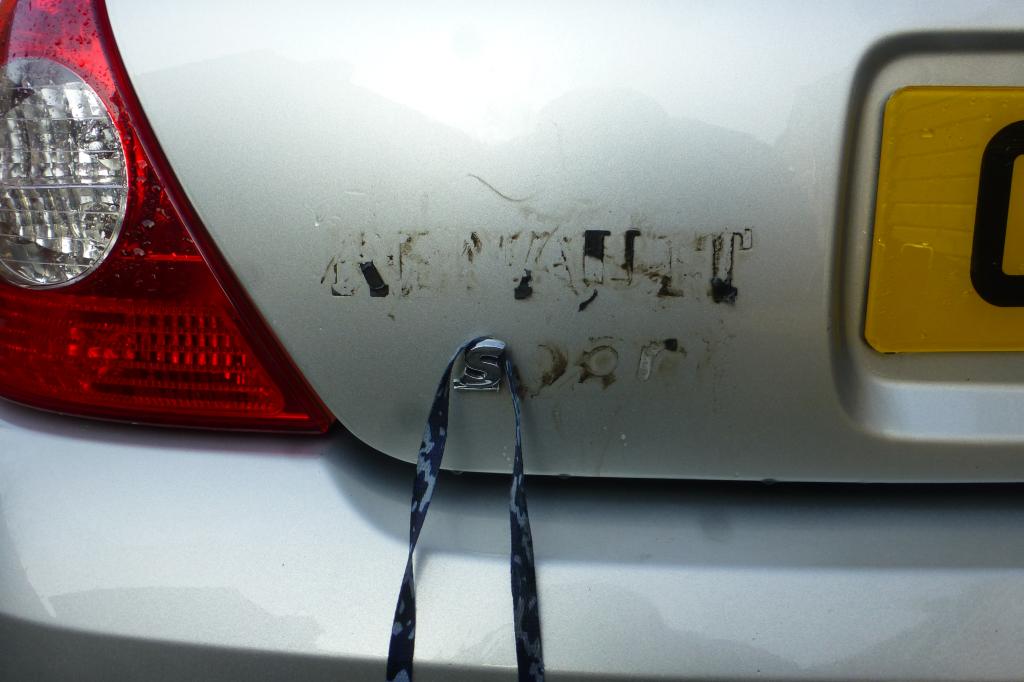

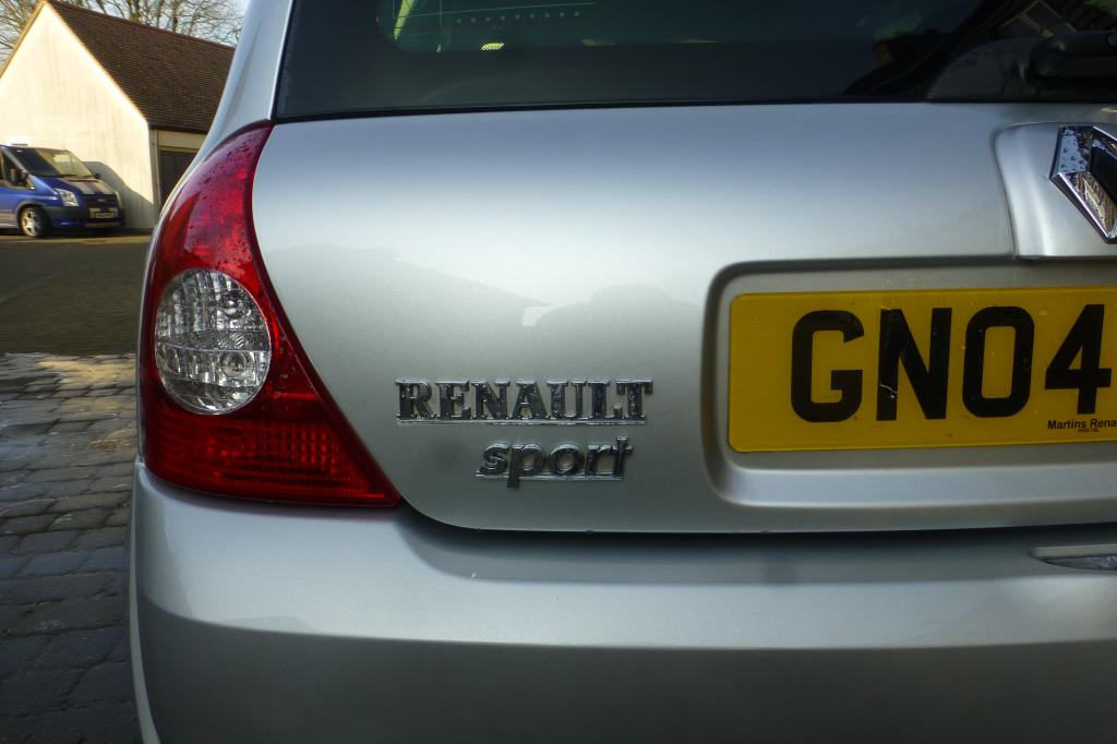

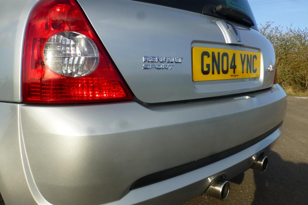

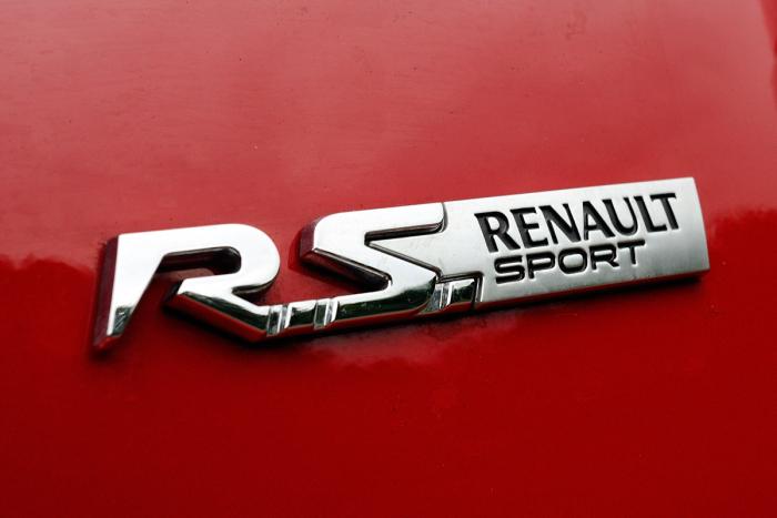

I decided to replace the rear badge which arrived over the xmas period, frustratingly even though I lined the badge up to ensure that it was level and correctly spaced when applying I slipped and it hasn't gone on completely level, VERY frustrating but its only marginal.
Original:
Removing:
Cleaned down with white wine vinegar to ensure a clean surface.
New badge:

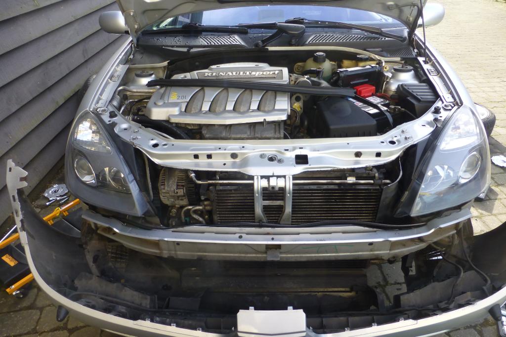

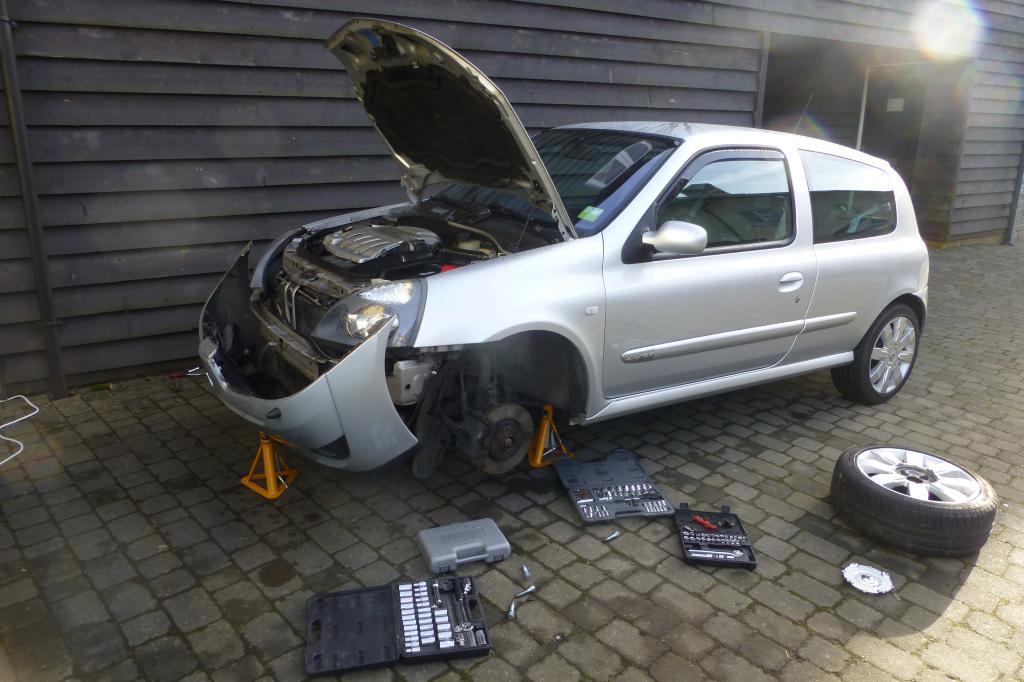

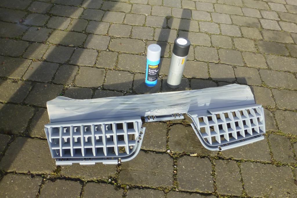

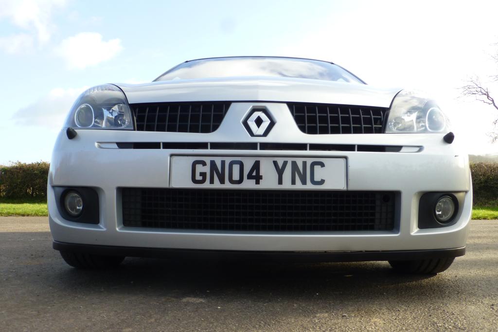

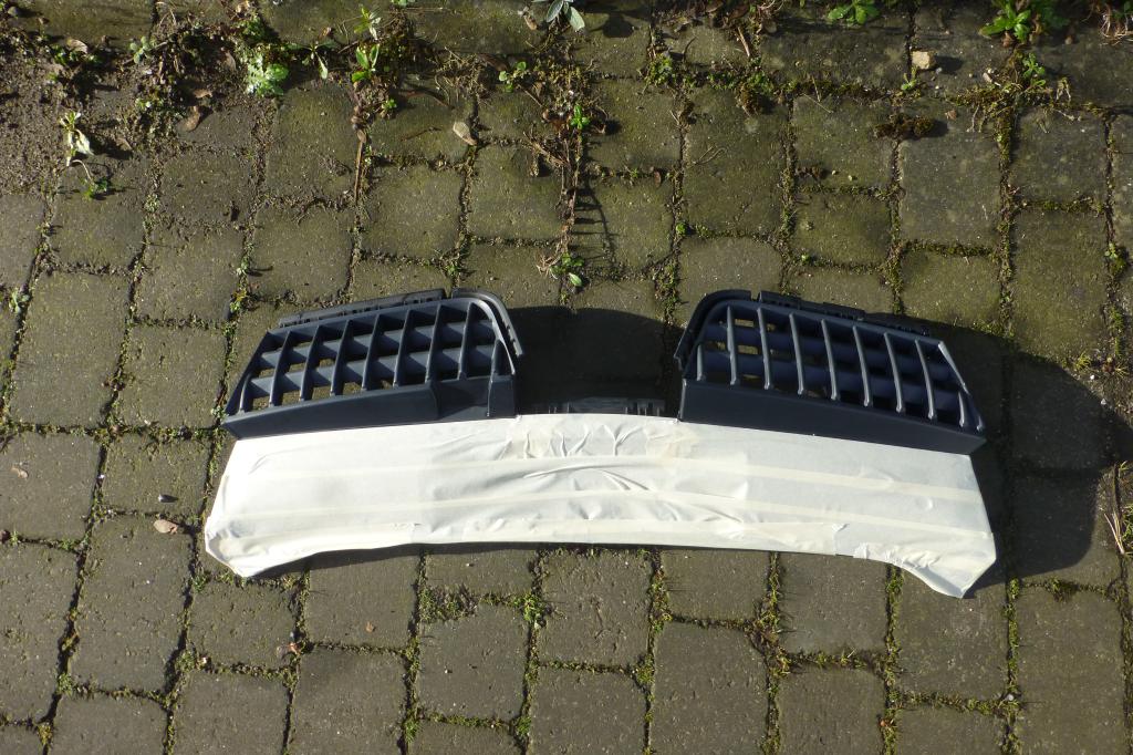

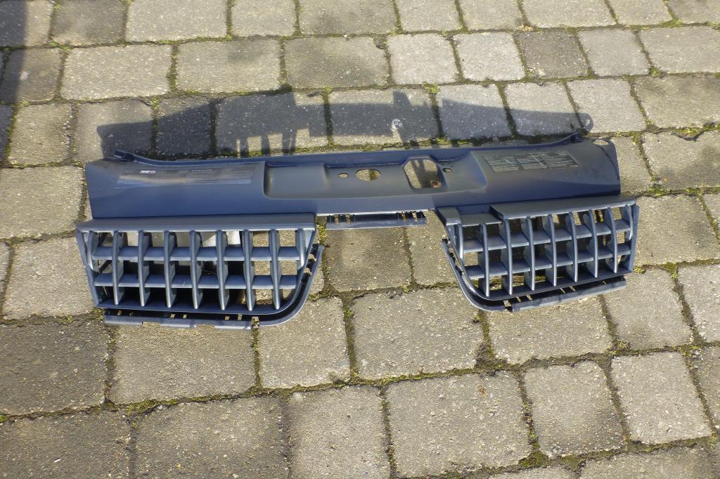

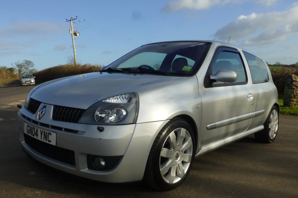

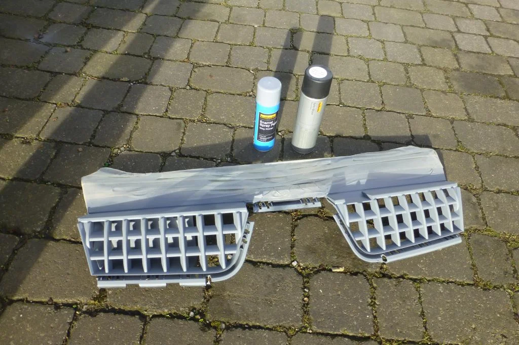

Then it was on to spraying the front grill between the head lights, so off with the front bumper which was pretty straight forward, no where near as difficult as taking off the FRP bumper.
Masked up the grill:

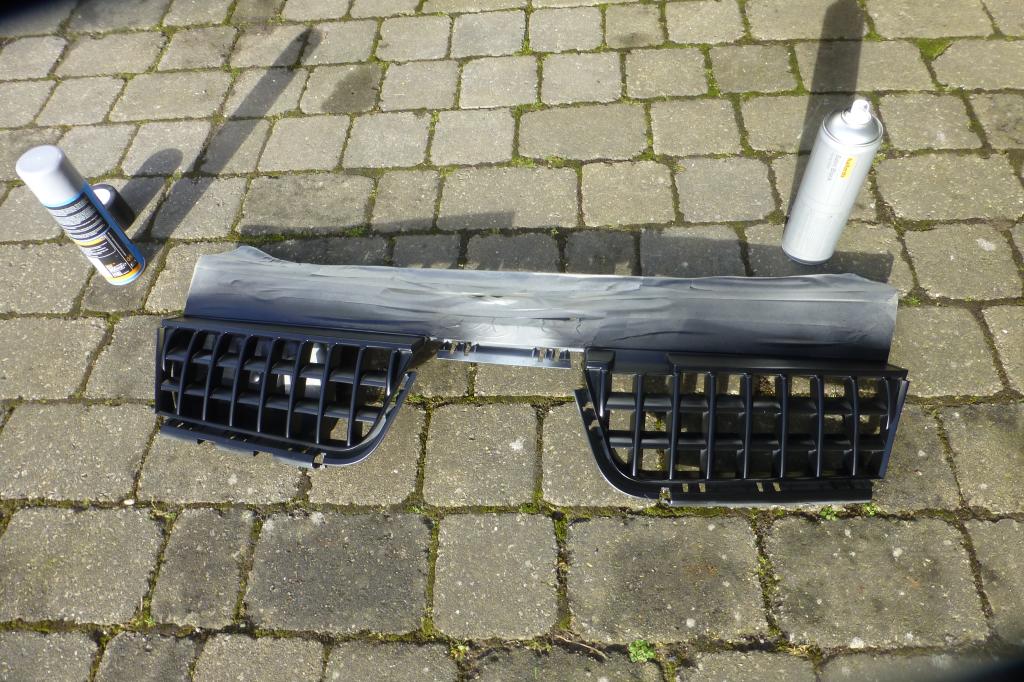

Few layers of Undercoat
Whilst the paint was drying I cleaned up behind the bumper and tweaked around in the engine bay, as well as fitting my new stainless steel bolts (no photos of them but I will upload some at some point) it has freshened the engine bay up a little so worth the few quid that they cost.
I built the paint up slowly over about 7 or 8 layers to make it nice and think as well as making sure no drips occurred.

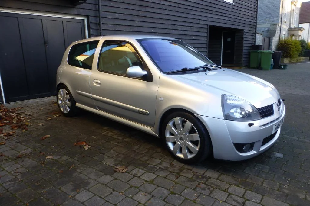

Once refitted I was extremely happy with the results, would strongly recommend the Satin finish as its very OEM,
The lower grill I will be masking up and applying the same paint as back to blacking that grill is so time consuming.

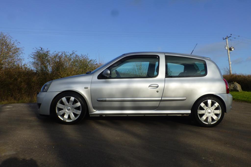

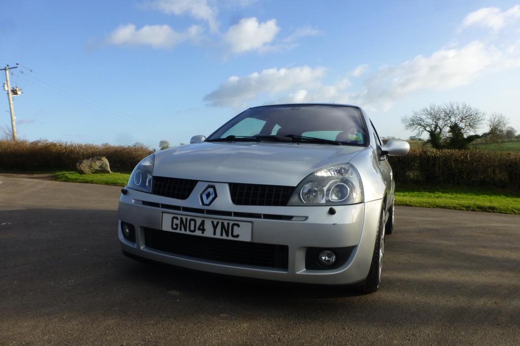

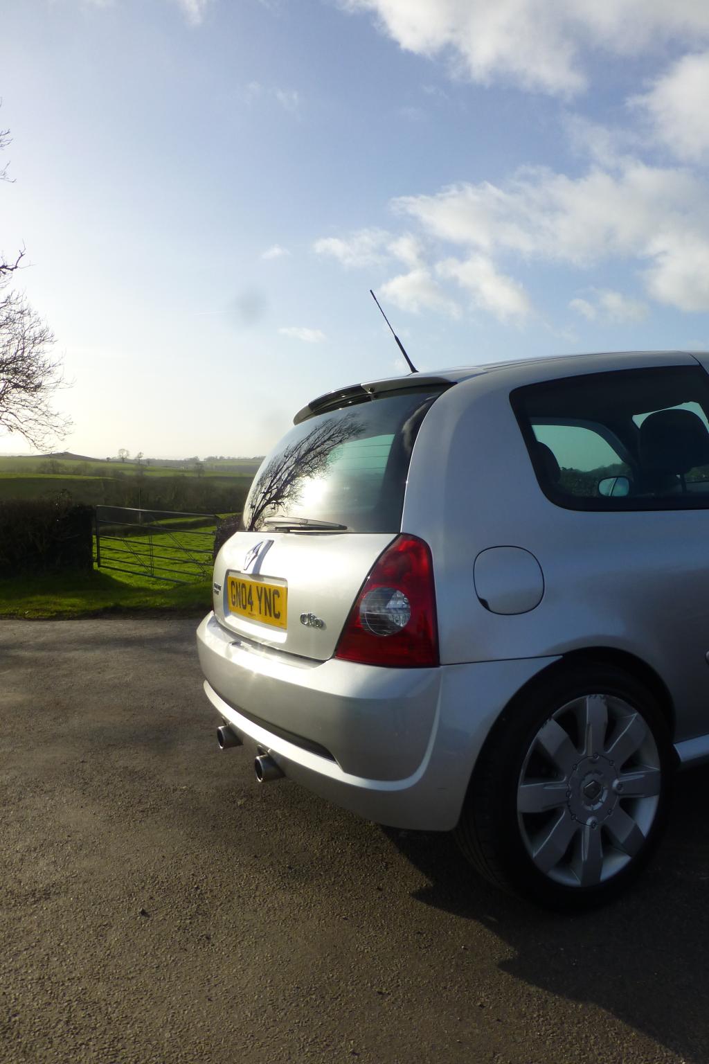

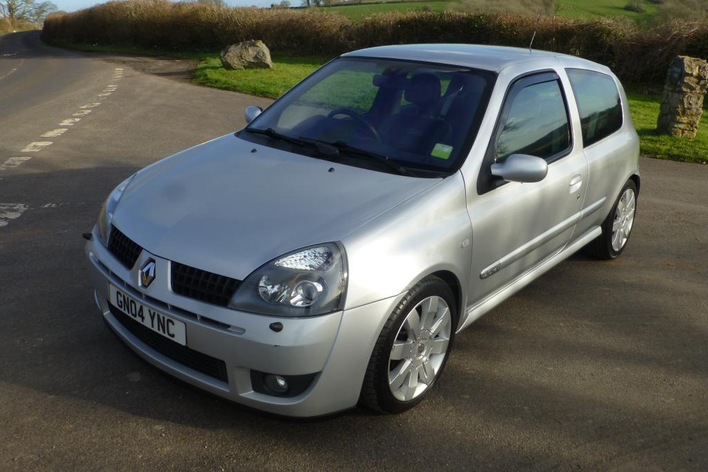

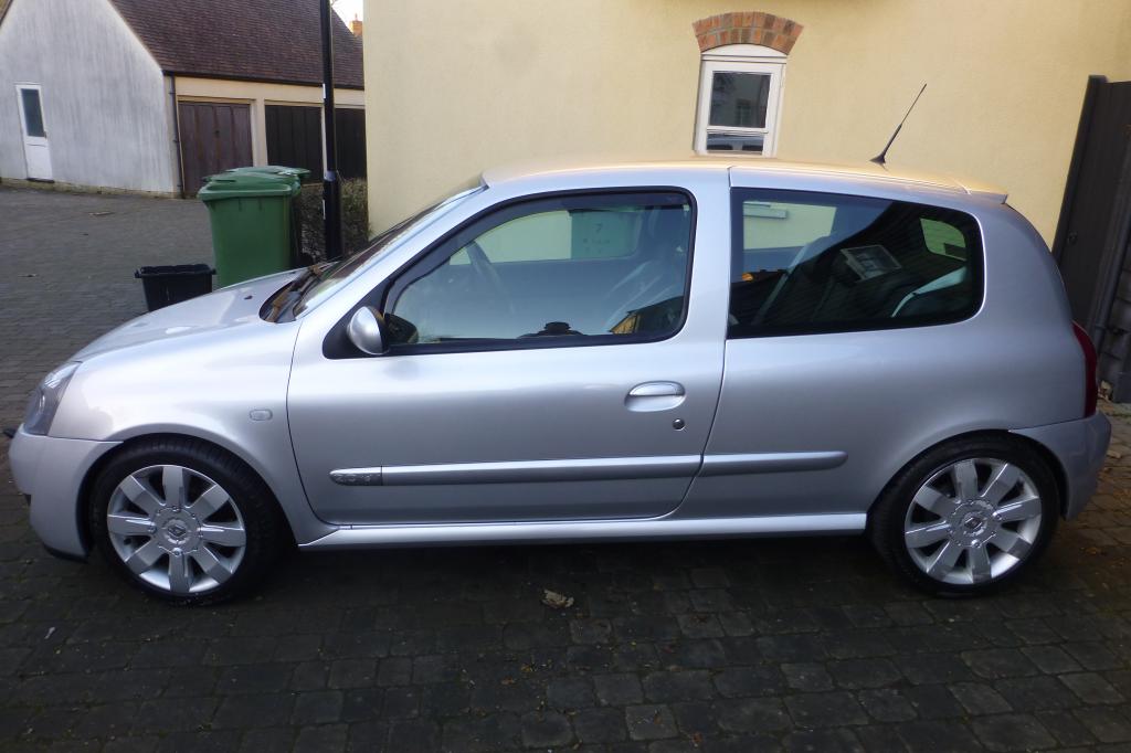

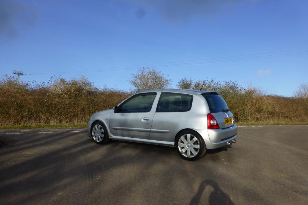

Then I went on a short drive and ended up stopping to take some photos.
Next Thursday I am going to a friends garage to have the rear spacers swapped over to the axle spacers and to have the gear box dog mount replaced.
Hopefully have the Spoiler sprayed in the next 1 to 2 weeks and I think I might have sourced some Trophy Turinis

Looking good mate, the badge looks pretty level tbh, but imo should have been about an inch lower to match the clio badge.
The top grill also pops out, no need to remove the bumper.
