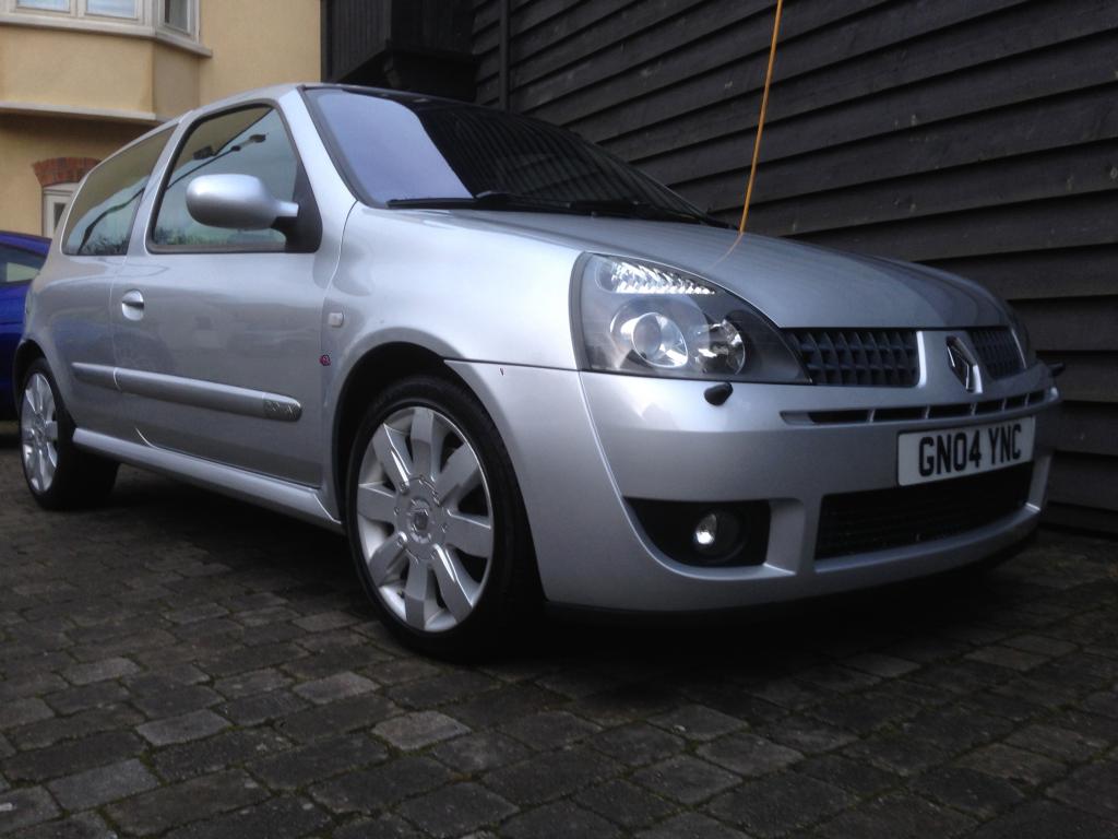

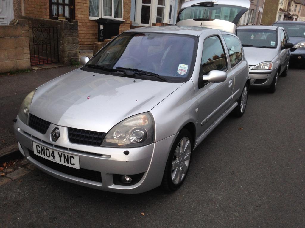

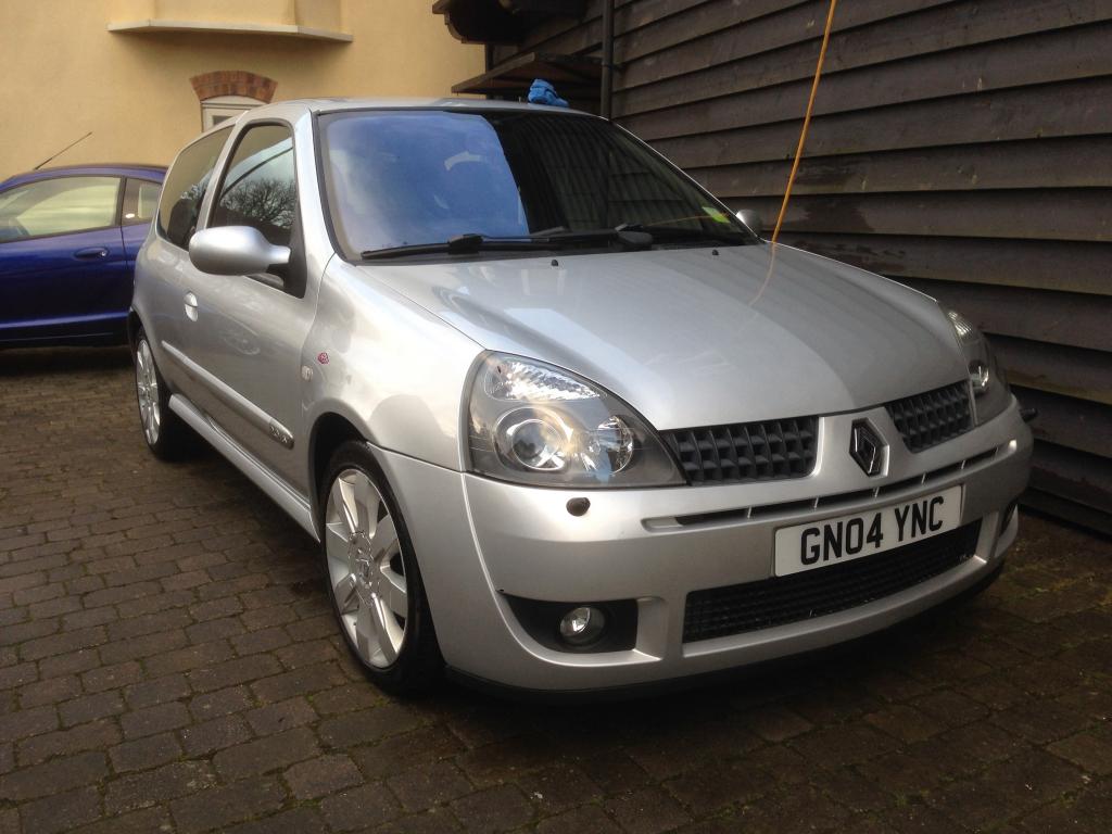

I have been looking for a new car for the other half and decided on a 182, after only a couple weeks of searching I managed to find one listed for £2450 with 90k miles on the clock and listed as in excellent condition.
The issue is that the belts dephaser pulley etc all needed replacing as they where last changed about 30k so I managed to to knock the seller down to £1950, is still rather expensive, however the condition of the car was to good to miss.
I am the 3rd owner and the car came with plenty of history, the service book was missing with the car, however its has receipts for service work carried out ever year or ever 10,000 miles from Renault.
Recent worked included replacement exhaust system, new discs and pads all round and new rear shocks. Its also worth pointing out that its a standard car and its clear that when ever any work was required it had ben carried out.

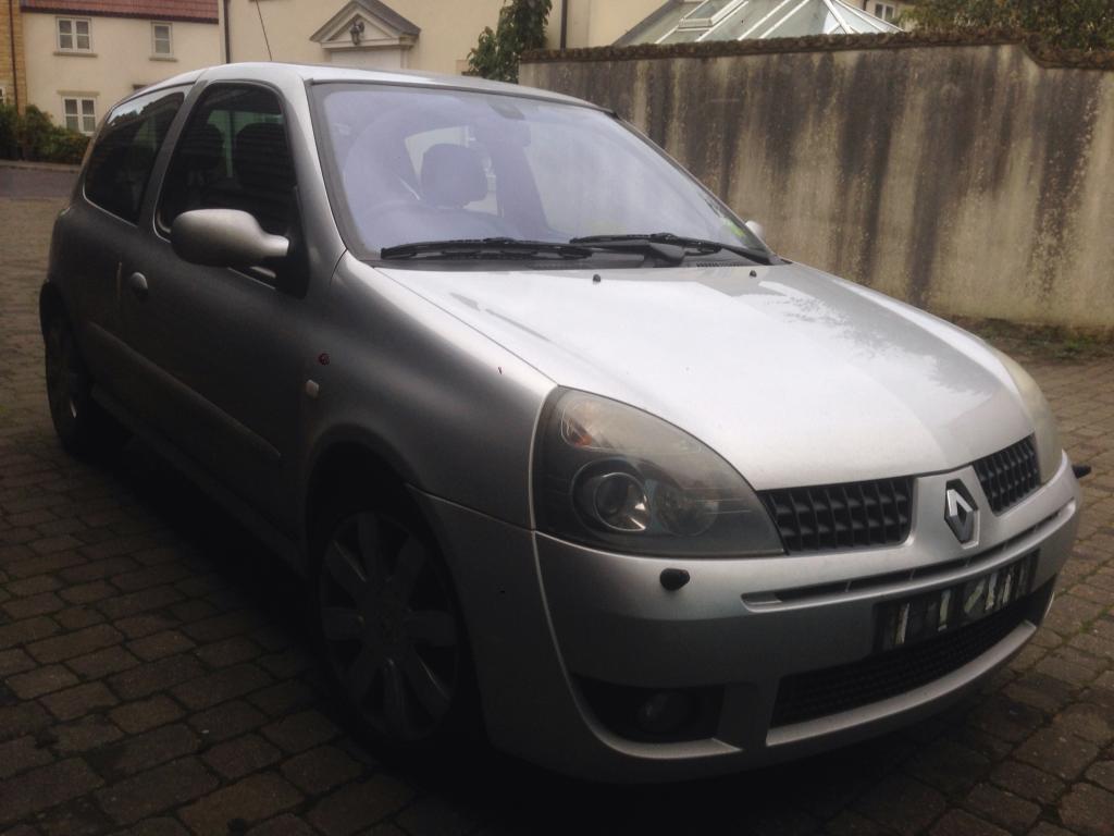

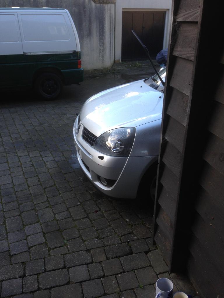

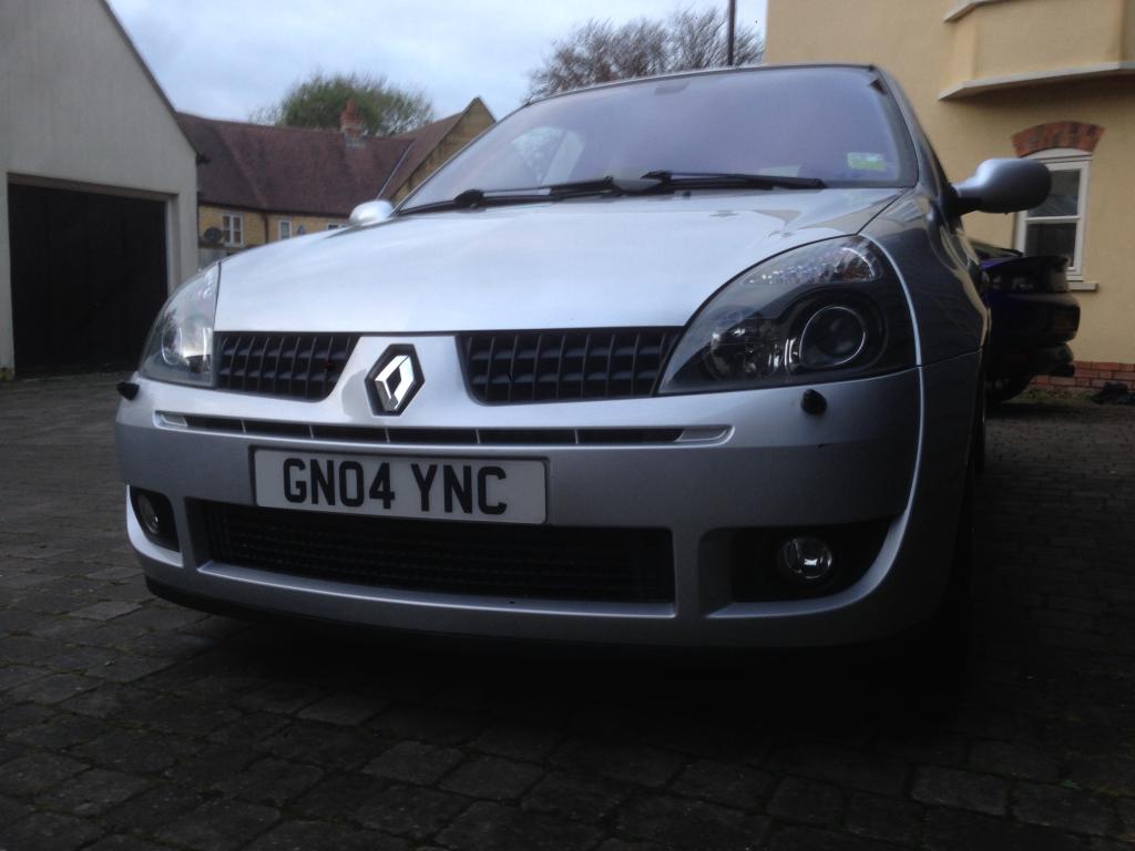

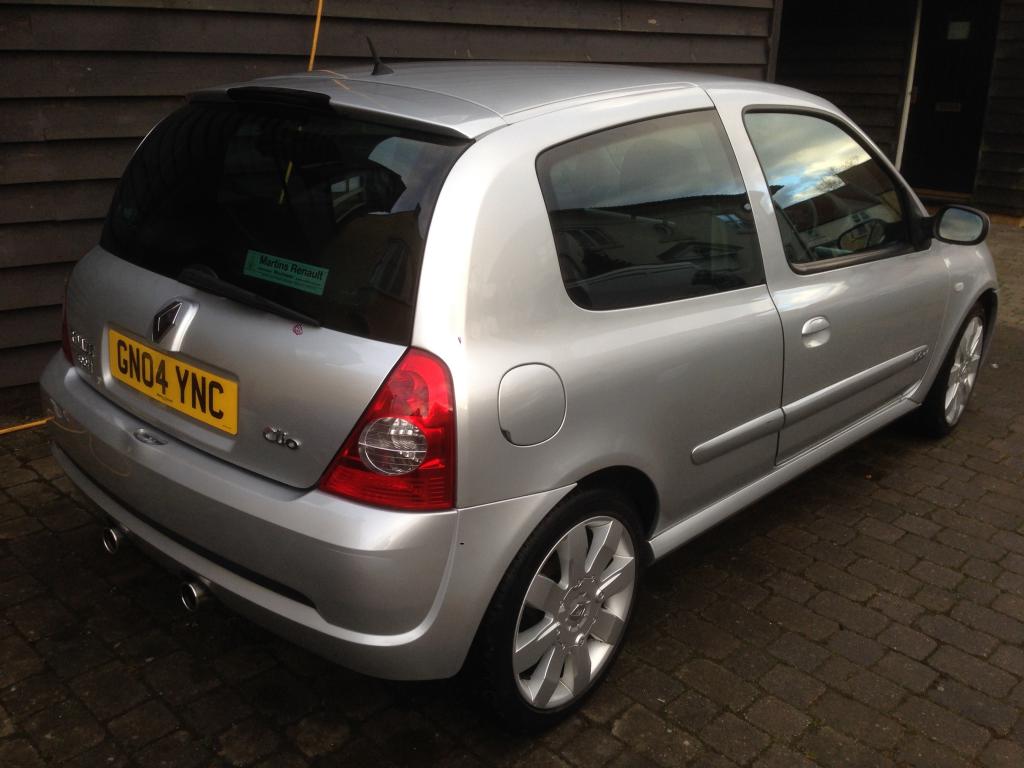

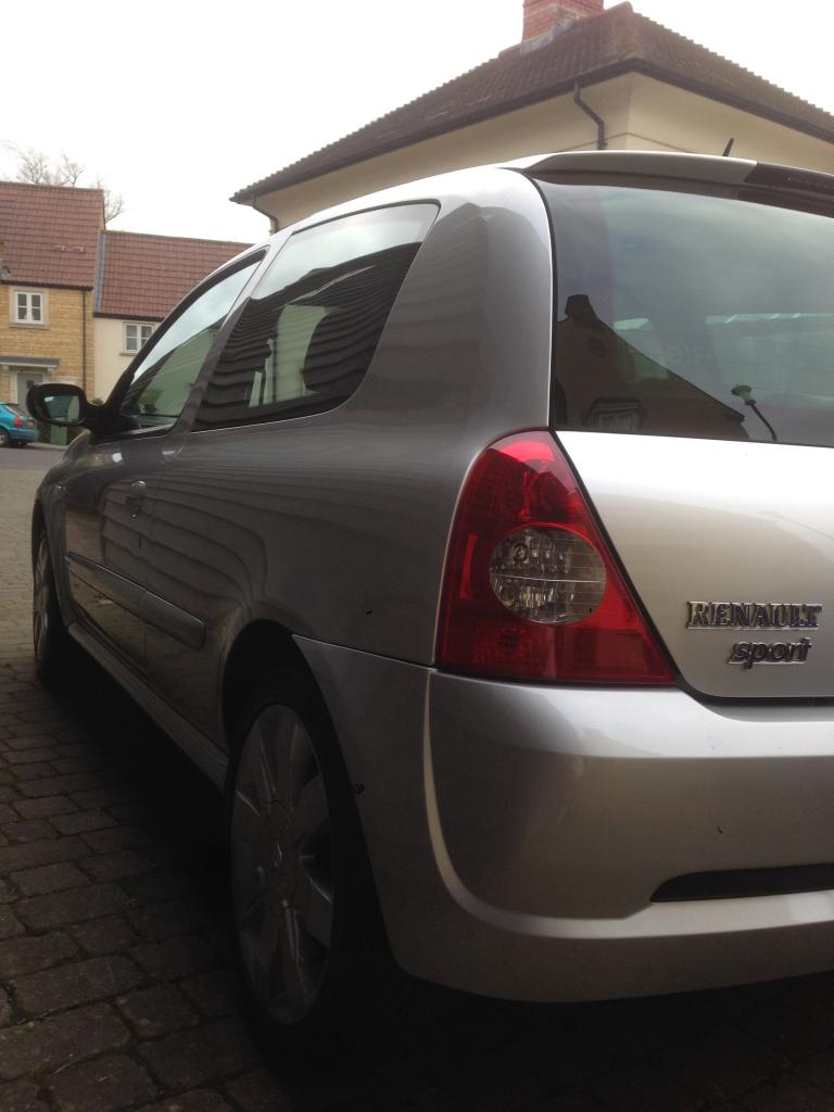

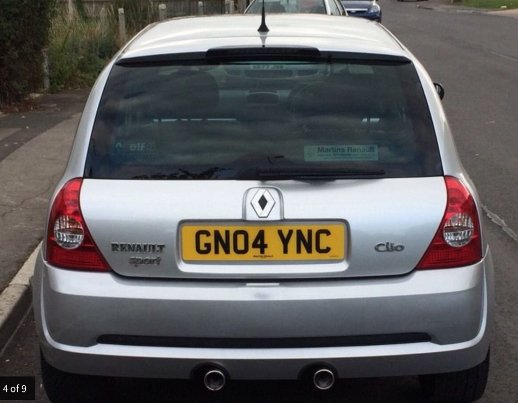

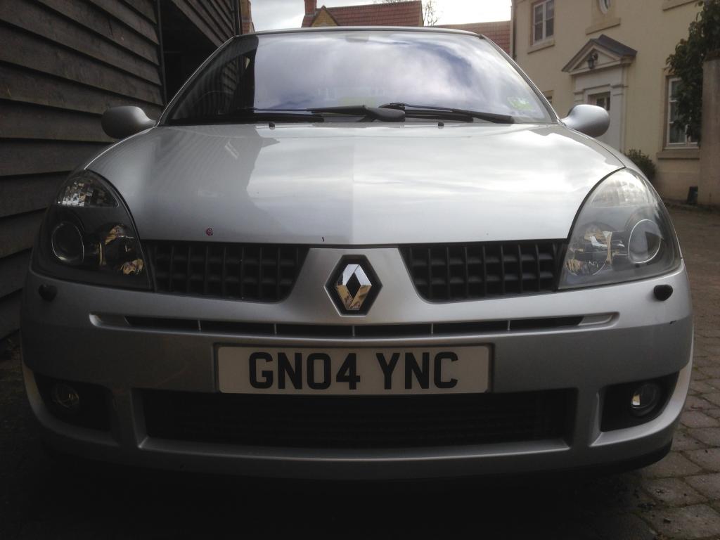

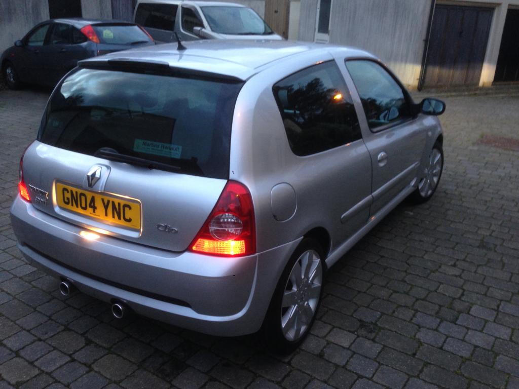

Only a couple of images of the car so far:
(Exhaust has slipped out the hanger so needs re-aligning)

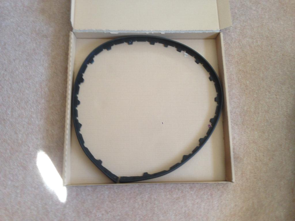

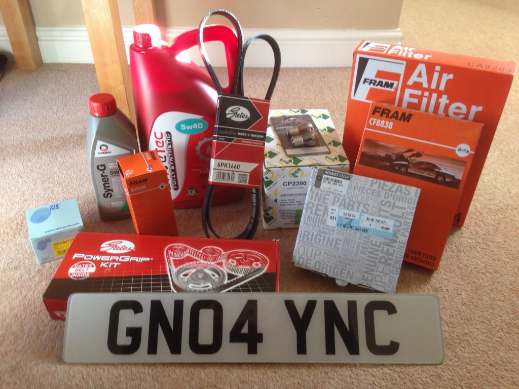

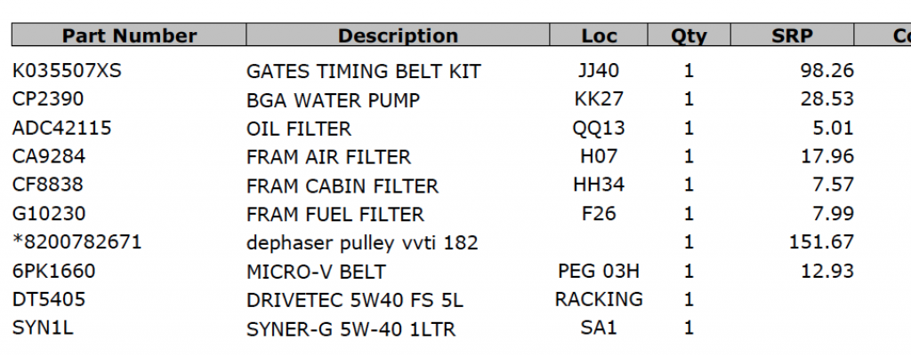

I ordered all the parts in that are required:

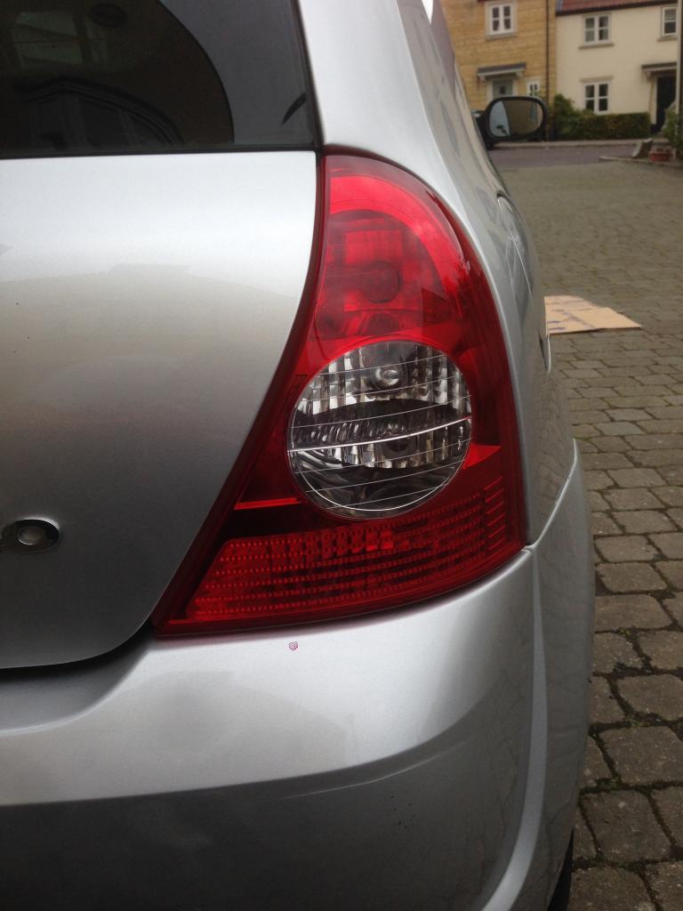

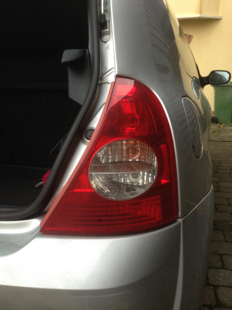

In addition to the service parts I have also purchased two lots of Silver Tek bulbs to replace the orange indicator bulbs:

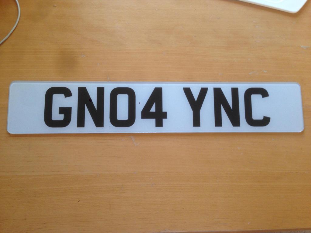

Also the small registration plate (90mm Depth) to sit flush on the front of the car:

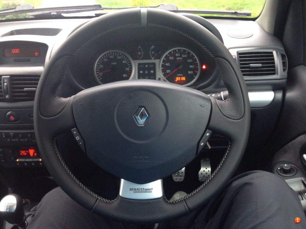

The steering wheel is in really good condition but in the long term I will be looking to having it refurbished, picture below is of the finish that I will be going for (Snappy a forum user I am led to believe who everyone recommends)

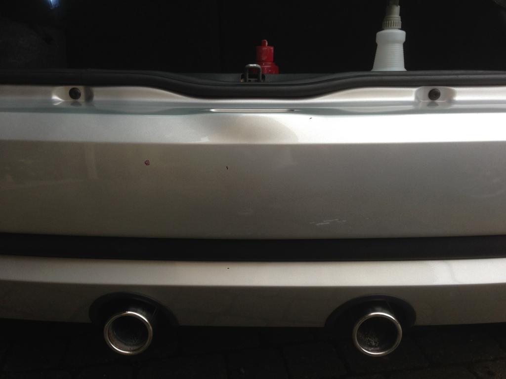

Respray door protector on drivers side as slight mark
Touch up small mark on front bumper

Whats up with the one I have got? Surely makes no difference? This was the message I got from the specialist
"It would be best to grab an auxiliary drive belt as well. Part number 6PK1663 or equivalent."
Sure he would have said Renault one if its that important.
Are you going to replace the kit or just the belt?
I can't see to clear on my phone mate, im guessing that the box has a water pump in?
How old is the auxiliary belt kit on the car?
I'm only saying as if the aux belt fails then it will take the cambelt out smashing the engine to bit's.
A full aux belt kit from Adam @ Wolverhampton Renault on here is about £55 so hardly worth risking using the old aux belt tensioner.
Also the idle roller can sieze up causing problem's.
Im also sure that it's not recommended to re tension a used tensioner.
Gates timing belt kit is fine mate, I would strongly advise replacing the aux belt kit.
I would hate to see all you're hard work and money go bang all for the sake of £55 pounds. :)

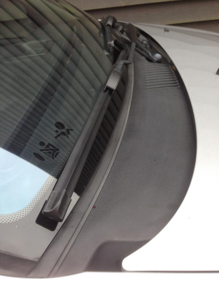

Trying these wipers as well, might be to cheap, but worth a punt at £5
http://www.ebay.co.uk/itm/21-21-Aer...o|Cars+Type:2.0+16V+Sport&hash=item4ab235738f

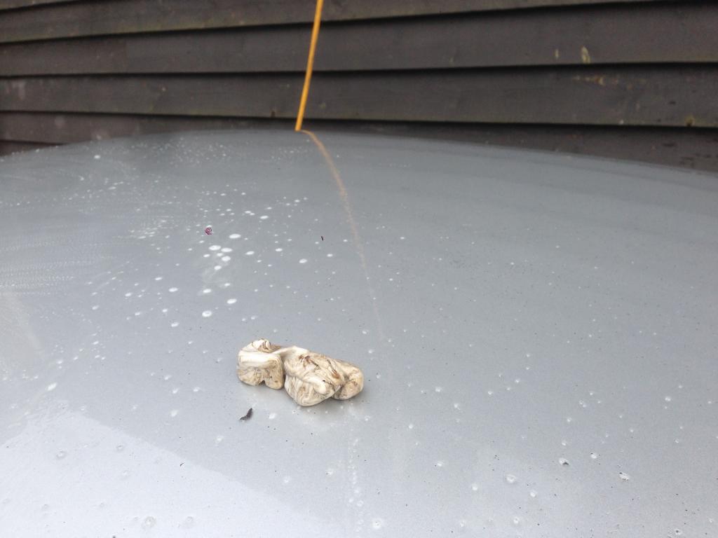

Frustrating all the photos where taken on my phone and have the same purple mark showing in the same place.
Anyway I have plenty of images to share and I will comment on each of the main stages:

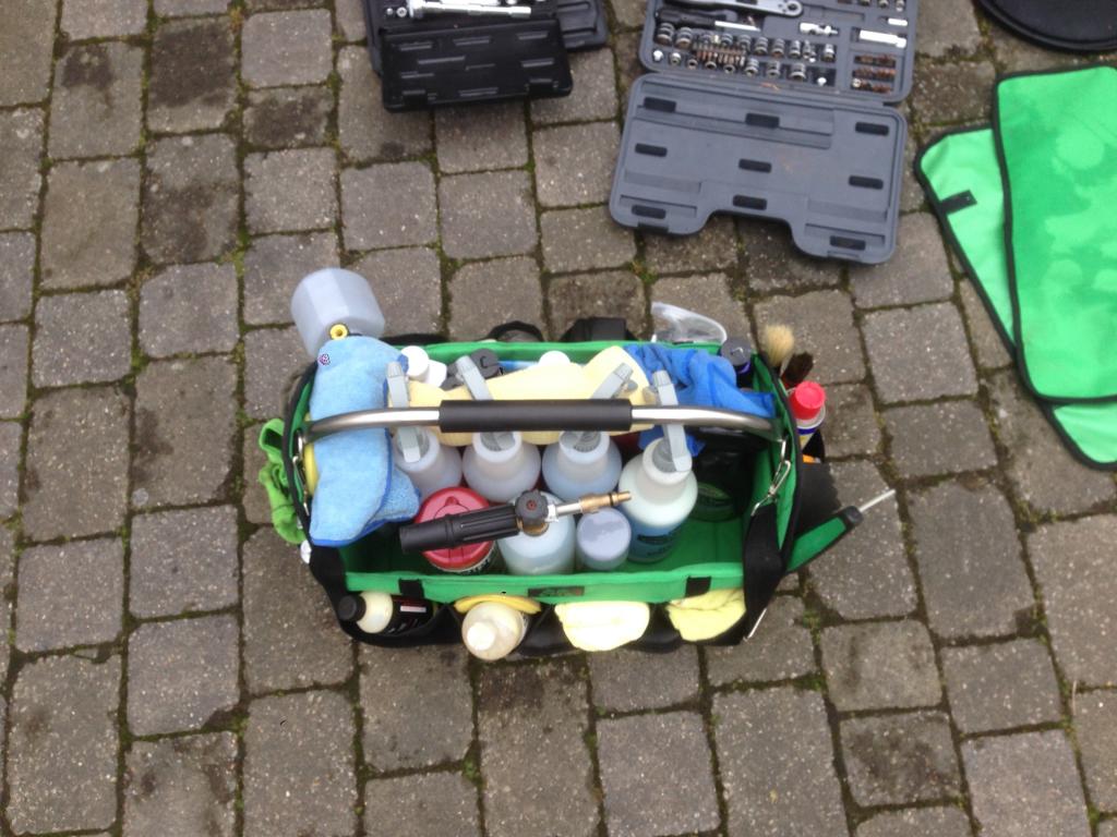

Some of the kit at the ready:

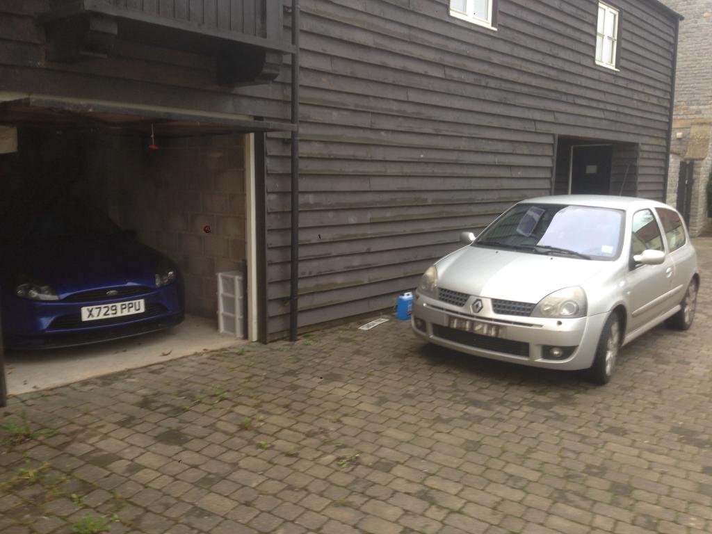

The mess I started with:

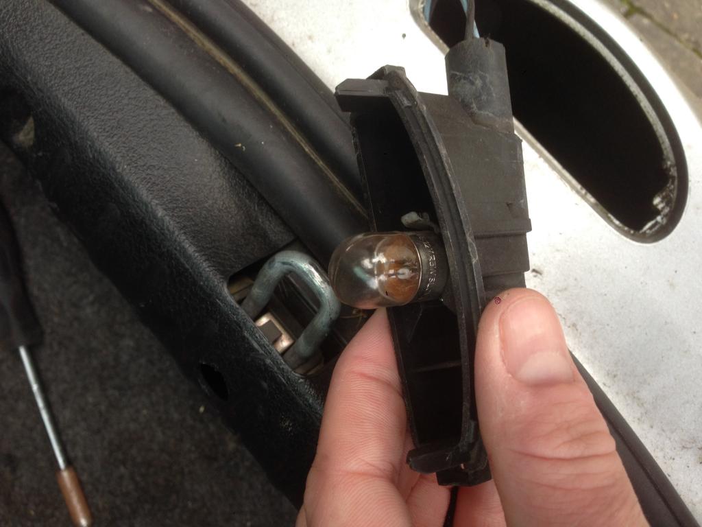

1st up:
Silver Tek indicator bulbs:
Before:
After:

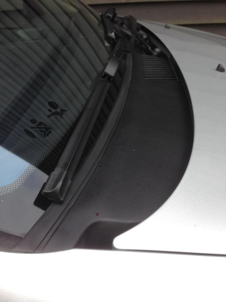

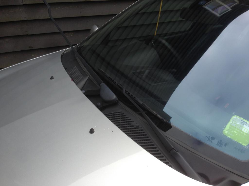

Aero wipers
Before:
After:

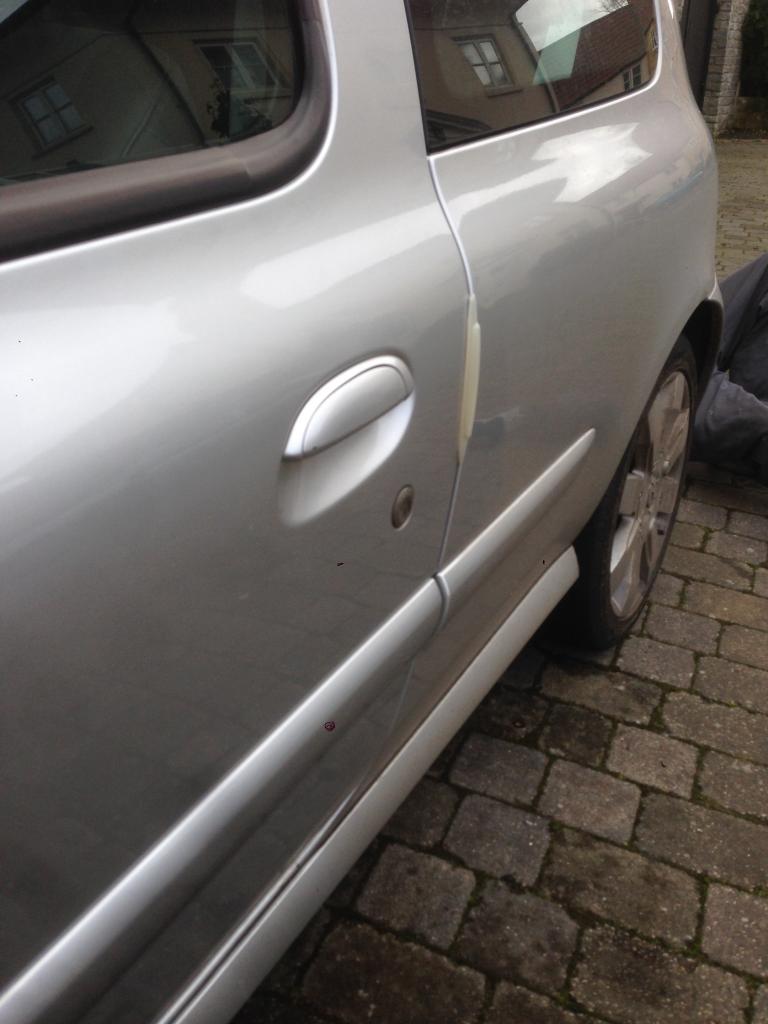

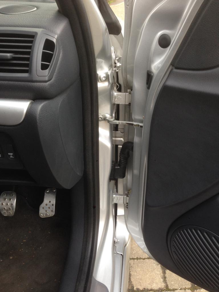

Removed these horrible protectors from the doors:

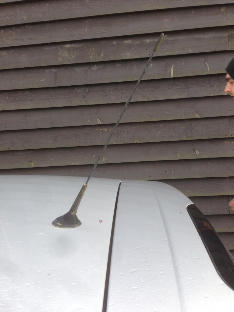

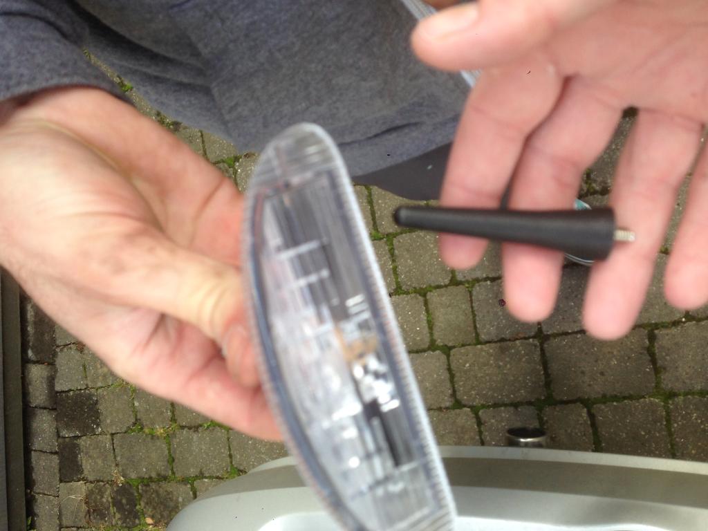

Changed the aerial:
Old:
New:
If i am honest I am disappointed in the ariel, where it threads on to the car its not flush, :/ I will be seeing if there is another option otherwise I will replace it with a standard one again. Its only a little lip as can been seen in the image but I’m not 100% happy with it.

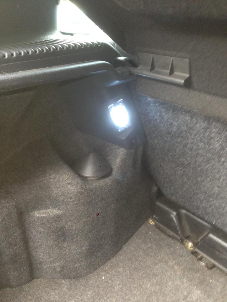

Replaced the interior boot light for one of the new LED ones:

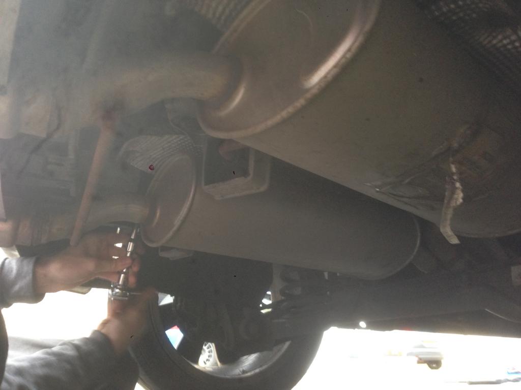

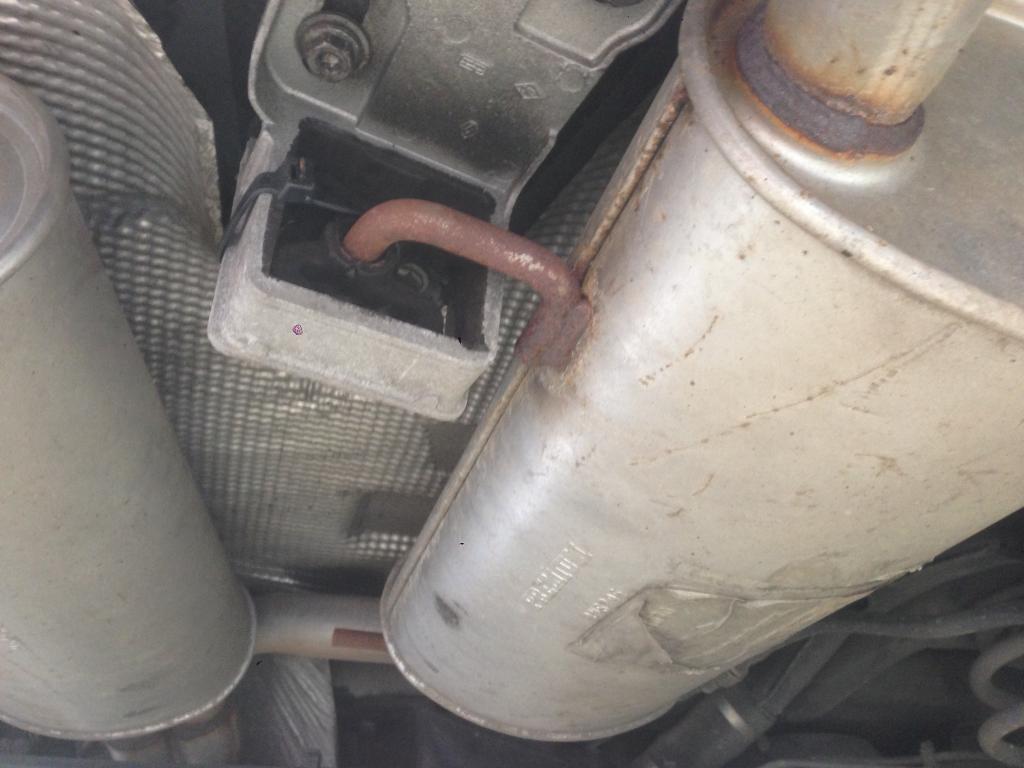

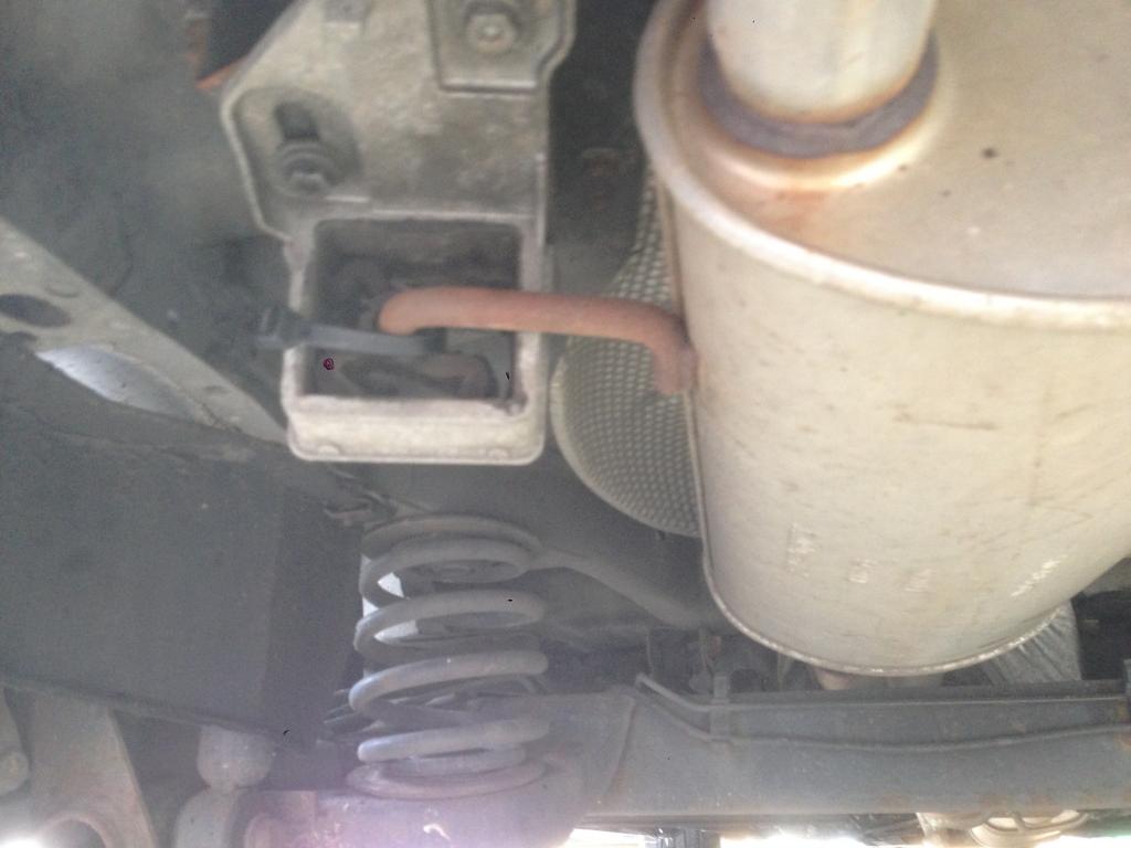

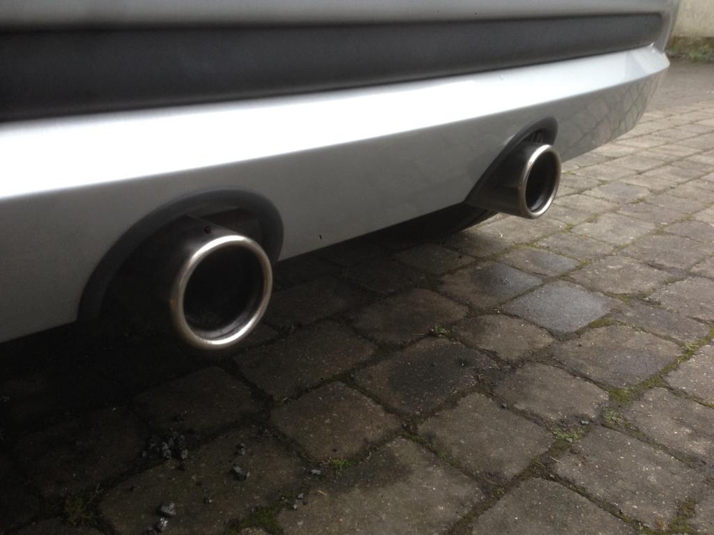

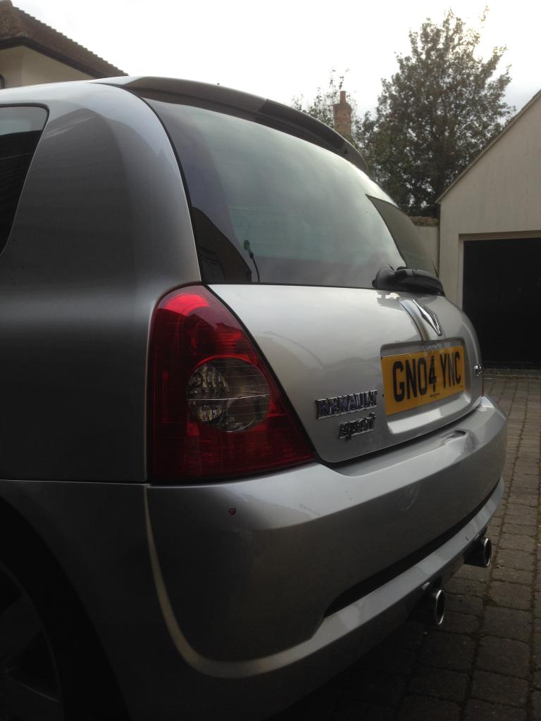

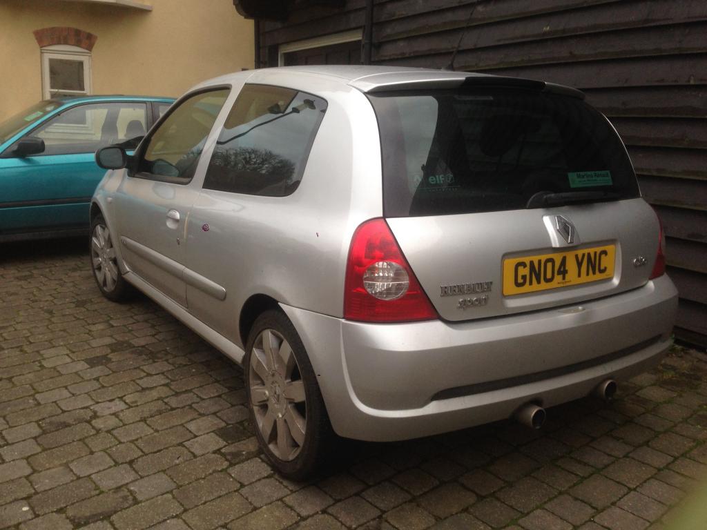

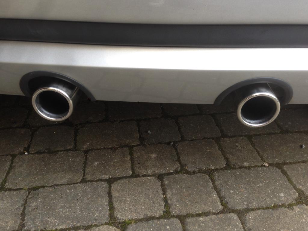

Next up rehang the exhaust:
Before:
During:
We placed the rear bar back in the hanger, however it was still not central, we then undid the centre section bolts to allow us to twist the system which brought the two pipes in level with one another.
We stil had a issue that the pipes where not central, so out came the heavy duty zip tyres just to pul the brackets over slightly.
The results:

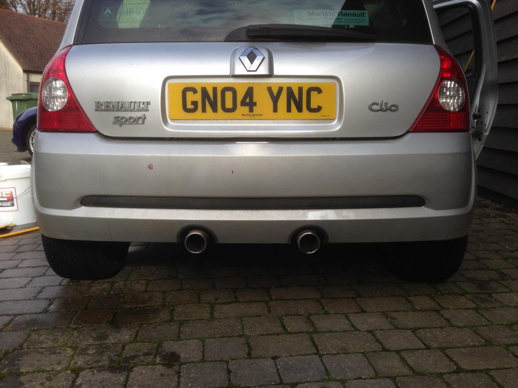

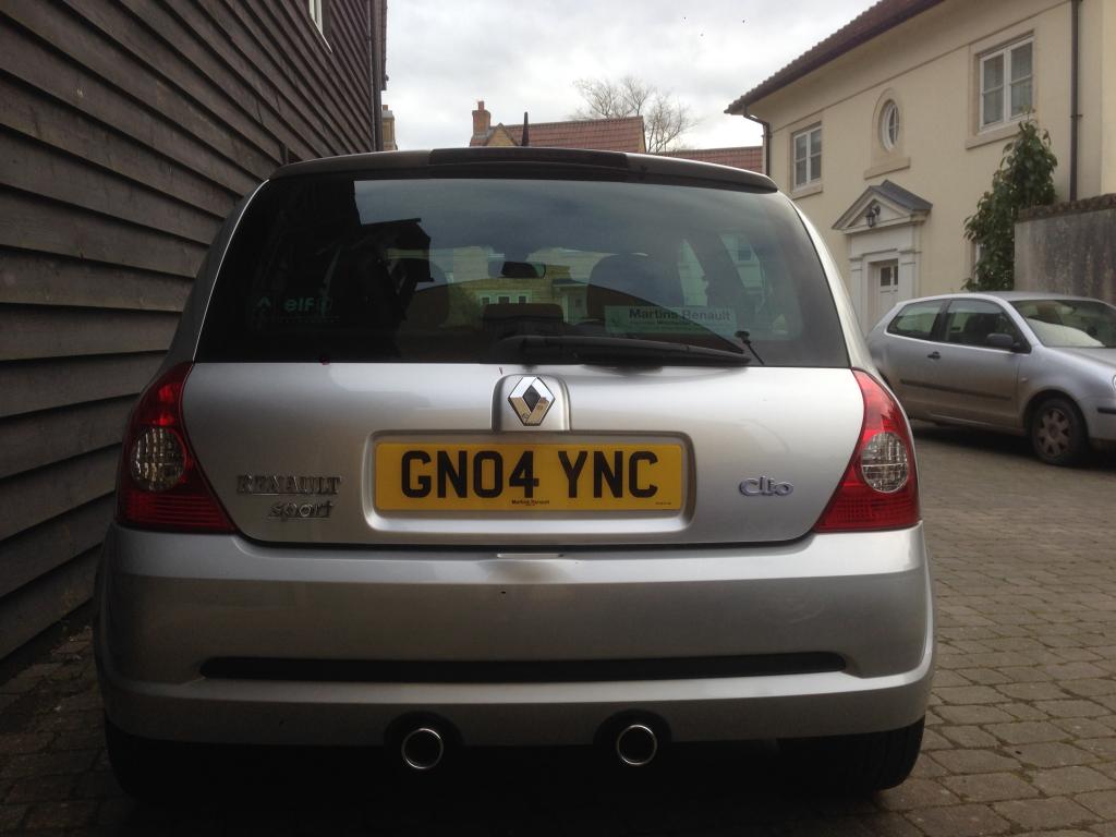

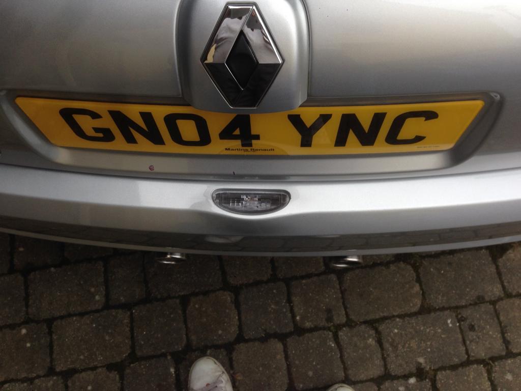

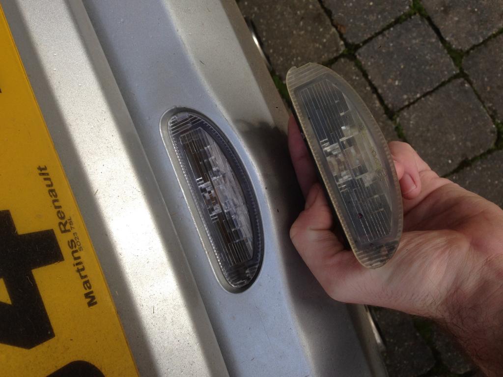

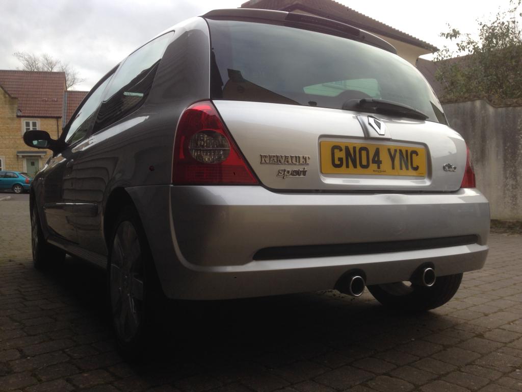

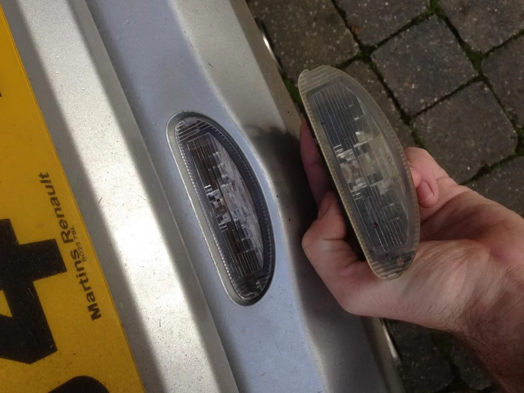

On to replacing the rear registration lamp holder, small but HUGE difference:

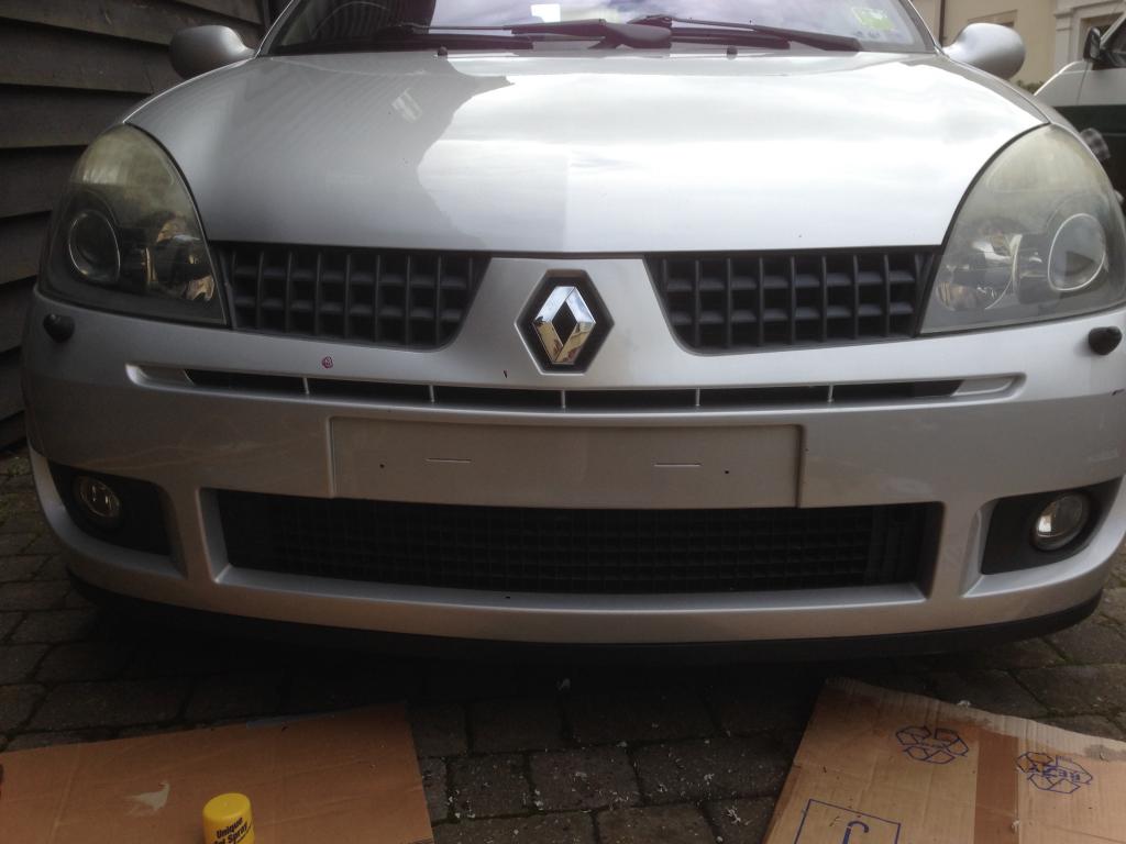

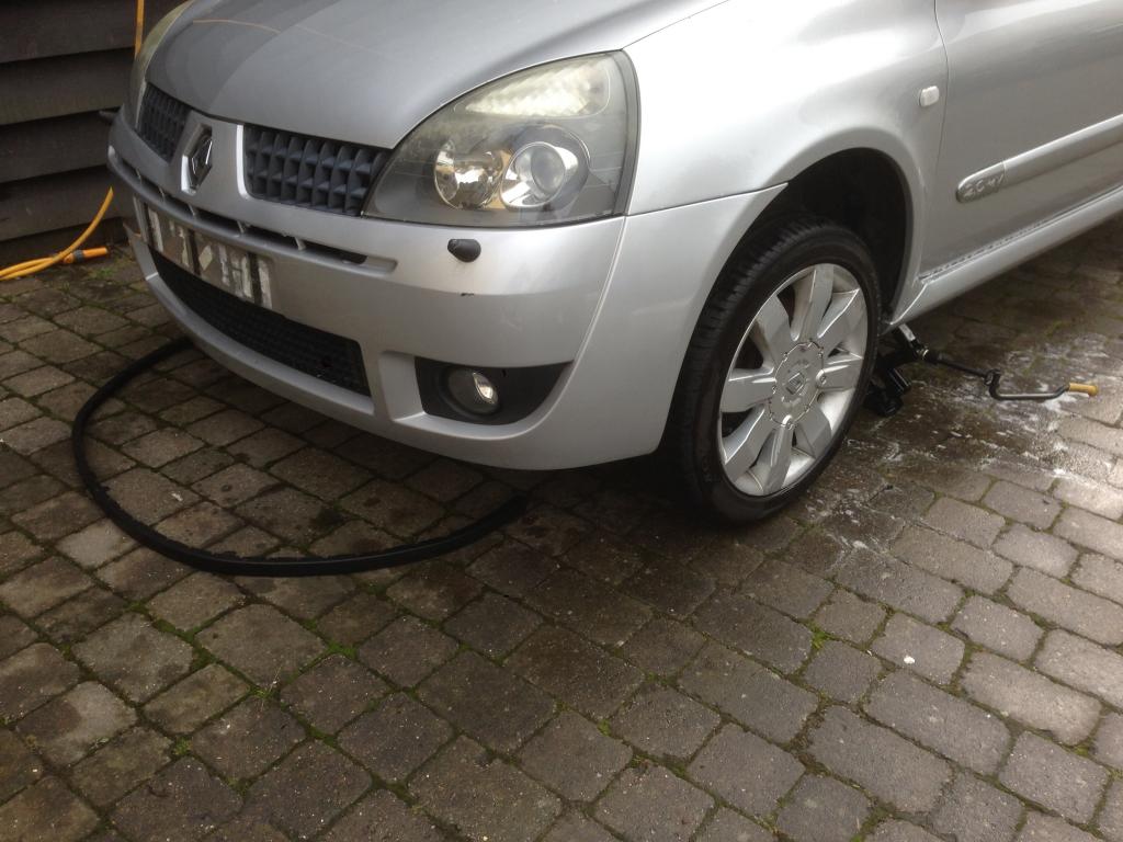

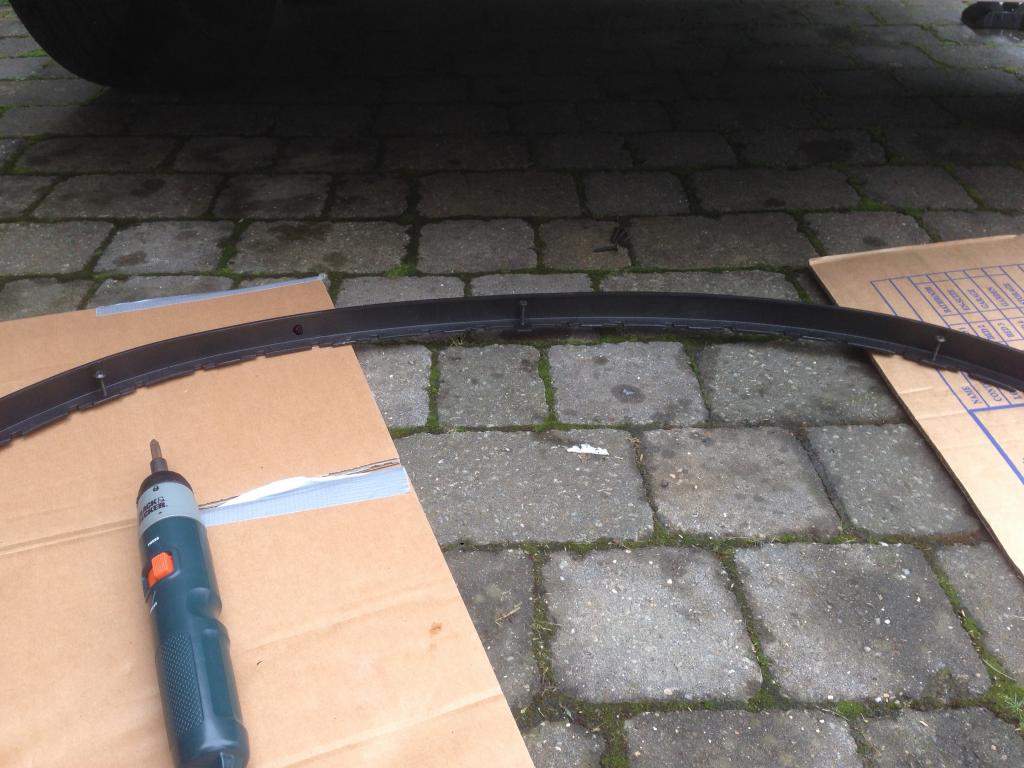

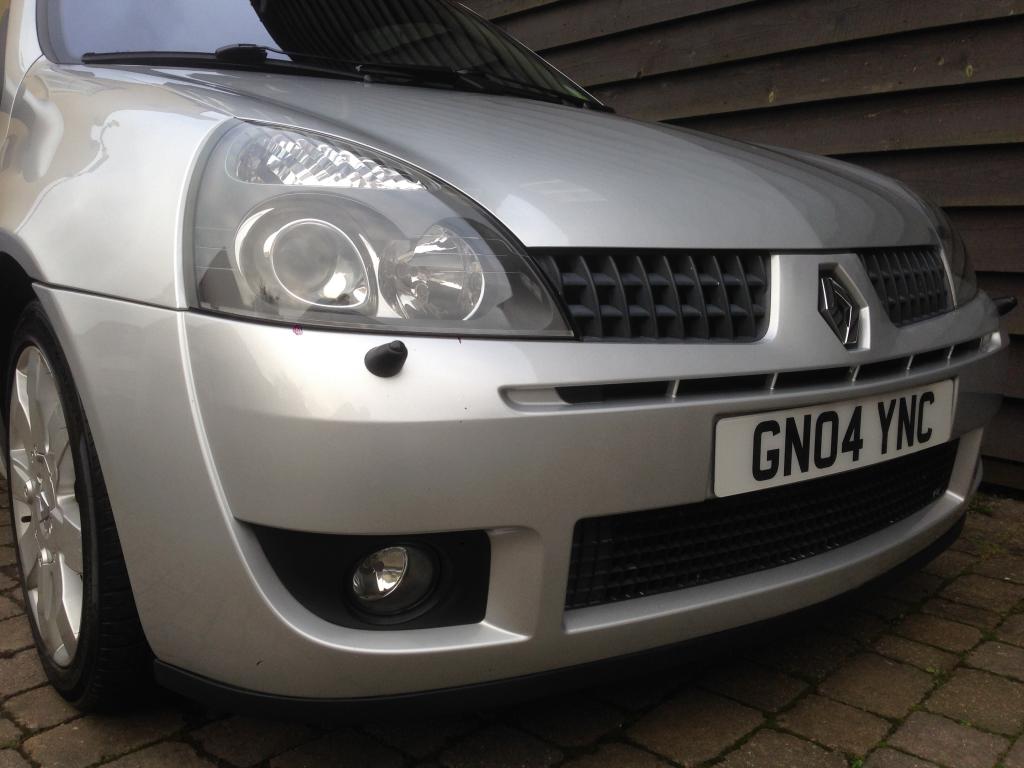

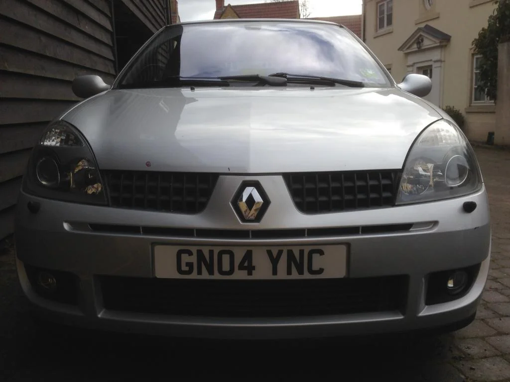

Jacked the car up ready to fit the splitter and registration plate:
Cleaned up behind the old plate, plenty of double sided tape marks etc
Fitting the splitter, we marked out the centre of the splitter and the centre of the bumper, then we partially screwed in three screws to help when lying under the car, using an electric screwdriver is strongly advised at this stage.
Registration plate and splitter all fitted:
I fitted the registration plate with the heavy duty velcrow as I did with my FRP:

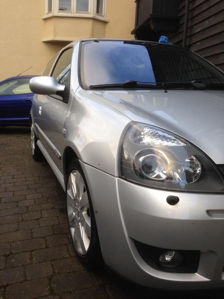

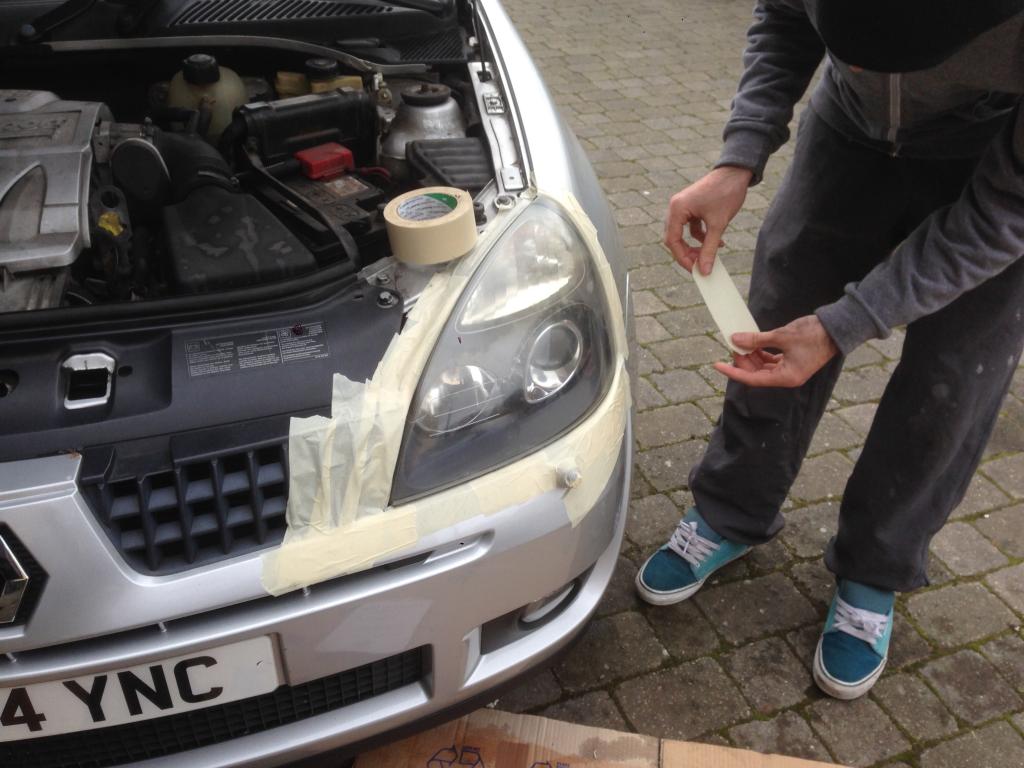

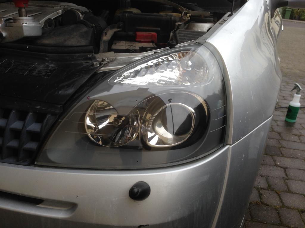

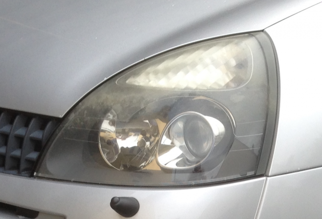

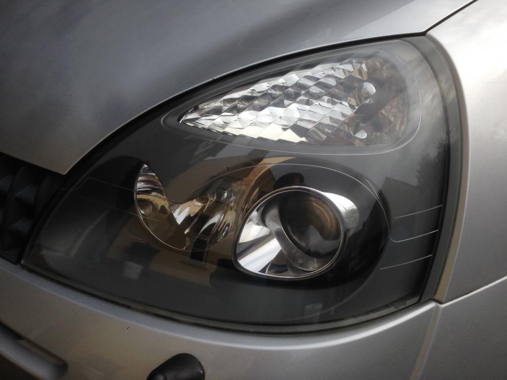

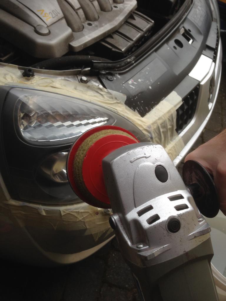

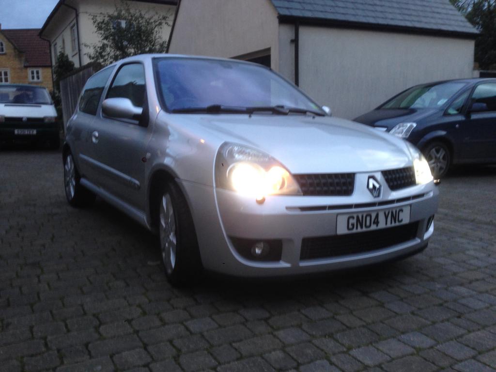

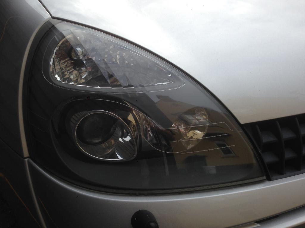

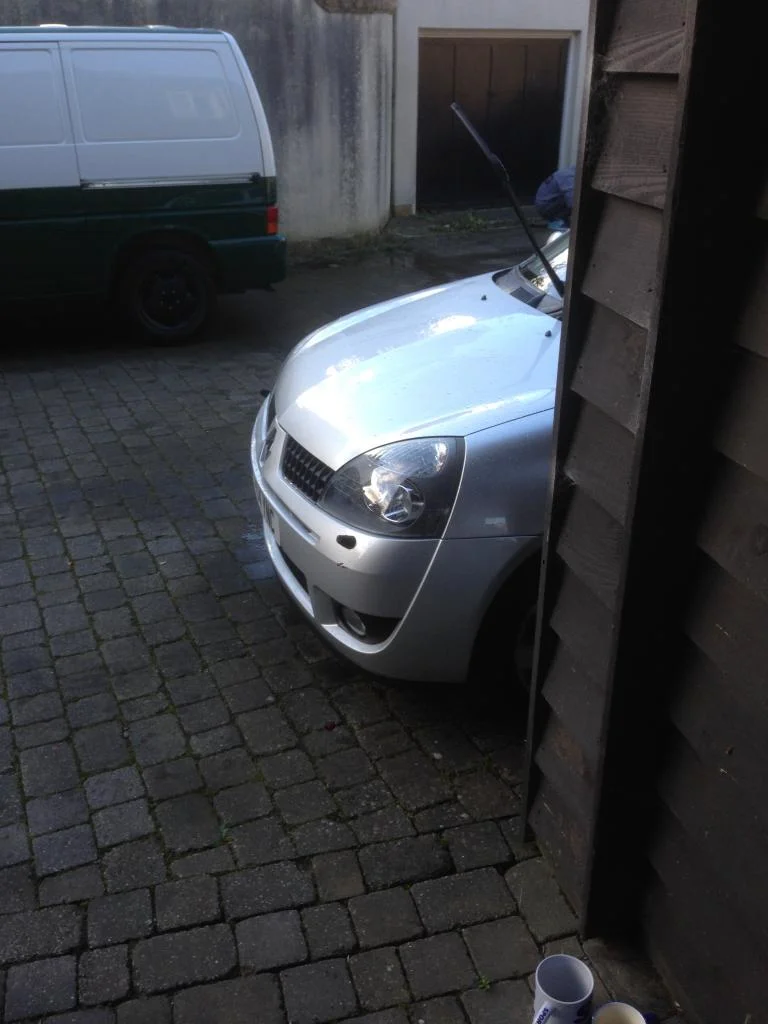

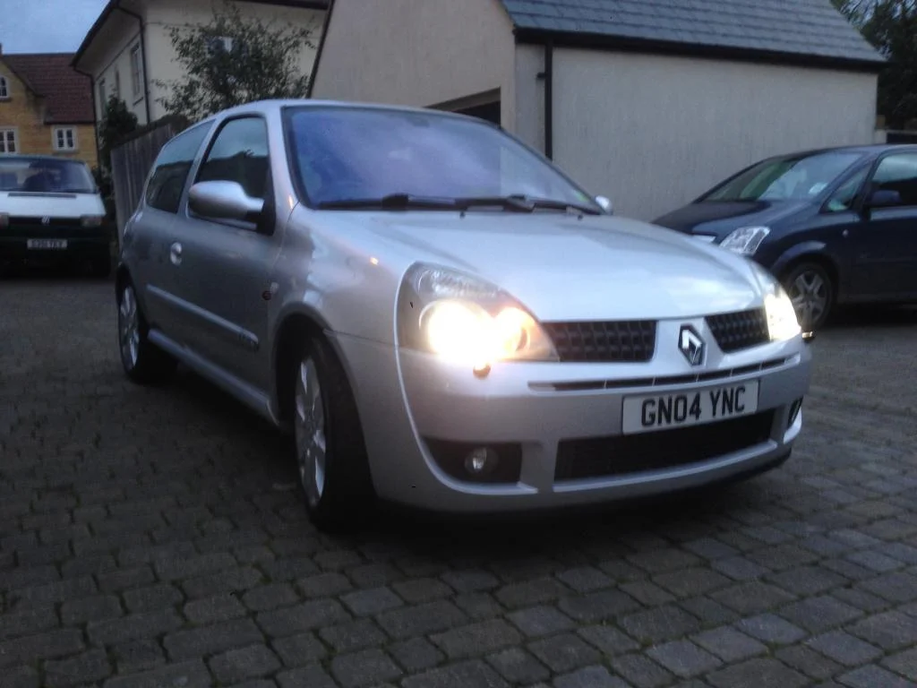

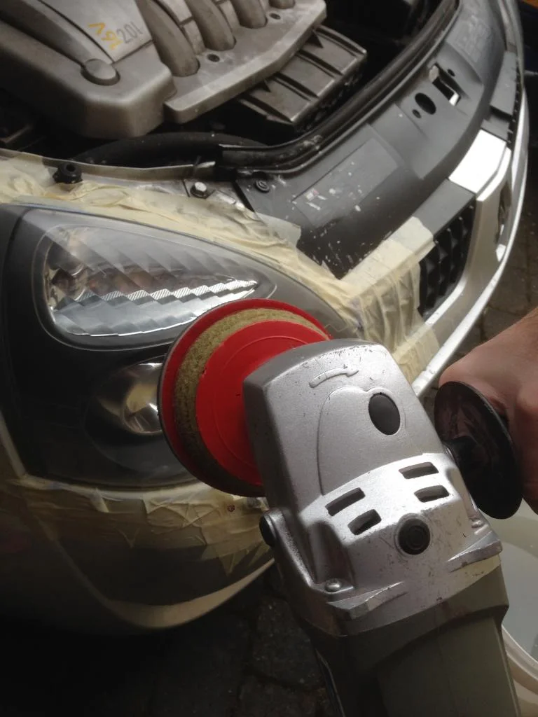

Headlights next on the agenda:
Few before photos, it pretty hard to see how bad they where before we started:

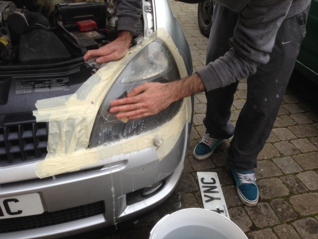

Masked up and ready to be attacked with the 1200 grit:
after about 20 to 30 mins we then set about the lamps using the mop:
Using the following product:
After a couple of passes, the head lights came up like new, couldn’t believe the difference:
You’ll also notice at this point we changed the orange indicator bulb to the silver tek ones.

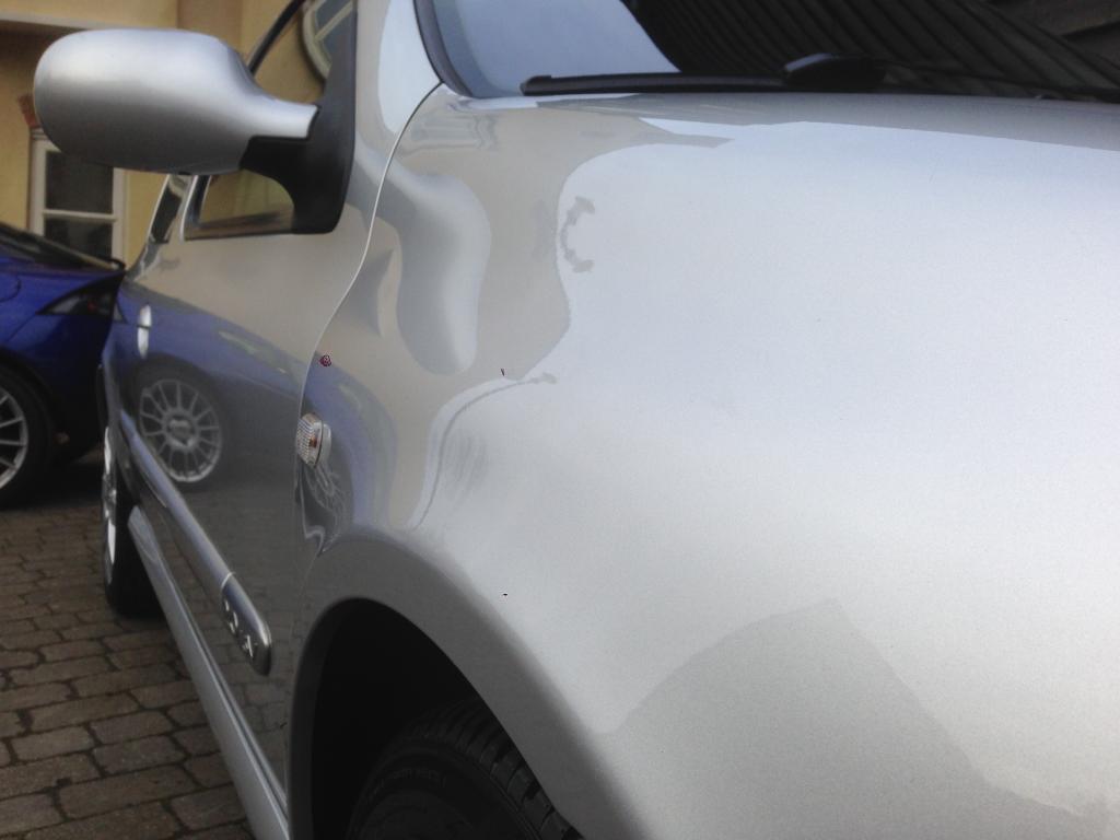

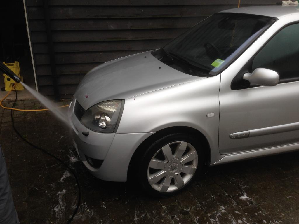

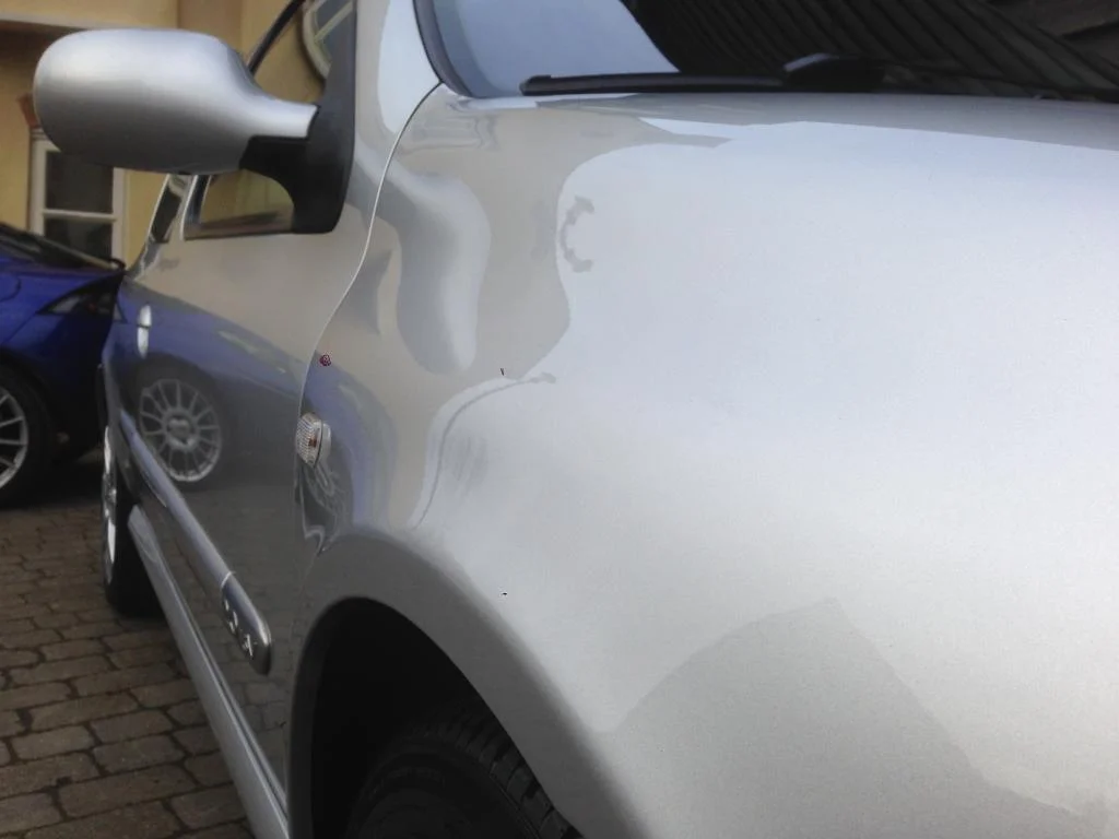

It was then on to washing the car and then the dreaded task of clay barring, I decided to attack one panel at a time, good wash, followed by fall out product, tar removal then a clay bar until all marks, stains tar etc had been removed, this needless to say took hours especially on the lower sections of the car and on the roof.

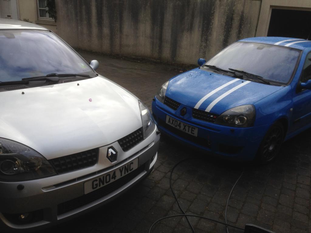

Whilst I was carrying out the individual panel wash, Ollie then set about washing his lovely looking 182
Hard to see the stains in the photos:
Random during shot:
So at the end of day one, car cleaned and the first Meguires stage 1 product used, leaving the following finish:

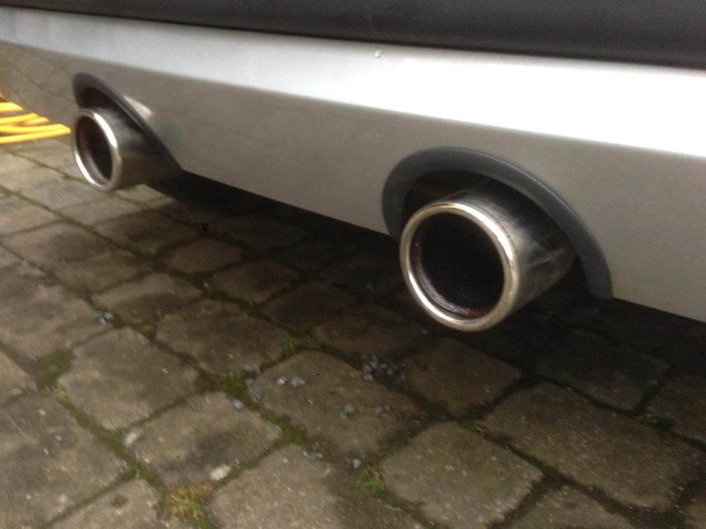

Last thing before putting away I went over the exhaust tips with some Meguires metal polish:

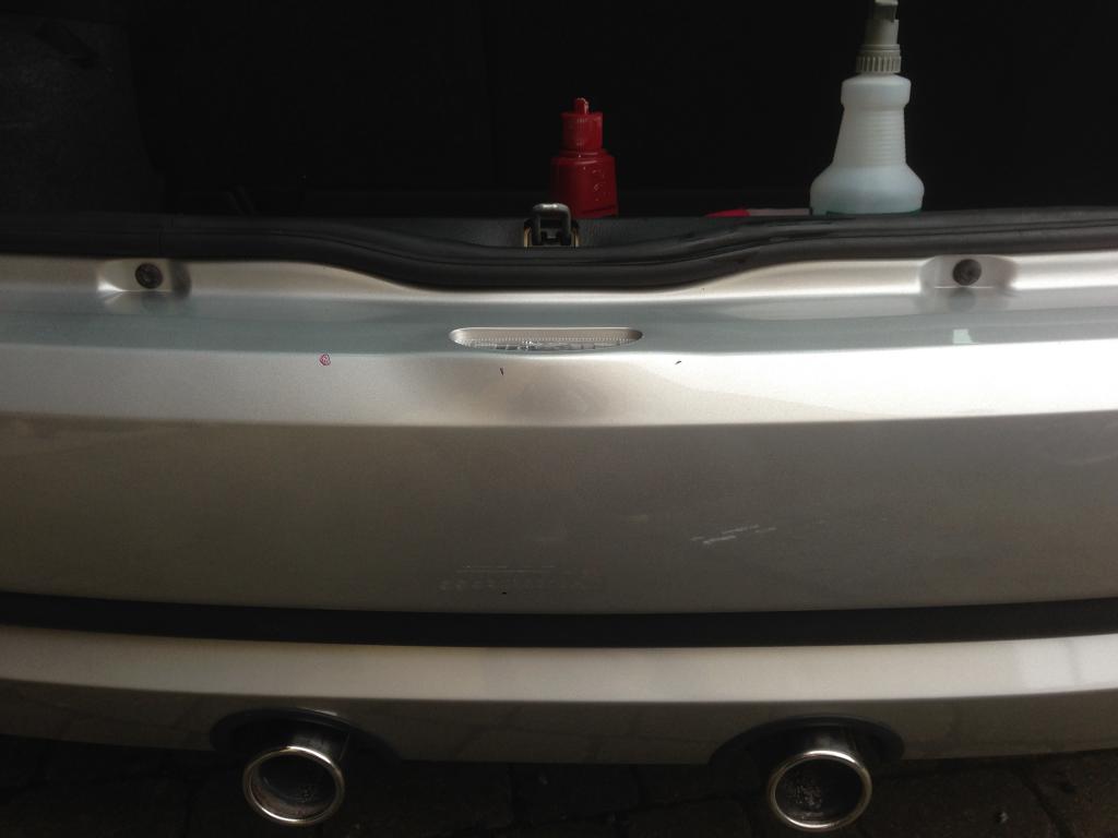

I manage to finish the coats and still had a bit of time left, so I then cleaned and waxed the boot shut and door shuts:

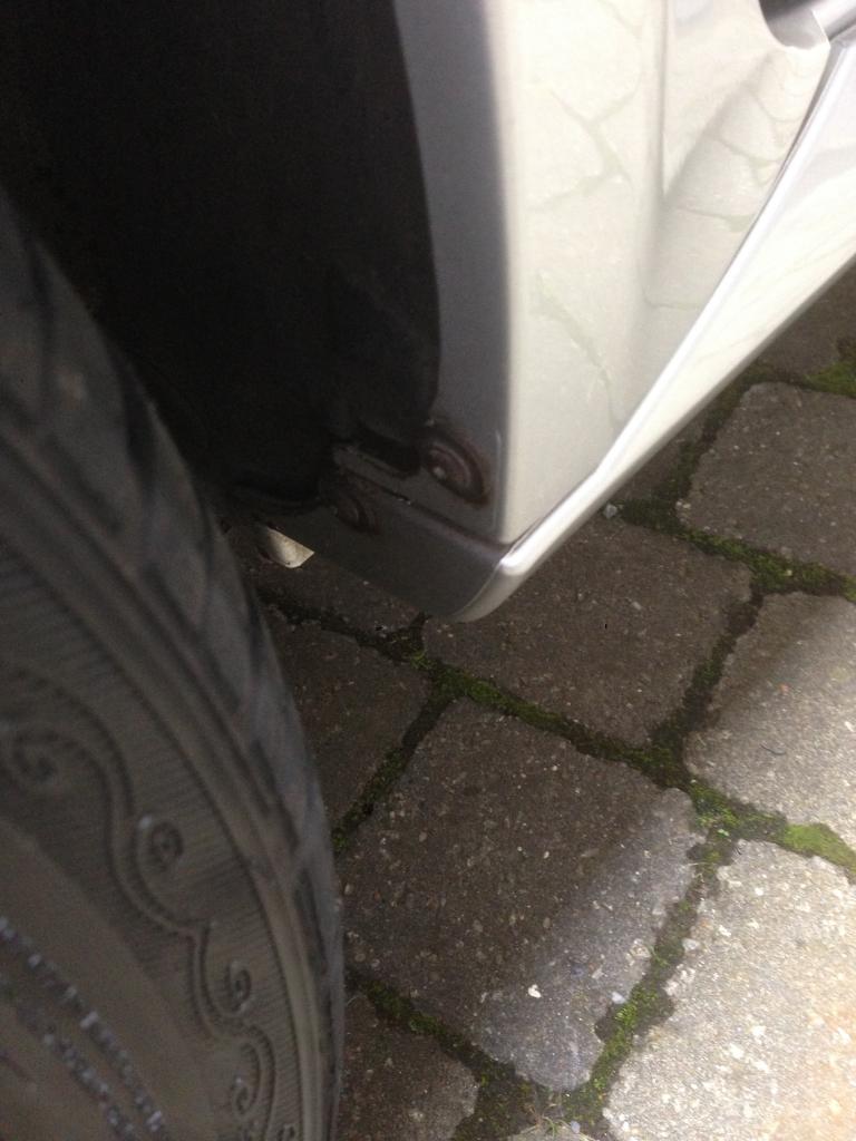

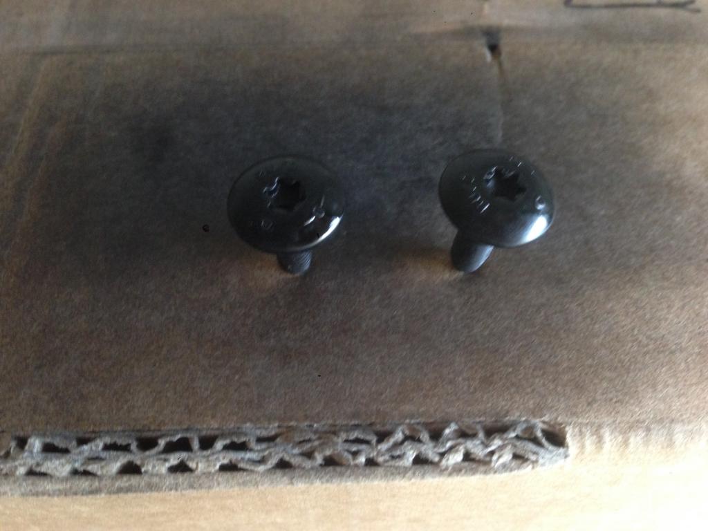

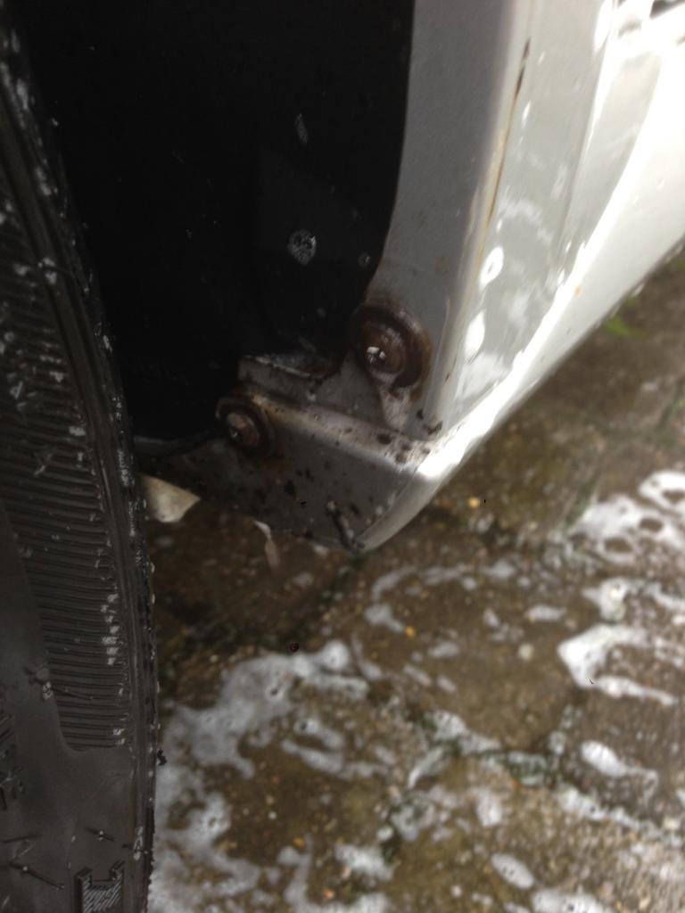

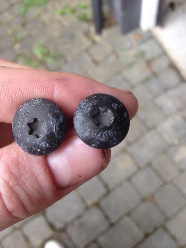

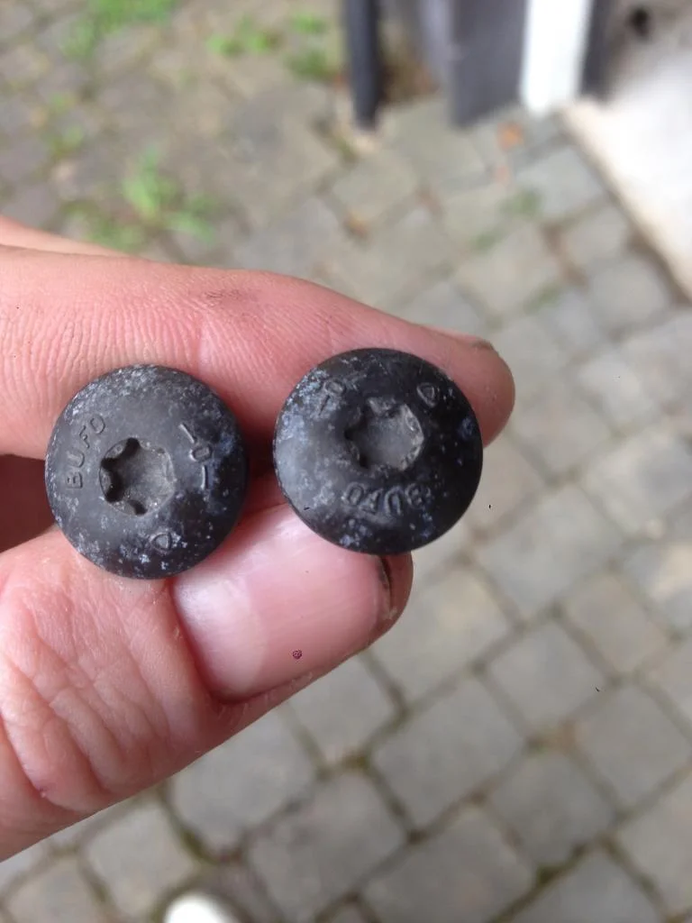

It might be to hard to see in this photo but the two bumper screws looked in a mess, so i decided to throw a bit of paint over them:
Before:
I couldn’t get a clear enough photo but inside the exhaust tips there where odd gray marks, so I carefully sprayed black spray paint in them (in fact in the photo above you can see what I am referring to)
The final results:
So who can help me with the part numbers for these bolts please, really letting it down now:
Shame that you cannot really see how well the car has come up, but its fantastic so really happy with the results.

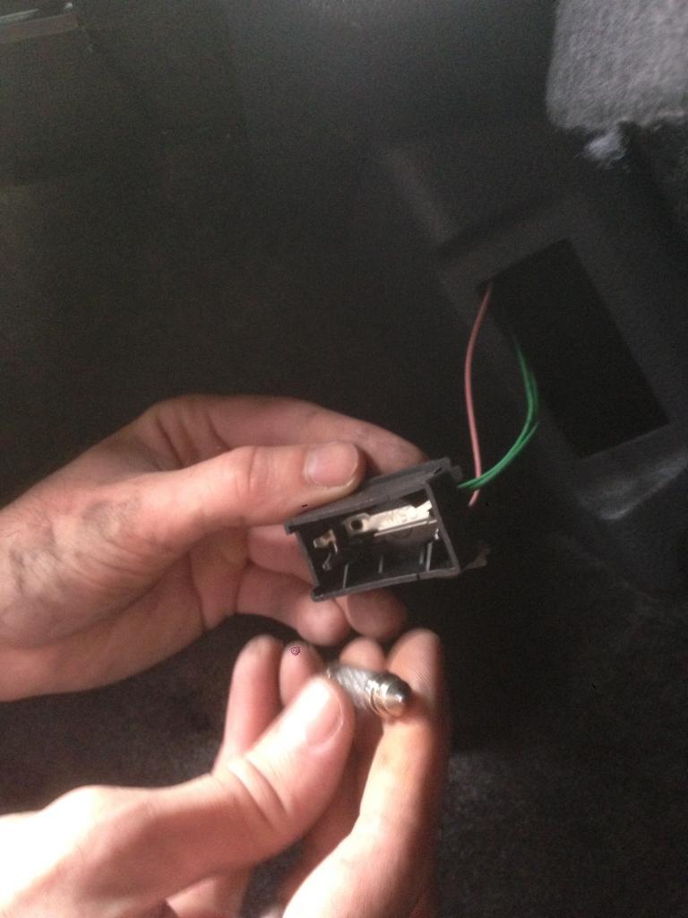

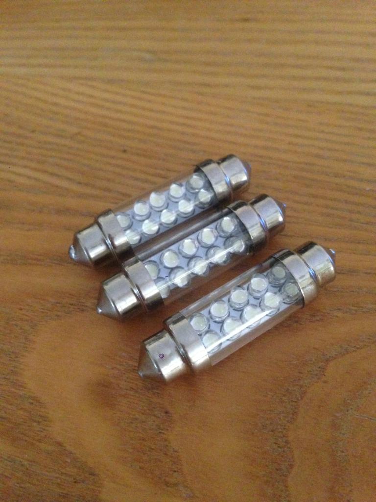

The interior LED bulb and registration LED bulb that I purchase where incorrect so I need to source the correct fitment type.

looks lovely jubbly,i dont like the aerial,2 small imo, the rear bumper light changed what a difference good work man
Joys of the internet:
FRONT ARCH LINERS
Trim Clip Wing Housing - 7703077435 x 10
Bolt MT Balck Washer – 7703017090 x 10
FRONT BUMPER
ECROU TOLL ¼ AC - 7703046145 x 5
Plaquette Fix AIL – 8200715957 x 5
Screws & Bolts – 7703016567 x 5
Nut C2 – 7703046120 x 5
Metal Bolt TH EMB RDL M6 x 20 – 7703602282 x 10
UNDER TRAY
Clip Nut M6 – 7703046048 x 10
One Thread Speed Nut 4,2 - 7703046116 x 10
FLGD HEX HD SCR M6X100 – 7703002820 x 10

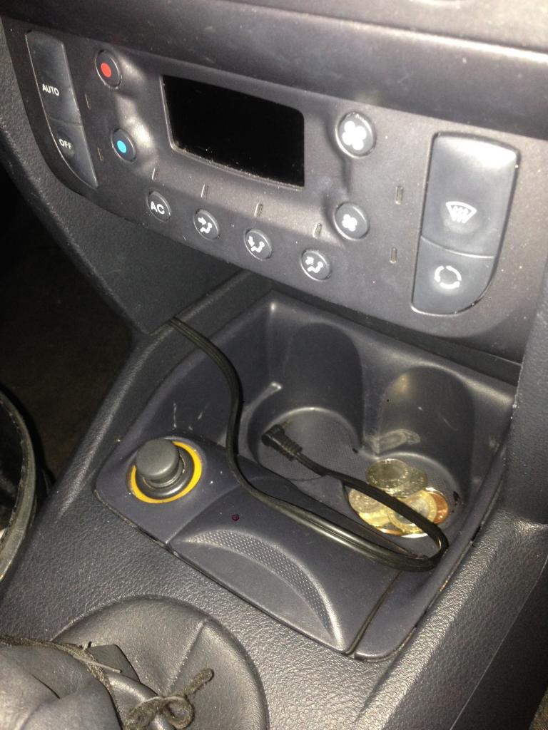

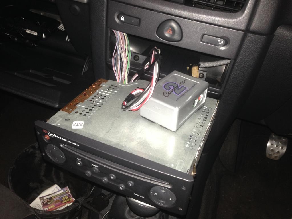

Connect 2 Aux in adaptor arrived today so installed it in about 2 mins, usually cost about £30 of amazon but managed to get one delivered for £15 from other user on the Clio Sport owners club on Facebook.

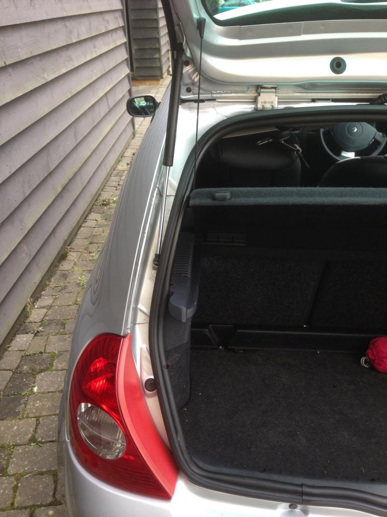

Can I just ask why u need the shorter boot struts? :)
I rang Renault today and the Trophy / V6 Spoiler is £273, in addition you need shorted arms which are suppose to be very expensive as well.
Cannot justify that amount on a spoiler which is only slightly bigger than the Cup spoiler so it will have to wait, will have to keep my eyes out for when one comes up for sale.

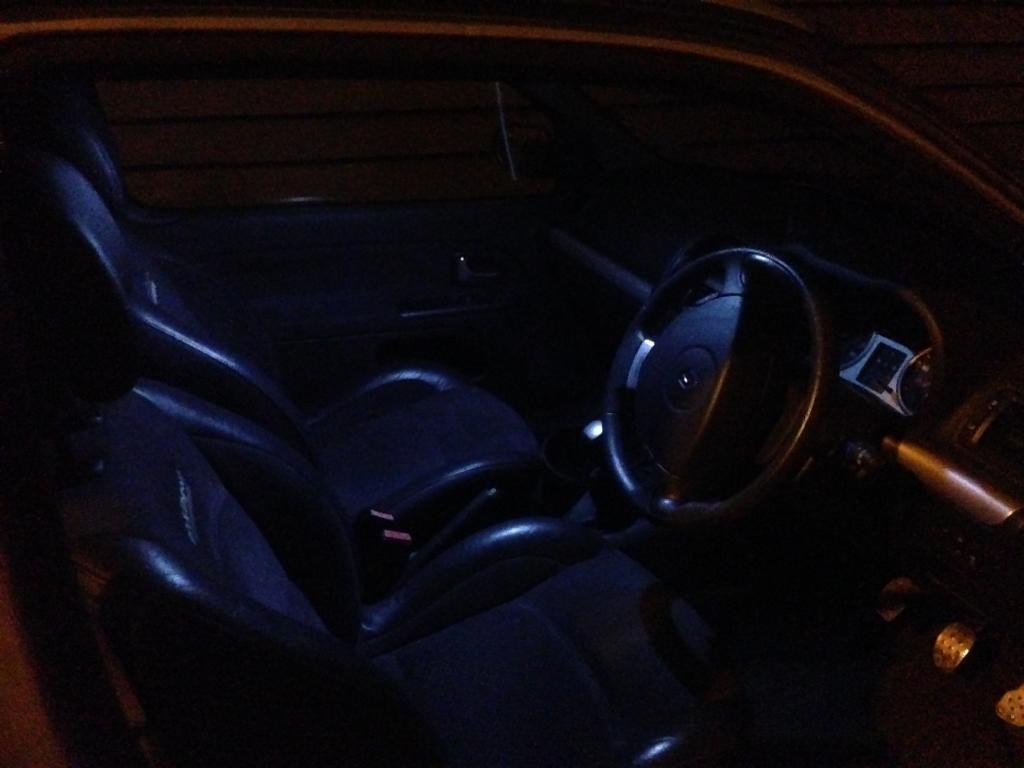

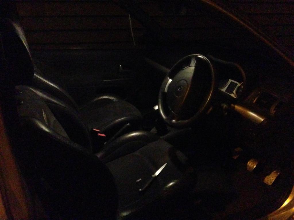

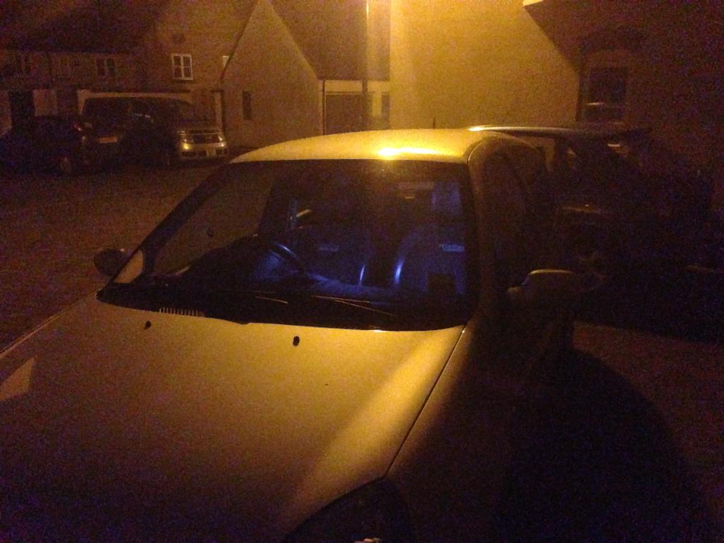

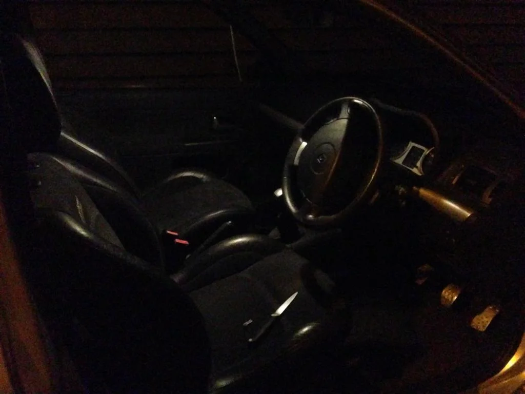

Not much an update and poor pictures but interior lights fitted and phone holder
The photos make it look really blue but it is bright white:
Before:
After:
