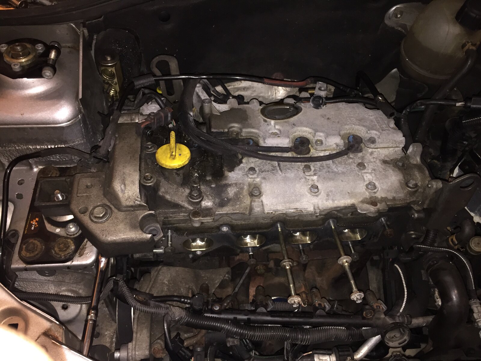

Cars back from cambelt change and.........

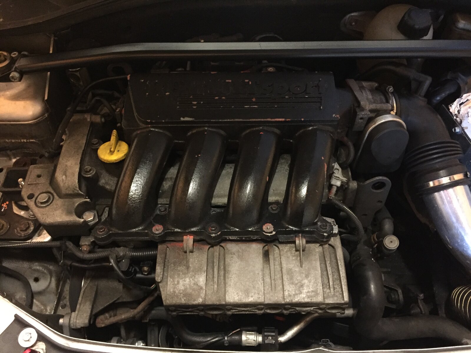

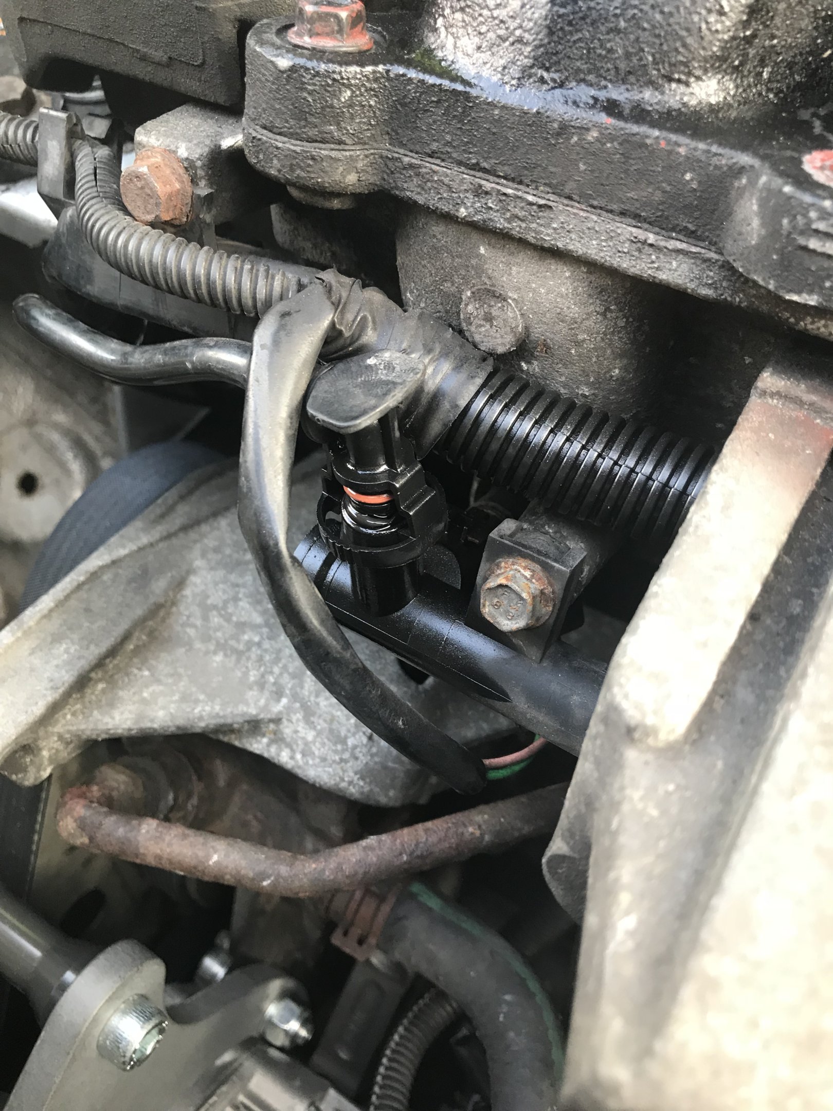

It works! Idles fine, drives fine and starts fine! It now has the PMS a/c delete bracket. I haven’t given it the full beans but it feels a little more responsive. Such a relief after what happened last time. Let’s see how we get on.
Just going to do an oil & spark plug change as a precaution, have the tracking done, get the trailer down from my Mum and Dads (forgot I had it!) and then trackday. I’m disappointed with how many trackdays I’ve done this year but it’s time to make a change!

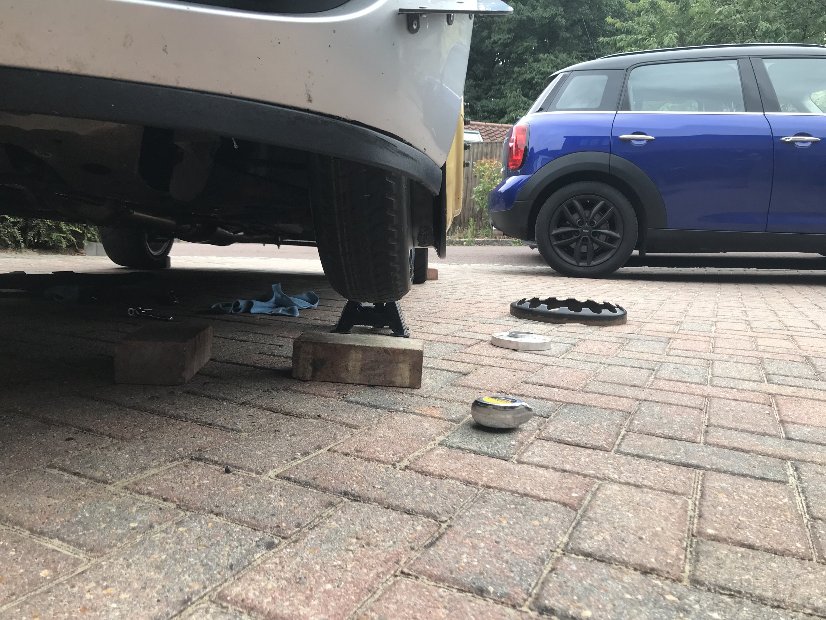

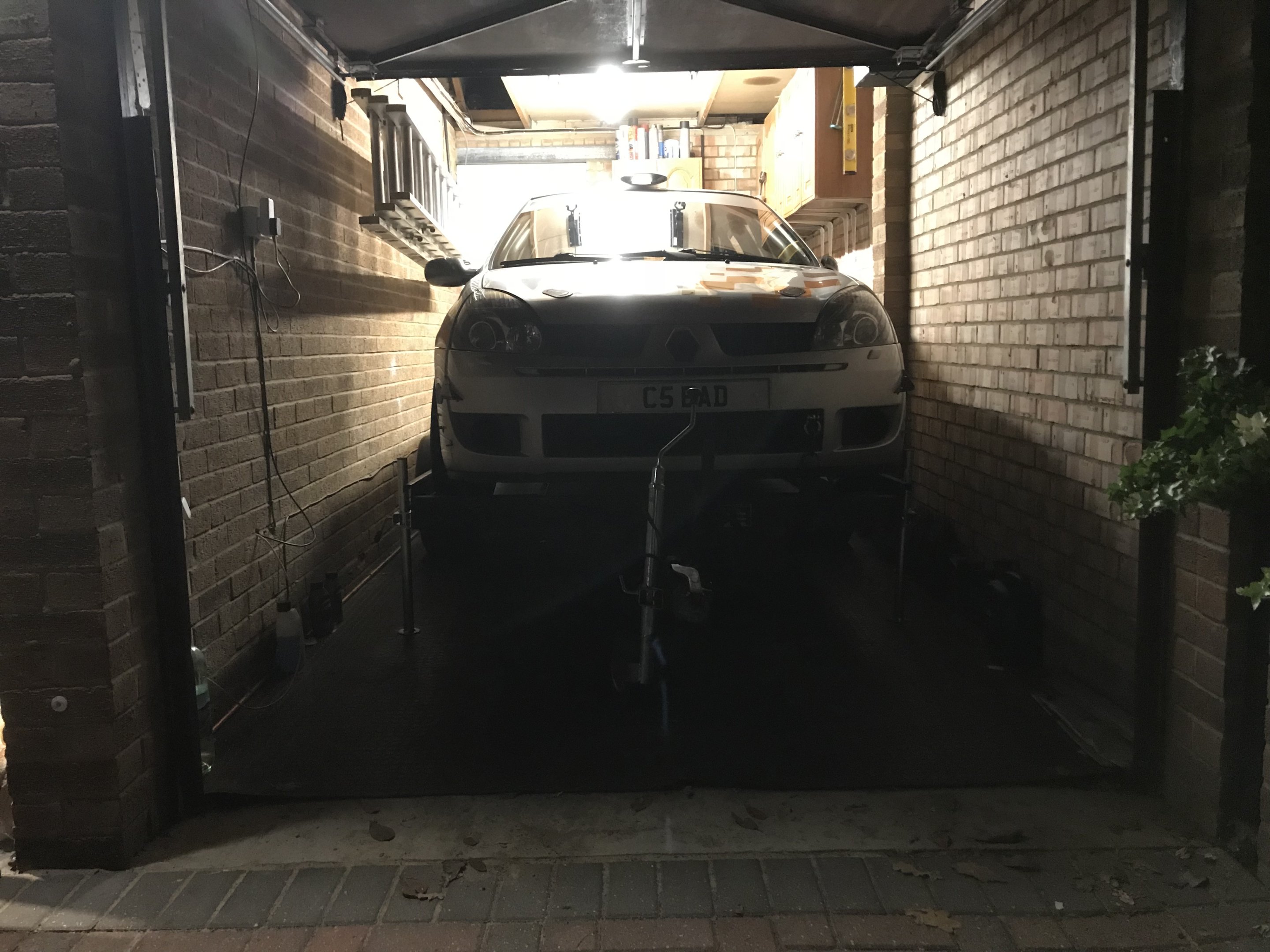

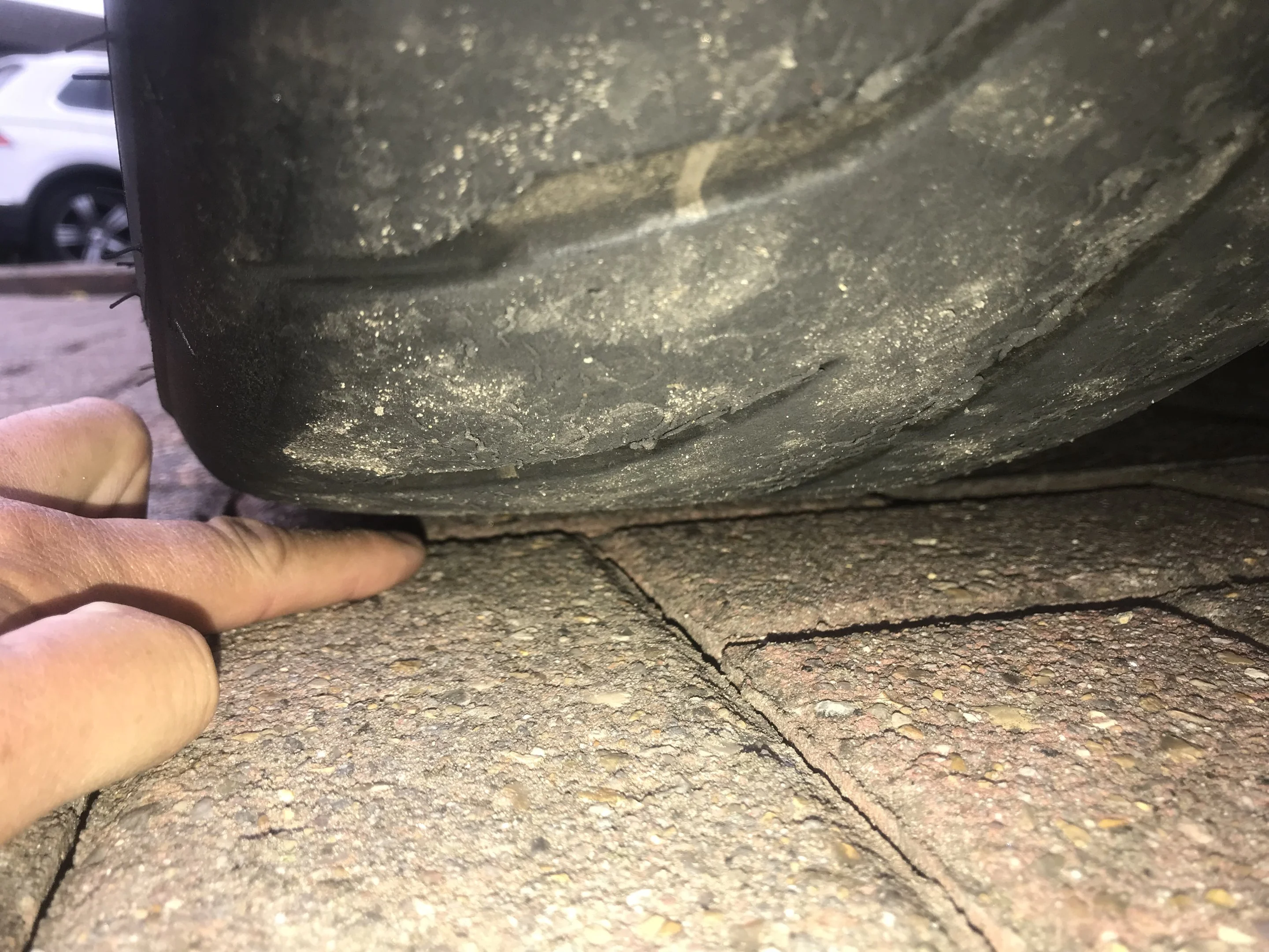

Park on the drive on a slight slope and the rear wheel is clean off of the floor!

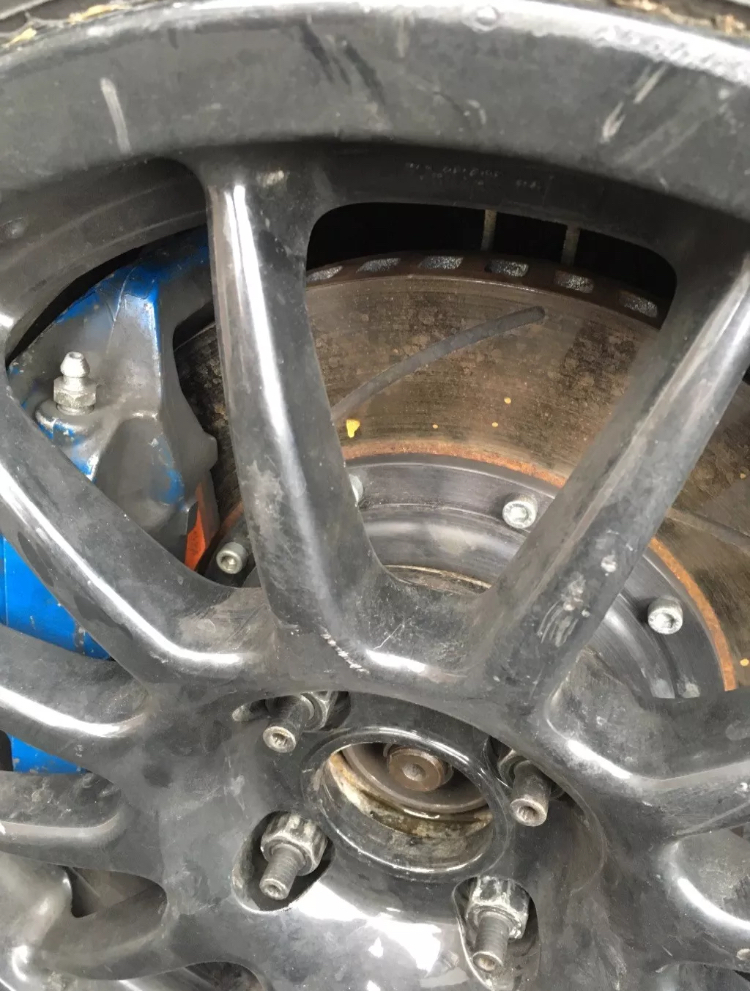

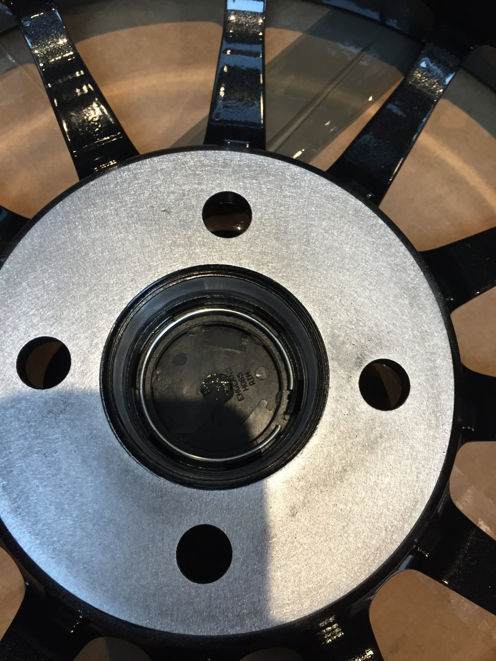

Nearly there, the car is to wide at the front and it’s hard to reduce it due to the brembos. Basically i’ve had to make a bespoke wheel for this made from a 16’ space saver and a 16’ wheel. It just needs welding together now but in principle it fits. Rear was fine as a Nissan Micra spacesaver clears the callipers easily and bolts straight on.

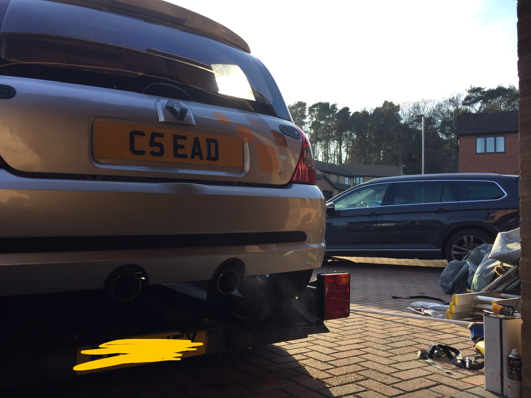

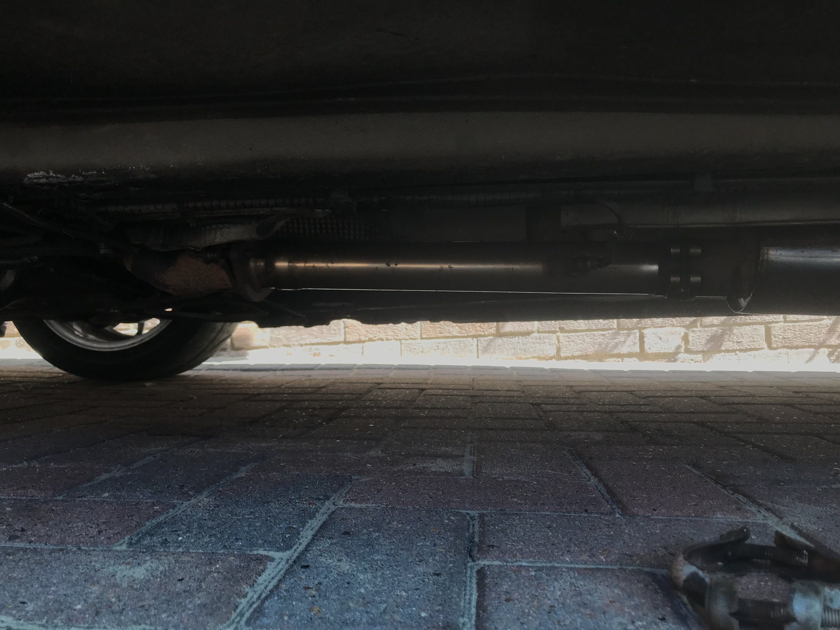

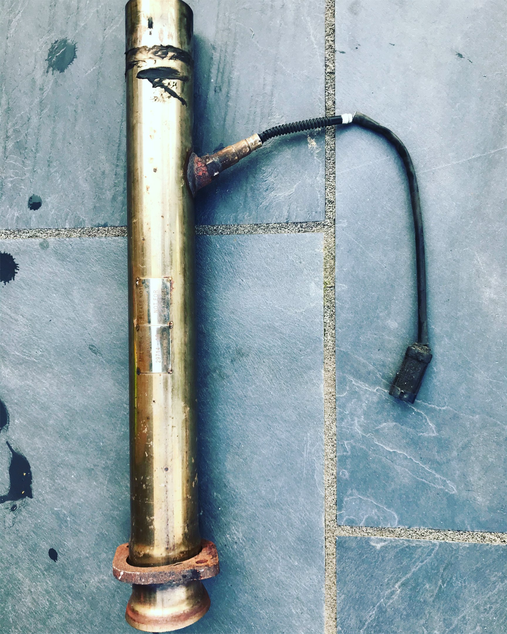

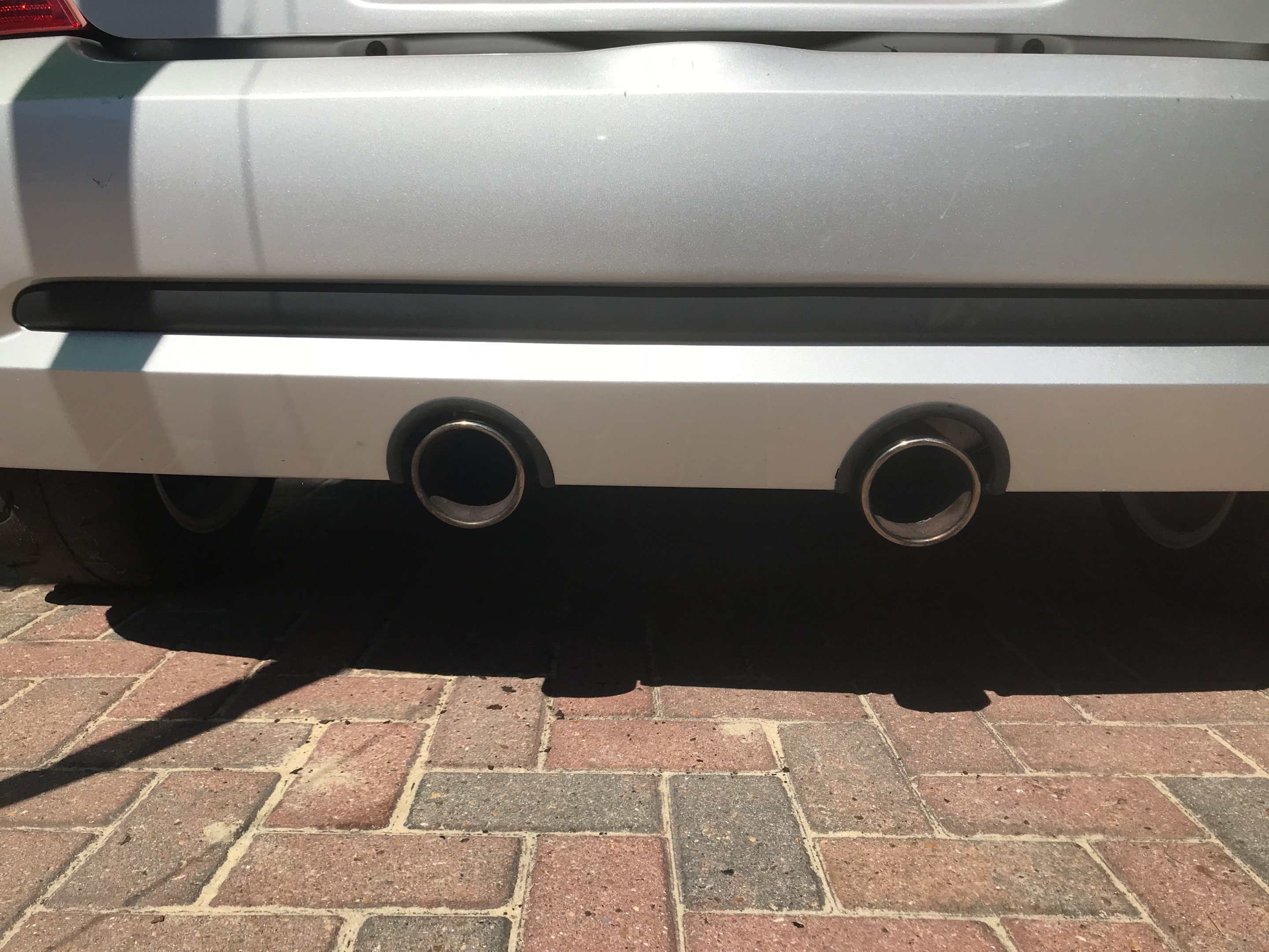

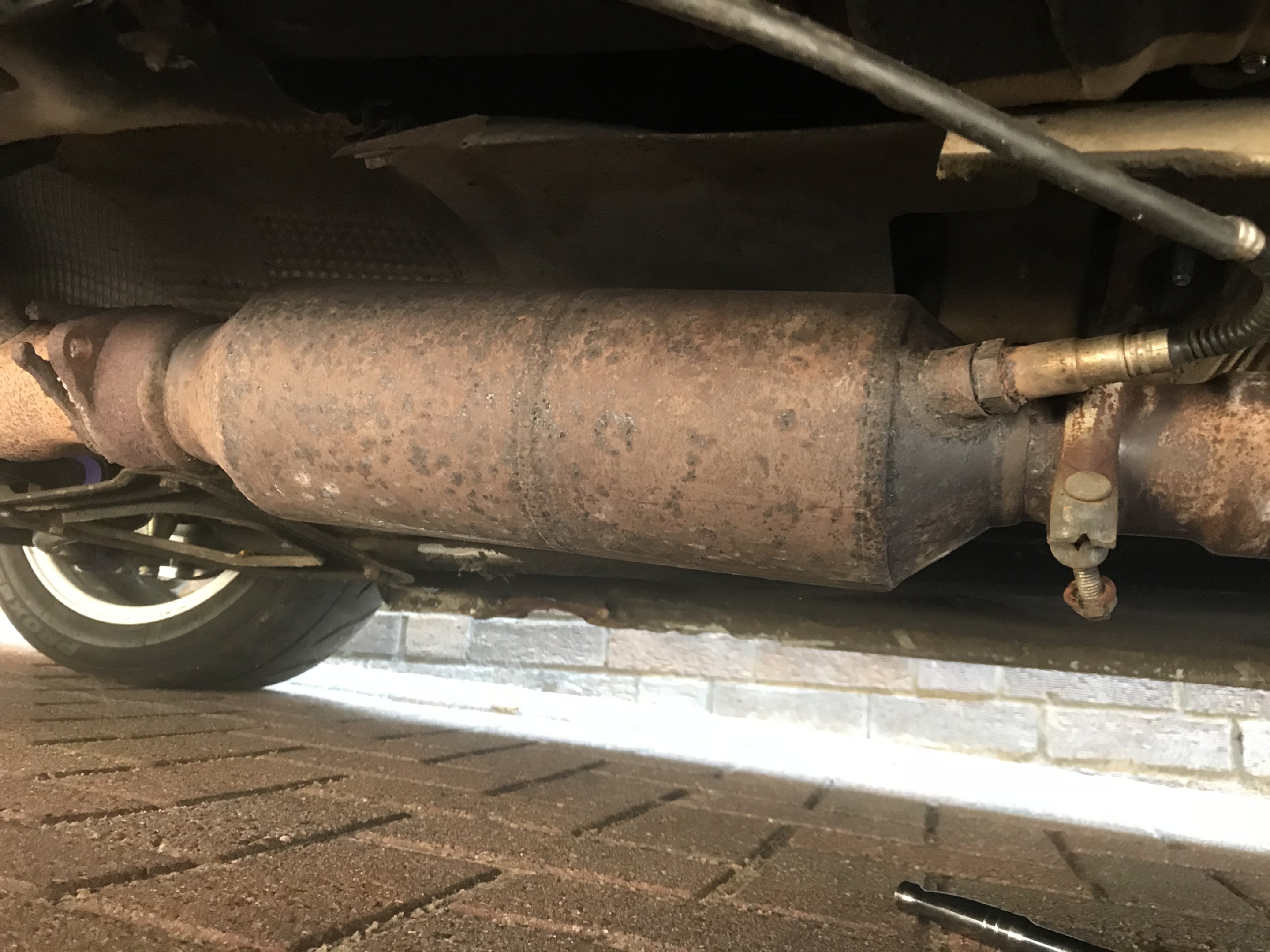

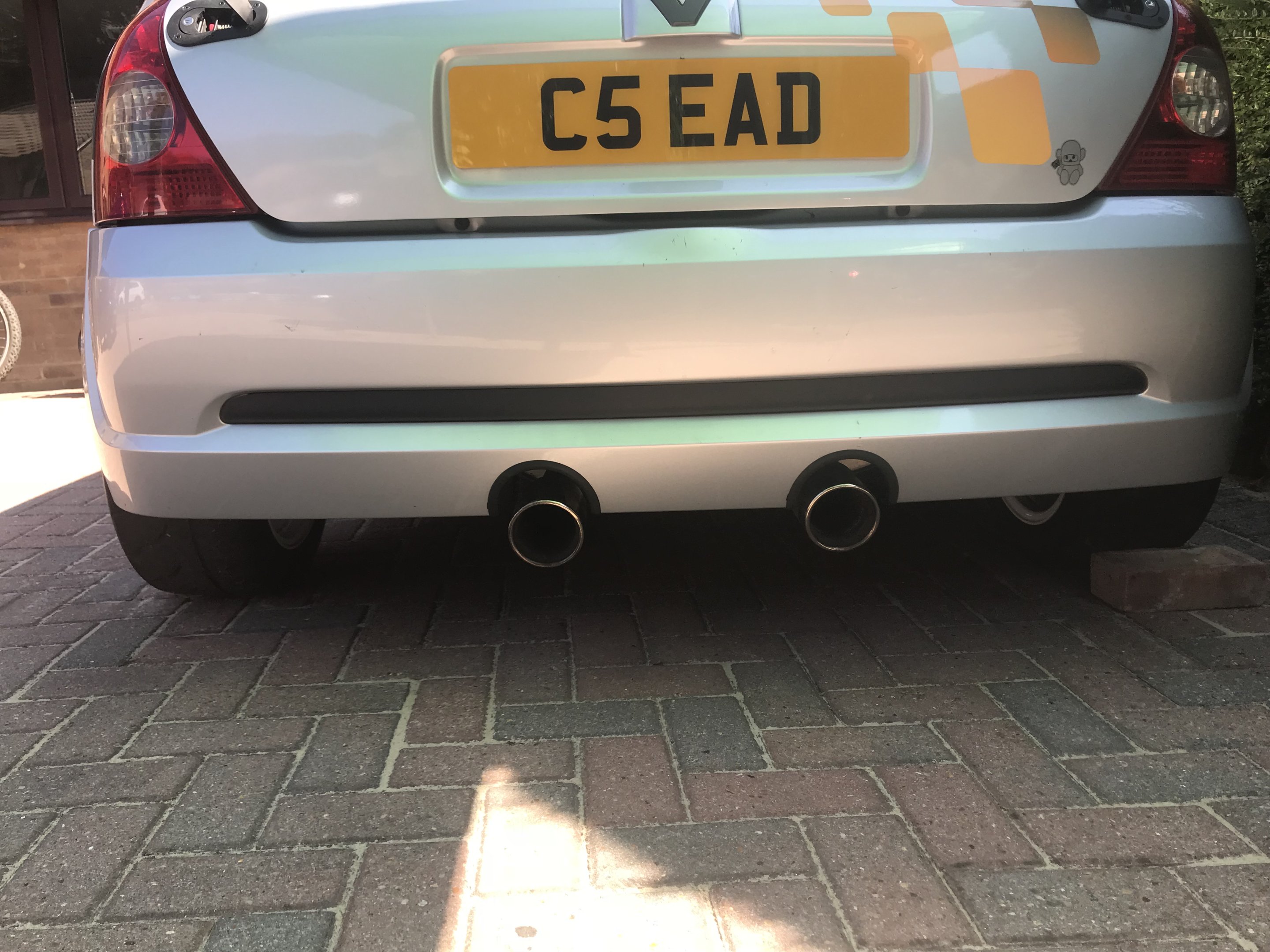

Little impulse purchase, a Decat pipe. Fitted it today (bad idea at the ground was on fire!) and took the opertunity to straighten the exhaust. It’s always been wrong but I didn’t fancy taking it off. I had it in the vice and bent the brackets as far as I dared. Just needs a little tweak but it’s 1000% better.
Before
After

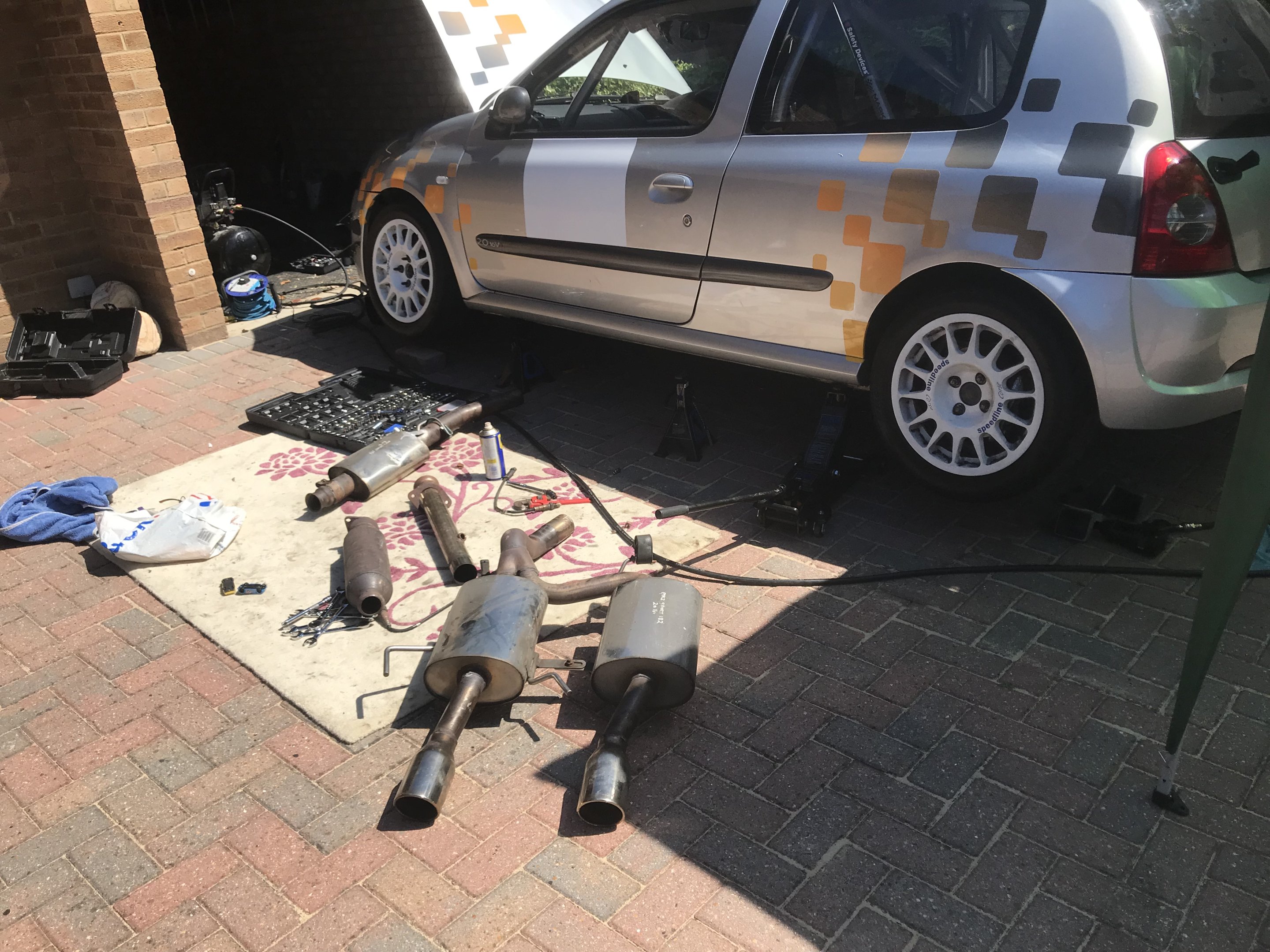

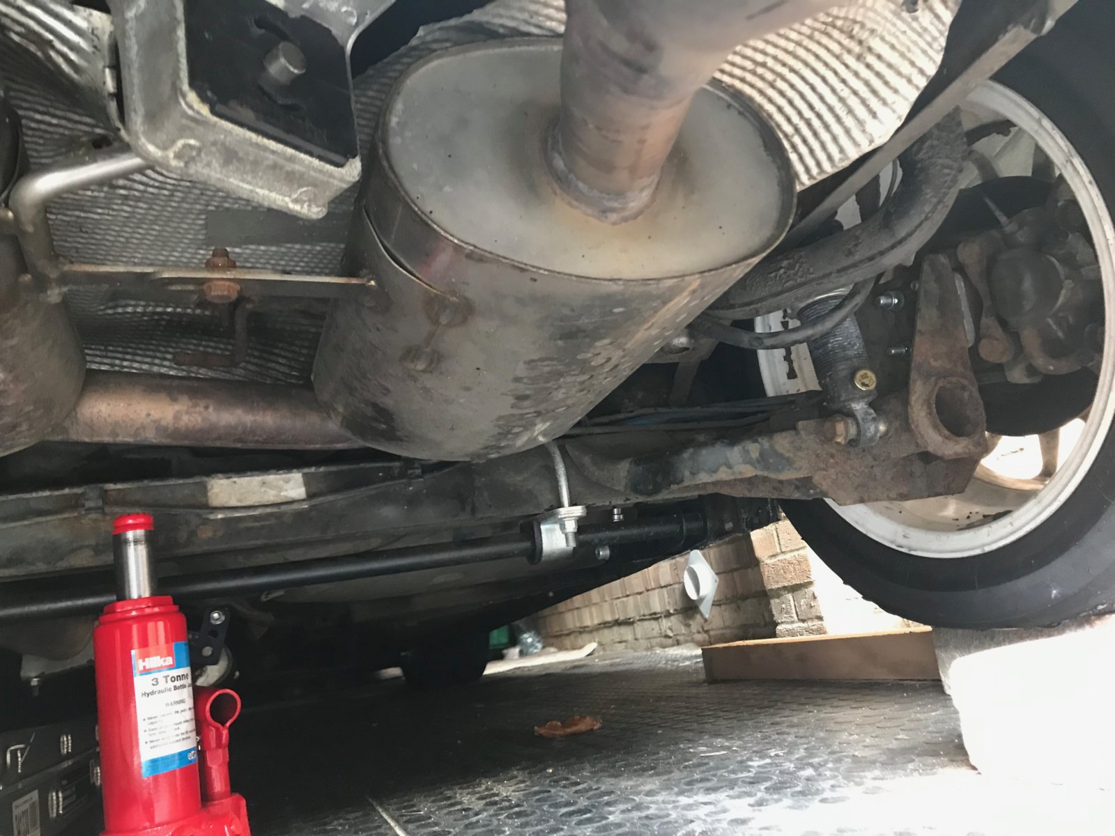

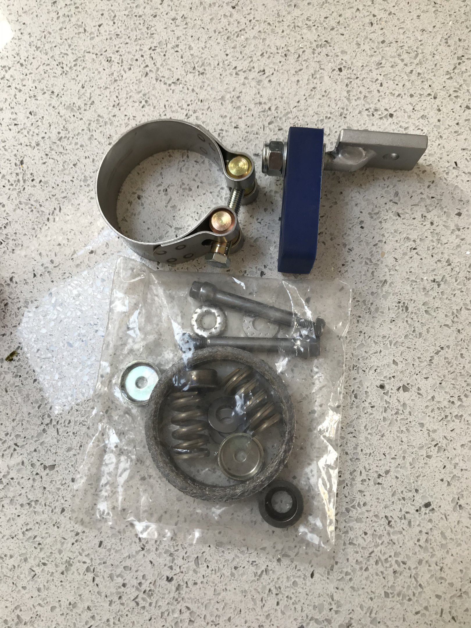

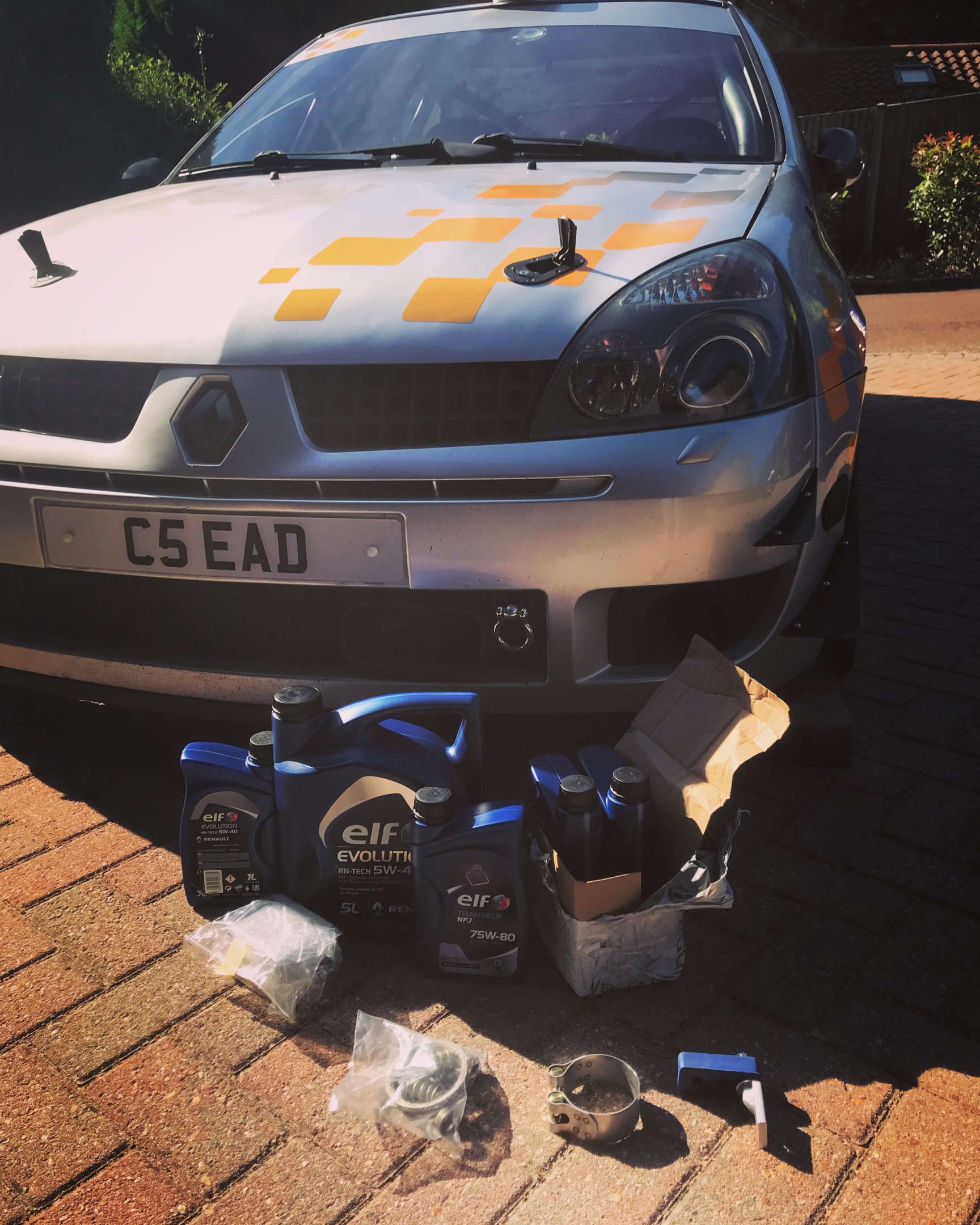

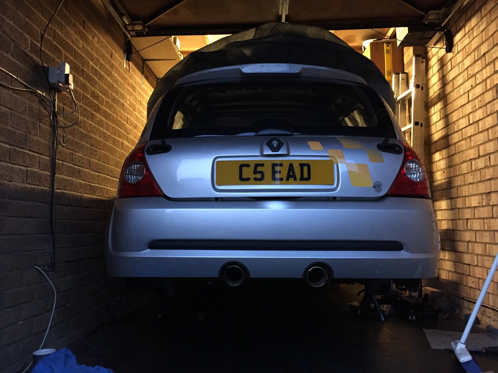

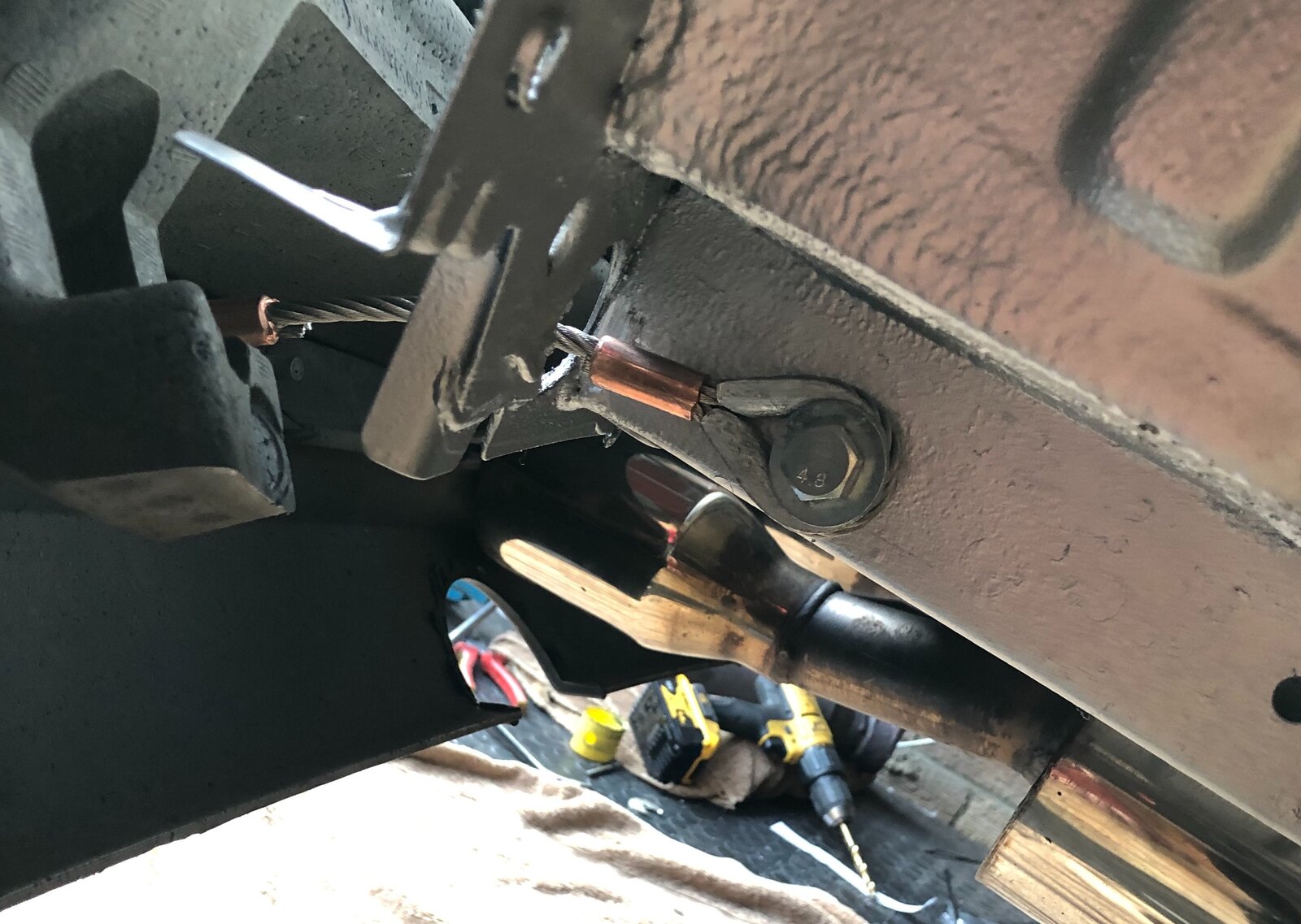

Busy day today changing fluids and making sure the exhaust won’t fall off. I changed the below brackets as the old ones were all knackered. Cost over £40 for the brackets!

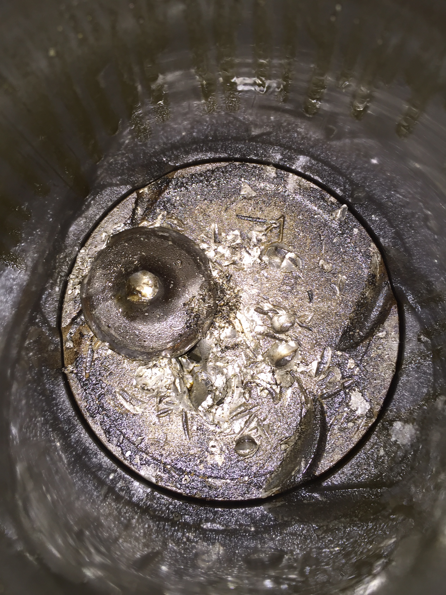

Then an oil change. Couldn’t believe how black it was. After lots of research I used the original Elf oil. Turns out you can get this and the gearbox oil as cheap as any others when you look around. Didn’t get to top up the gearbox oil as spent the rest of the day getting the trailer space saver wheel together. Had to weld it at my mates house. Happy days as he had is 944 turbo with him. Loving the old school turbo lag and noises!
Bit of welding and then back to my house.
On the way home whilst going past a fancy pub/club I caught site of the new Car throttle feature car ‘Garath’. Didn’t go in as we were covered in dirt from the car adventures which is a shame as I like what Alex’s does. I did meet Ant from Wheeler Dealers on a plane to Ireland 2 weeks ago. Chatted to him and he’s a really nice guy.
Moving on the great news from today is the Clios going to fit on the trailer! Result.
Rain stopped play but fundamentally we’re good to get the trailer back and get the car on it at last.

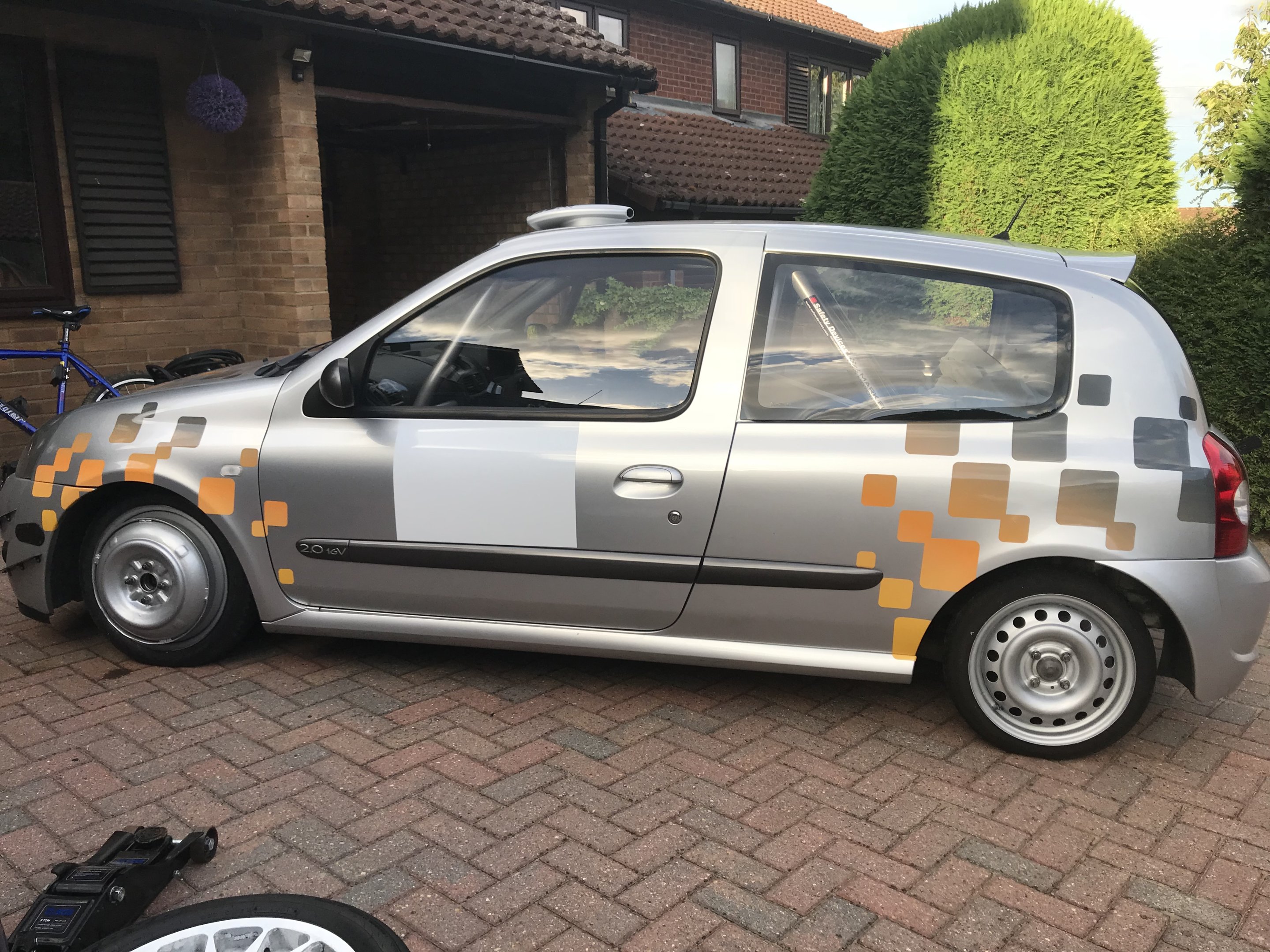

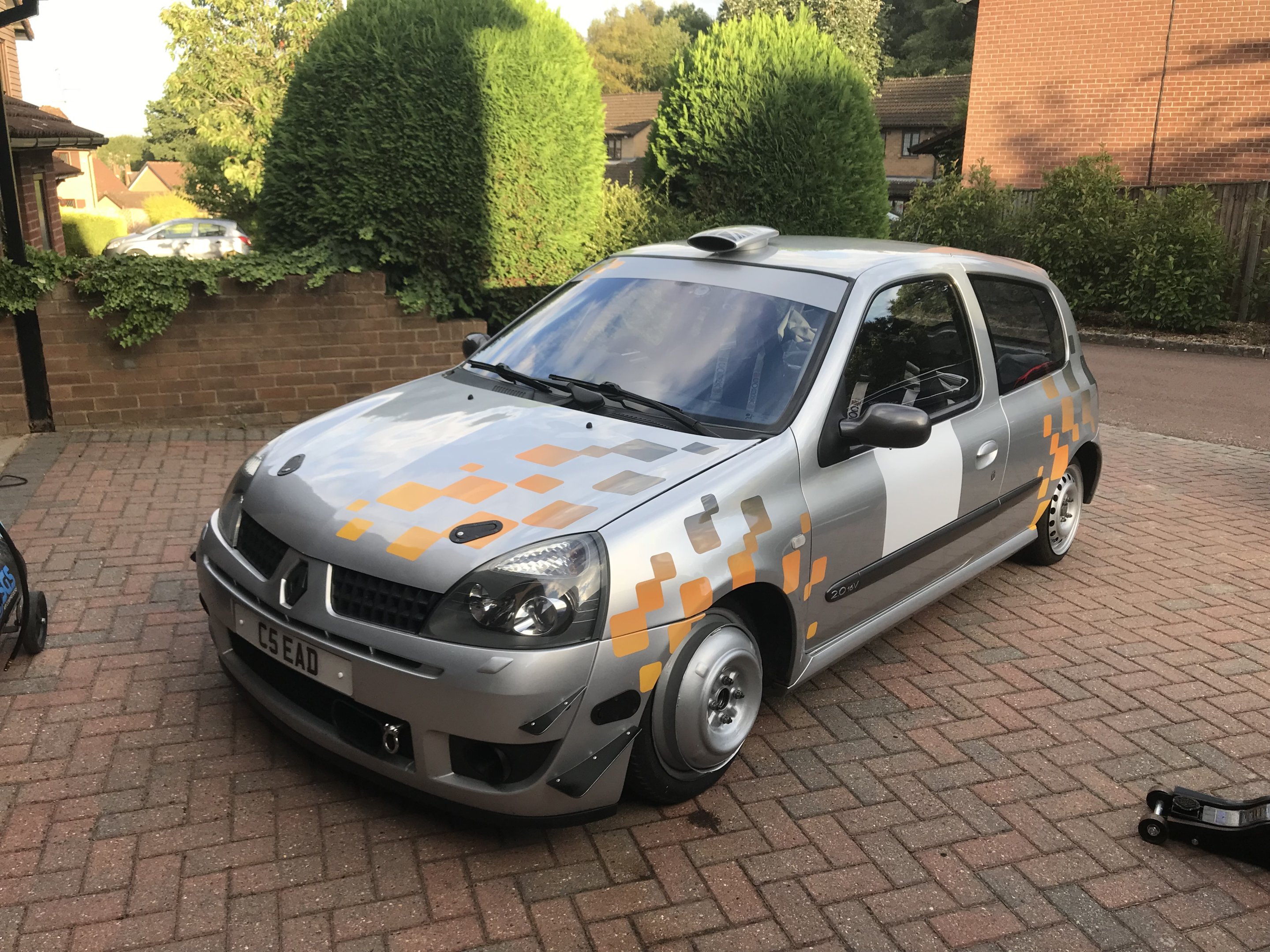

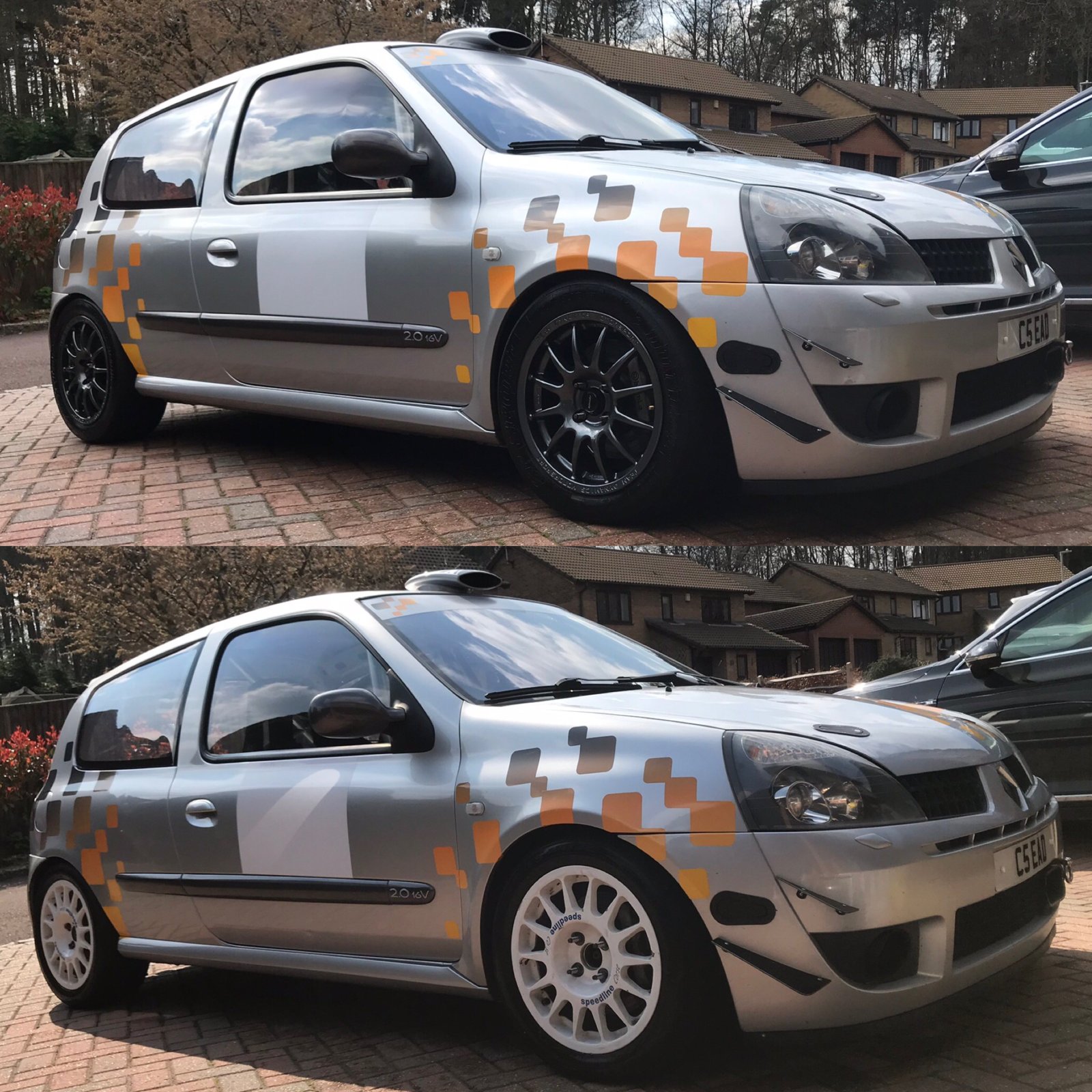

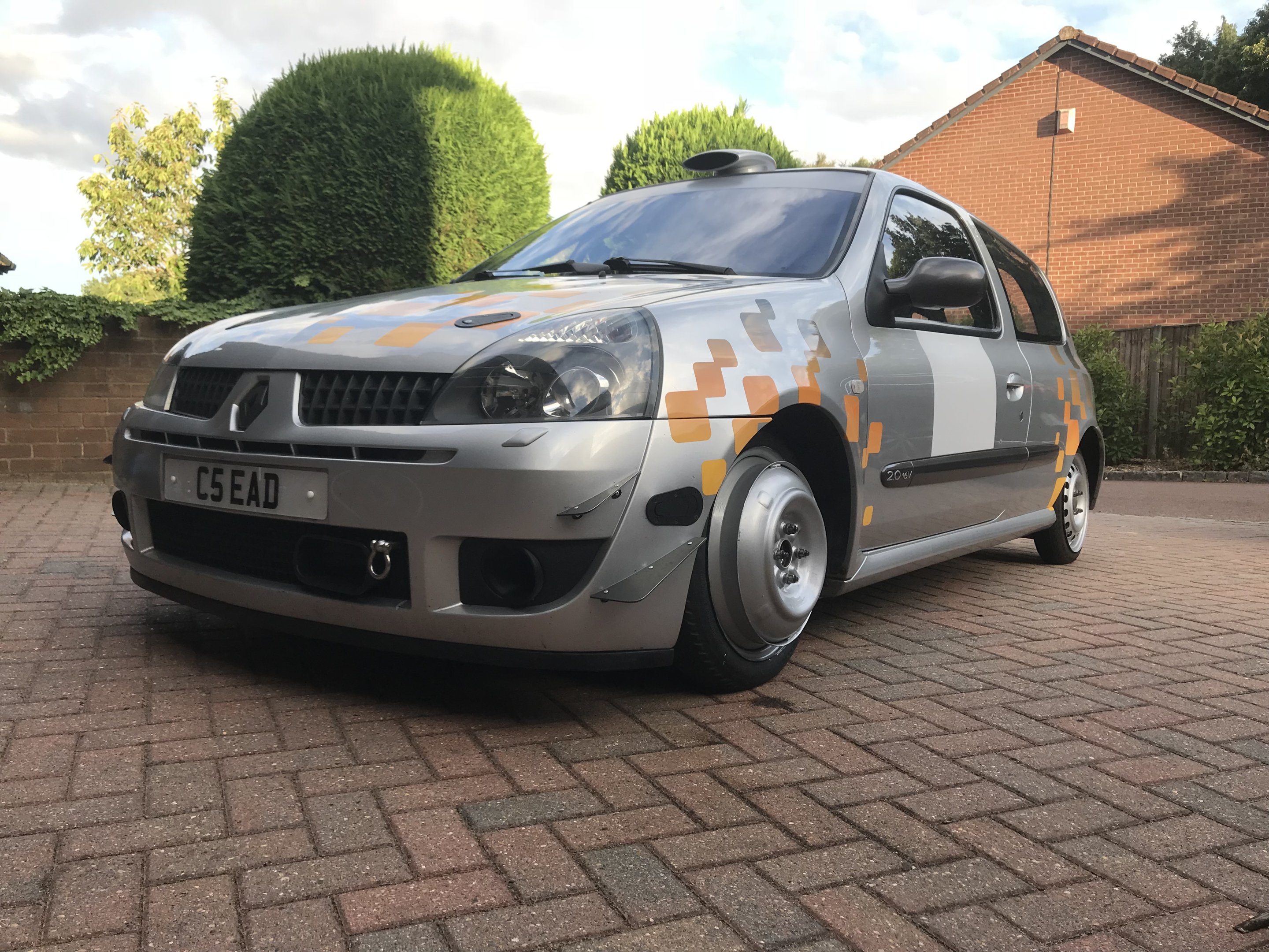

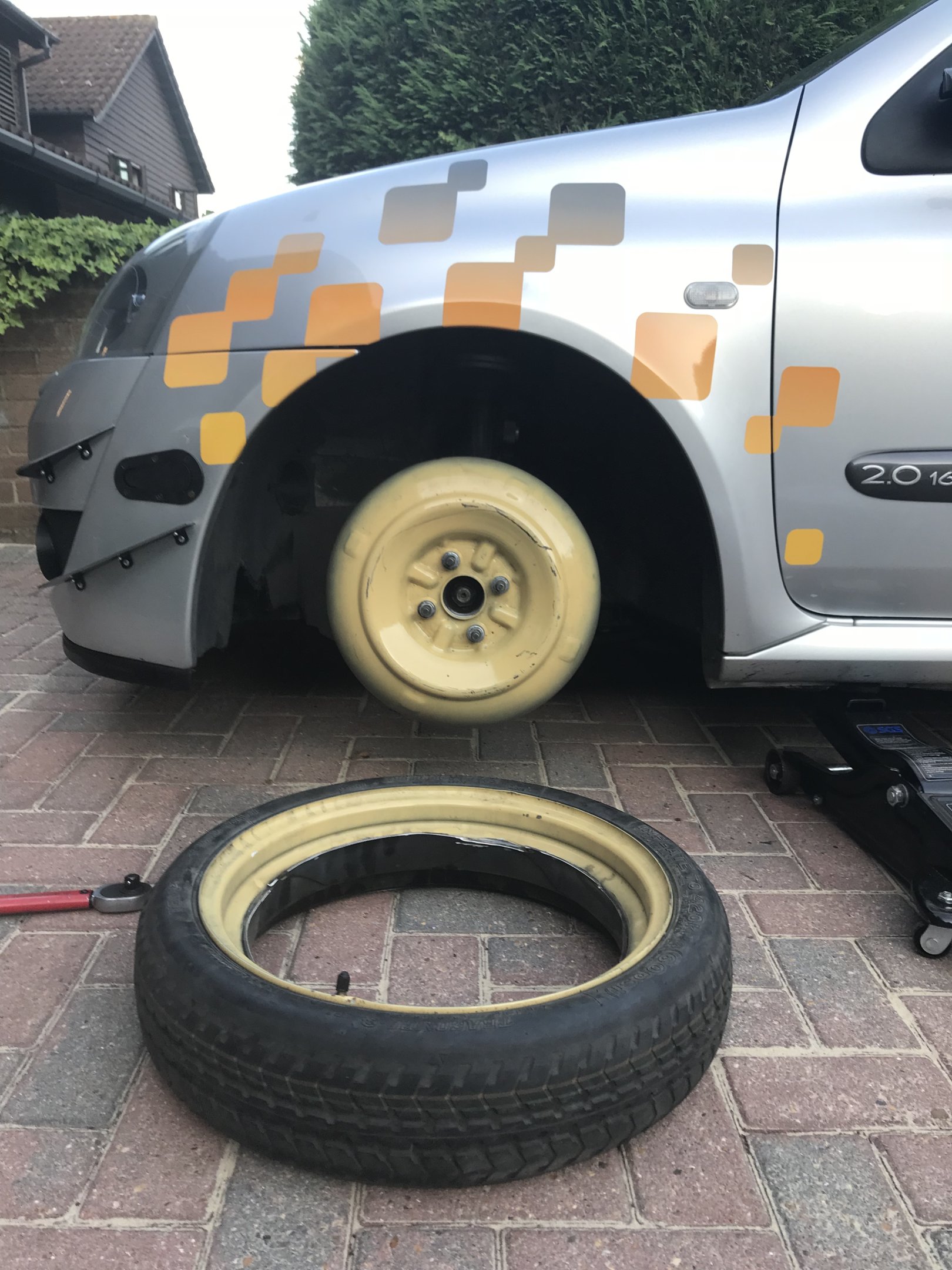

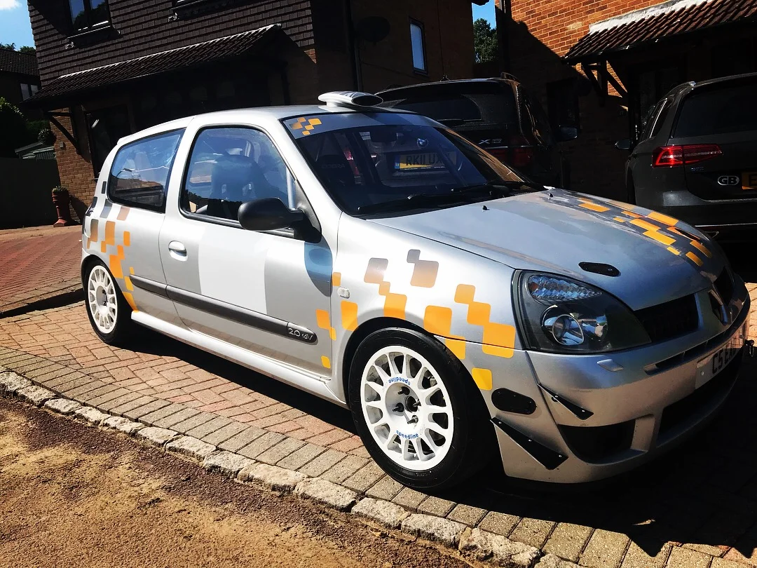

So here’s a strange look. Function over form!

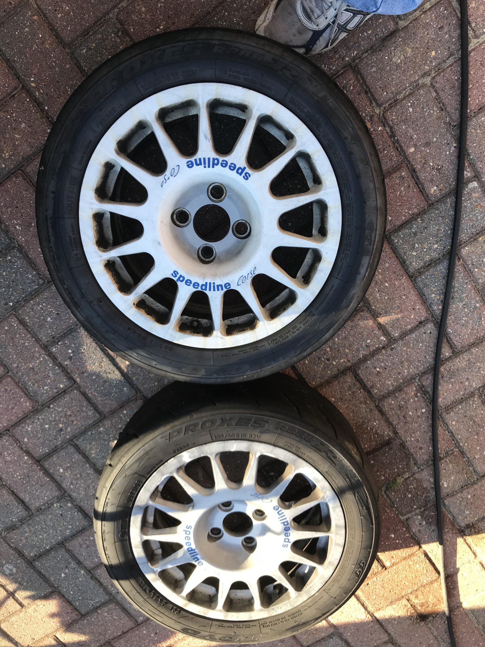

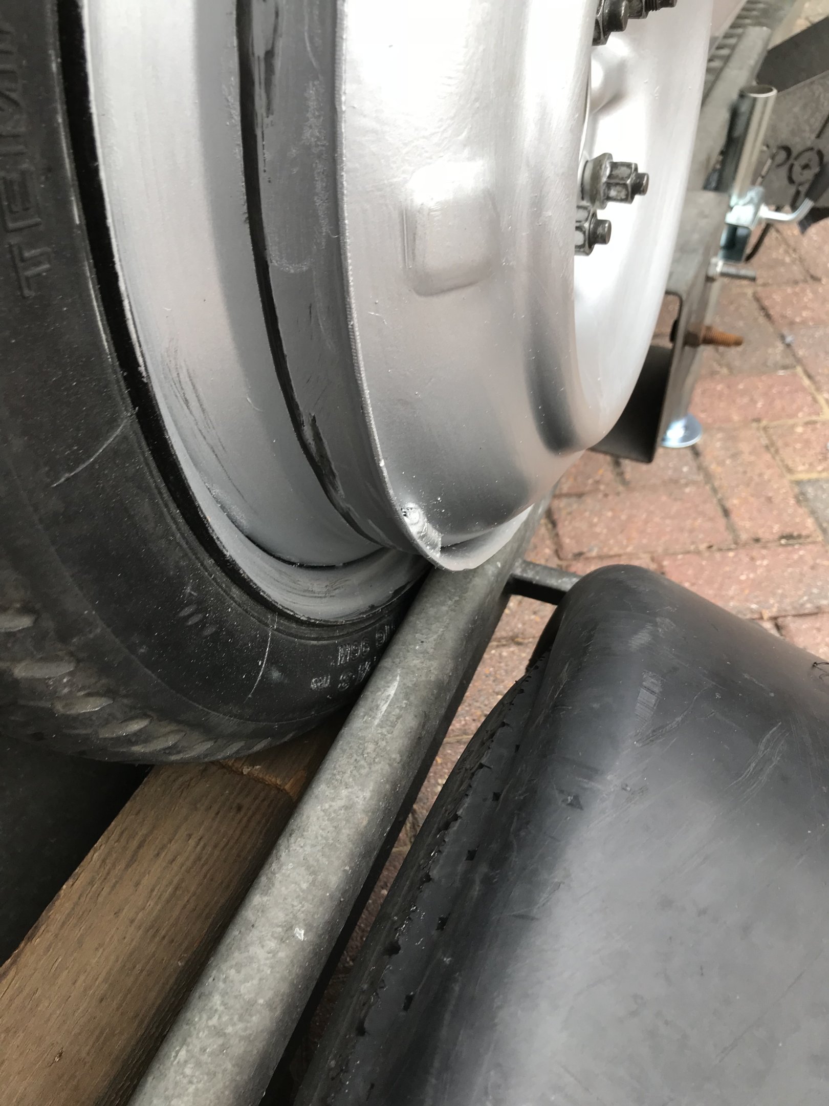

Painted the new wheels hamerite silver as per normal. I’m right on the width limit for the trailer. If needs be i’ll make another one for the other side but I can’t delay it anymore, i’m getting the trailer back home tomorrow. Busy weekend ahead as I want the car on the trailer and the trailer in the garage ASAP. But then there’s no holding back

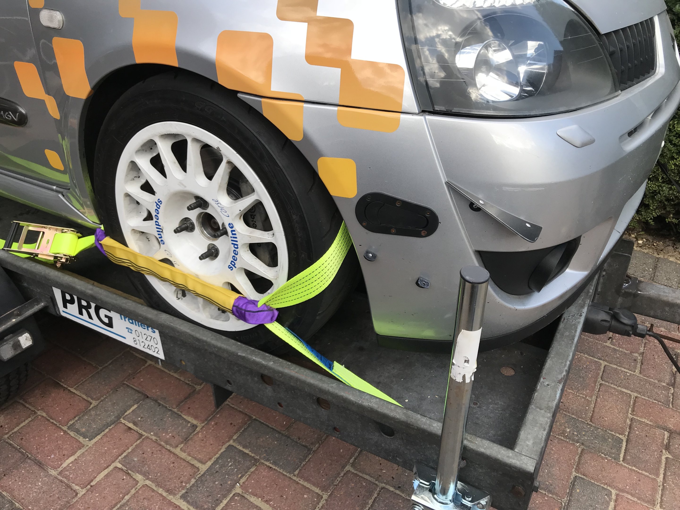

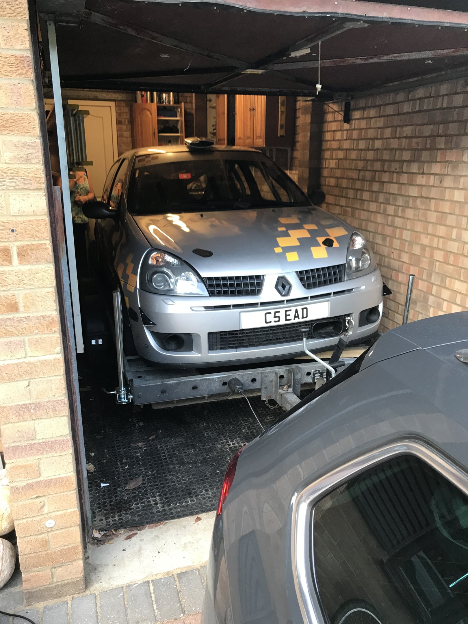

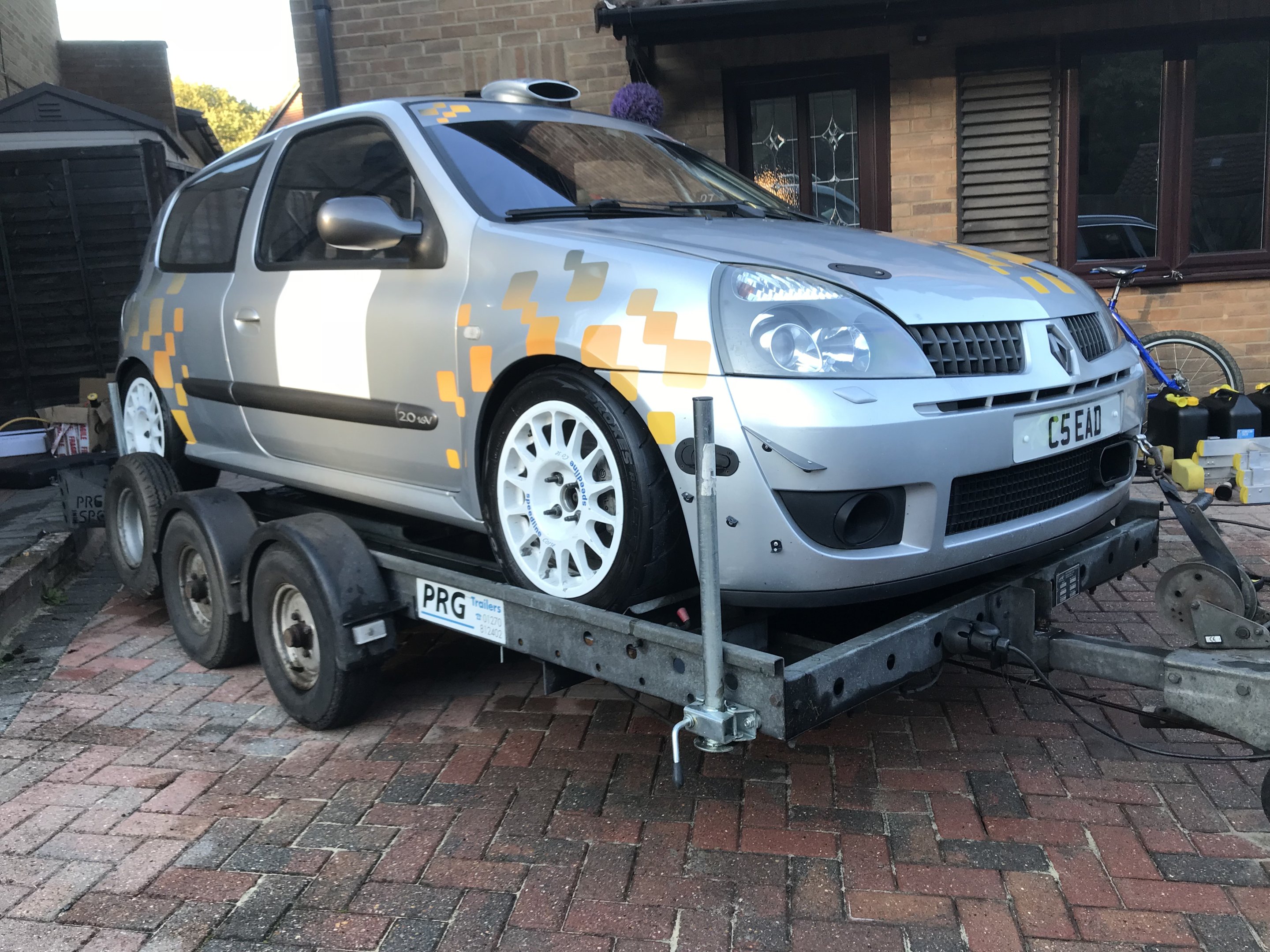

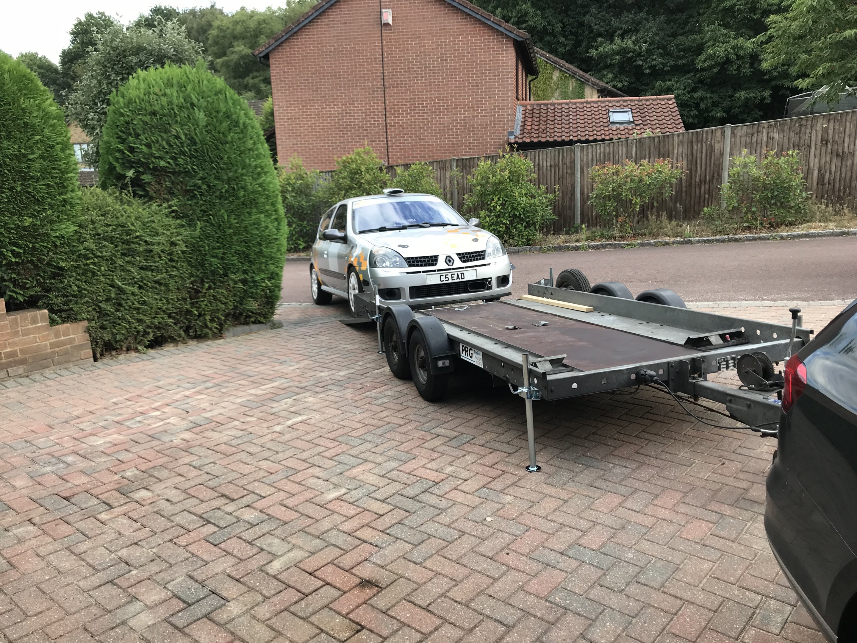

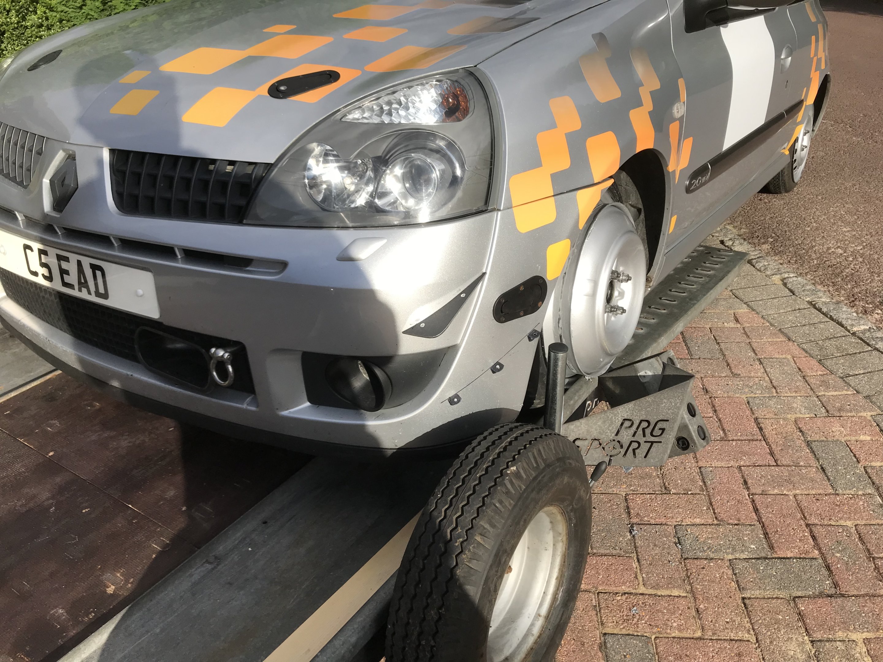

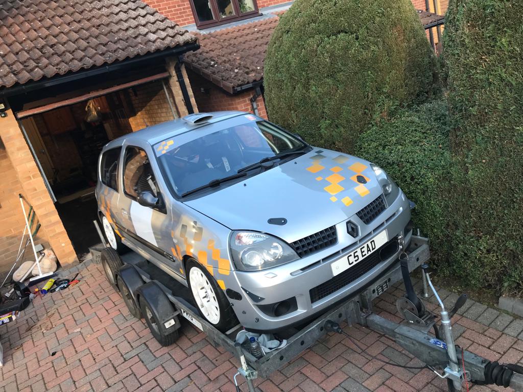

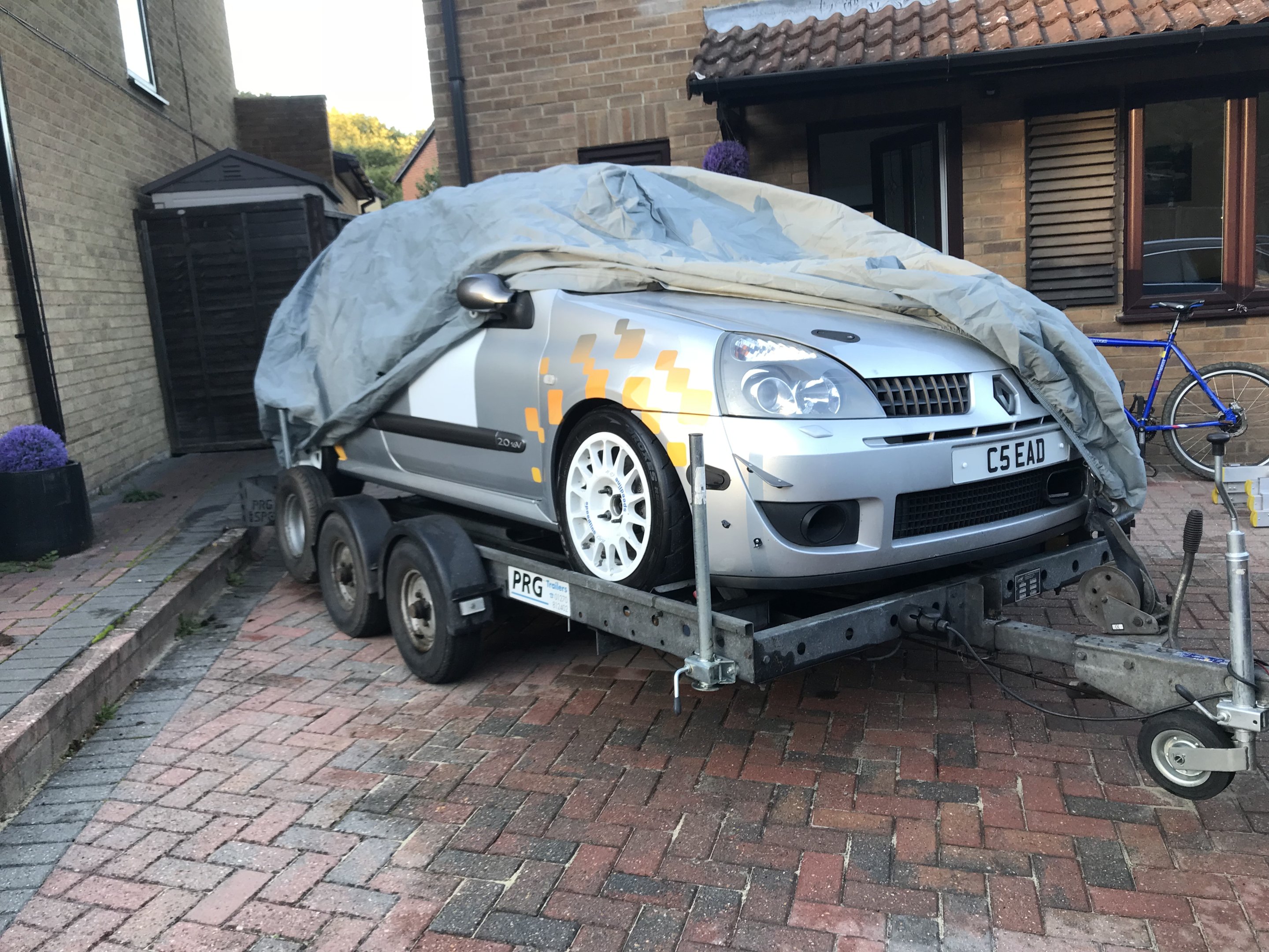

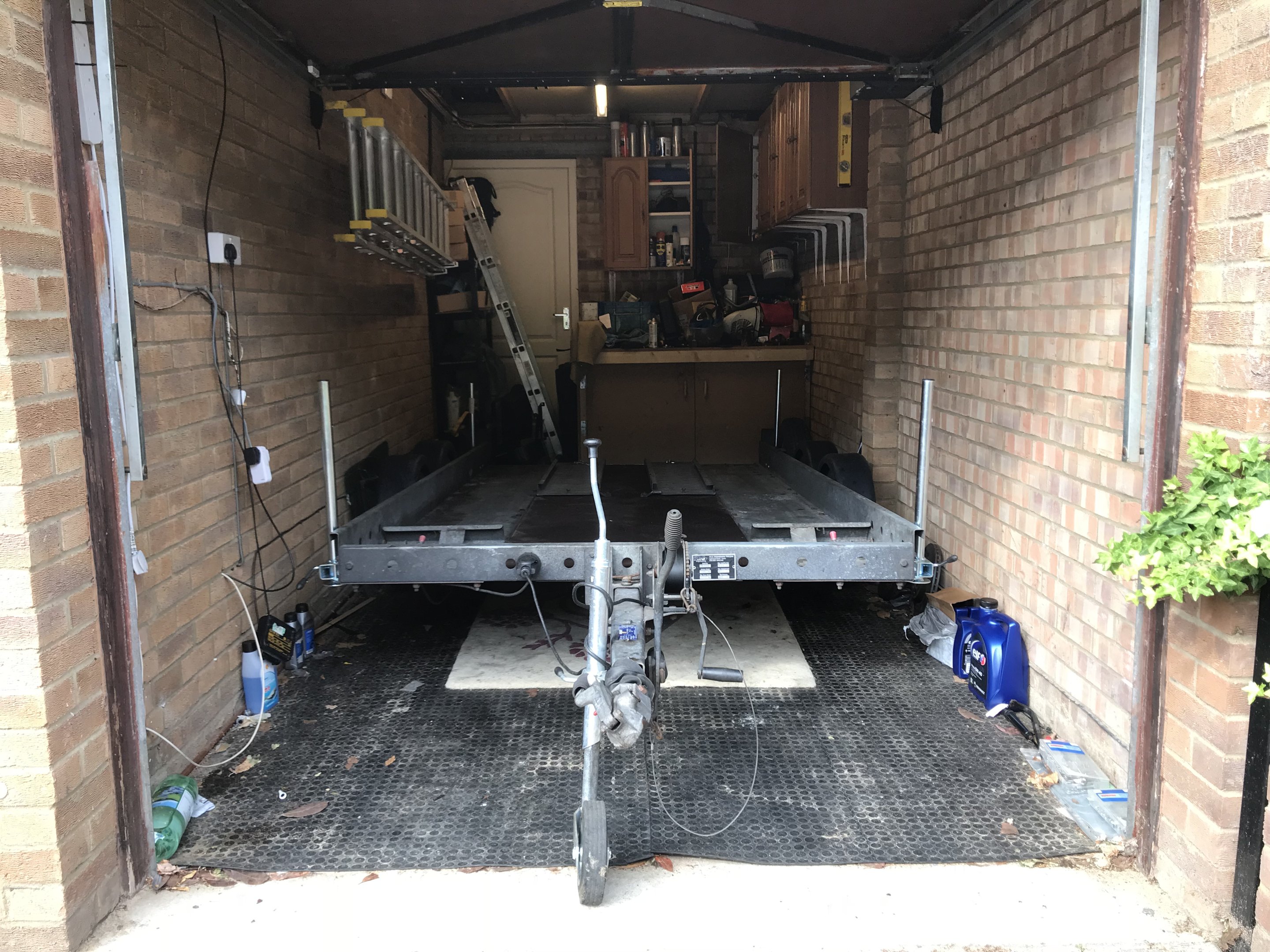

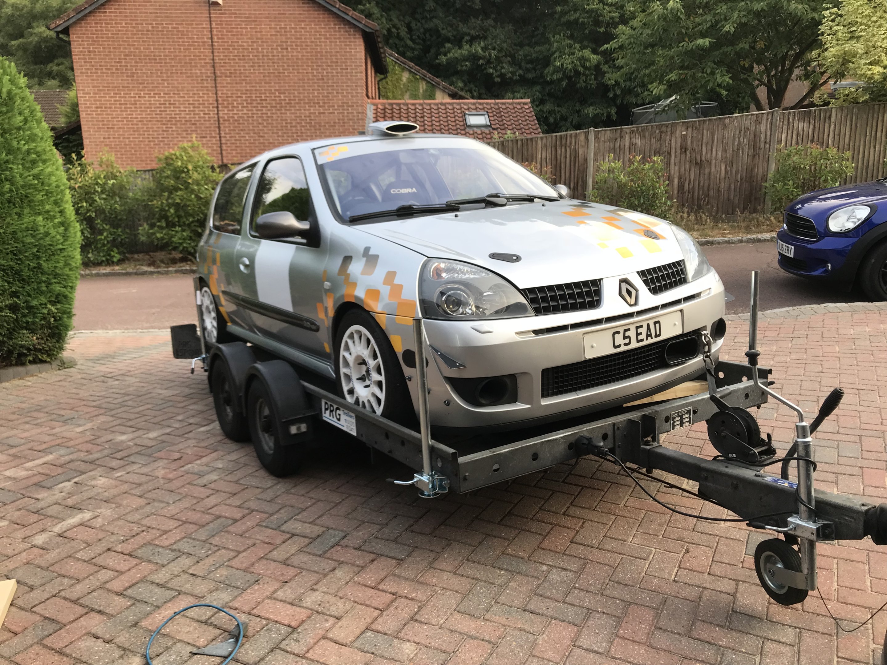

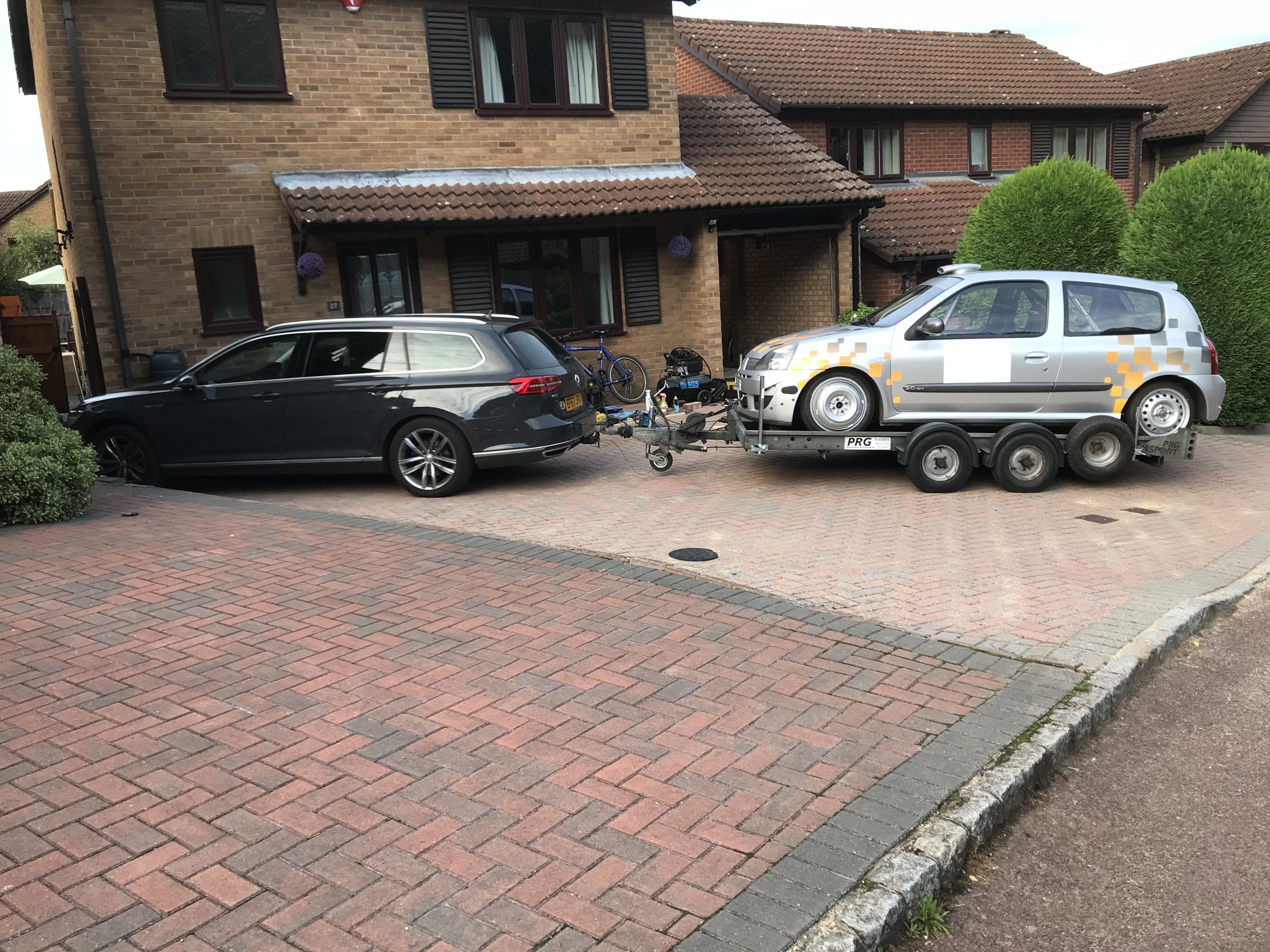

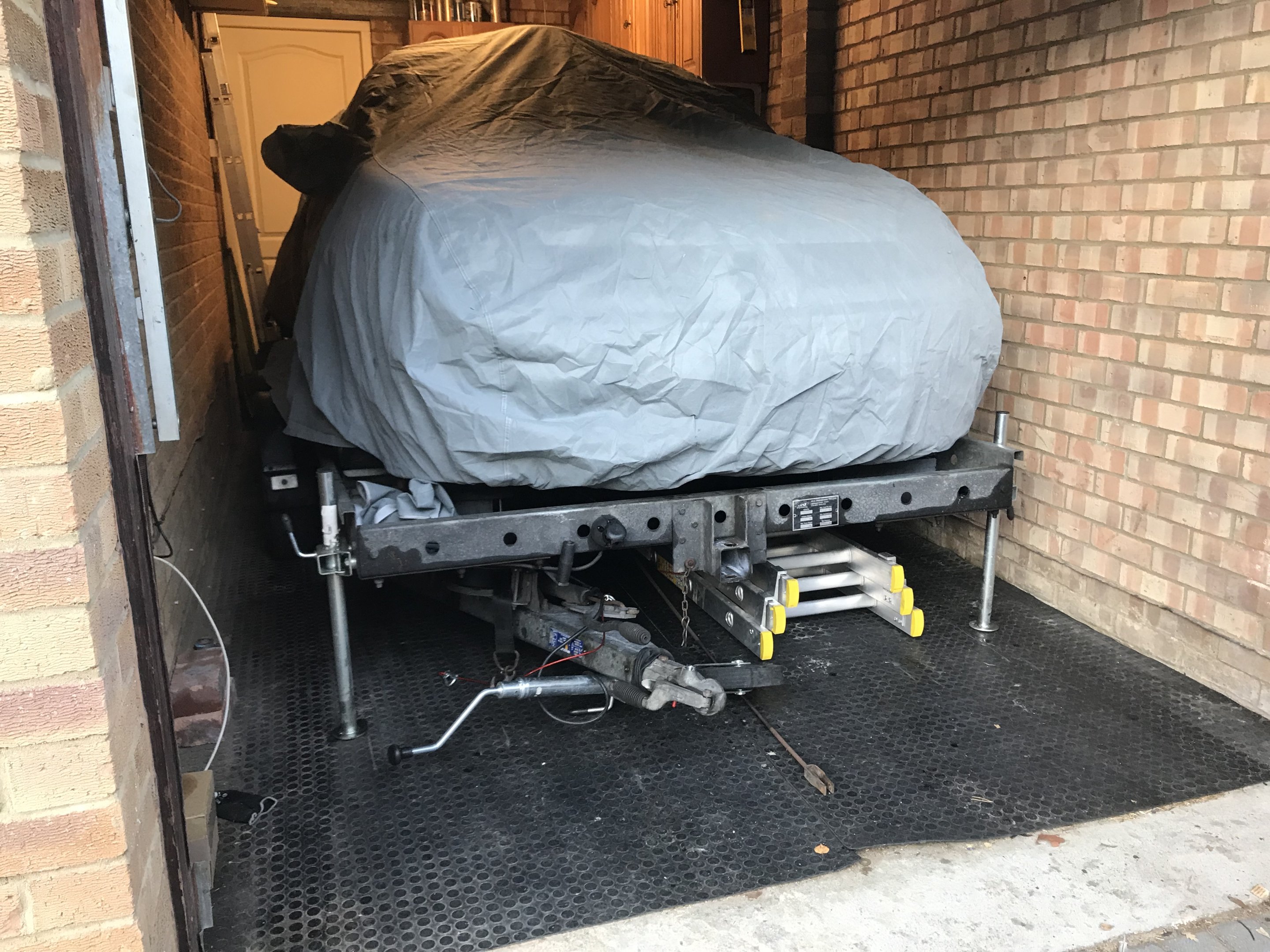

I bought the trailer back in February and finally it made it to my house!
Cut to the chase, the car is on the trailer and the both of them are in the garage, result! But it wasn’t easy.
First up I jet washed the trailer, mounted the number plate perminantly and fitted some stands to it. Then the moment of tuth. Edged the car up and then realised I had to make some mods. Firstly the canards had to come off. Then I had to remove the rear light cluster and ‘adapt’ some metal work. Also needed to run a strip of wood to lift the new front spacesaver hub over the end of the trailer. Then hey presto it’s on!

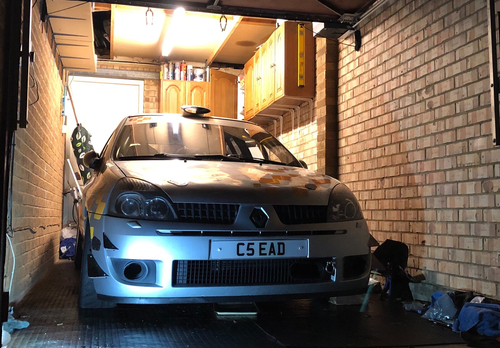

Then I got to revere the trailer into the garage with the car on it. Not easy but it’s in!
Going to fine tune the trailer by changing some of the bolts that can catch the cars wheel face to flat headed bolts. Permenatly fit the wood and rub down the wheels and spray them silver again.

Car is now on the trailer properly. I moved everything out of the garage so I can just back it in now and not removed the drawbar to shut the garage door.

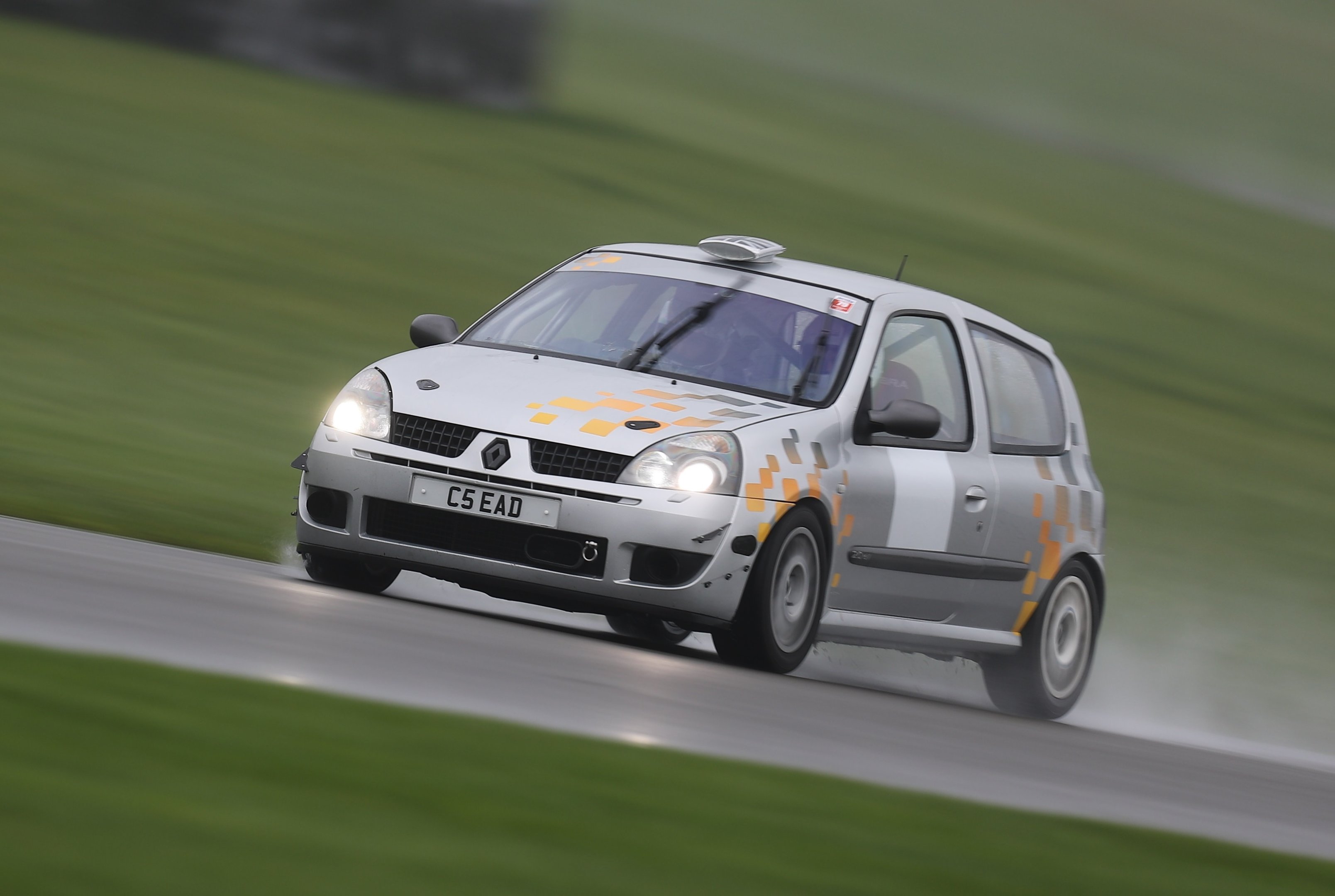

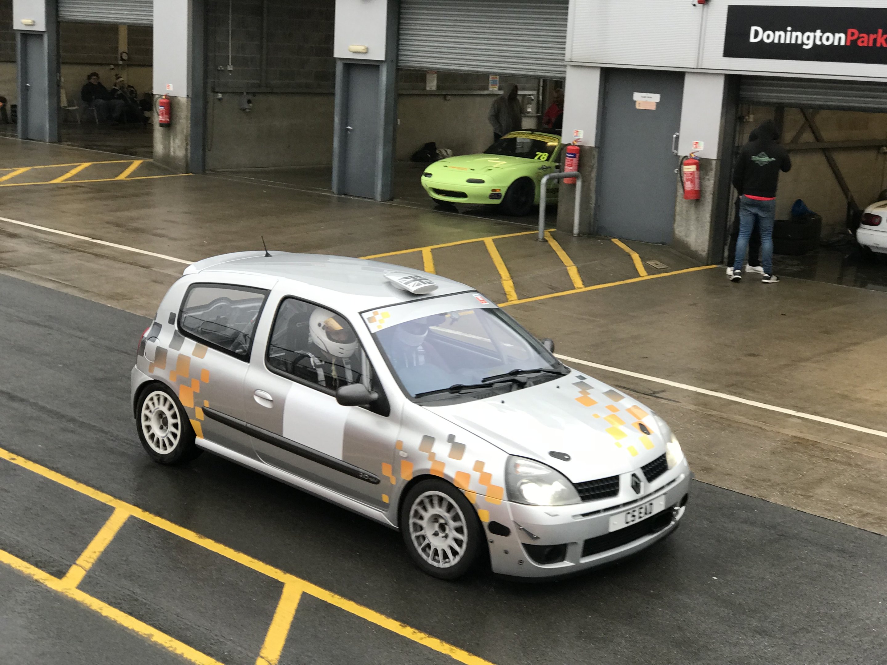

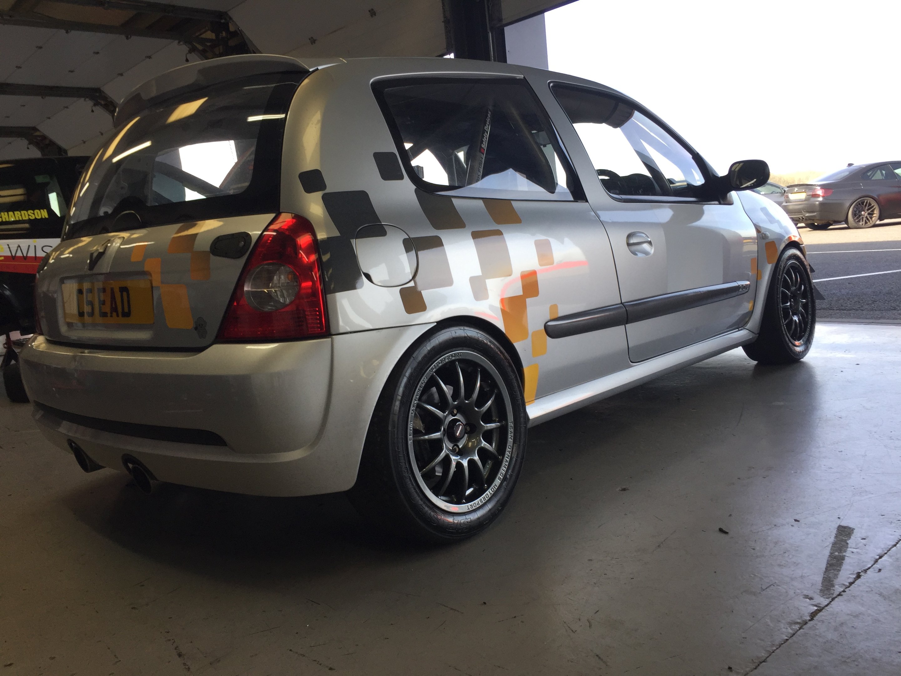

After an 8 month layoff. New brakes, new cambelt, new wheels/tyres, becoming a trailer queen from a road car, various other changes. The clio went on it first track day. It didn’t stop raining all day and the little clio performed faultlessly!!
Well happy with the changes but would like to try it in the dry!
First time at Donnington. Interesting track but again I would like to try it in the dry!
I’m back in love with the clio. Always puts a smile on my face
Nice to have some photos of it off the drive again ?

Official photos are in. Still happy reflecting what was a challenging day. I did film it but the footage isn't great as the road has reflected any form of light so you cant see where I'm going. Shame
As we're all Renault fans I'd thought a couple of photo of my mates 197 would be nice...................

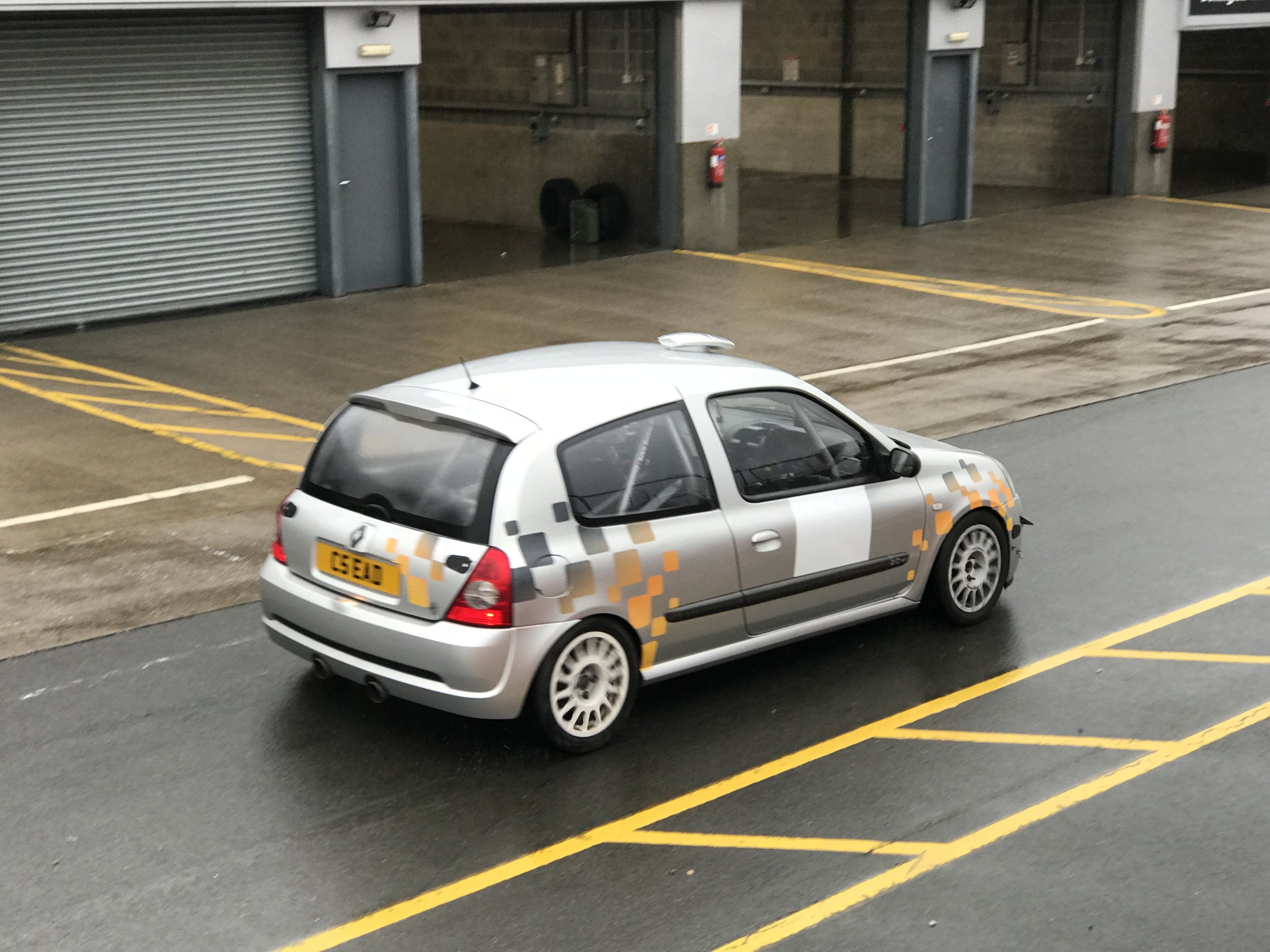

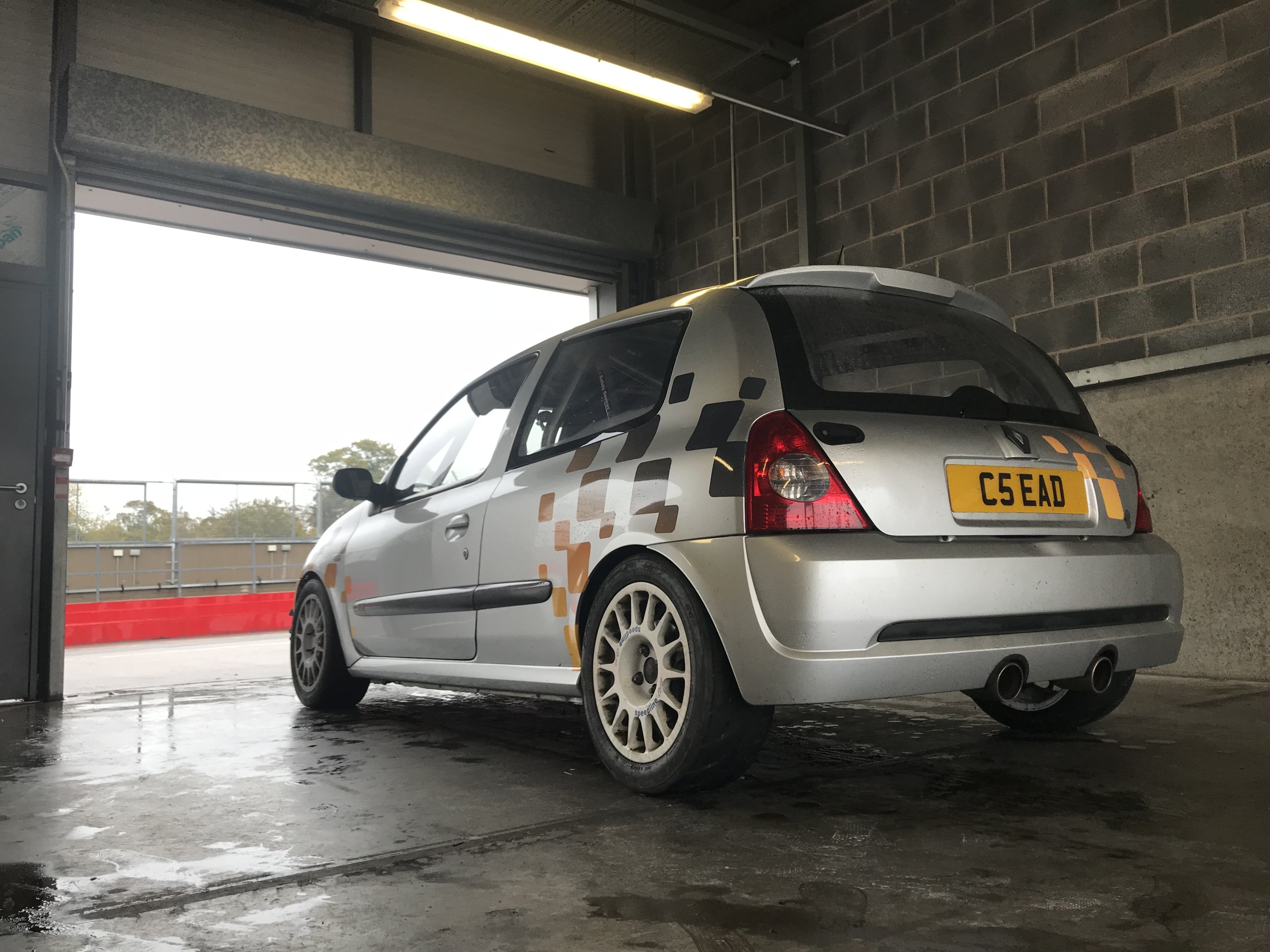

Donnington can be slippery when wet!

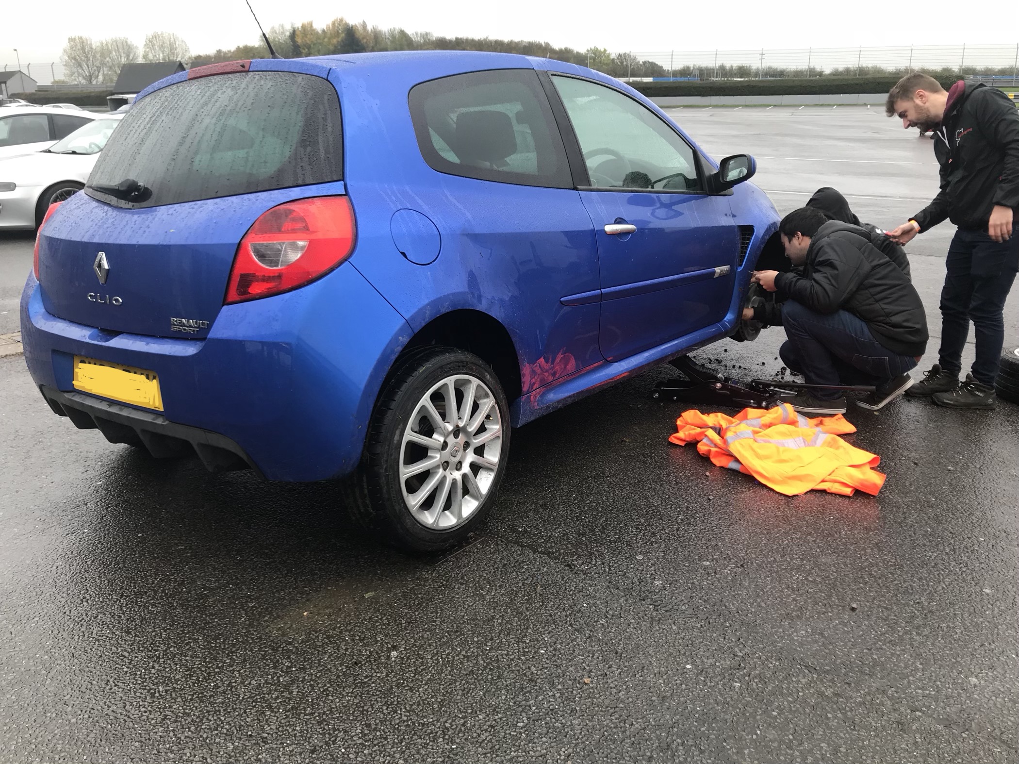

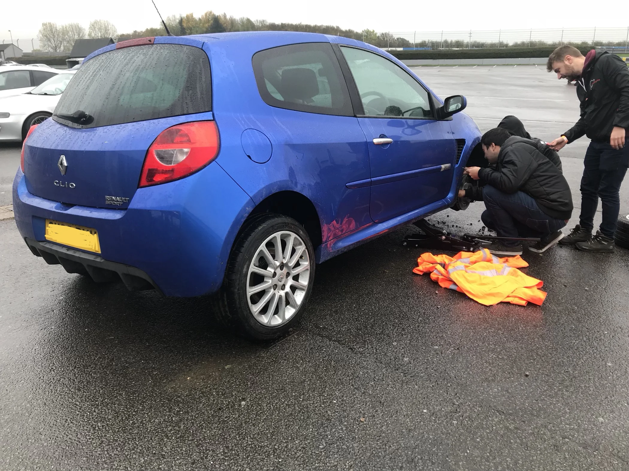

Oh s**t!
Was your mate OK?
Amazingly yes he was. Fustraited as it was the slowest crash in history. It literally tipped on its side when it dug into the gravel.
No scratches but a crease in the rear quarter and the mirror was knocked off. Lots of stones stuck between the tyre bead and the alloys. Once these were all removed and and the gravel out of the engine bay was removed he started and drove it around the block with no issues.
He managed to drive it home to Woking with no issues. Tracking will need checking. Unlucky to go over but lucky to arguably get away with it!

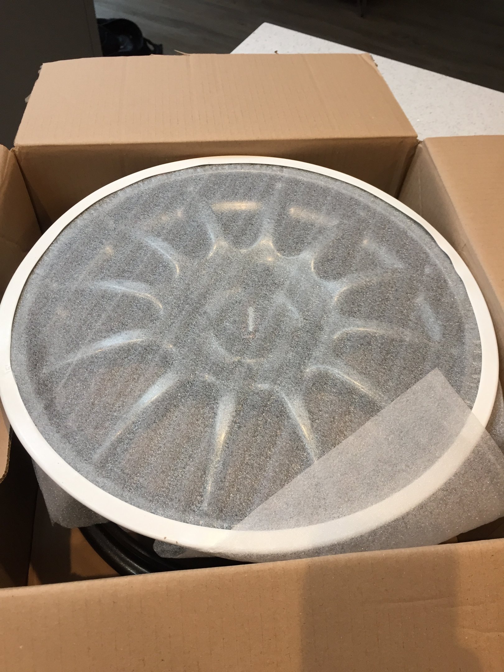

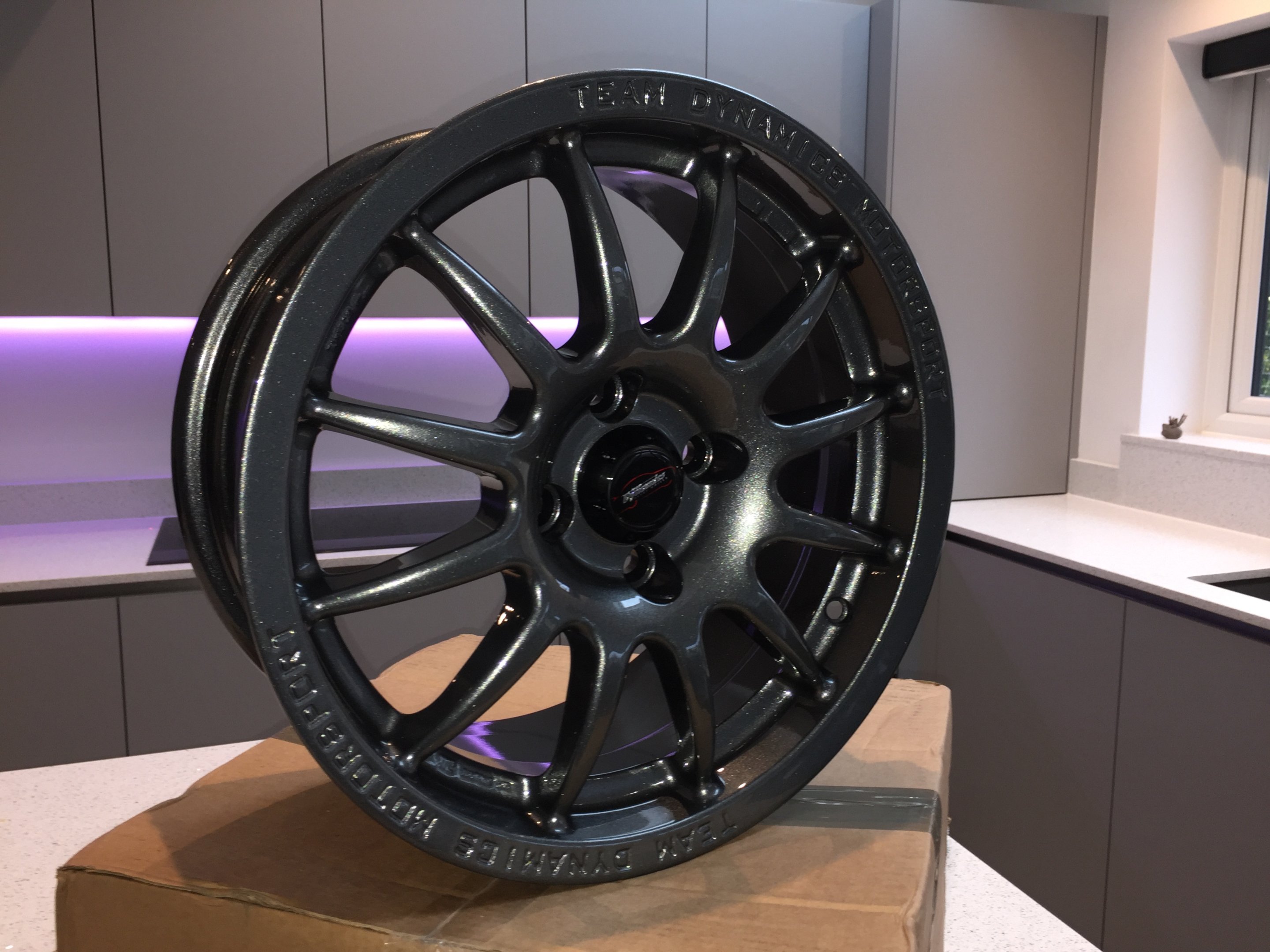

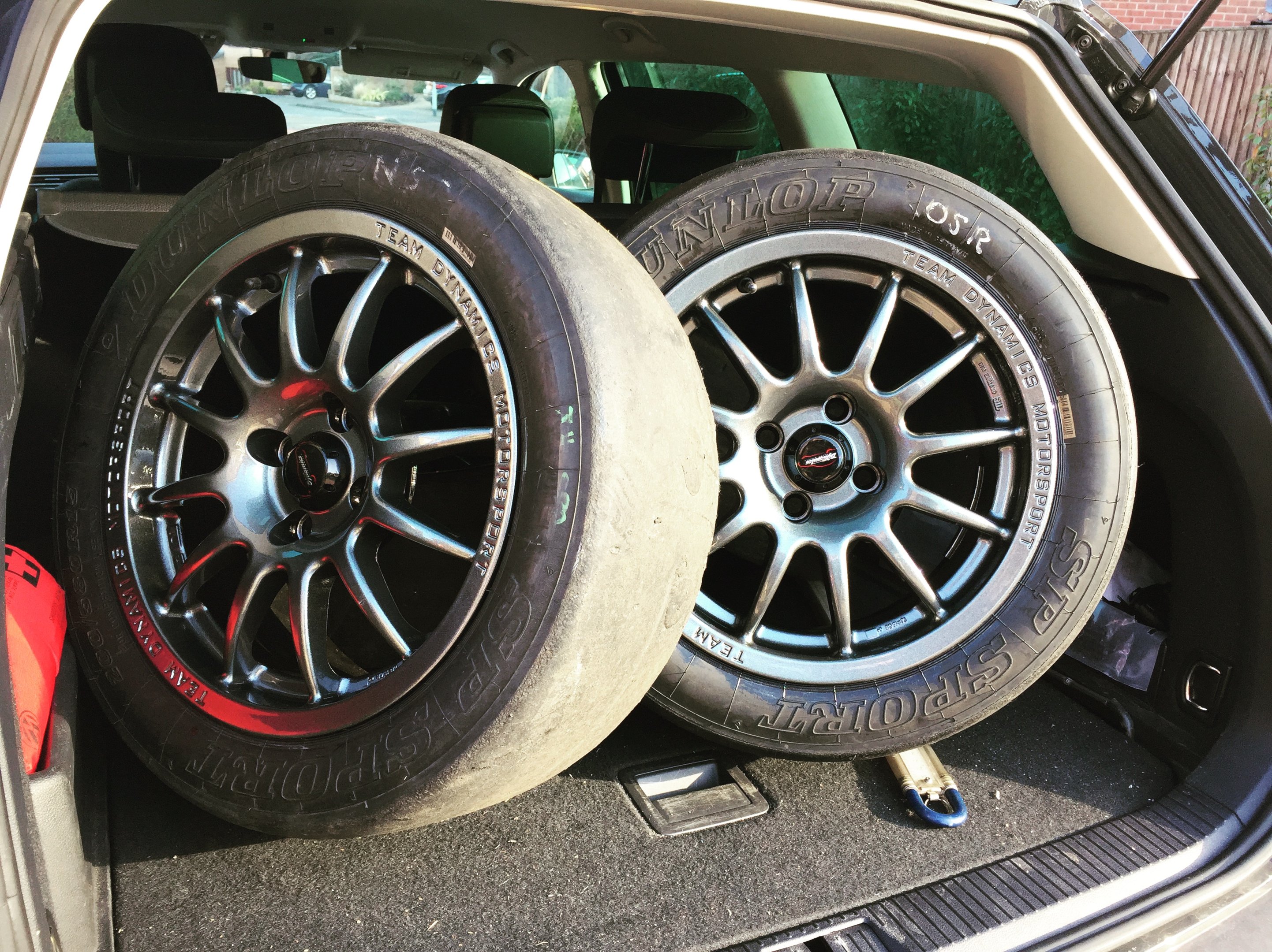

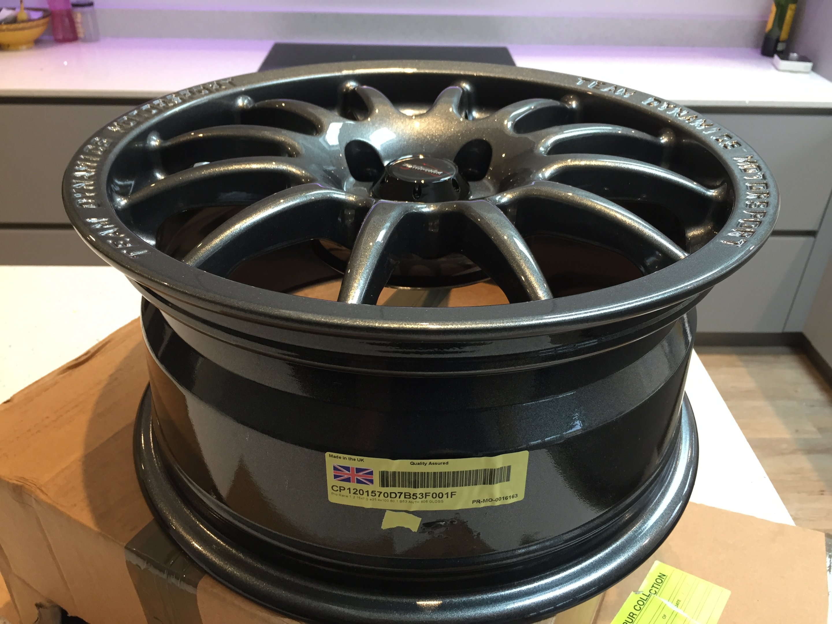

Thanks to an unexpected bonus from work I purchased a second set of wheels for the Clio.
I now have some brand new Team Dynamics pro 1.2 in anthracite. They’re brand new but managed to buy them second hand off of a guy on eBay. Came in the Rimstock boxes with all the protectors still on them.
These are going to have slicks on them. Just narrowing down the options on which slicks to buy.
Can’t wait to get them on the car to see how the anthracite works with the graphics. The 2118s will be refurbished soon and I need to pic a colour.......

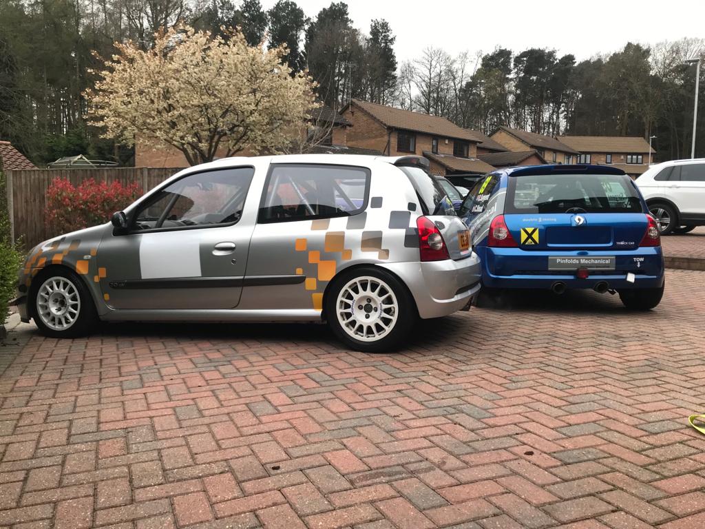

Title of the project and it’s been bugging me for a bit........ GF05LWT (or as it is now C5EAD) hasn’t made it to race car status. Problem is i’ve spent to much on it and my personal circumstances have changed. When I bought it I was self employed and it was easy to loose some bills in the company etc.
One of my biggest goals in life is to race a car before i’m 40. That’s Oct 2019. Soooooooooo............
I’m going racing in this one instead!!!
When I got the clio everyone thought I was mad. Now one mate has one as a road car and two others have bought race ready ones. The one above has just been purchased and is ready to race. In hindsight I should have gone this route aswell! We’re going to aim for the MSV trackday trophy 2019 hence two drivers (40 min race 20 mins each). Mates just completed their ARDs test. I was busy on that day so I’ll will book mine for Jan/Feb.
C5EAD isn’t going anywhere (unless someone has a manual 996 4s they want to straight swap?!?!? Didn’t think so......). If I enjoy next season i’ll aim to get it out soon or just use it as a trackcar. Run slicks etc as there’s no limitations on trackdays. To much time, effort and care has gone into it!
If anyone recognised the blue one please let me know. Cheers

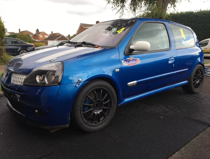

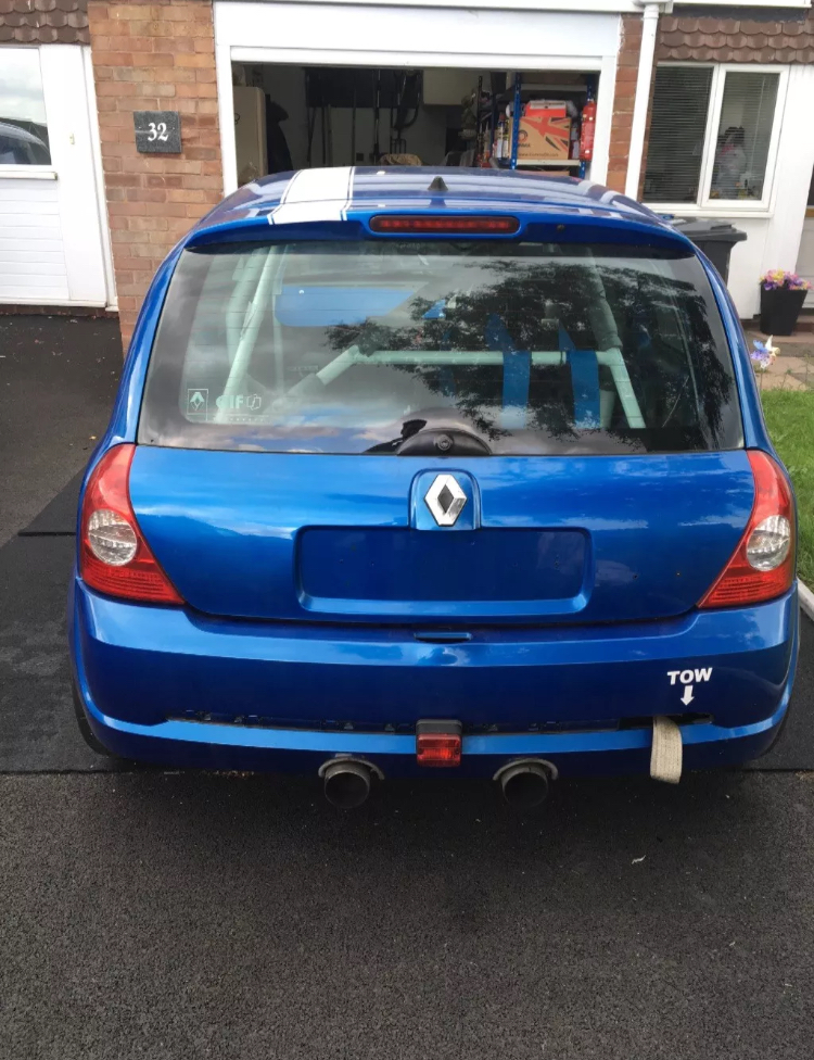

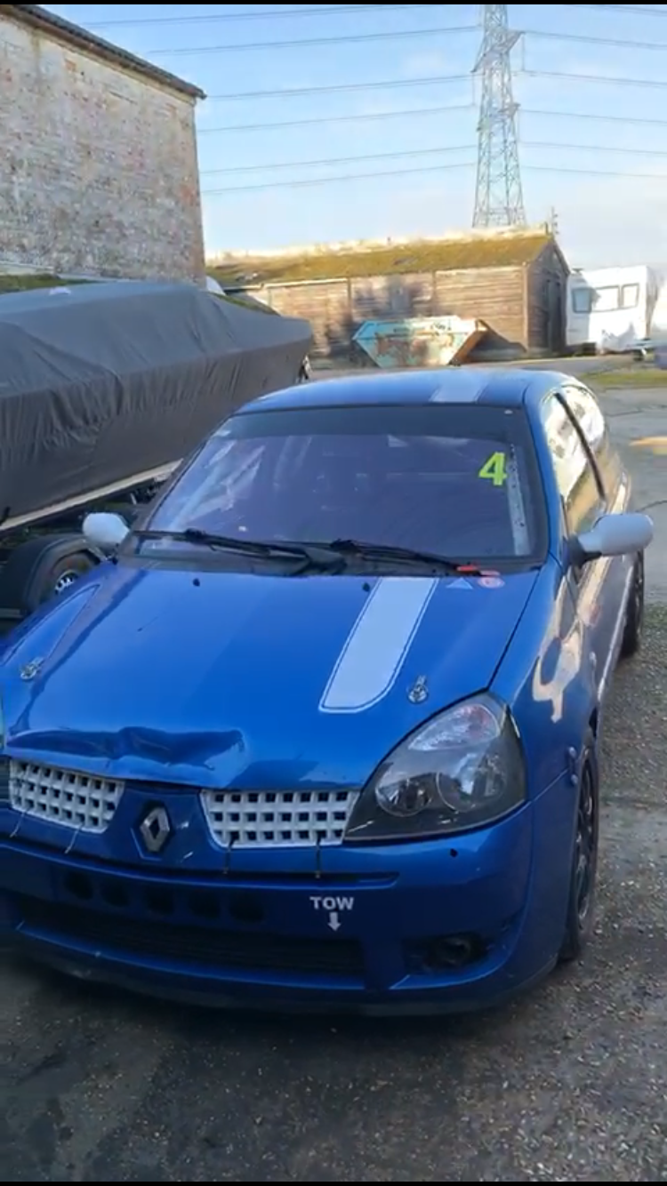

Blue clio update - looks like I’ve secured some sponsorship to help this year. This is great news! The clio is booked in for new belts etc. We’ve also bought some new harder springs for it (same as C5EAD). There’s a test day at donnington 4th March which we’re aiming for.

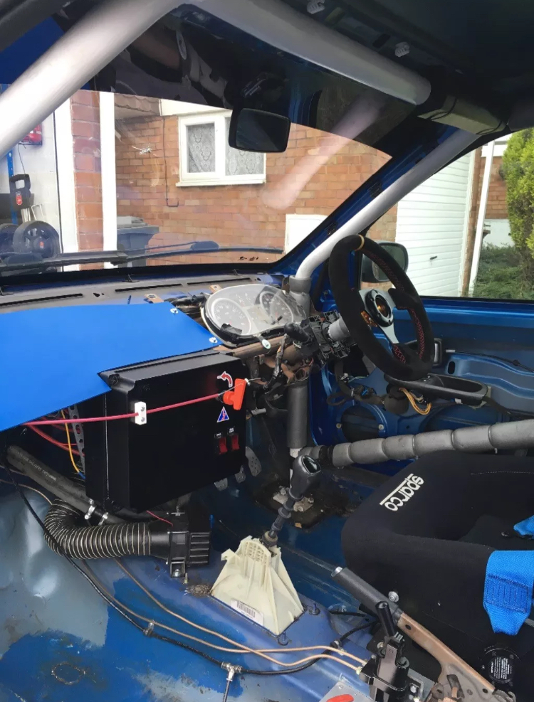

One of the biggest headaches is we need to rebuild the dash to enter trackday trophy. Lots of work for no gain!
Thinking of starting a new build thread for the blue clio and the trials and tribulations of first year racing. This ones for C5EAD (or the parts car as my friends have started calling it!). The blue ones not my car but a lot of what i’ve learnt with my car is influencing what we do with the blue one.

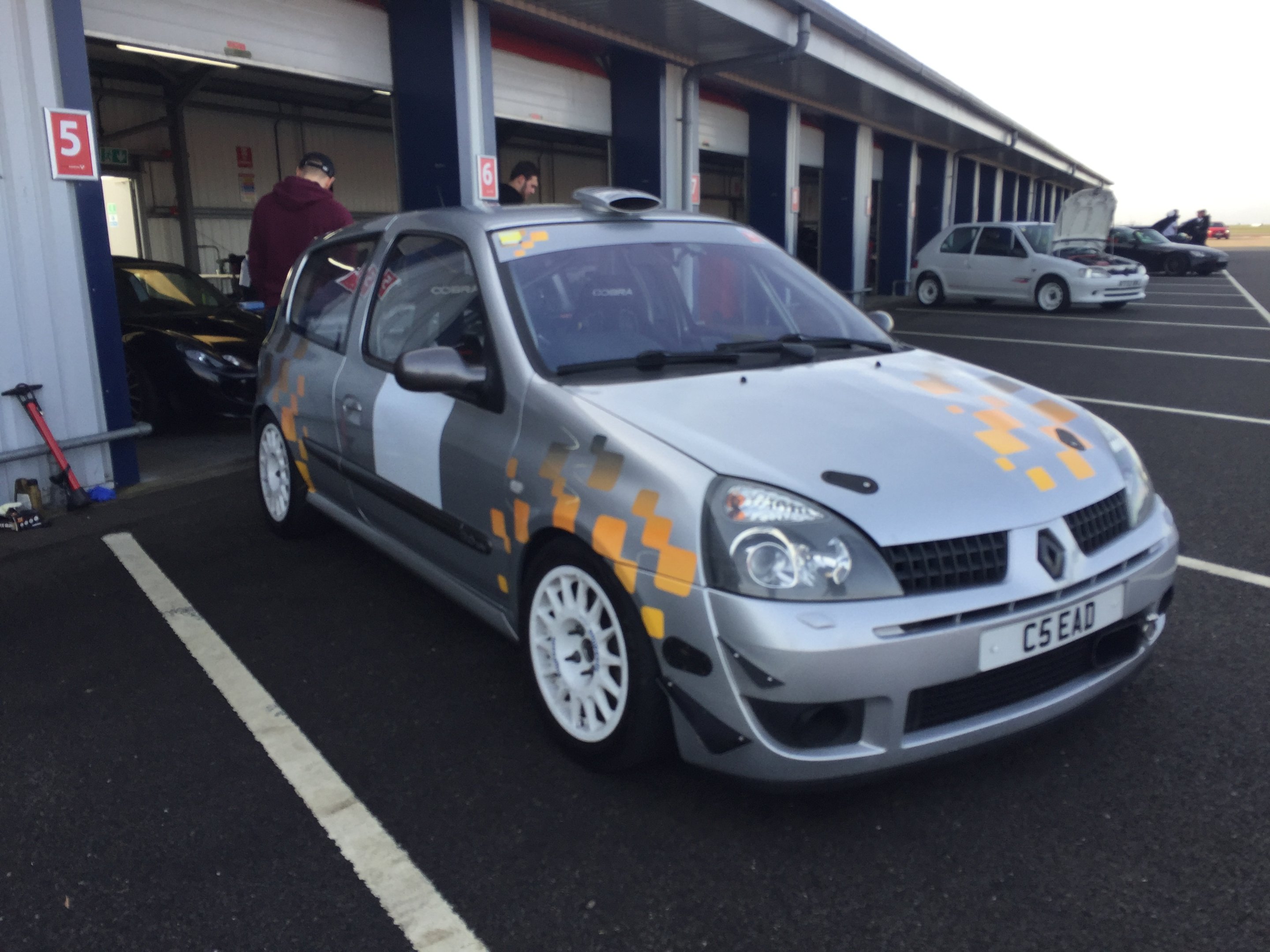

C5EAD - dragged it out of the garage for the first time this year. Charged the battery and it fired up with a second! Not bad as it last run in October. The weathers looking good and there’s no puddles of liquids under the car so i’ve booked Bedford for a week today (22nd Feb). Looking forward to enjoying the new set up in the dry!
Not going to lie some dark thoughts have gone through my mind with the future of the car but at the end of the day it cost me £0 to keep in the garage so it’s staying for now. I’m well over due a good day out in it!

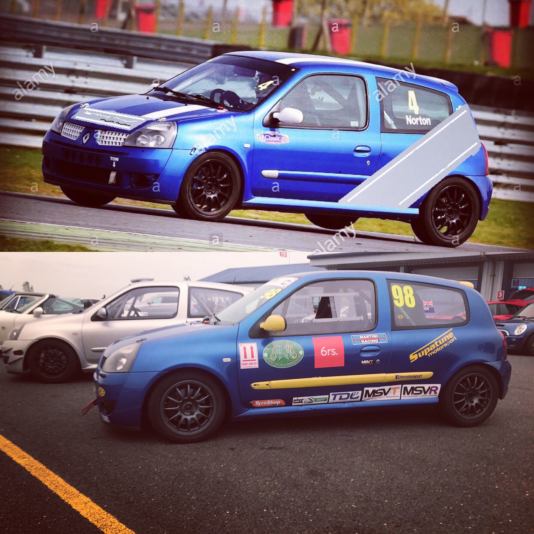

Team ‘double S racing’ .........

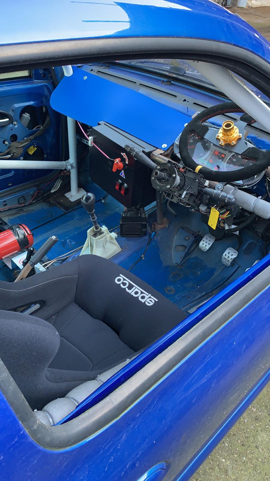

Is officially entered into the MSV Trackday Trophy. Blue Clio is off for belts change, spring change and alignment this coming week and then we’re booked on to the pre season test at Donnington 4th March.
We’ve managed to secure some sponsorship so here’s a little tease of the new graphics. I’m using the same guy who put the ‘yellow dots’ on C5EAD so it should look good!
If all goes to plan first race is 7th April at Donnington.
The two team cars together (blue/yellow car is team Auto Solutions)
The dream is becoming a reality........

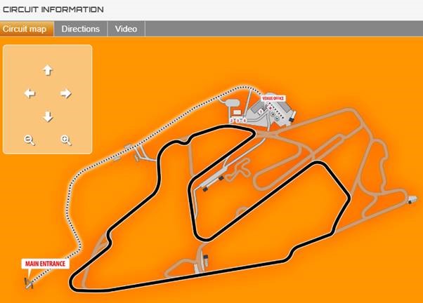

Also we are going to be running two different tracks at Bedford. AM - West circuit, PM - Full track. At first I was a little let down but now I'm excited. Two different tracks for the price of one!

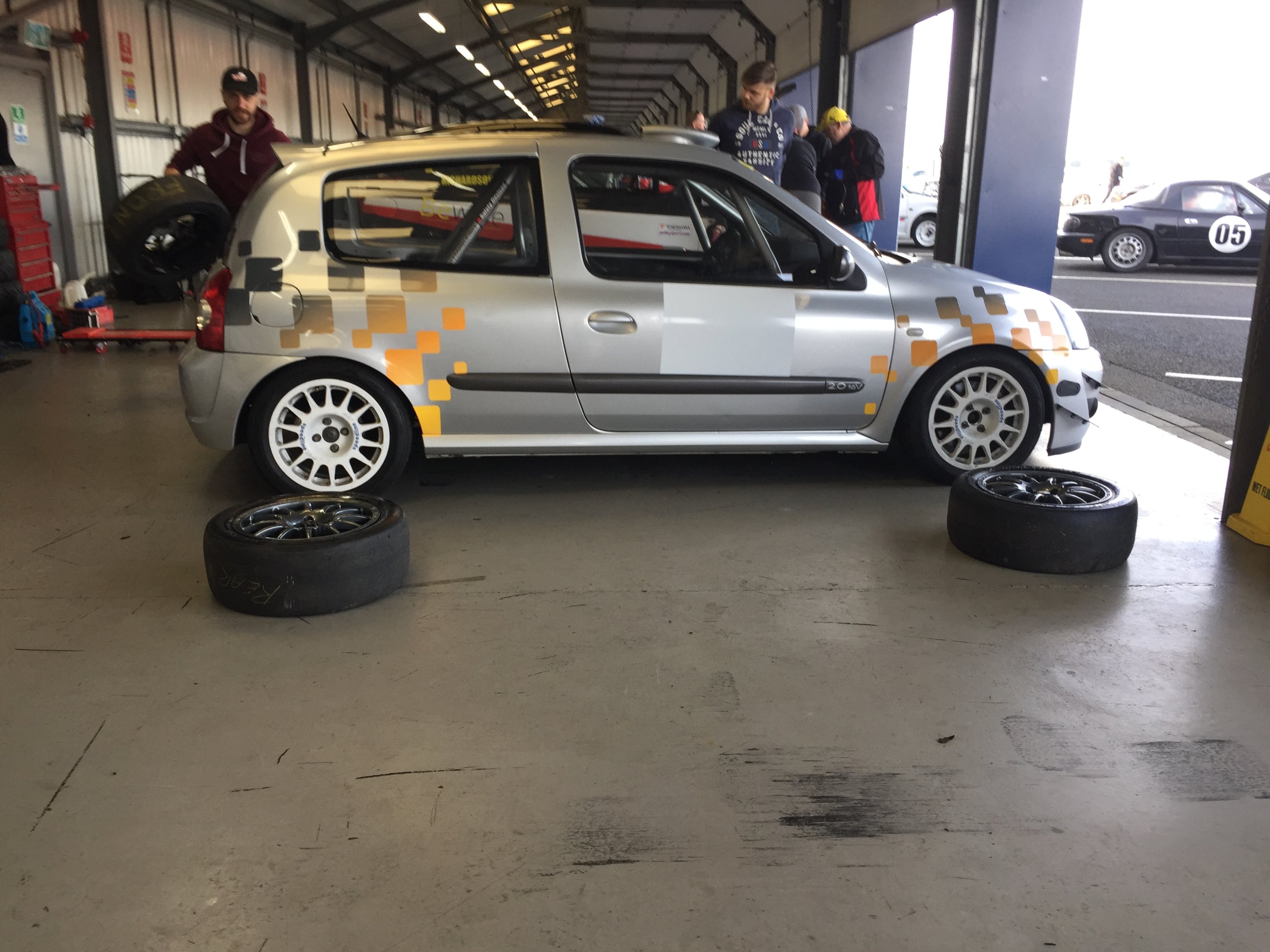

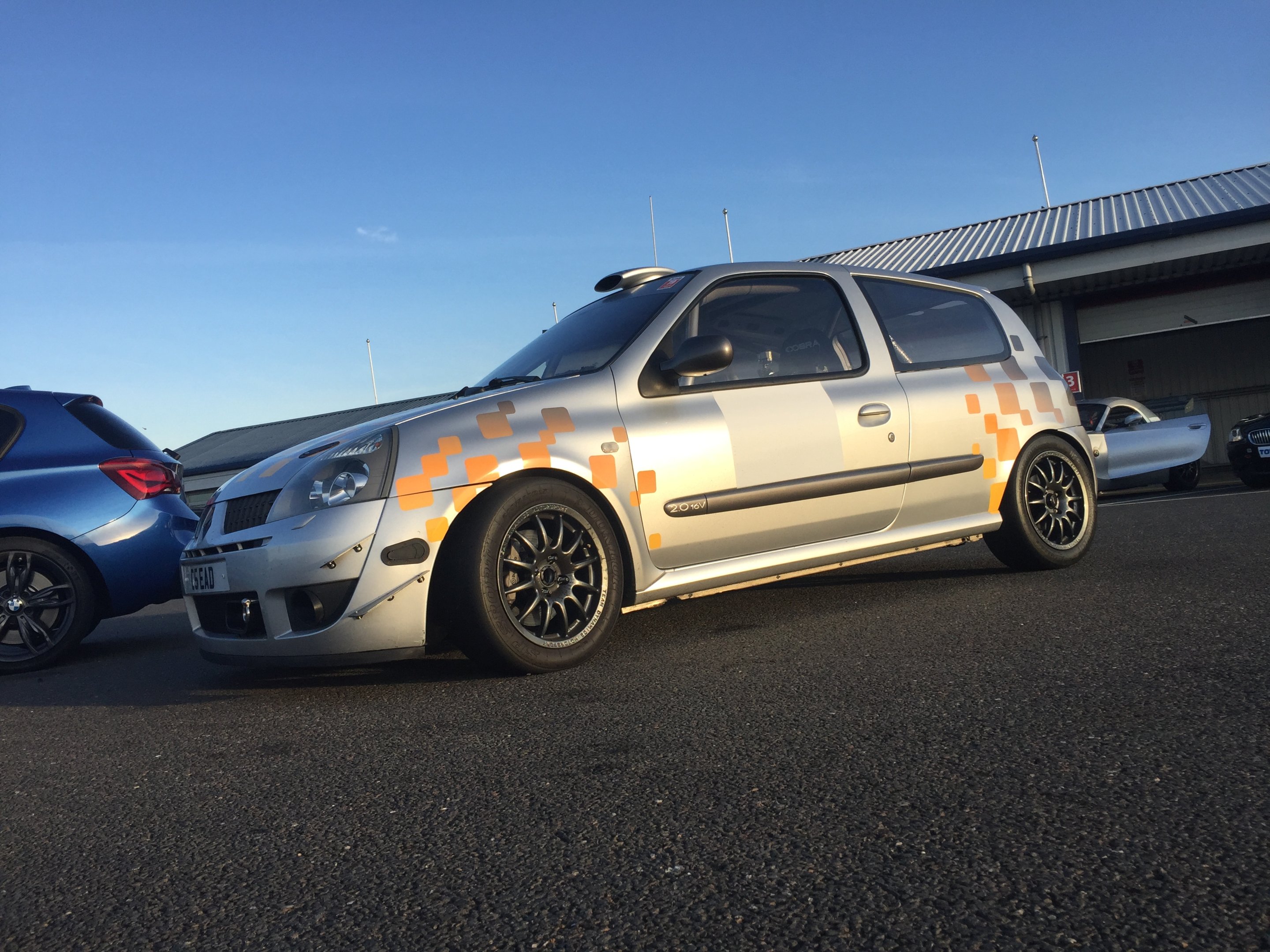

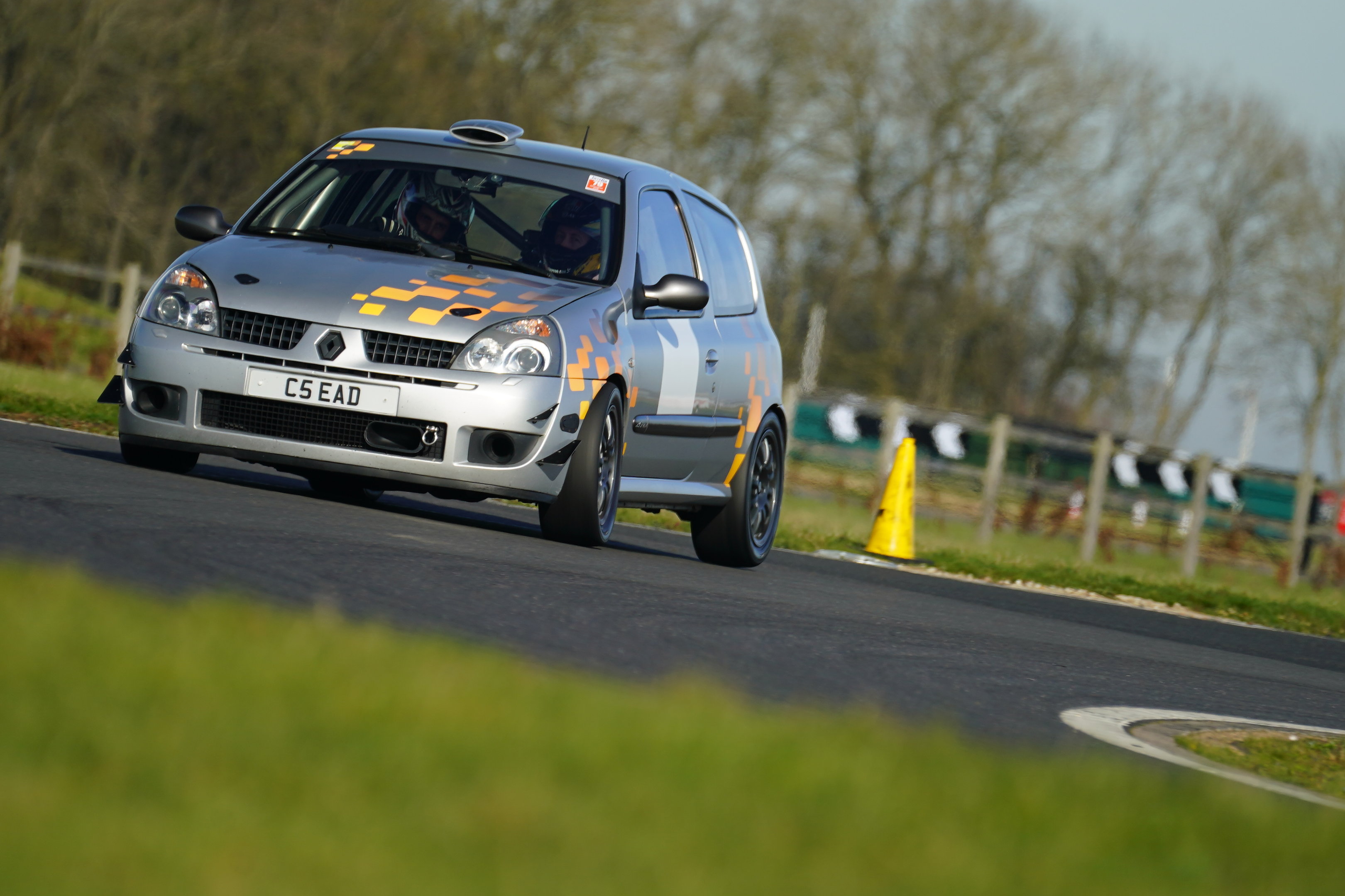

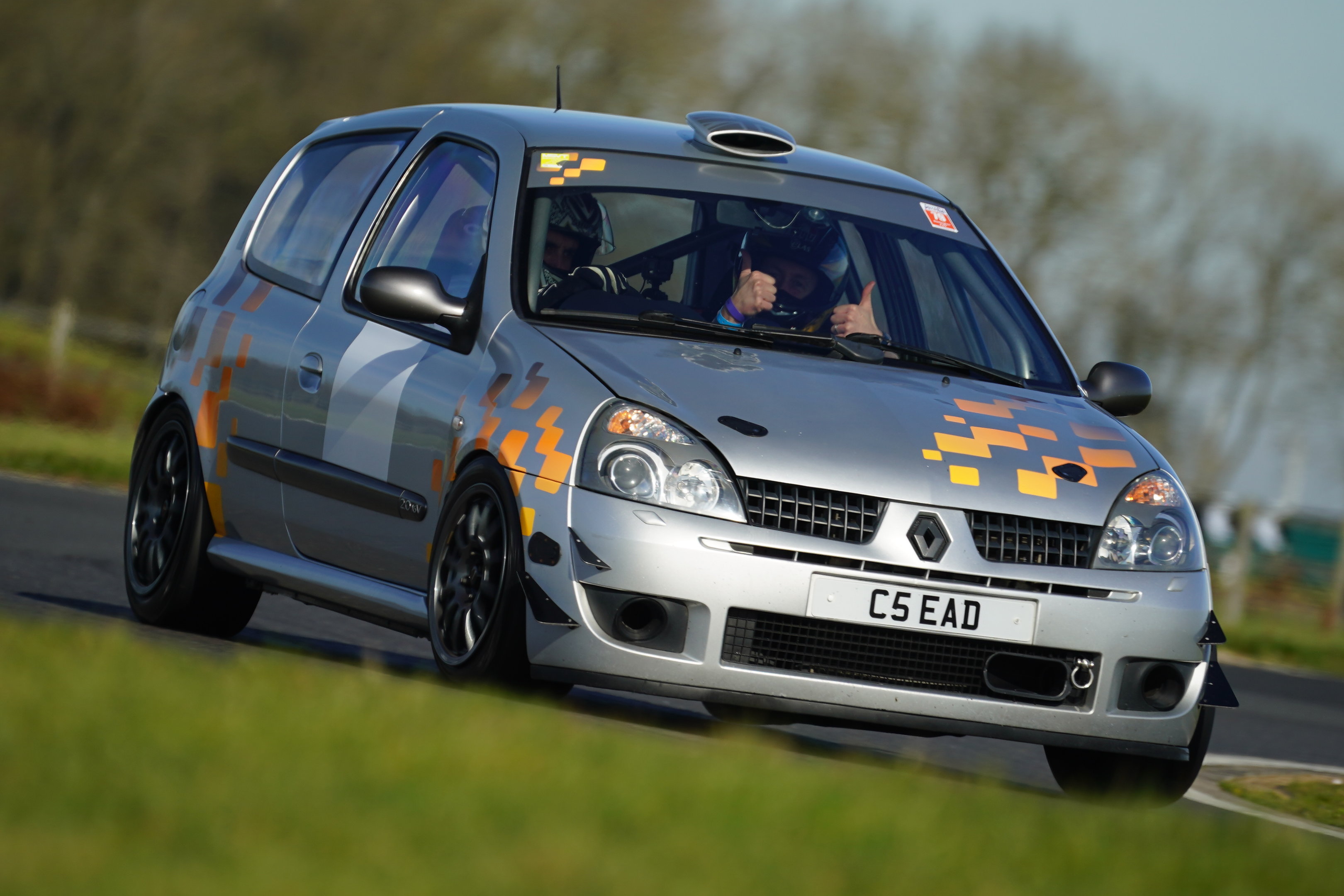

Had the 'if Carlsberg did trackdays..........' trackday at Bedford on Friday. Weather was perfect and the Clio was perfect!
Remembering the car hasn't even been off of the trailer since October I did the sigting laps and then checked over the car. All was well so off we went on the 888r's. First time in the dry with these tyres and 15' wheels. Already I was over the moon with the car. Better balanced than before and more on the nose. No issues with brake clearance etc.
1407689
1407690
Second session out and I ran a bit wide on one of the back corners and spun. Was entertaining!
Car was fine. Went out again and then it was time to grow some and bolt on the slicks! I swapped them over when the converted the track from GT to West circuit.
1407692
1407693
So off we set, to my amazement there were no balancing issues with the second hand tyres and within 1-2 laps we were up to speed. The difference is amazing particularly under braking. If you can buy some slicks, for £100 its an amazing performance upgrade.

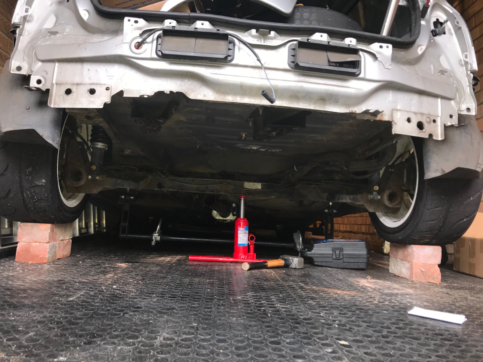

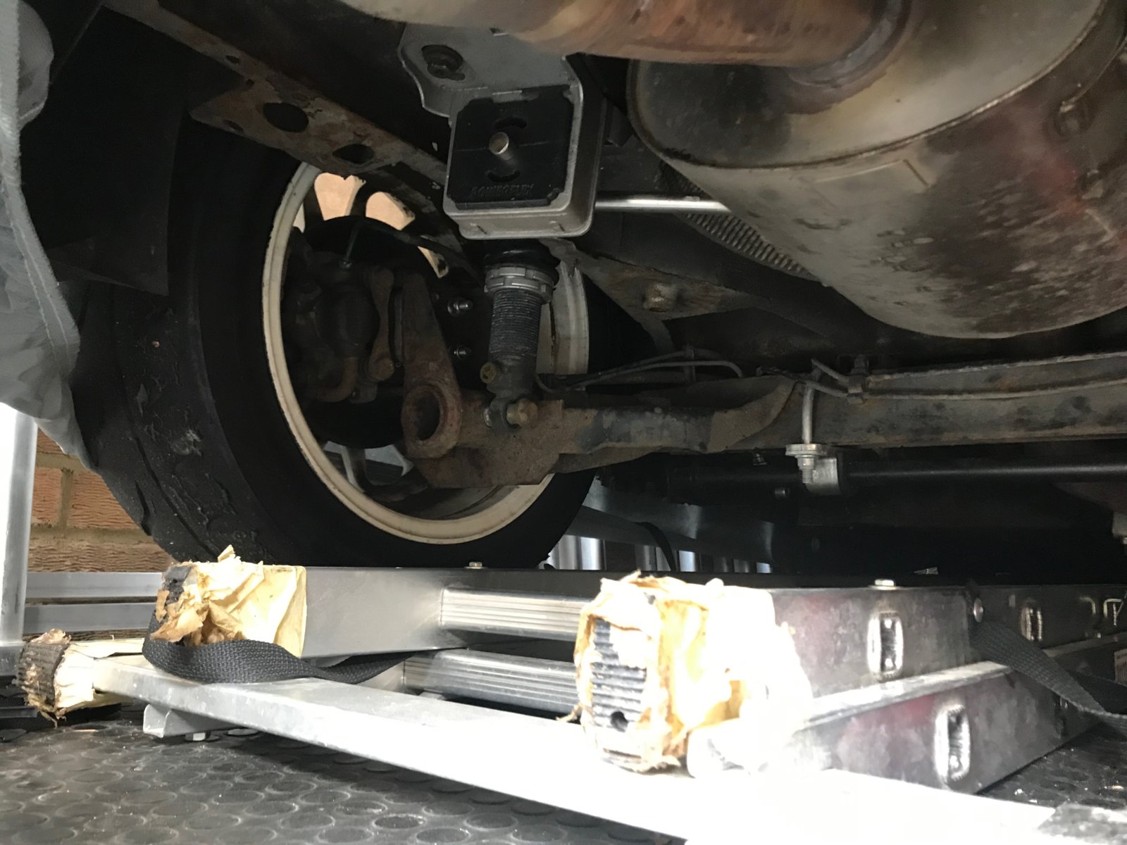

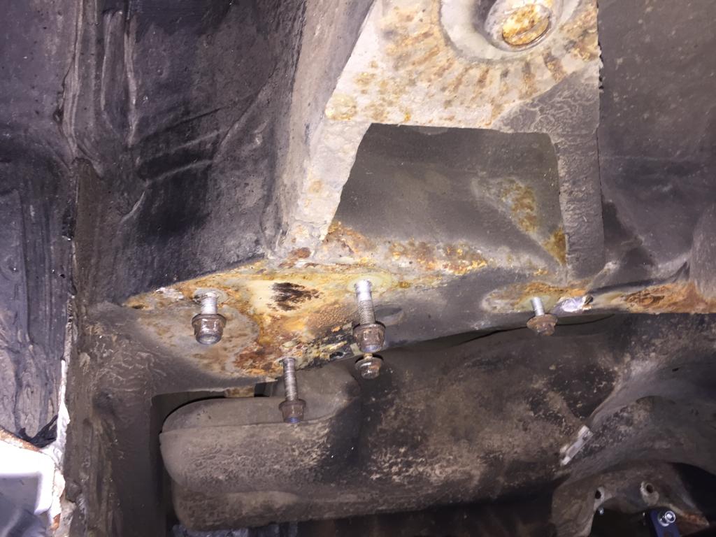

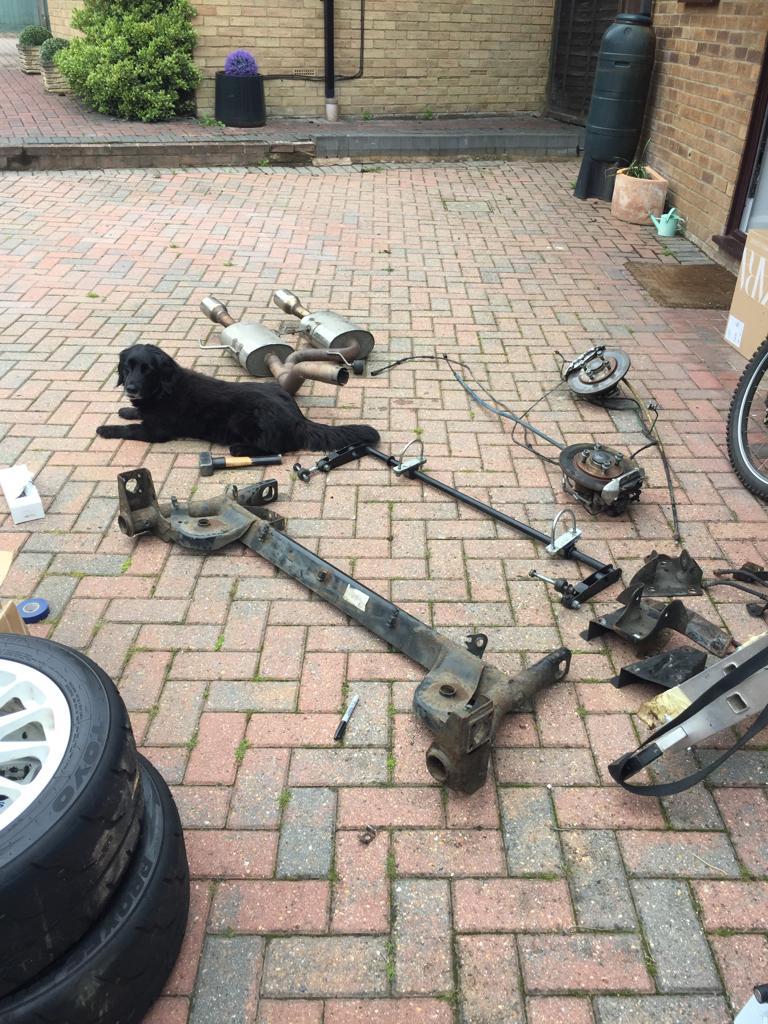

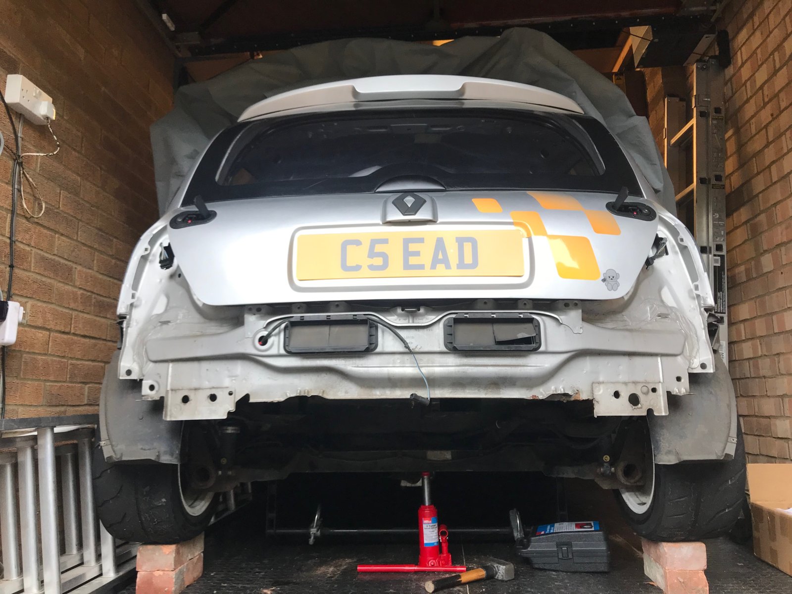

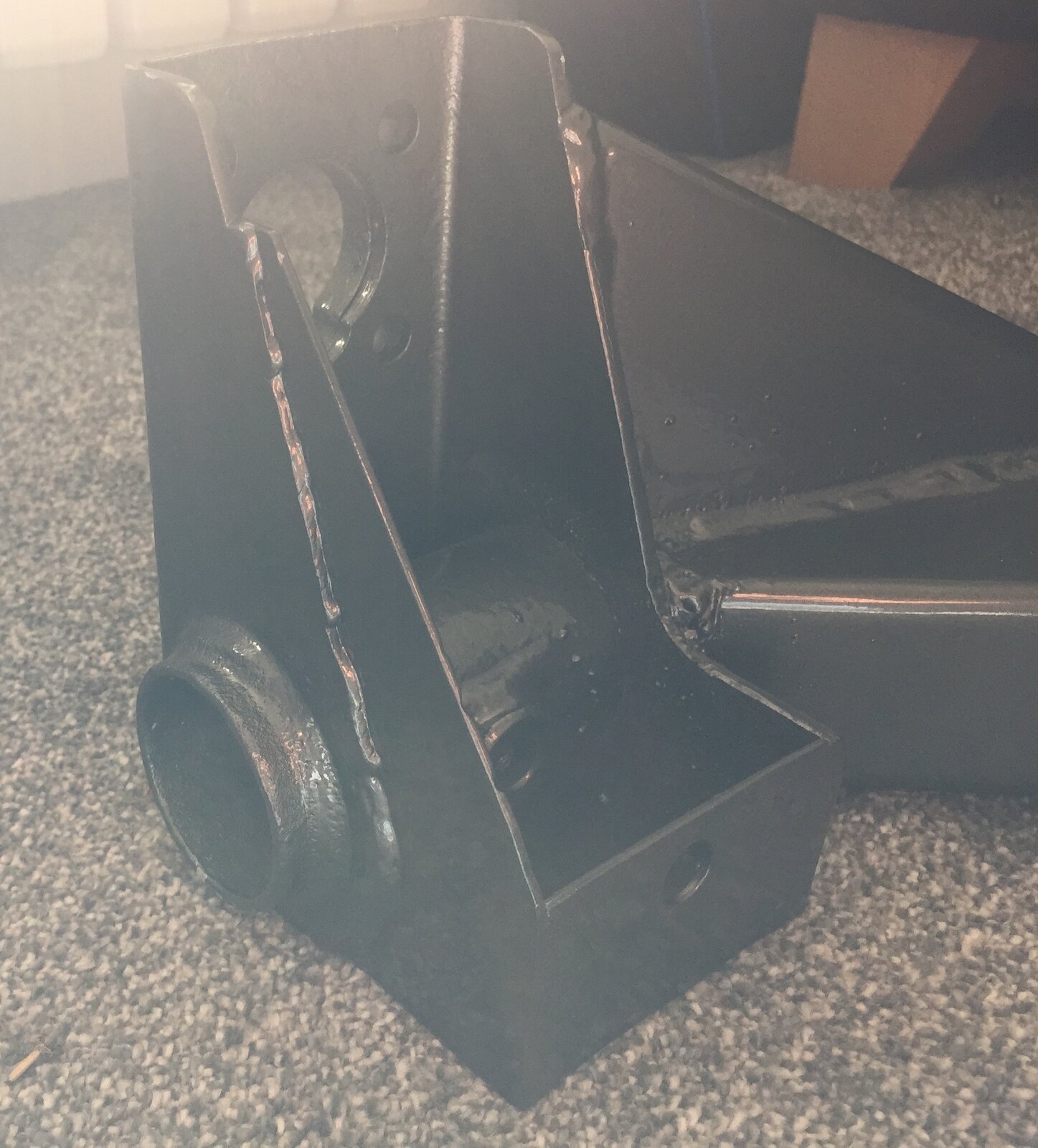

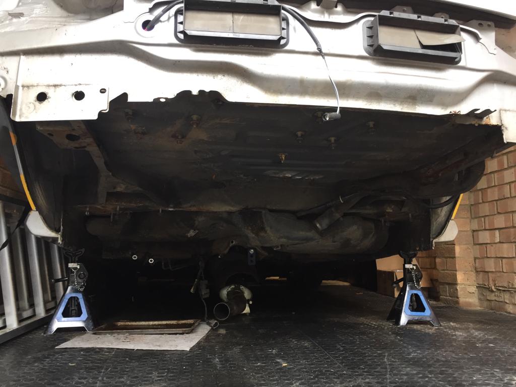

The rears all apart now. I think this is one of those small jobs that will result in the car being off the road for some time as there's more and more I want to do. Turns out there's lots of orange bits but nothing to bad.

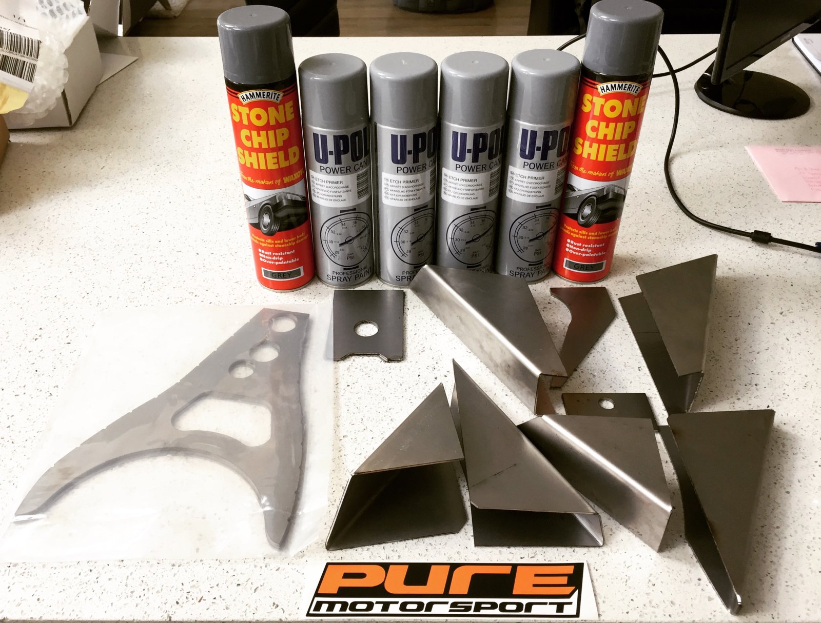

Time to order the strengthening kit and clean up the underside ready for paint.

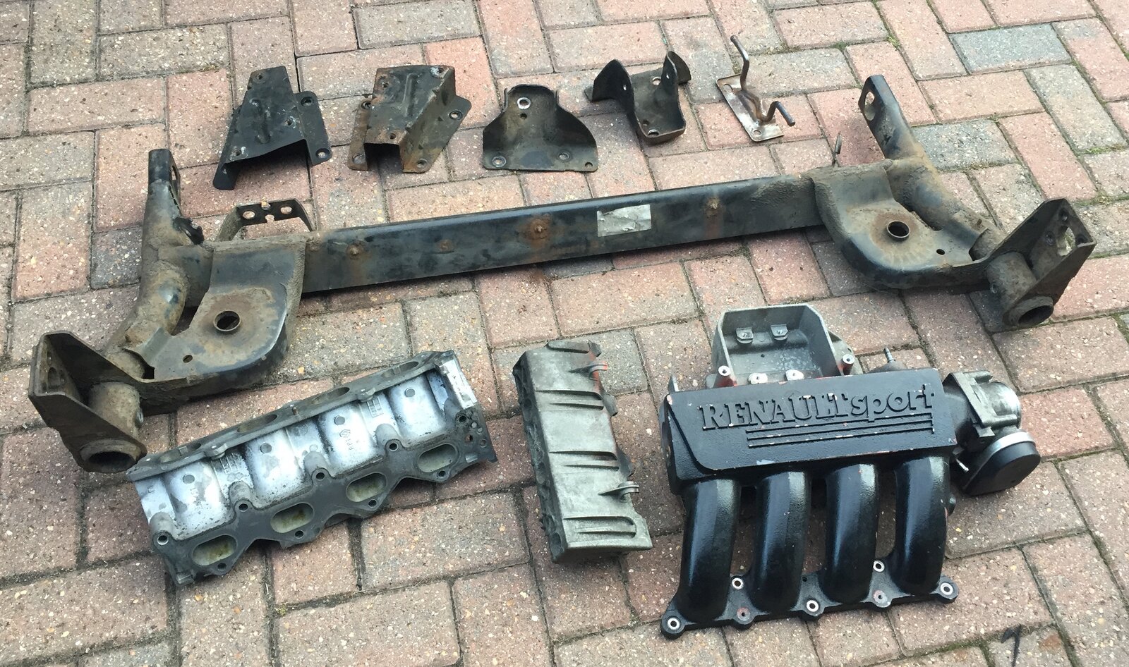

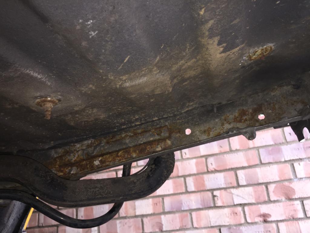

The bits arrived from PMS. I’ve arrange who is going to be sandblasting, welding and powder coating them. Whilst the bits are there I will also be sending some other bits to gain a few ponies for the first time. More to come on that.........

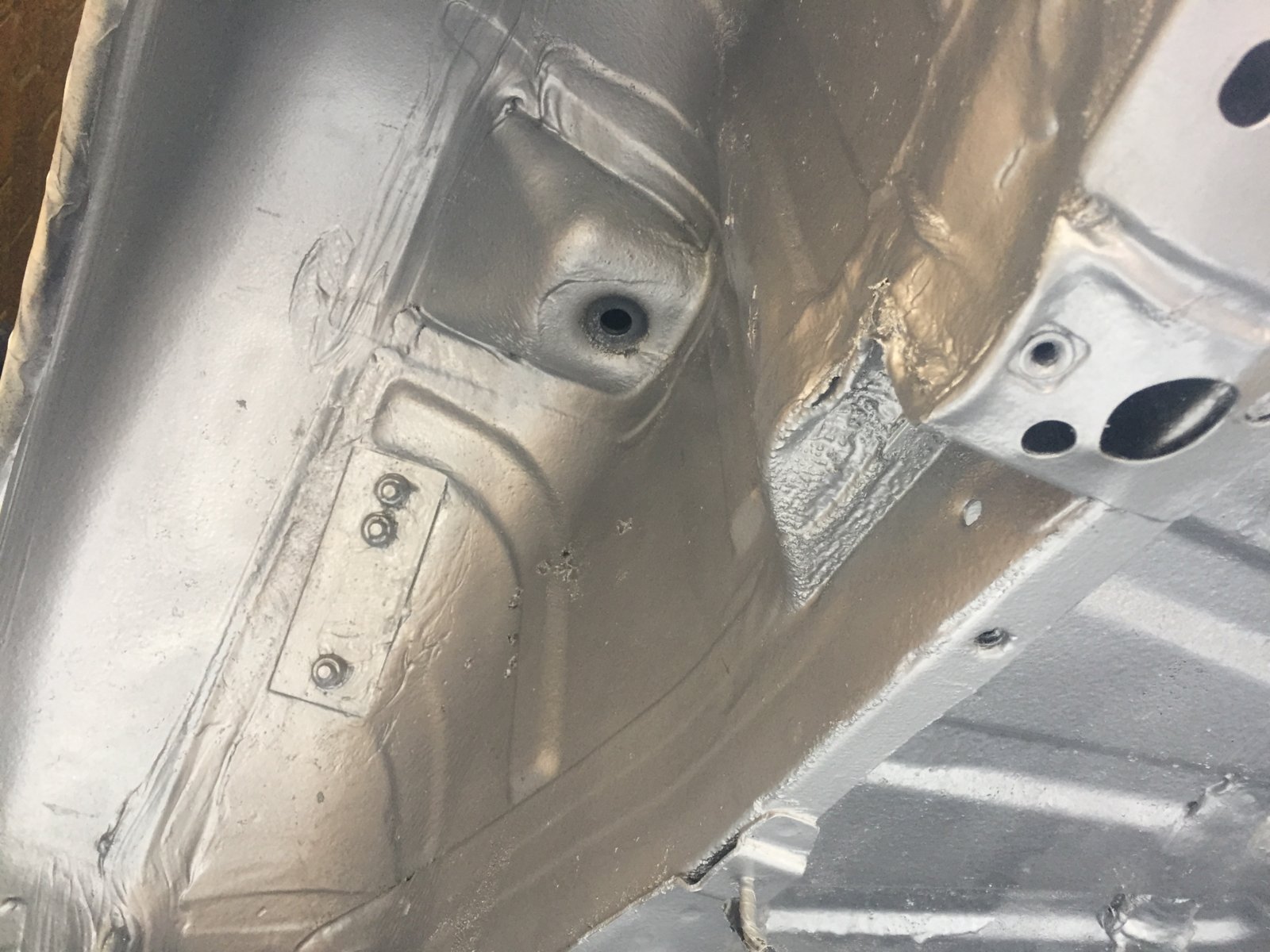

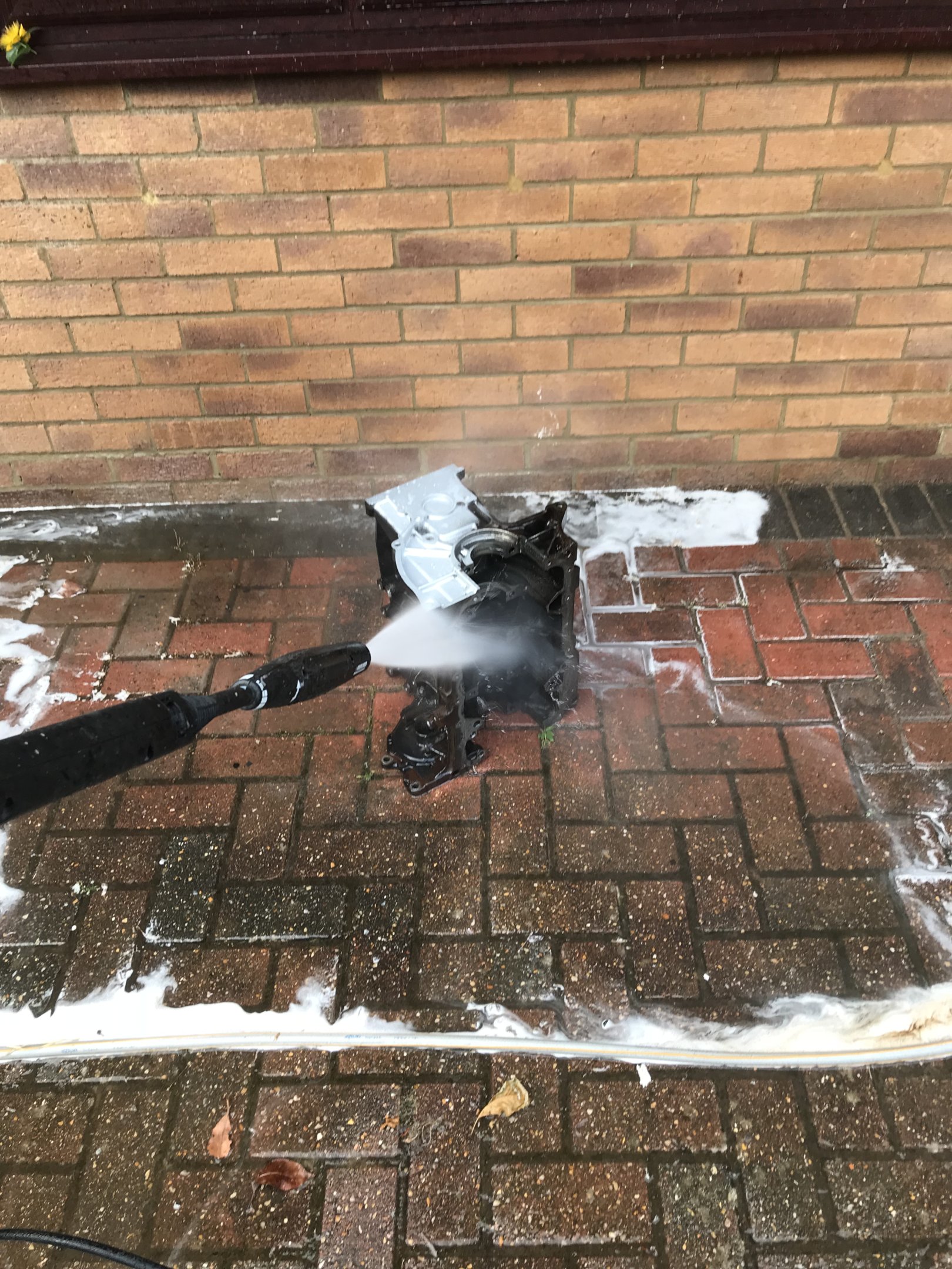

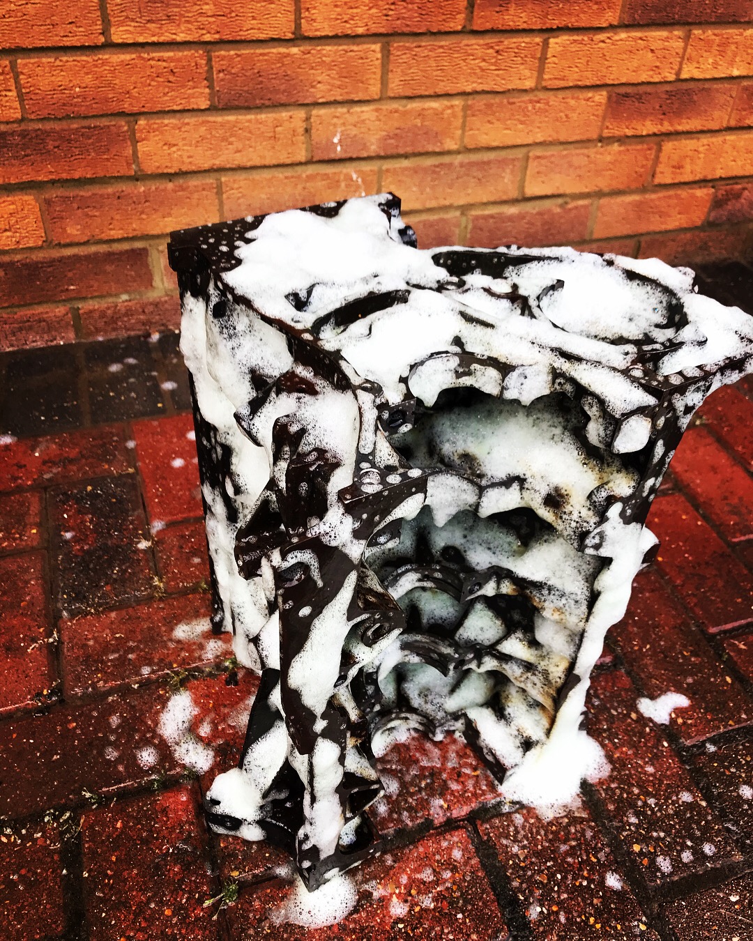

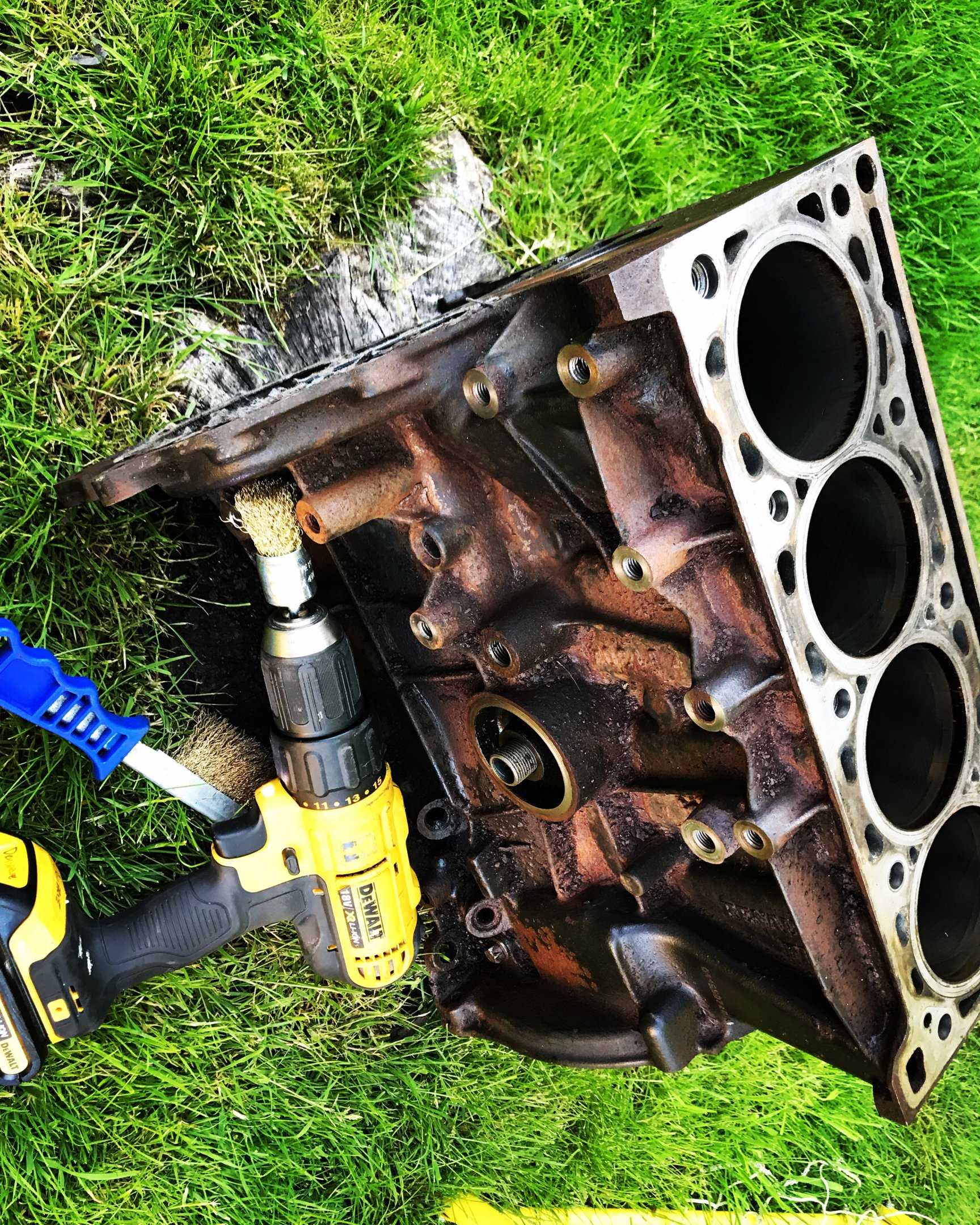

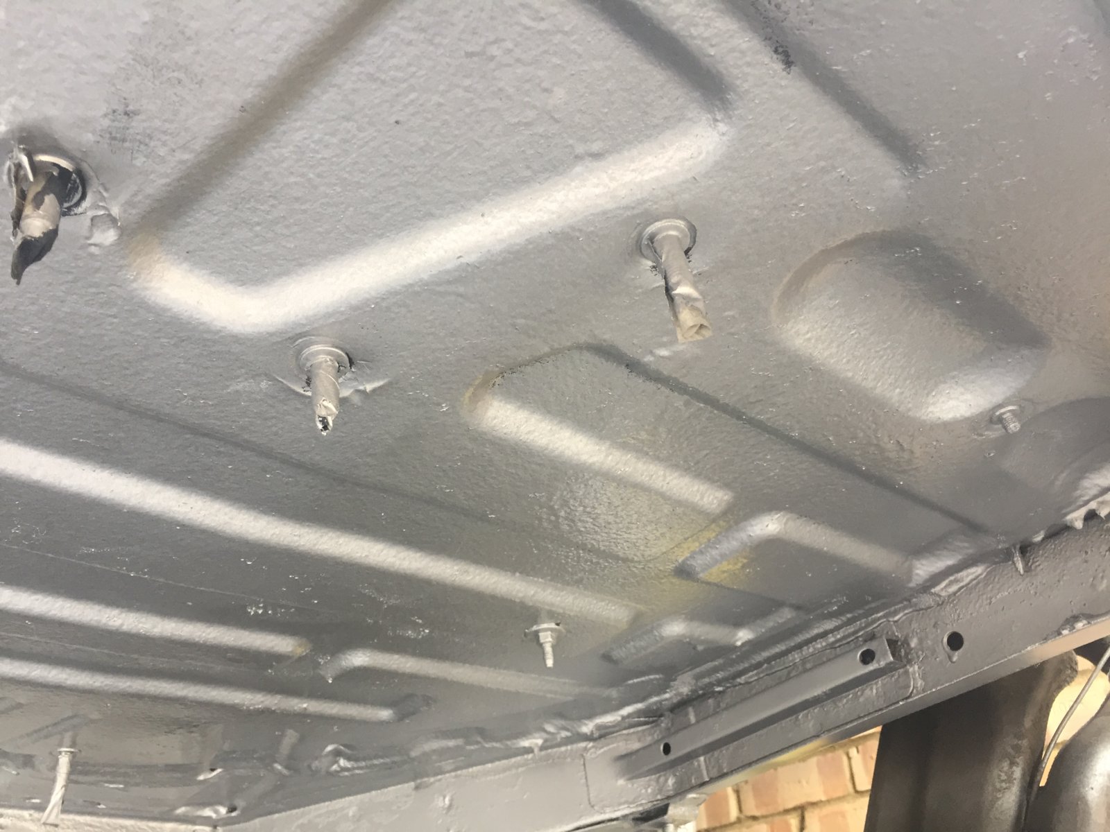

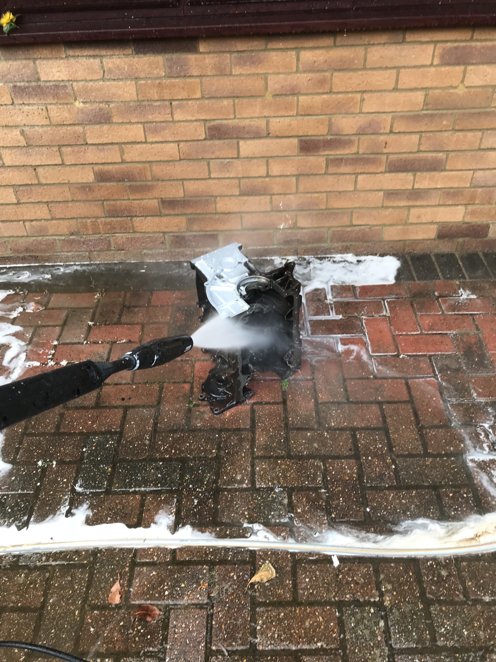

It’s a crap job but I had to make a start on cleaning up underneath. I’ve spent many an hour under the car removing all the old mud, crap and rust. It’s easy to get carried away but it’s a track car and no concourse restoration. Hopefully we should get a few more years out of it.

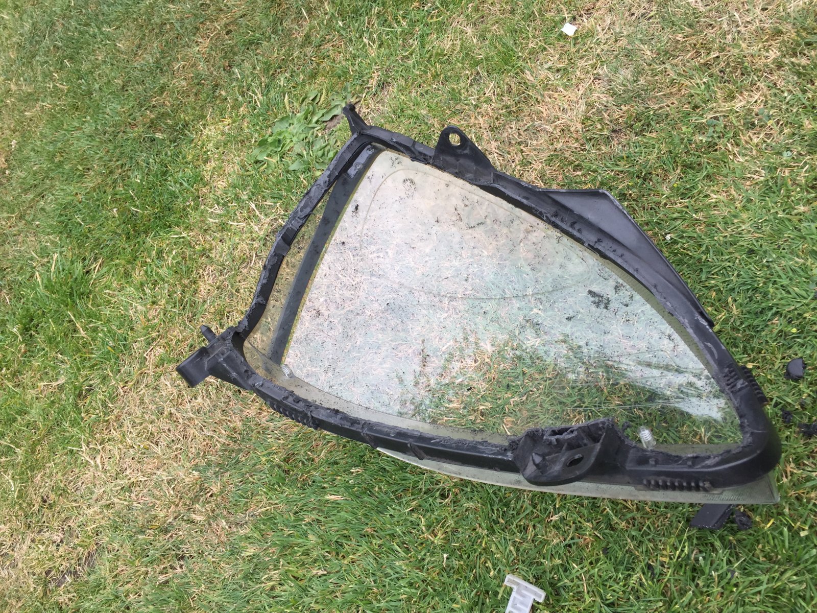

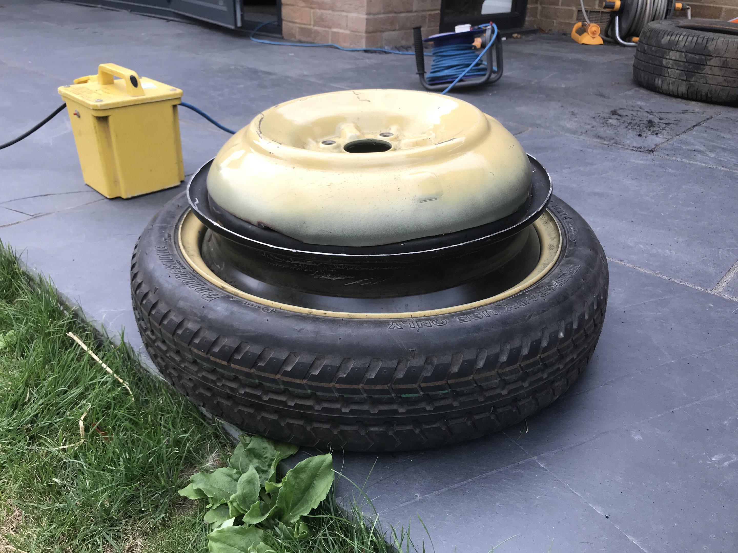

I’ve completed a nice little side project that cost only £5.50 and saved around 2.5kg. I found a cheap set of headlights on eBay and have converted them to headlight blanks. I had some spare paint from the anthracite side trims and wing mirrors so painted them the same colour to match.

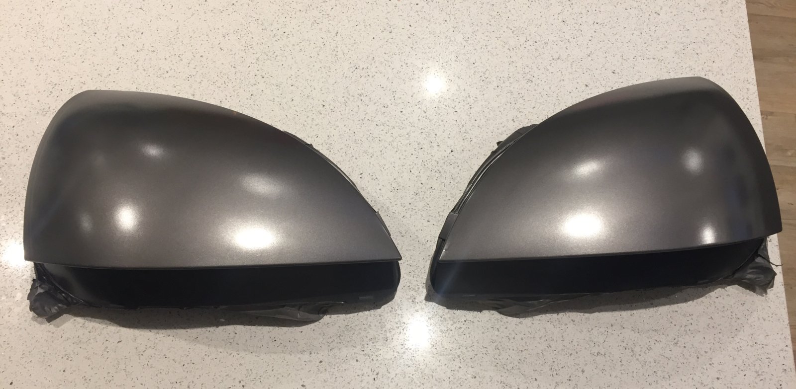

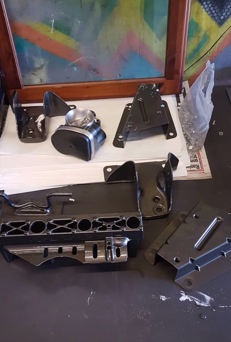

I might have been lying a little when I said i’d stoped taking the car apart. Whilst the rear was at the powder coaters I thought it would be rude not have some of the engine parts done at the same time. So off have gone the manifold etc for some powder coating and some porting..........;)
I’m looking forward to collecting it all shortly but have been sent a teaser photo.
Can’t wait to get them back

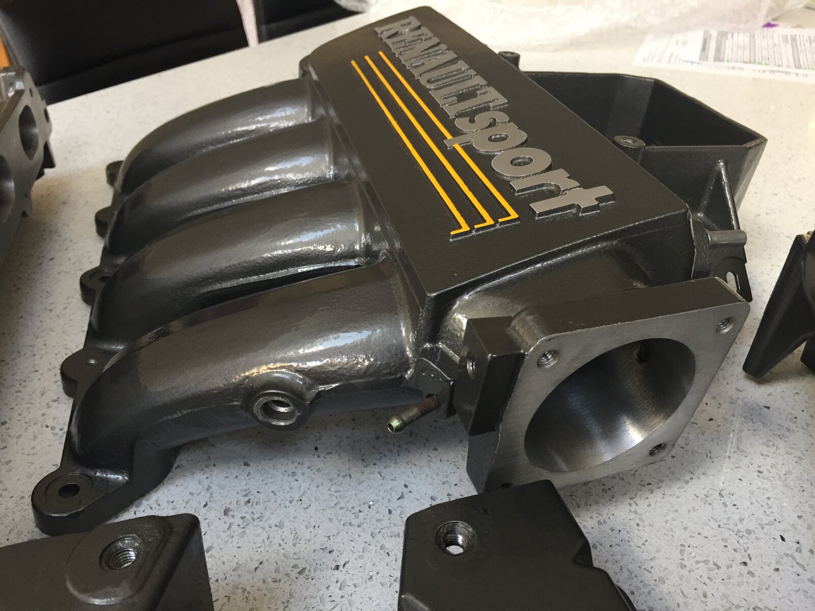

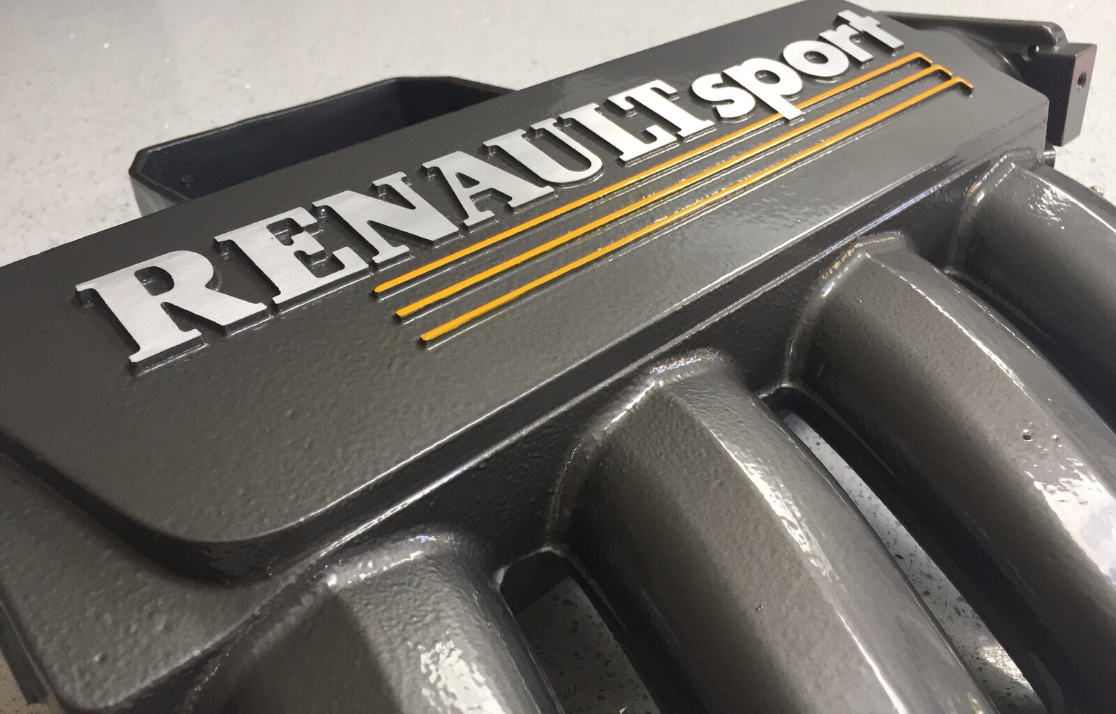

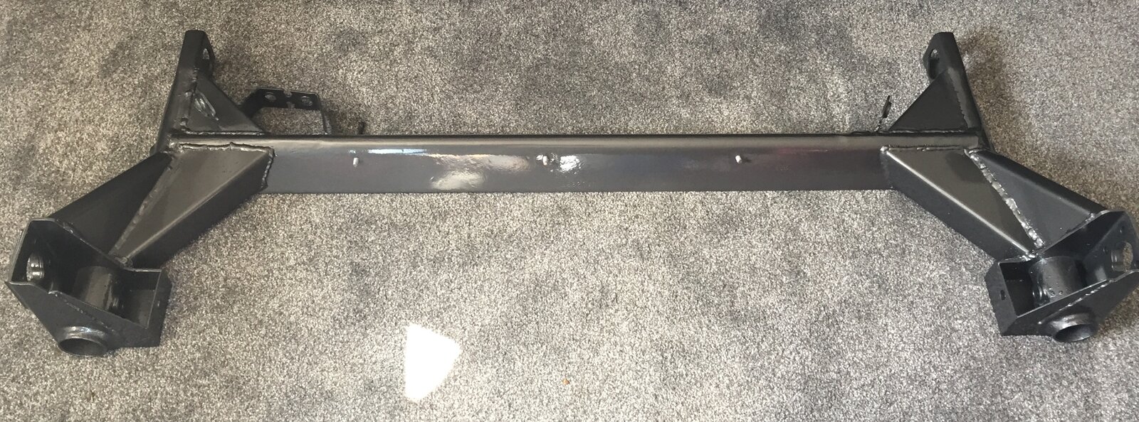

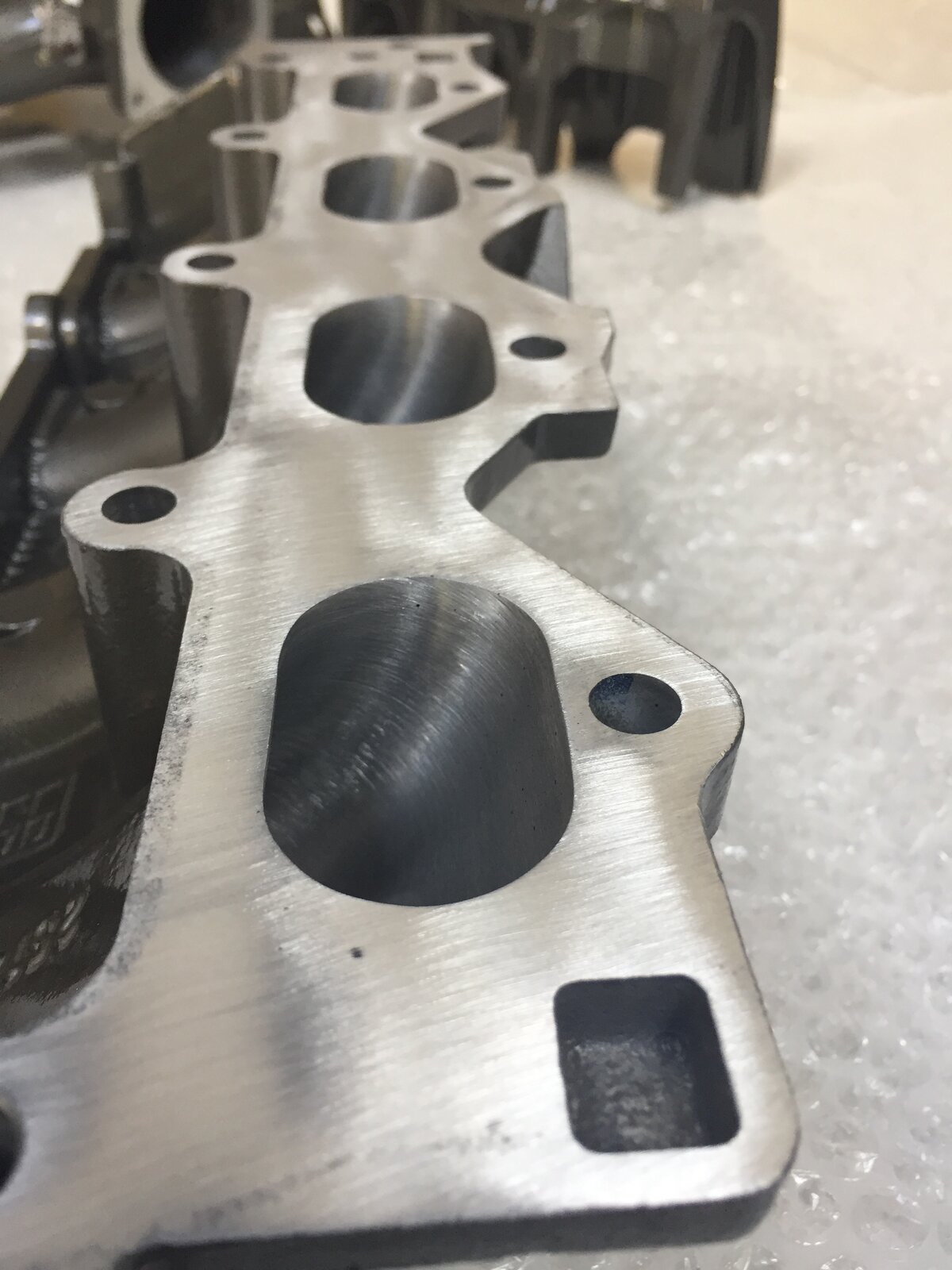

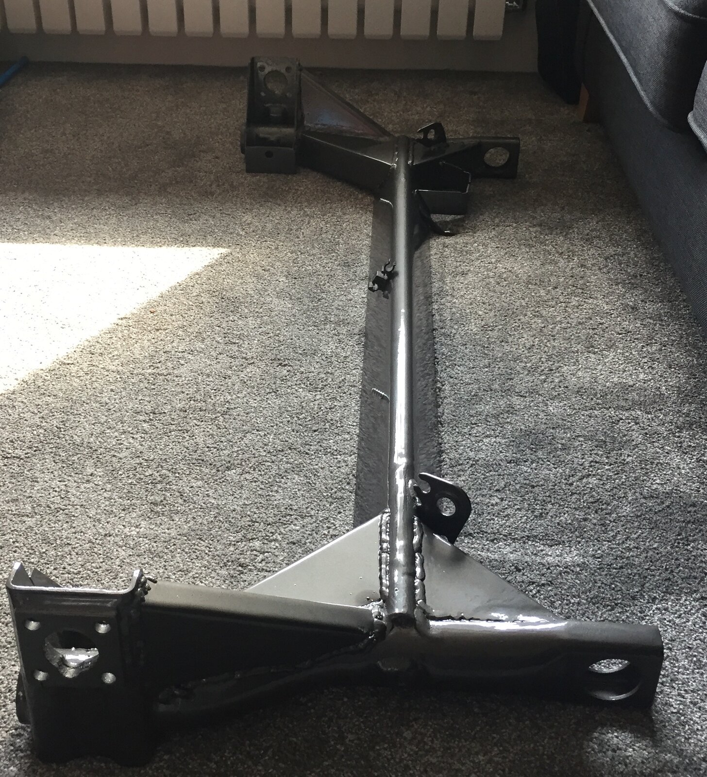

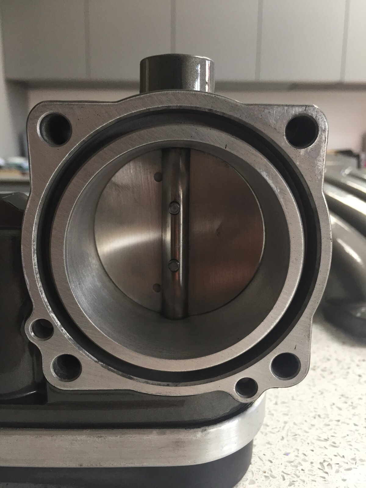

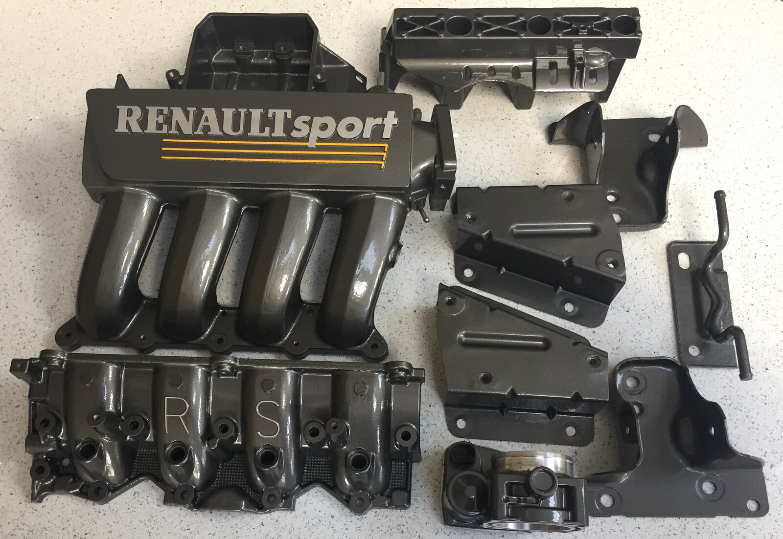

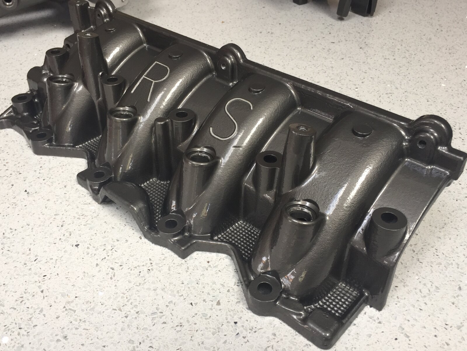

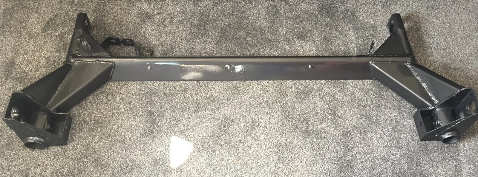

I went to pick up my parts today from M.S. Custom Engineering and i’m Very happy!
Everything has been powder coated anthracite and in addition the main inlet has had the stripes colour matched to liquid yellow like the graphics on the car.
The inlets have been port-matched and gas-flowed and the throttle body has been gas-flowed aswell.
I also had the exhaust hangers and rear beam mounts powder coated aswell.
Then there’s the rear beam. This has the PMS strengthening kit installed and powder coated aswell.
I’m looking forward to getting all this back on the car ASAP now 👍

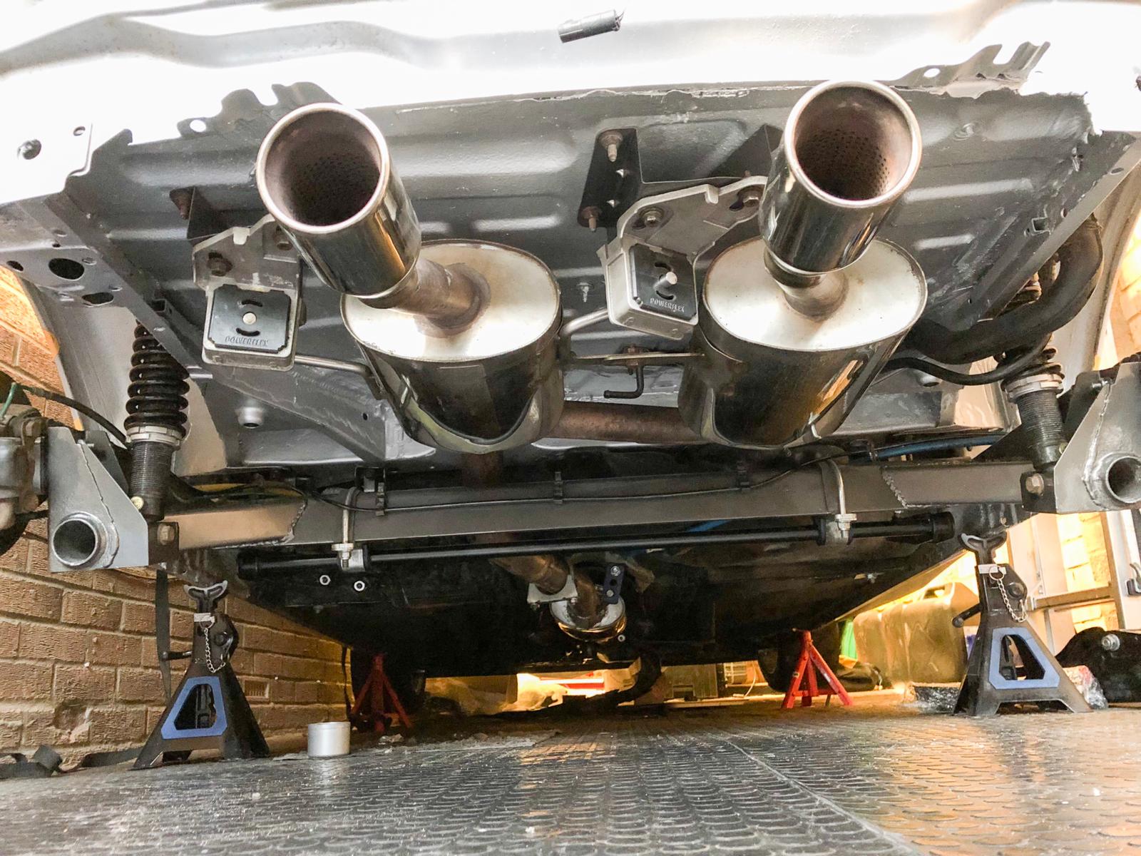

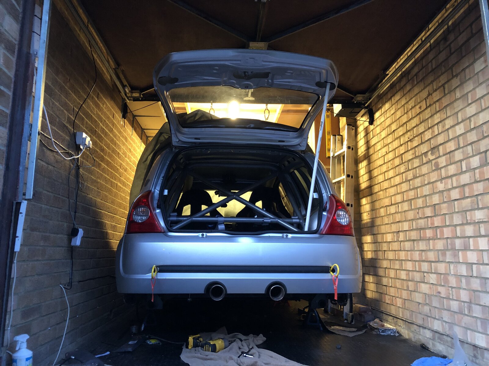

Today we put the car back together. It’s nice to finally say that!
The day went well but a few little niggles have cropped up. I need to upgrade the short flexi brake lines but didn’t get chance to order them. Annoyingly I found the long hard line from the drivers side rear calliper has a couple of rust spots on it. This won’t be going back on so i’ll either go copper lines or order a new one.
Apart from that i’m Happy with what we’ve achieved......
I threw the bumper on as I keep tripping over it.
Once the replacement bits arrive it will go back on it’s wheels.........

waiting for the test drive as I ordered the pms beam strenghtening kit as well :) Hope you'll like it (and hopefully me too:p)

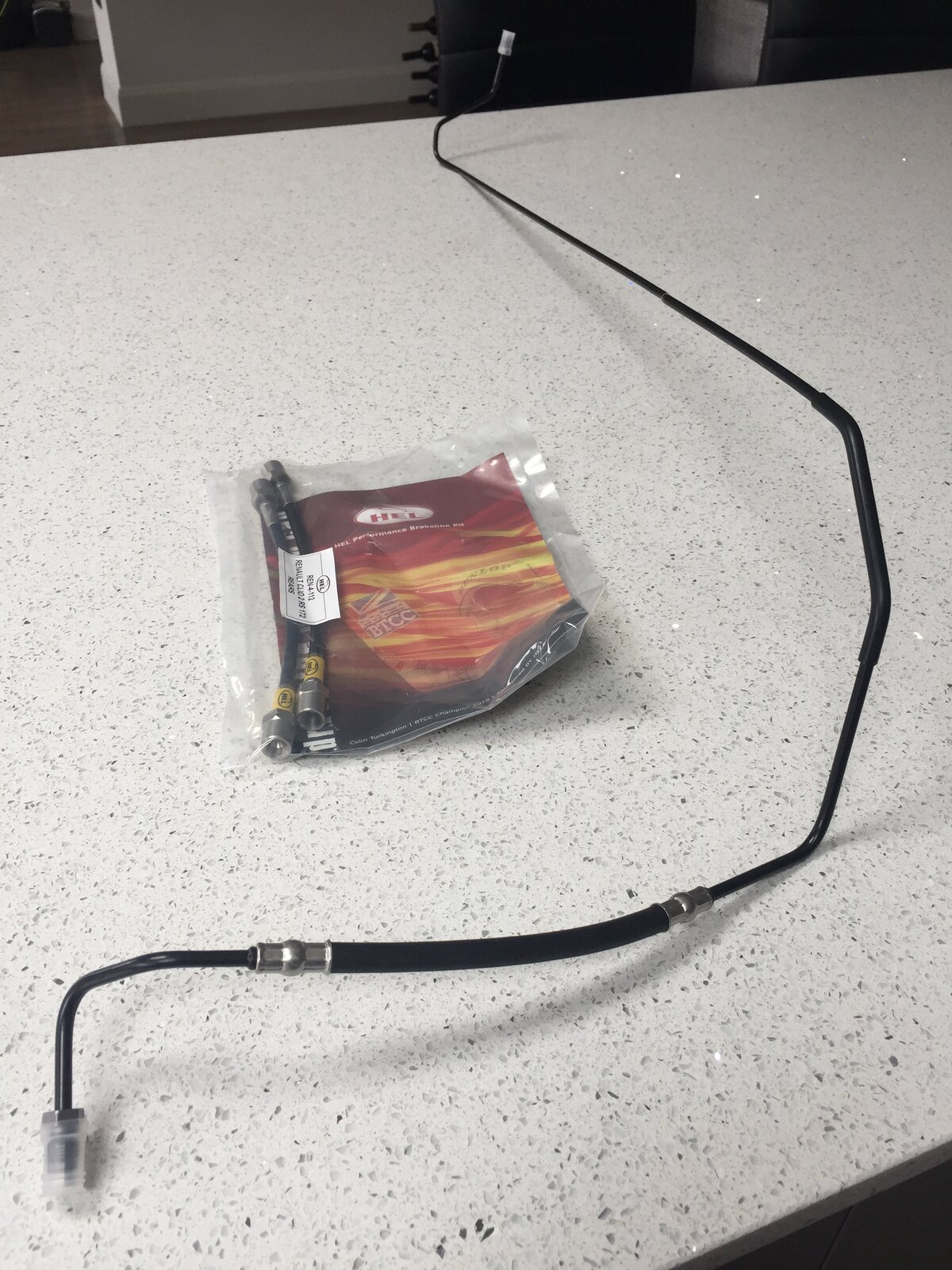

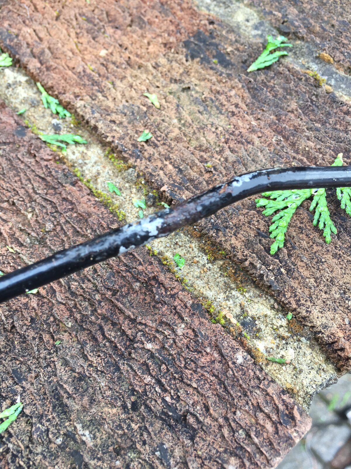

Turns out you can order the OEM brake lines from Renault and they arrive the next working day for a reasonable price. Not bad for a 15 year old car.
Also ordered the short braided rear lines from KAM. The only place I found that sells the rears on their own with next day delivery.
Time to get them fitted and then tackle the front of the car......

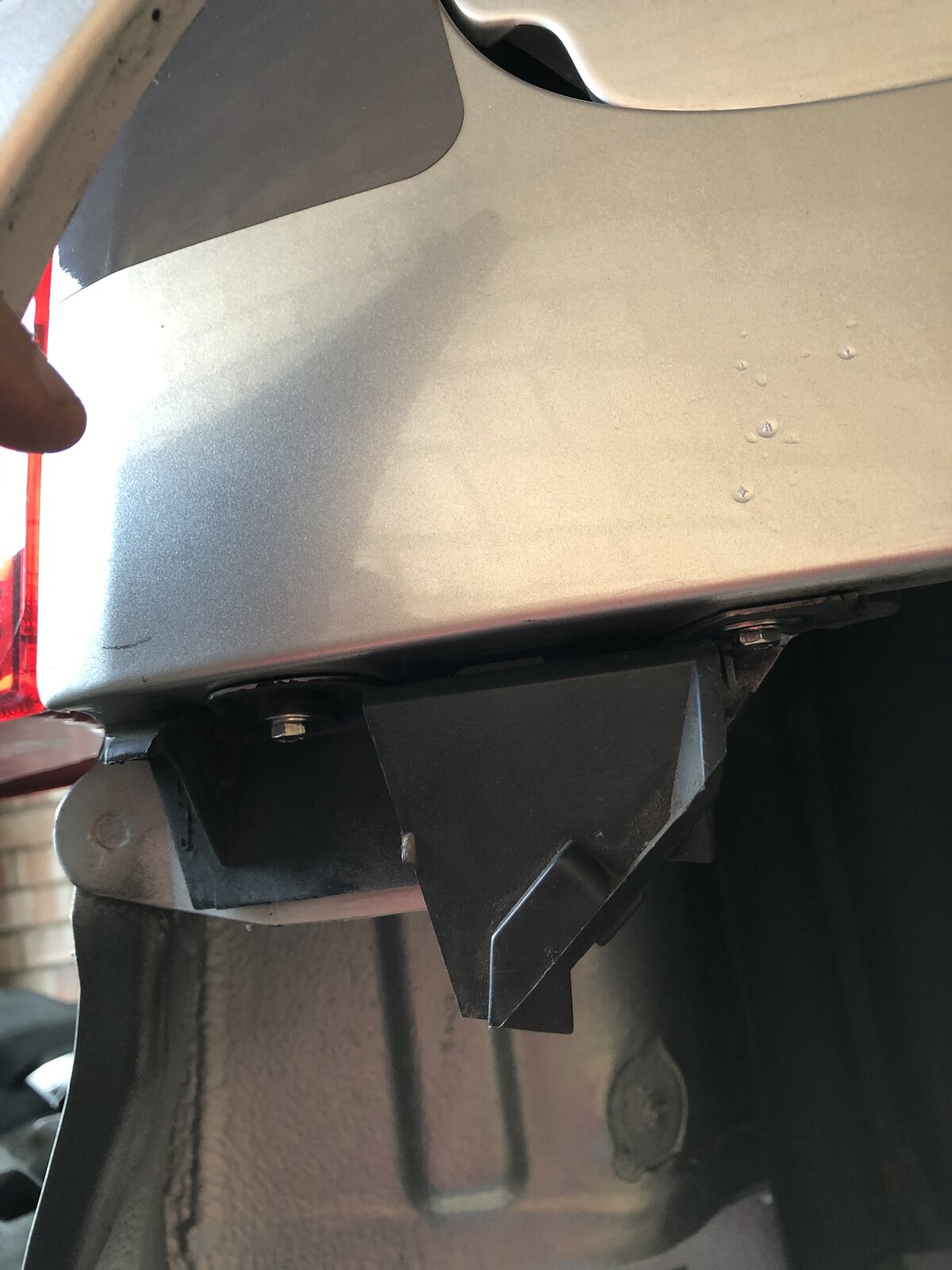

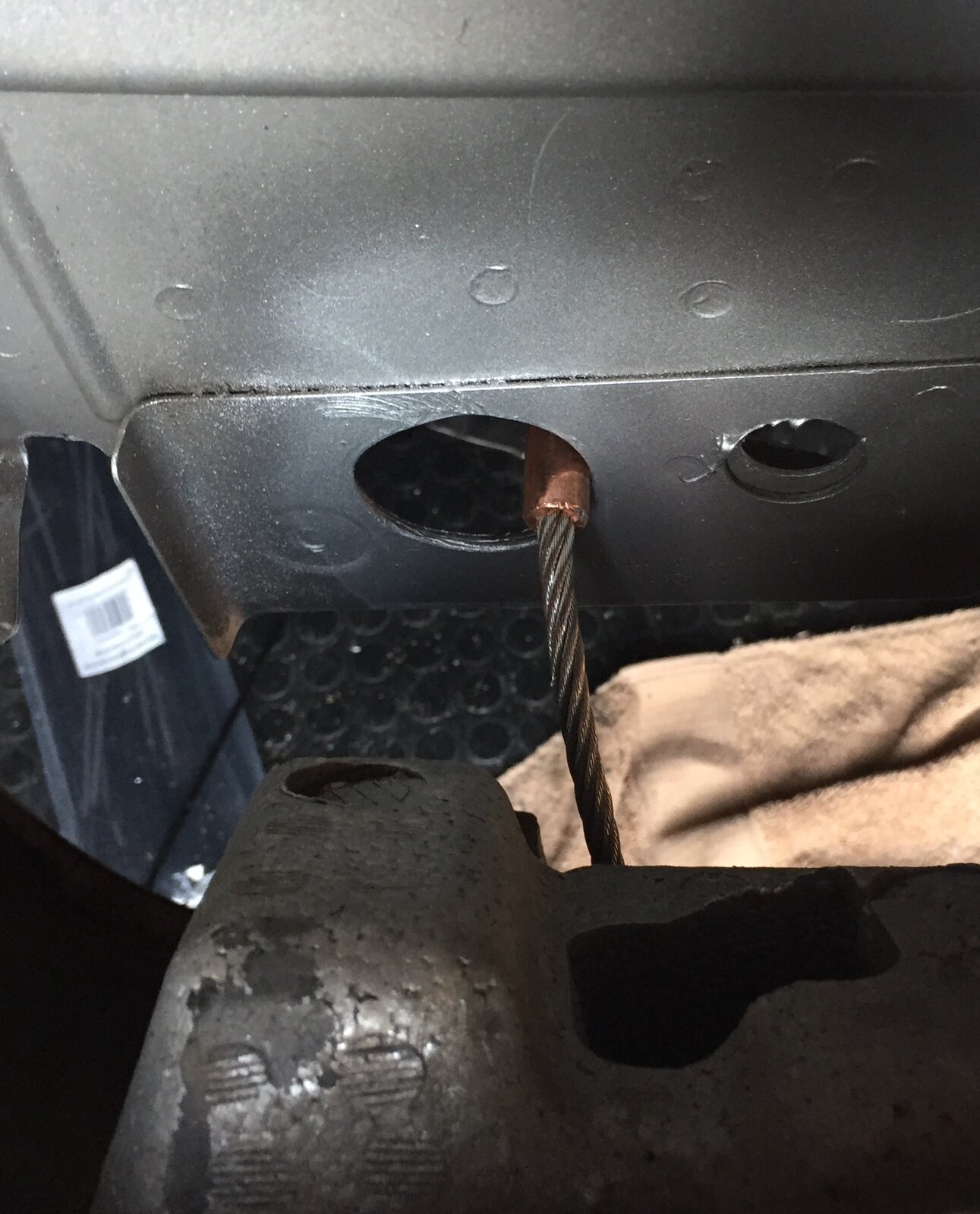

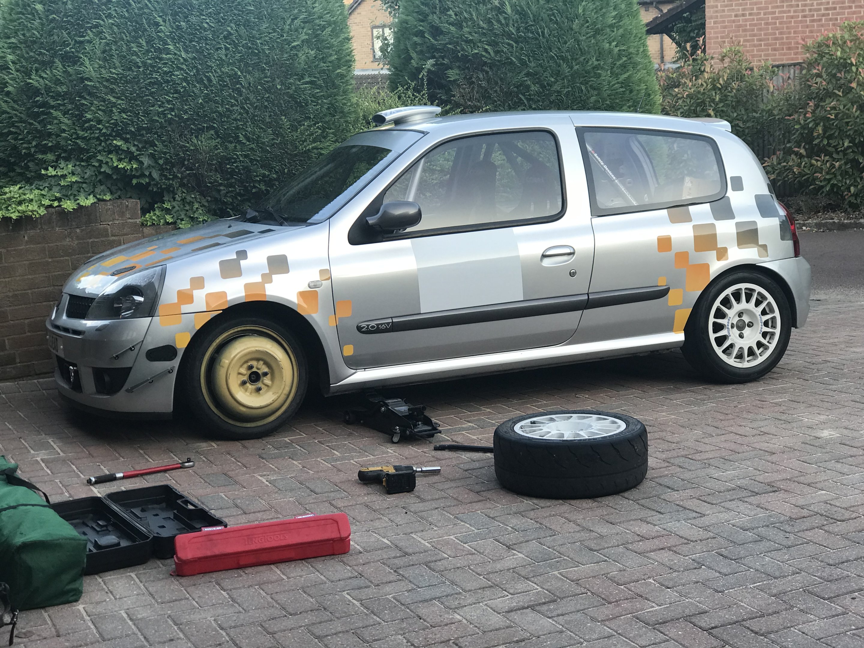

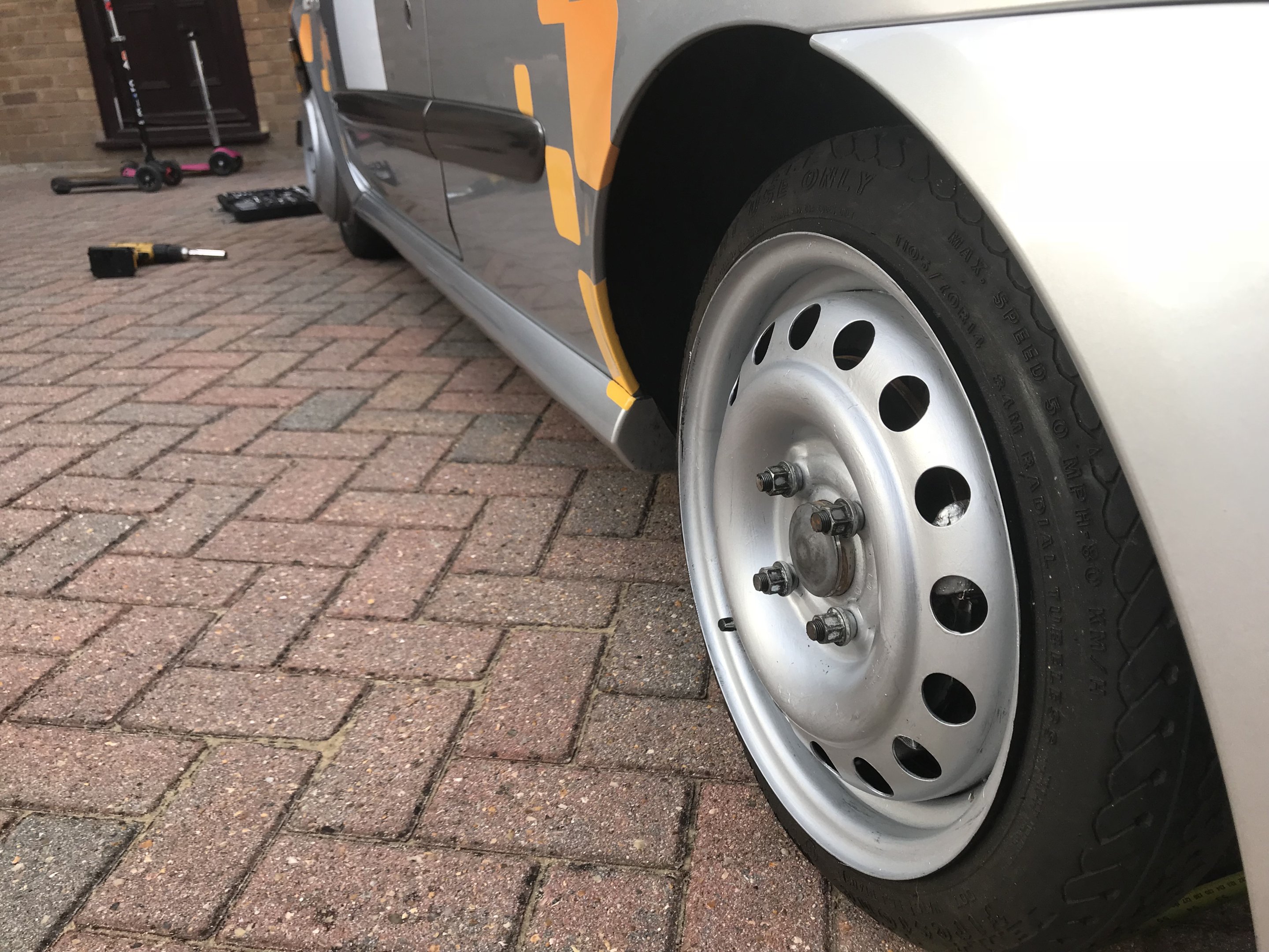

After 4 months it’s back on 4 wheels.......... for now 😂
I was a bit lapse in taking photos but first up the new brake lines were fitted. Then attention was turned to the rear bumper. Remembering I want to compete in some sort of motor sport with this car i’ve now fitted two metal tow straps. A couple of 40mm holes were drilled in the back panel and the straps were bolted into the rails at the back.
This straps line up with the black insert in the rear bumper so a few minutes with the dremel and a couple of cut outs were made. I’ve also added nutserts for the clips to help remove the bumper if i need to.
Bloody exhaust won’t go on straight again but i’ll play around with it later.
Wheels went back on and down she went. It’s now facing the opposite way ready for putting all the engine bits back on, remove the wish bones and add the strengthening plates and then.............
