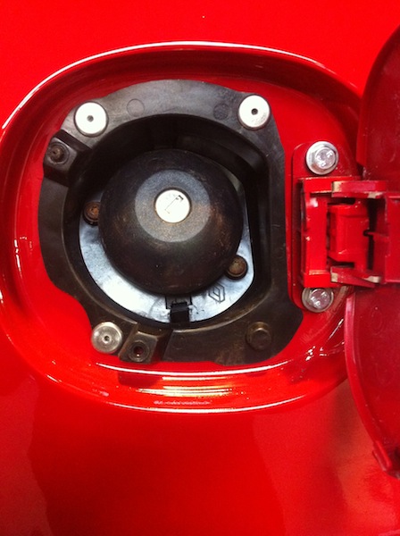

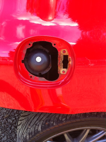

Open the fuel cap and you might be unlucky and see rust also.
Here is a very very bad one in the picture below and once again its down to the dirt and grim collecting in the arches and not being cleaned.

Is it hard to fix this? Or is it expensive? Ill definitely have a look at the filler cap but if its clean surely the rust may still be bad?

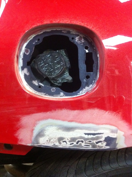

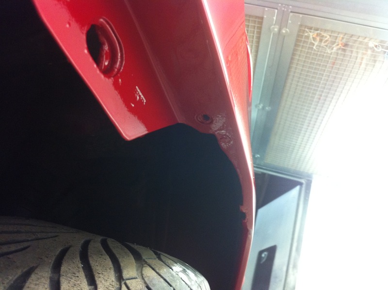

My rust on my arch was smaller than a 5p and i mean very very small, it could only be seen when the bumper was taken off as it was on the lip going under the arch.
From what you are showing in your picture it looks a lot of rust from what i have ever seen on a 1*2.
I only noticed mine due to the dent in the rear below the fuel cap which had cracked the paint on the lip which as said could not be seen when the bumper was on.

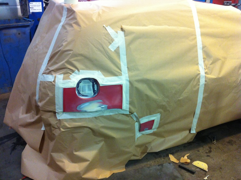

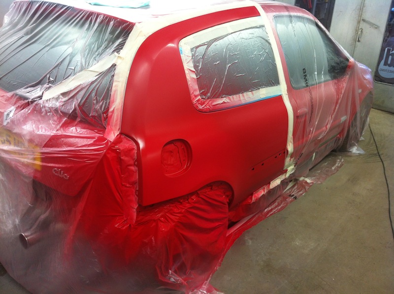

It was repaired by a friend who is a panel beater / spray painter.
I never paid a penny as i looked after his car for over a year in my garage so he done all the work free.
Here was my dent that was in the car since i bought it
