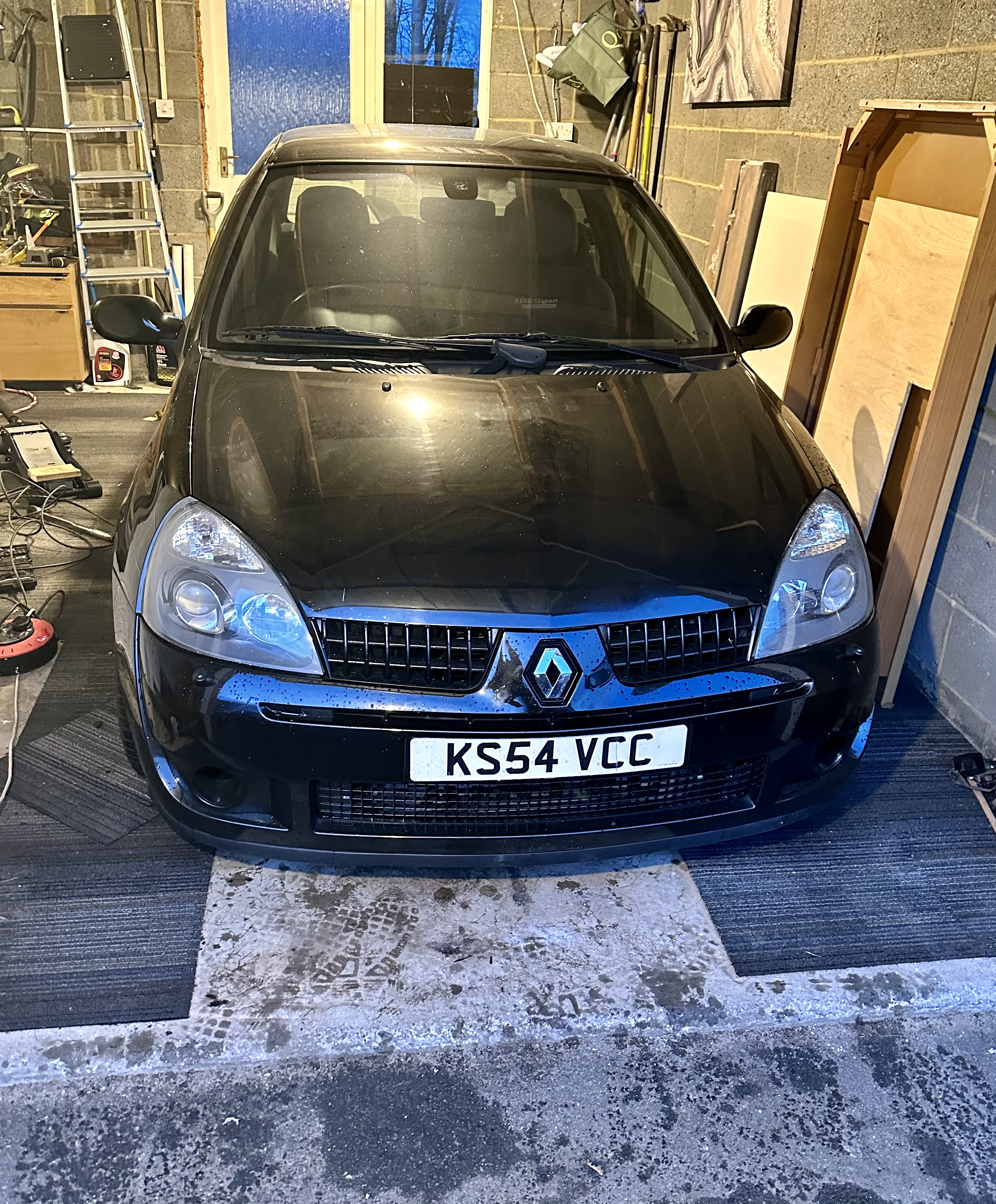

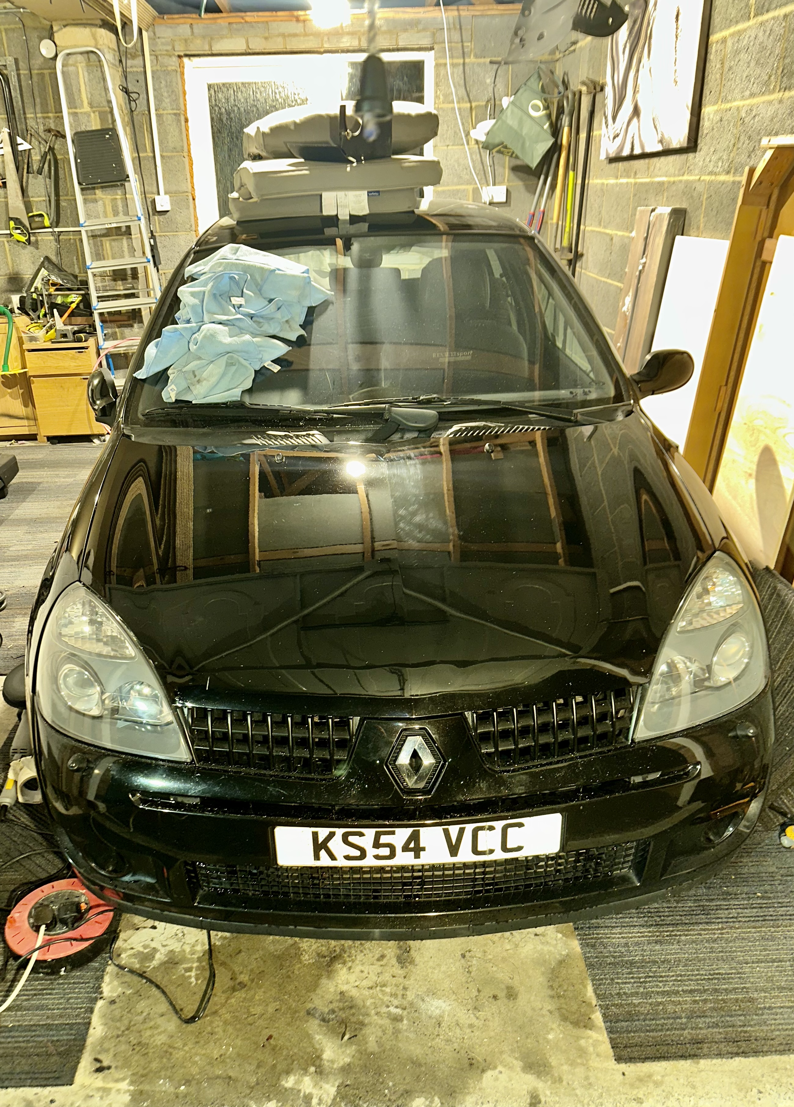

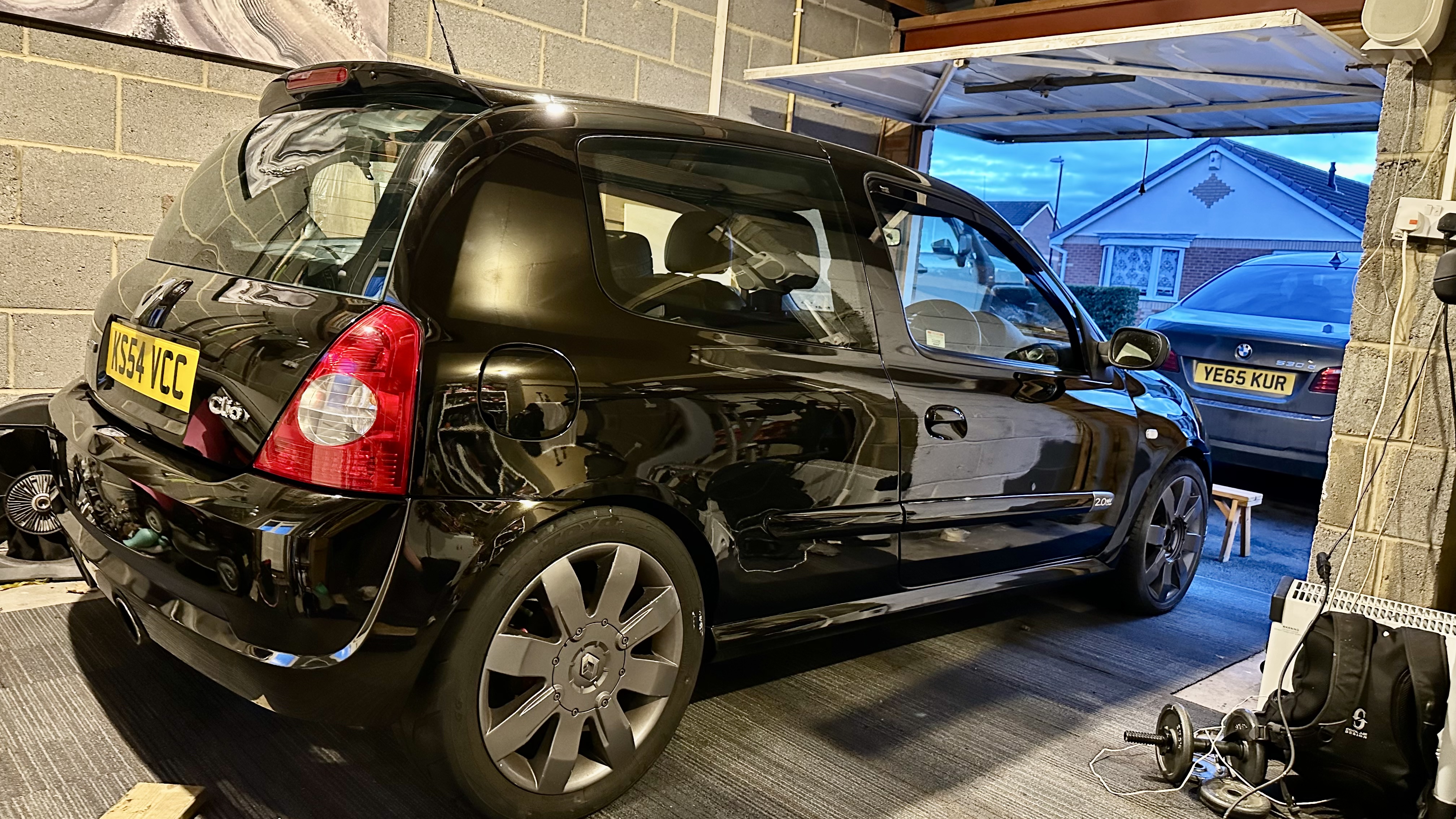

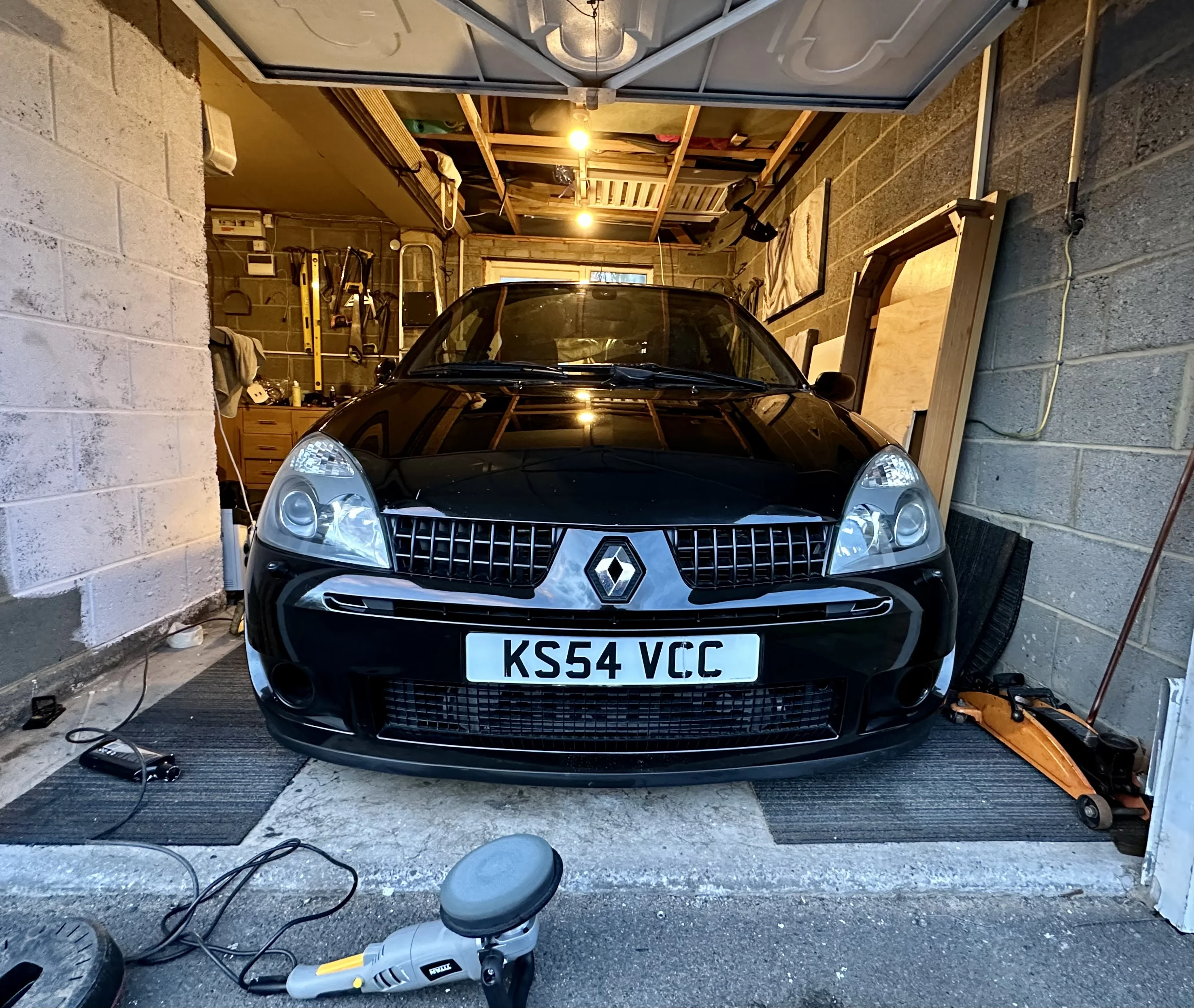

No, not much up at the min. I was silly and let the MOT expire in April so it’s never moved since. The exhaust has a blow that I need to sort but aside from that it’ll go straight through, it’s just finding the time and motivation. Battery is also totally dead and won’t hold charge which. Again easy fix.

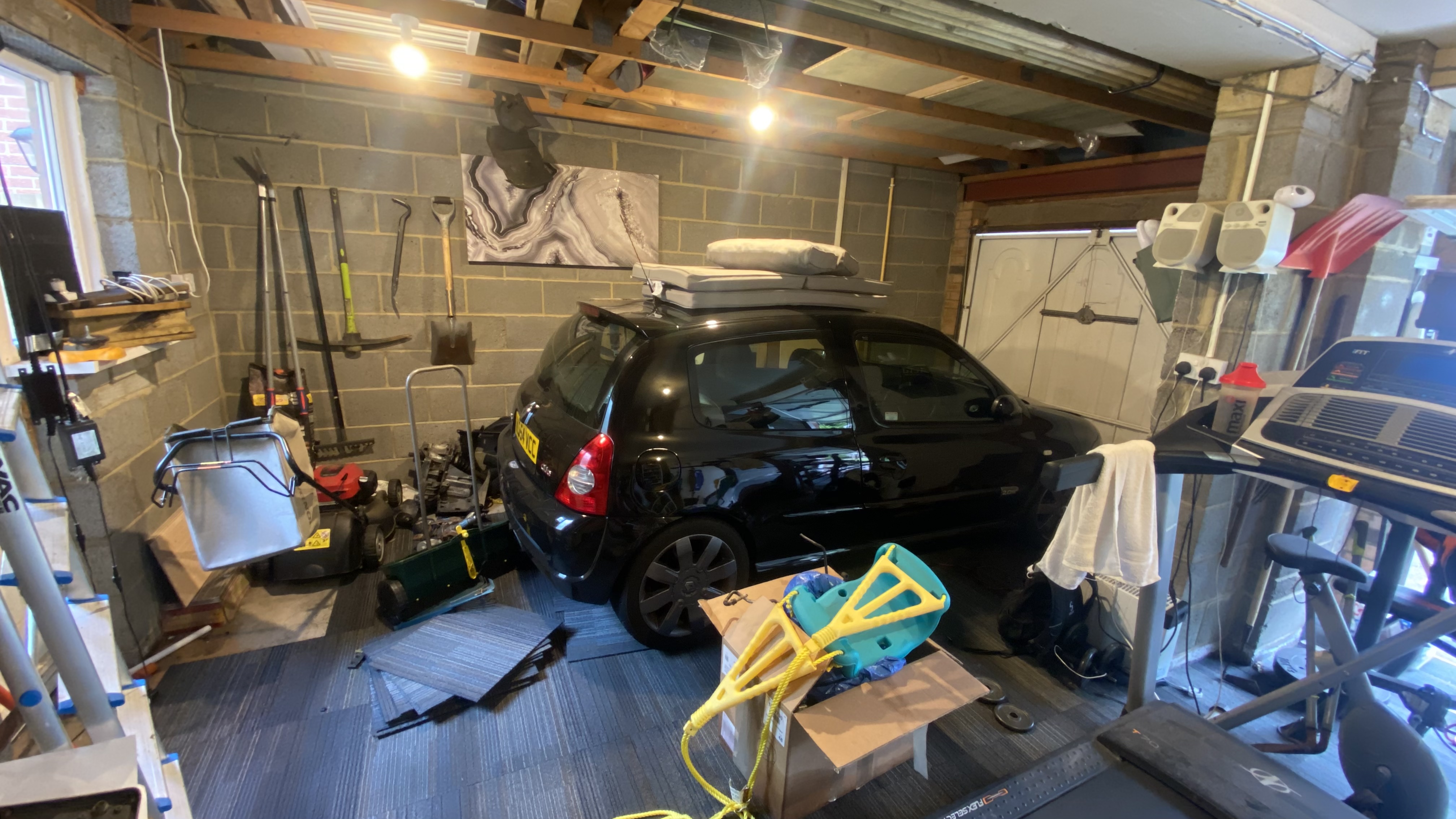

This is how it’s sat. On the upside the carpet tiles keep the dust in the garage well under control so it’s nice and clean

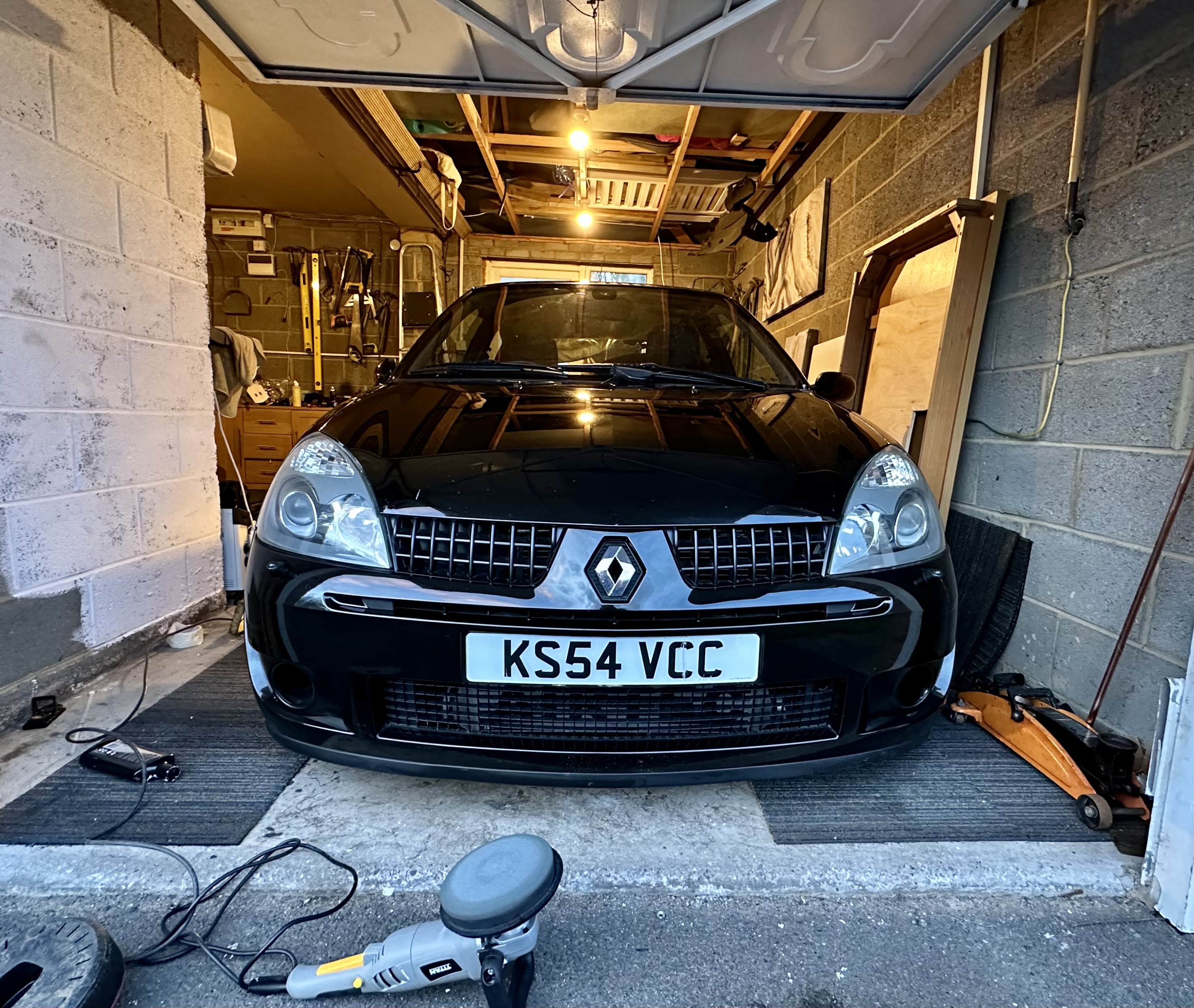

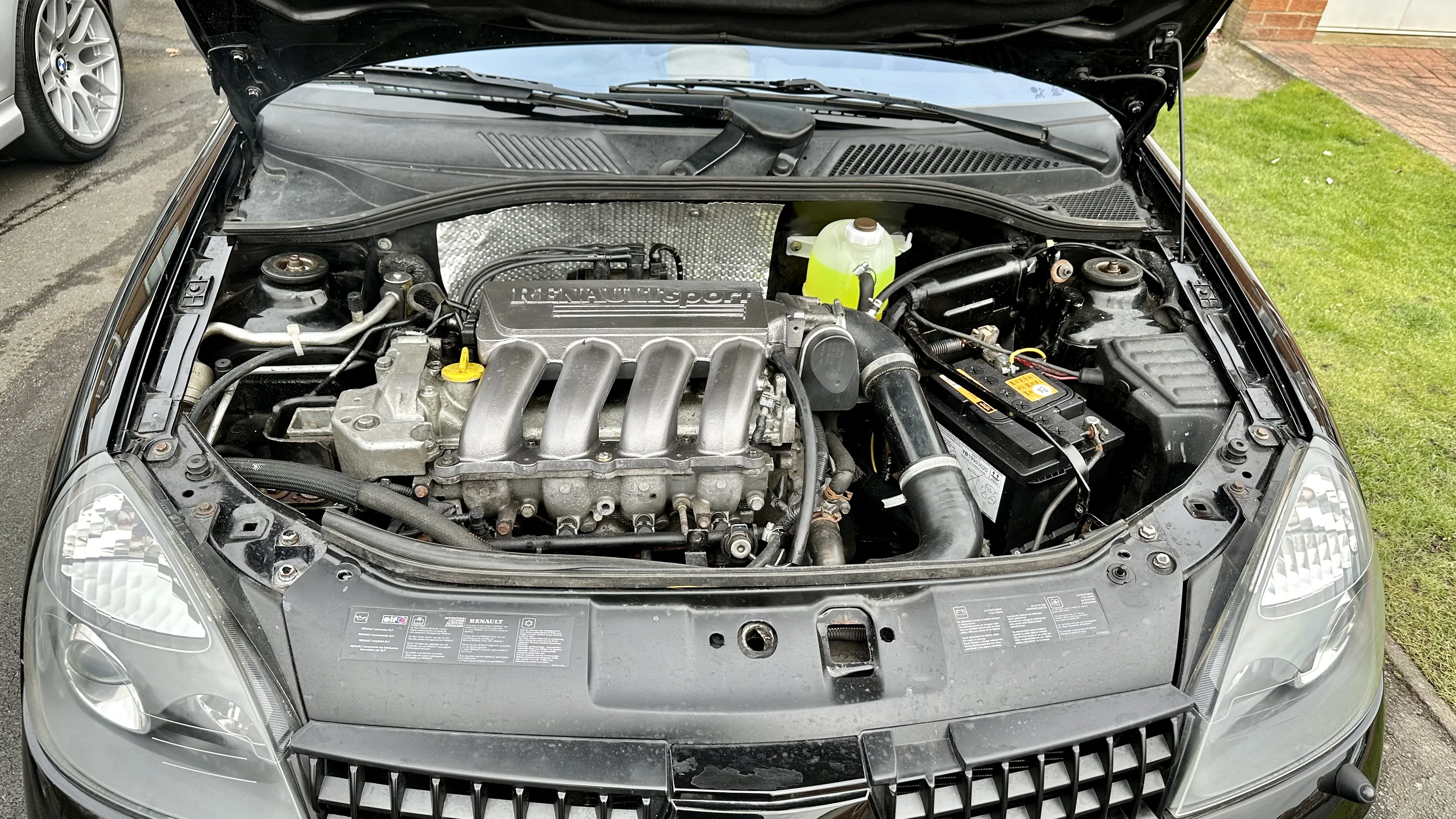

The Clio has been in hiding for a while after it’s mot ran out. Main problem is a blowy exhaust which I assumed was coming from the joint that sits above the subframe. Access is a right t**t and the only way to do it properly is to drop the subframe and I couldn’t be arsed.

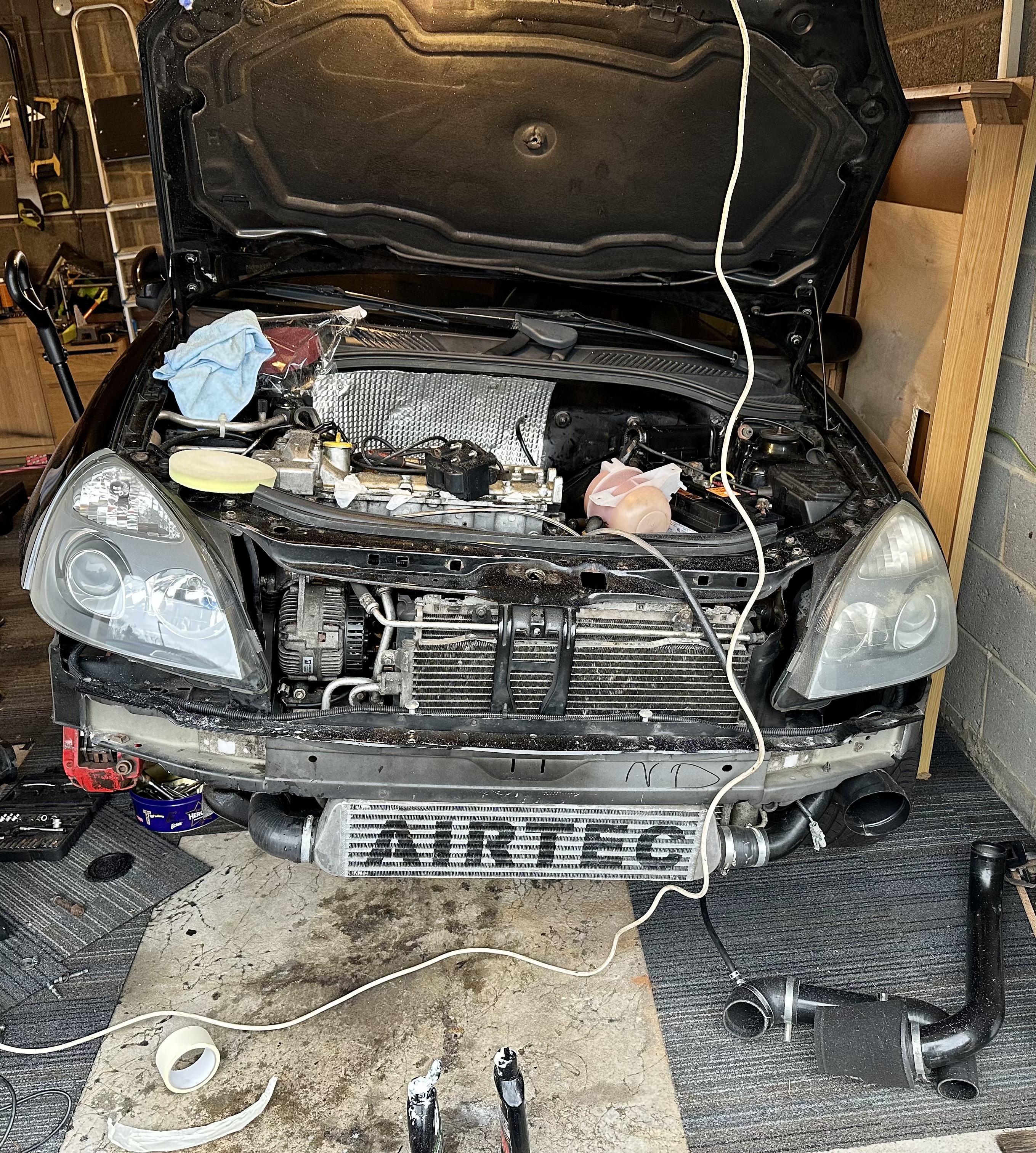

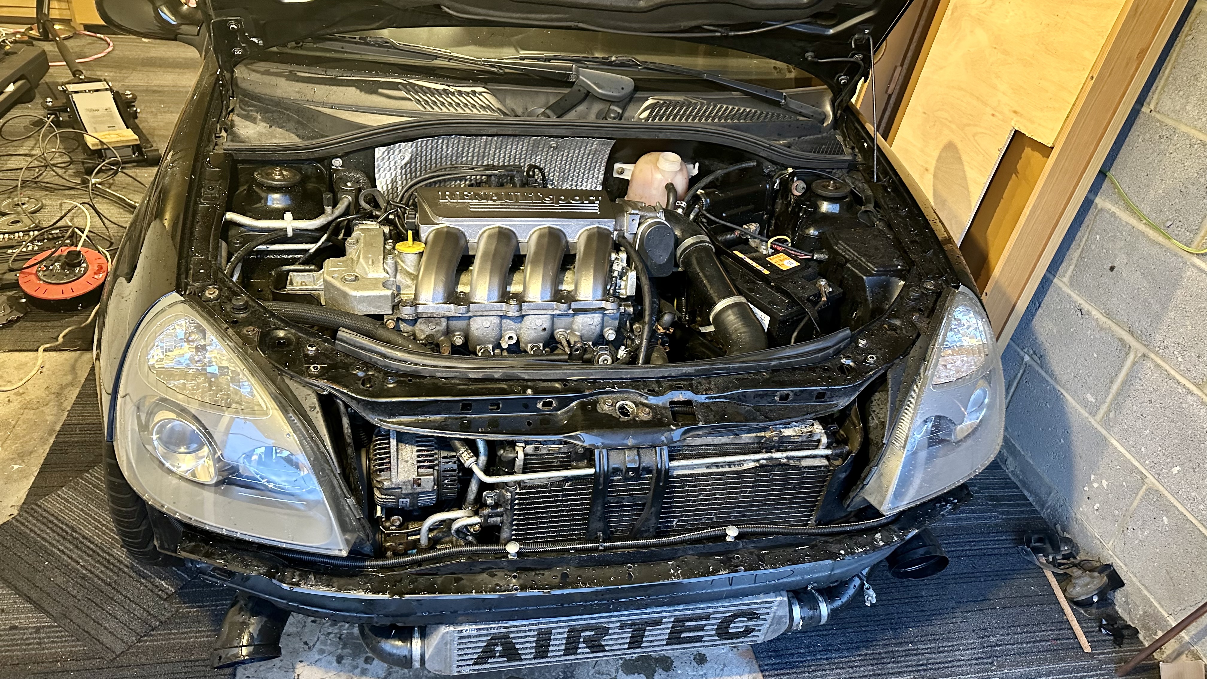

I finally built up the motivation to look at it today. I fitted a new battery and started on with lowering the subframe. While undoing the back bolts, I spotted where the blow was coming from

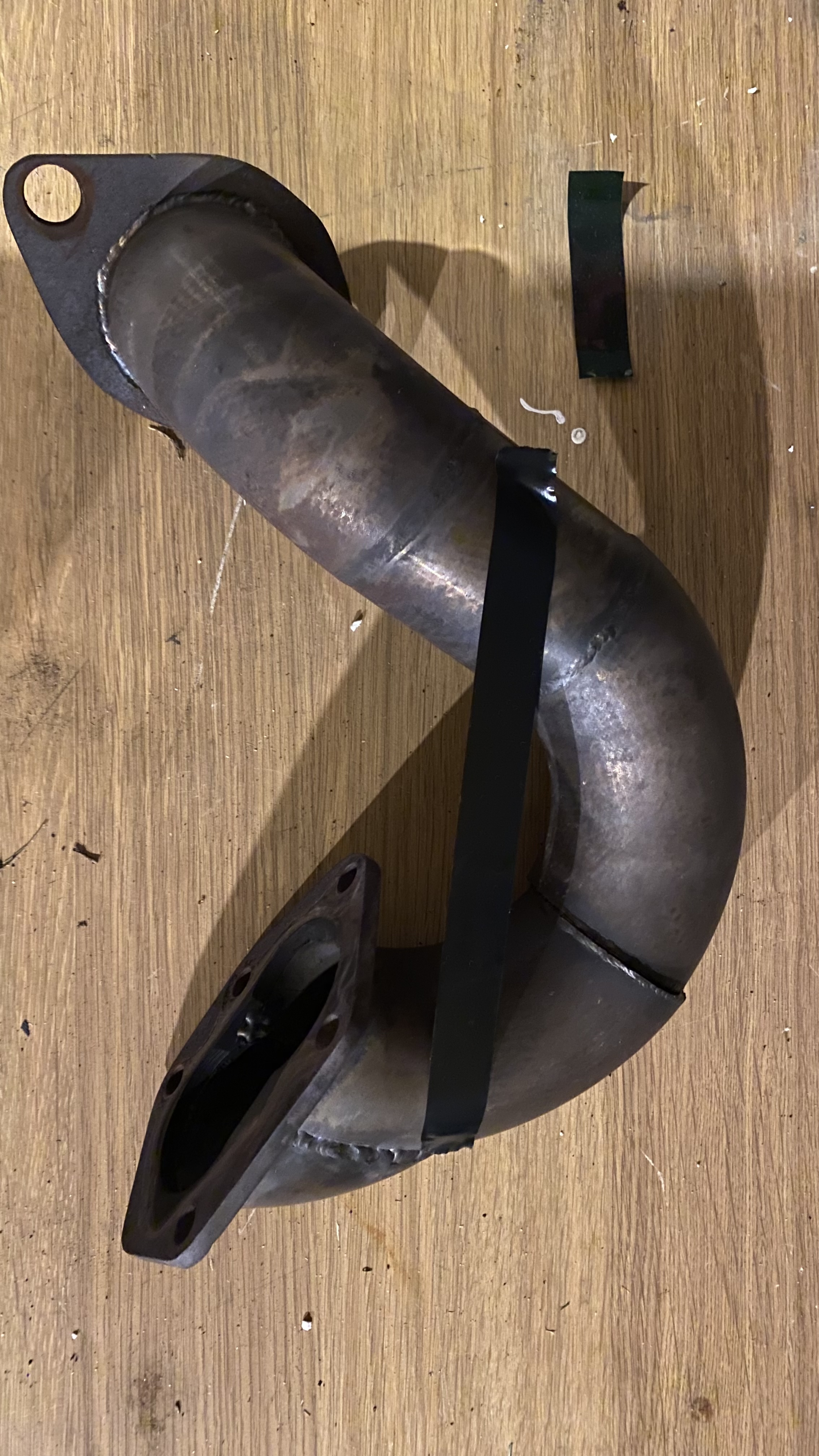

The downpipe has cracked clean across one of the welds and is now in 2 bits. The only way to access all the bolts is with it off the car so off came the turbo too 🤦‍♂️
It’s a lovely clean split. Anyway, that stopped play for today. I now need to ask my local exhaust place very nicely if they’ll weld it back up. My only concern is that it happens again but suppose there’s only one way to find out
No, it’s a TRW one that the guy in Portugal makes. The welds are neat but not the meatiest looking things Ive seen. I’ll get it welded back up and see if they can maybe add a bit of a brace onto it. I’m going to fit a flexi just after the subframe too. All the weight of the exhaust basically hangs on that downpipe
Aye was gonna say that, see if you can brace it on the block to save it from cracking again. My mate went through 2 downpipes and welded them both multiple times
In the end he added bellows from a wagon exhaust and a brace from the block to the turbo that solved it
Yeah I think it should work. I’ll get them to add a brace in where the tape is and then I can knock something up that bolts to the block from there and then the flexi should take a bit of stress off too. It’d be tight to add a bellow but if it does it again one would probably squeeze in on the short straight bit just before it turns to join back to the rest of the system

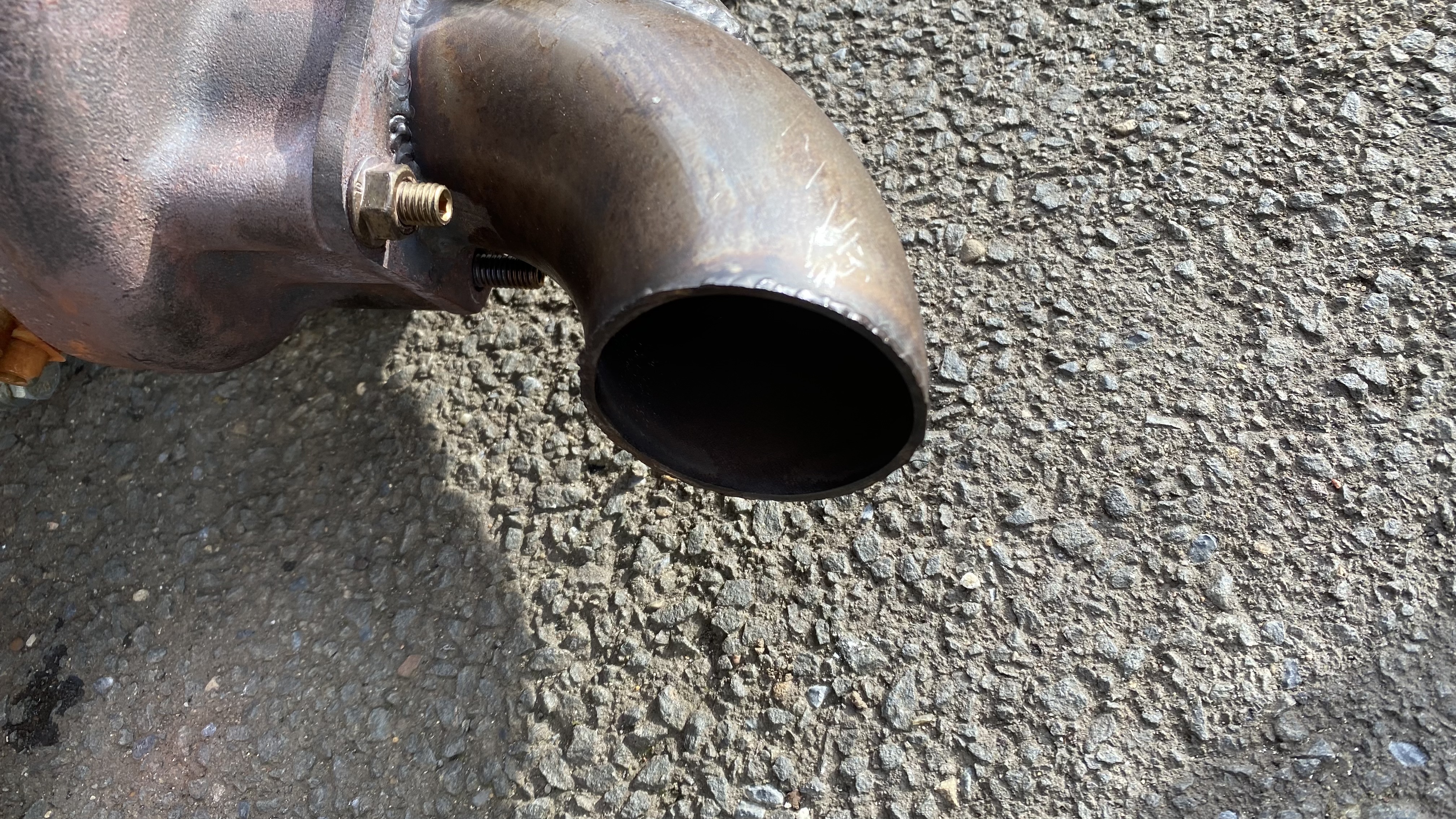

The Clio has been a bit neglected recently so pulled my finger out a bit. I had the downpipe welded up back at the end of October.

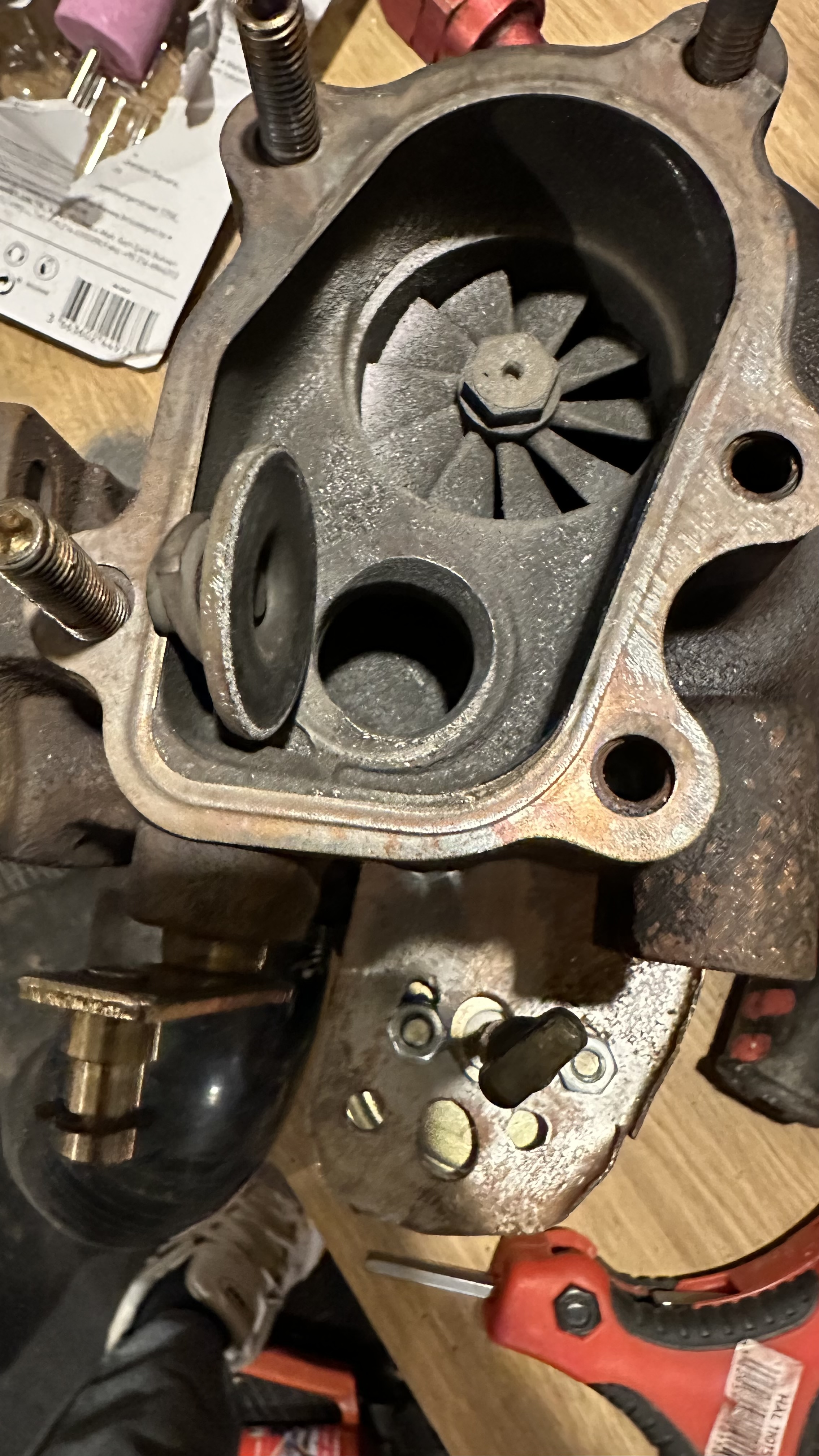

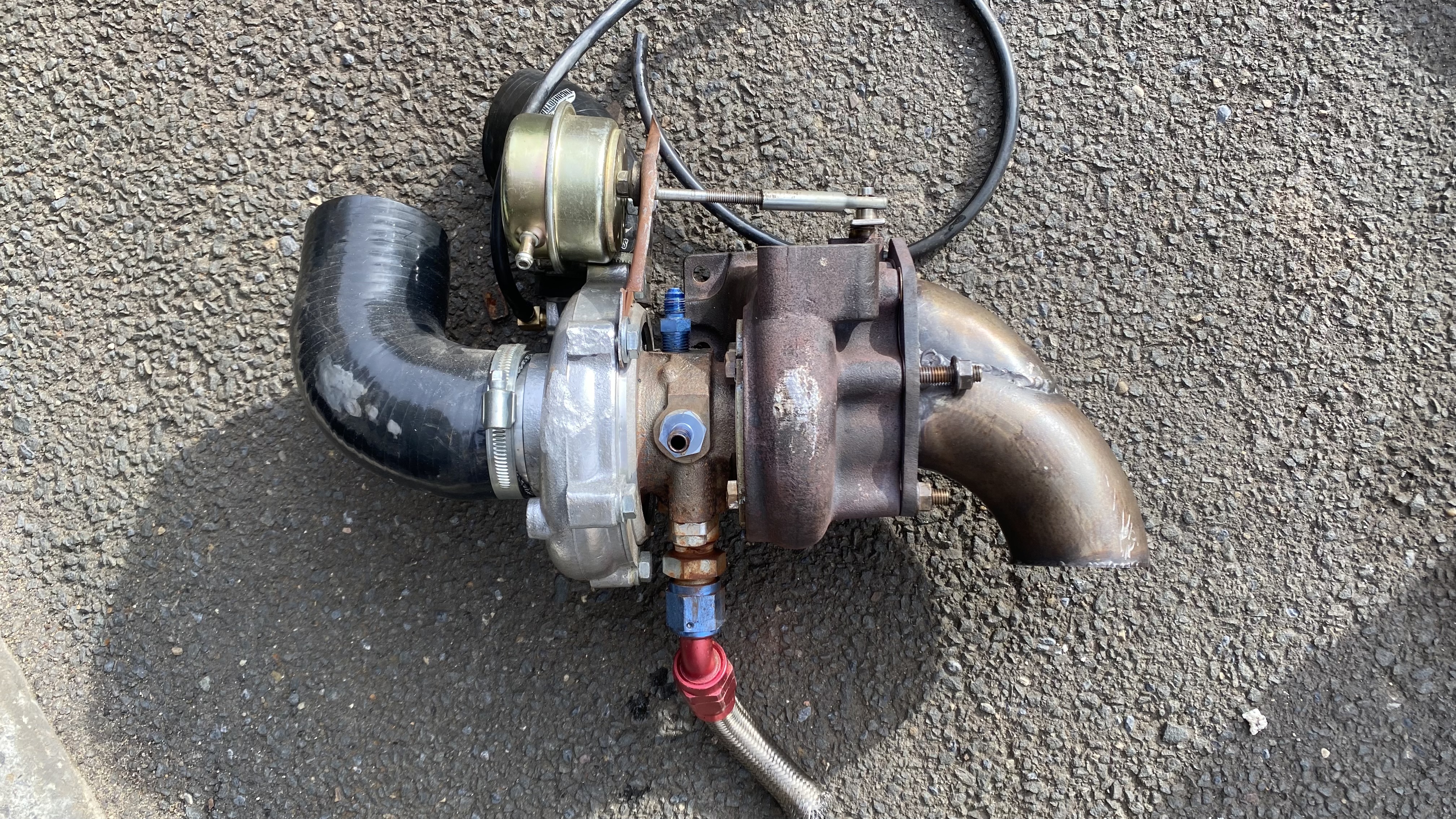

While the turbo was off I decided to widen the wastegate port slightly. I’ve always had to leave one of the ports on the boost pipes unplugged to create a tiny bit of a boost leak to stop it holding 10psi and blowing up. Hopefully this should help!

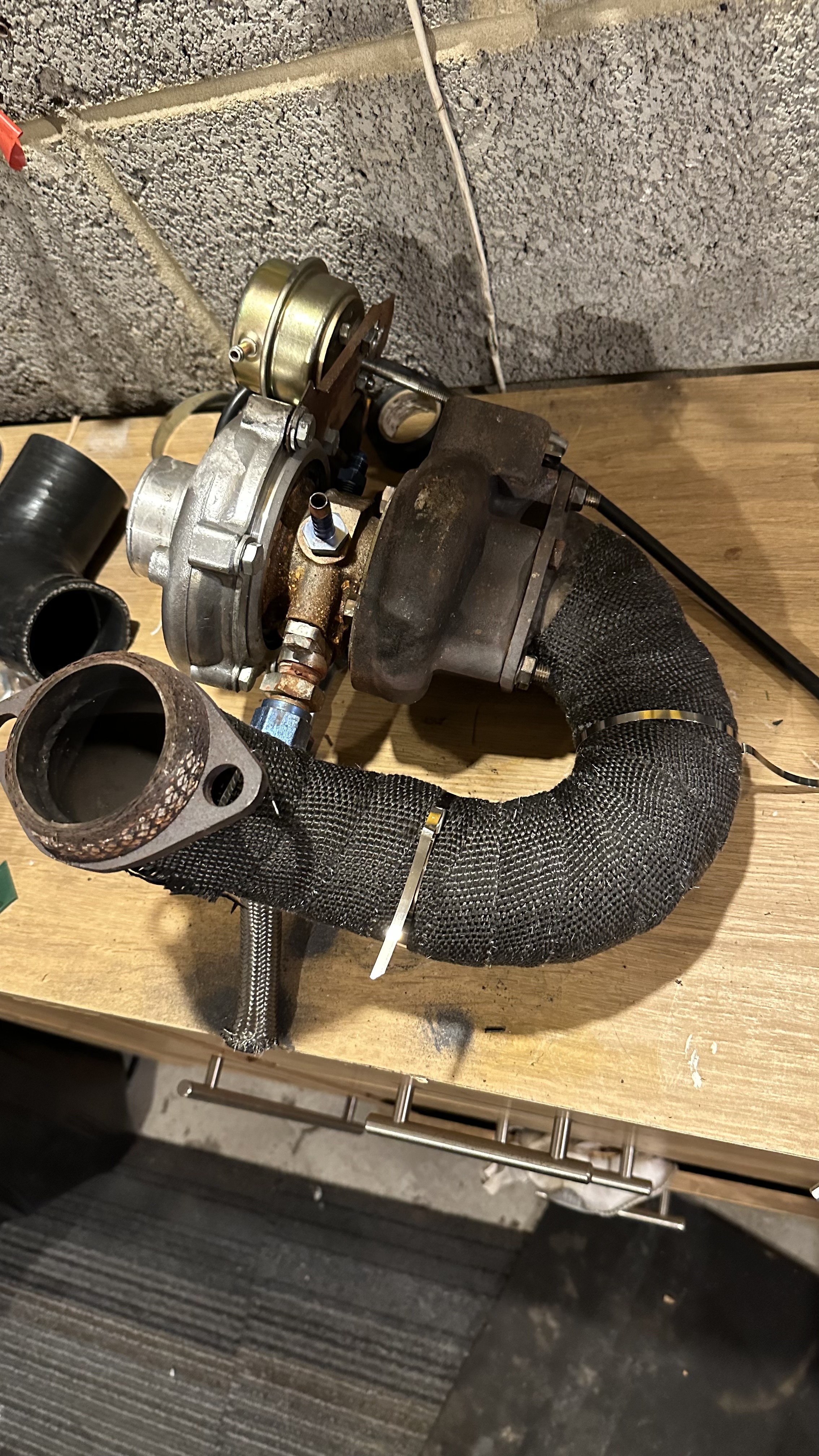

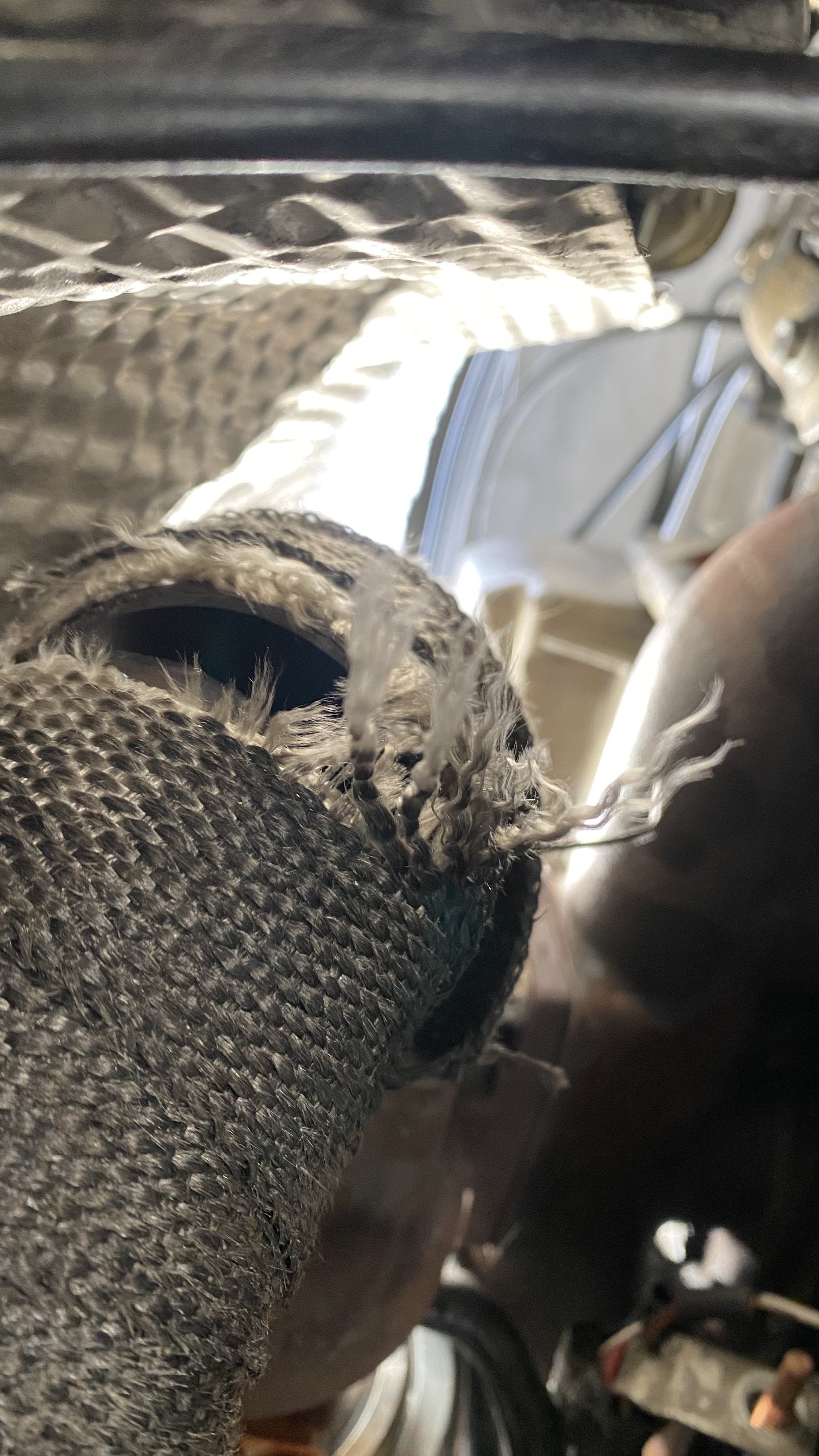

I then heat wrapped it (f**king hate that stuff) and joined it back together
I then went to refit it to discover that it won’t fit with the downpipe on. Note to self for next time it comes off: FIT THE DOWNPIPE IN THE BAY.
The only way it goes in with enough space to work with is to take the dogbone off, loosen the top engine mount then jack the back of the engine to push it up and forwards. With that done the turbo drops in and there’s space to bolt the downpipe on and move it all about. Didn’t get any photos but more to follow over the next few days. The worst job in the world is due next which is joining the downpipe to the decat around the arse of the subframe 🤦‍♂️

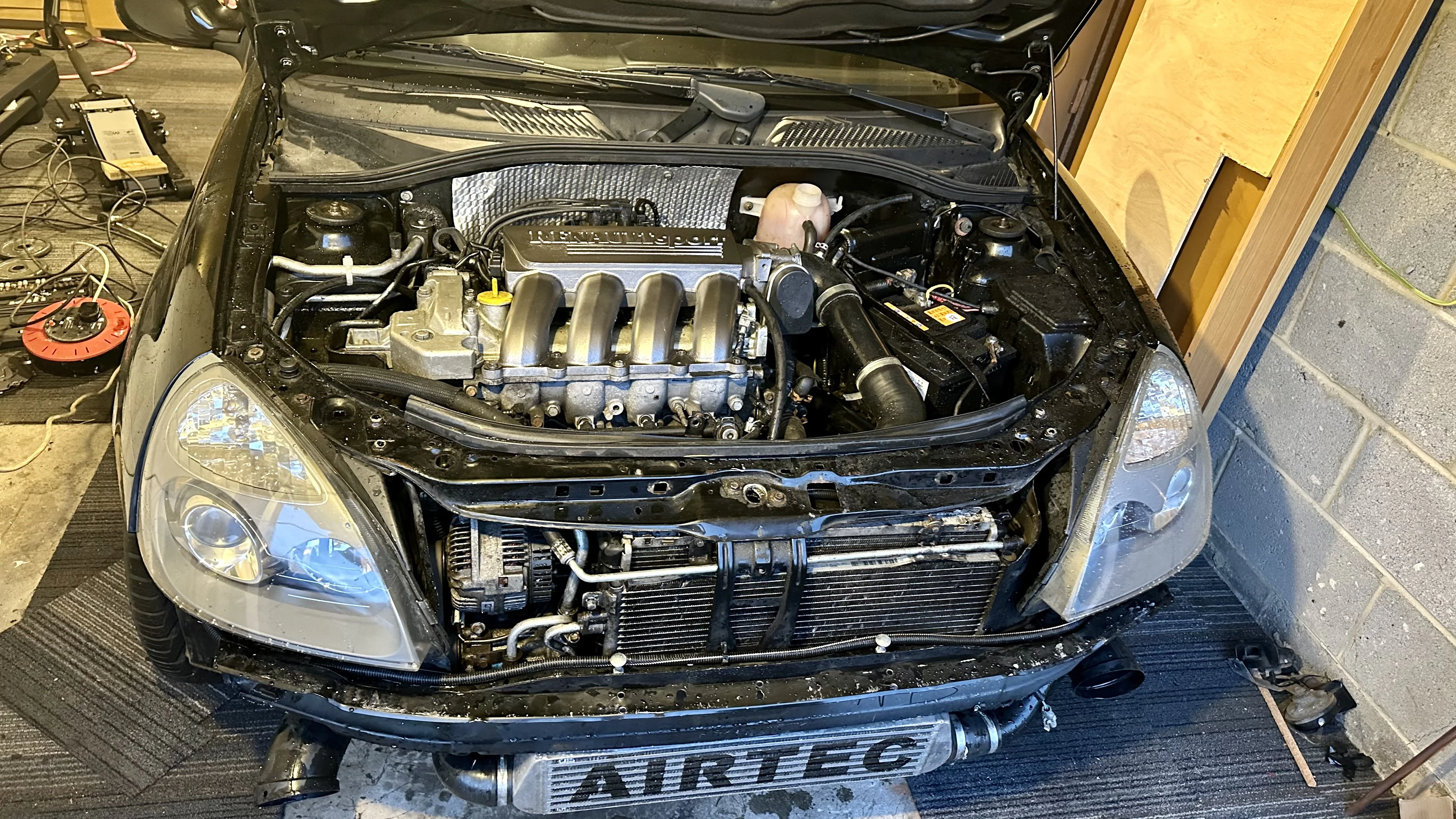

I had a day off work today so spent most the day in the garage. I got the downpipe linked back up to the exhaust. I dropped the back of the subframe as it’s pretty much impossible with it in place. I then redid the oil return. I’d used a braided hose with an AN fittings and it just wasn’t sat right and had been leaking a bit. I didn’t get any pics but I’ve used a central heating fitting of all things (perfect wiggly angle), coupled with a bit of high temp silicone hose.

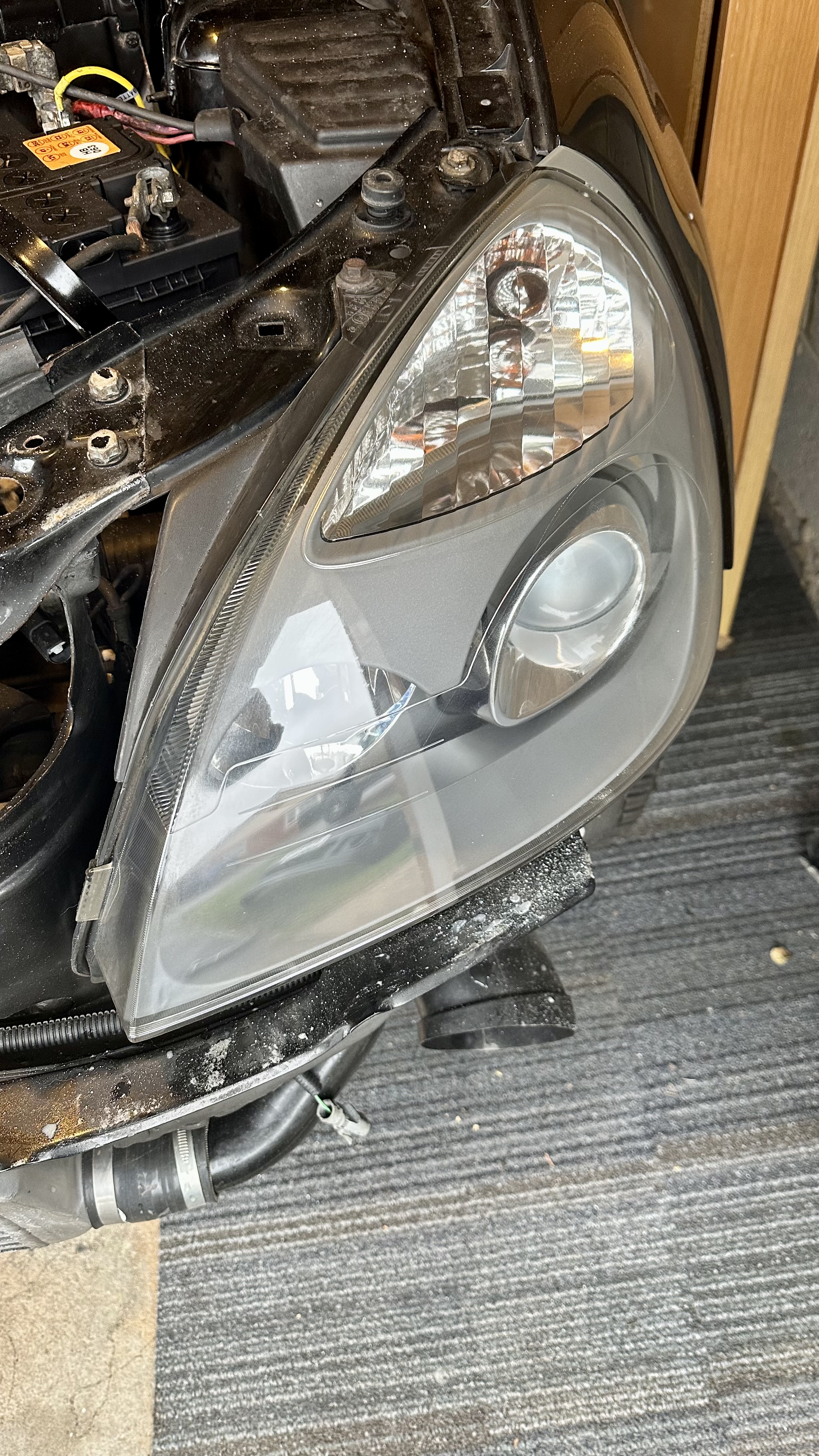

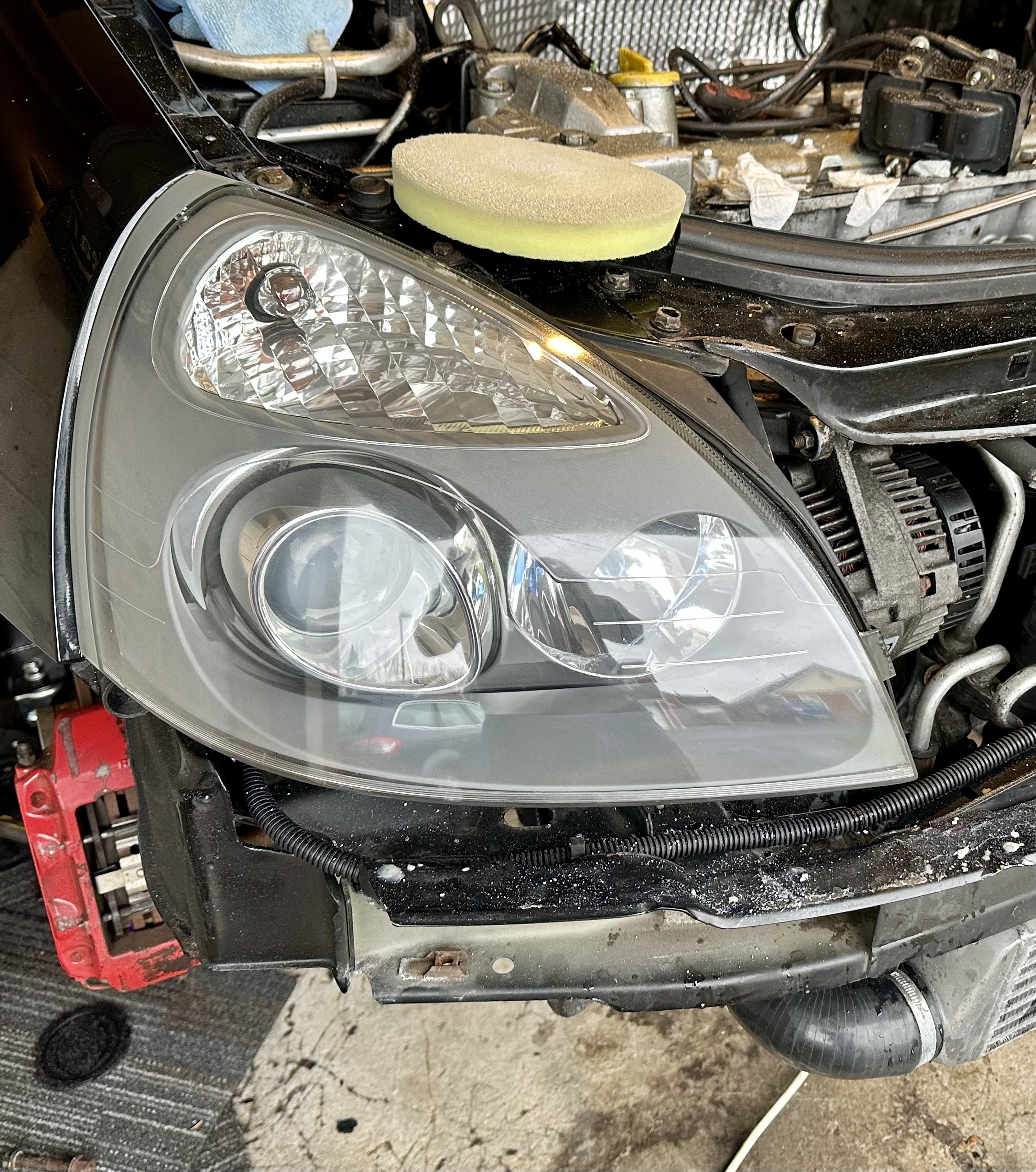

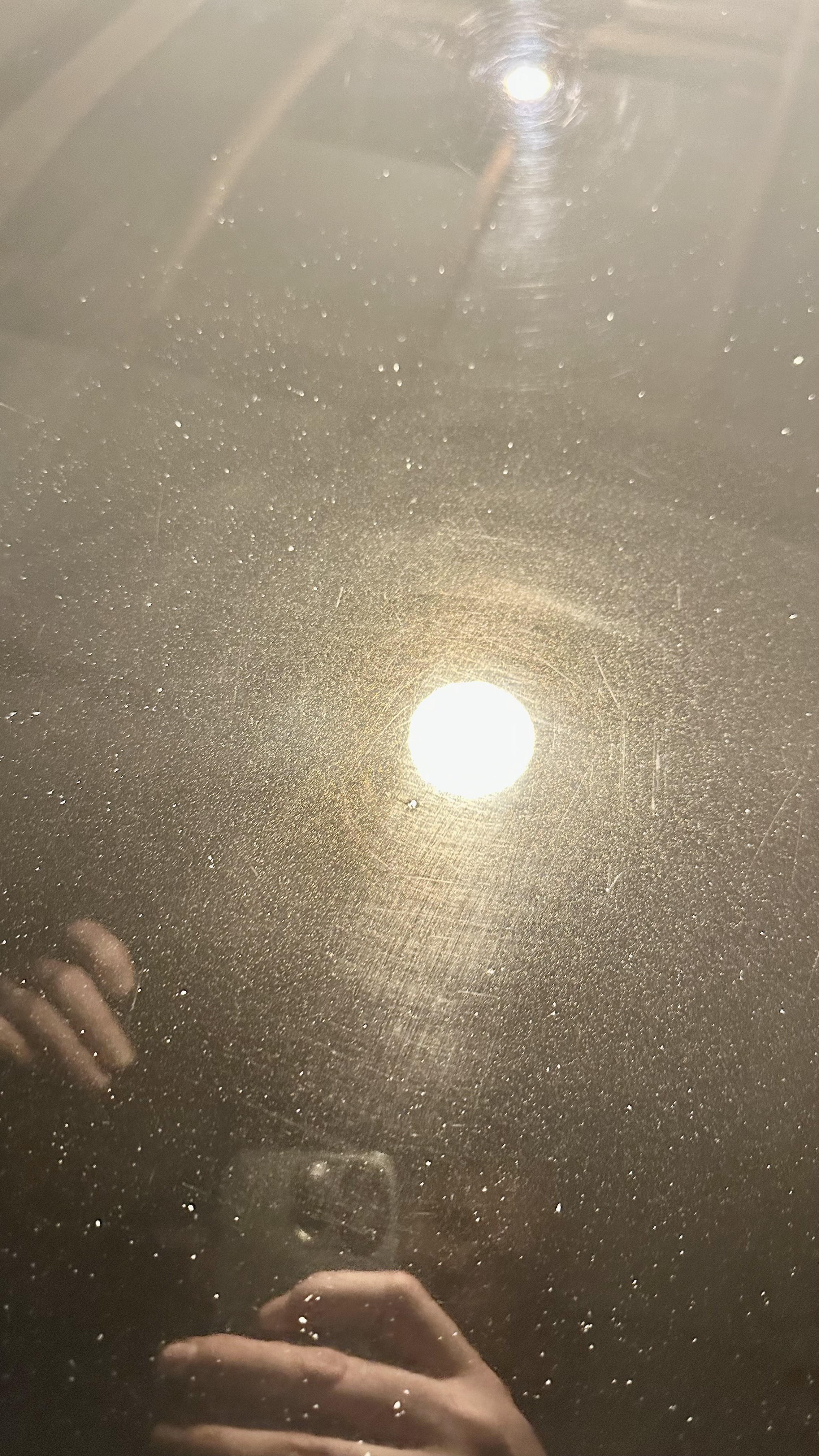

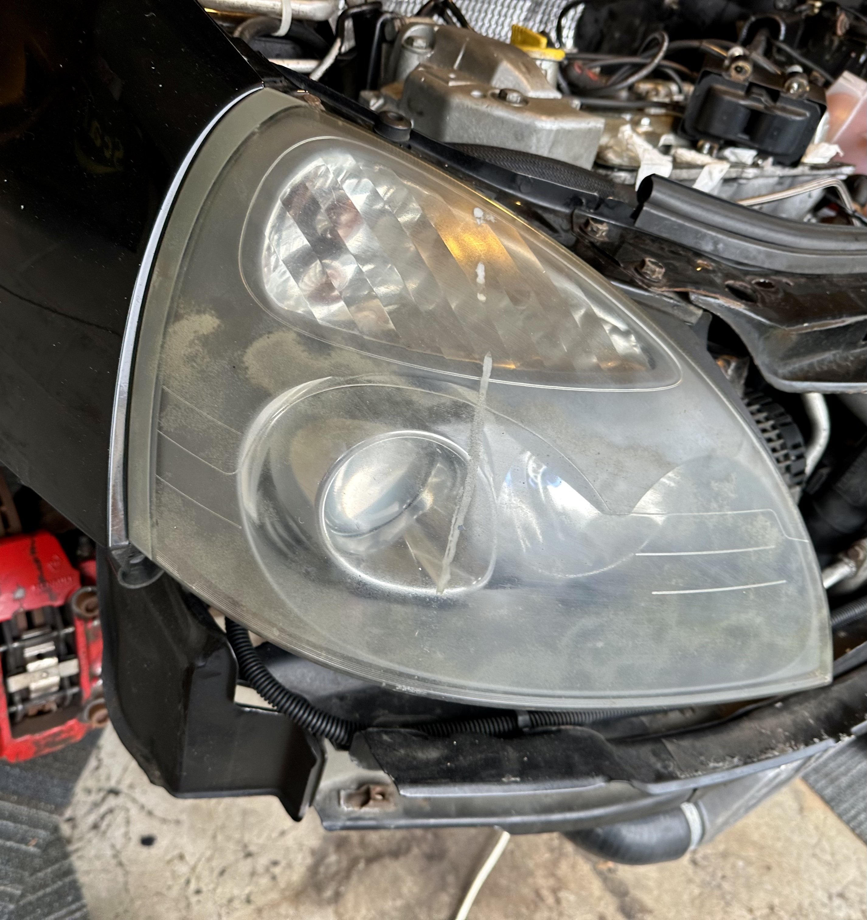

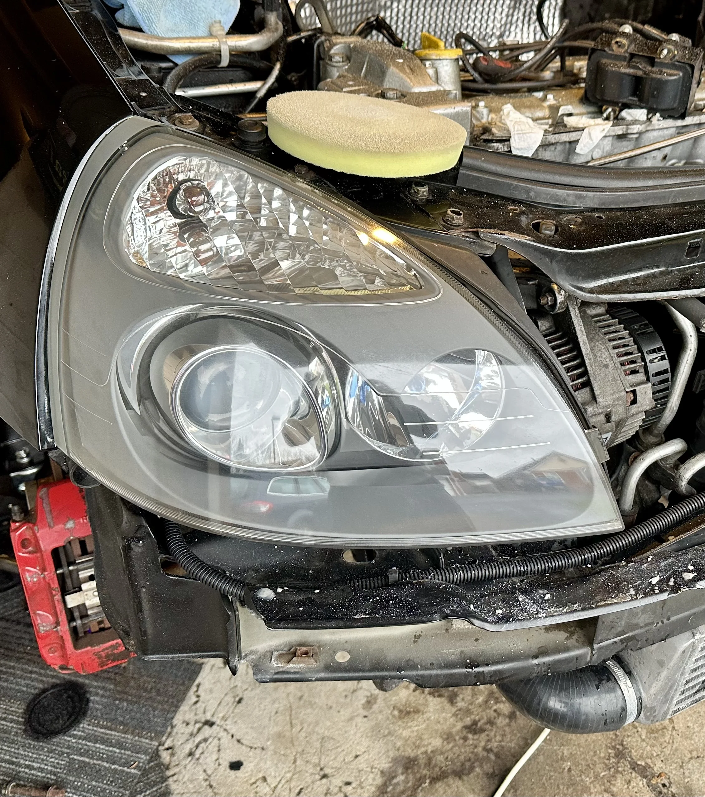

While the bumper was off I decided it was probably a decent time to polish the headlights. This is what it was like
I used wet and dry and went through 600 grit, then 1000, then 1600 and finished off with the DA with a bit of meguiars compound. They’ve come up unreal
One side done, one not
And the same treatment for the other side
With that done I got the oil feed back on the turbo but left all the boost pipes off. It fired straight up without any arguments 👍. For the first time in what must nearly be a year I pulled it out the garage under its own power and got a hose on the coolant lines to flush the shitty red stuff out of them. I’ll run it to temp a few times on water to make sure it’s all out and then fill with the proper Renault stuff.
After that, I got the boost pipes back on
And then the front bumper refitted too. All that’s left is a run up to temperature to check for leaks and then it should be good to go for MOT time. It’s desperate for a polish so that might get done first. The swirls are out of control 🤦‍♂️

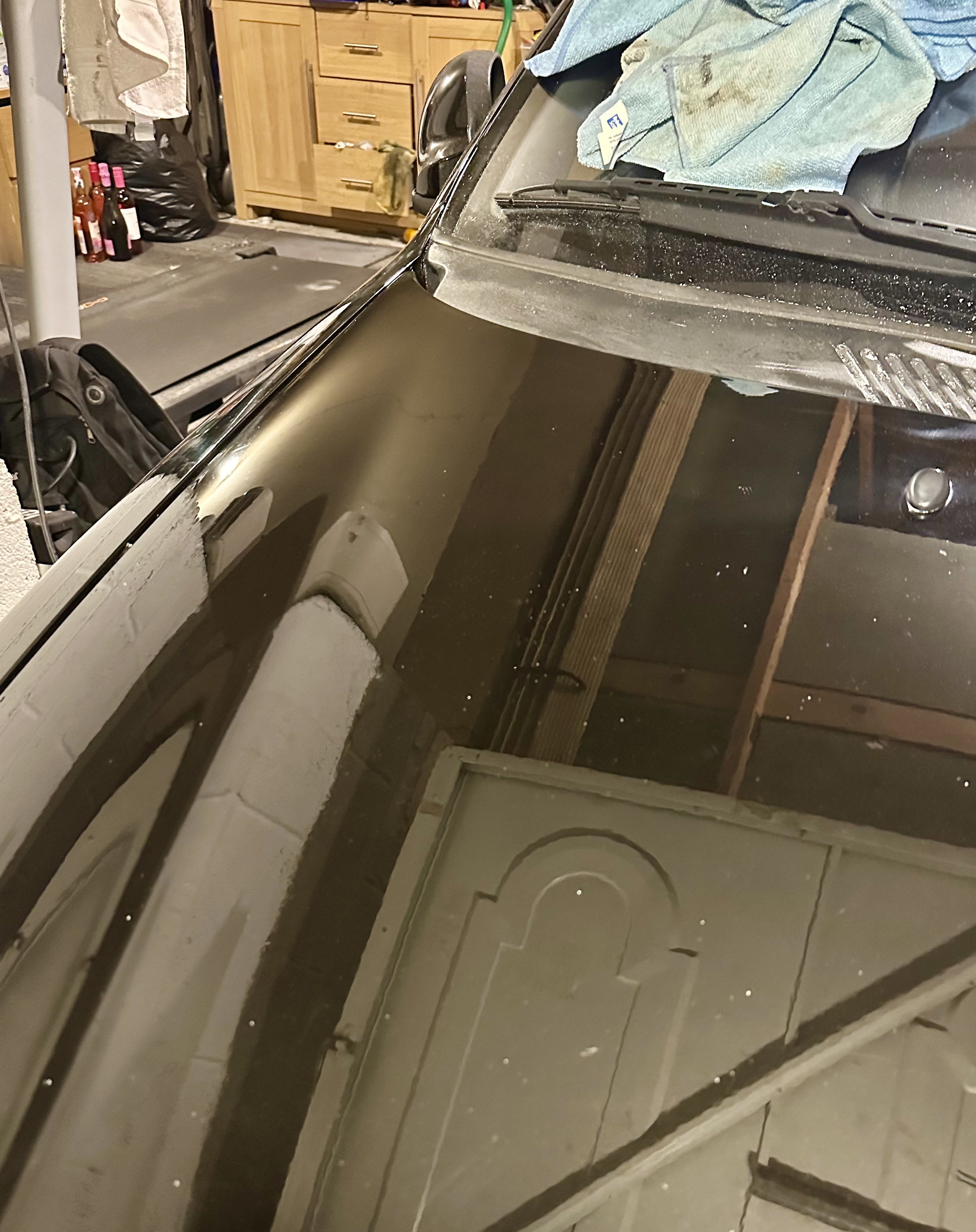

I clayed it then ran over it with the DA. There’s still some swirls left so it’ll take take another go or 3 but the initial results are cracking. I might need some more aggressive compound or it’ll take forever to do the whole car.
And a quick half and half. At least the roof is spot on cos the sofa cushions have protected it 😂

I had it up to temp and it seemed happy enough. It was a bit steamy with it having been sat for about 14 months and had a cracking rally idle until it settled down. There were no leaks which is awesome so as soon as my new header tank turns up I’ll drop the water and put some proper type d in it

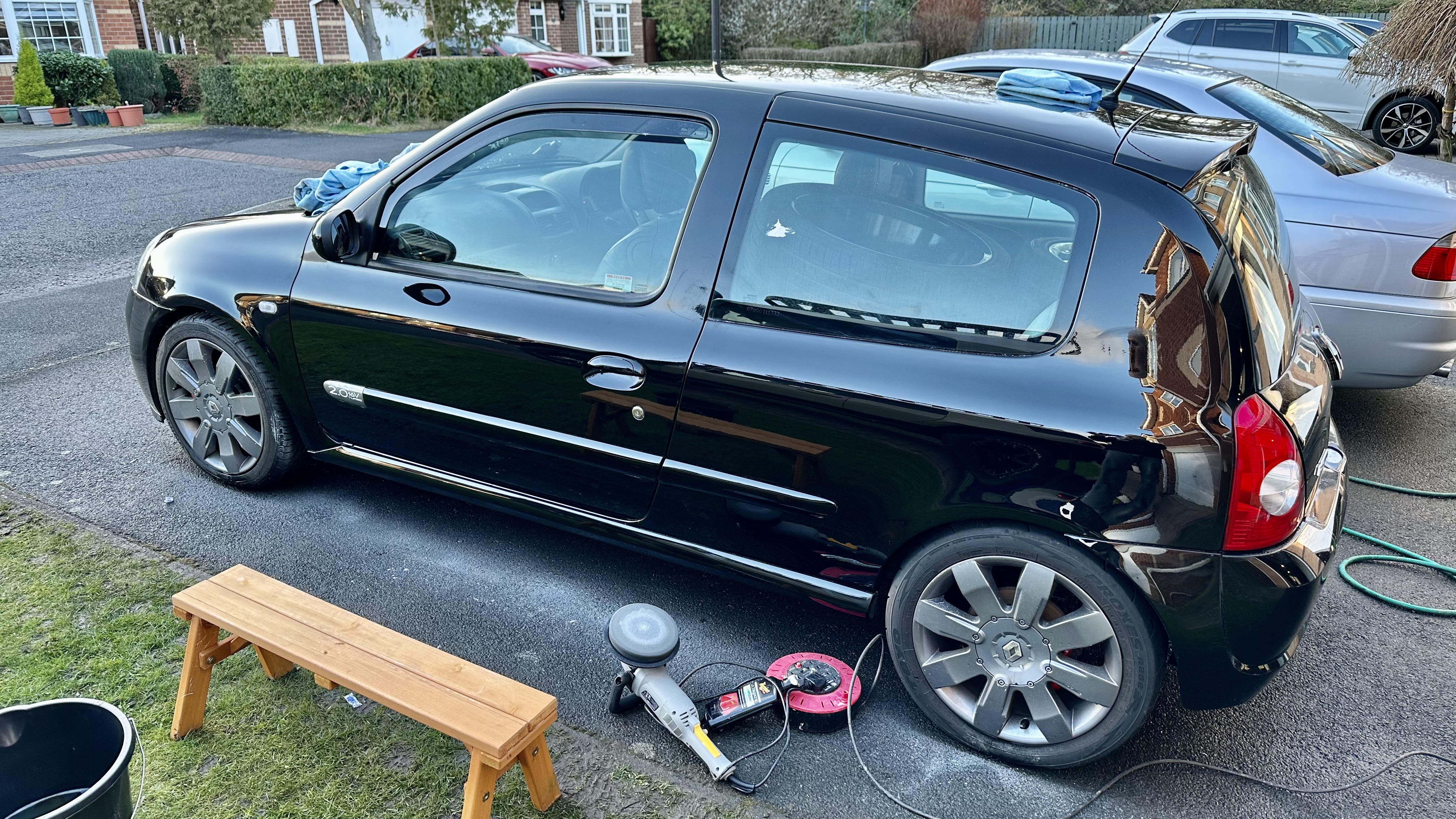

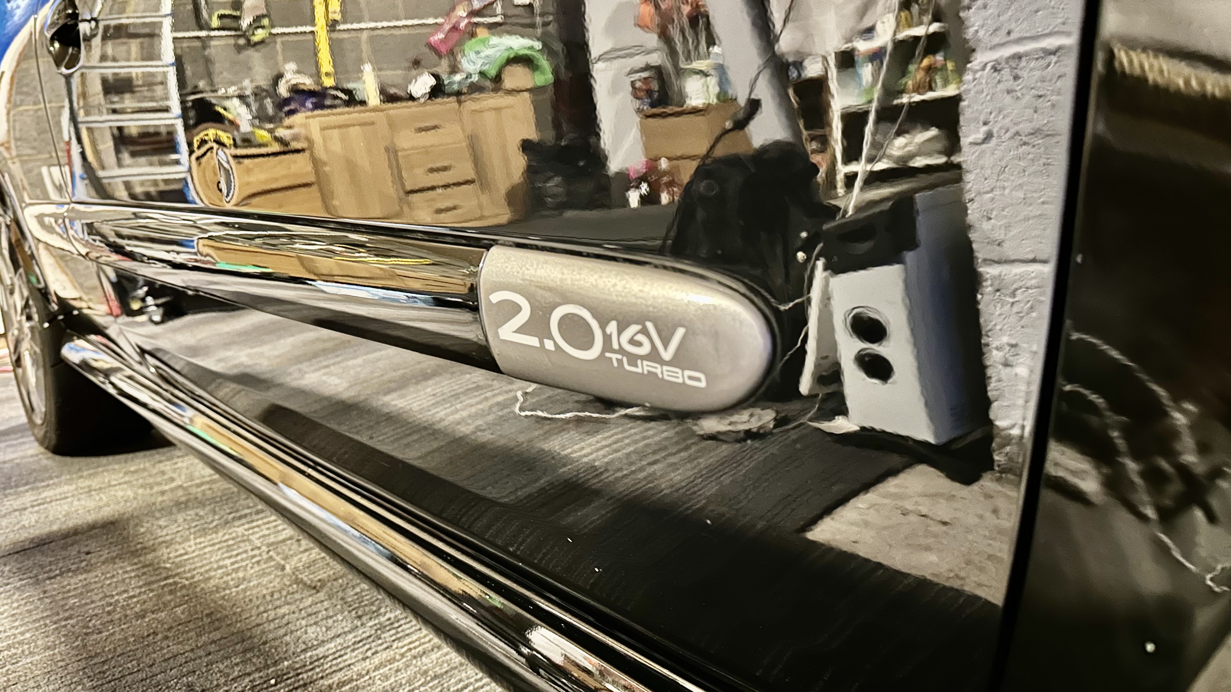

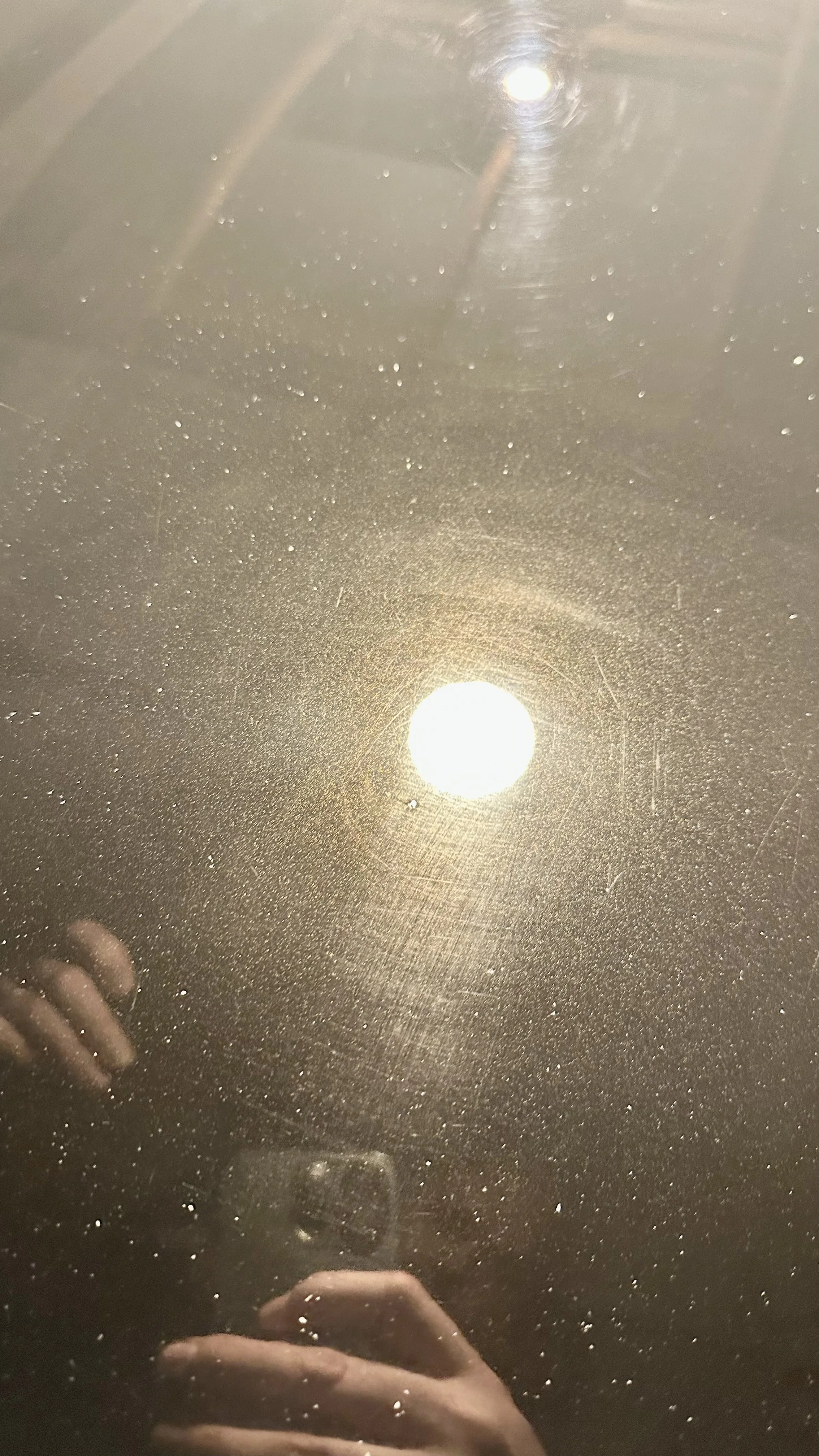

I then continued on with the machine polishing. I clayed the whole car but thought I’d stick with working on the side that’s usually against the garage wall as the rest I can work on when it’s in there. This was the result
The reflections in the black are simply stunning 😍
I’ll have to see how it looks in direct sunlight but under the lights in the garage it’s pretty much flawless. Slowly edging towards it being back to life!

In the meantime I finished off the polishing. There’s still a couple of odd deeper scratches showing and under really bright light some of the swirls are still just visible, but overall it’s come up really well. The gold fleck has come out in the paint and the reflections are really good. I just need some decent wax to seal it all in and really bring out the shine

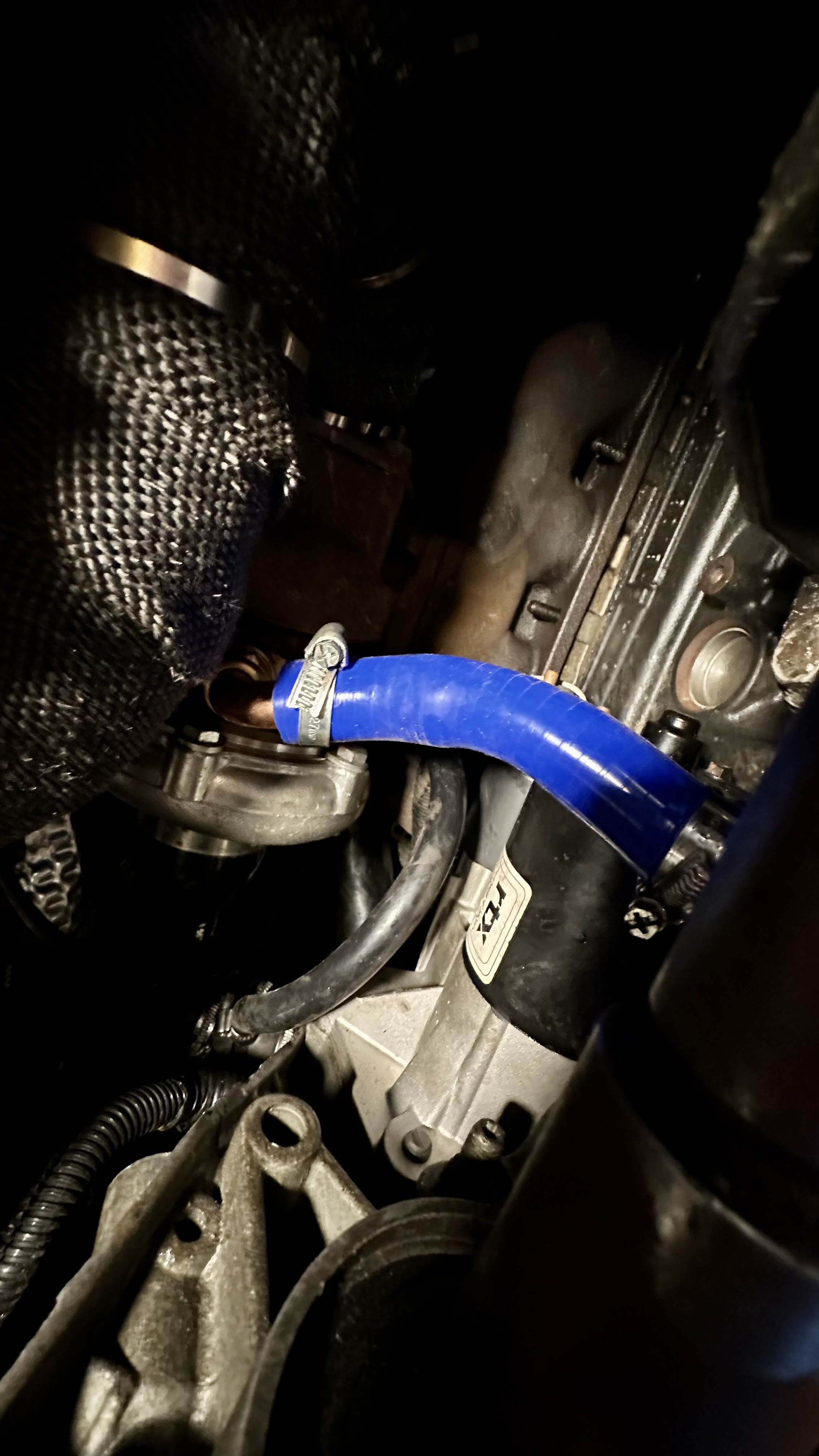

I got the new header tank fitted and some proper coolant in it. The bay needs a bit of a clean
With that done I left it to run for about half an hour. The idle from cold is still shocking but once it settles after 30 seconds or so it’s fine.
