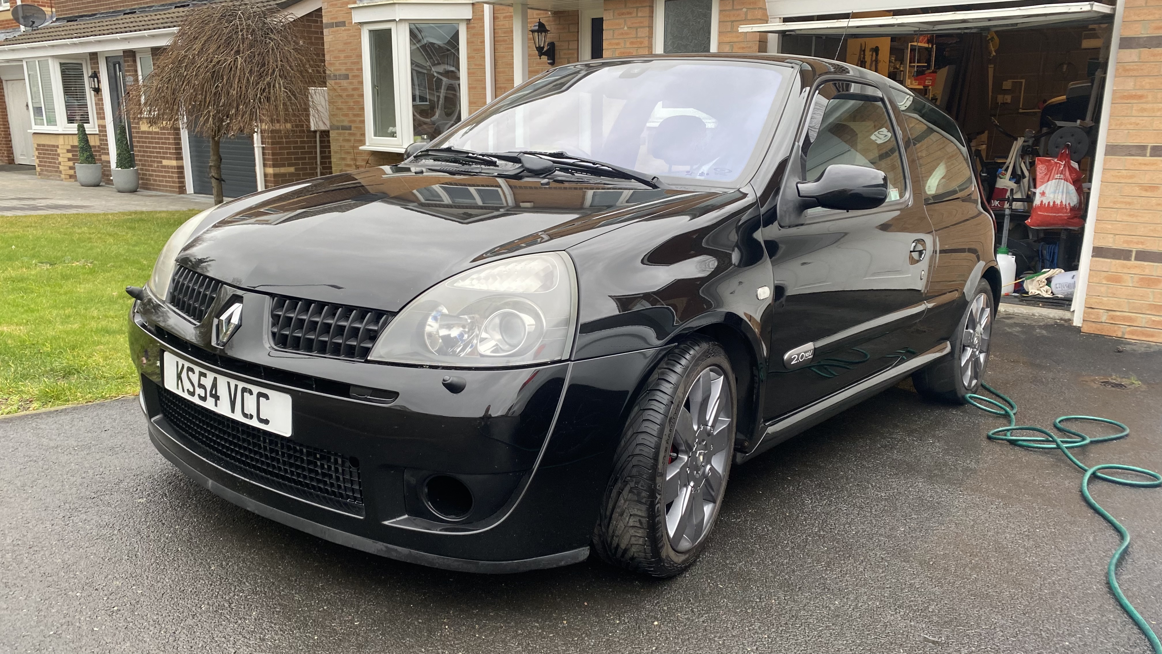

Clio 182 Turbo

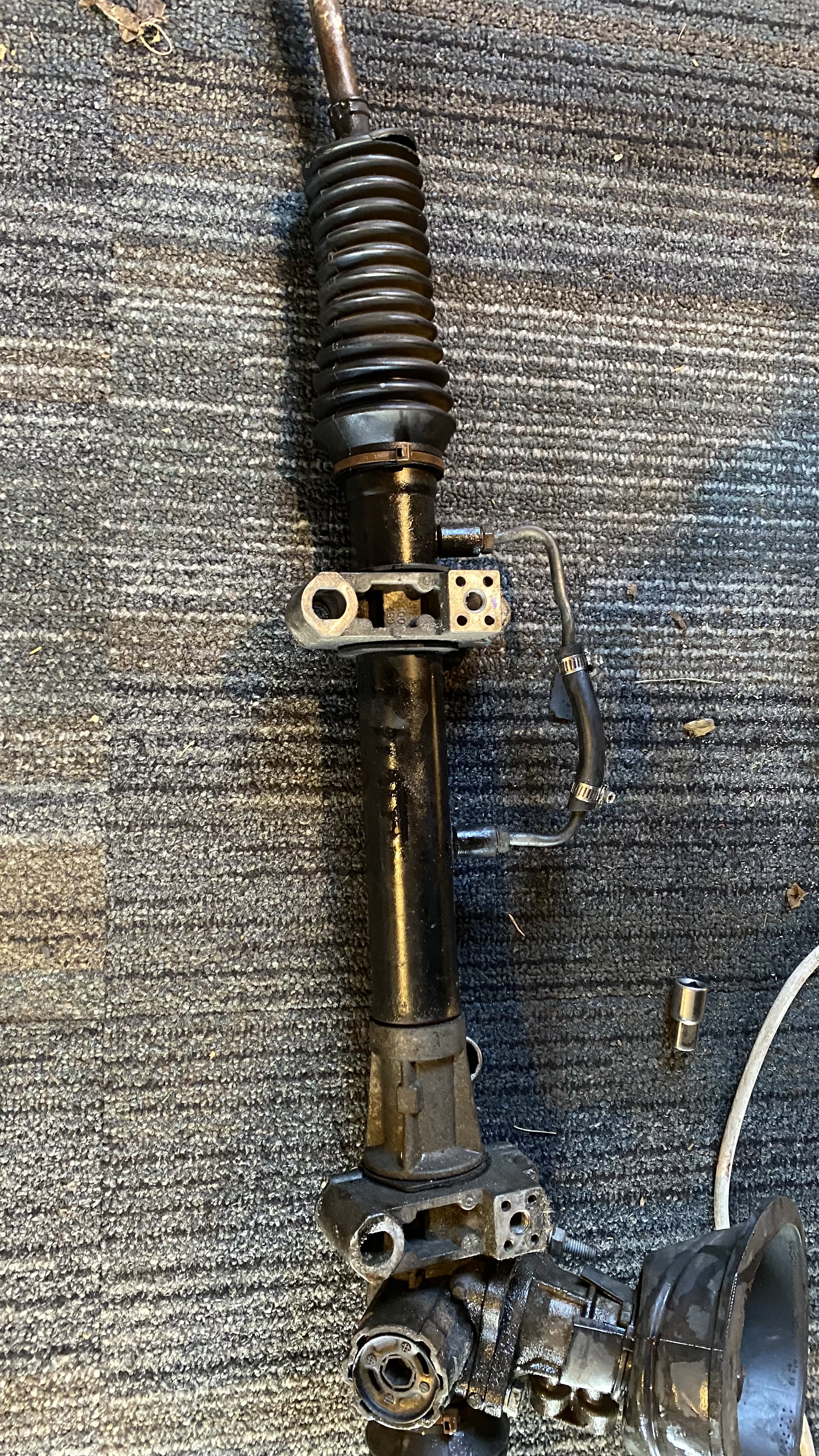

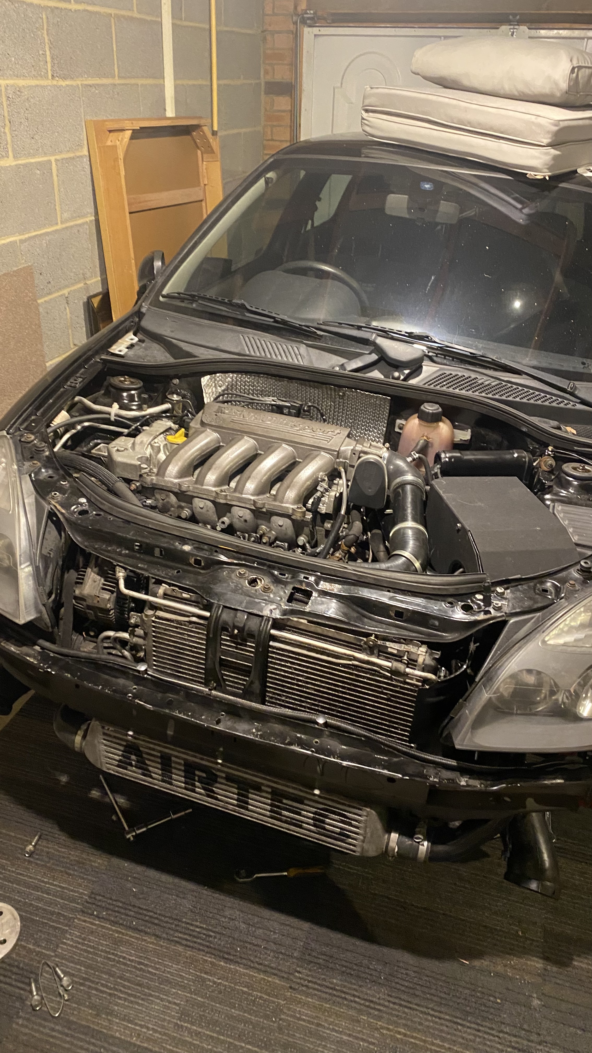

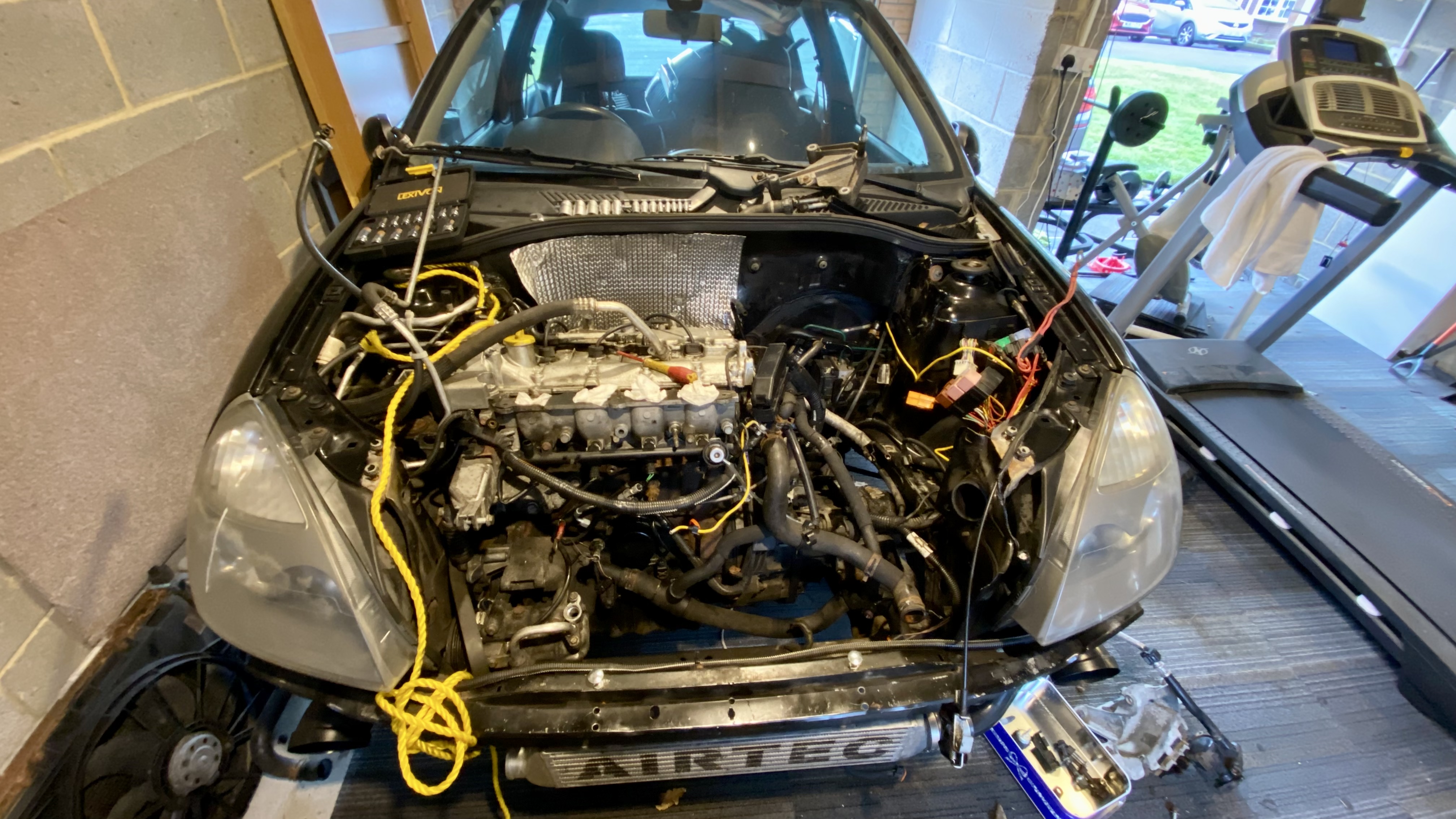

I don’t feel any closer to the road 🤦. I’ve 100% decided to go epas so stripped out the pas pump (pms pulley en route) and the pas lines as much as I could. Engine doesn’t look like it’s gonna run any time soon haha!

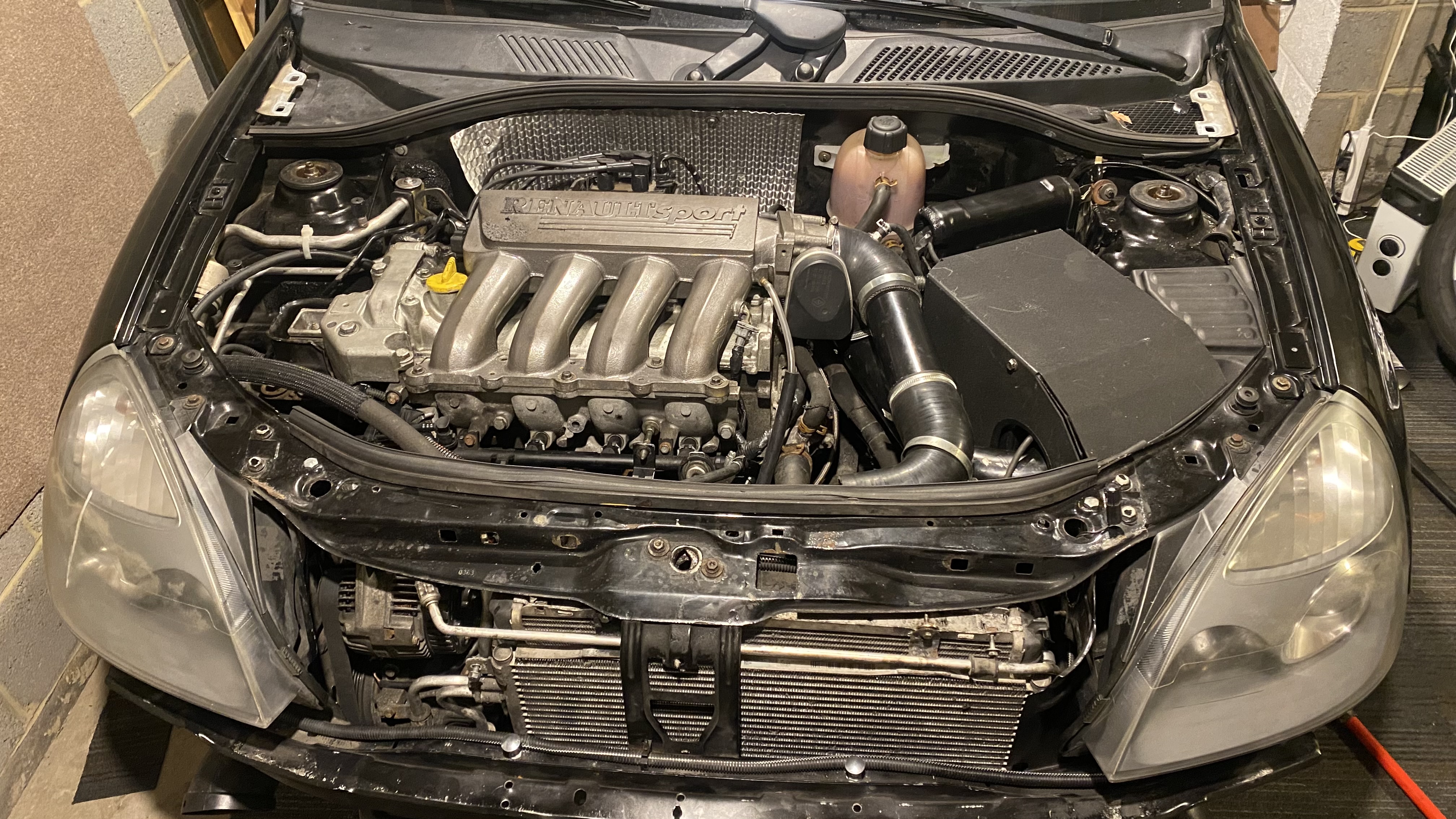

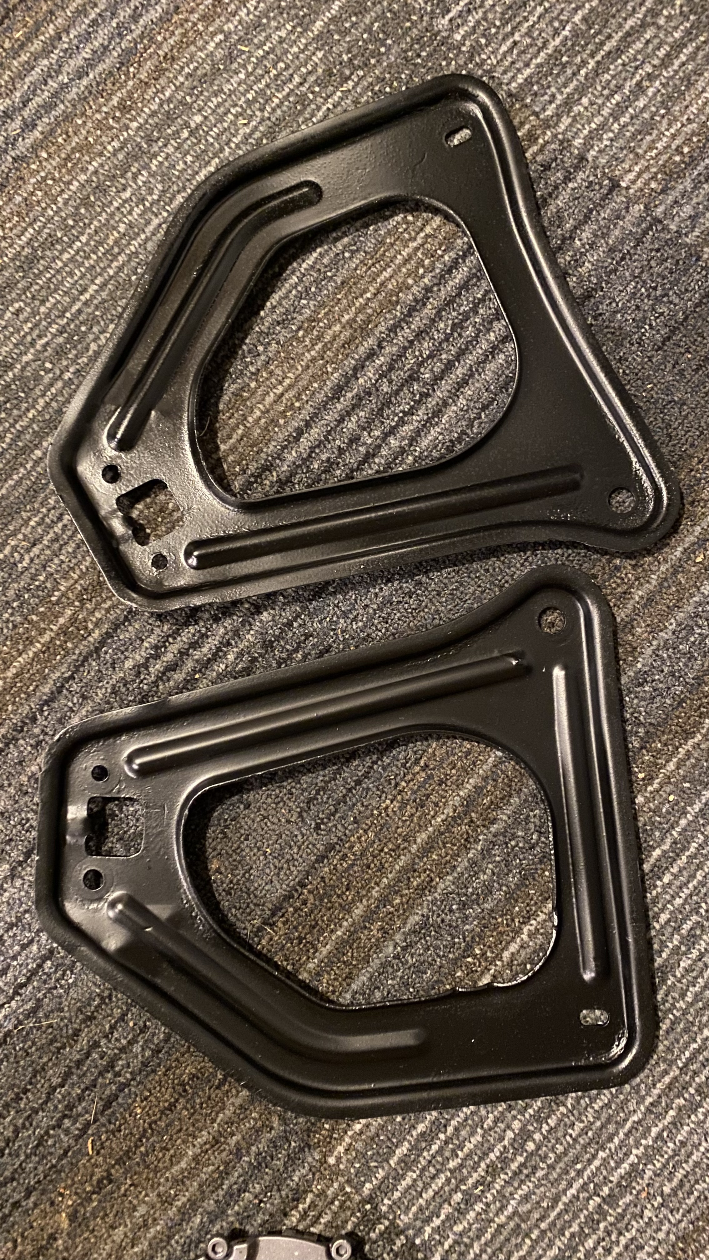

I also managed to clean up the subframe support brackets a bit too which have come up ok for a rush job
plan for tomorrow… drop the subframe, remove all the rest of the pas stuff, swap the boxes, put it all back together. Should be a doddle 😂.

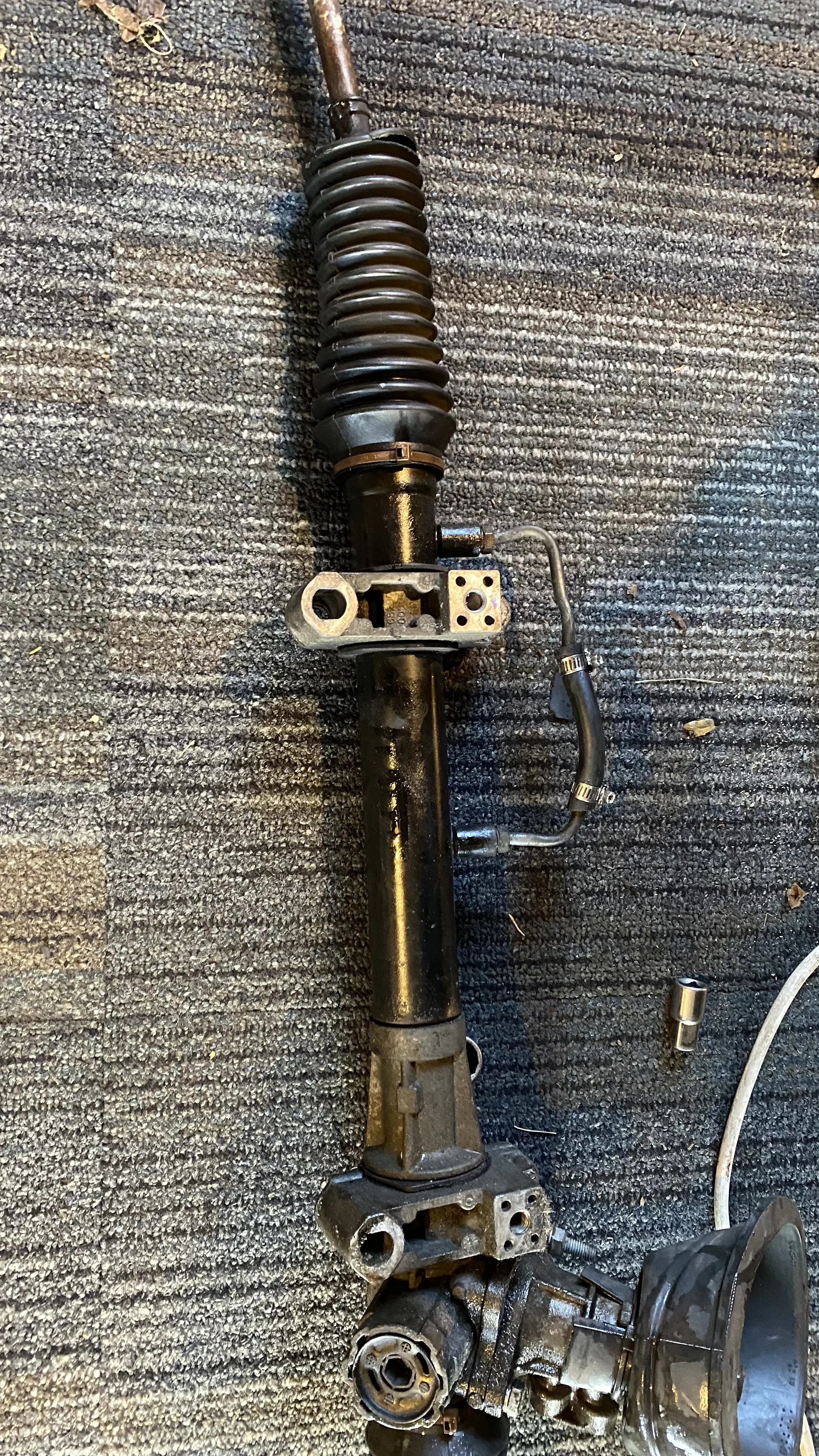

Managed a few hours today. Started by dropping the subframe which decided to be a total dick. Every captive nut gave up and turned a simple job into a right ball ache. Then to top it off the passenger side rear disintegrated at about 80% off so was totally stuck.
It dropped enough the get the rack off. I binned all the pas pipework and looped the rack with a bit of random hose I had kicking about
The subframe had dropped almost all the way off just on the last bolt so decided to crack on swapping the box. I dumped the old box oil (it came sealed with shafts in) and the oil was black and nasty. No floaters or anything but a million miles from my nice golden oil that came out when I emptied the current one. I had a think and decided not to swap them just now. I know my box works and has no crunches so just isn’t worth the potential trouble. Plus the dci box has a circlip diff which will last about 4 minutes too.
With that decided I put the rack back on, joined the exhaust back up (significantly easier with the subframe dropped!) and then put the subframe back up. I then chopped the arsehole bolt in half with the grinder so will have to order a new one of those at some point.
With that done I started putting it all back together. Got the shafts in, brakes/suspension all on, wiring done, most the coolant pipes on and most the boost pipes back in place. This is how it was left tonight. No point putting any more on because it’ll just make access more awkward when I come to fit the PMS pulley

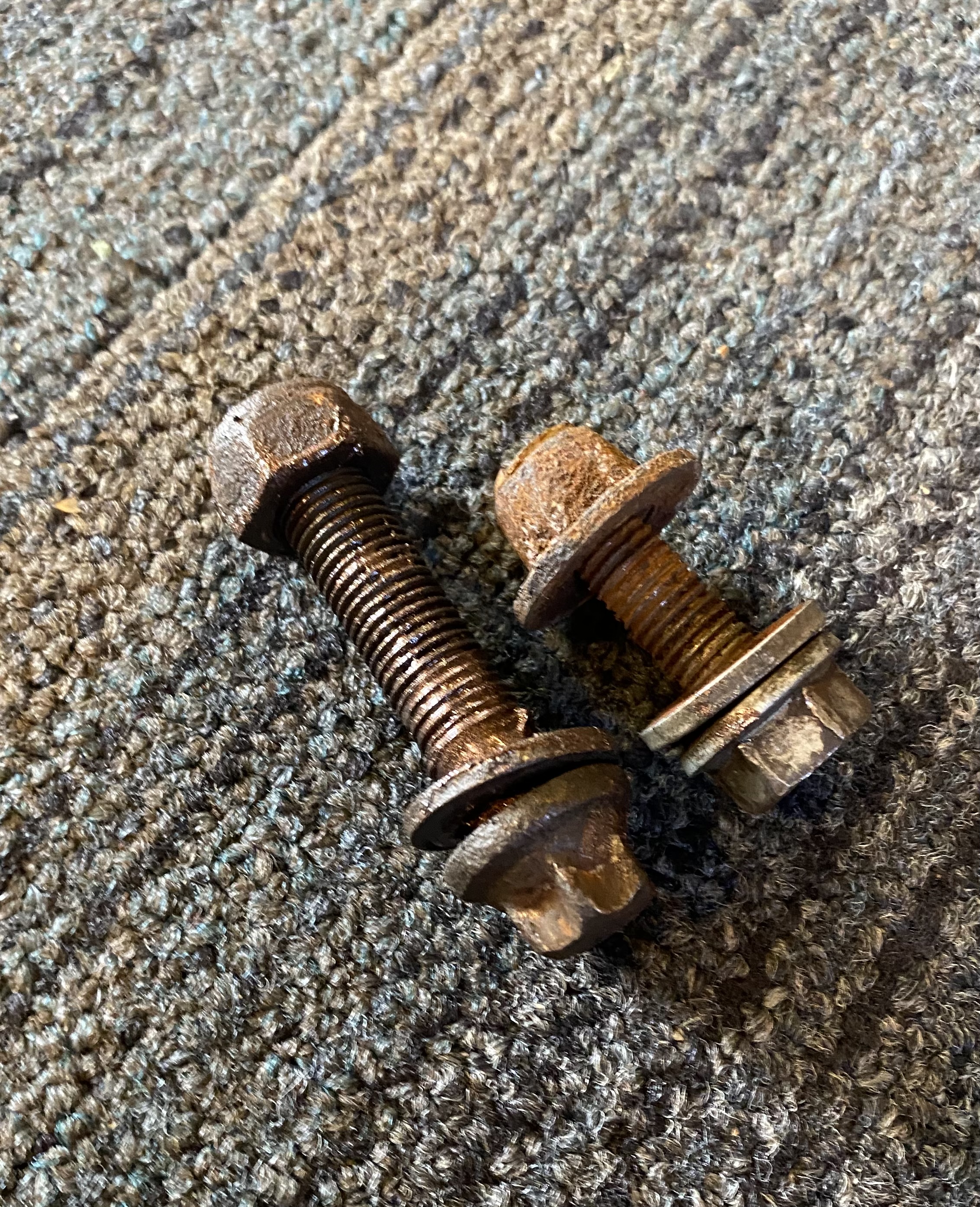

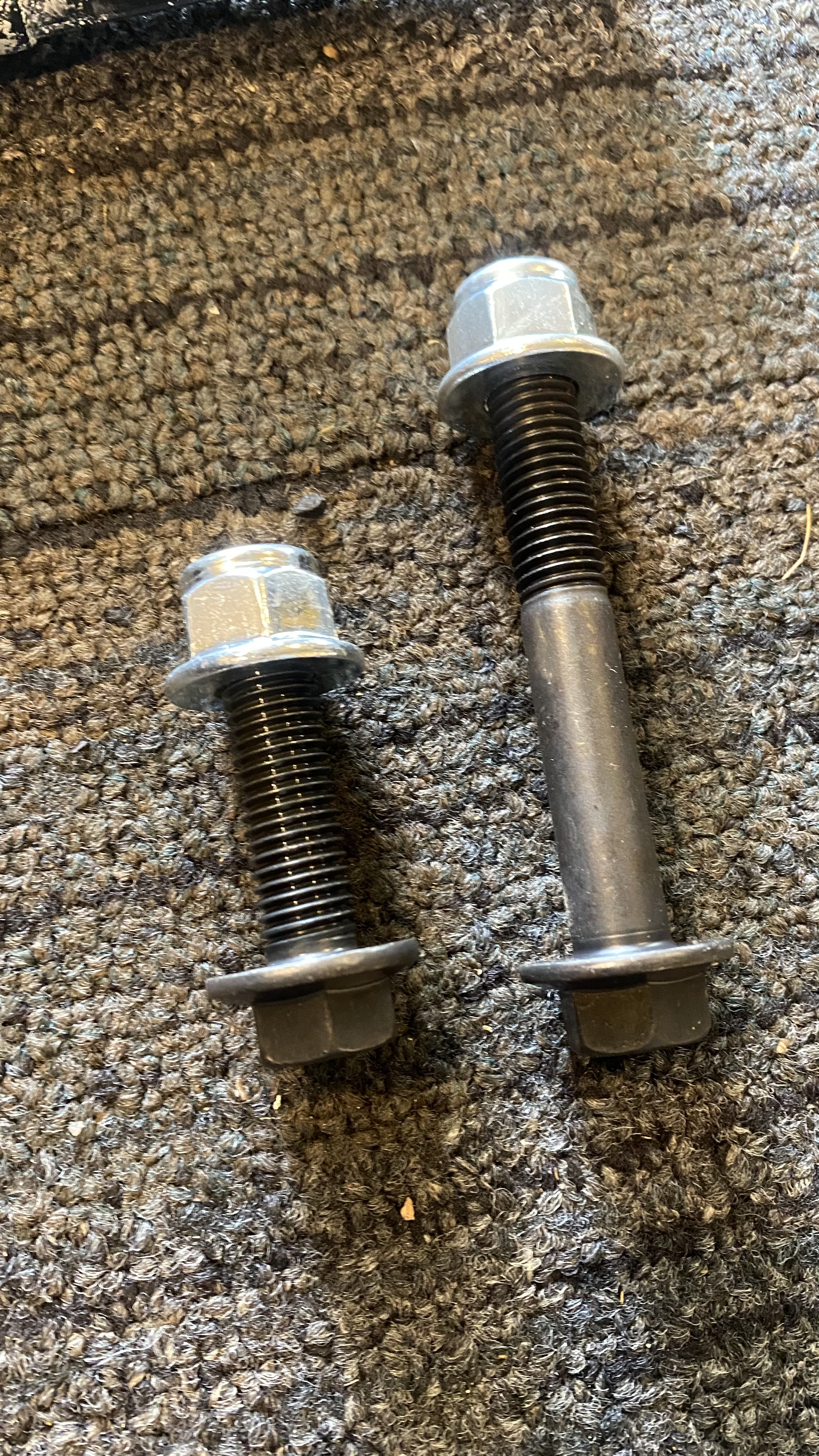

The PMS pulley seems lovely, really well made bit of kit. Fit was perfect. I also decided to sort the subframe bolts out too. I’d already angle grinder the back one in half and these 2 chunks of shite were in the front
Swapped them for some bolts you’d actually use to hold the front of your car on rather than something found in a box of spares
It’s now pretty much all back together. Just needs a final nut and bolt go over and it’s good to go. Almost looks like a real life car again! It all needs a good clean but the biggest waste of time of my life is almost over 🙃
7/10 for replacing those subframe bolts. I’d give you 10/10 if you used the proper captive bolts 😅

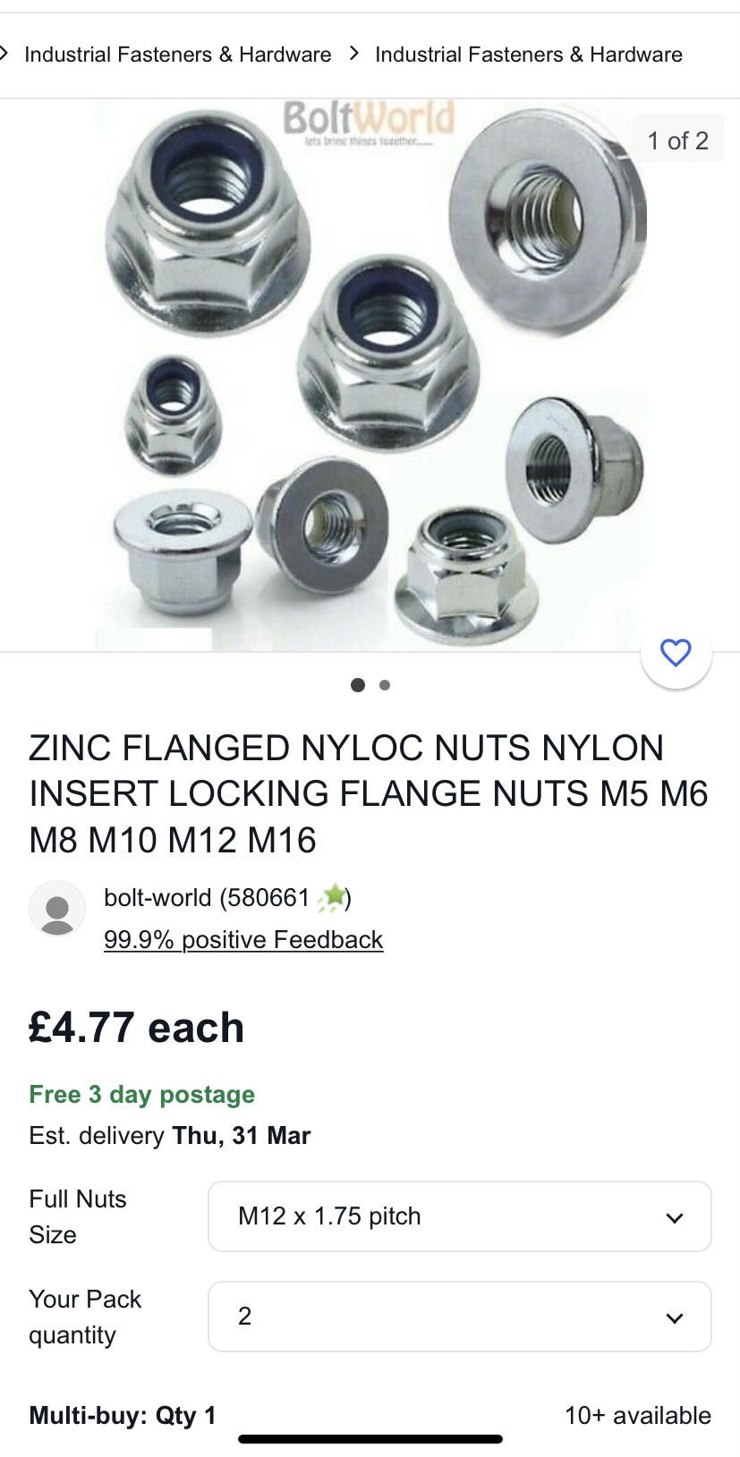

😂😂. I got a quote off Renault for the proper ones and nearly shat my pants. Set of 4 bolts and nuts was £101.04 + vat 🤦‍♂️.
I used MK3 Clio rear axle bolts to hold my subframe on
My gearbox is held to the engine using MK1 Seat Leon gearbox bolts 😂 Zinc coated from factory, no rust on them badboys
Love a good parts bin raid. Most the engine bay bolts are fine. The never ending gearbox oil leak does a great job of protecting them 😂
Aye they’re a bit expensive but think of how easy it’ll be to take off for you or the next owner 😊
Limited risk of that happening. If I ever sell it they’ll be a puddle of rust again by then! I’ve got a specialist tool for the new ones too (a 18mm spanner cut in half that wedges perfectly in the cutouts)

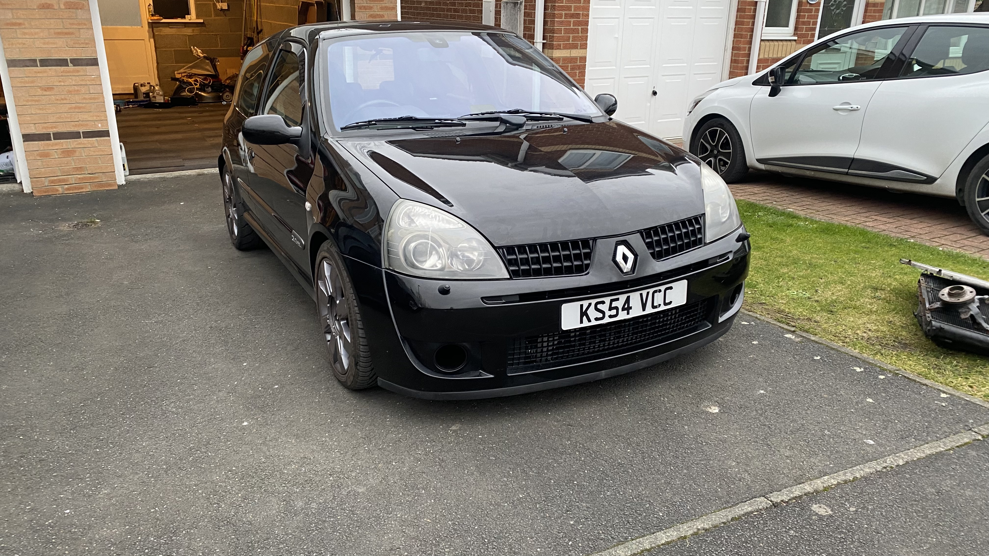

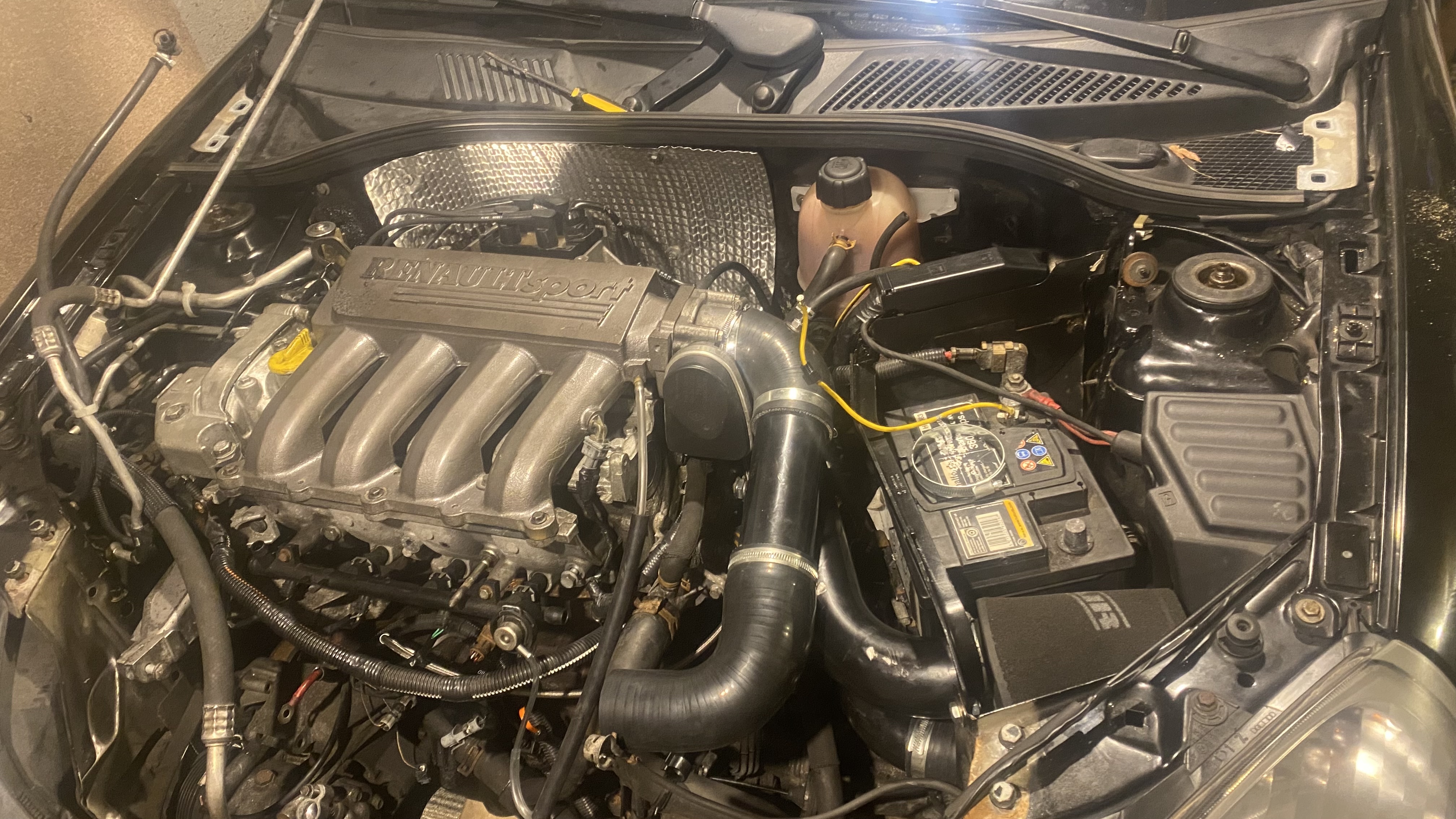

The little french shite is running again. Couple of slight hiccups along the way. I’d cocked up the gear linkage so only had 4th, easy fix. I’d also forgot to reconnect the clutch cable, again, easy fix.
With it back together it started straight away. It now idles at between 2k and 3k and whistles like a boiling kettle 😂. It only boosts to 6psi too so I must have a vacuum leak somewhere or the inlet manifold isn’t sealed properly. Either way it runs. It just needs a wash

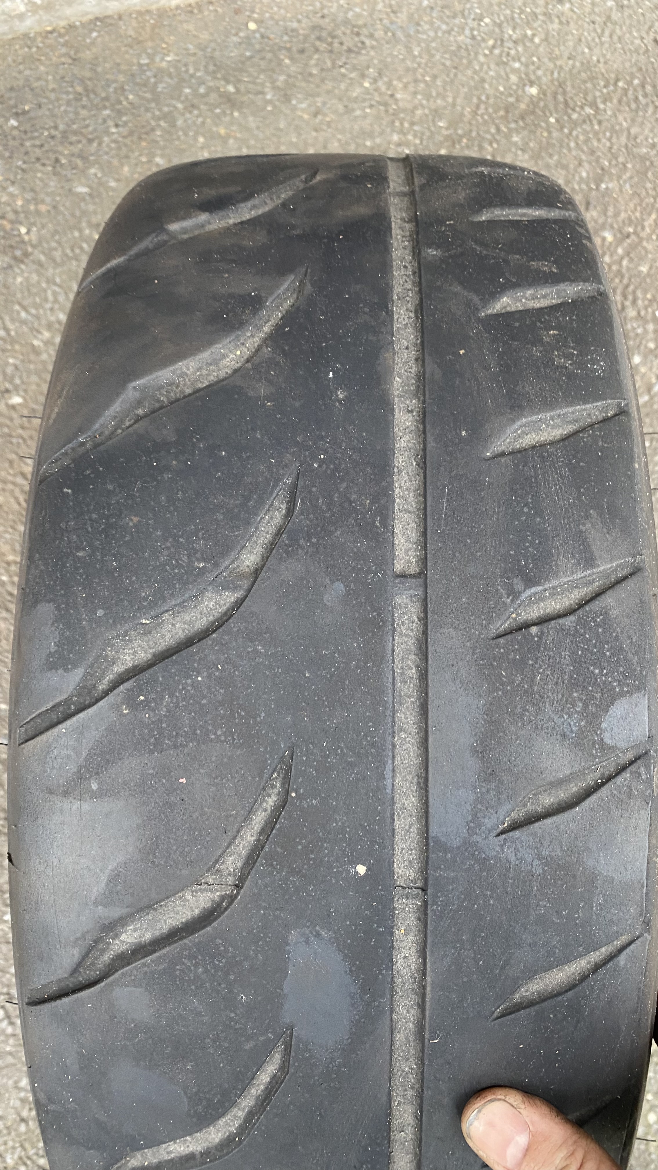

I did spot the front tyres are a bit baldy. They’ve only done 800 miles or so 🤦‍♂️. They are now on the back and the RS3s that were on the back are on the front. They should last a bit better and stand some chance of gripping a bit better in the wet

Idle issue is sorted. Not sure if it was the breather or the gasket between the manifolds. Either way, I covered the whole lot in a s**t load of gasket maker and it’s fine. I think one/both may have been leaky for a while cos it’s never idled this well. On the downside it now sometimes cuts out when slowing down. Fix one thing and the next thing breaks. Love french cars me. More investigation required there.
After 3 days of daily driver it’s already covered in salt and bird shite. Bit of a shame really given it’s only seen a wet road twice in 5 years

  • The rainsport 3s are s**t. The side walls are too soft and they are sloppy and nasty. They grip worse than the R888rs in the wet so are a waste of time and going in the bin

I've just got Rainsport 5s on my 2118s, and I I kinda agree with you.
I'd read some good reviews but grip on damp roads is dicey at best and as you say, the tyre walls do flex a fair bit and give a bit of a pogo effect when really pushing on in the corners. I'm quite disappointed in them tbh
Bloody hope not just ordered a set for the track car :cautious:
Genuinely felt very dicey on damp/greasy roads.
On tight corners, if you really stuff it in, as above, it gives a weird 'pogo' effect to the point I've been round to check my suspension because I thought something was wrong with it.
I'm on cup shocks with eibach proline springs, so not a superduper set up, but competent enough for some hoonigan action.
It may be the tyre size. I've just gone from standard 16" to 2118 15" with a taller tyre wall, but still.....I won't be getting them again.

It’s now covered 6000 miles since being turbo’d. I had my first fault yesterday and the 8 year old battery gave up. I ended up having to pushed in greggs when it wouldn’t start again 😂. It claims 38mpg on the trip computer too. I’m not sure I believe it, but if that’s right it does 10 more mpg than my 5 series did! It’s 100% the best daily I’ve driven

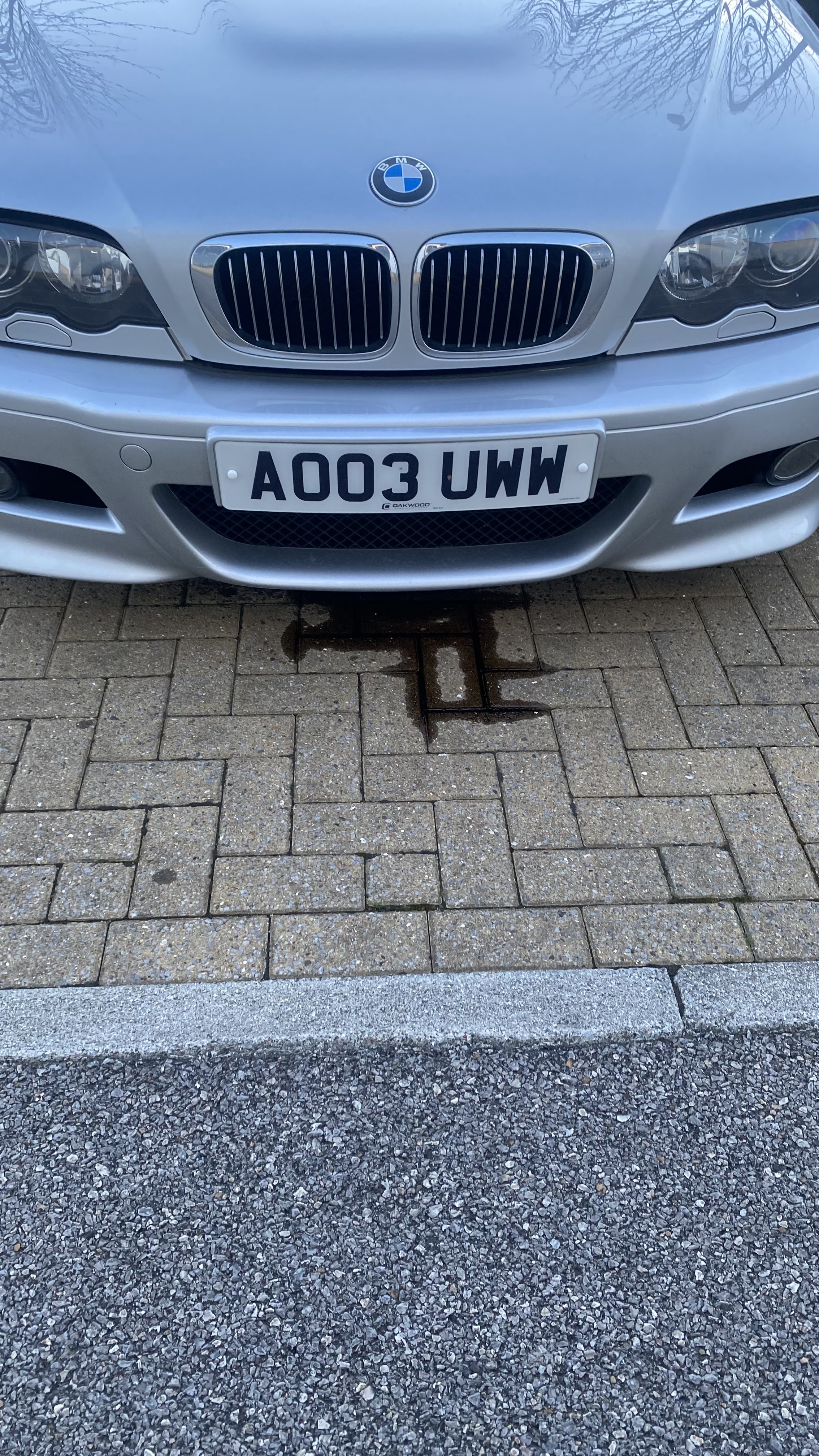

Update on that one… the M3 shat it’s pants on Friday and started pissing oil everywhere. Took it to a local garage with the dealer’s recommendation and it’s squirting Oil out from somewhere above the AC pump. Oakwood collected it 8:45 this morning to repair. Can’t say fairer than that!
Fair enough then if they’re sorting it all. If they do then to me it means a lot and I’d likely return again later.

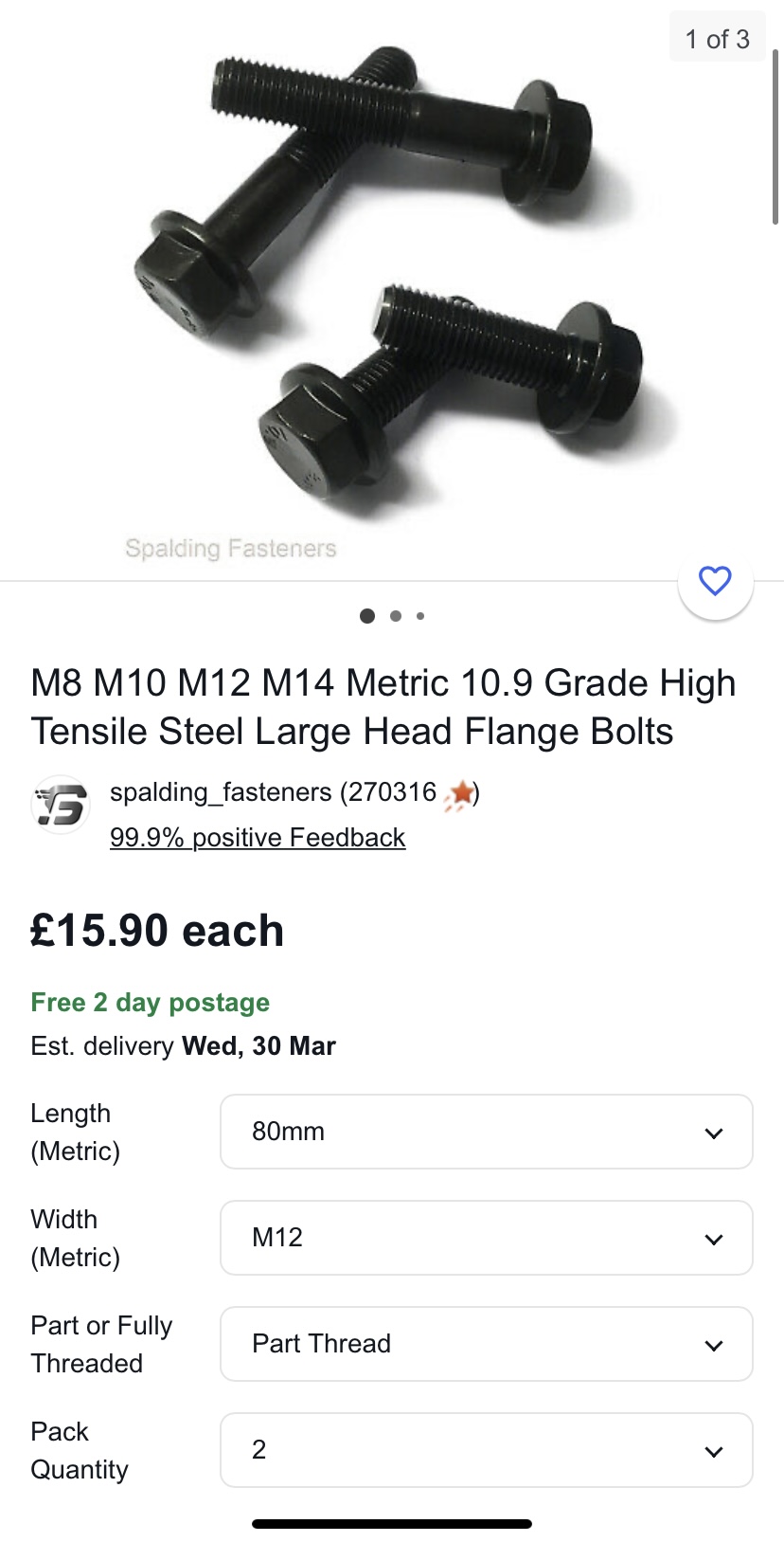

What bolts did you use for the rear subframe?
Thank you so much 😊
No worries. Just don’t use a swan neck ring spanner on the nuts or you won’t be able to get it back out once it’s tight 🤦‍♂️. There’s space to get a normal spanner in from the inside
