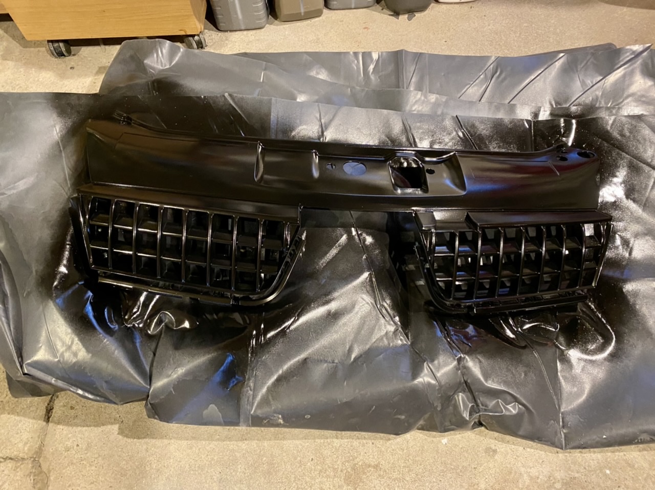

After finishing that I decided that the top grill needed some attention. I whipped it off and gave it a blast with some satin black. It’s now sat in the airing cupboard with the wife’s towels to go off 😂. Looks shiny in the pic but it’s just cos the paint is still wet. Depending on how this turns out I may or may not also do the fog surrounds and bottom grill too
Yarp
  182 Turbo, E46 M3

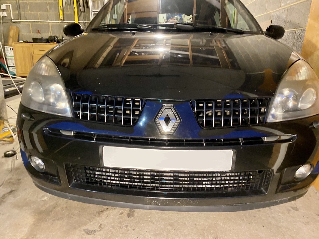

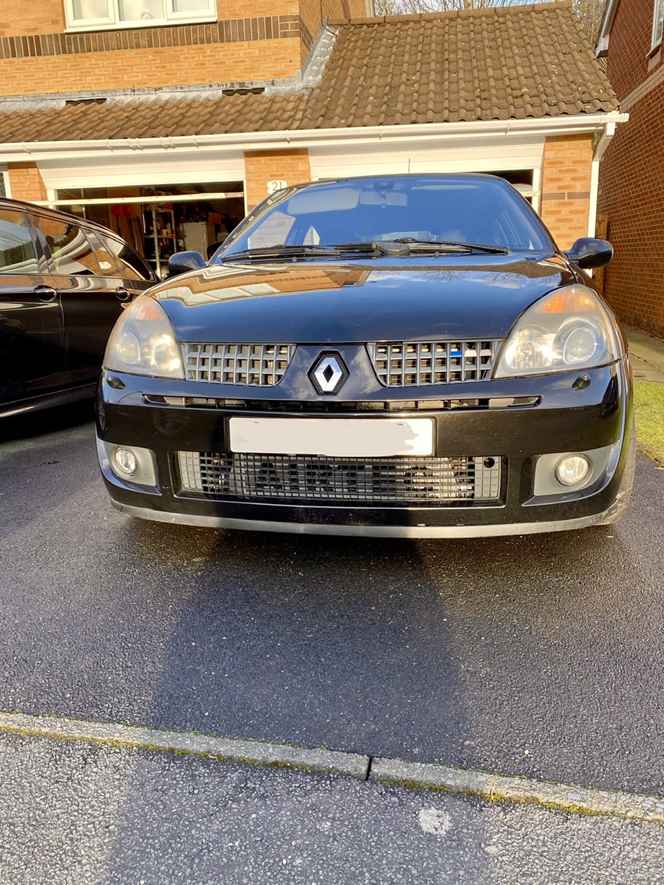

The top grill turned out really well so decided to do the bottom grill and fog surrounds too. It’s really freshened the front up. Just can’t decide whether to stick my little french stickers back on there again. The flash doesn’t half highlight the stone chips and the splitter took a bit of a battering taking the bottom one out 🤣.
before:
After:

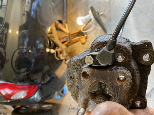

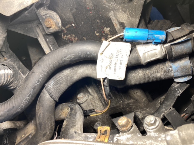

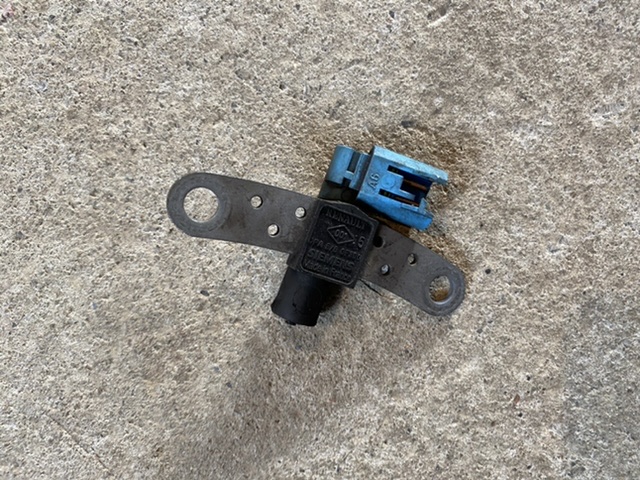

Mission misfire continued this week. I ordered a new crank sensor and also got a loan of a know to be working coil pack just to be sure. The wiring for the sensor has been badly changed at some point with the wires twisted together and almost taped up. The sensor eas
Swapped the new one in and fitted the coil pack and there’s further progress been made. The rough running is now down to about the first 20 seconds after it starts and then it’s fine. The hesitation when revving under light load is pretty much entirely gone and the cutting out when slowing to a stop now only happens maybe 1/10 times.

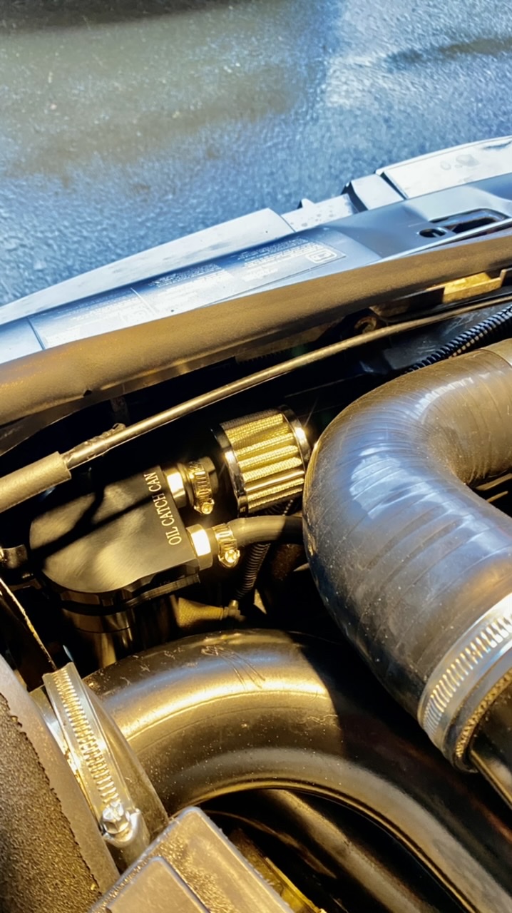

when the revs are dropping at idle it does sound like there’s an air leak down the back of the block somewhere. The acoustic valve has gone and that now links to the FPR, the carbon canister feed is blanked and airtight and the one that goes to the brakes is connected and airtight. Not sure there’s anything else down there? What’s the port for on the underside of the upper inlet? Could that be leaking?
If there’s nothing else I’m half tempted to drill a hole or 2 in the blanked carbon canister pipe to increase the idle speed slightly and see what that does

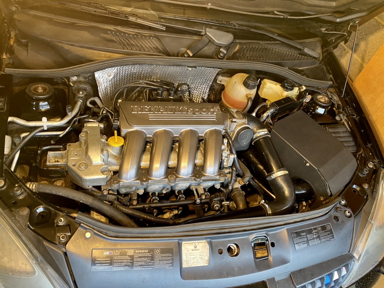

Had a bit more fannying at the weekend and I’ve now got the cutting out to go altogether and the rough idle down to the first 30 seconds or so. I’ve spoken to Chris @ EFI and he thinks it could be because it’s trying to run too lean at idle and it’s taking a while for the lambda to warm up and compensate.
It’s also been running 10psi of boost which on a gt28 and standard internals is a recipe for disaster 😂😂.
I tried to sort that tonight bu adjusting the actuator arm which has been successful and it’s now down to 8psi, but I’ve had to adjust the preload so much it doesn’t come on boost until 4k now 🤦‍♂️. New 7psi actuator has been ordered 👍

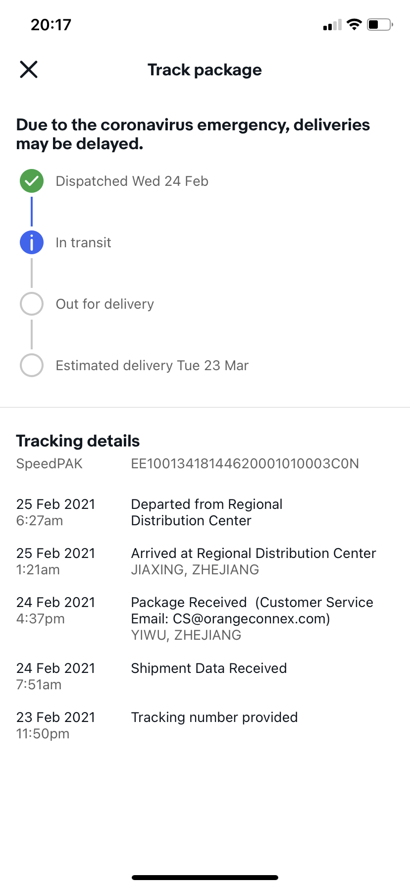

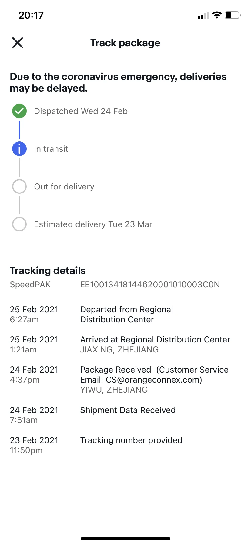

It’s interesting you say that. The actuator I’ve ordered was from Shenzhen and wasn’t due to turn up until May 😳. It’s since been cancelled so onto plan B. Is there anything you’d recommend? It’d have to be manual with the ecu having nothing to do with boost at the min

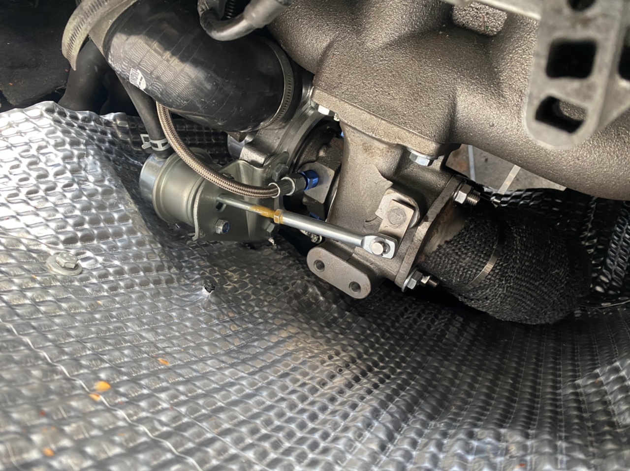

The wastegate seems ok on mine for the application to be honest. On actuator pressure it’s been holding 10psi without fluctuating at all. I’ve used them before in “reasonable” boost applications and never had any problems with them. When you factor in the cost they really are a disposable item. A set of front disks and pads costs more than the turbo and we don’t have this drama with them. They just get used, destroyed and binned 😂.
Anyway, I’ve ordered a manual boost controller and a new bracket for the actuator. The current one sits at an awkward angle and is pretty much touching the heat shield as in the pic below so seems like a good time to sort that too

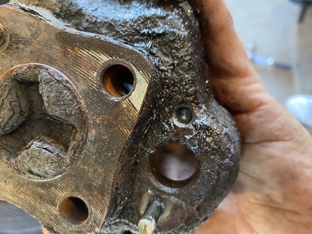

My build has hit a small set back after I found all the exhaust valves in my donor engine we're banana shaped 🤦‍♂️🤣
Absolute nightmare! Been there, done that, didn’t like it 😂.

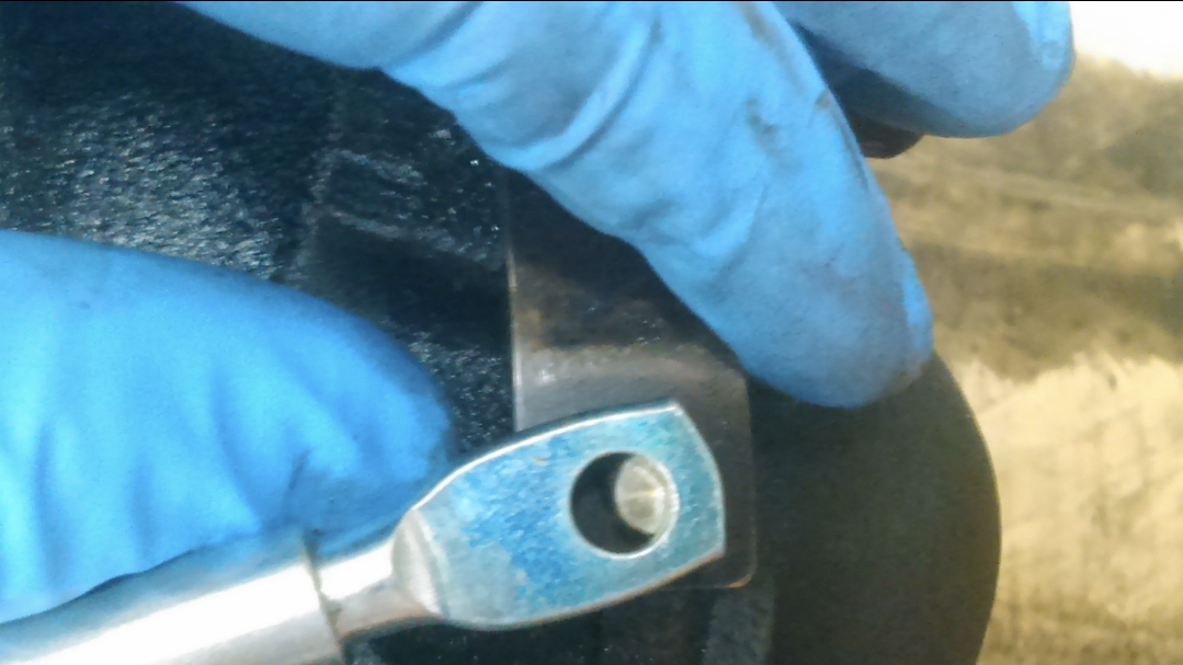

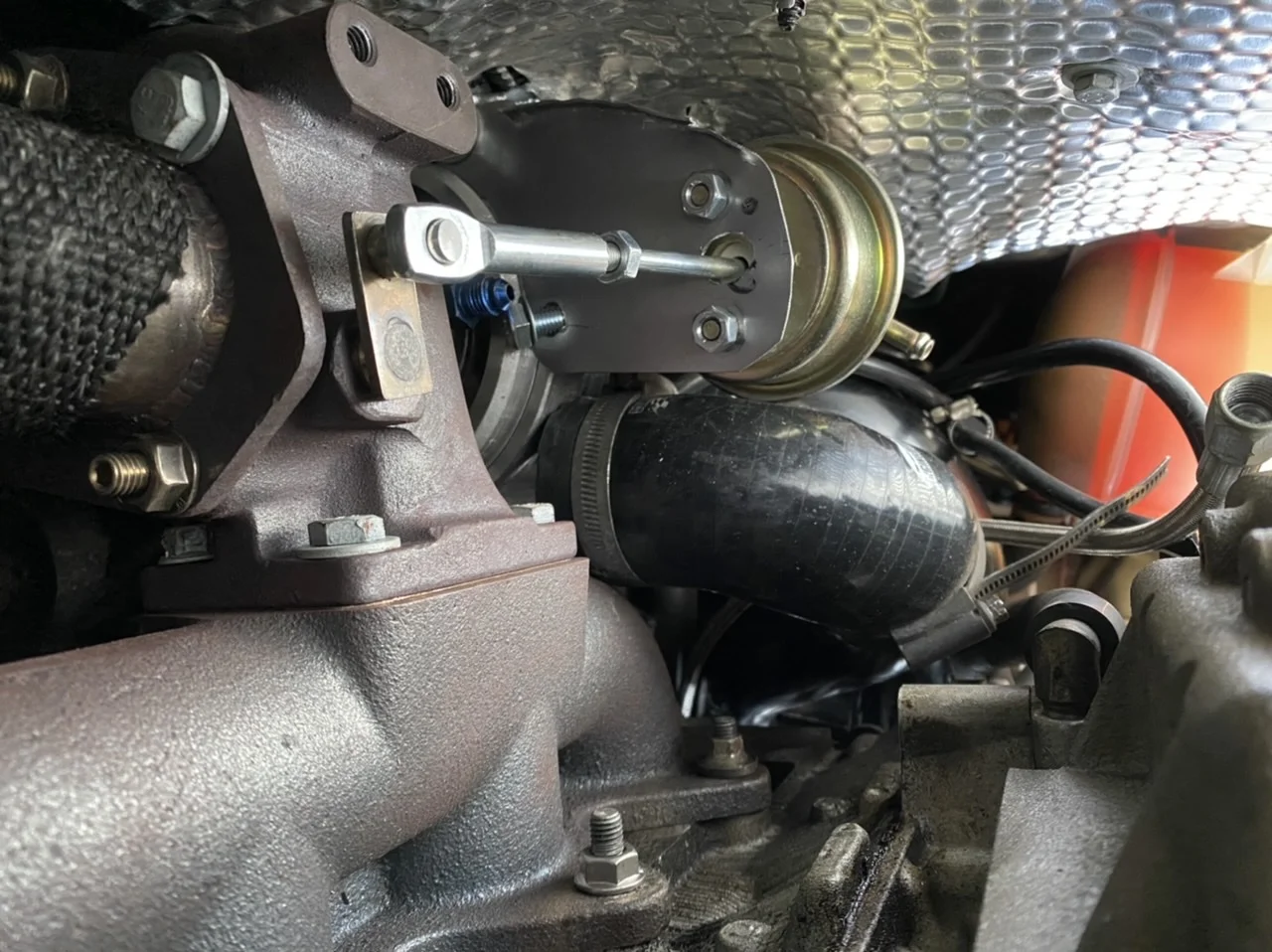

There’s no holes on the arm, it’s just a threaded rod that needs adjusted. Originally I set it so the wastegate was closed then just a smidge more on it just to give a little bit of pre-load. Setup was perfect aside from the boost 🤦‍♂️. On the original setup it made full boost by just over 2k and held it perfectly too. I’ve always had it before where it’s spiked and tailed off slightly but this has been bang on.
Pretty gutted I didn’t get a 5psi one, that would make life much easier haha! Could need some imaginative engineering to get the desired result I think 😉
Adey.
If your actuator is already taking its feed from the turbo outlet its already at the lowest pressure point it can take it from, moving it further from the turbo will only increase overall boost pressure to the engine. So you are into the realms of swapping out the actuator for a lower rated one in my opinion. Could just get it set to 10psi and take it to scoff for a mapping session :D
Fishfire
  Clio 172
Half a hole refers to the hole on tbe end of the actuator arm.
You pop it off and wind it in until the hole only half covers where it attaches to the wategate. This gives you minimum preload on the arm, but it sounds like you've pretty much done that anyway 😉
Yarp
  182 Turbo, E46 M3
I like that plan but on standard internals it’ll go bang pretty quickly. The bill is growing by the second 😂.
I can see the grinder getting fired up to sort this 😊
Picture paints a thousand words and all that.
Thats what I mean by half a hole (diameter) of preloaded.
that does speak a thousand words! That’s exactly what I did, just in words not pictures 🤣

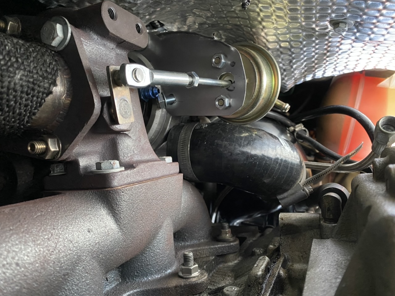

My boost controller arrived today so decided to go full pikey and use the spring on the actuator. 100% didn’t work. Just ended up with loads of lag until nearly 5k then a massive dump of 15psi of boost and that was at 1/2 throttle!!! Wind the boost control valve a bit and managed to get it to come on boost at about 4k but was still aiming for rod bending psi. Moral of the story, I need a 7psi actuator

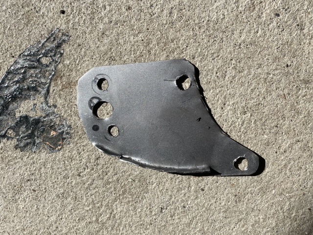

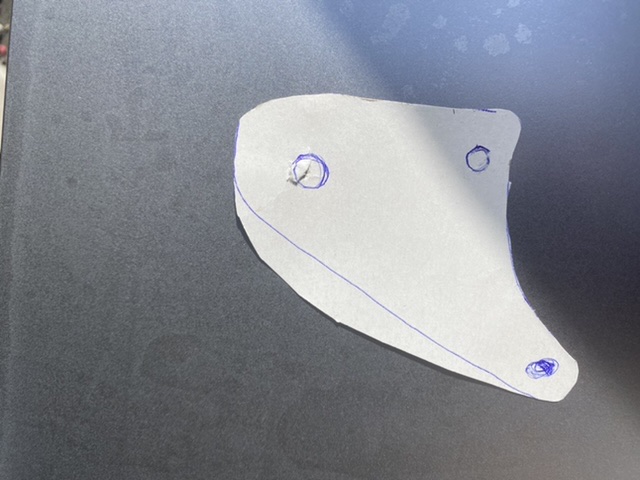

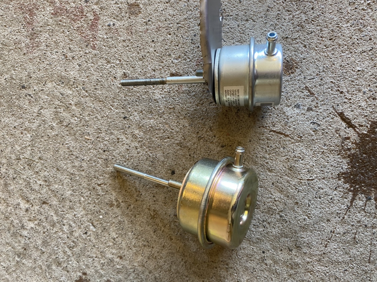

Had a stroke of genius with the actuator. I remembered the other day that the standard z20let uses 7-8psi and I’ve got an old turbo sat with a mountain of other Astra related crap that’s been in my mams shed for years. Sure enough it was still there and I found a catch tank too. I’m still waiting on the new actuator bracket arriving so rather than messing about twice decided just to hold off. After much head scratching I finally found just the right spot for the catch can. It’s tucked right under the slam panel and can’t be seen at all from the front unless you’re looking down over it. Hopefully it should be a little bit less stinky now and always good to have a non-filtered way to the engine blocked! More to follow once the bracket turns up

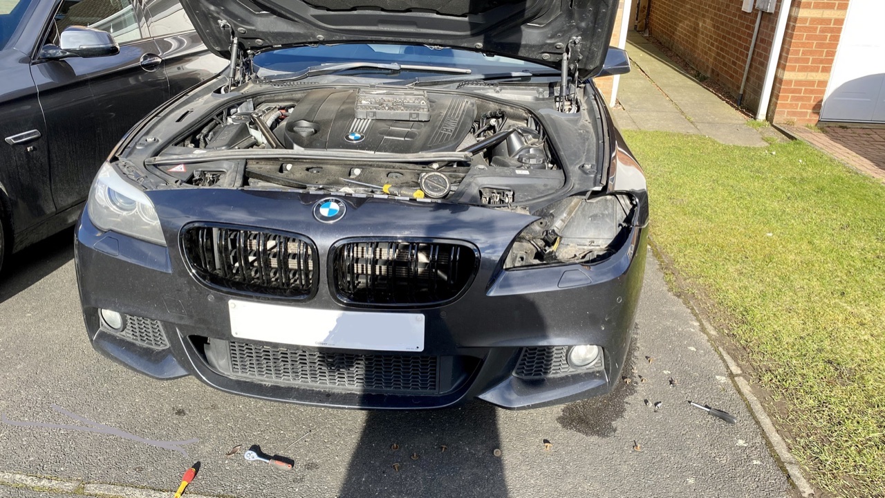

no more Clio progress recently. Been on with the 5 estate trying to sort it’s misting headlight. It’s eventually destroyed the headlight ecu (seriously, why is that a thing) so had to bite the bullet and replace it.
it’s a bumper almost off job. What an absolute doddle. No shitty torx screws that are rusted to death, every single bolt (of which there are many) was a stainless 8mm that came out with no argument
Stuck the headlight in the oven to dry it which was a pretty tight squeeze. I didn’t realise quite how enormous it was. I then sealed the entire outside of the headlight with some nasty all weather sealant and so far there’s no new water ingress. Irritatingly the headlight bulb must have still been damp from my leak test when I put it back in cos the bulb popped. Trade price of £44.50, won’t do that again in a hurry 🤦‍♂️.
It’s all back together and I now have 2 angry looking 5s with a full selection of non flickering angel eyes and working indicators. Happy days! More Clio progress at the weekend

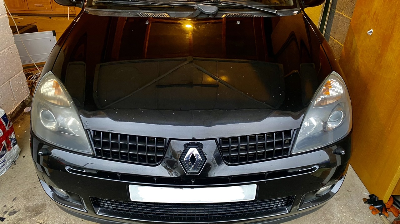

The sun was out and life was good today so decided it was time to show the Clio a bit of love. My actuator bracket never materialised so I decided just to make one myself.
After a few CAD (cardboard aided design) efforts I got the right shape. Serious precision engineering right here
Then chopped said design out of some 2mm stainless with some tin snips. This is the first version before a tidy up. It’s bent one of the edges over slightly too just for some extra rigidity in it.
Next up was to fit the z20let 6pis actuator. The new one is on the left, old one is on the bracket. No idea why it’s so massive but hopefully it’ll bring the boost down to sensible levels
The fun didn’t end there though. The end of the arm for the original actuator is m6 x1.0. The new one is m6 x something else. Out came the tap and die set to tap the new actuator to m6 x 1.0. Once the arm was attached it became clear it was about 35mm too long. I chopped 15mm from each half and then added some spacers to the bracket and it’s bang on. Just need to do the bolts up properly and plumb the boost pipes back in and it’ll be good to go. The bracket has moved it up and away from the bulkhead too as the old one kept hitting it. Hopefully on test drive tomorrow it’s where it needs to be!
Yarp
  182 Turbo, E46 M3
Took the car out for a quick drive today to see how the new actuator works and it’s absolutely perfect! Boost is peaking at just under 8psi and holding perfectly to the redline. I’m not getting full boost until nearly 5k so the preload isn’t quite right but that’s a very easy fix. I’ll sort that once it’s cooled down.
I’ve bought a rs tuner for it too. It’s picked up a couple of faults I wasn’t getting that I’ve cleared and haven’t come back. I’ll hopefully be able to get some decent live data and find out what the cold/low rev misfire is all about. The abs lights are on too so it’ll be nice to get rid of them as well. Once that’s done it MOT time 👍

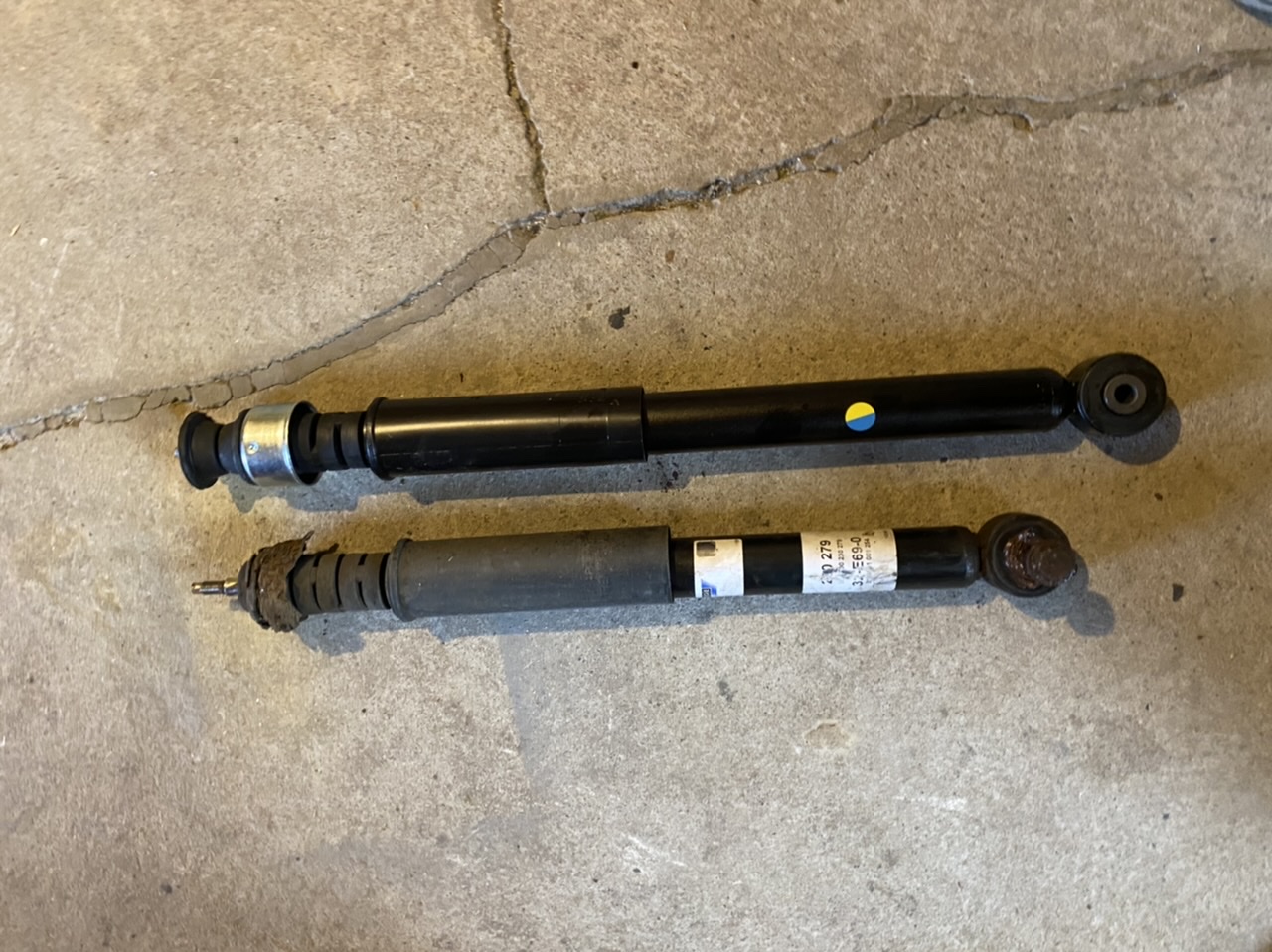

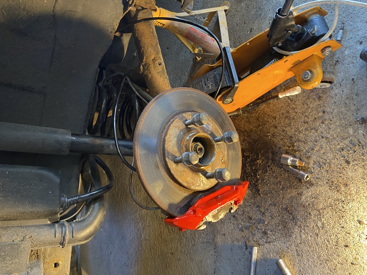

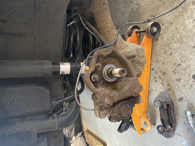

Little bit more progress on the Clio over the last week. I noticed the rear shocks were paggered so swapped them for some cup ones. The ones on there were shite fitted by a previous owner so hopefully these are a nice improvement.
Next up was the issues with the abs sensor and the Christmas tree dashboard. I ordered some sensors from Latvia for about 1/4 of the price of the ones from the uk so got them fitted. Hub with all the bits stripped back
The new sensor was the right fitment and the right length but back to front. Nothing that can’t be fixed. Tapped a new thread into the hub for it
and all nice and fitted
and when I was on I gave the front half of the calliper a lick of red to match the fronts
That’s done the trick and the abs lights off 👍. also fitted a new set of pads to the front that I’d had sat for ages. It’s bugging me that they don’t cover the whole disk and I’ll starting to get a rusty ring on the disk around the middle but dont suppose there’s much I can do about that.
