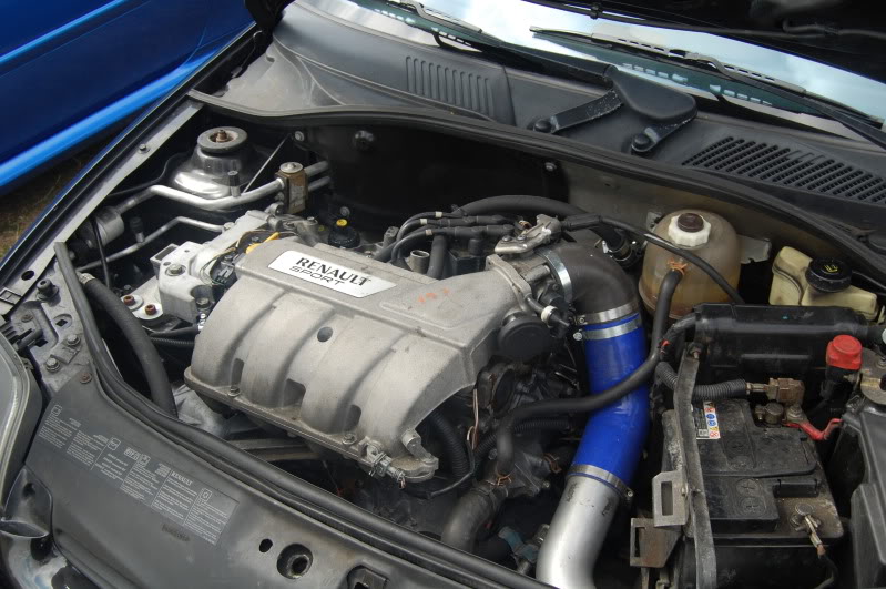

Dont know what the set up was but this PH1 was at CSS, i have no idea if its was a 1*2 lump with 197 Inlets or a complete swap, I didnt look that closely.

im sure this one is just inlets swapped because if u take the engine out for more power why would you leave the AC on it?? sayin that some people do things that make you wonder so could still want AC with the added power lol

Looking at it, Same coilpack as well....

Thats a 172 engine with the 197 inlet on it, just to prove it could be done.
We still need to finalise the map at the moment but it seems to have given some good results. It wasn't the main reason for fitting the manifold tho. All we really wanted to know is if it would fit in the space given. We are currently doing some development work with something elce that incorprates the manifold modification, witch when finnished, will be posted up. Im sure people will find it very very intersting.
