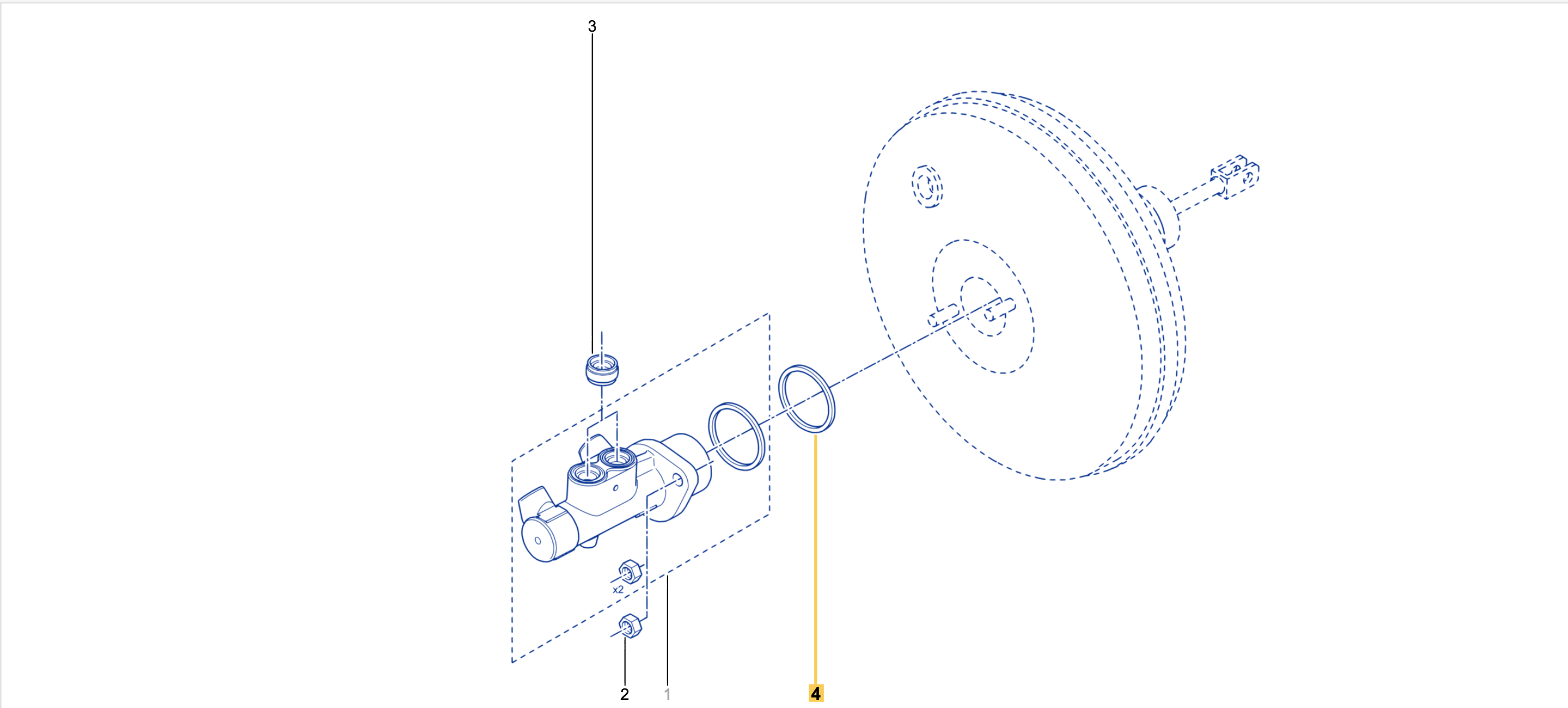

Hi, my clio 197 brakes have gone spongy and inconsistent with pressure. I've noticed an internal leak from the brake booster.
I've scoured the net and simply cannot find a RHD replacement. Apparently, it has been discontinued by Renault. I've seen mentions of a Peugeot 406 fitting, but not entirely sure this is correct. Has anyone with a RHD found a suitable replacement? There's virtually nothing here in AUS.
MarcB
  Too Many
Item number 1 = NLA from Renault.
You can still buy the seals (Item 3 & 4)
