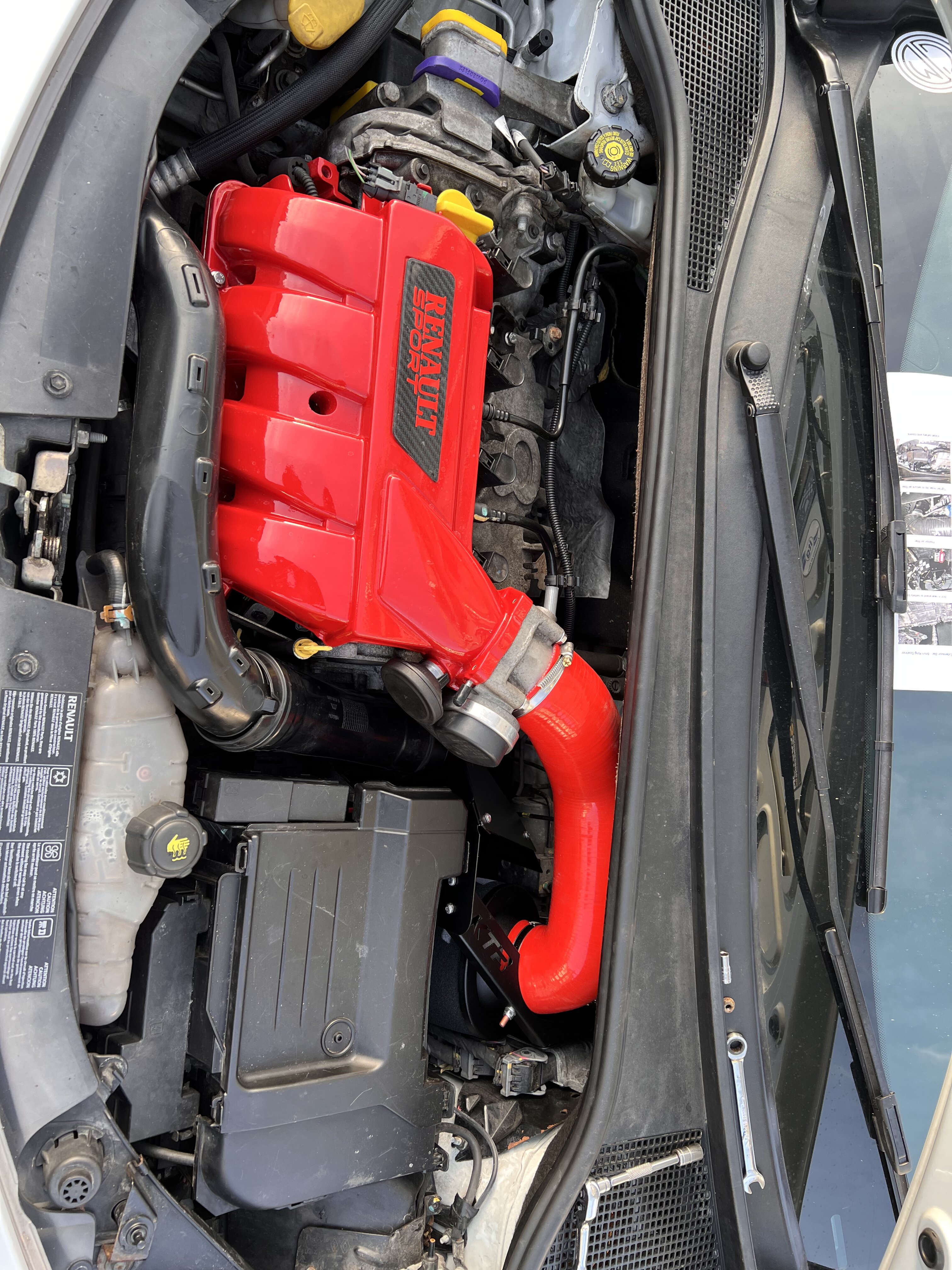

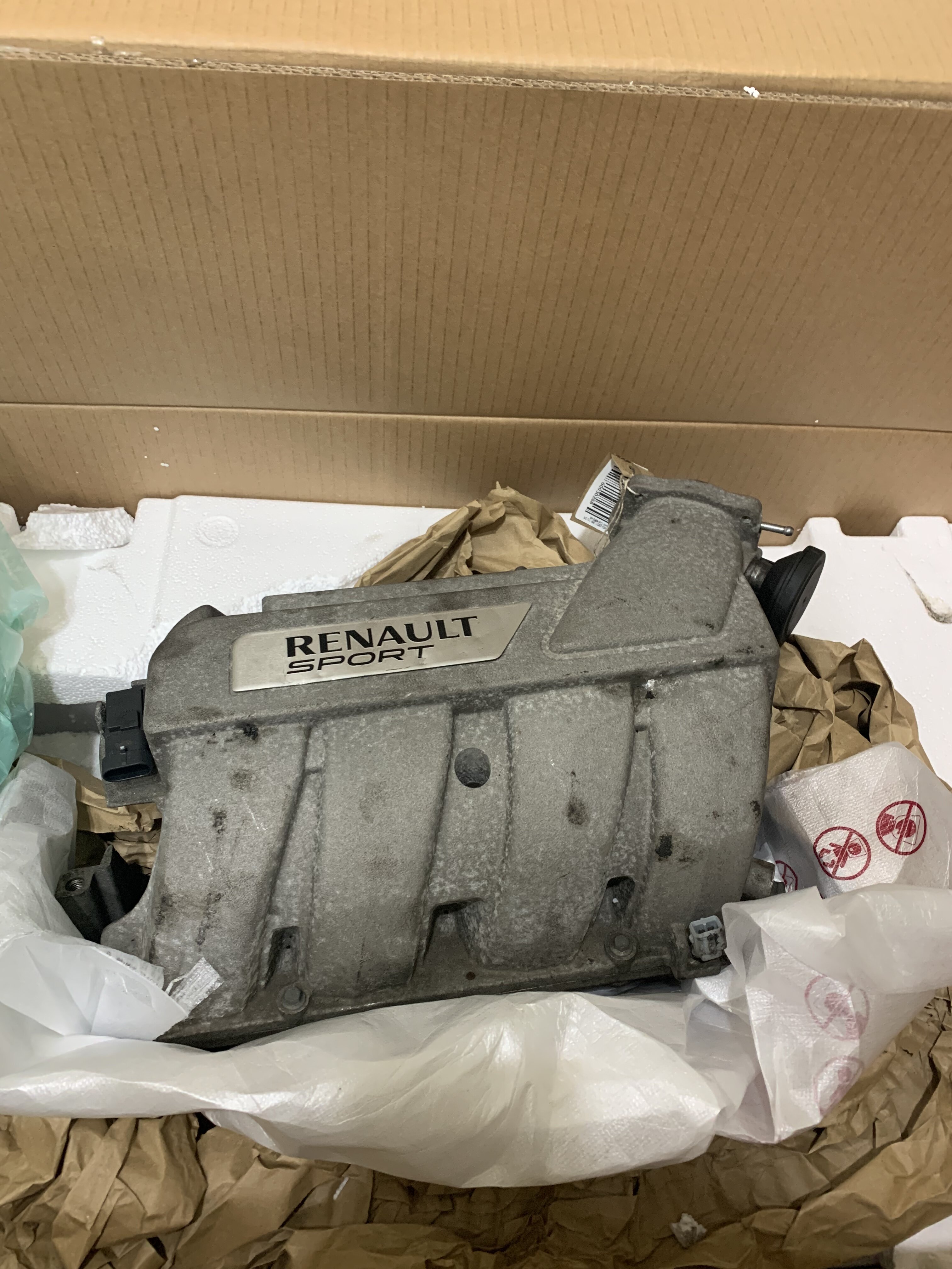

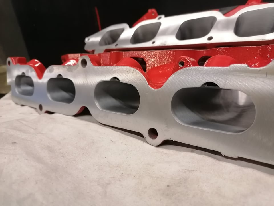

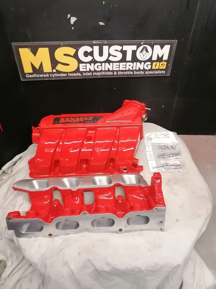

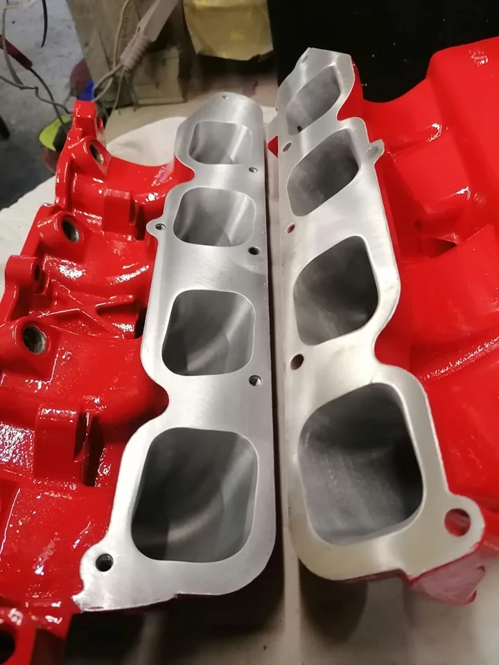

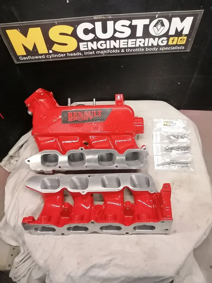

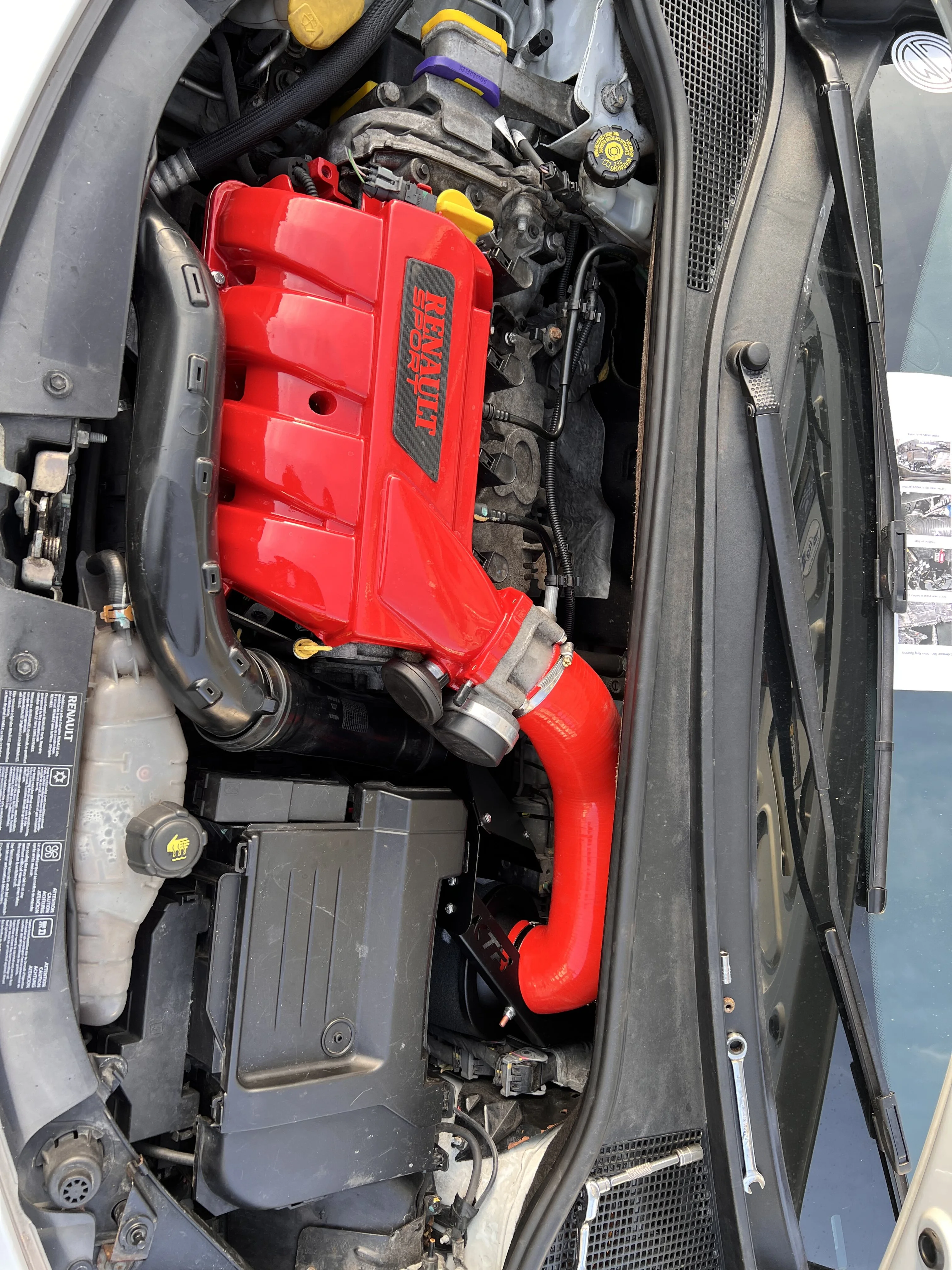

Had a new inlet turn up yesterday, getting send off to MS engineering for portmatching and gas flowed. So starts the engine work

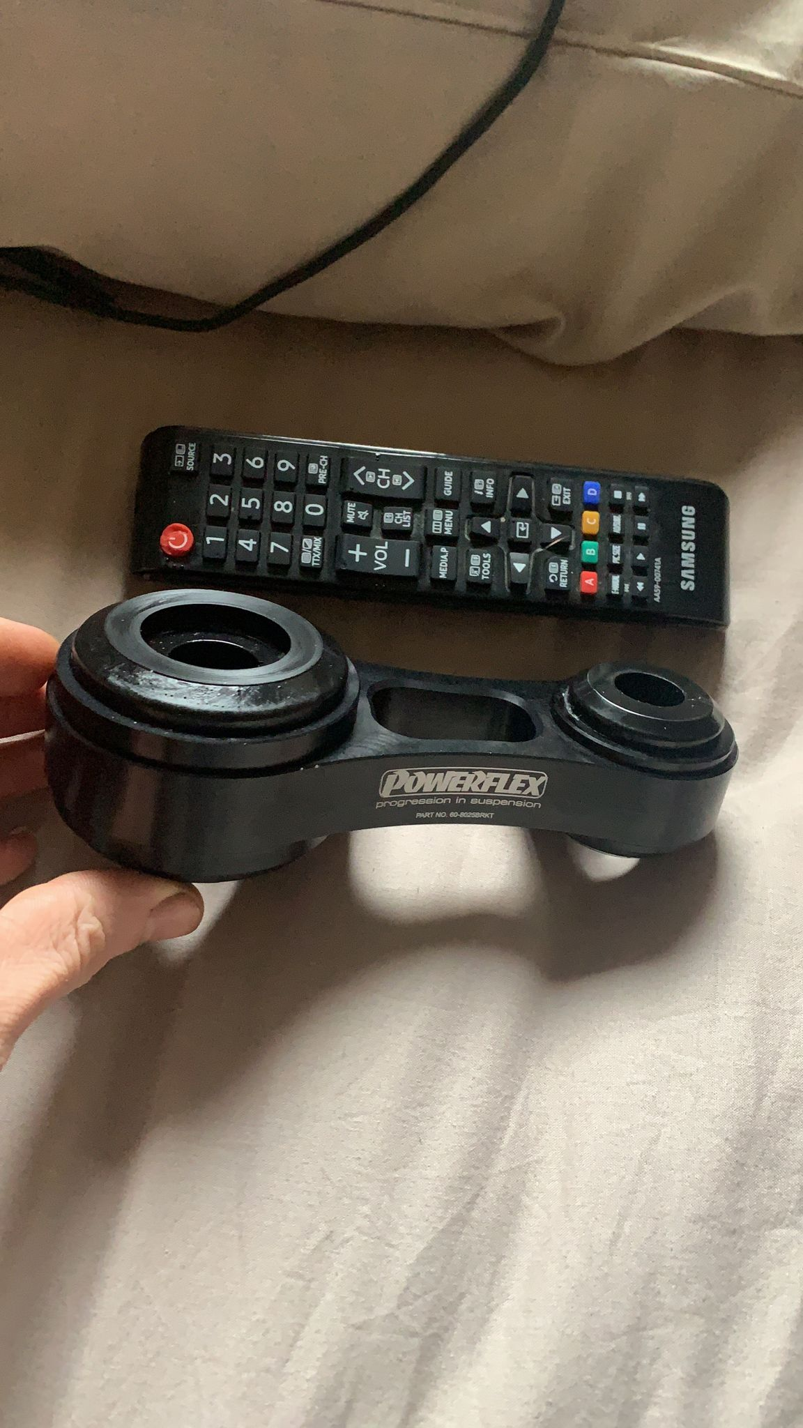

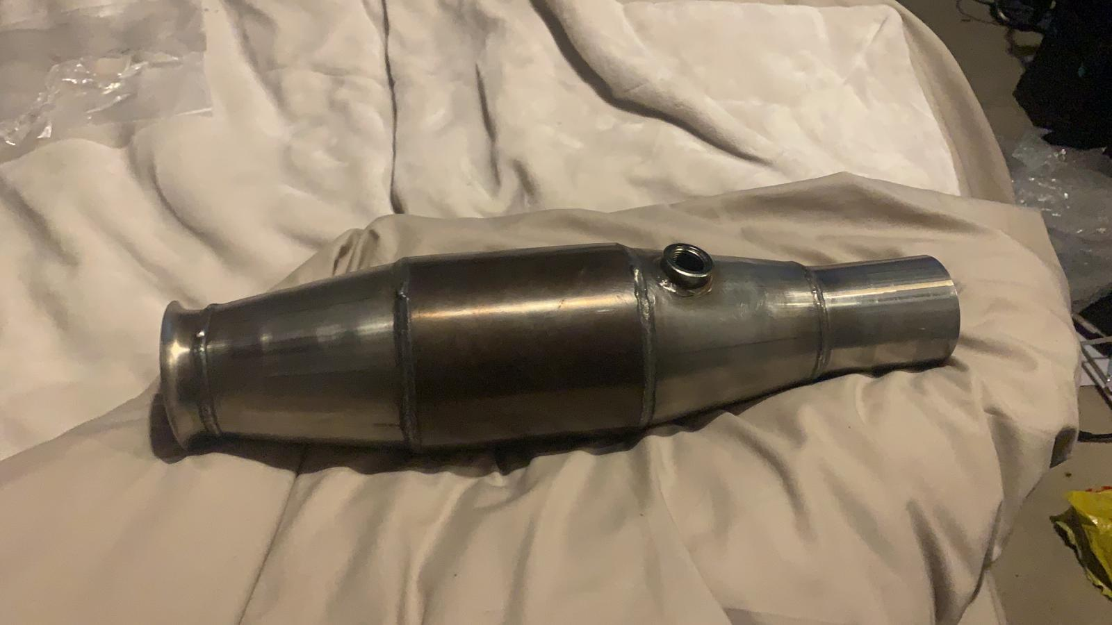

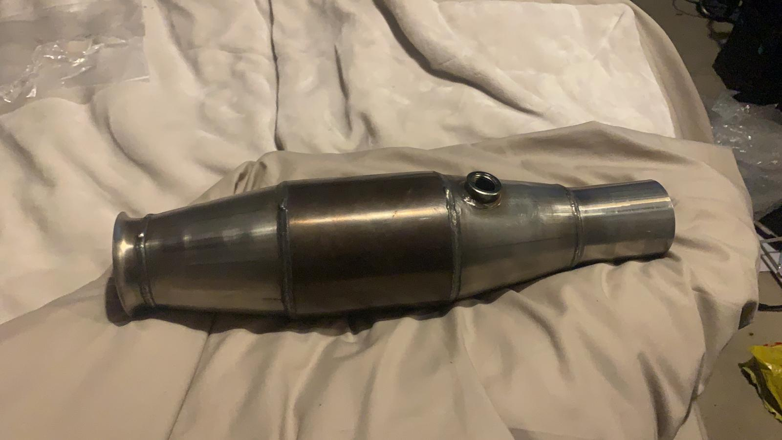

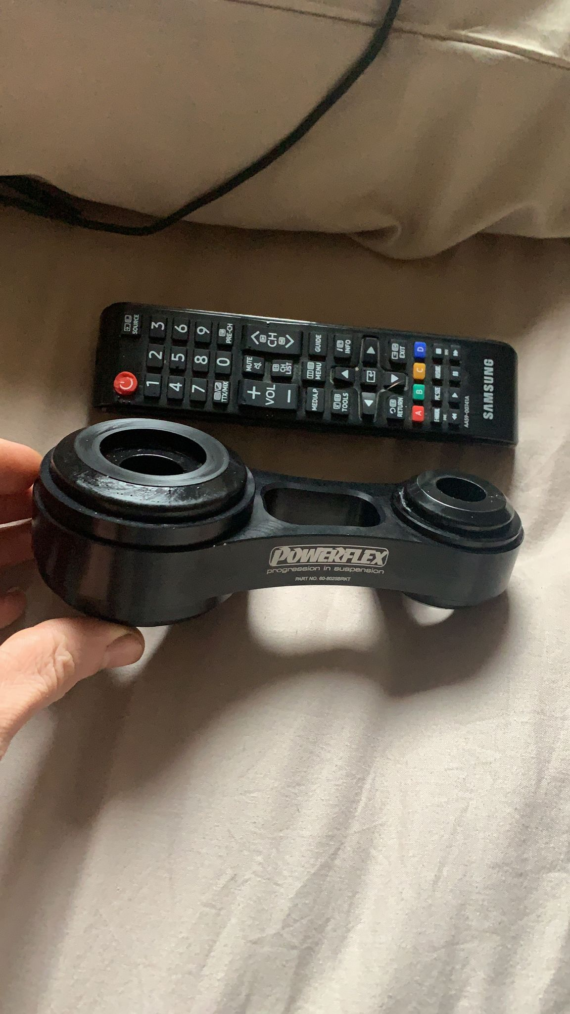

New dogbone mount and sports cat arrived. Just waiting for it to get booked in to get everything fitted and mapped .. and then we're even closer to track days!
  • Like
Reactions: Gus
Gus
  182Turbo,DCi90
So many nice mods on your car. The dog bone will be great once it's bedded in. They do make the interior rattle for a few weeks though but stick with it.
Have you got a date for the remap ?

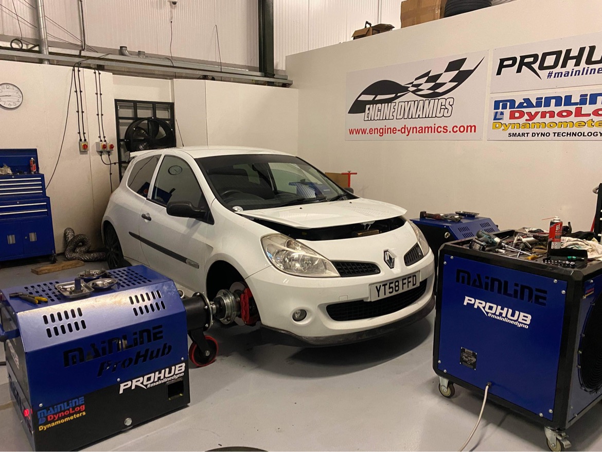

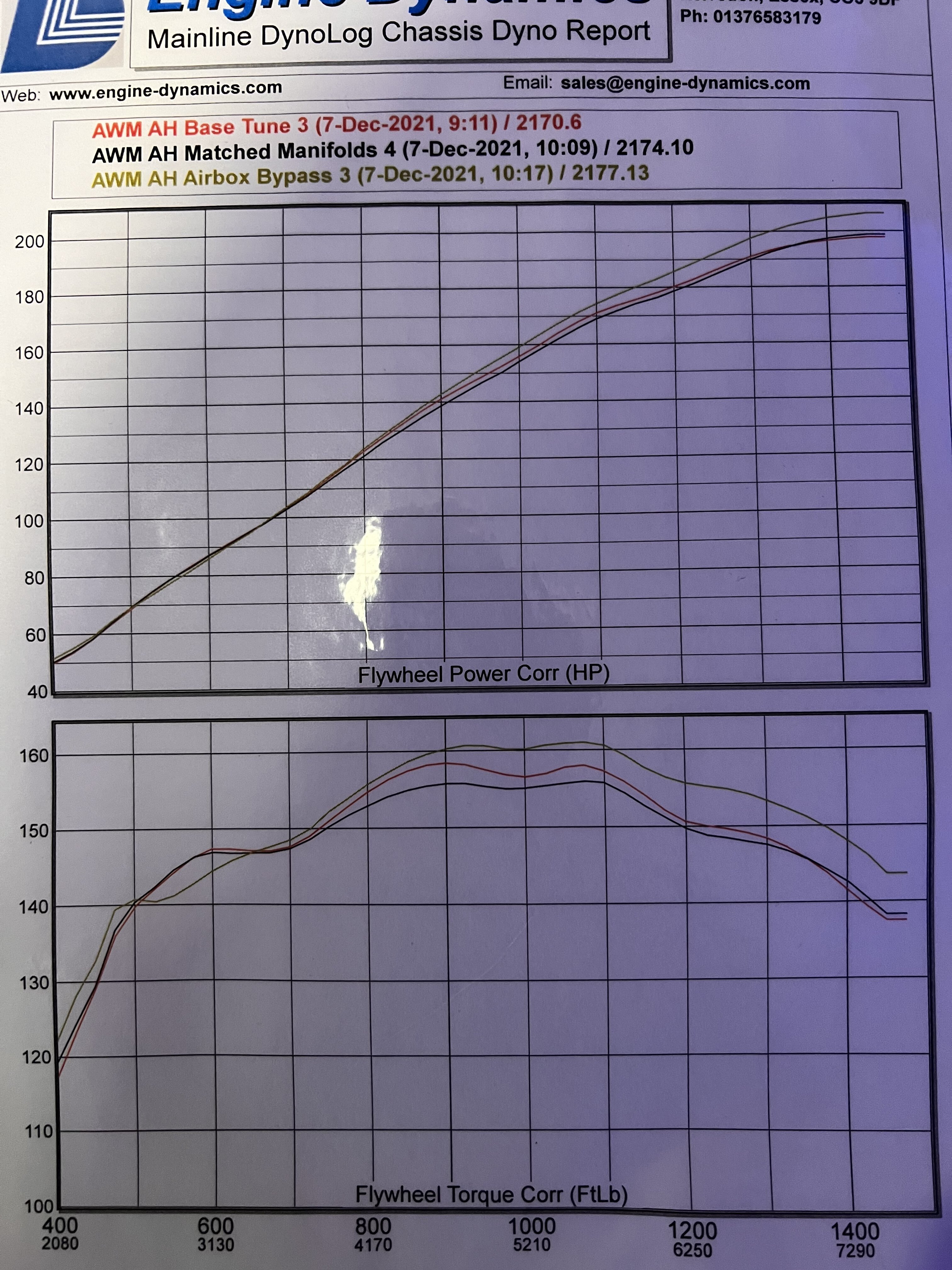

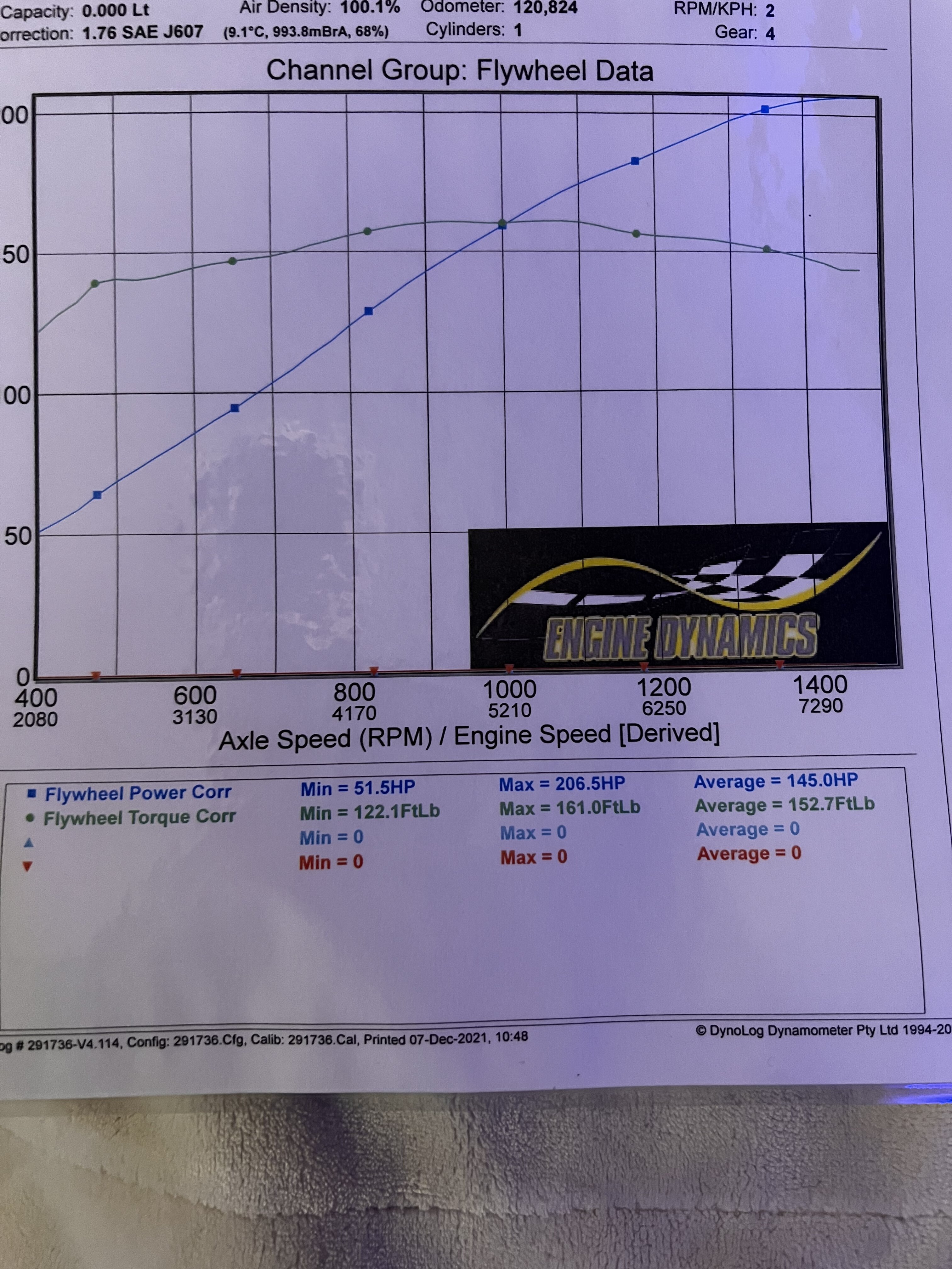

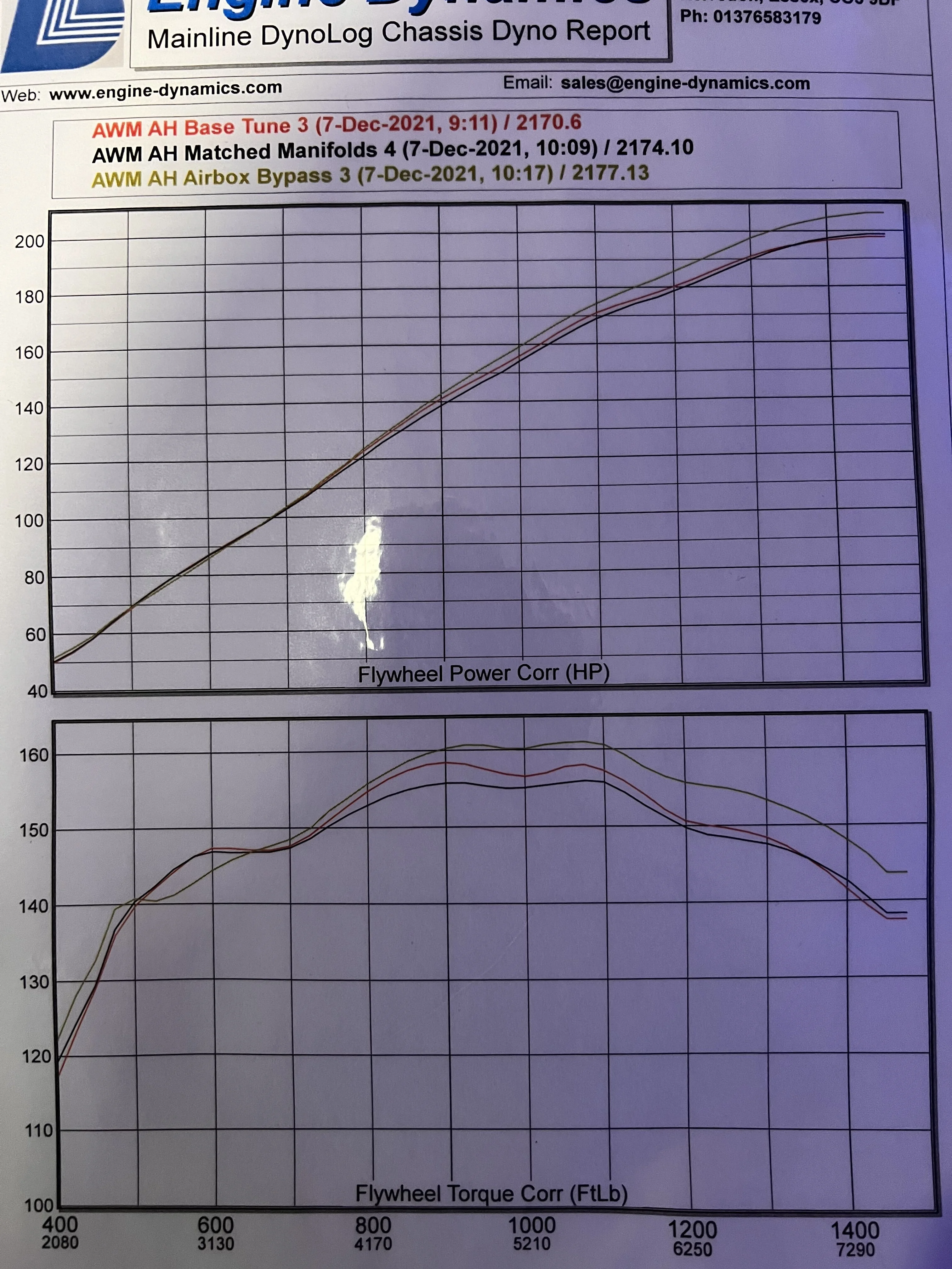

So today was the big day .. MAPPING!
Alex sorted out the exhaust and the sports cat on it and had it send to engine dynamics for mapping and inlet testing.
This is the report alex had sent me, bit long but better than explaining it !
Nope all good.
Obviously this morning we tested it with manifold already fitted, with the old map testing was pointless, although wasn’t much in it top end.
Loaded our base map, good enough to test. Produced 197hp.
With inlets swapped, no other changes 198hp.
That’s within enough to say the inlets do absolutely sod all top end.
Everything looks healthy & correct. Airbox is restricting it a bit, proved by disconnecting air filter when we made 206hp.
Would have been nice to test it prior to exhaust manifold etc, but the point of today, manifold makes no difference, reduces torque in mid range by 3lbft, otherwise exactly the same.
Overall it’s been okay, 198hp as it sits, 206hp with an open cone type filter. No need for map tweak with cone air filter fitted.
Nice to finally have some proof that inlets are pointless on these!
Very happy and a good rest over all, ordered a ktec induction kit to bring it up to its full power

Interesting information about the standard airbox restricting the airflow. I always thought that induction kits on these cars, or open cones, created an entertaining noise but lost a tiny amount of power.
Good figures at 206 bhp.

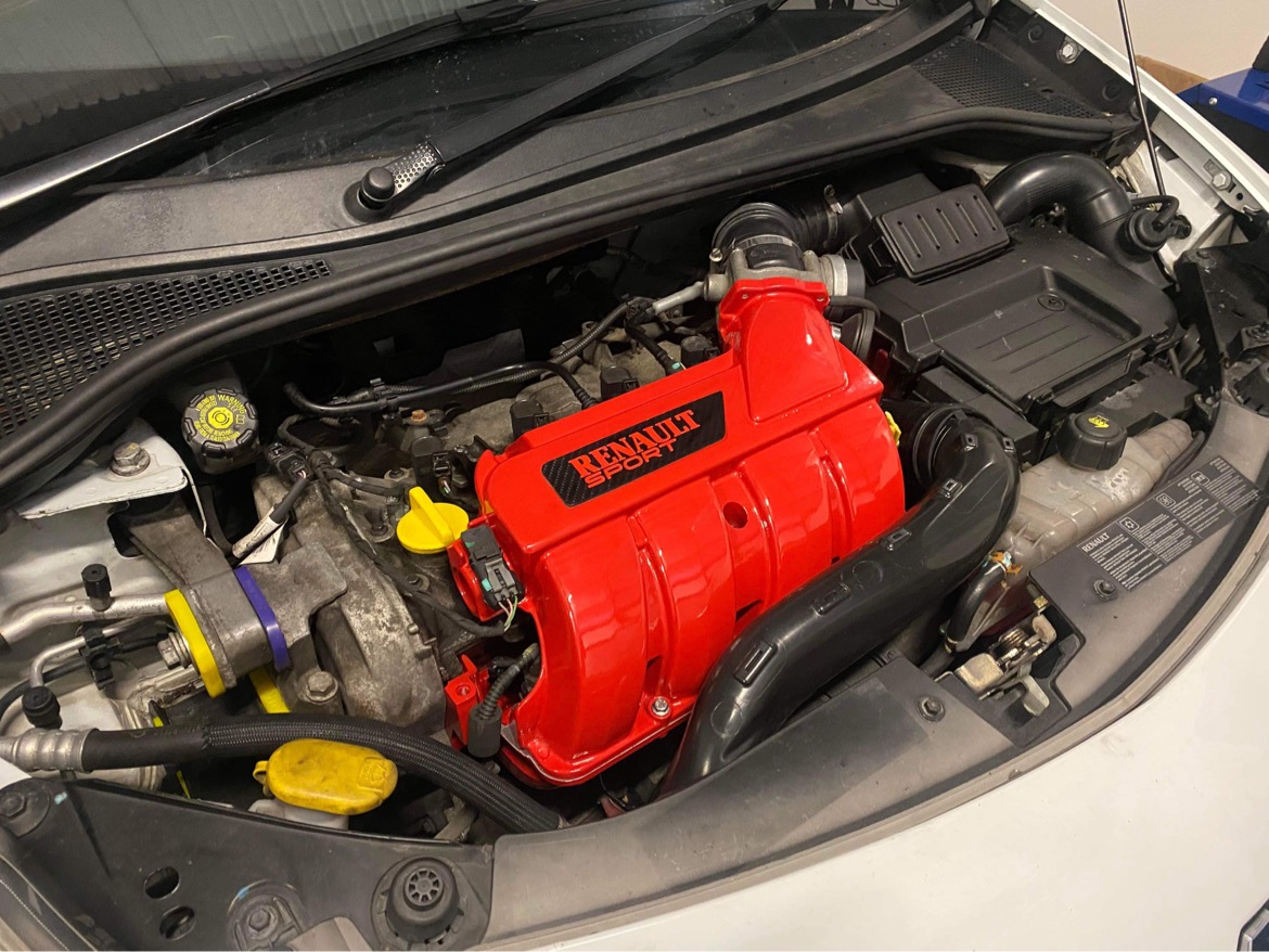

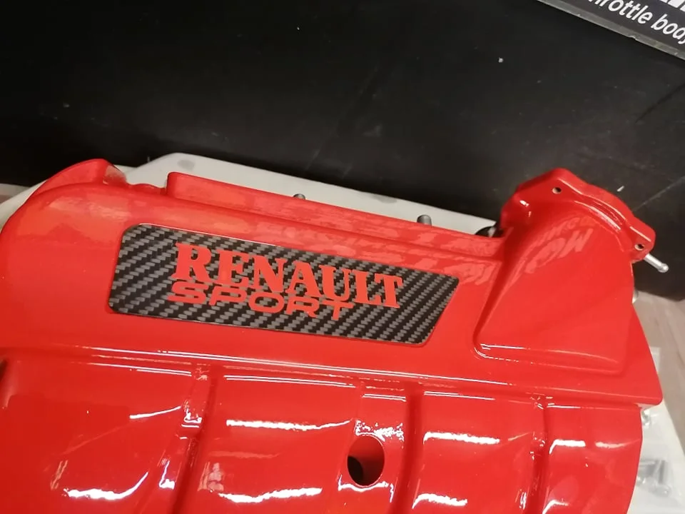

Great result there, must drive sensational. Looking great in the bay as well with the painted manifold. I'd recommend some Autosol to polish up the cambelt cover and the engine mount. It will clean up nicely with some elbow grease.
TRH_Racing
South East - Herts/London
Ill definitely give that a go when it warms up a bit! :D

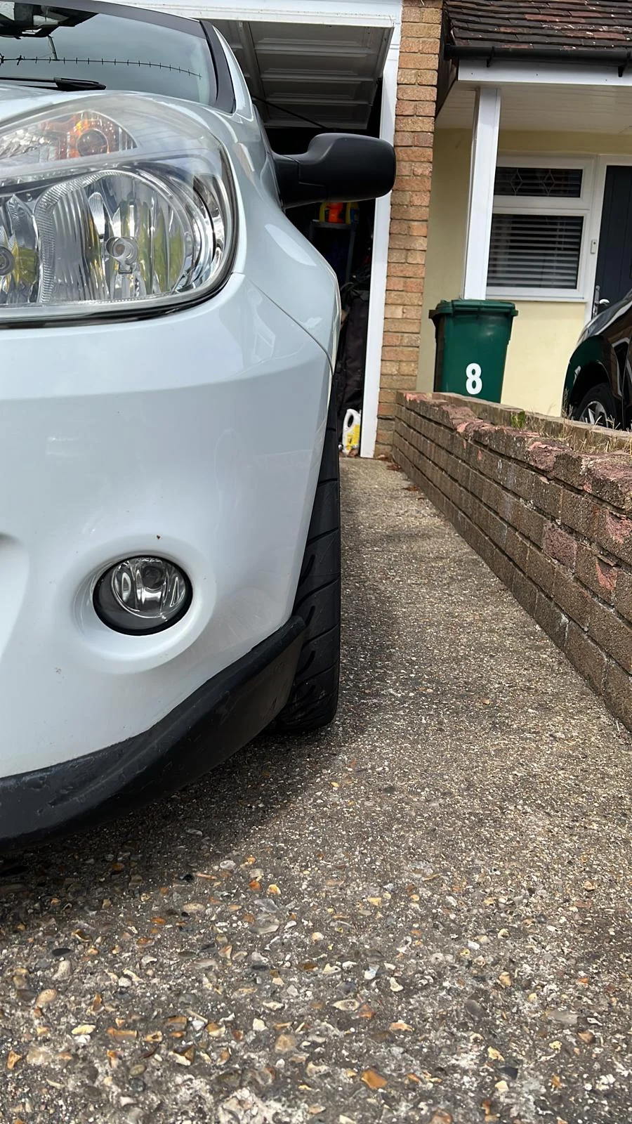

underside is now fully bushed with black series bushings, pure motorsport stud and nut kit, 21mm spacers up front and 10mm hub axle spacers rear.
arb, rear beam and wishbones all have black series bushings, new inner and outer tie rods along with new ball joints, so the only thing that’s left is the swivel hubs and that’s 99% of the suspension and handling done which is nice!
TRH_Racing
adding to my last post .. woops.

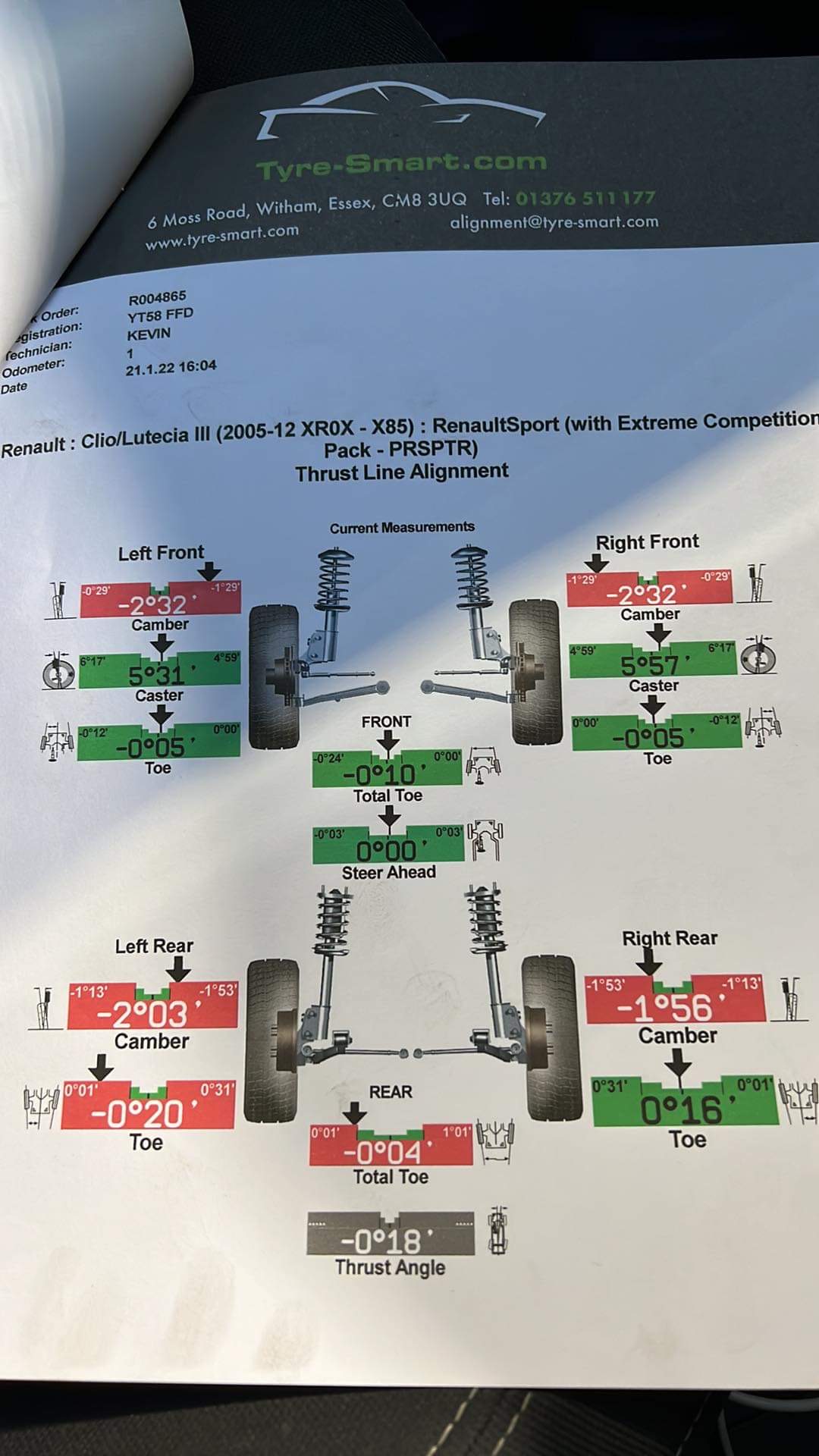

Along side another alignment check due to the set up changing slightly with spacers / toe needing correcting ..
shims needed for the rear but gotta work out how I want it to feel first

Portmatched/gas flowed inlet painted red

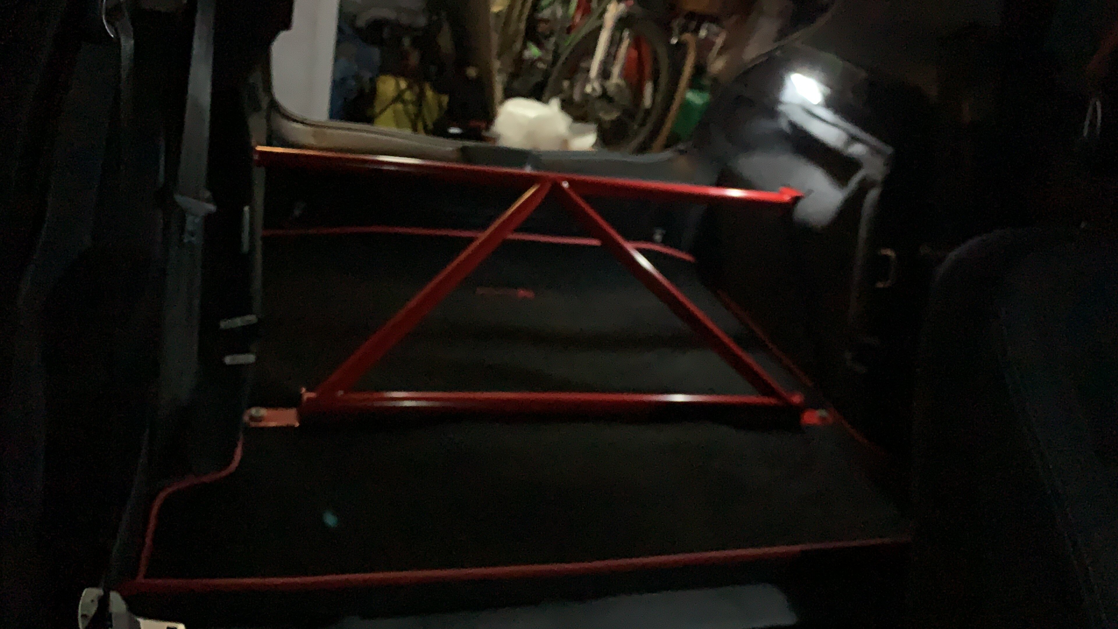

No rear seats, with extended boot Matt

Geo set up:
-2.3 camber / -.10 toe front
-2 camber rear (toe needs dialling in)

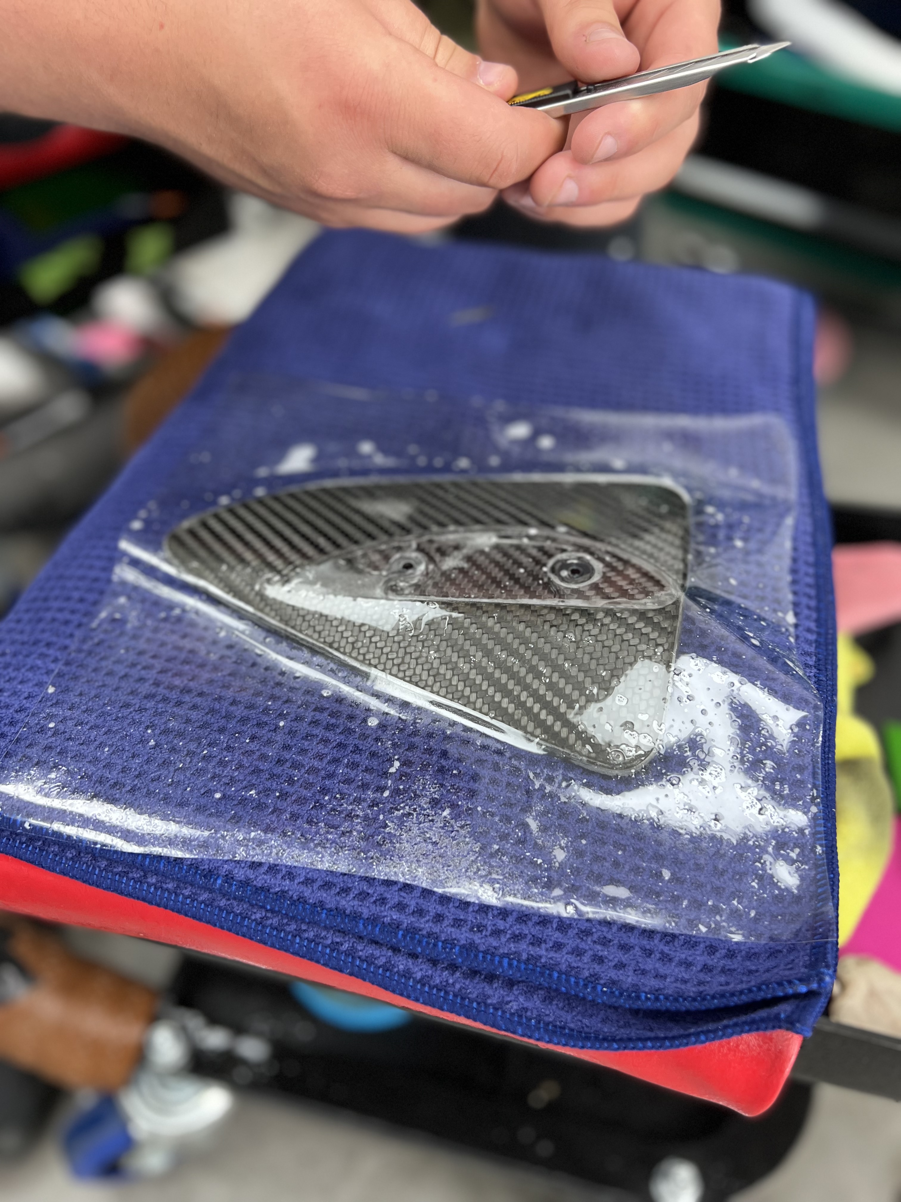

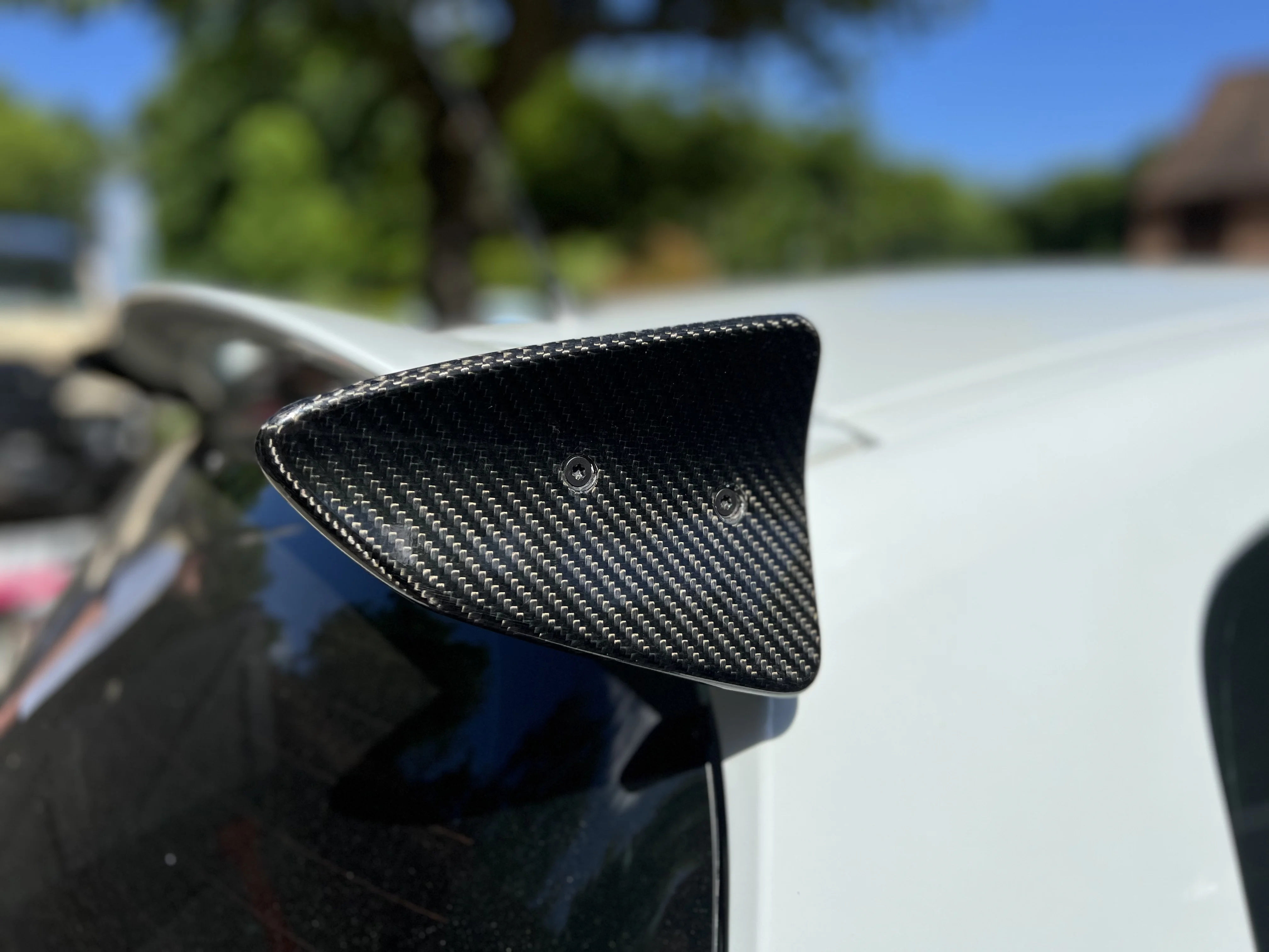

Ktec carbon wing ends

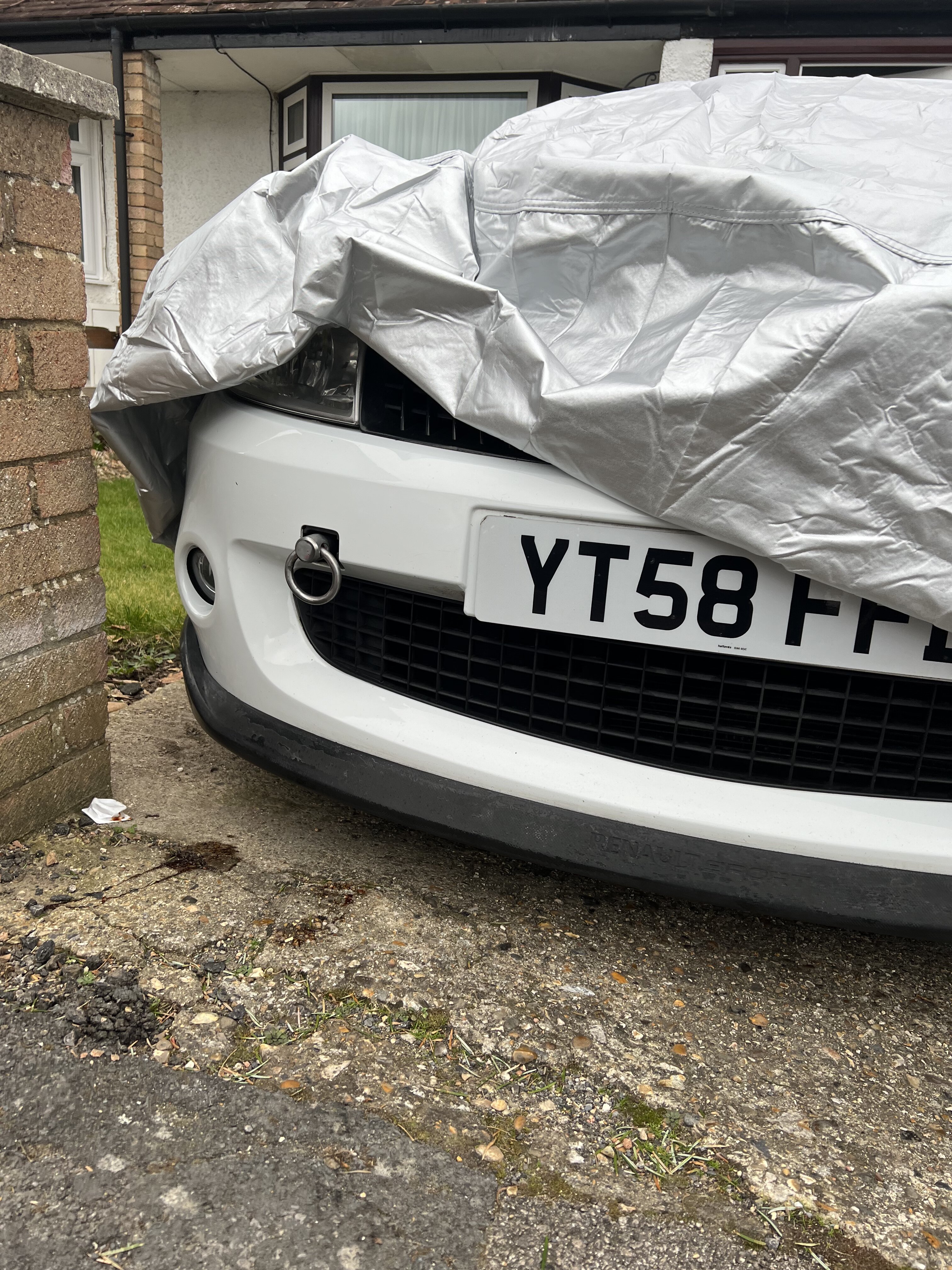

Cup racer towing eye

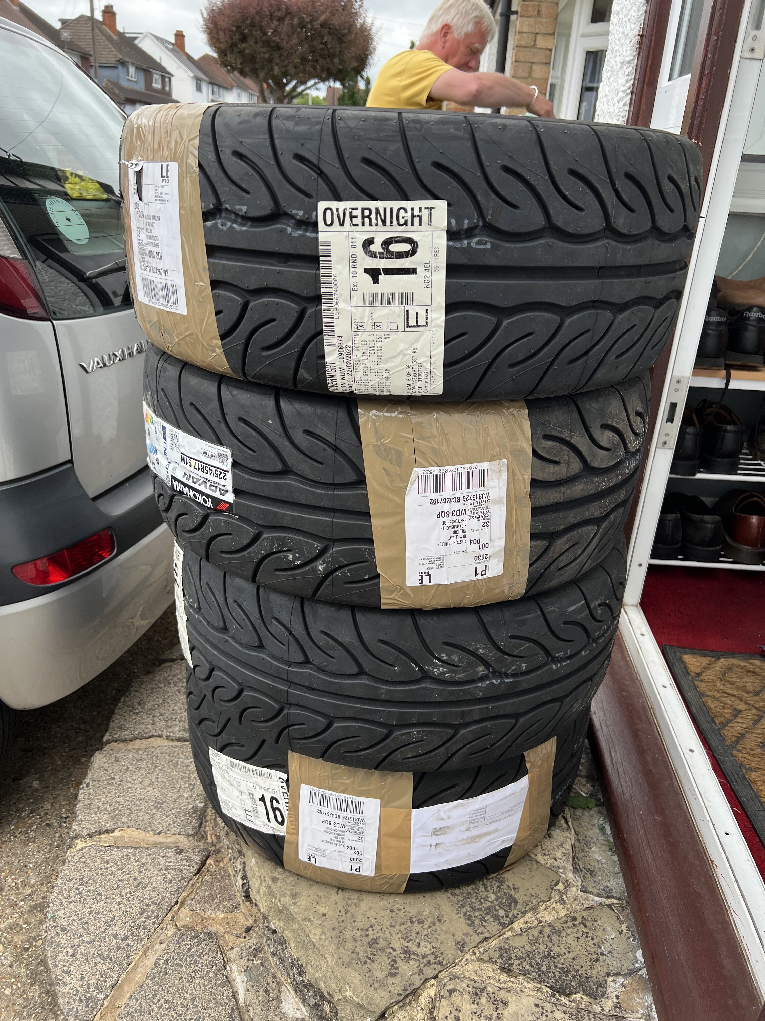

Should be getting a set of some AD08RS's and a bucket seat and harness set up next month. exciting times being closer to getting onto track again!

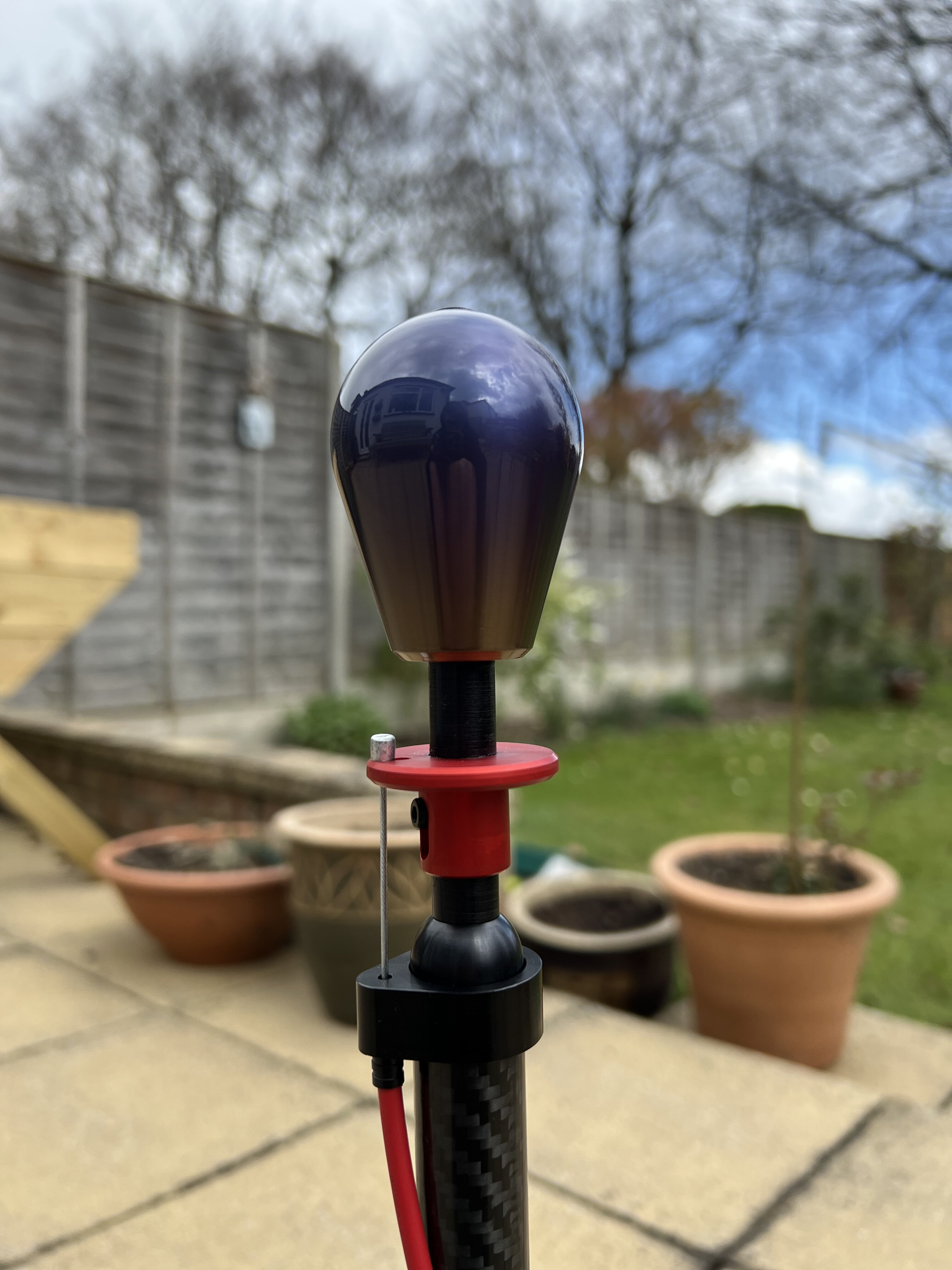

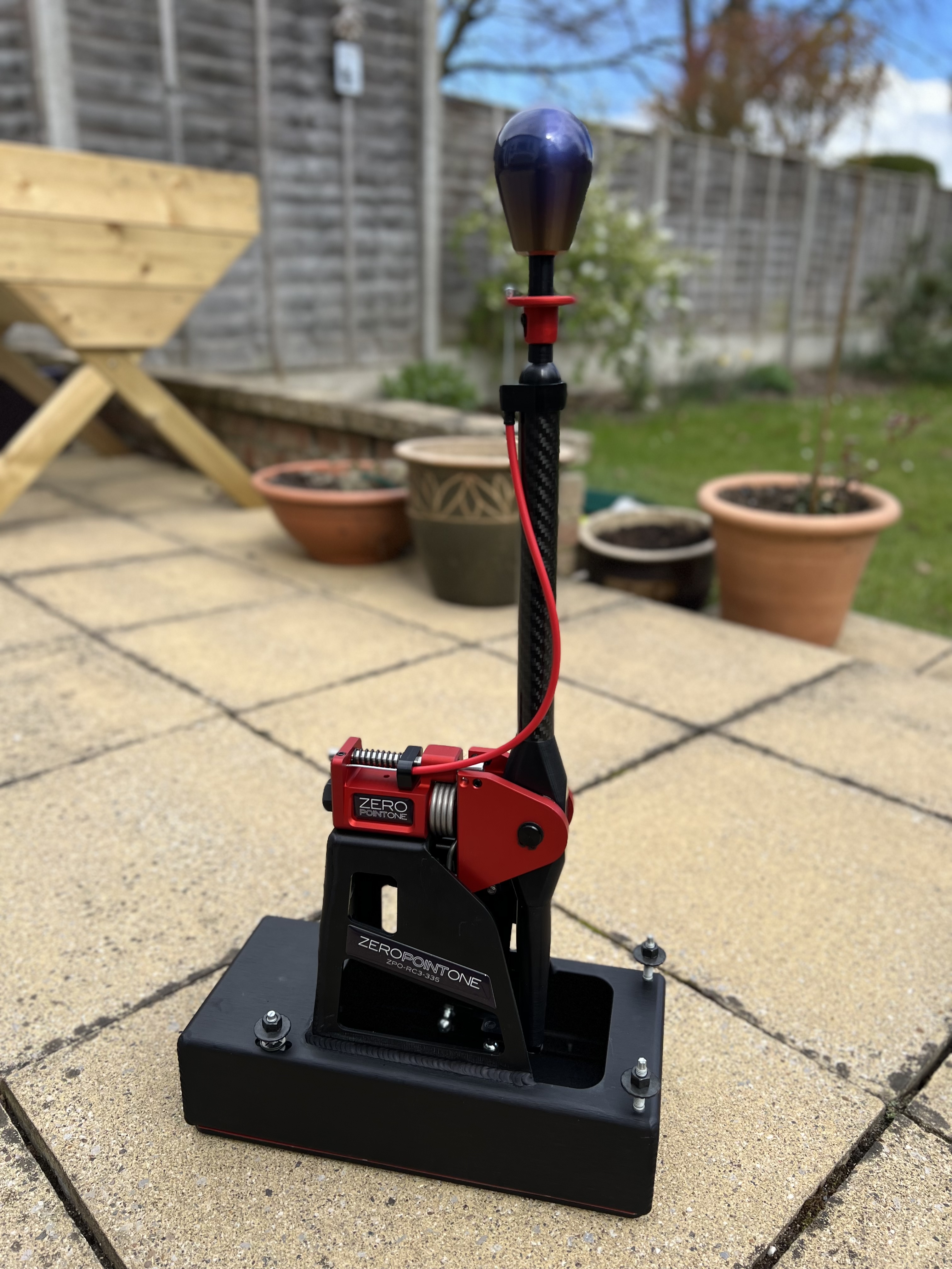

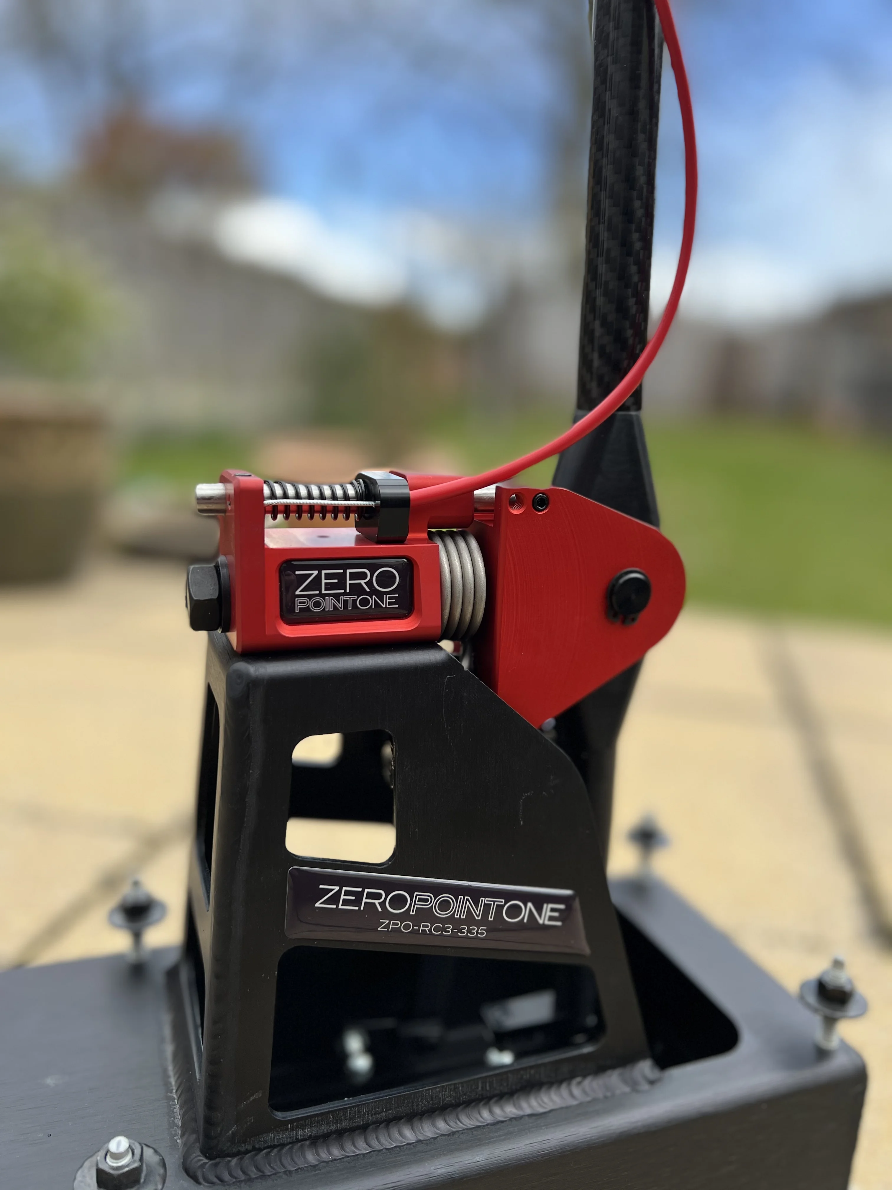

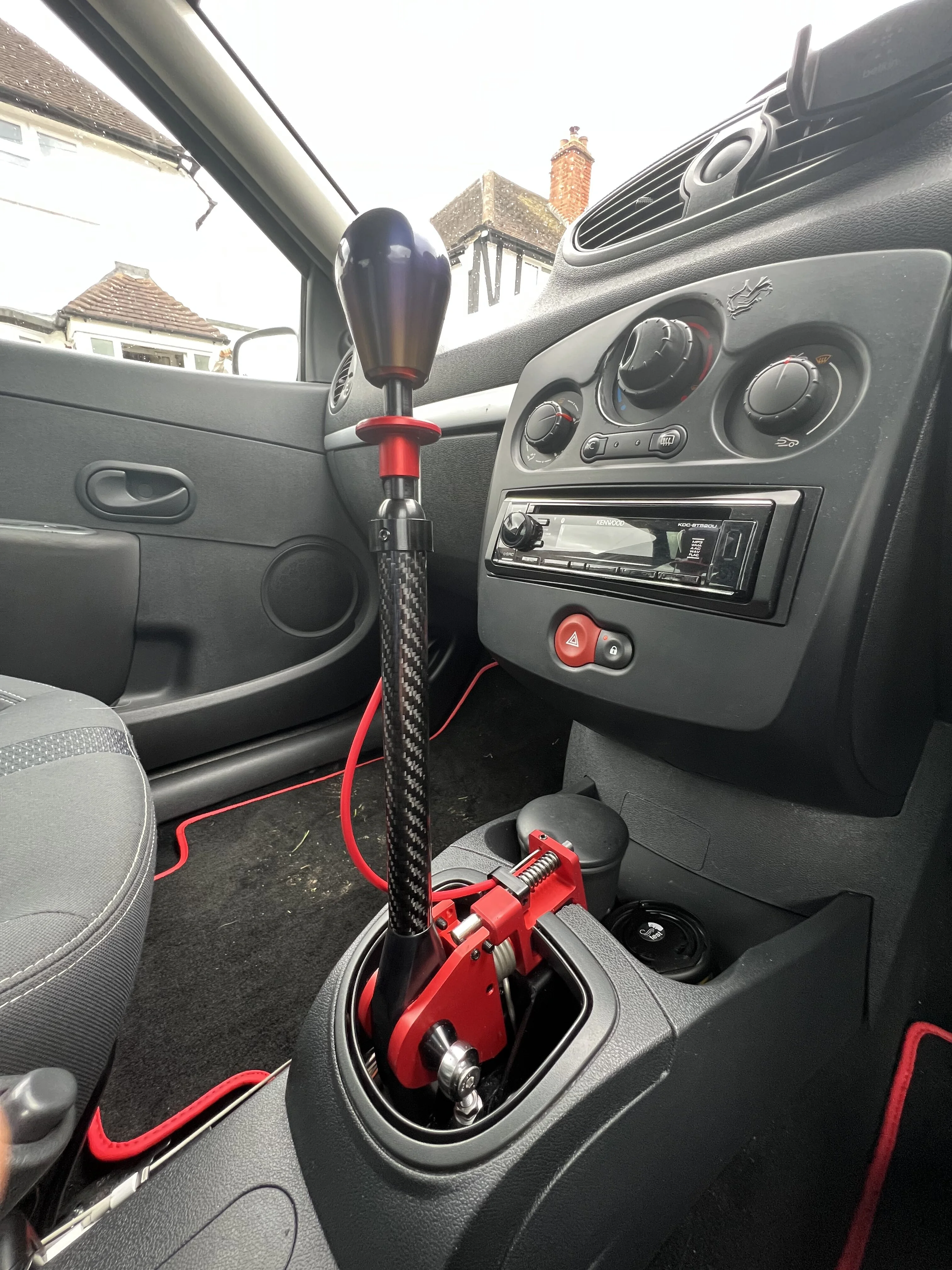

Got the shifter fitted today .. 100% transformed the gear changes, much more direct feeling, and the shorter throw just helps a lot more as well!
fortunately today at Alex’s the swivel hubs where okay, turns out they’ve been changed before .. it’s just the steering rack that’s buggered. So we’ve got a 200 cup one coming to be fitted next week, should improve the turn ins with the quicker rack ratio

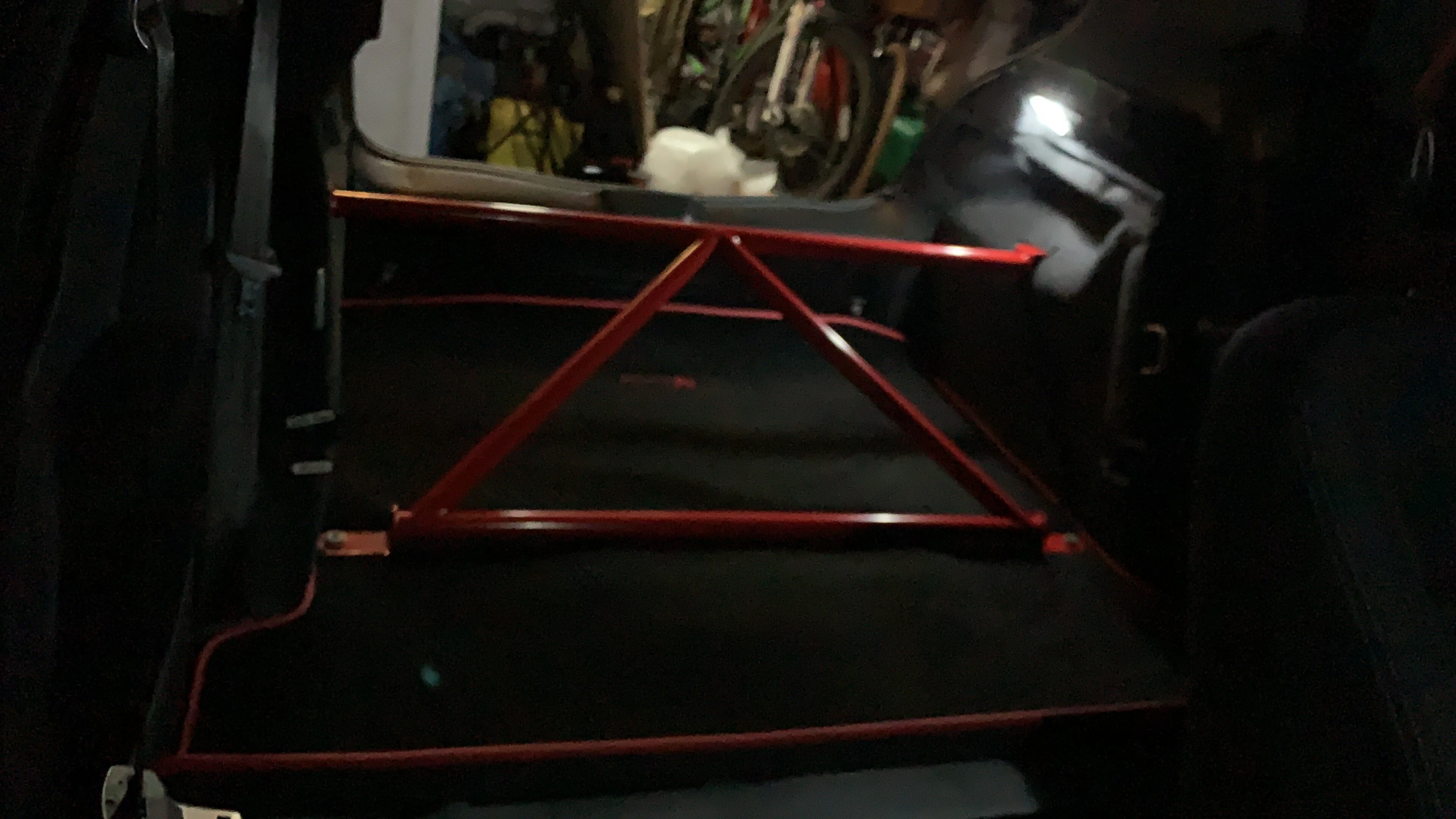

Full cage
Buckets and harnesses this summer hopefully.
And then a long term build of getting the engine forged and a G25-550 and all the supporting goodies, my target power is somewhere over 400+ which should make it very lively
