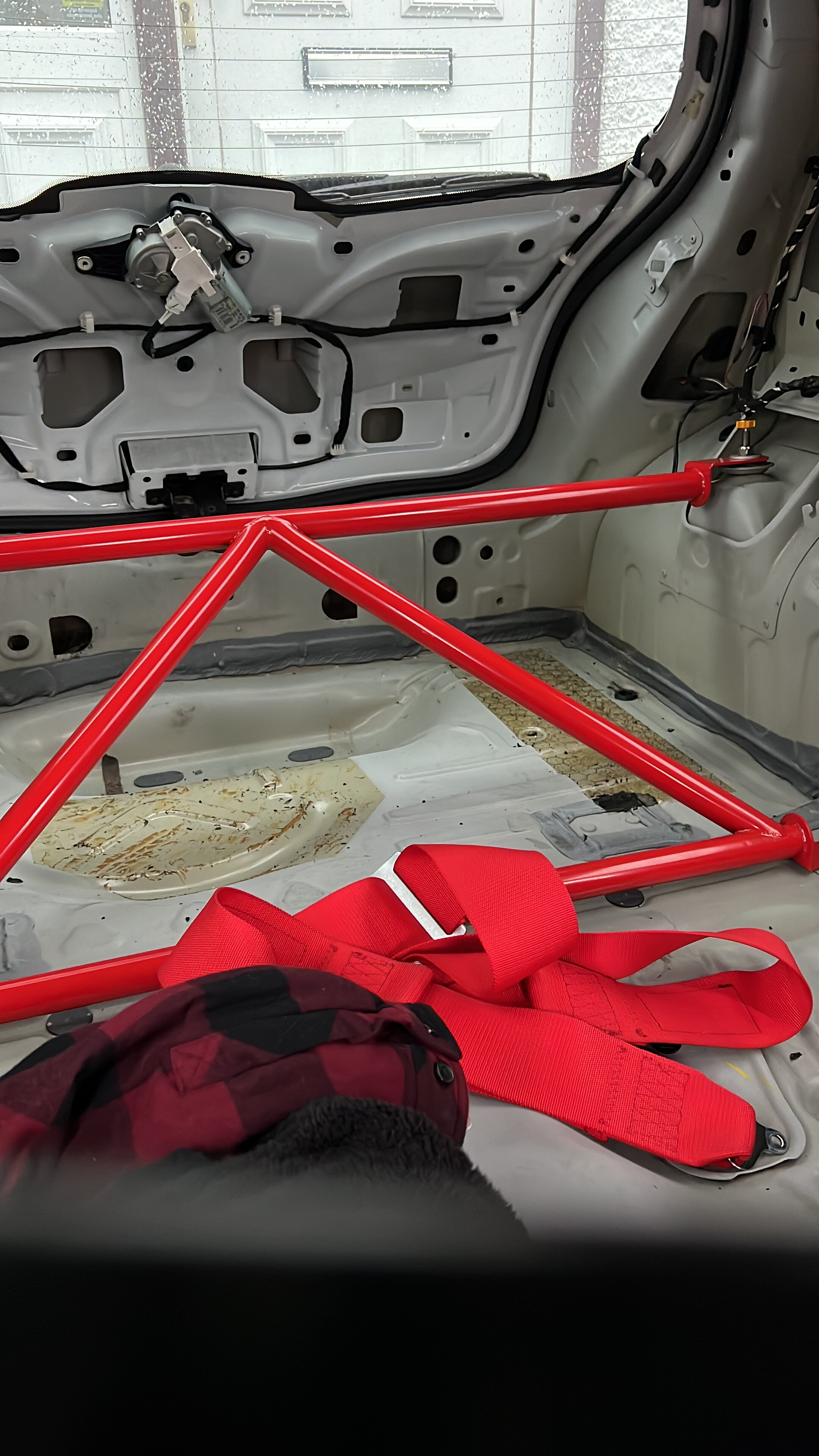

Been in talks with Fulcrum Motorsport recently, and I've decided to put a deposit down on a cage and get that done over winter. Also have a few other ideas of what i want to get done to make sure the car is safe and reliable (as much as you can get a French car to be anyway)

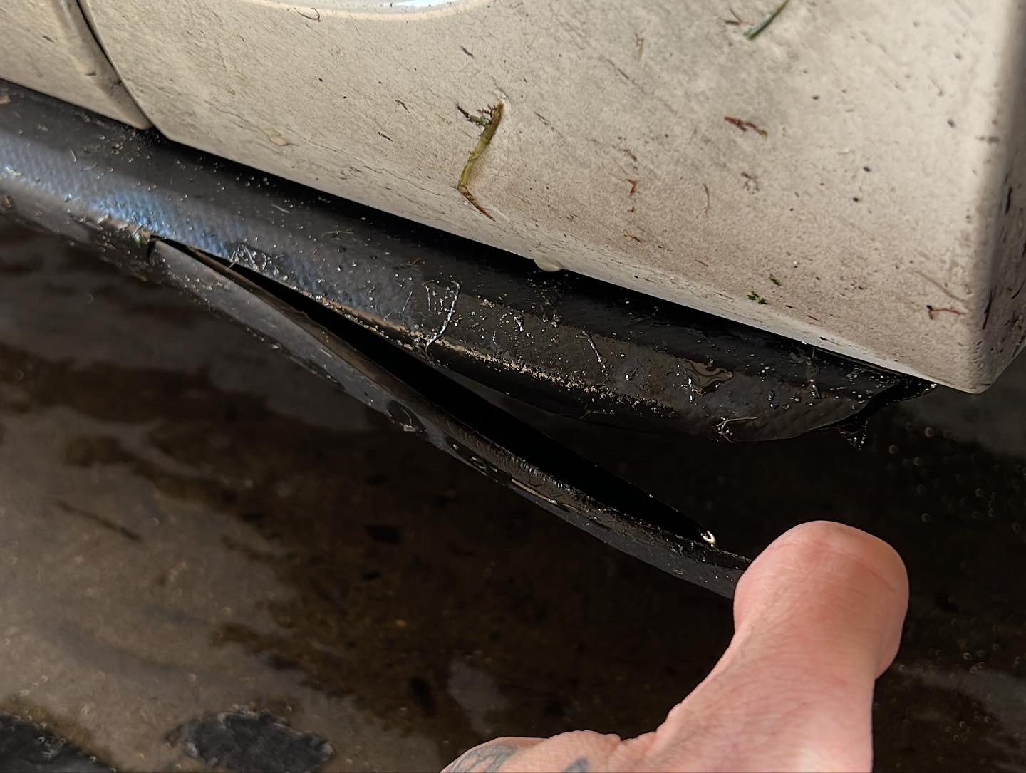

what a wet wet wet day that was, had a couple of spins; caused a small bit of damage to the side skirt but nothing bad

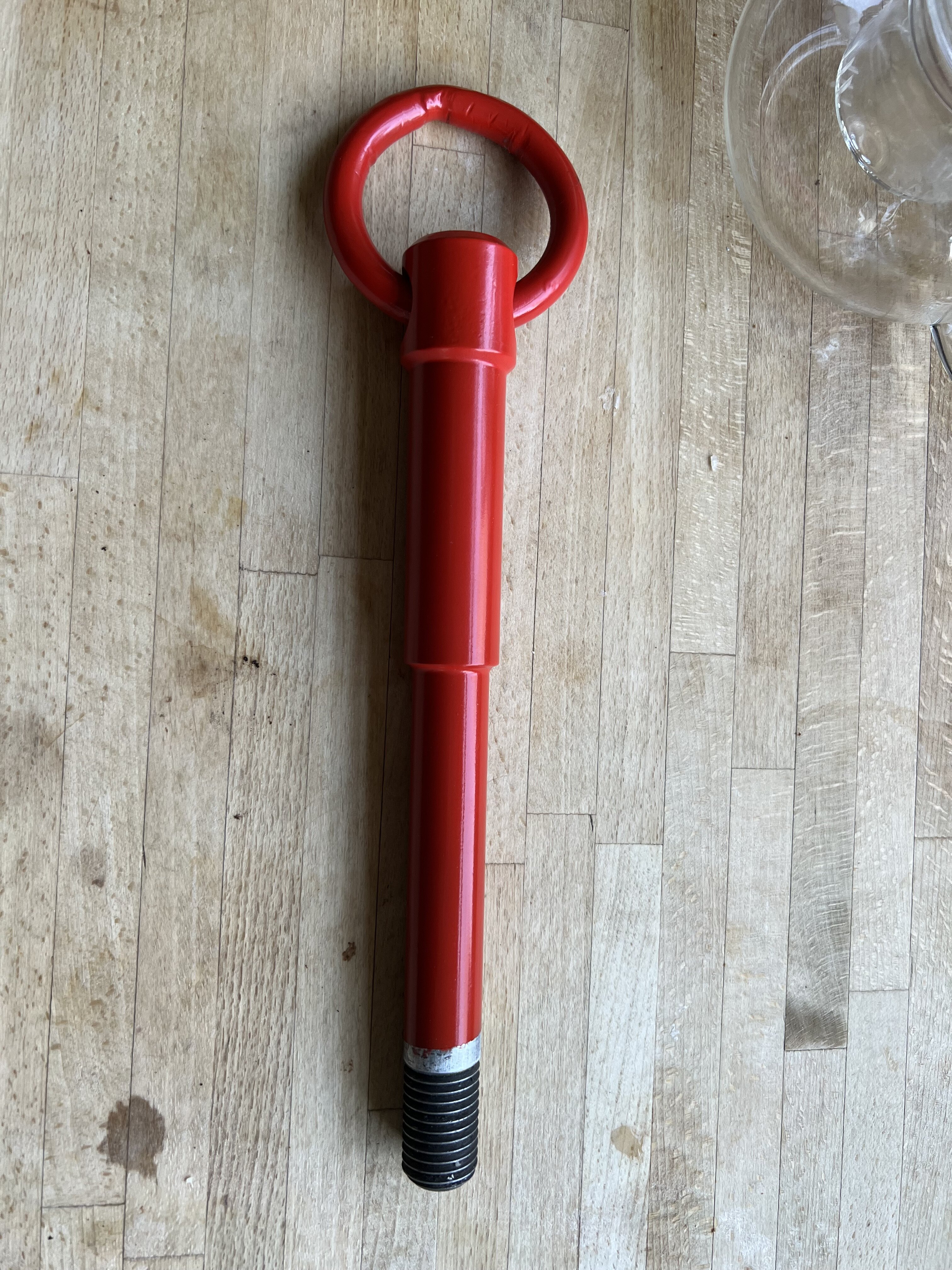

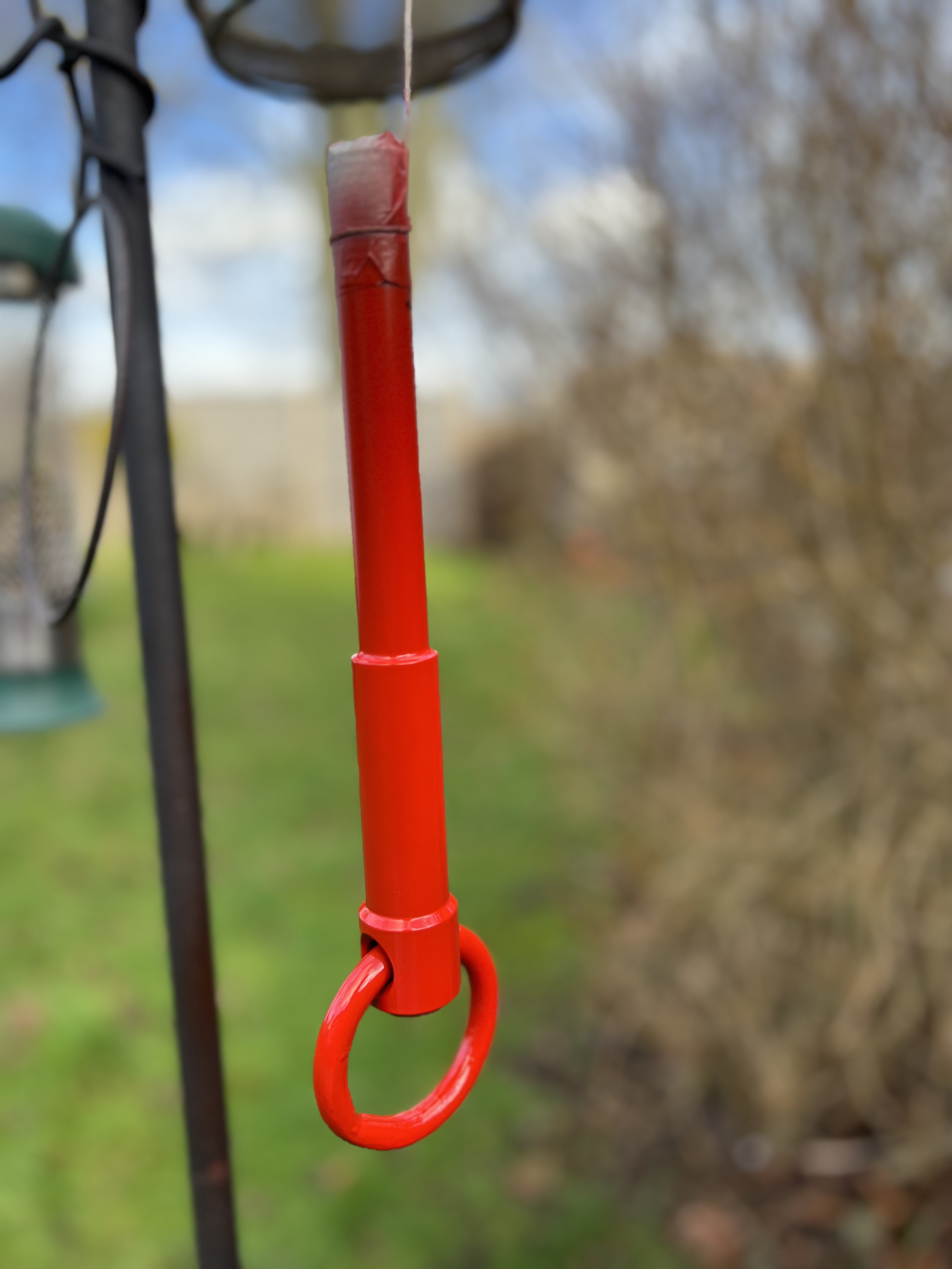

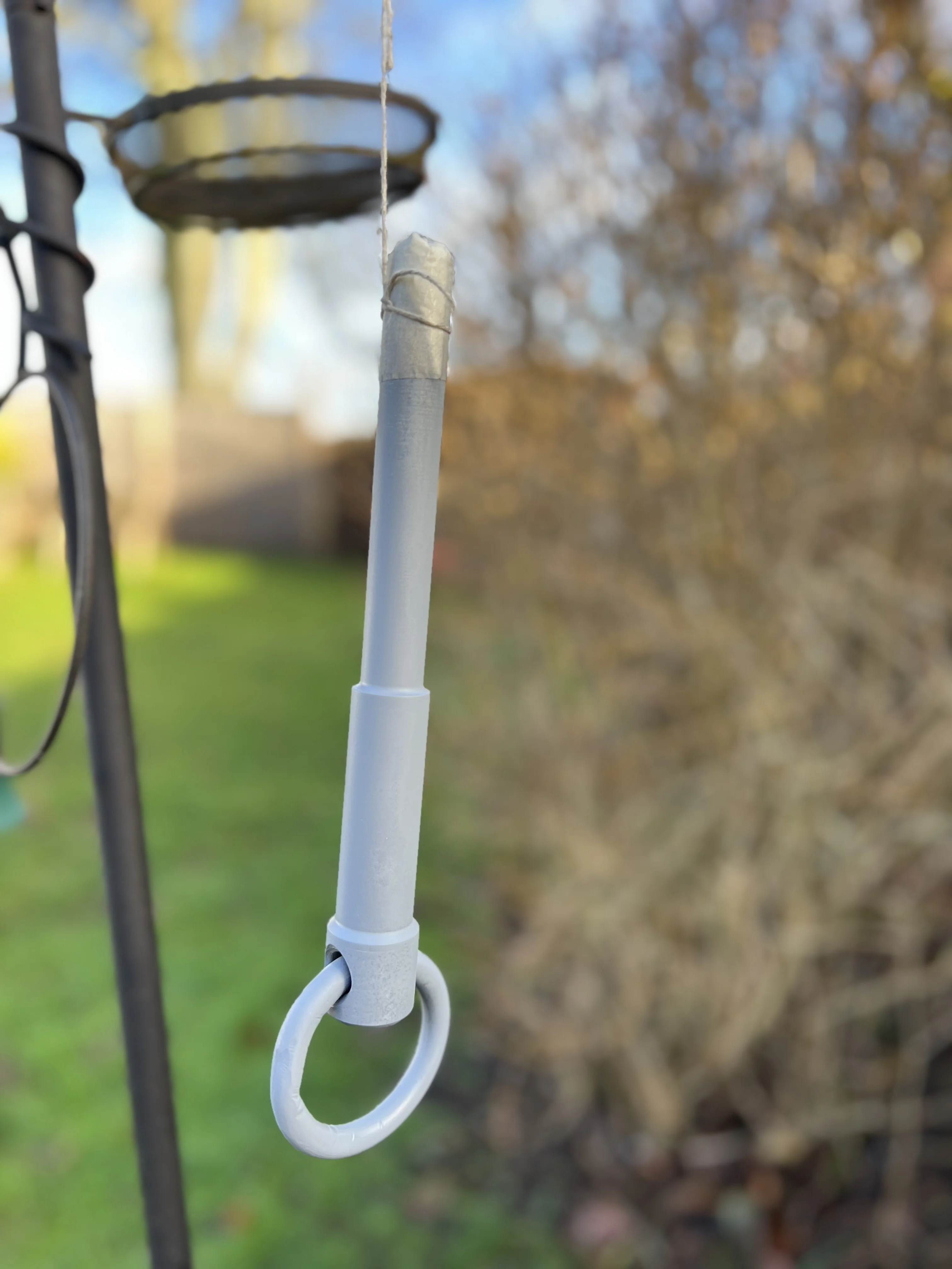

Couple of jobs completed yesterday.

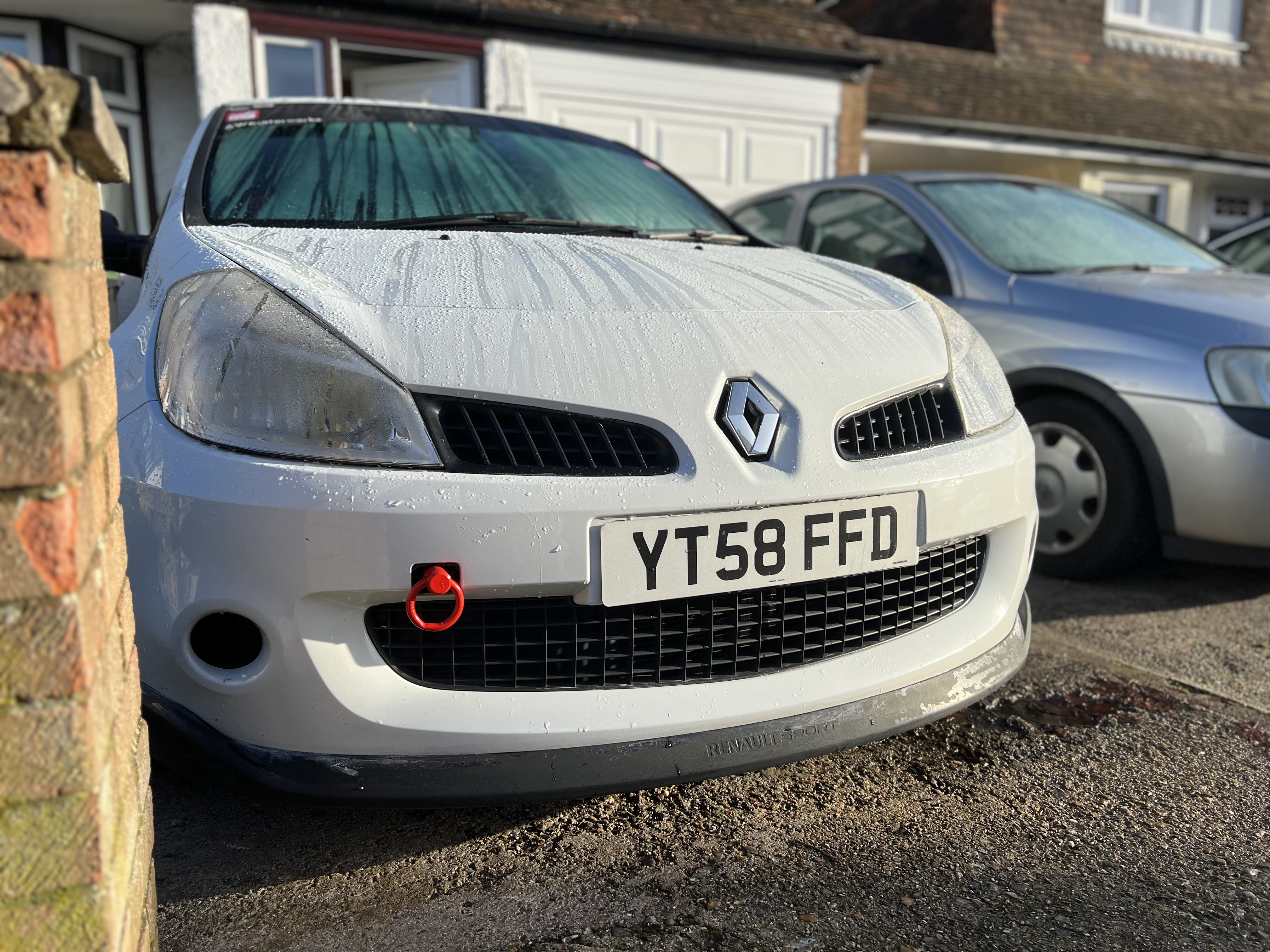

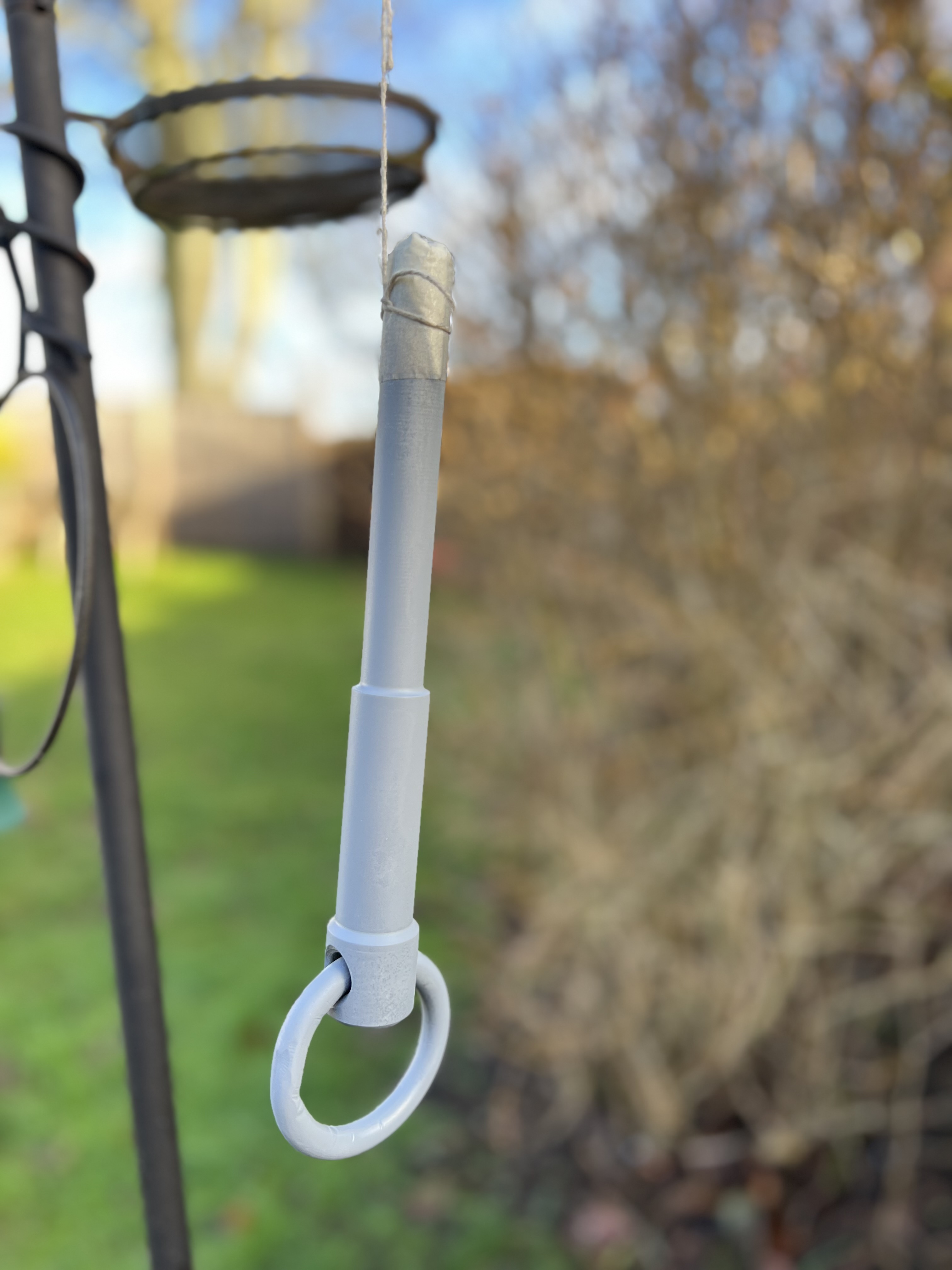

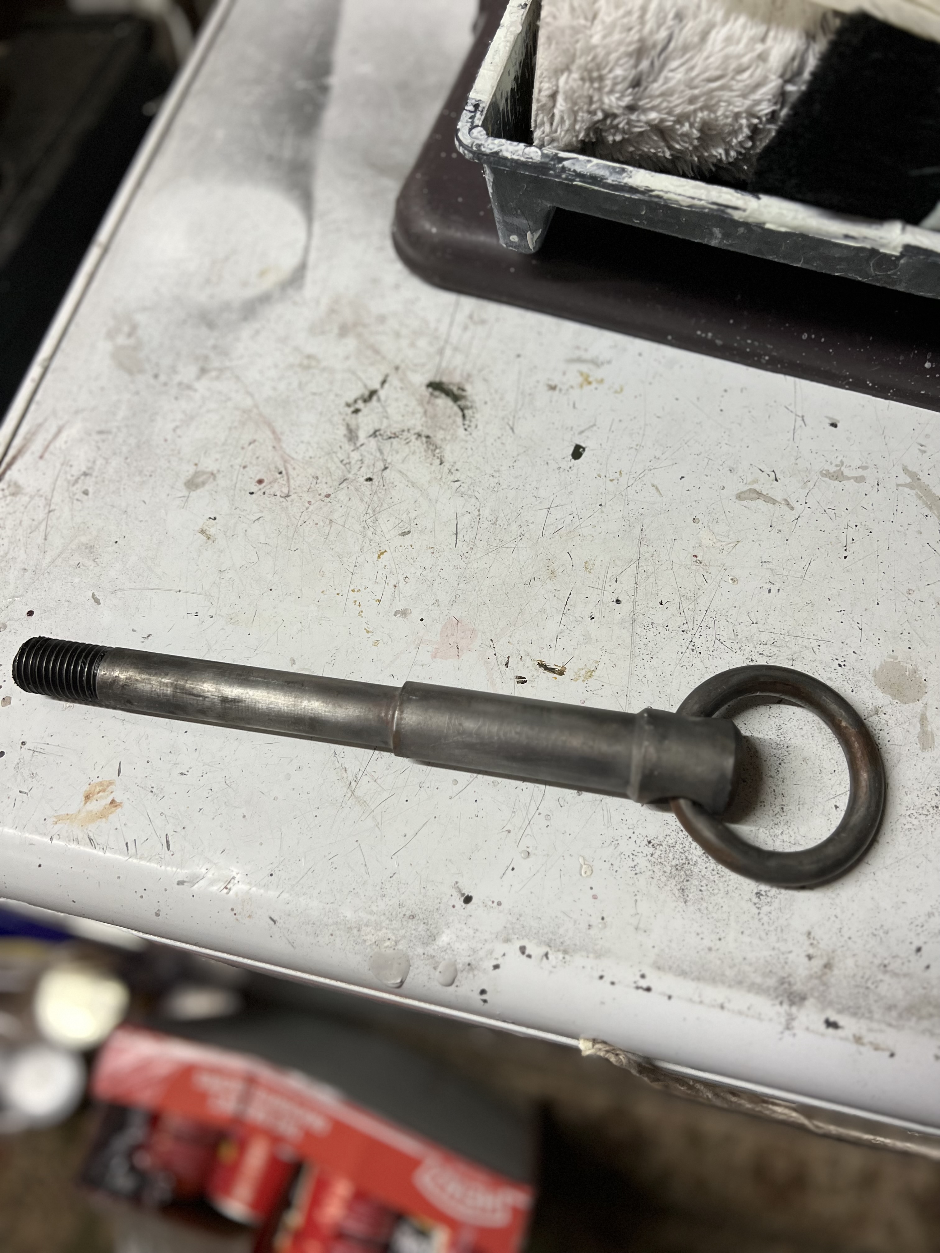

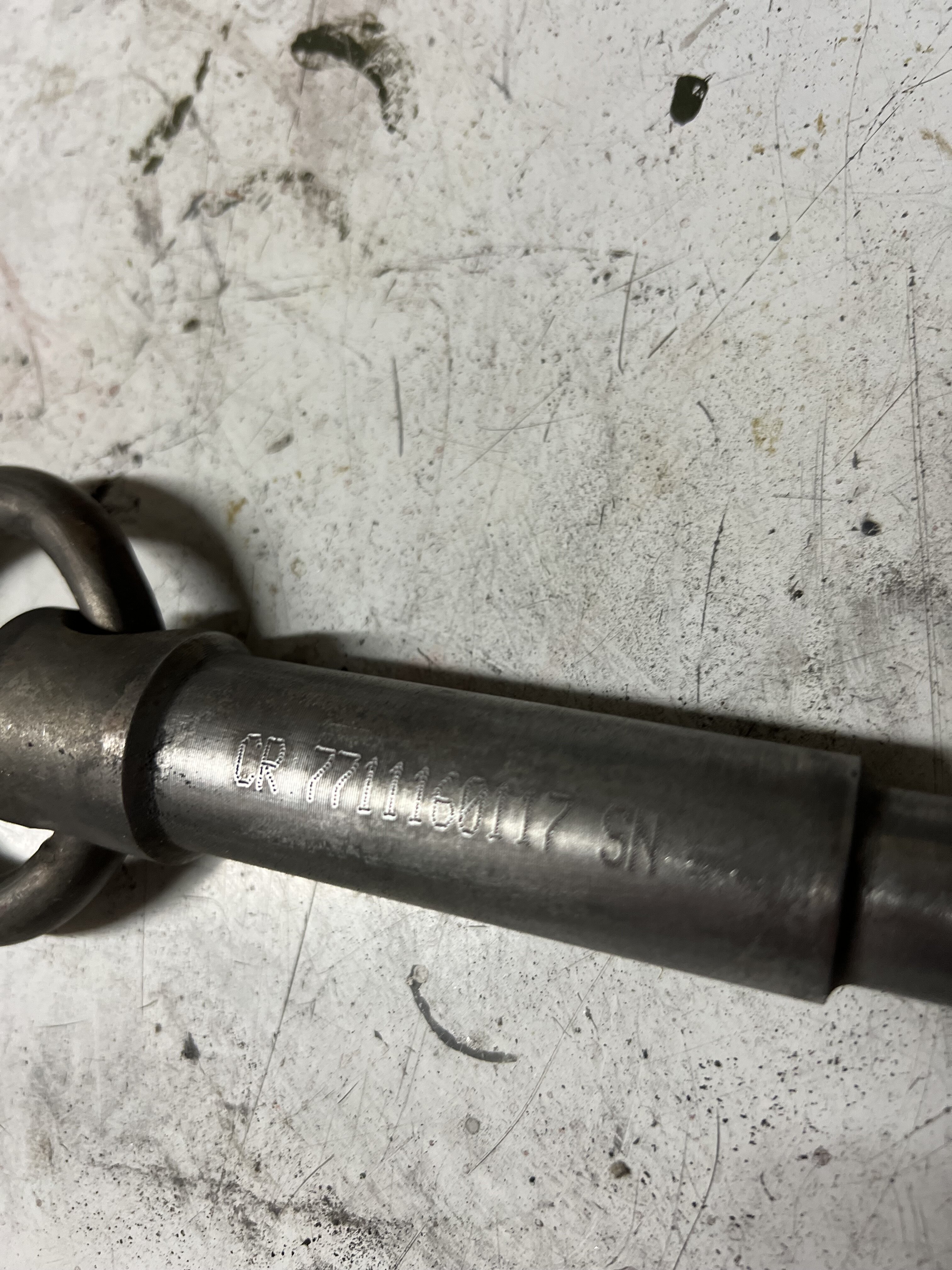

Finished painting the cup racer tow eye and got that back to good condition on the car, as well as stripping 5kg worth of sound deadening out the car as well, every little helps towards the end goal!
Apologies for the s**t pics!

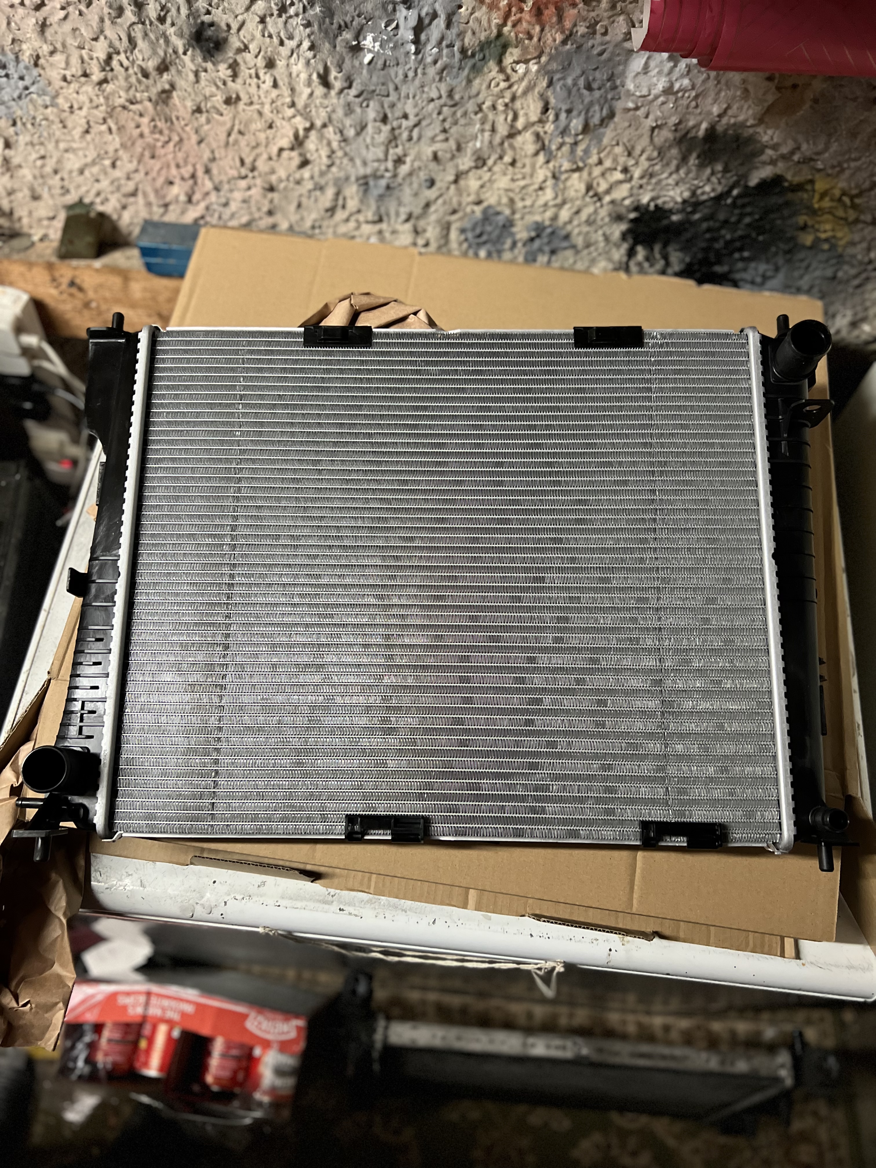

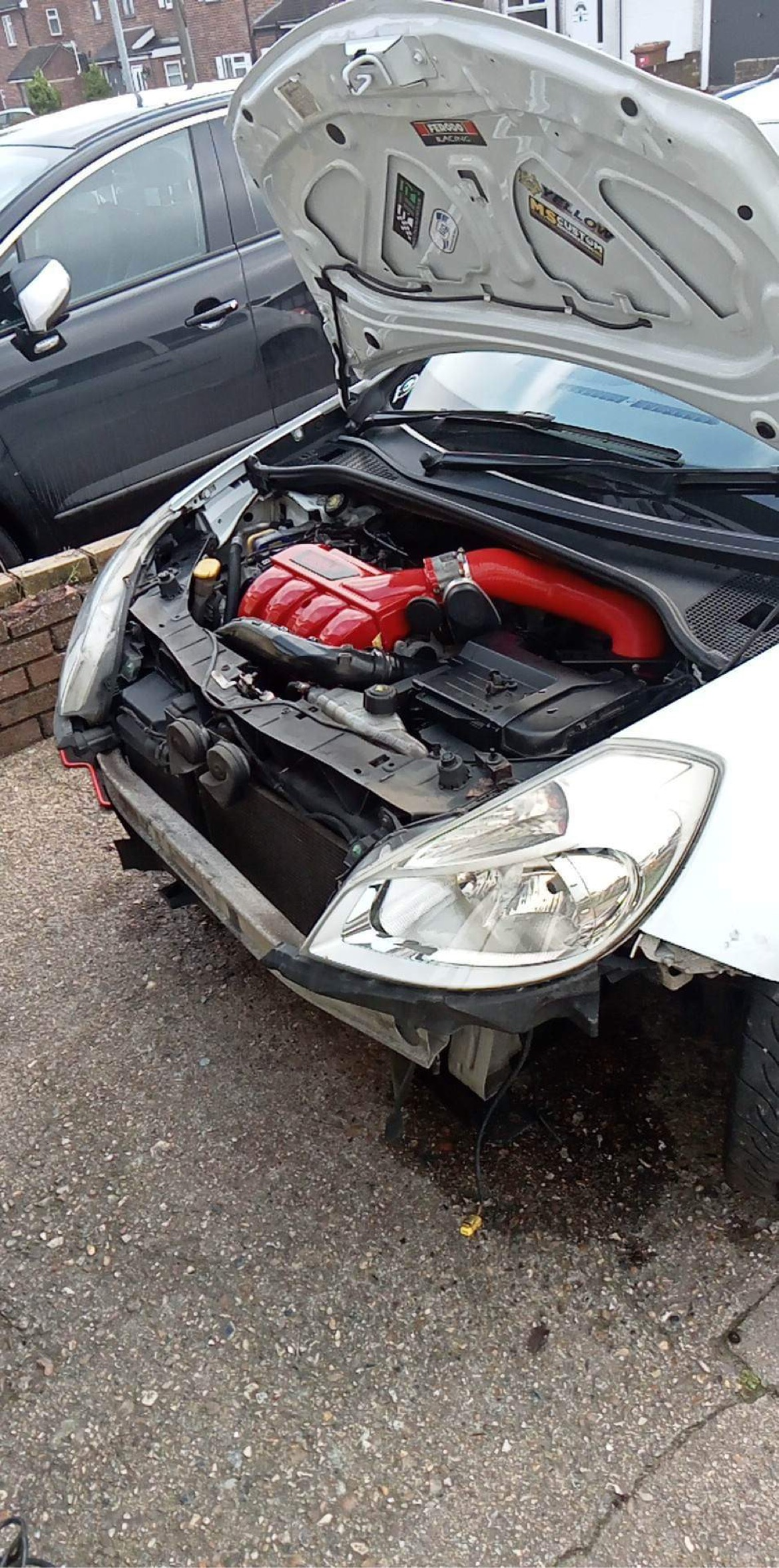

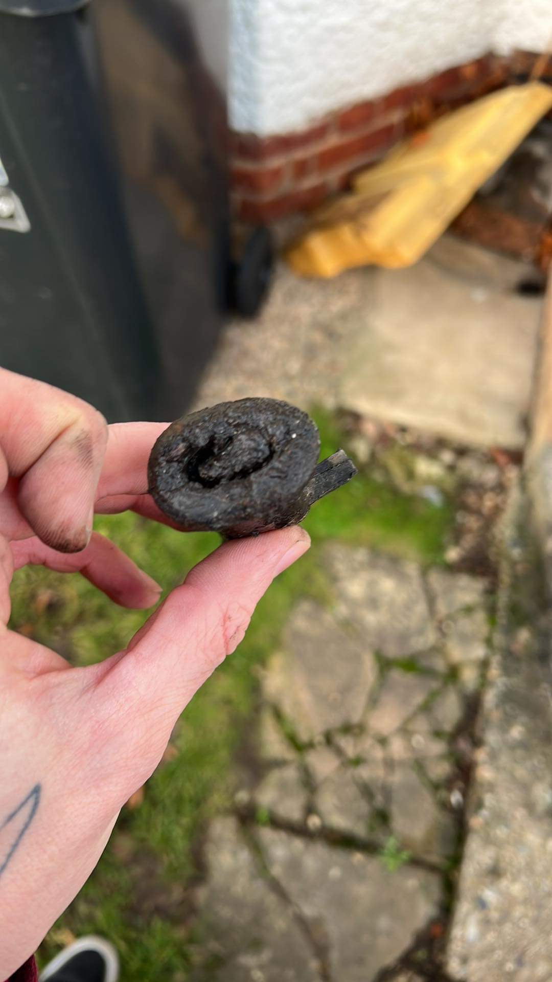

Done some digging. Turns out it’s the radiator / hose that’s caused the leak this time and not the water pump
Starting to lose love with the car recently, small issues keep popping up and it’s really demotivating!
Been a while since i updated this .. so i thought I'd have a quick catch up
The coolant loss issue was down to the radiator in the end, glad I got that fixed and didnt have to get the belts and water pump done just yet!

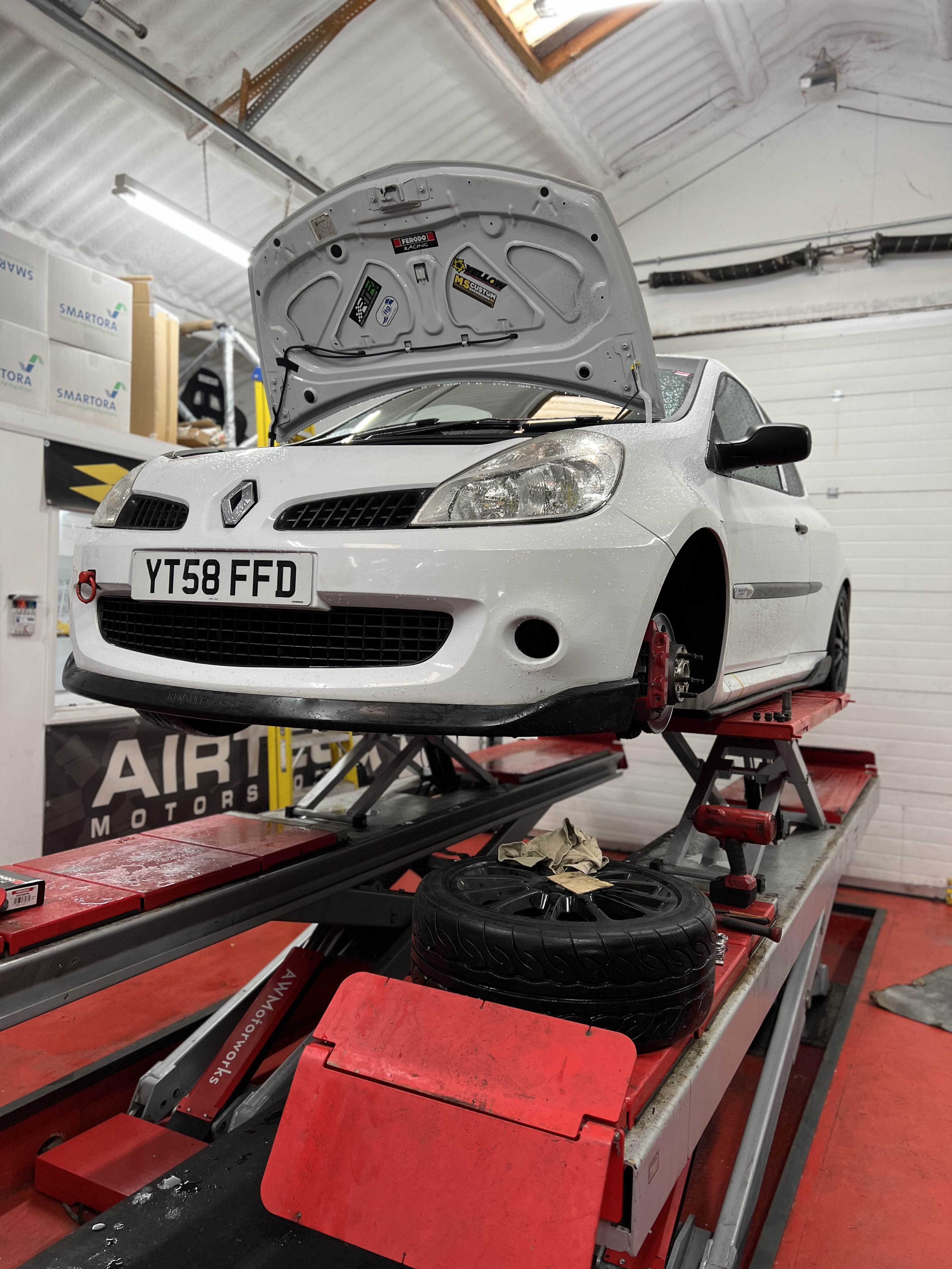

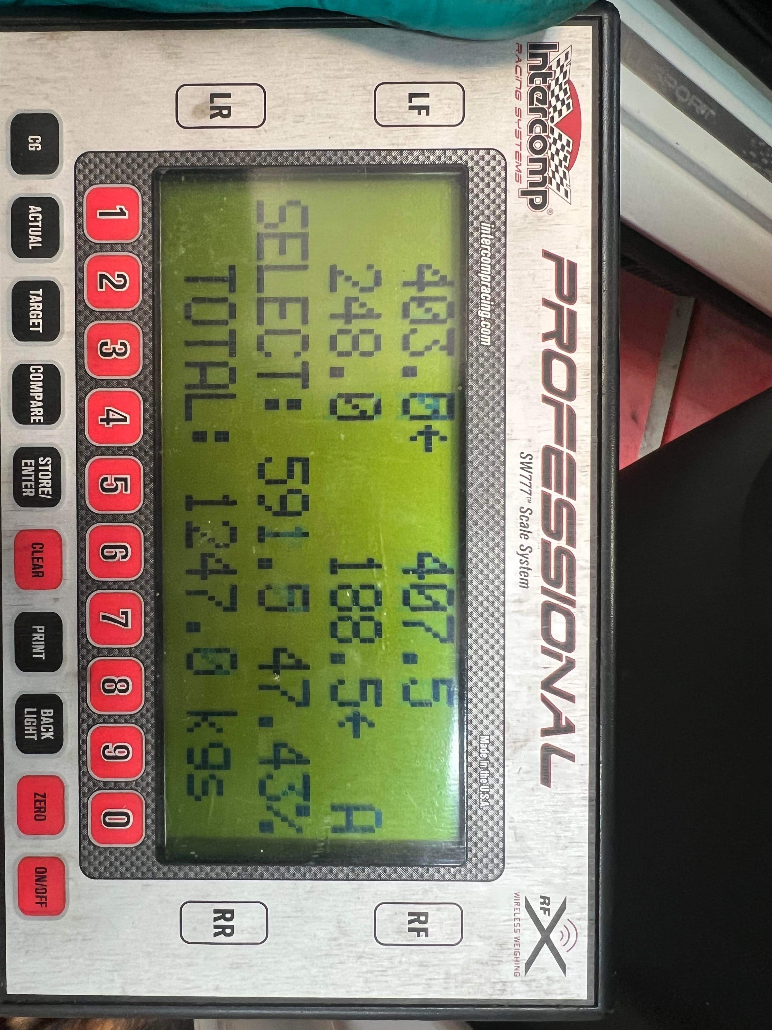

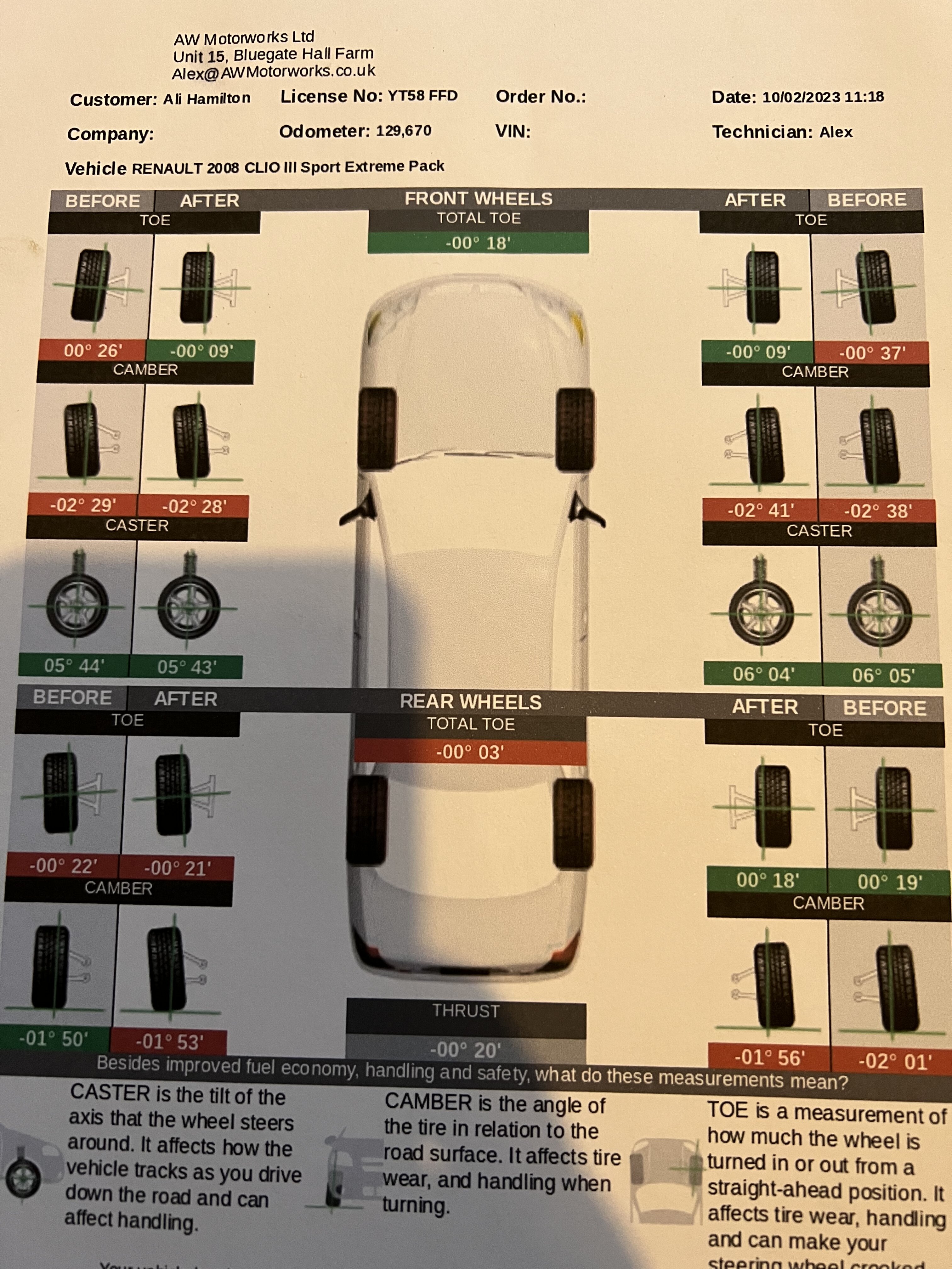

February: time I popped up to AW Motorworks for a service and to get the corner weighting sorted out again, car was a bit lighter than i expected it to be, but still too heavy, the weight shown is with me in the car as well.

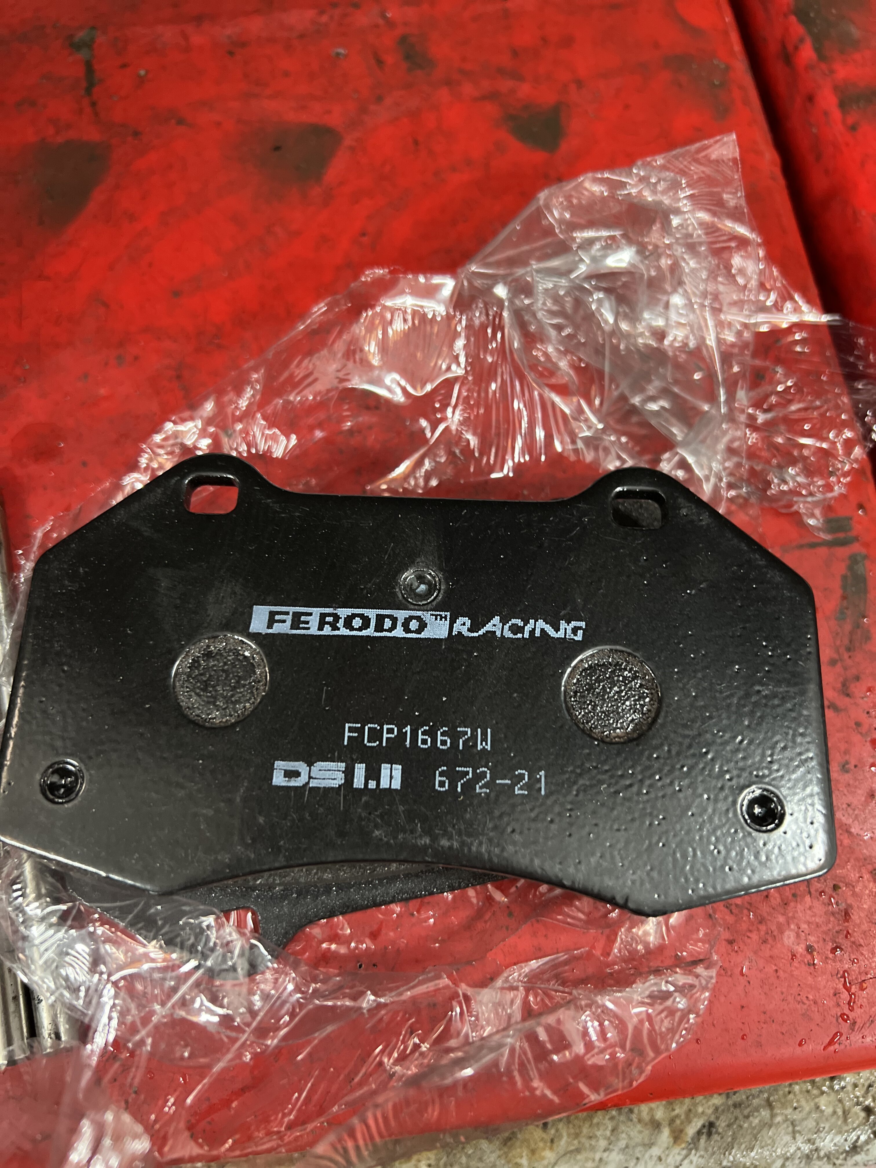

A couple weeks passed ... Got a new passenger seat and some new pads, decided to try out some DS 1.11's for this year and so far they're pretty decent! got the seat sorted and the lap belt holes drilled while at Alex's sorting the brakes out.

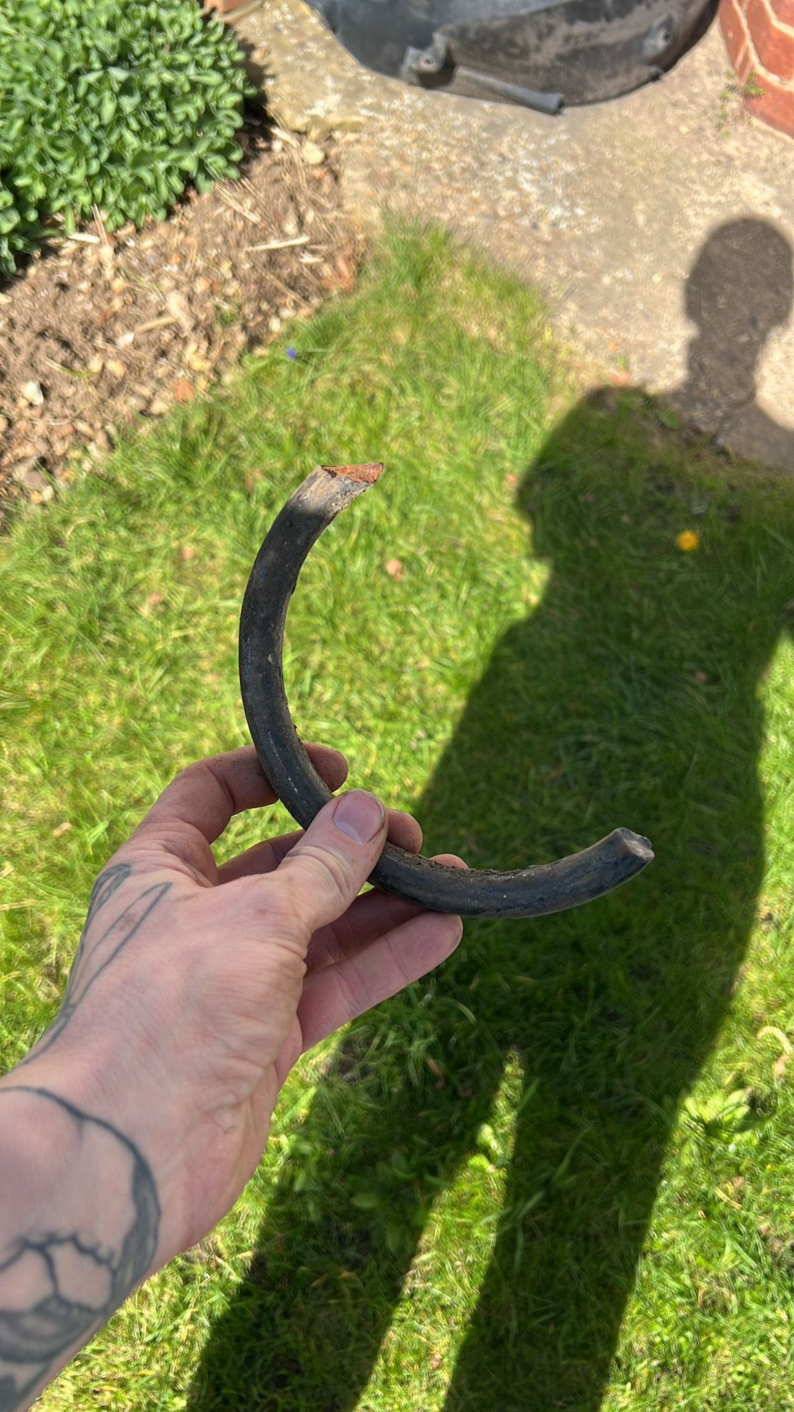

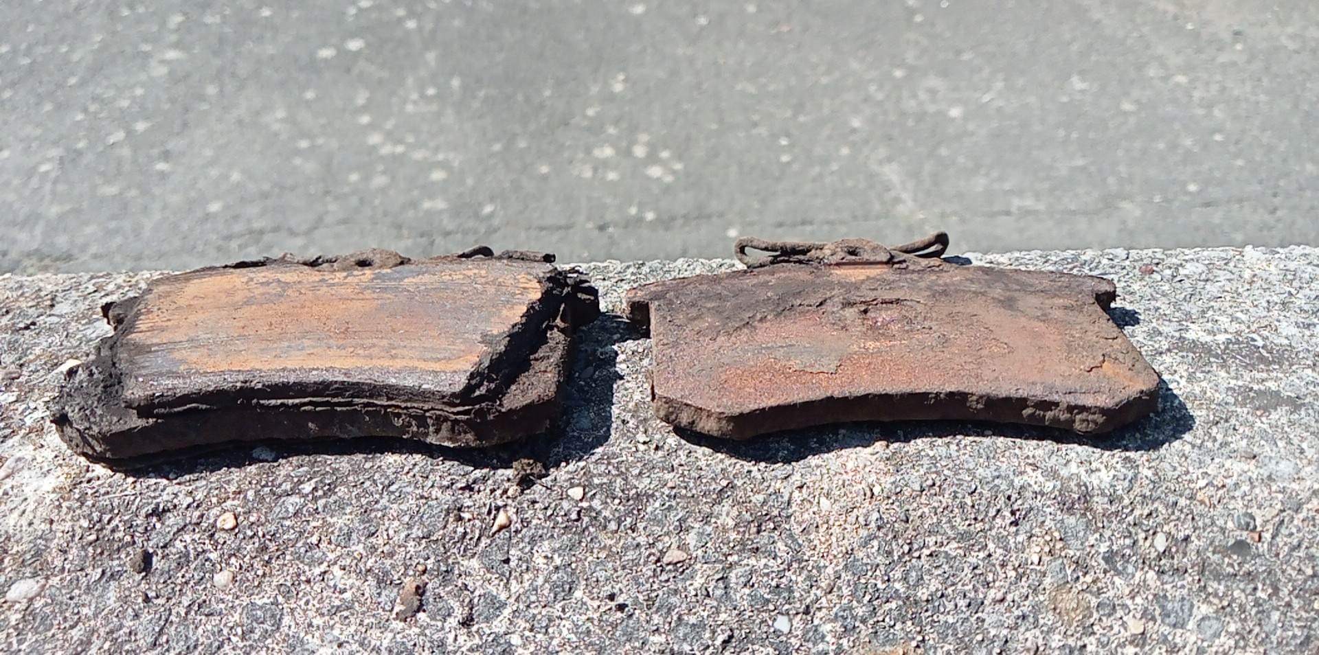

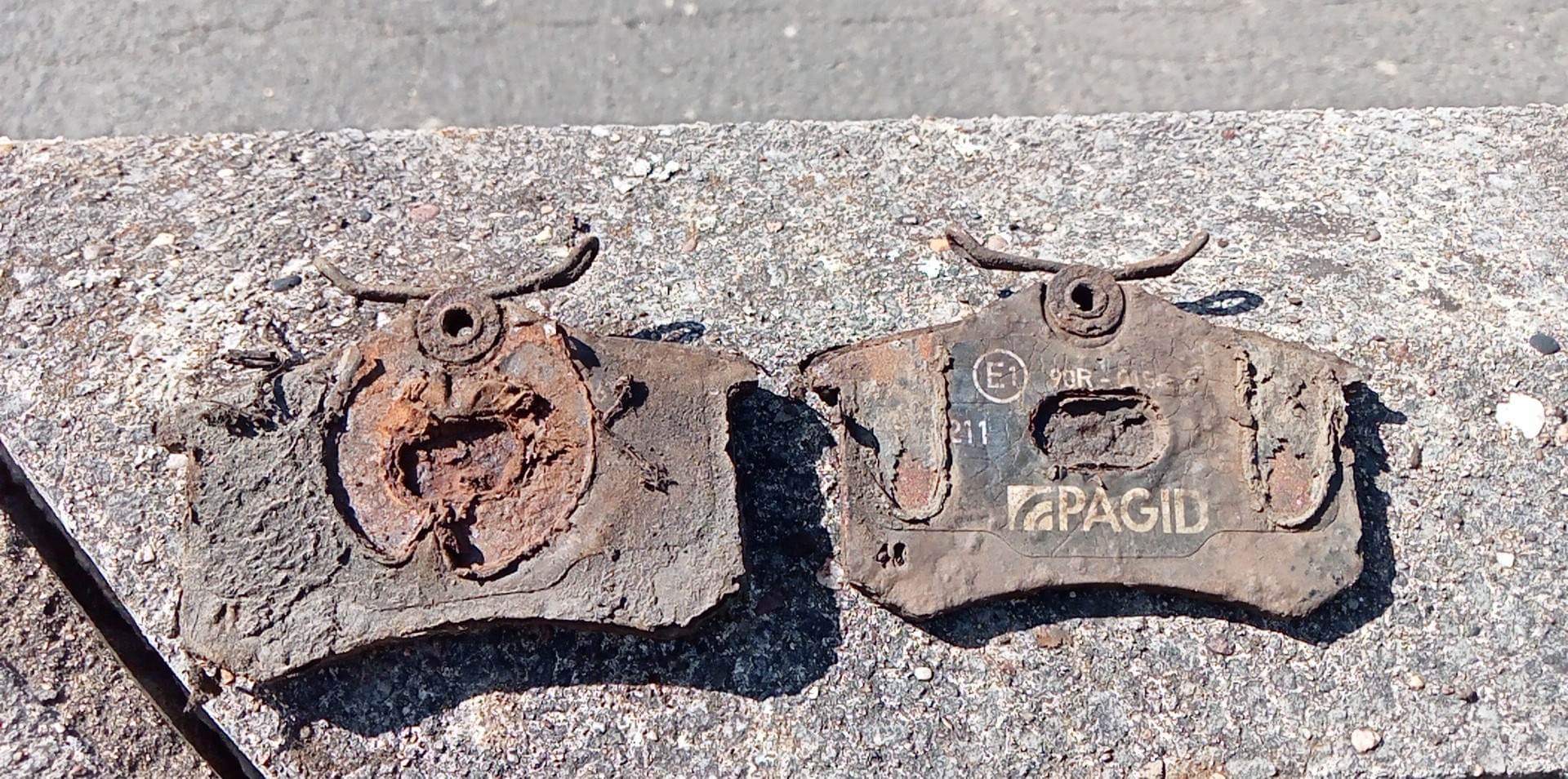

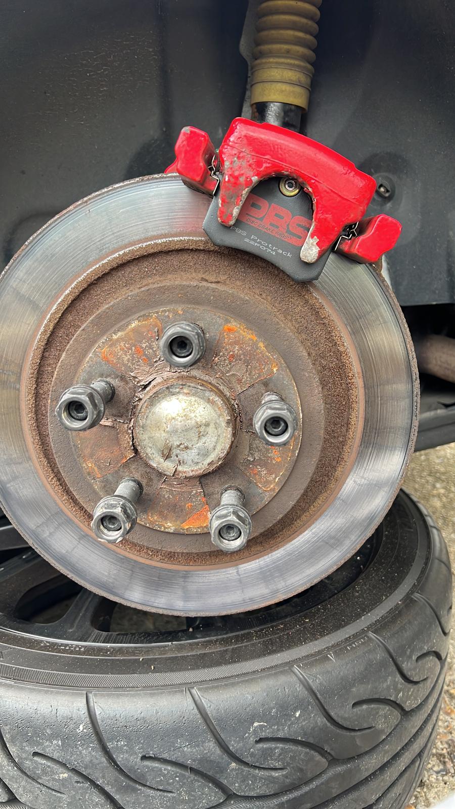

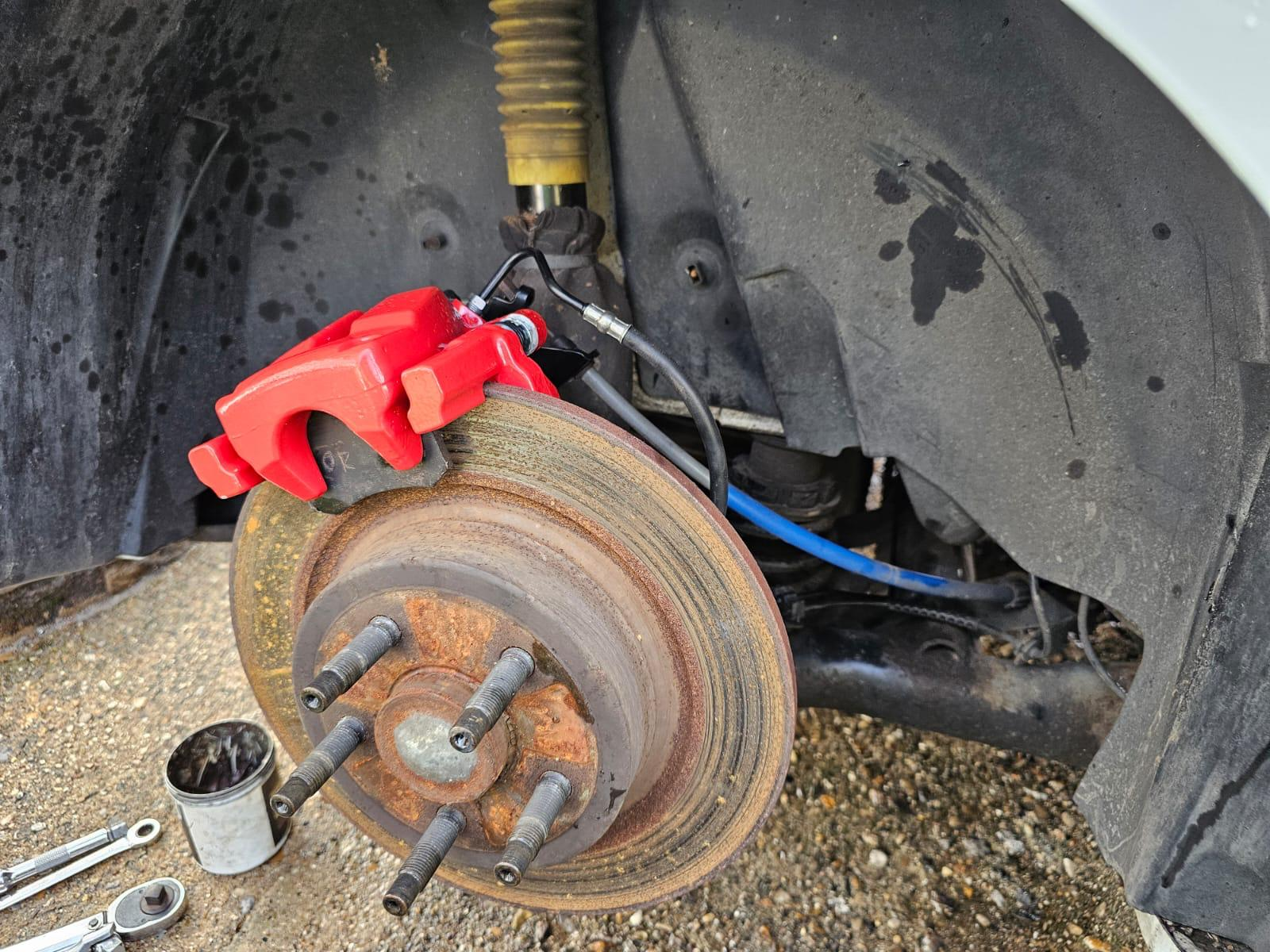

Then coming up to the past few weeks / today I got round to the rear pads .. One of the materials fell out on the way to caffeine and machine last month, didnt realize how bad they where so its a bit embarrassing! Got some brembo's in there to get me along for a couple weeks until my PBS pro track's turned up, which I got in and sorted this afternoon.

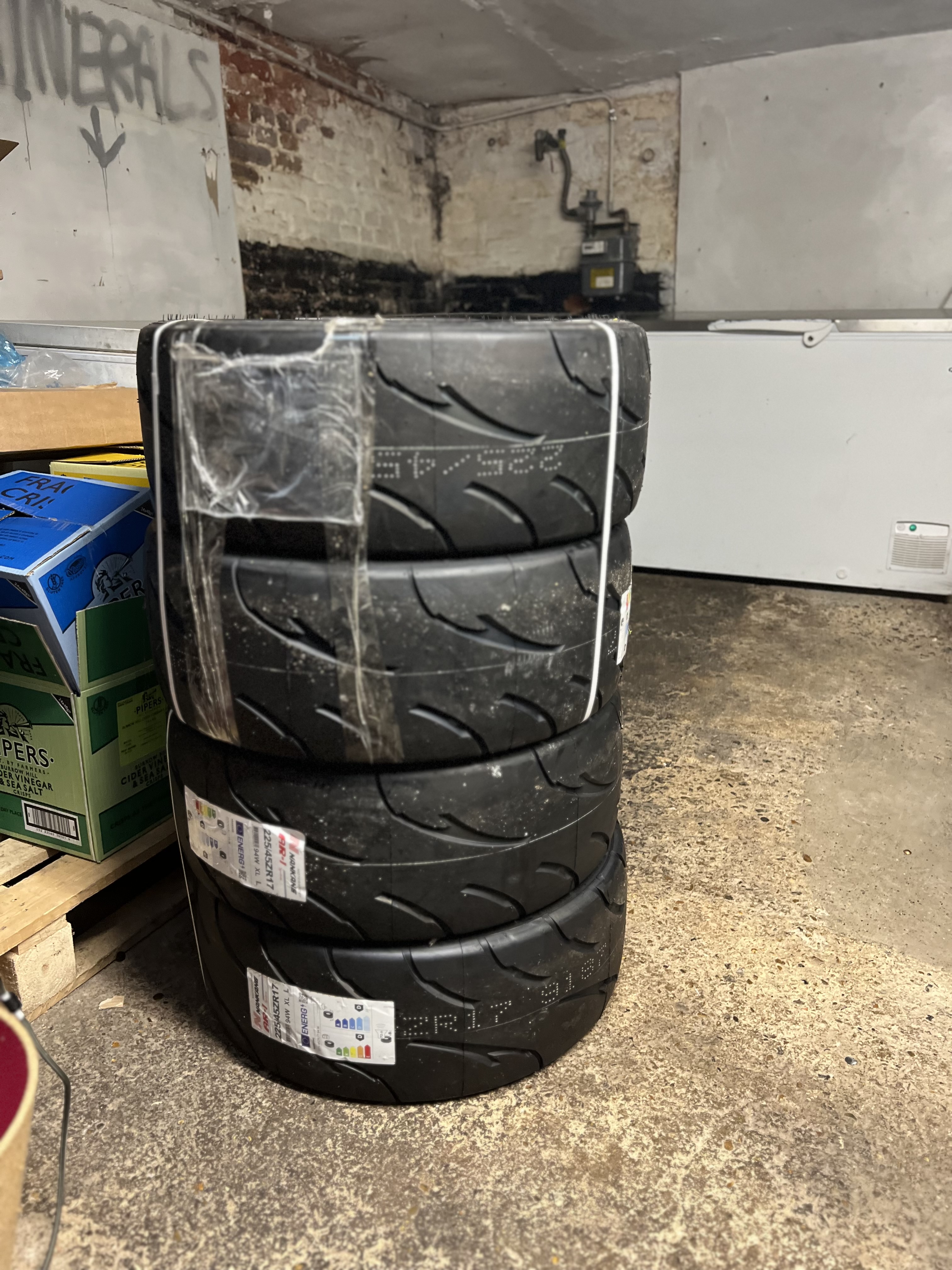

Got some fresh ar1’s through to try for Anglesey which I’m excited about.

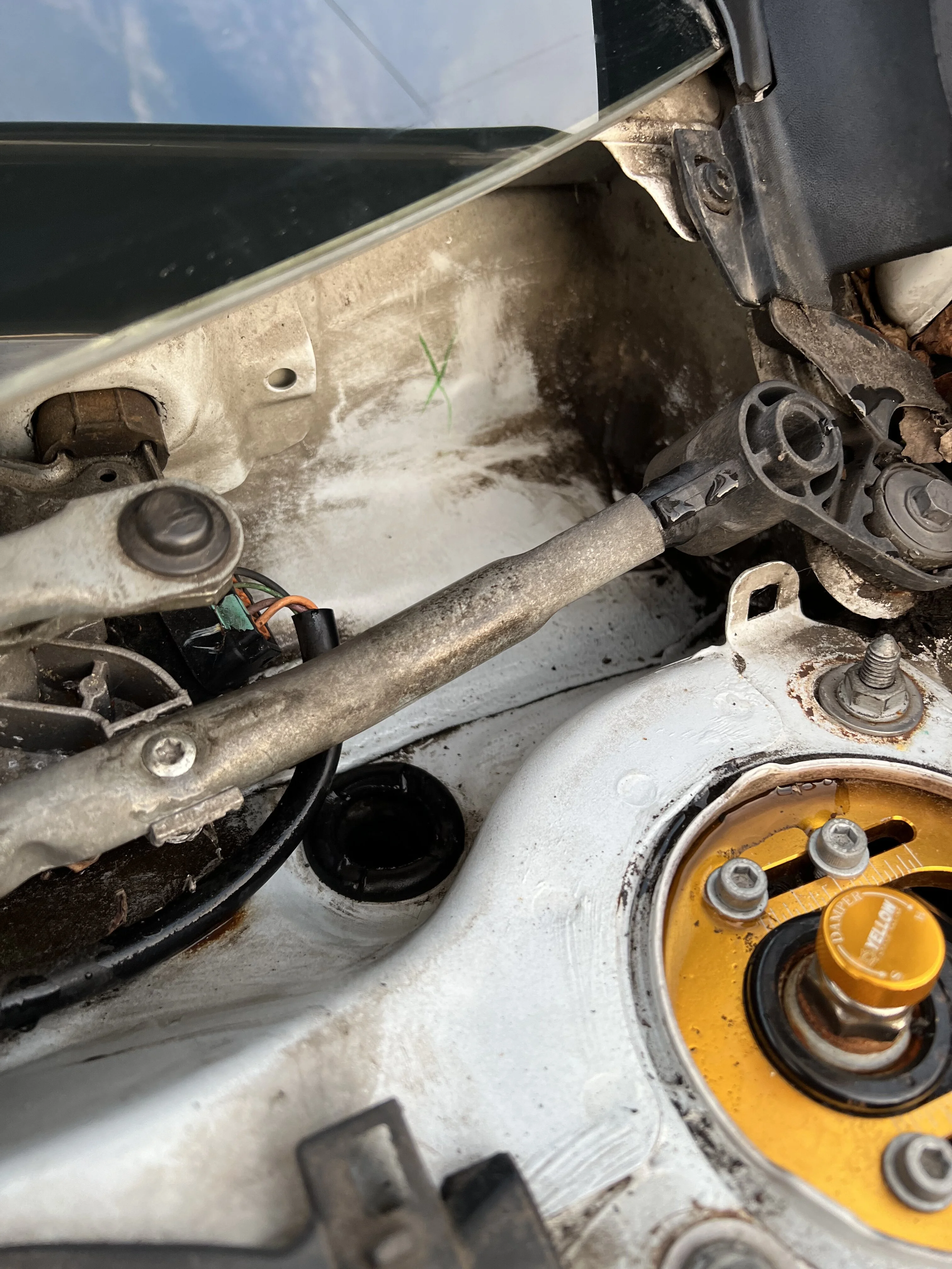

Fitted a new windscreen wiper motor the other week due to the last one packing in, and cleaned out the scuttle while I was there

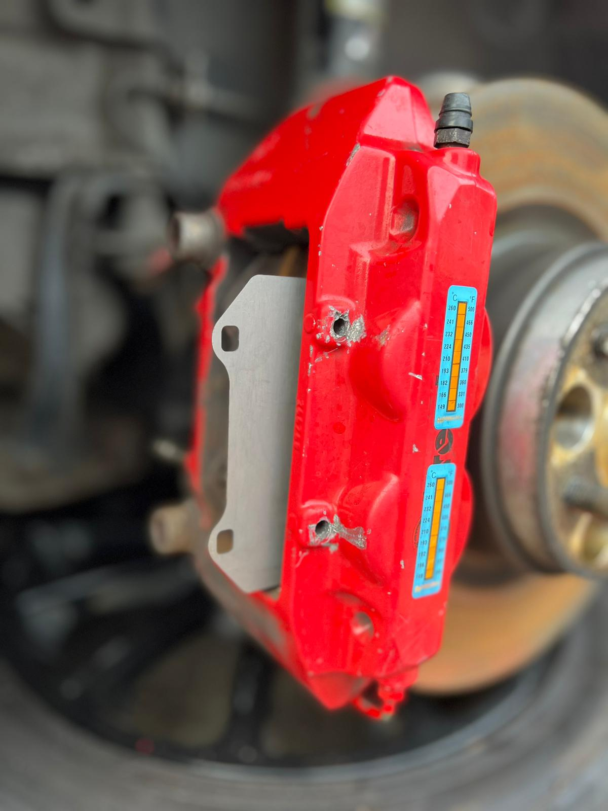

Calipers refurbed and painted by MS Custom engineering and new OEM brake lines

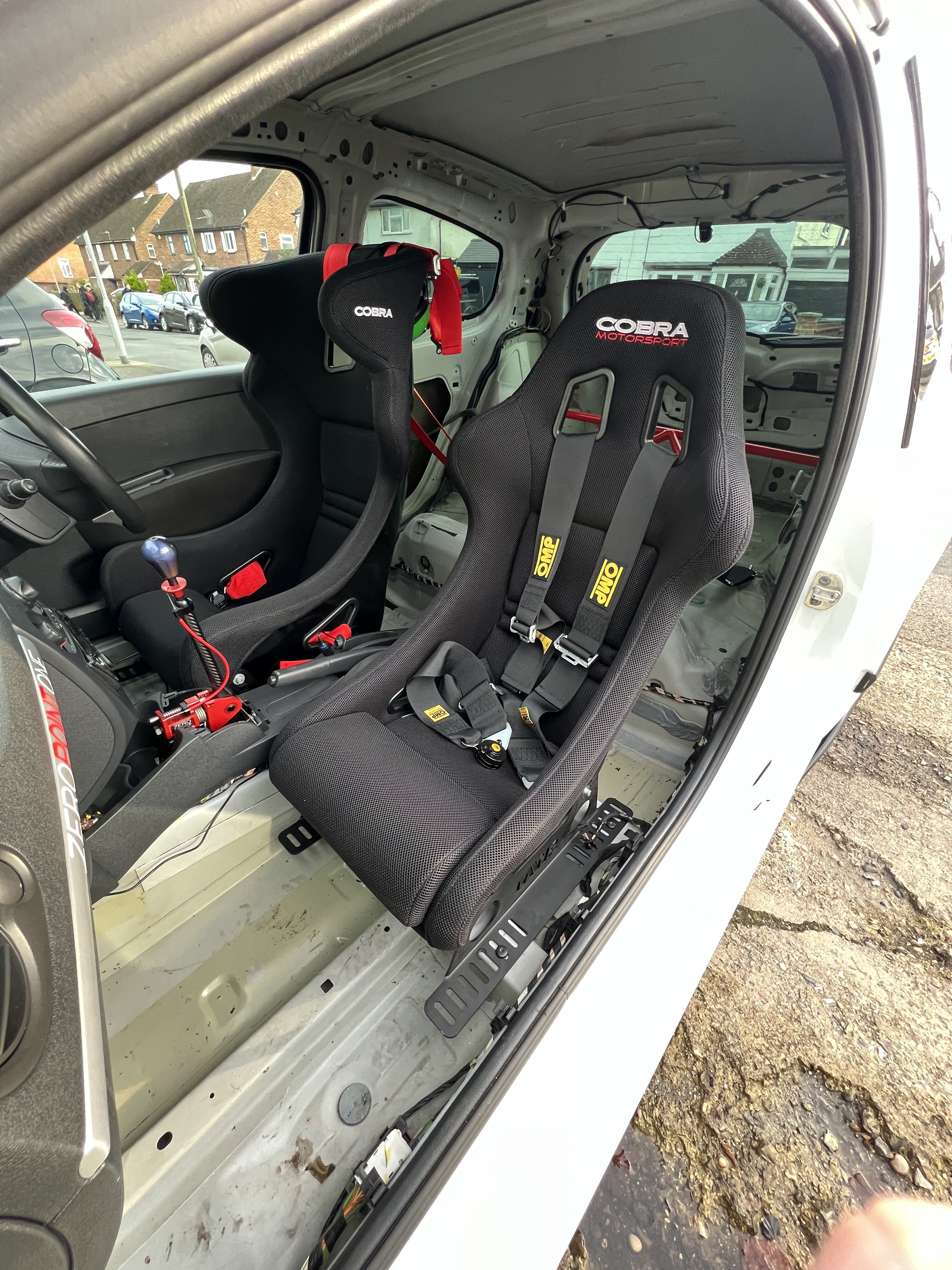

swapped the seats over - passenger seat is now the drivers and the halo seat is out .. swapped the harnesses over as well as i prefered the newer black 801.

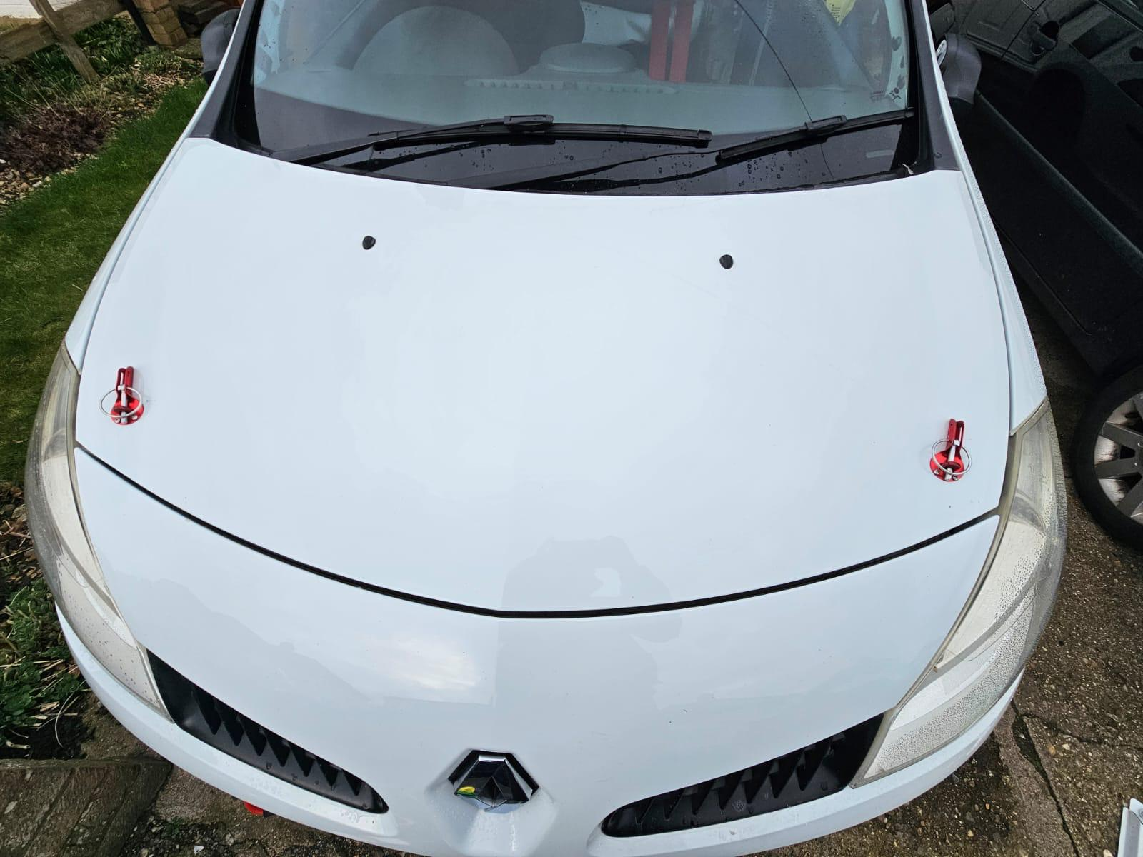

Bonnet pins installed

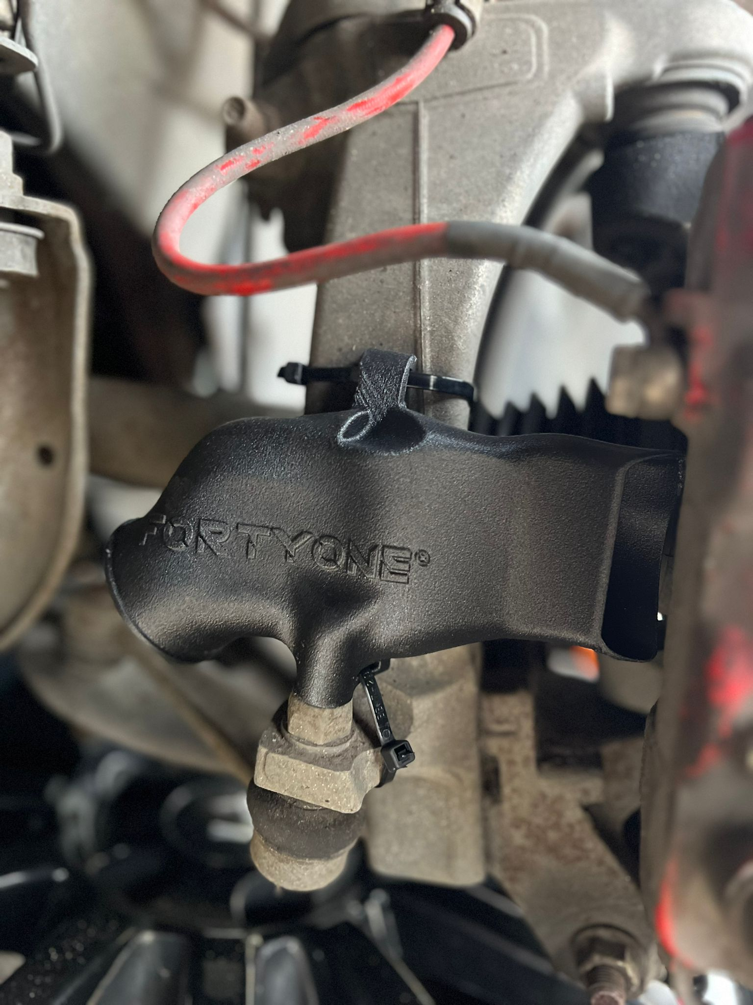

Fortyone brake cooling strapped up and waiting for the hoses to arrive to make it all work and their Ti shims in as well

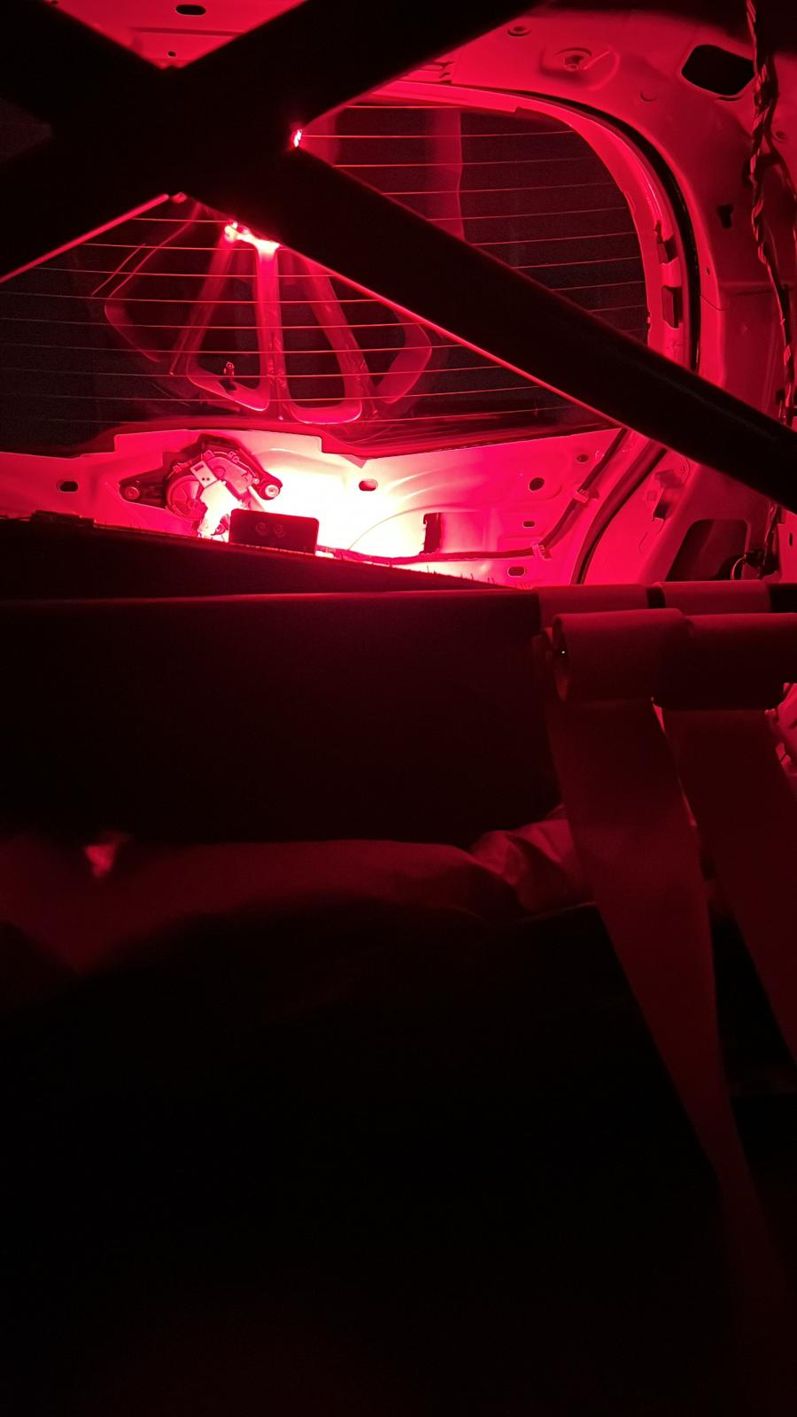

Cool down light wired in thanks to Joe (cant remember his user on here)

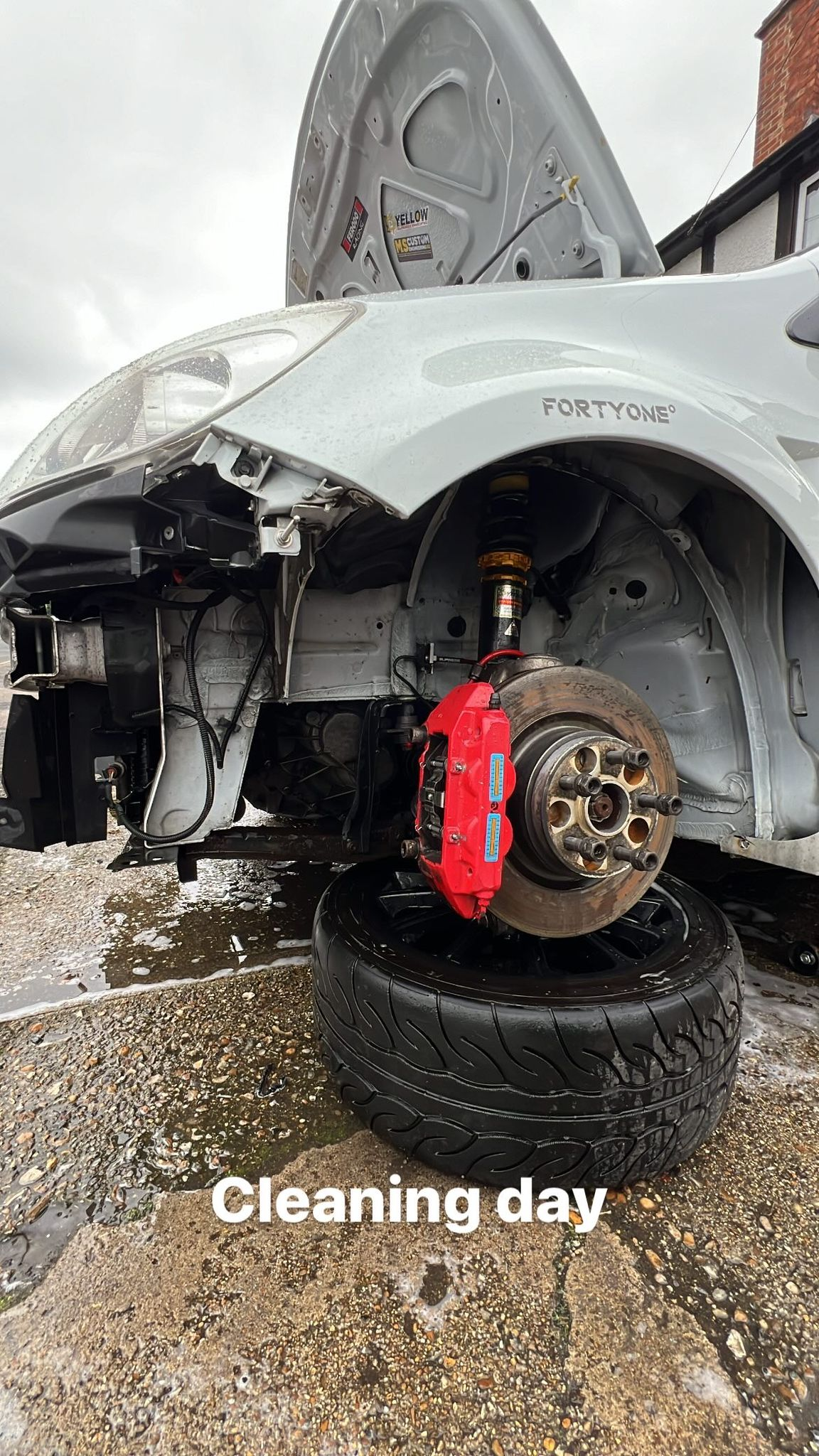

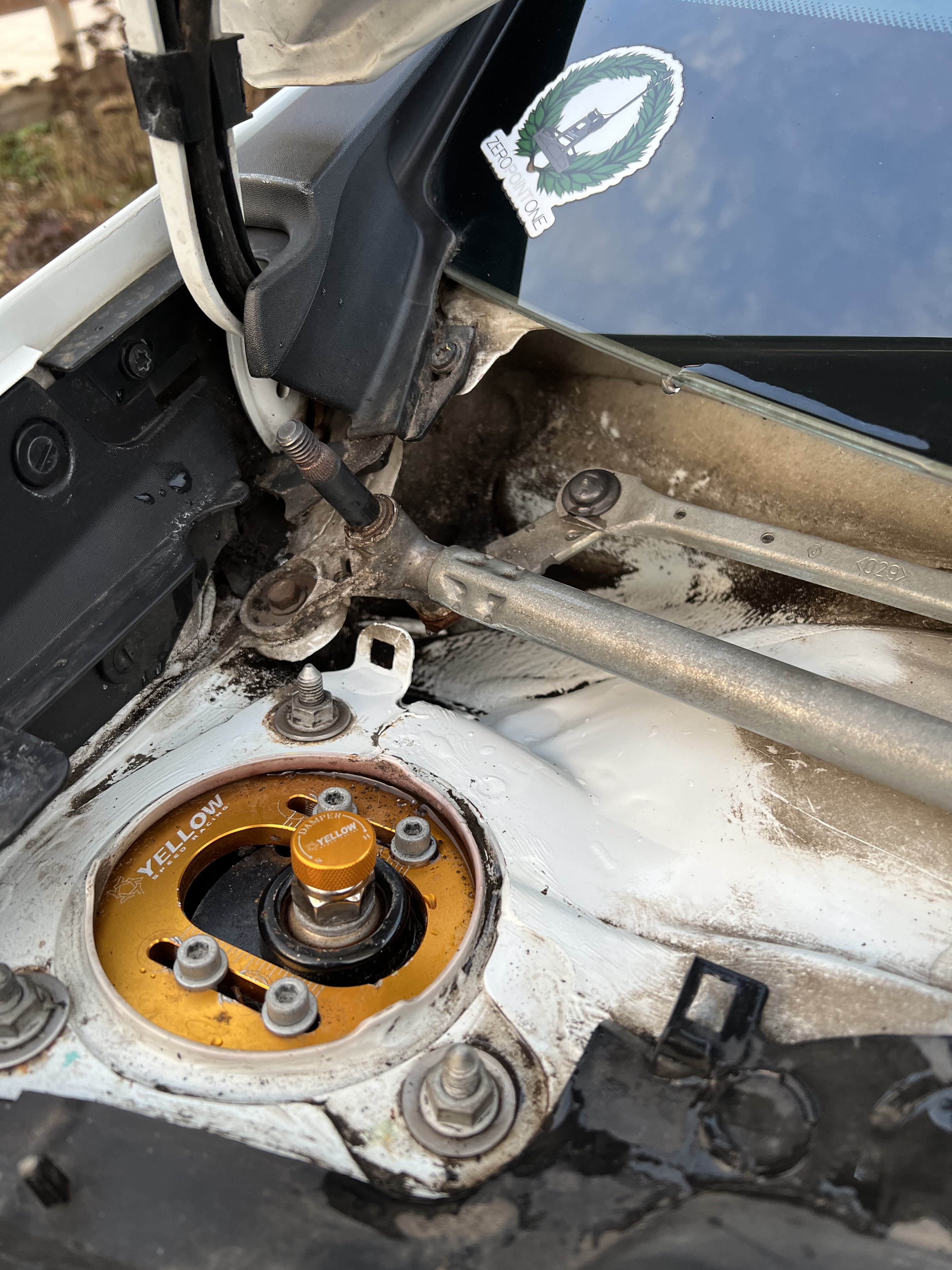

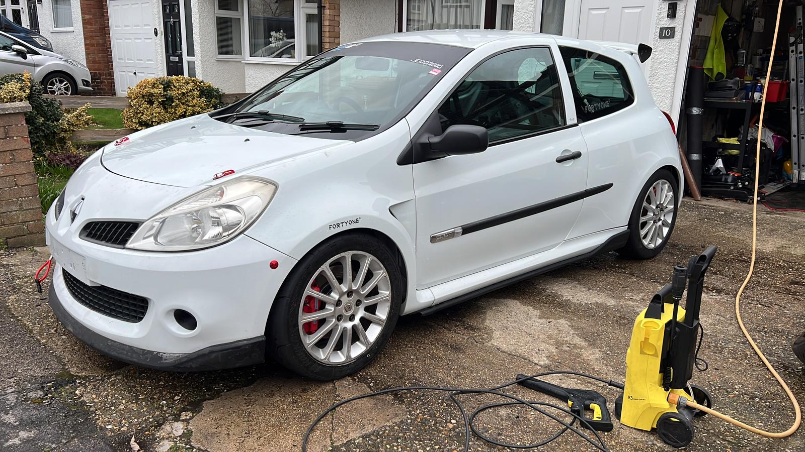

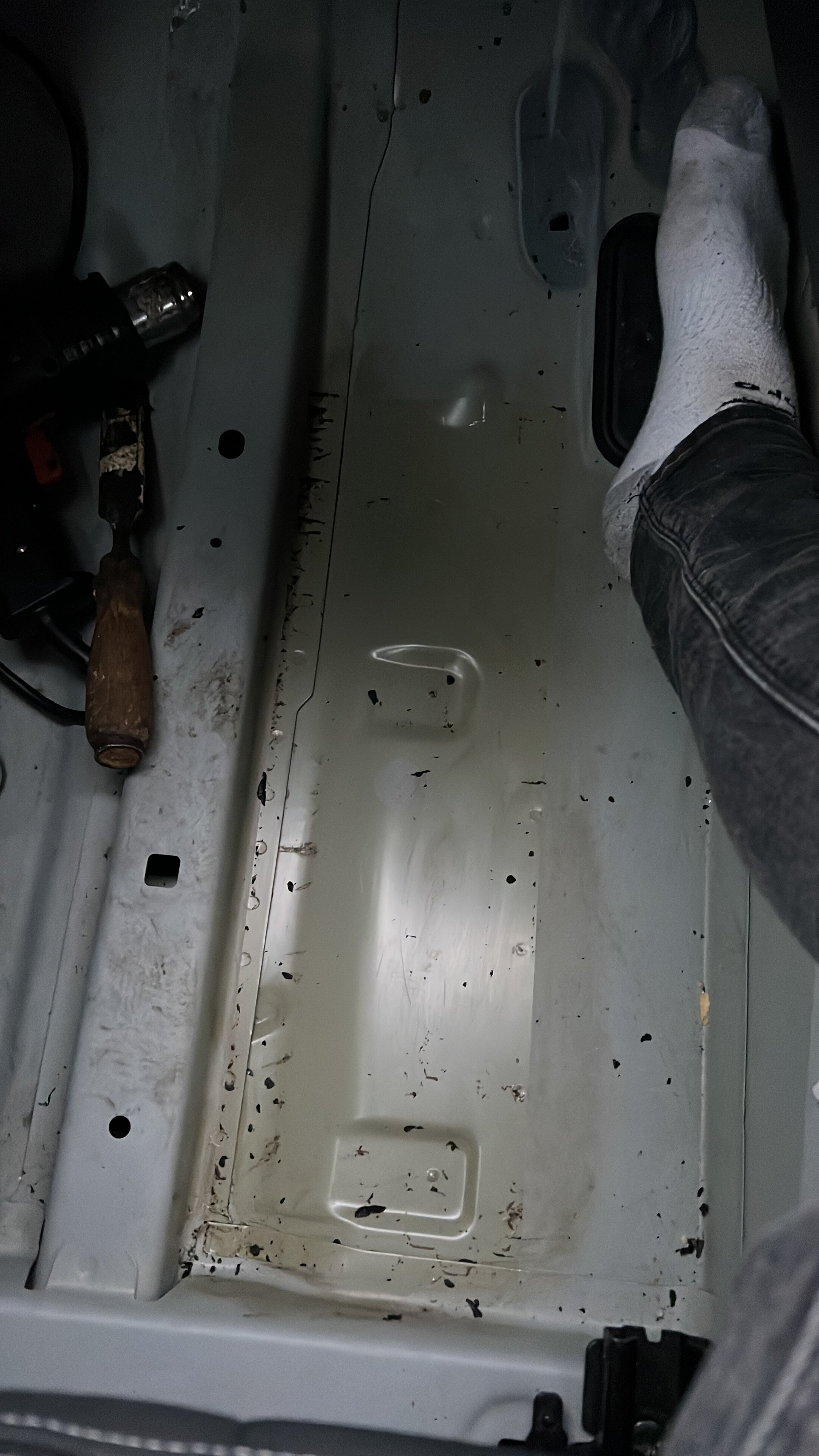

Deep cleaning day the weekend that just went, arch liners out and bare metal out. Nice to get the Yellowspeeds cleaned up again and lowered the car a tad up front both sides also

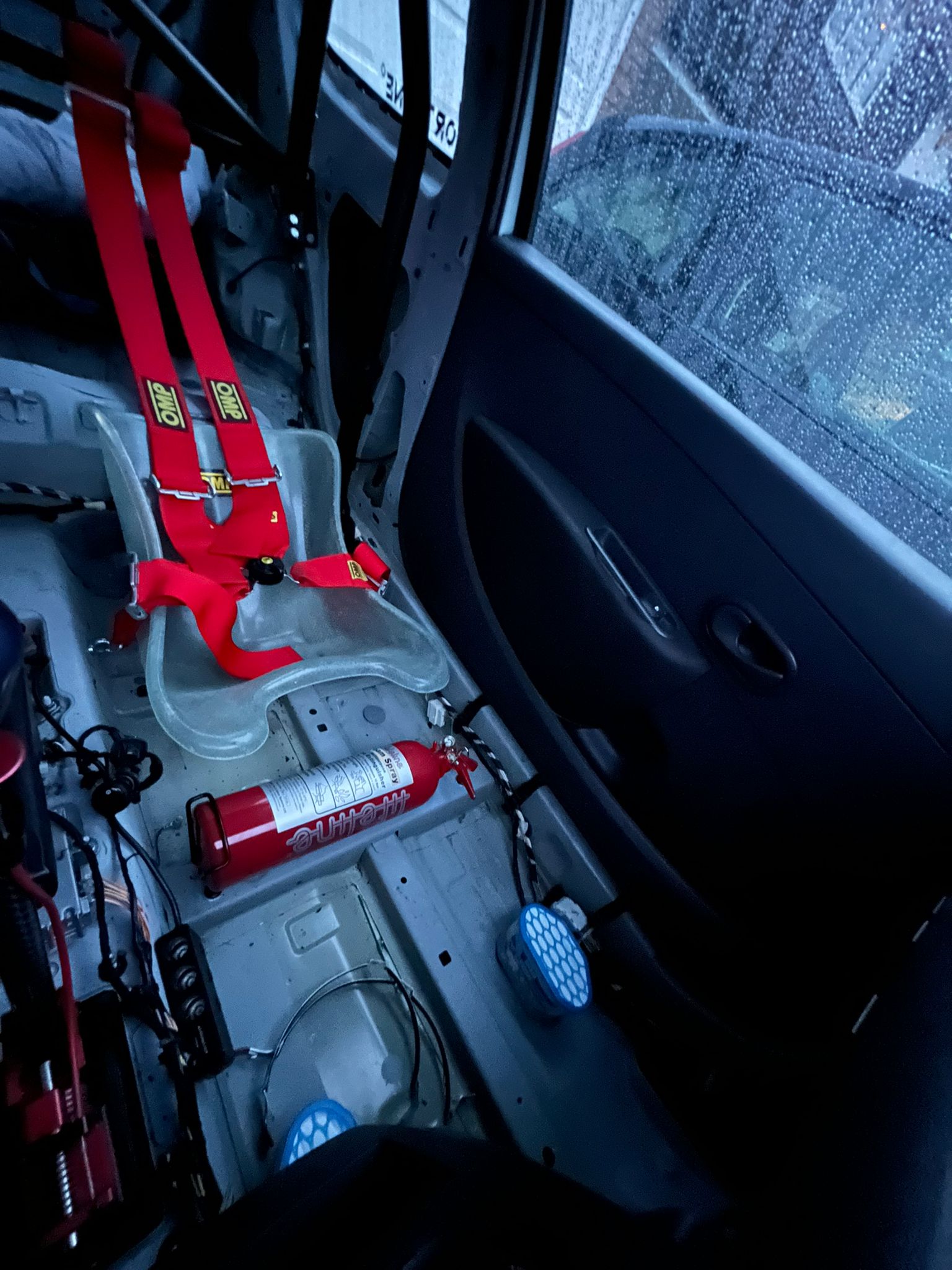

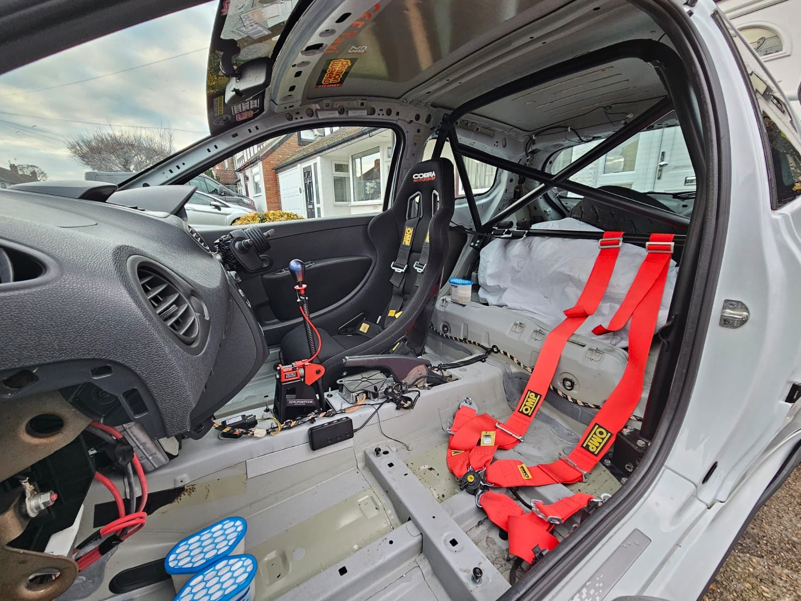

Fire extinguisher and kart seat turned up so gave them a test fit today, prior to bolting in saturday! - Yes the seat is for the passenger, and yes it is allowed by regulations of time attack.

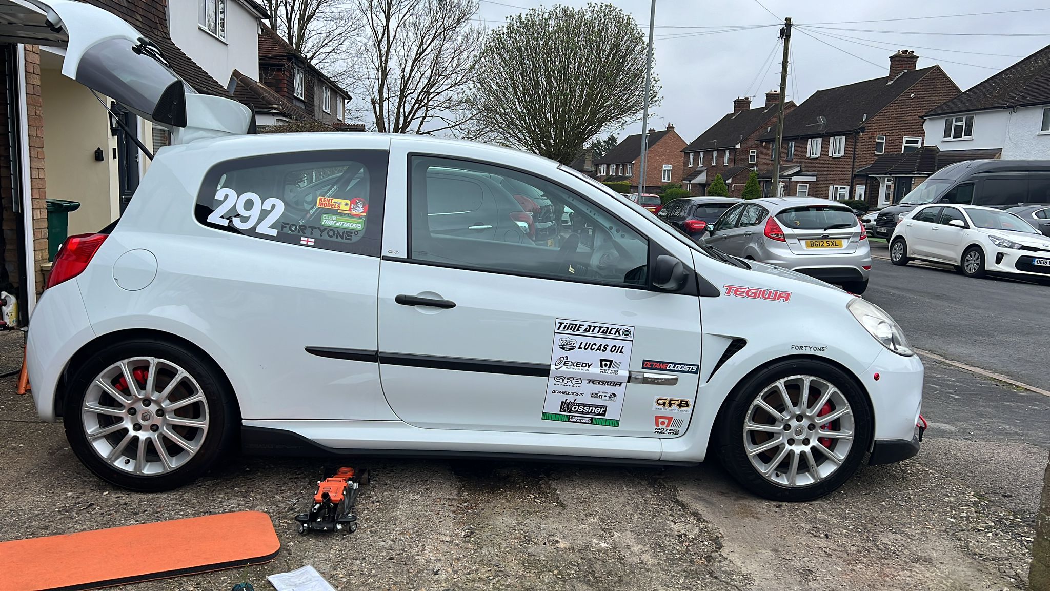

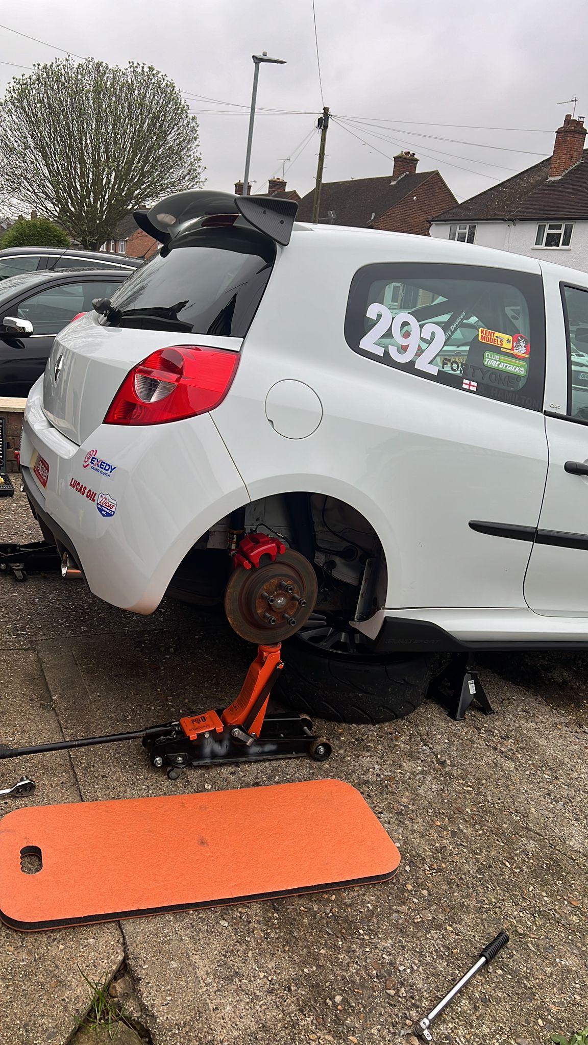

Today's job was changing the rear springs from 4kg to 8kg to get the back end a lot stiffer and let me have a bit more dampening adjustability now which will be handy.
Managed to set it up so I've got some rake in there now, it looks a lot in the photo but front / rear difference is only half an inch in height.

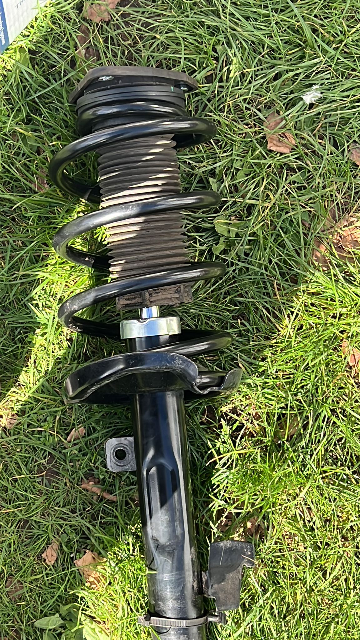

And after having one car's suspension sorted, the daily Kuga needed a new front spring, annoyingly enough it had snapped and we didn't notice on the test drive .. Rip me. Easy change as it has a new strut anyway

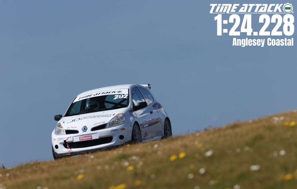

Round one was on the coastal circuit at Anglesey. Started off well getting used to the track again after almost a year since I've driven it, lap times started slow but got better over the day's outings, from a 1:26.3 down to a respectful 1:24.2 in warm up. Thinking it would be a good idea to change the suspension and tyre pressures to something else to try, ended me back up to a 1:26.001 .. not what we wanted! Changed everything back and hit a 1:24.7 in the finals, not bad but could have done way better. This put me 7th out of 8th which wasn't what i wanted.

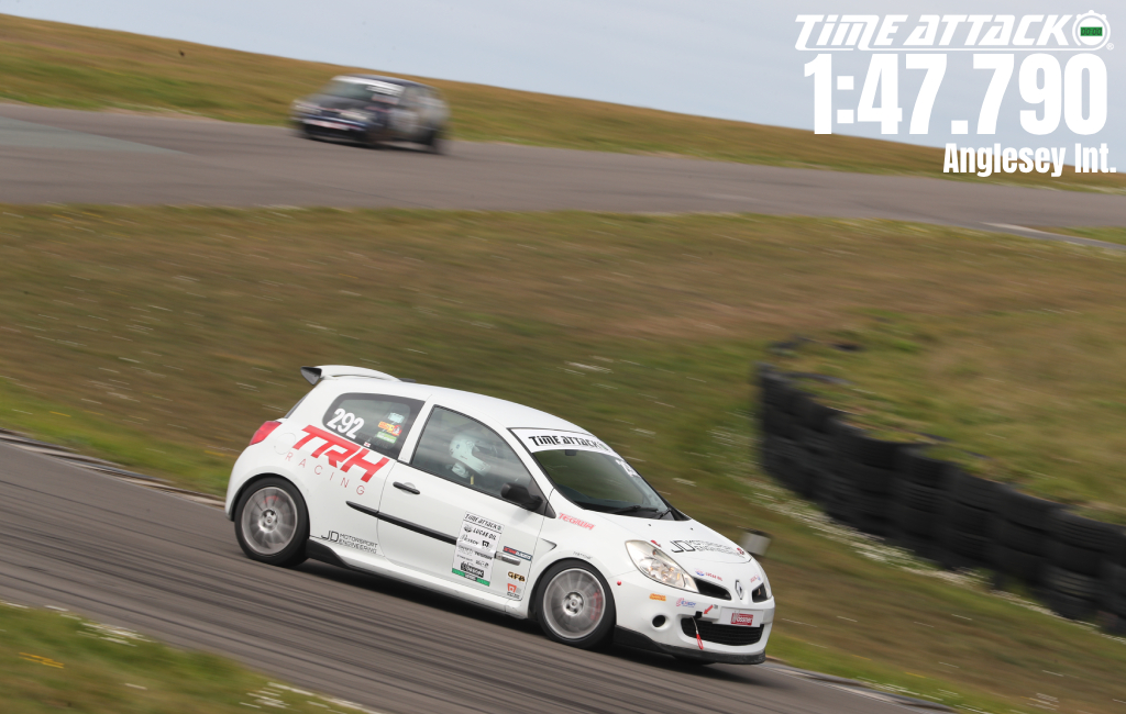

Started off well with a 1:52.5 and dropping way down to a 1:47.7 in the final run, ending up in 5th out of 7, missing out on fourth place by 0.05 seconds ..!!

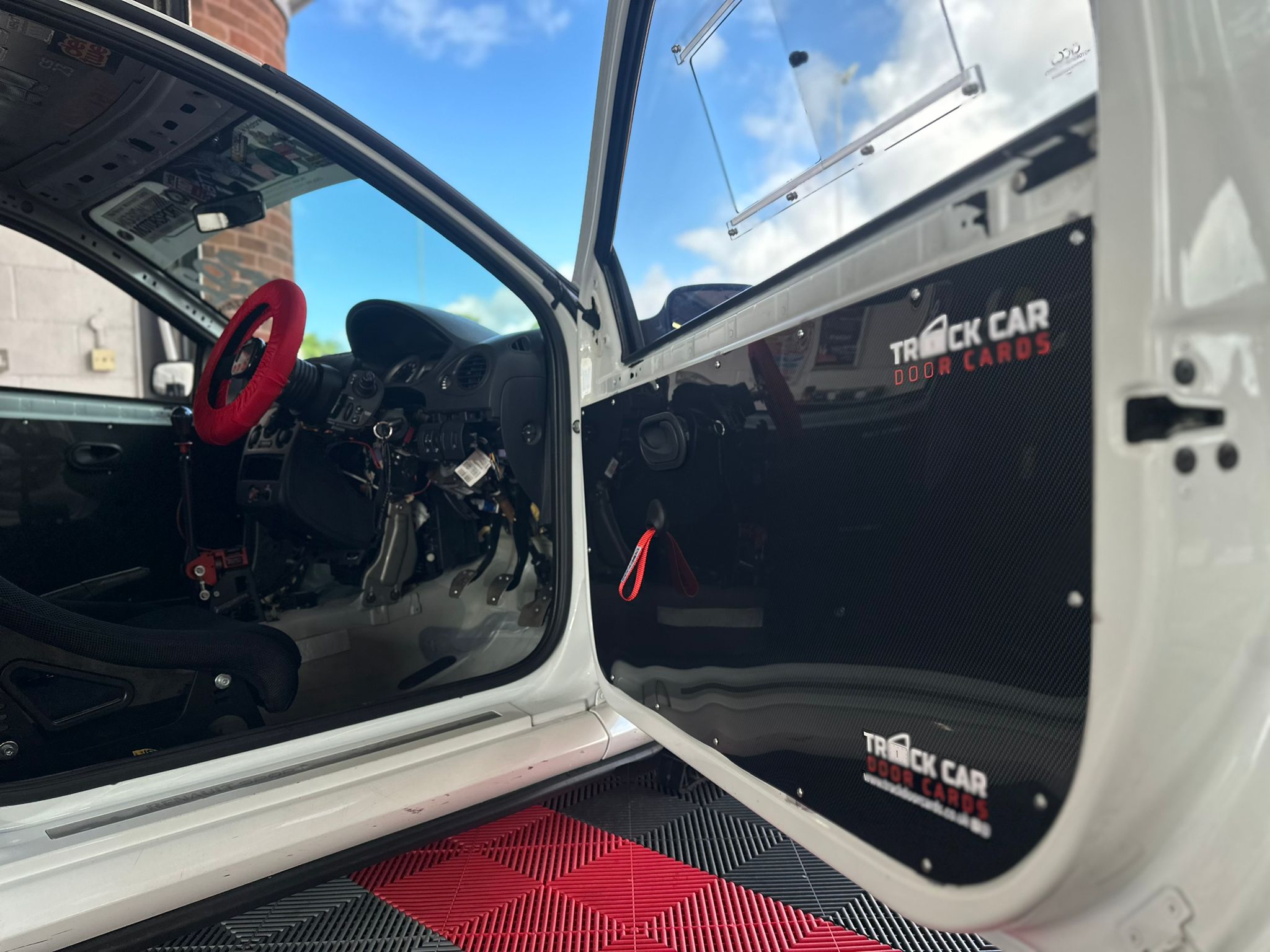

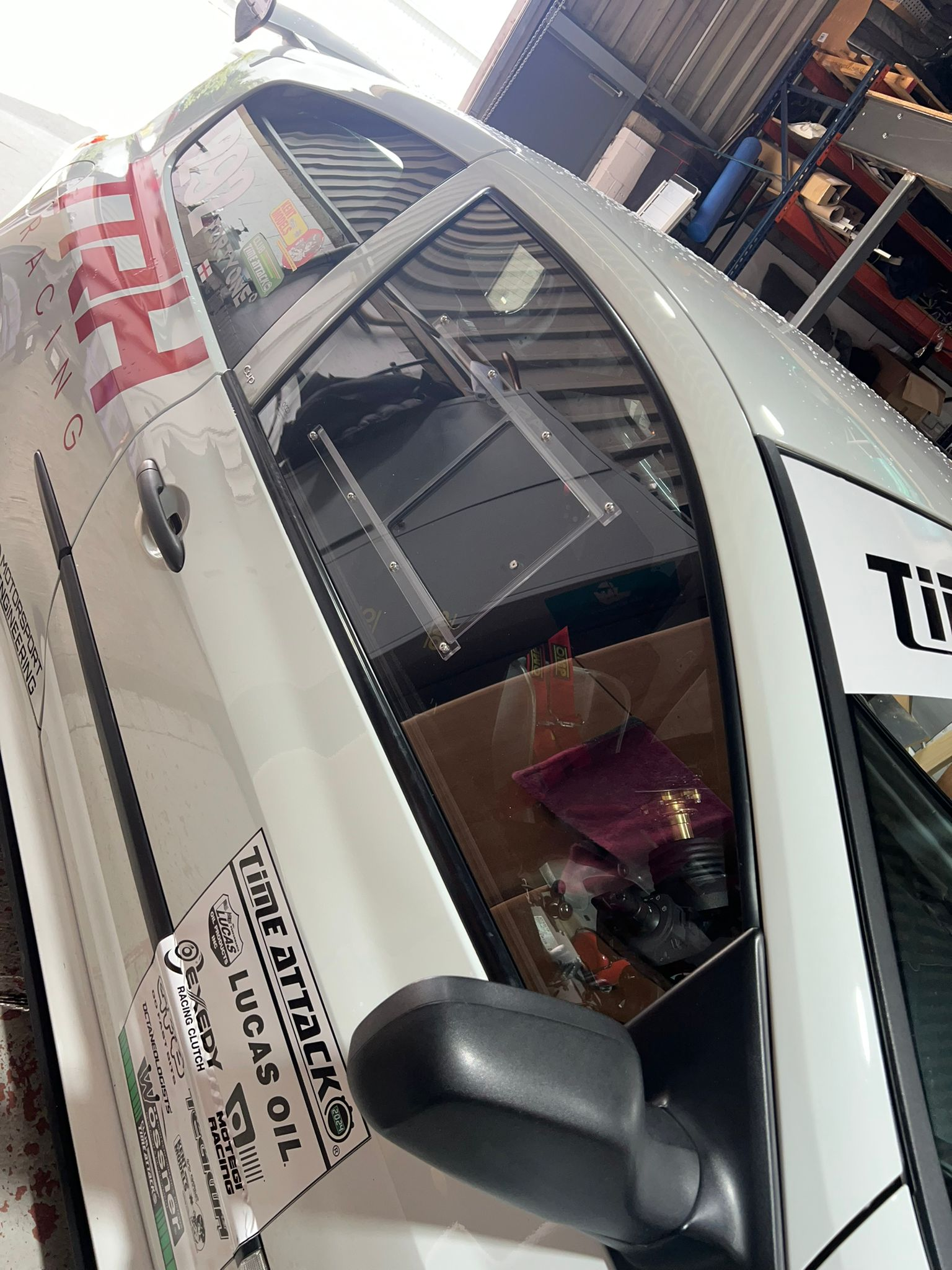

my new poly front windows came through also and got fitted, I have some track door cards arriving hopefully next week and the doors will get shaved down to bare minimum for weight saving .. one week left till round 4 at brands

Track door cards very kindly agree'd to coming on board this year, so i'm not running theirtrack door cards which where a big change from the standard cards, as well as making it look more race cary

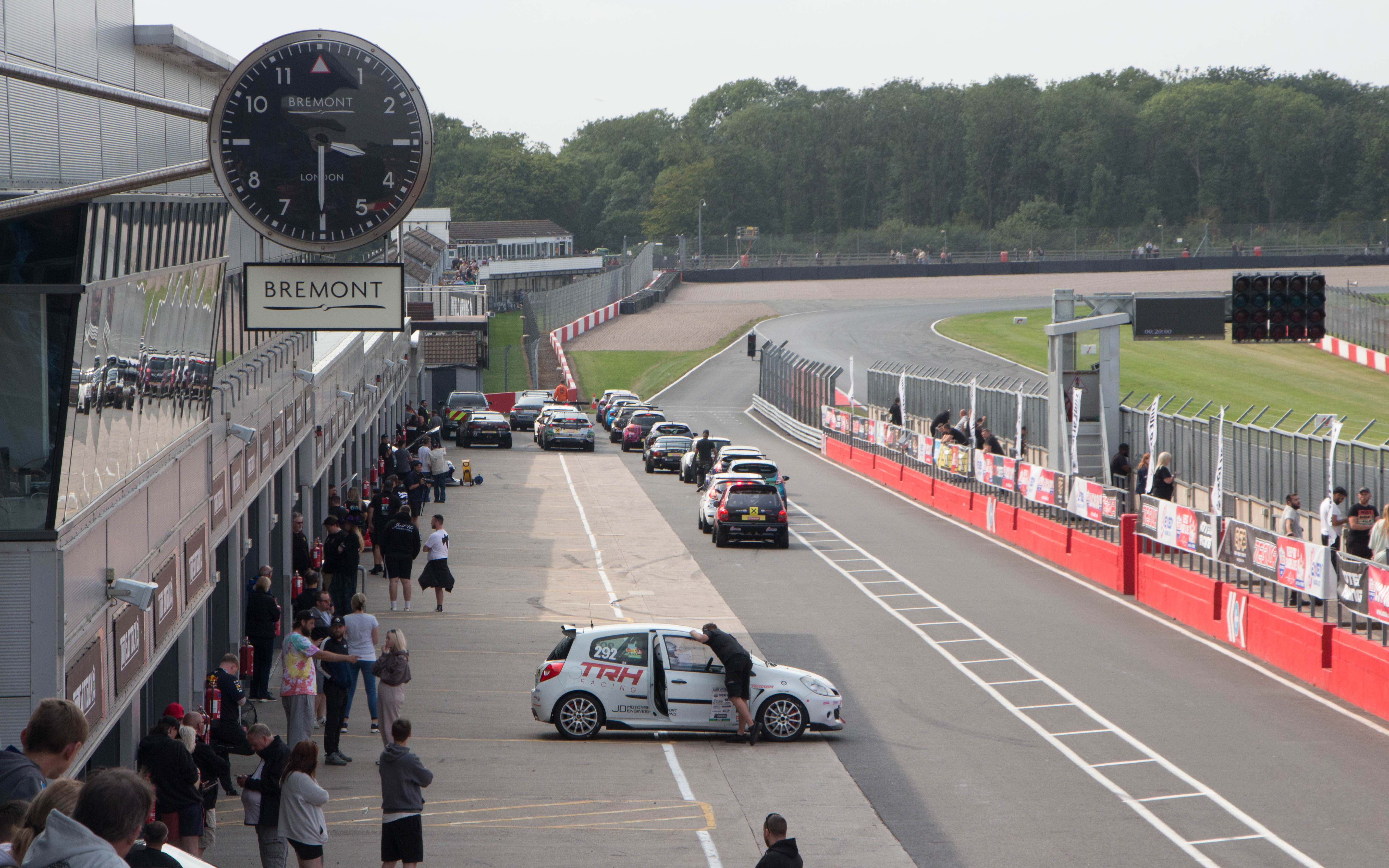

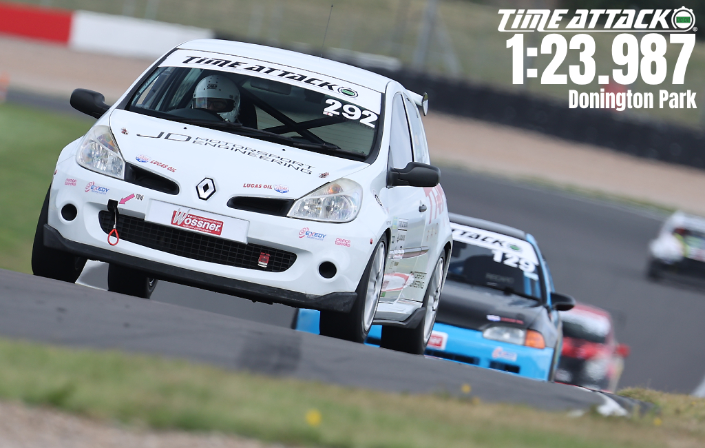

Round 6 - Donington Park. First time having been here, it was another learning curve but nothing I haven’t done before. With the hopefully achievable goal of 1:25, and a dream of 1:23 in mind, we went into it.
Warm up - Straight out, learning the circuit and getting to grips with the car again setting a healthy 1:25.322. A 1:25 being my first goal, this made me super happy already and gave me the drive to go quicker!
Practice - Settling back into the car and feeling good with the track layout, I started pushing a bit more to find a few more limits of the car and circuit which was fun to do. Setting a respectable 1:24.987, so slowly taking the time down to my goal.
Qualifying - With the car set and ready for quali we head out, 4 minutes into the session we got red flagged due to an incident, thankfully the driver was all good. The session got cut down to 10 minutes which meant I had to get a wiggle on. Setting a 1:25.143, which unfortunately was slower than practice due to not managing to find a good space and empty track.
Finals - Went out, ready to make the most out of the final session and get some good times set in, unfortunately there was another incident which meant another red flag. Back in the pits we realised the timer was still running, so time was definitely against us when I went back out. With the last push to be now or never, I had to drive as hard as I could, and in true style I set my fastest lap on the final lap of the finals, hitting a 1:23.987 which was my target for the day.
Huge thanks to @jdmotorsport_engineering for the excellent help as always, couldn’t have done it without out them.

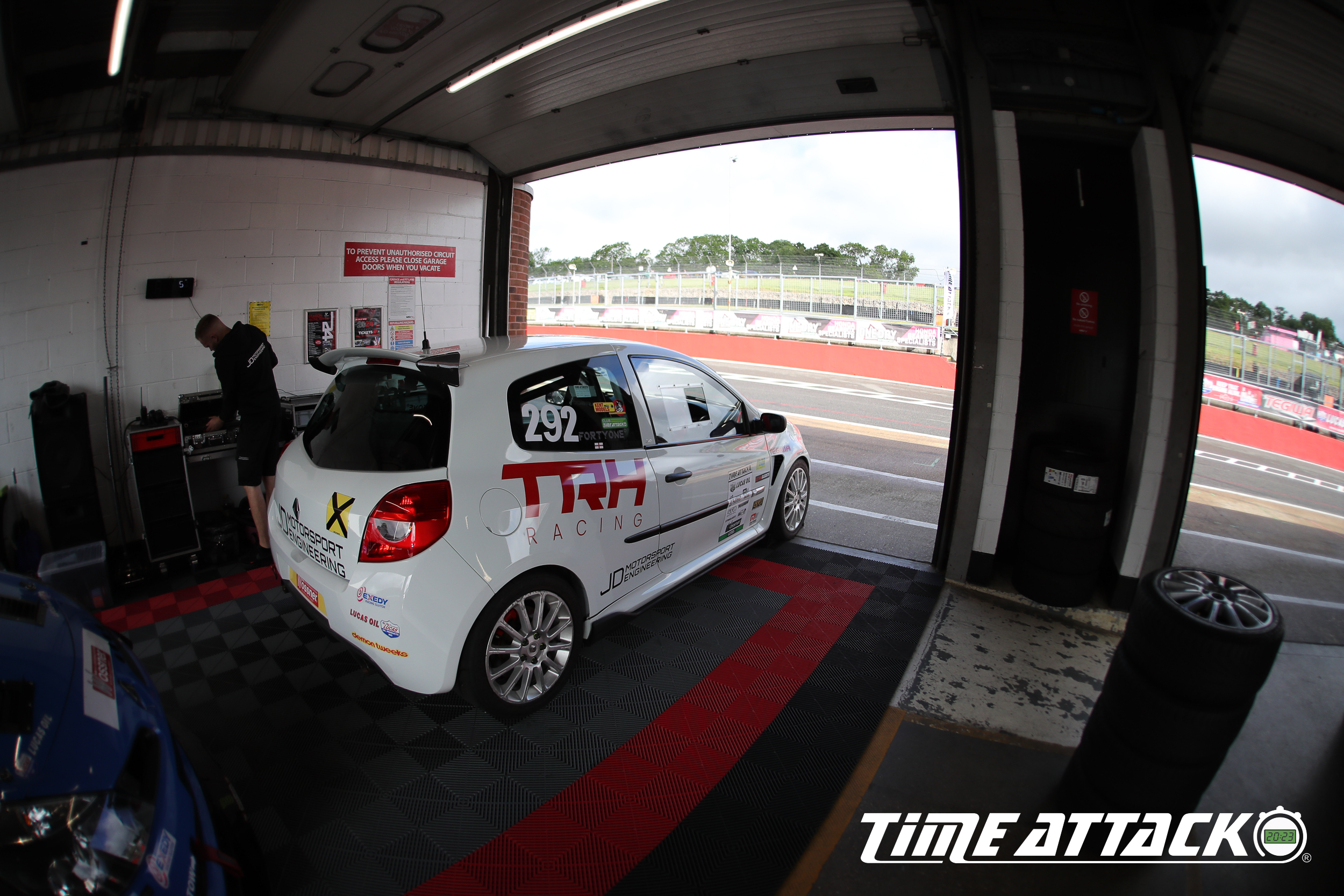

Brands Hatch round 7 - let’s get it

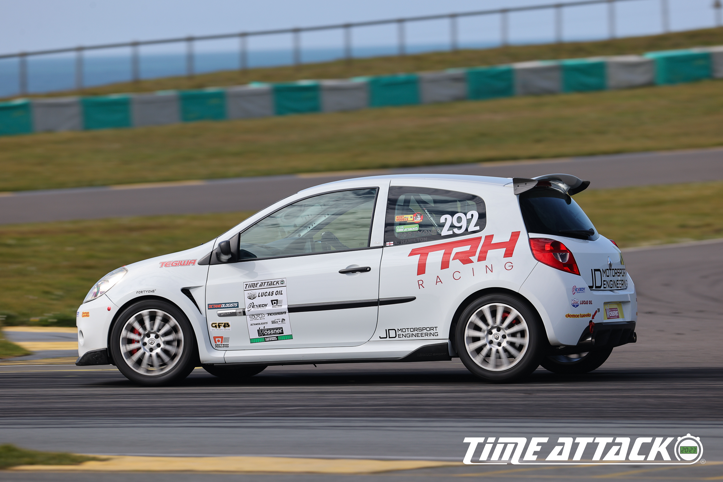

Brands Hatch round 7 of Time Attack UK must have been my best round so far.

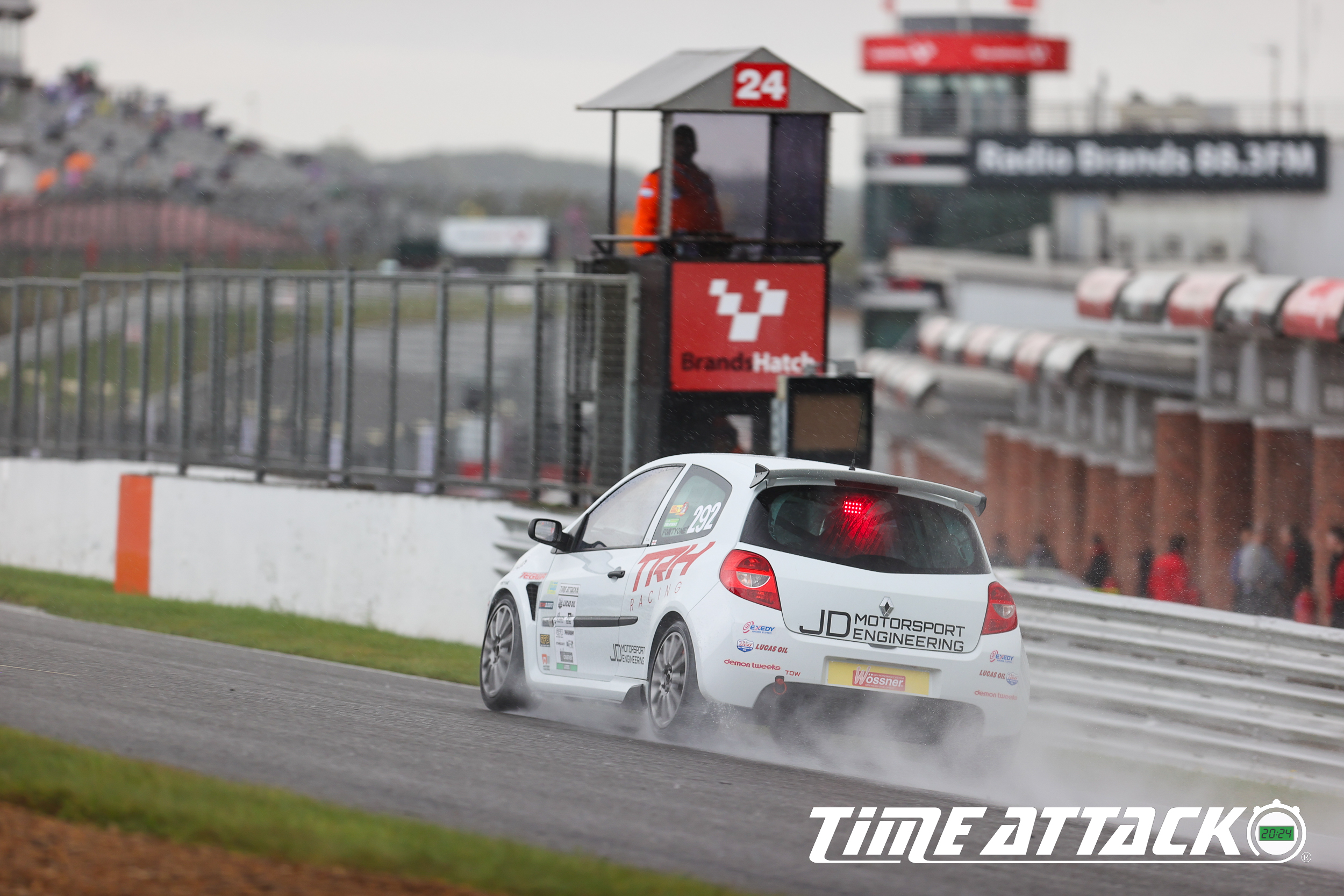

Practice - With practice just around the corner the heavens opened, being the first time I’ve driven in the wet in years I was extremely nervous but very confident in my ability to be able to drive my best in what seemed to be a torrential downpour. Setting a 1:04.504 putting us third place, showed I had the capability to drive fast in the wet also.
Qualifying - With the rain still present and feeling confident with driving in the wet, I went out and pushed even more having quickly learnt a new line of a very wet circuit. Setting a 1:04.338 which put me 4th in qualifying which is the highest I’ve qualified so far, and being in the wet made me SUPER happy.
Finals - The finals ended up drying out and becoming a perfect circuit for some fast laps, having driven the day more in the wet I was confident I could keep pushing hard with knowing more limits of the car from the first few sessions to push into the finals, setting a 56.454 which put me in 6th place over all.
Extremely happy with how the day went, car was faultless and the guys at JD motorsport engineering did a fantastic job with looking after the car and it’s set up!

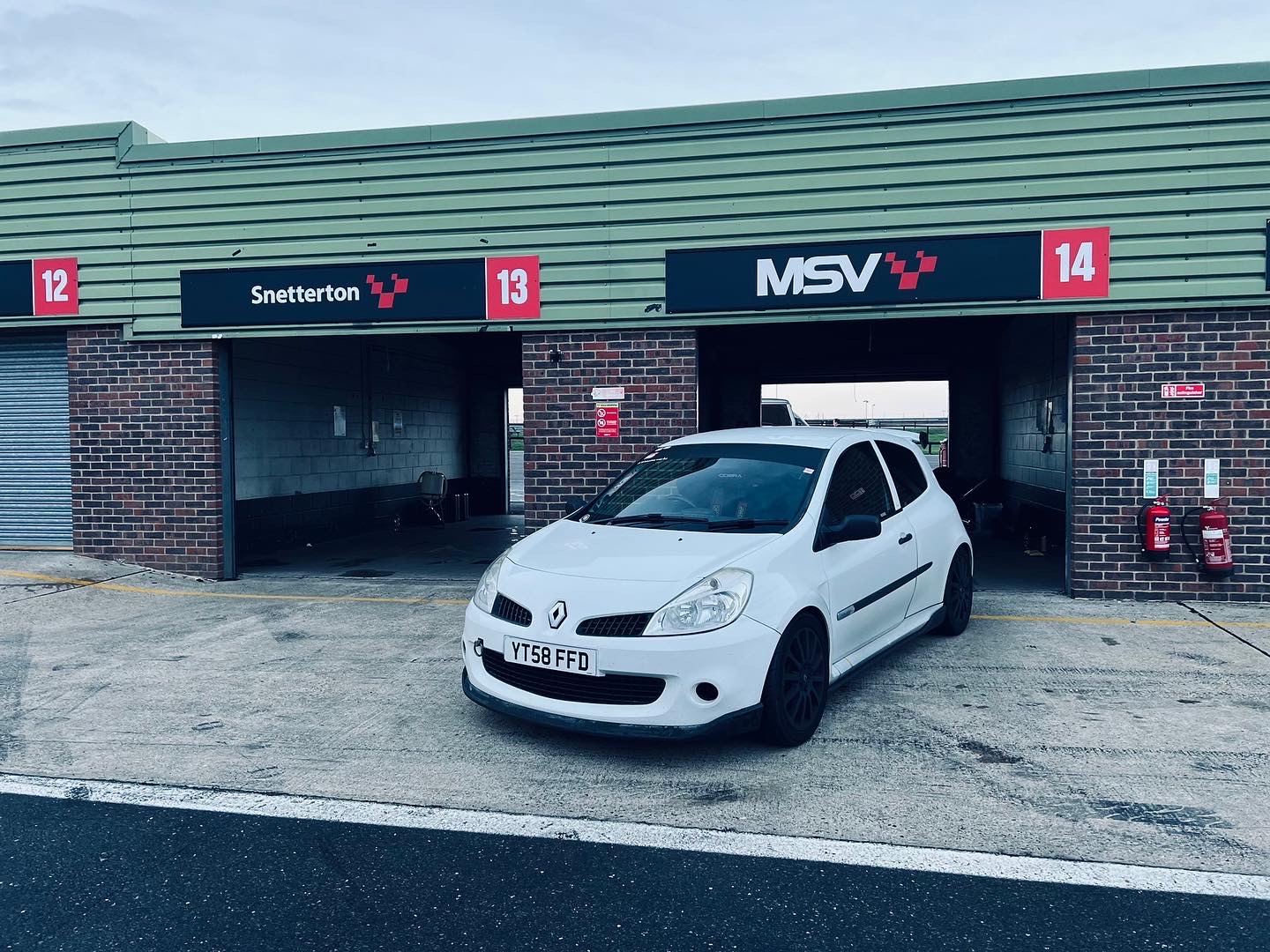

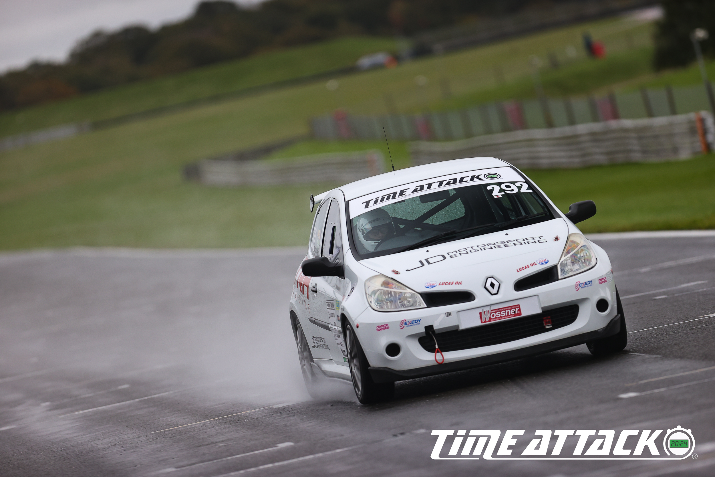

Round 8 of Time Attack Championship held at Snetterton 200 was a tough but good day. A very greasy, wet and puddle filled day made for some good driving experiences!
Warm up - Warm up ended up being super greasy first thing, so we opted for the AR1’s as our choice of tyre to start with, due to it not being standing water. I headed out and set some good lap times, learning the circuit and conditions again. Going sideways through bomb hole as I passed Anthony Mann wasn’t part of the plan, but I worked it to my advantage to keep finding the limits and improving my car control. Setting a 1:40.381 in the greasy conditions was a good start.
Practice - With the rain inbound, we headed into a wet practice. With experience from Brands Hatch still in my mind, I went out and got to grips with a wetter circuit with the wet tyres on and a new suspension set up to test. With one red flag giving us a good break to have a chat and discuss the car before heading back out, I set a respectable 1:41.455 which I was happy with to start pushing into with the wet weather continuing.
Qualifying - As the wet weather was set to continue, it was time to get a wiggle on. With a fight for 5th taking place between me and Wilko, I had to push on to stay ahead of him throughout the next two sessions. Setting a 1:40.620 putting me in 5th over all was a great motivator for the finals.
Finals - The heavens opened shortly before the final session, making it the wettest it had been all day. With the car set up to suit the conditions we were ready to go for it. Managed to set some good times but unfortunately with 4 minutes left of the session it was red flagged due to a mechanical issue from one of the other competitors, the race was over. Putting in a 1:41.430 with set me 7th over all in the finals.
Having finished up the day, the results put us in 6th overall in the championship and only a couple of points from 5th. It was a good but hard push and we barely missed out on points but proud to have finished this far up in our first season being competitive.

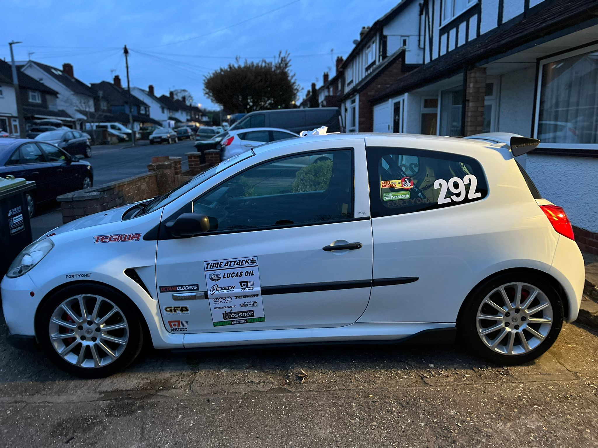

Bit of an update. Life got in the way, cars sat since November 2024 after a time attack end of season track day, got parked up and just collected its own habitat.
I moved out October last year and finally got the car home, bit of work to do but I think it’s time to get back on track.
