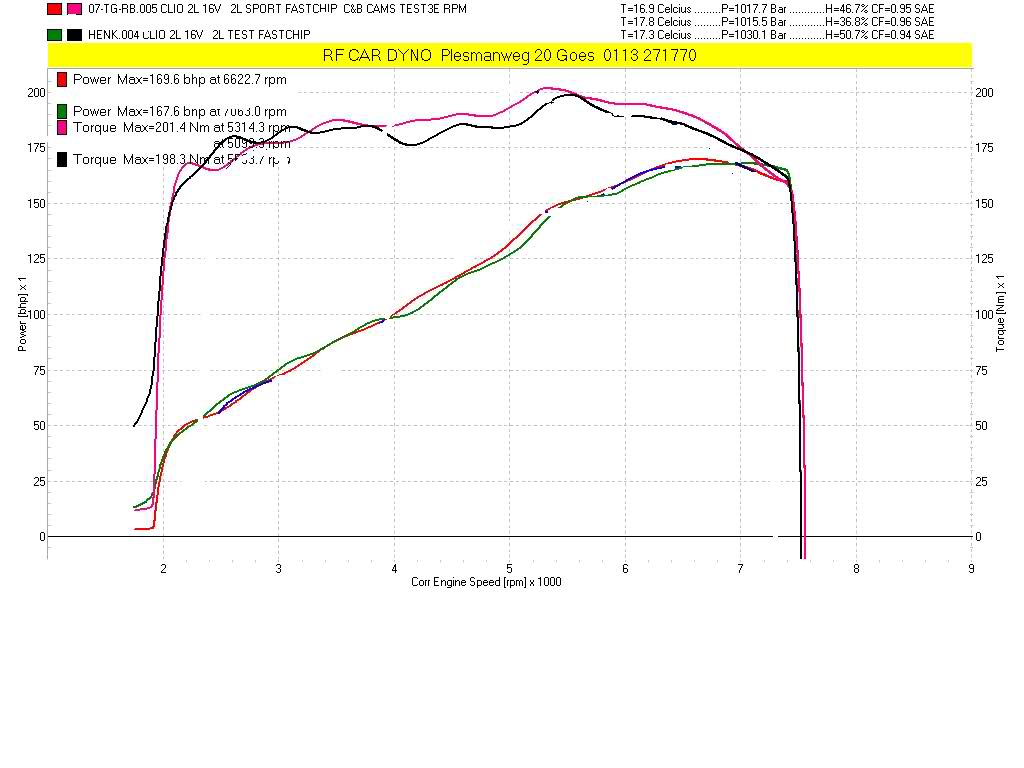

RR figures are from 1 of the most accurate wheel dynos there is. Why ?
Because it uses 1 big inertia roll of 440 kg/m2 and the simple Newton law of motion formula F=ma. No other fancy software algorithms and tyre crushing too small rollers. Plain & Simple.
Figures are SAE corrected @ wheels and off course everyone calculates flywheel figures differently.
What matters here is, that a Clio2 C&B pumps out equal/more power and torque than a stock 197.
In such a lightweight chassis as the Clio2 that is a lot of fun ;)
Also note that the 197 holds a little longer > 7k rpm but the 172 has the better overall torque figures(!)
Car Facts
Clio 3 197
- No mods , 167.6 BHP SAE corrected @ wheels
Clio 2 Cup Phase 2
- 169.6 BHP SAE corrected @ wheels
- C&B cams
- RSTuner remap
- 182 Manifold
- decat
- Matched inlets
- V6 Airbox
- 1 proud owner
Please note:
Had to take 1 power / torque curve out of the sheet due to a false measurement.
Many thanks to Frank for making his car available on such short notice.

Still amazes me Henk.. They're almost identical indeed!
If you loose around 300+ kilograms MAYBE your fat 197 (beautifull car btw) will keep up with my 950kg Cup someday ;)

167 at the wheels for the 197! is that completely stock ie no map?

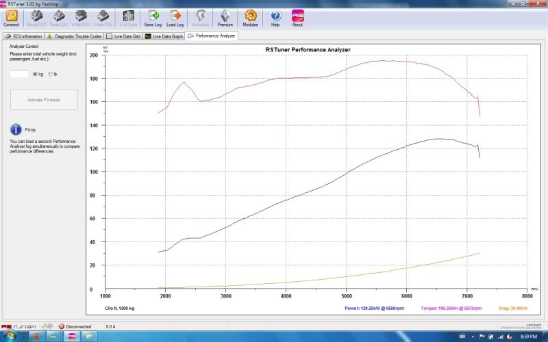

mine made 158 at the wheels and estimated 188 at the fly on TDF's rollers
what is your rough estimate for that 197 at the fly?
  197
That is with my RON95 map. SAE corrected.
DIN corrected it was 174 @ wheels on that particular day.
200 DIN PS
One car to the other makes a difference. There are weaker and stronger 197/200 than mine out there.
