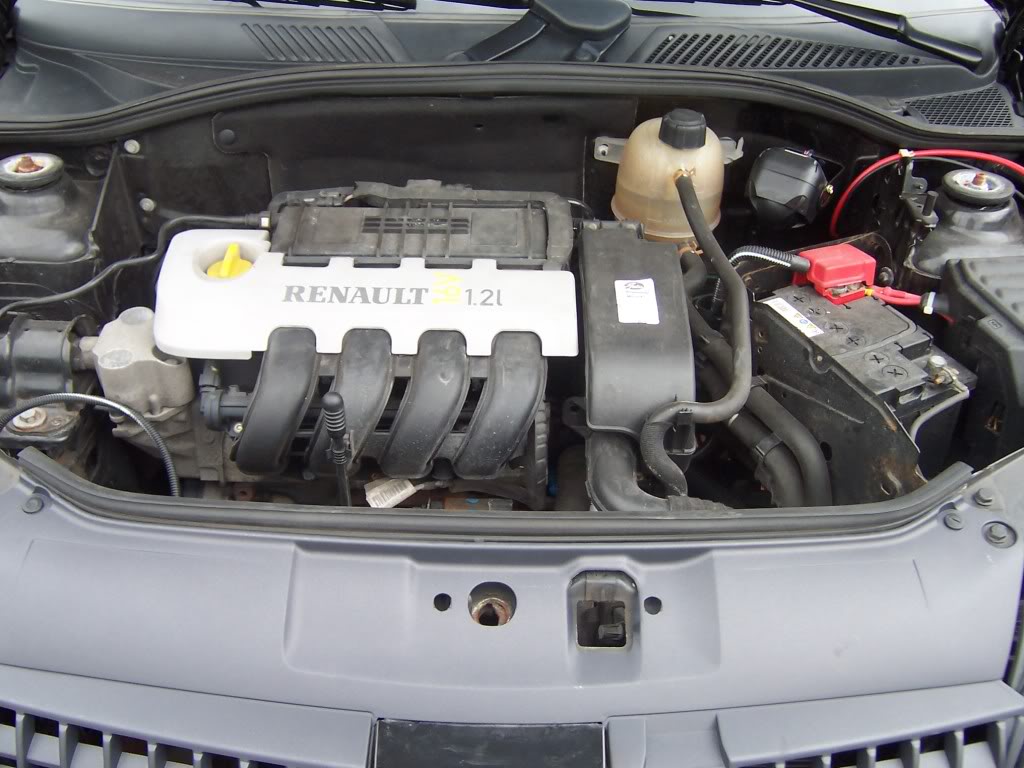

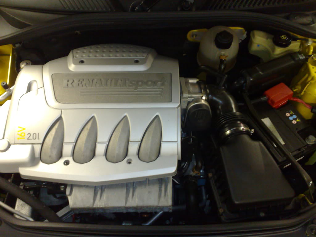

header tank on 1*2 and 1.2 are in the same place though iirc!! its the brake fluid resiviour we need to move im sure! :) not any others!
sorry riley went off to bed last night lol,
here are the two pics to compare :)
1.2
and sport
With this body loom i have no idea, surely it just connects to everything inside then into Ecu just like a normal, wouldnt see any reason why it would tho,
Who are the company in germany fella ? if its fastchip then fine as iv heard good stuff about Henk etc.
I wanted the pic on 1.2 to see brake res but cant see it in that pic lol. As for the sport, you do realise its the p/s fluid res next to header tank . . .

^^ thats what I thought, thats why I wanted pics. Im thinking he must be getting confused with p/s res
sorry riley, ye the big block on the bottom right with loads ov pipes is the brake resevoir:o my bad, i was talkin about the Brake fluid pot thats currently on the left hand side on a 1.2,
are you talking left looking at it or left as in sat in car. Talk to me in offside and nearside . . .
Haha sorry fella,
i mean from outside as you look into the car, but ye big block is on the nearside but the brake fluid pot is on the offside, so really can i just move it slightly higher from were its at now, or would i need to move it?
