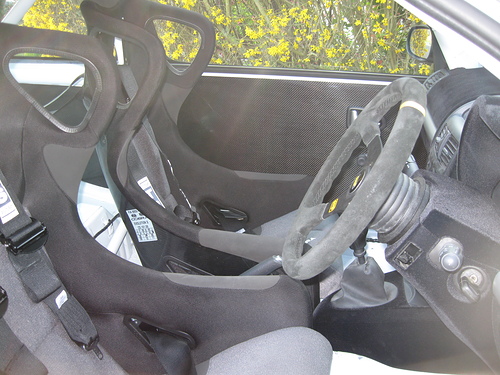

Pauls supercharged car has some in it.
Are these the same as the sabelt buckets in the R26.R??
nope, they are different in the cup racers.
R26R
They go in without too much of a struggle on the standard X85 Clio fitting kit. As said above Paul has them in the 172 Kompressor.

M8EDJ: This is for the Sabelt Race Seat as pictured above, the seat is available in Standard and XL
7711160192 Clio III X/L Seat was £321.20 (no idea what the price is now)
I think that £919 for two seats isn't too bad when compared to prices for Cobra Evolution/Sebring

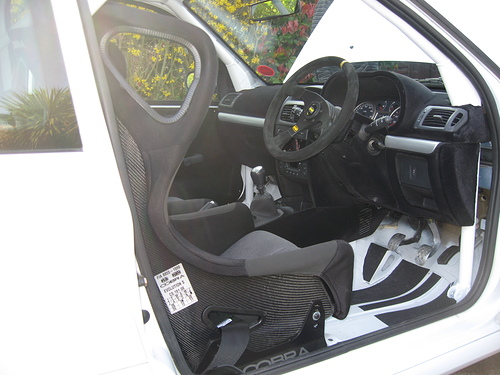

i had Cobra Evolutions in my old 172.

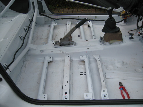

best way to mount them is with a seat bar kit.
i got mine from Custom Cages (were £50 +vat per side)
Allows you to mount the seat alot lower.
and seat rails:
Thanks FMP for the photos, looks great. I assume with the seat bar kit you have to decide exactly where you want the seats before fitting them in? Or do you use sliding subframes?
