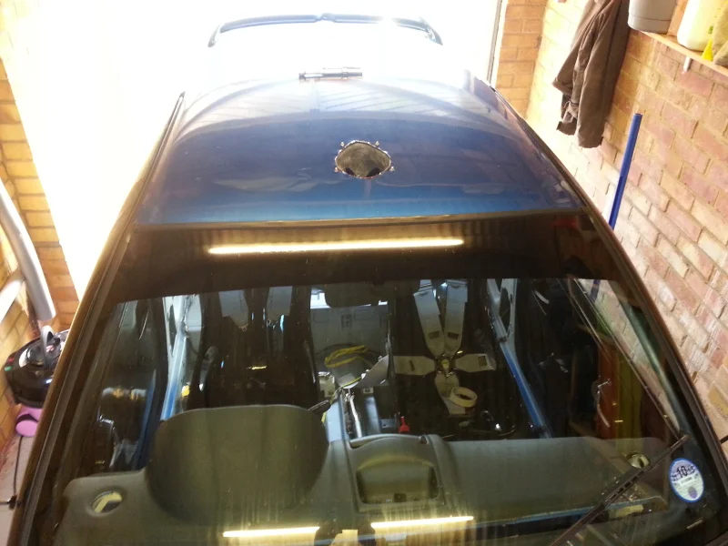

After clocking 43 degrees the other week in the track car...I decided a roof scoop would be a good place to start!

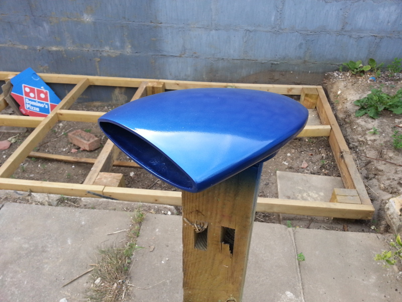

I decided on a cup racer style scoop from Chris @ CMComposites. Never used Chris before but will be using him again, good price, rapid delivery and the scoop is perfect. Cheers Chris.

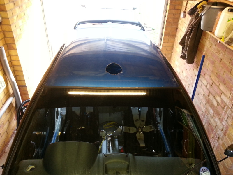

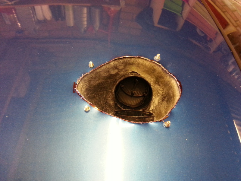

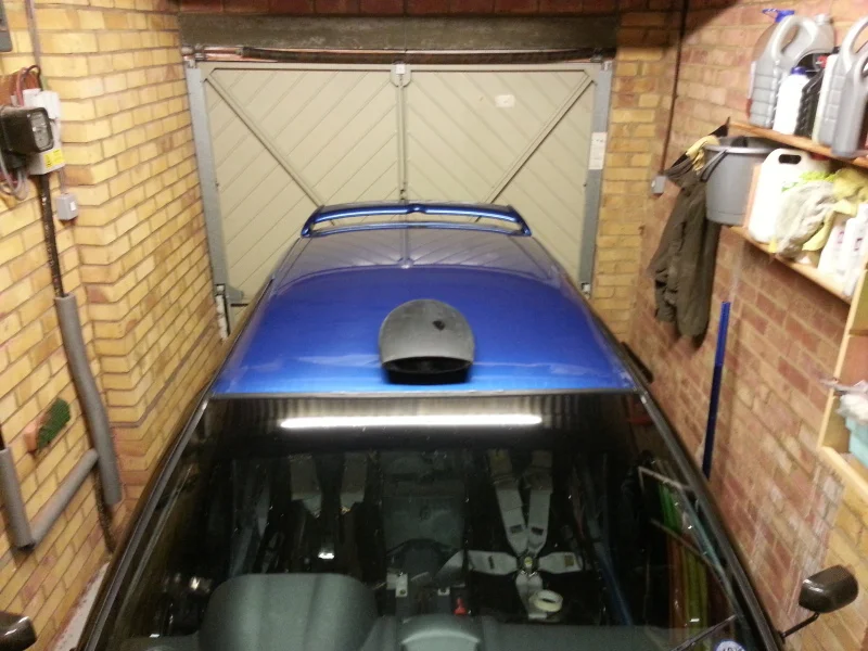

I had a can of Mondial Blue in the garage so I sprayed it up before I fitted it. I made the hole with aviator snips and then straightened the edges with a clamp before sealing the exposed edges and fitting up. All just in time for Brands on Thursday.

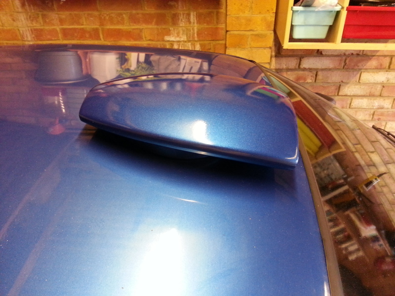

test fitted
no turning back now!
sprayed blue
all smoothed out

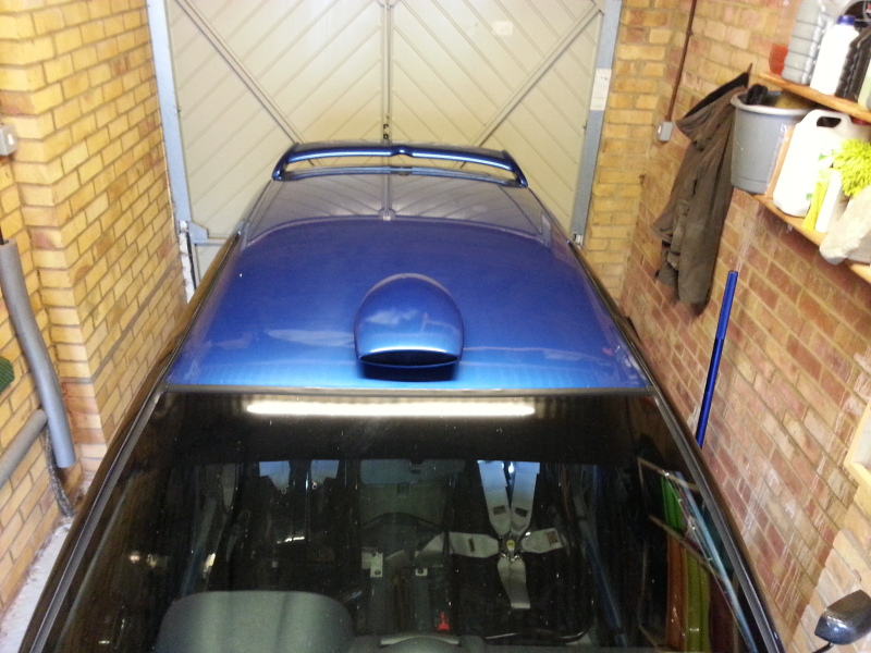

job done

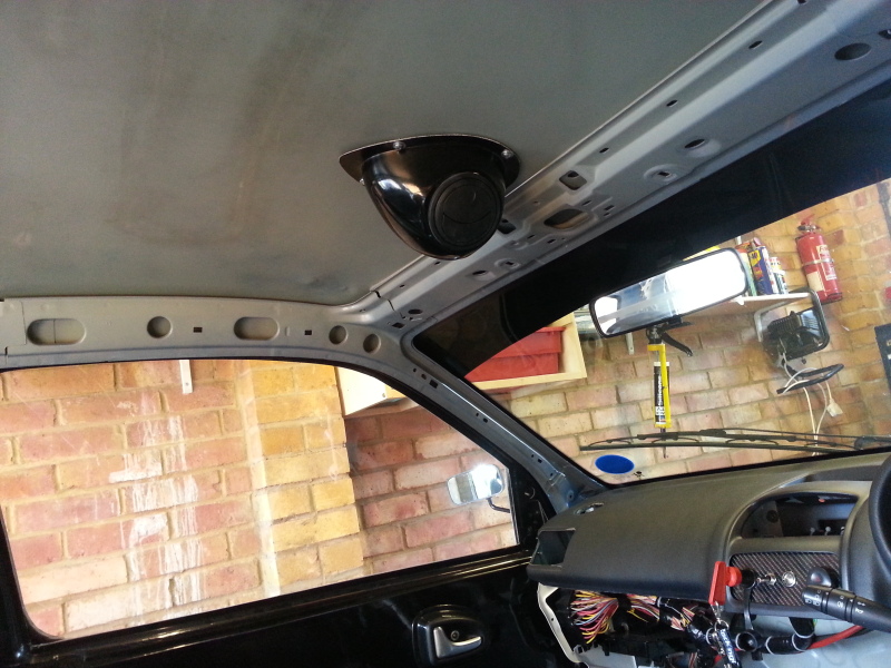

Looks great that and now on my shopping list as have needed one for a while. Quick question - one of the photos has the vent bolted to the underside of the roof, how does the scoop then fix to the roof?

I just bolted the inside section to the roof to keep any crap from falling through into the cabin. The scoop comes with 4 bolts and washers. The scoop has 4 nuts mounted into the base so you just mount the inside section and run the bolts through to the scoop and tighten...couldn't be simpler.

Tony, I used some generic sealant (car variety).
The best way to fit it, is to use a hole punch (that thing that marks points to stop the drill bit slipping) with the inside part on the roof, then just draw round it with a marker to get the outline, then draw a reduced outline and get cutting.
I can happily report that during the evening stint at Brands in the baking sun, the vent did an excellent job of keeping the cabin bearable!
