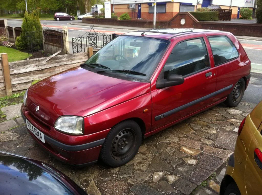

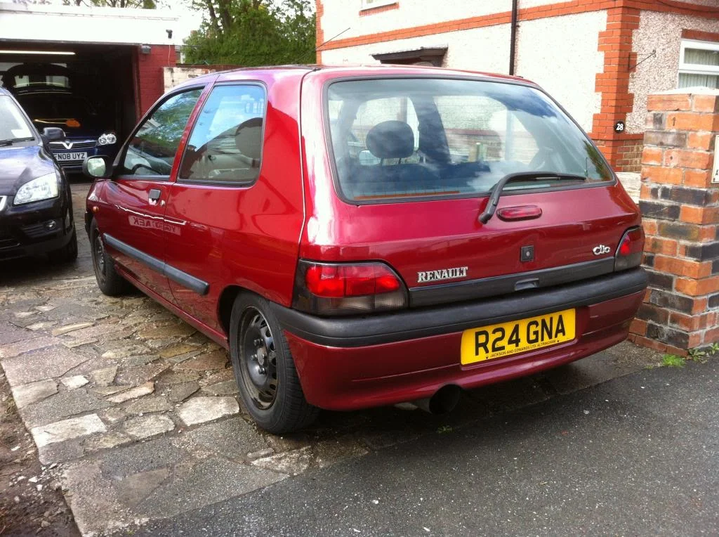

Some pictures of when i first got it, it was very dirty. :/ Washed it and hoovered inside. :
Before cleaning, LOL bits of chesse under the seat. ewwwwww
After

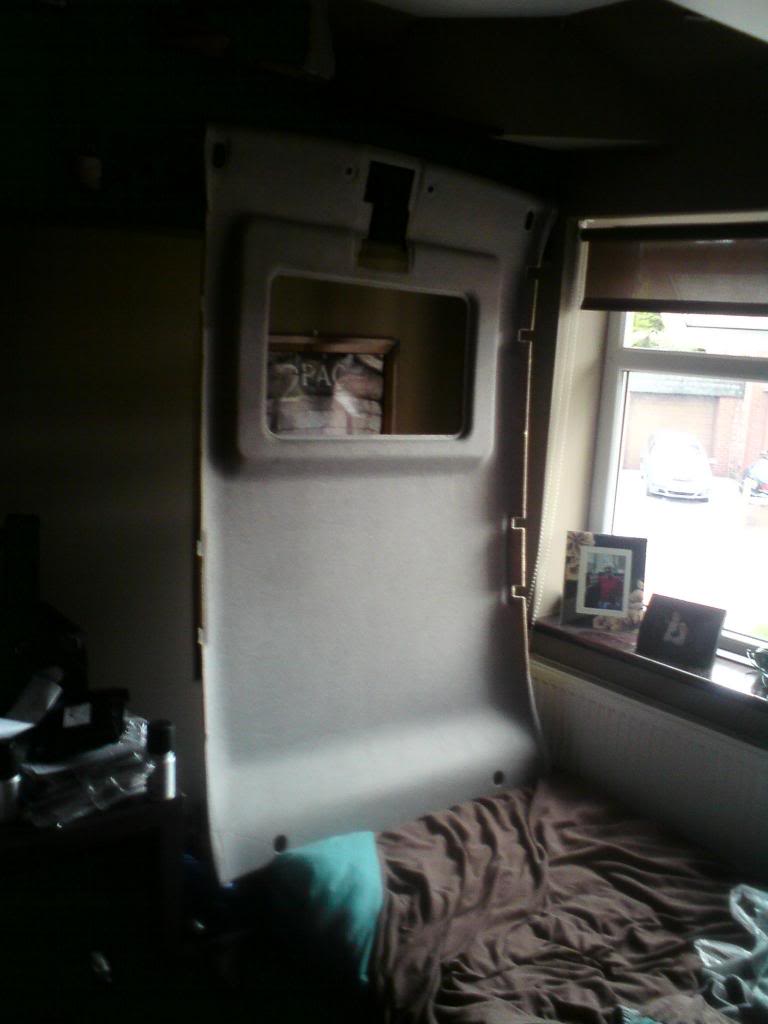

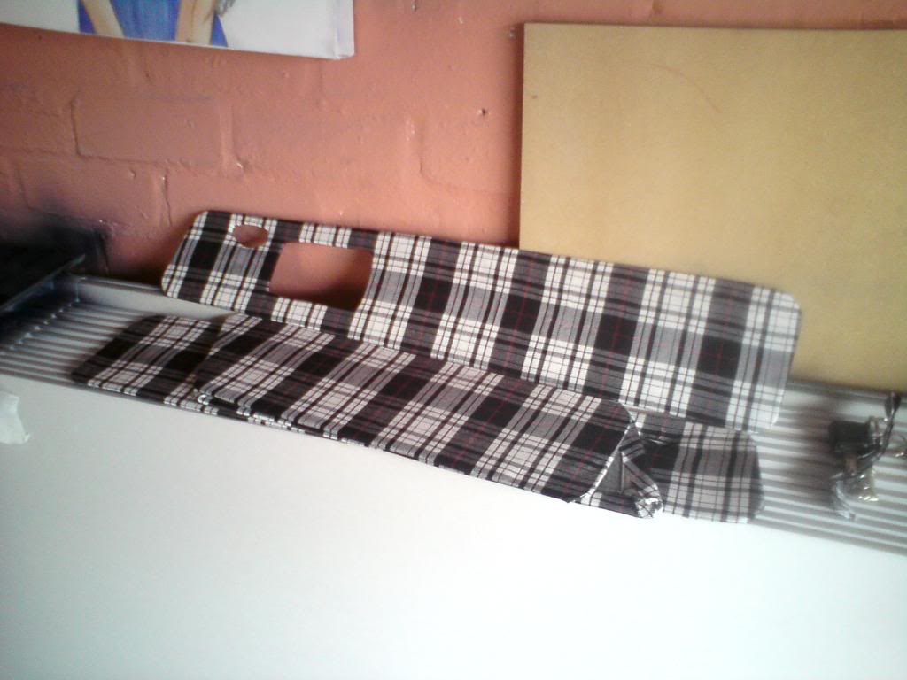

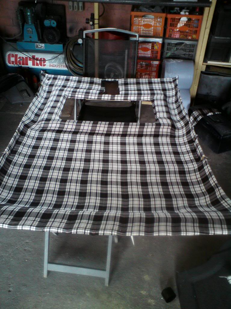

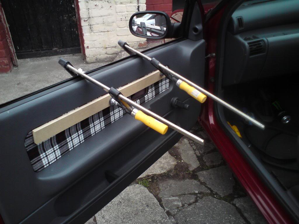

I always liked custom roof linings so I headed to a nearby shop with materials and picked up about 5metres of material of my choice.

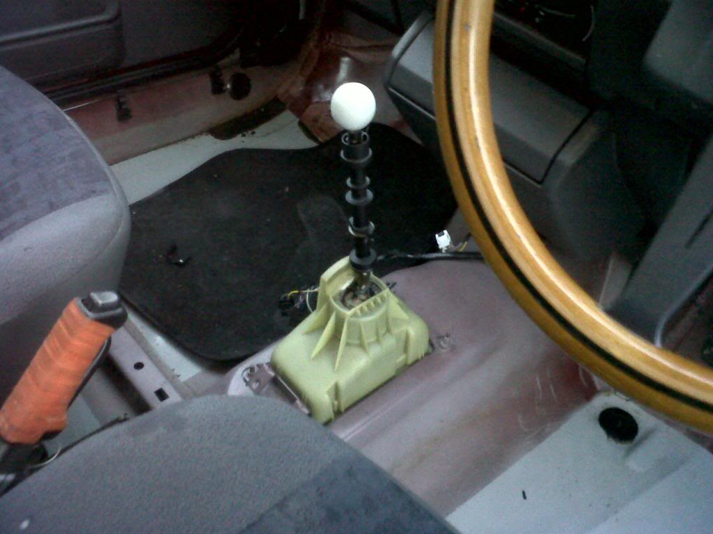

Other thing I'v done is I put on my Nardi Torino I had laying around in my room.

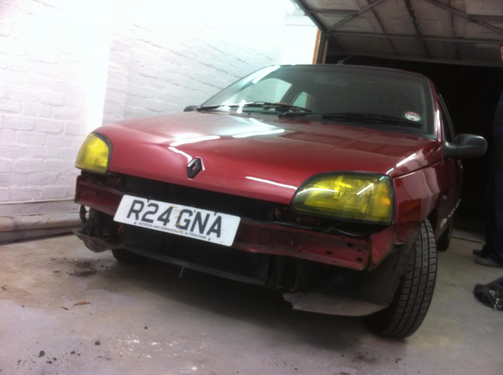

other thing I'v done is sprayed my headlights inside black and then decided to put yellow vinyl on top. I think it
gives it that nice retro look.

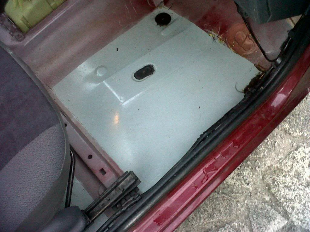

Stripped most of the rear, included removed sound deadening. (Saved approximately 35kg).

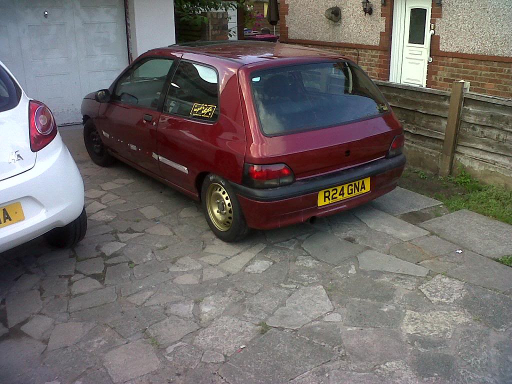

Thanks for the answer rctempire (Y) ! Here are some current photos of the clio. I had it on the road for 3-4 weeks, and I'v done roughly 1500 miles. I'm liking it, faultless.
All I'v done since last update is probably black vinyl on door pillars. With the vinyl, the red part of door pillar isnt all in your face. Don't know how to explain it, just looks smoother I guess.

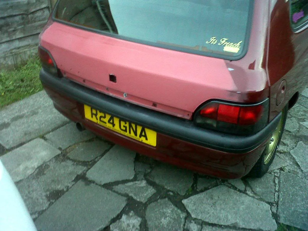

Little update: De-camo'd boot and welded up the center brake hole and wiper. Fibre glass over and primered for now. Will start smoothing and applying normal body filler for final finish tomorrow. Also here are some pictures of how I want to mount my spoiler. I know it's probably not y'all cup of tea. But I'm quite a fan of the JDM scene too and this is done quite commonly on EK civic's. Here are some pictures just
testing with tape while the spoiler is still in primer. :)

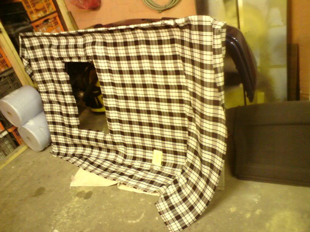

Like what you have done with the roof liner and door fabrics, Nice unique touch. How did you go about doing it, quite interested in giving it a go on my car.
Hey there mate, thanks! But tbf, right now I wish I chose a different material that I was thinking of using. Same style but different colors. And all I did is I went to a massive shop with fabrics that my sister showed me. I bought about 5 meters of fabric. (20 quid). I bought so much because I was thinking of doing the inside of seats too. On the way back I went to Dunelm's I picked up a can of "spray fabric adhesive" (about £6.50) ( btw I ended up having to buy a 2nd can since 1 wasnt enough for door cards, roof lining). Then at home i cut the material to the size of the part, but at the same leaving some excess. And I sprayed the adhesive on the middle of the fabric. Alligned it, and using a squegee I was removing the creases as I go along. So basically, middle attached. moving over to the left. Sprayed adhesive on part. With left hand applying pressure to material while with right removing the creases with the squegee. Then at the end I flipped the part over and pulled on the edges of material and used the same spray glue to attach them. Pretty much the same thing with roof lining. Just had to cut out some holes for the sunroof, immobiliser etc. At the end I re applied the roof lining and door cards using a bit of "SIKAFLEX". Put clamps on for a bit. Then left to dry for a few hours. Sorry for a long paragraph ! But thought I'll try give you as much details as I could!
Some pictures for ya:

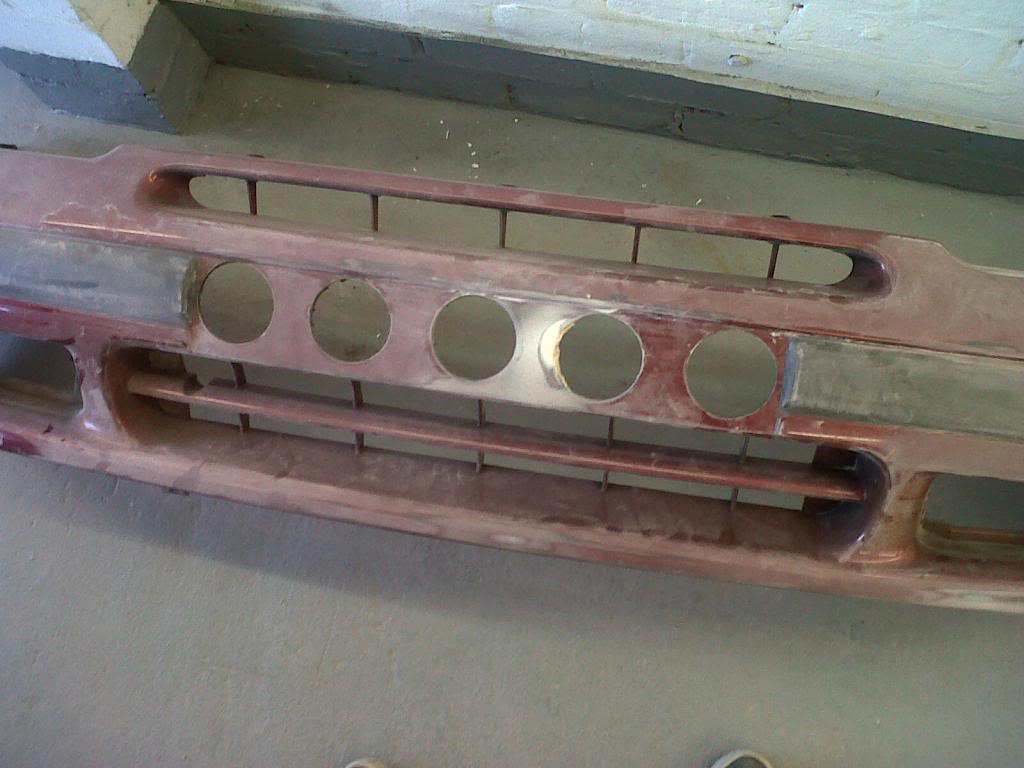

Boot nearly done, right now in primer. :)

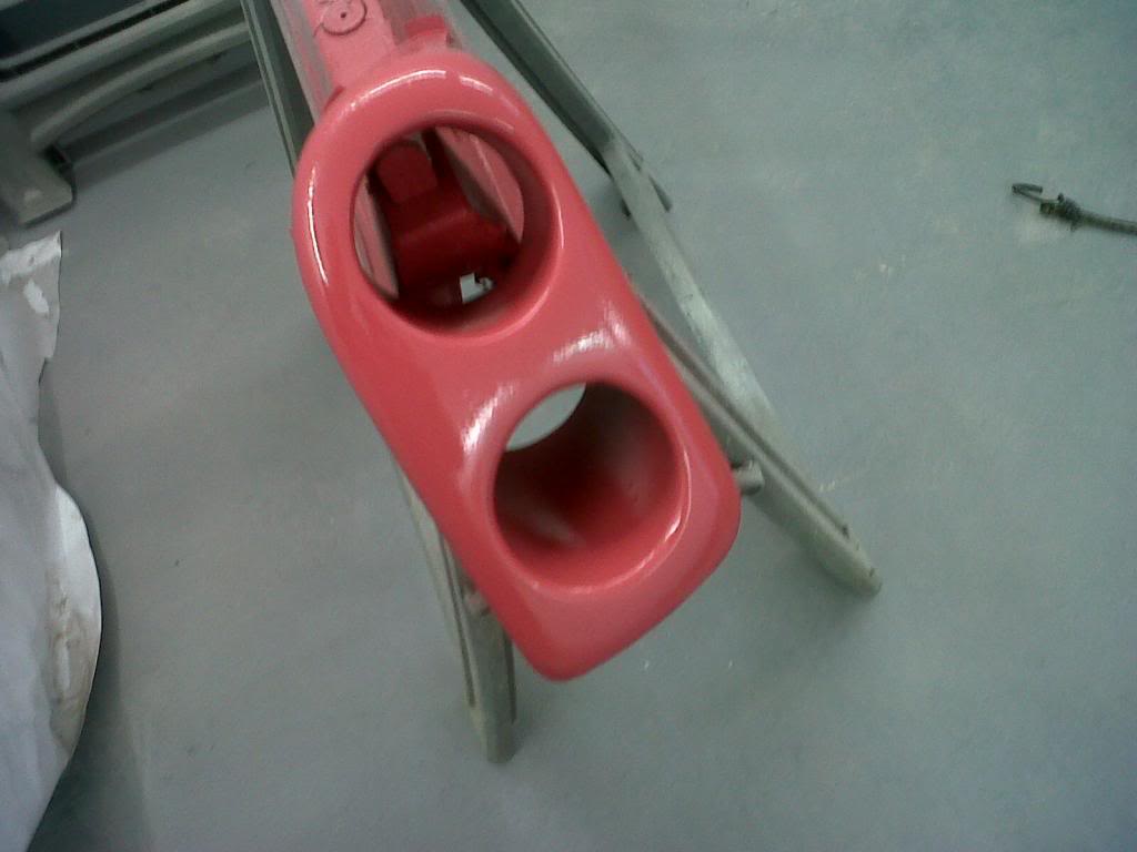

Air ducts reworked a bit and in primer as well

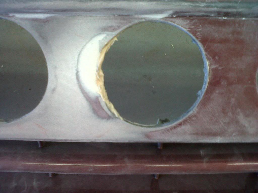

The little hole that's in the bumper originally got fibre glassed and filled so that all the new holes match nicely and dont hurt the eye. (Not done yet)

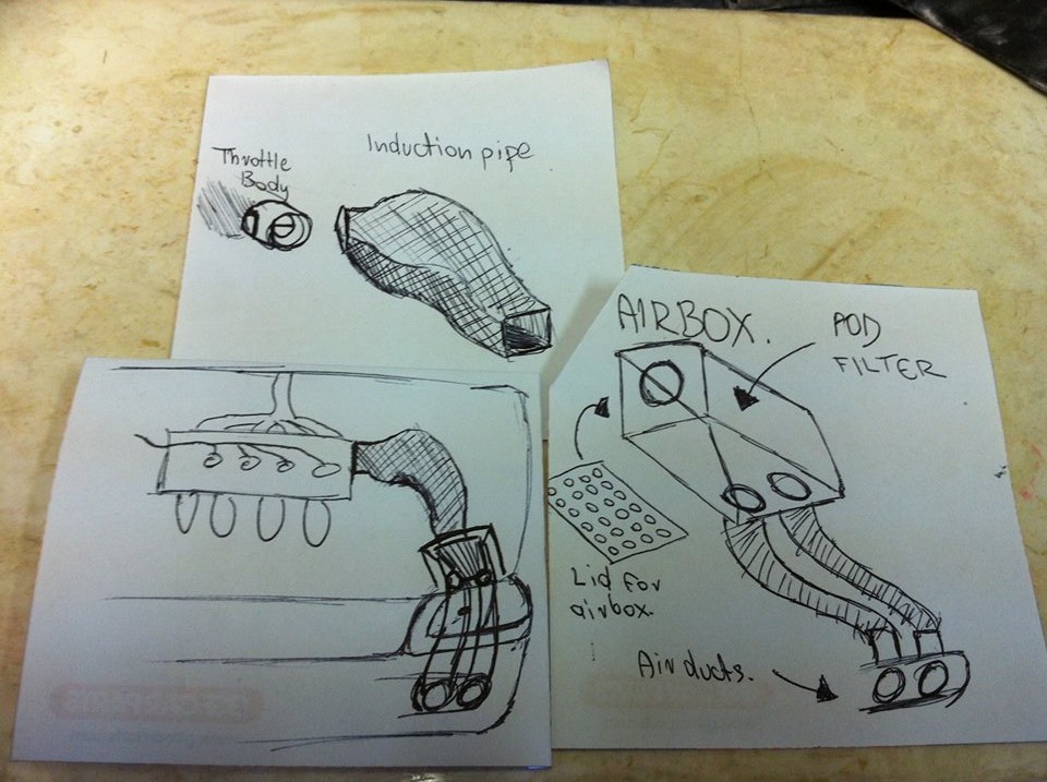

Also when body filler was drying I did some quick sketches of the induction setup I wanna make when I relocate my battery to the rear. I wanna make that induction setup with mostly glassfibre.

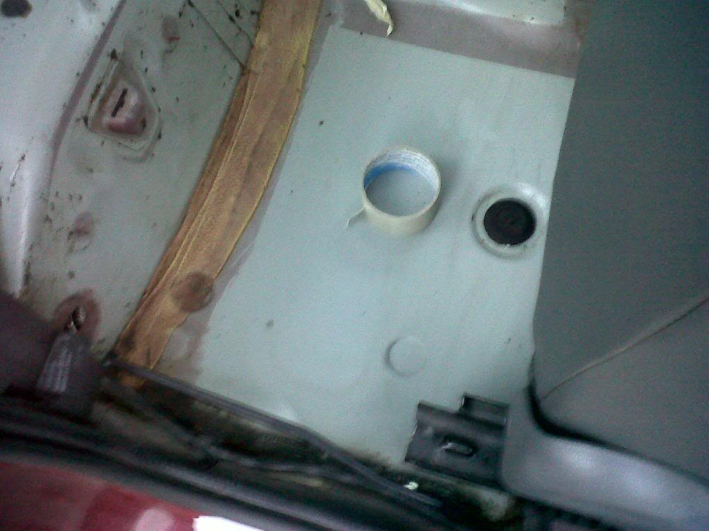

Removed the left over tar from sound deadening.

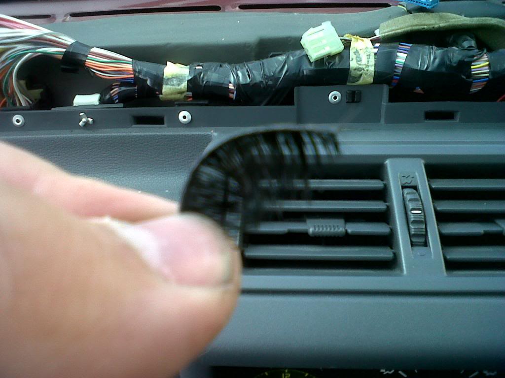

Lol stuff you find when you lift off the top of your dash. ha

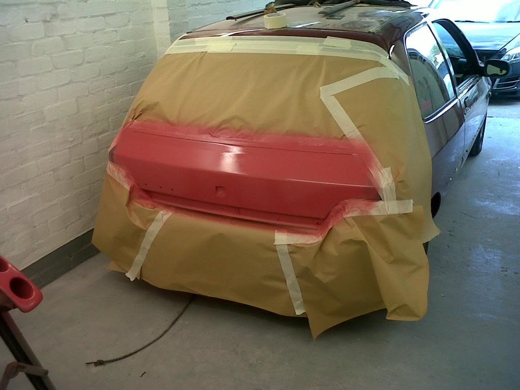

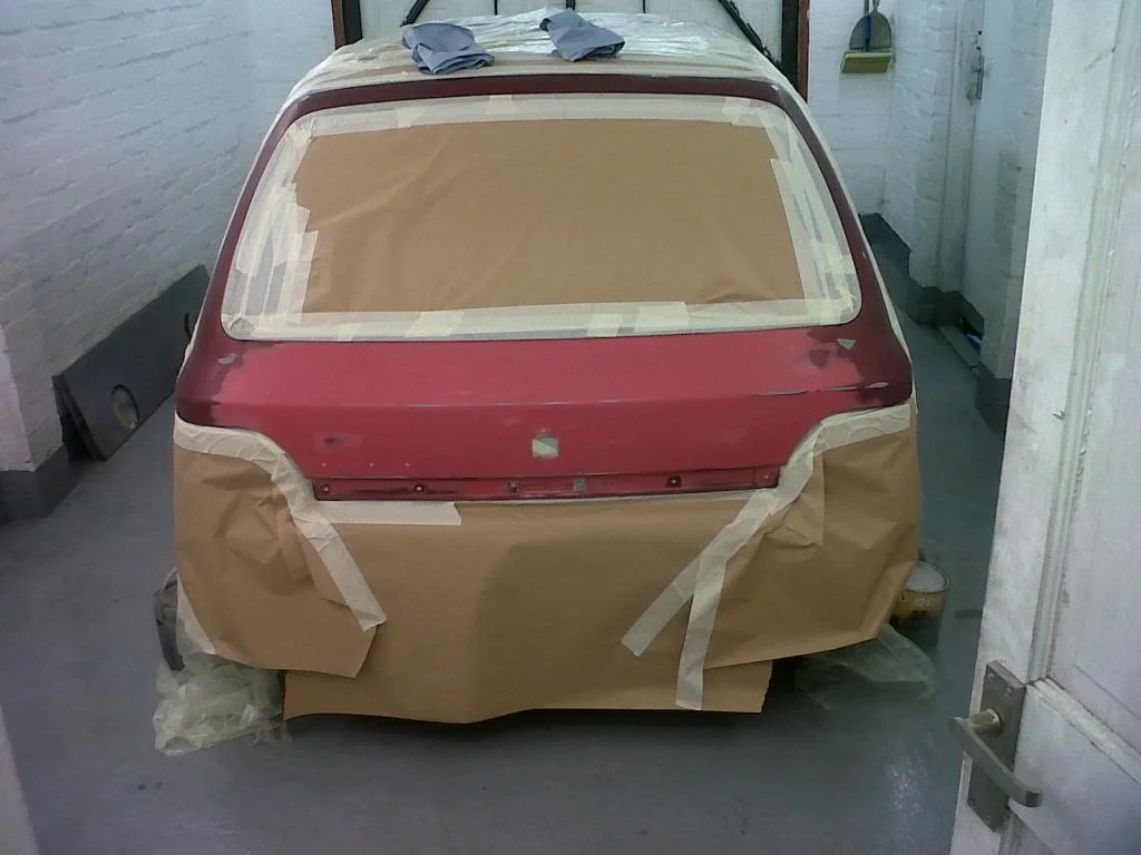

Prepping the boot for spraying and then aftermath.

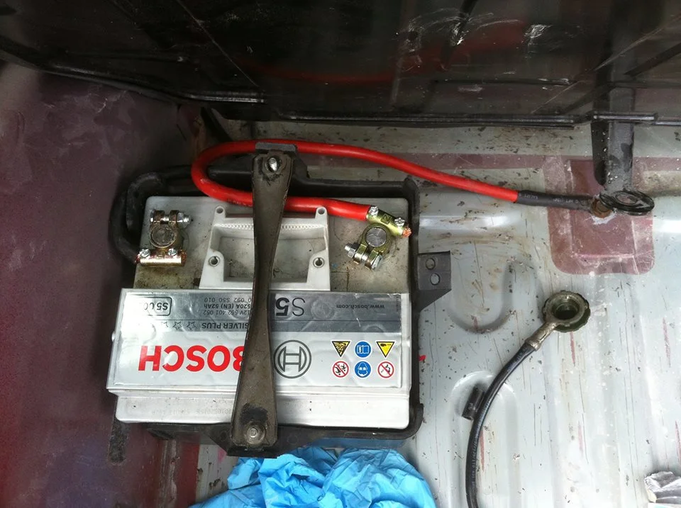

​Also relocated the battery to the boot today. When i went scrappers to get a fiesta mk4 battery box. I wanted to get a laguna bumper lip too. The guy was being a d*** and he said hes only selling the bumper all together and he thought that the lip dont even come off the bumper on its own.. oh well... il go to a different one bit further away.
