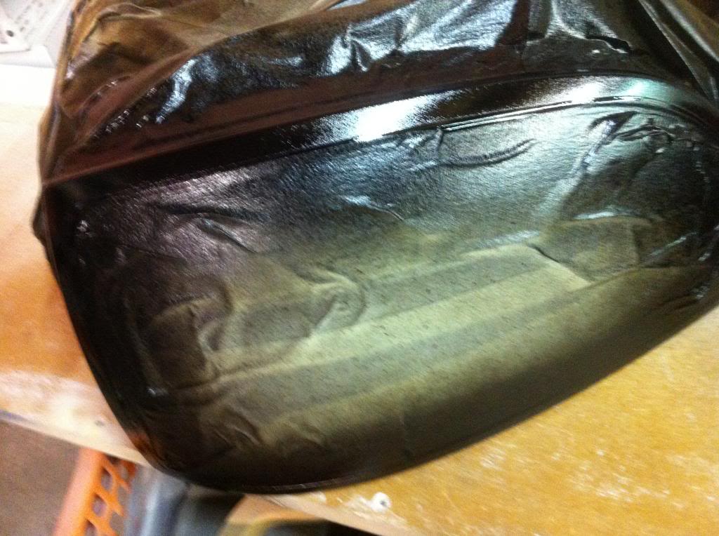

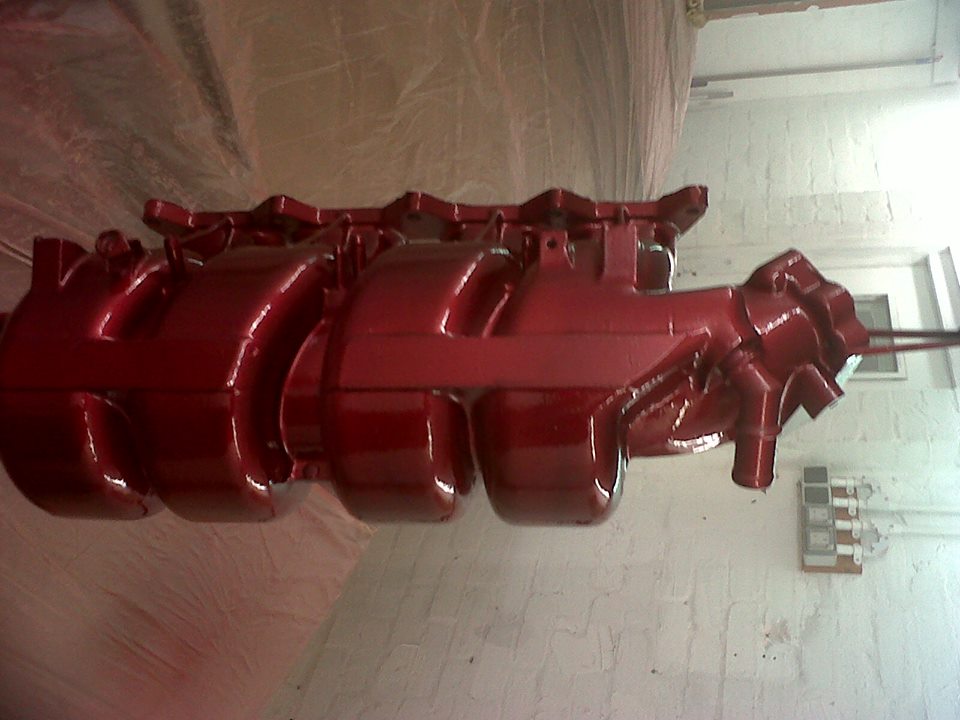

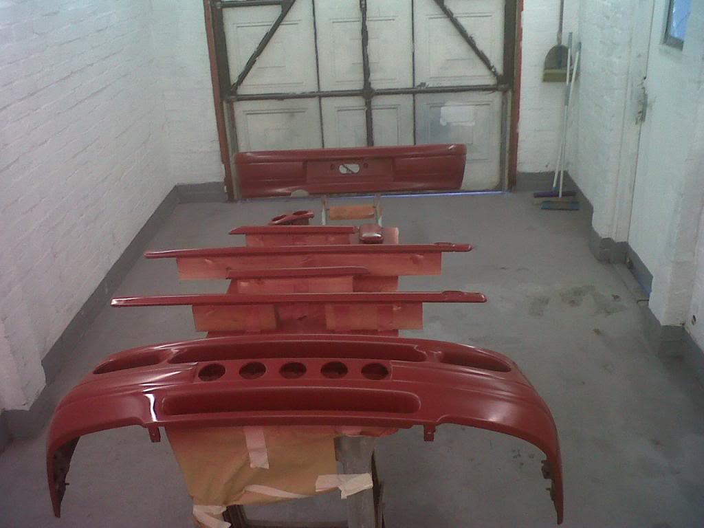

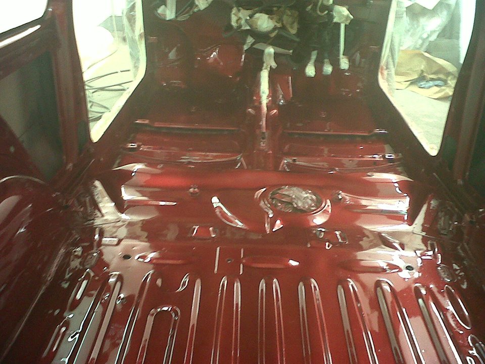

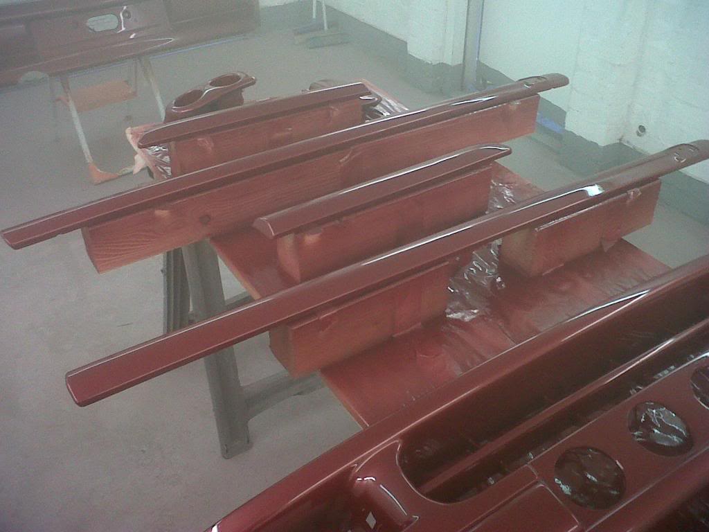

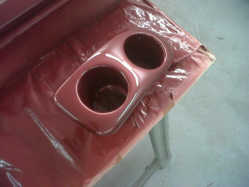

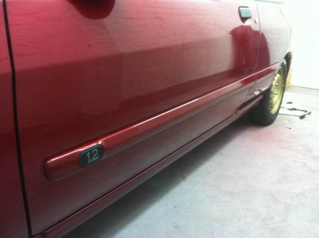

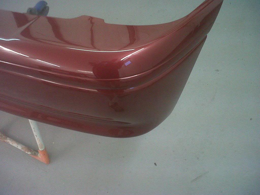

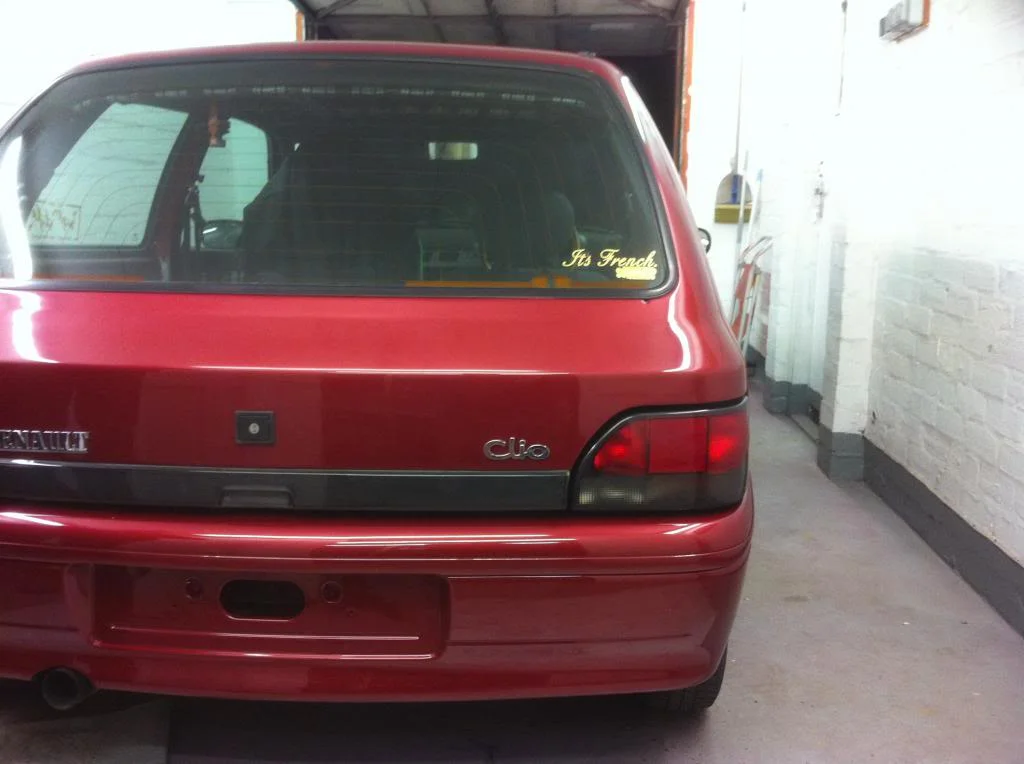

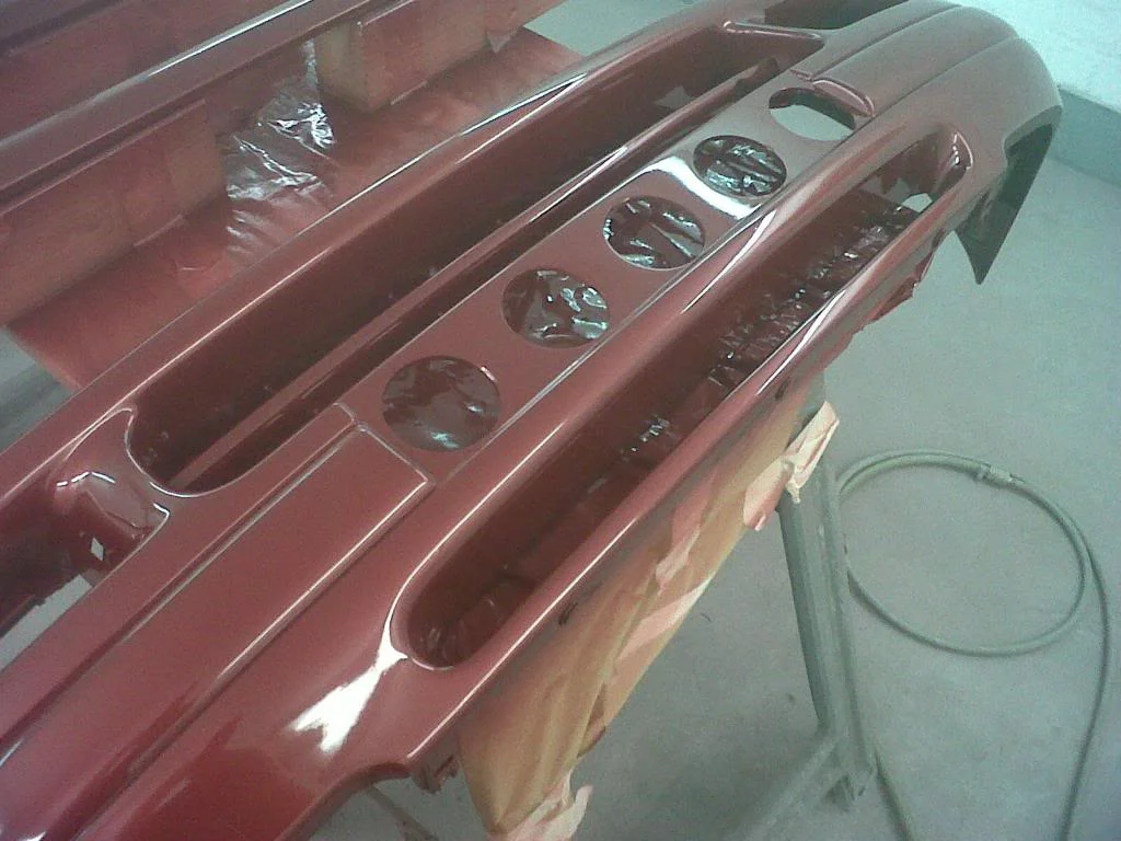

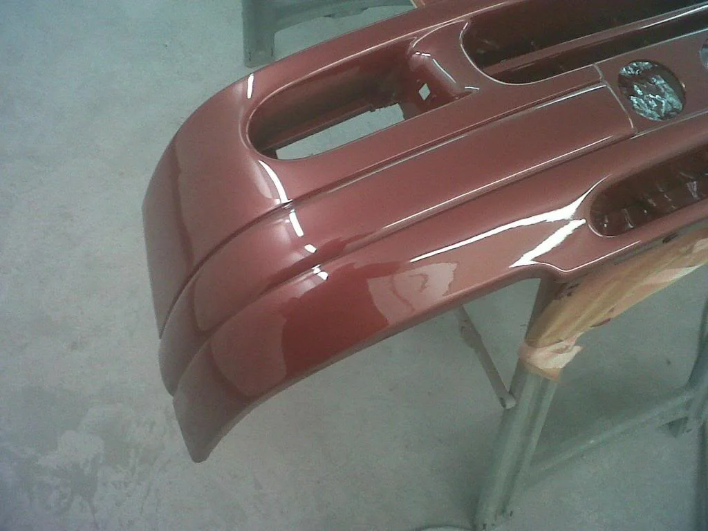

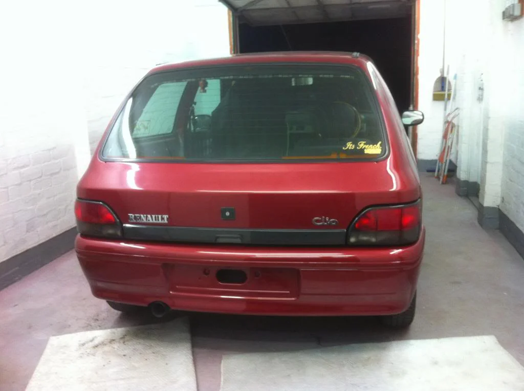

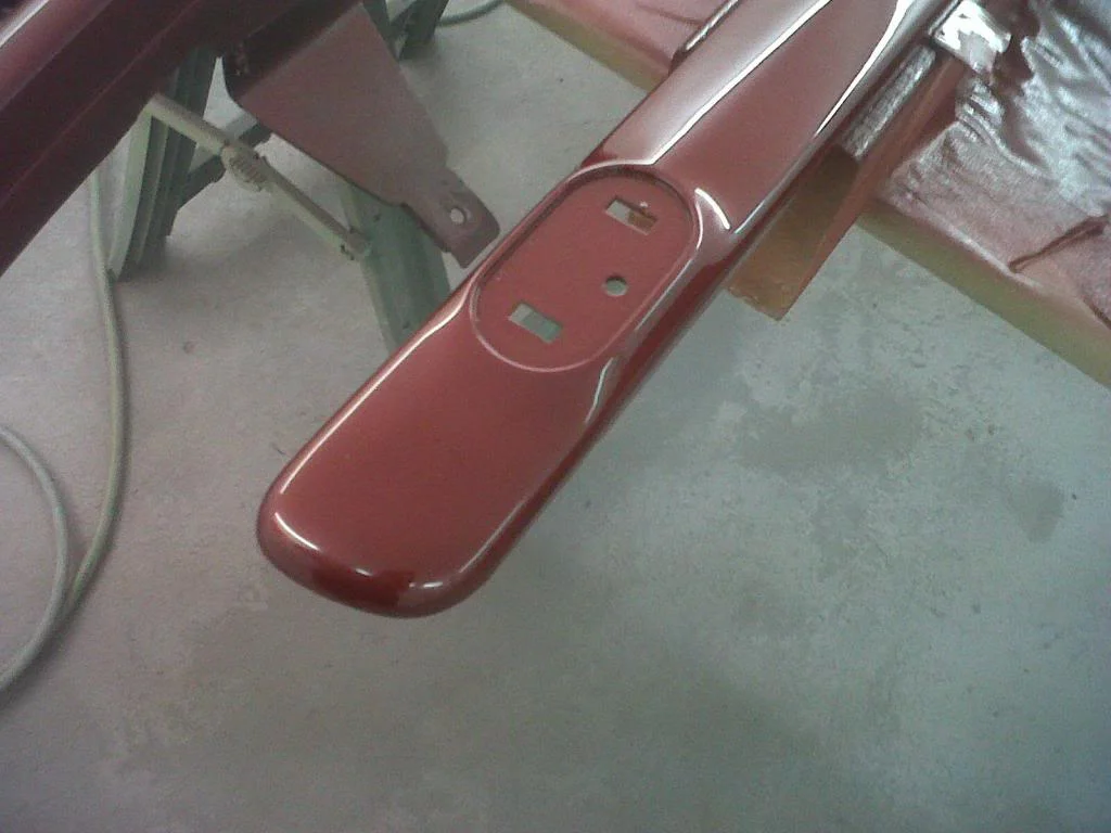

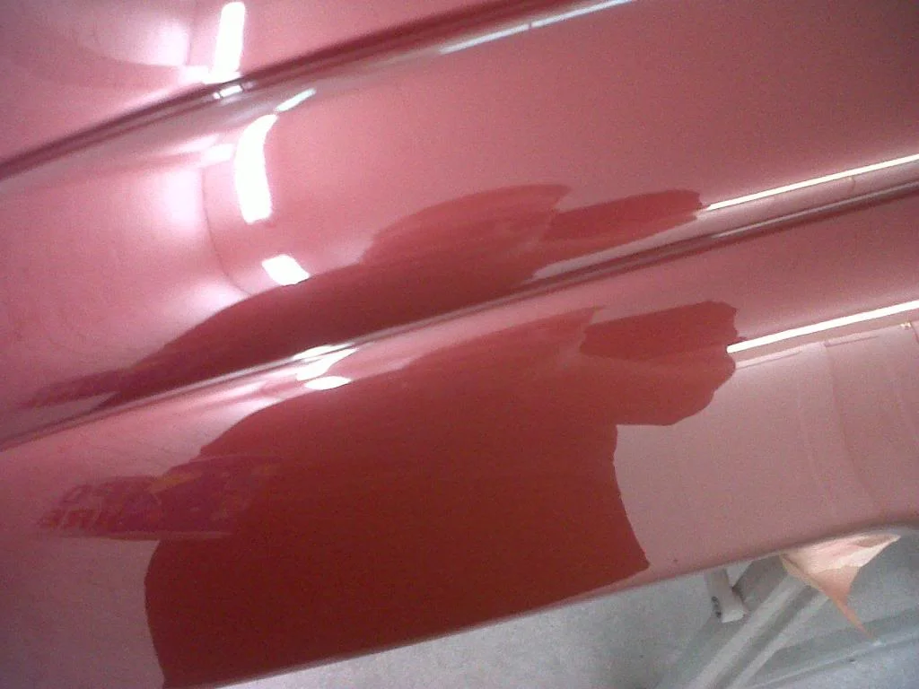

Spraying bits today. :)
The undercoat.
And after color coat and lacquer.

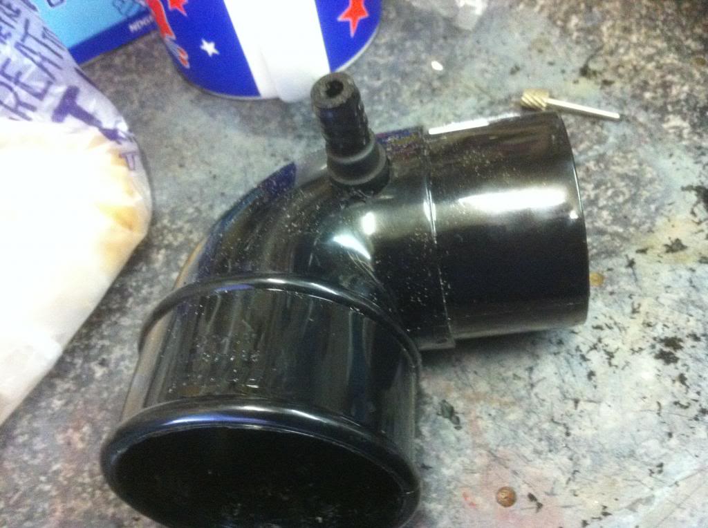

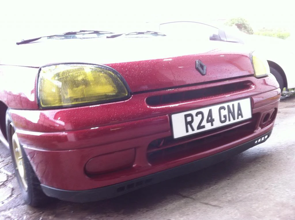

Home made induction kit. Temporarily I think.

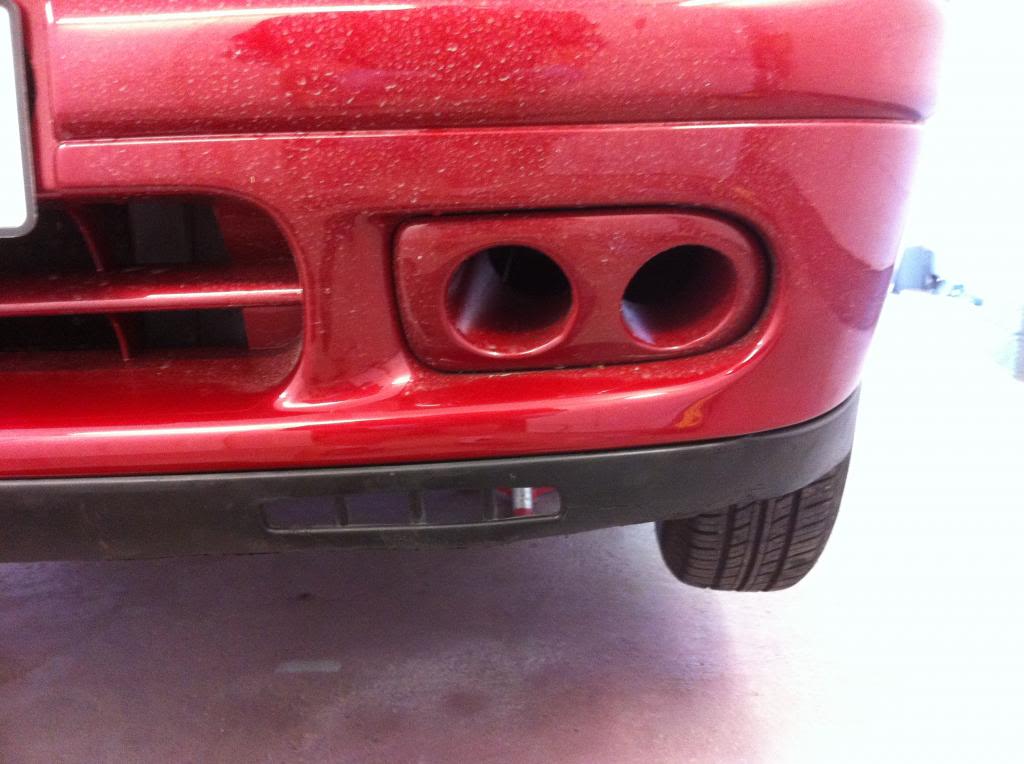

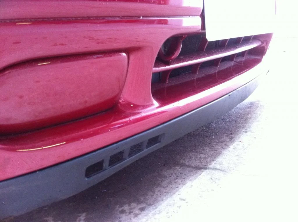

Also got a new bumper lip, thought it was missing something after the bumper respray :D I wanted a Laguna one but had no luck finding one. Ended up getting a clio mk2 which has vents to.
It fits straight on! no cutting, trimming etc.

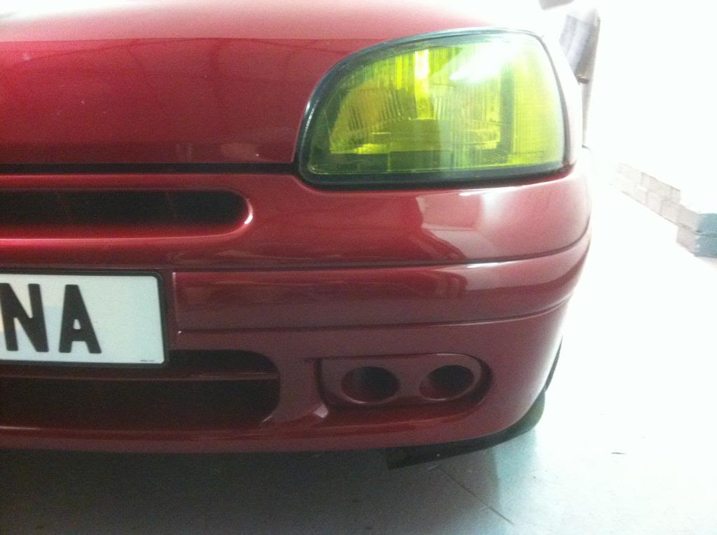

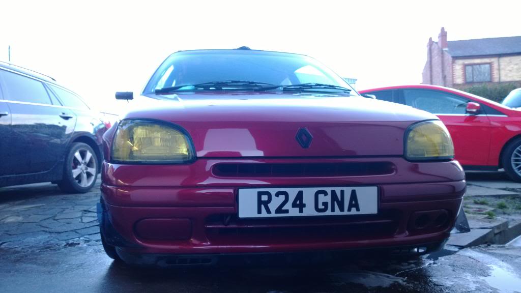

i meant how did you crack them open? oven method? how long did you put them in for? and what did you seal them with?
  Renault Clio MK1

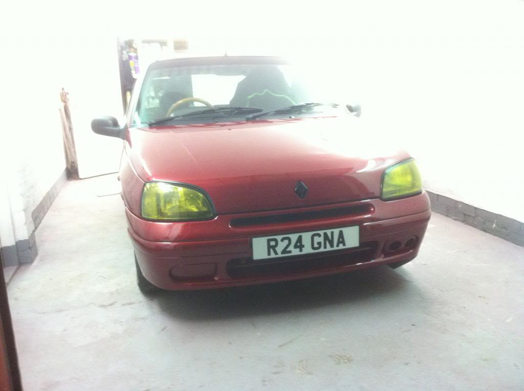

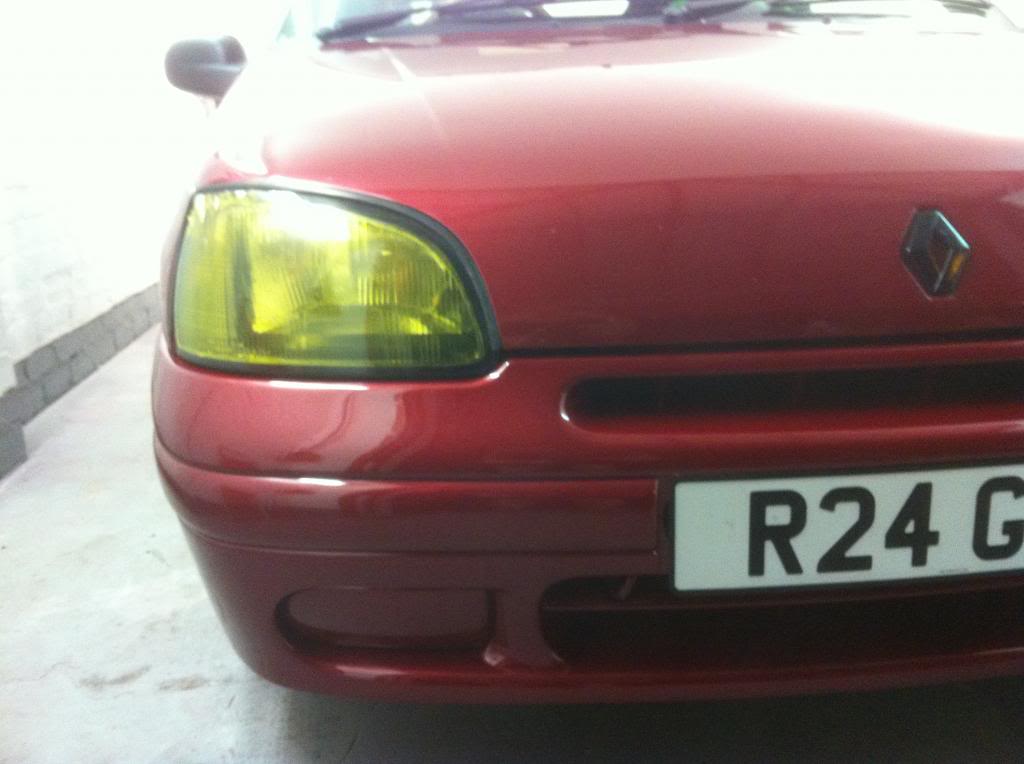

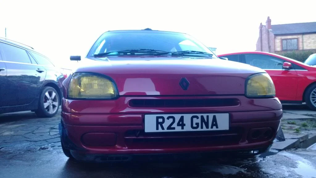

I heated them with a heatgun for a bit, then just pulled them open. Well, its not "just" because it was hard to do and I ended up breaking one lens by prying too hard. had to get a new headlight off ebay.
but yeah, I put masking tape inside the headlight and taped up the indicator. Then using a scotch pad i roughened up the silver surface and sprayed it black. Took masking out, and I put the lens on. Because i didnt have clear silicone, when I put headlight together you could really see the silicone and it pissed me right off. So using fine tape I masked off a edge on the lens, again sanded it and sprayed it black. (an edge on the actual white lens.) Heres some photos.

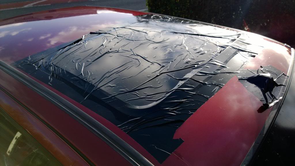

sunroof fix, f**king loving life. will stay like this until il get CF blank plate.

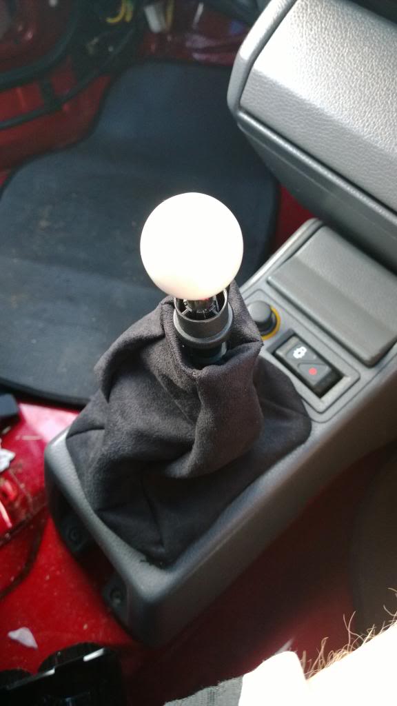

hand sew a suede gear gaitor ;)

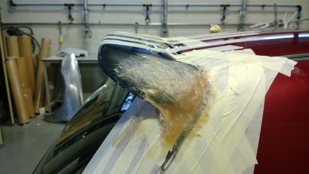

Decided to mould it in for smoother looks.

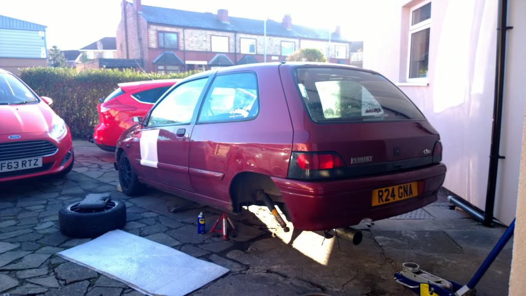

Changing poop 1.2 rear beam for a 16 valver one.
its CLEAN

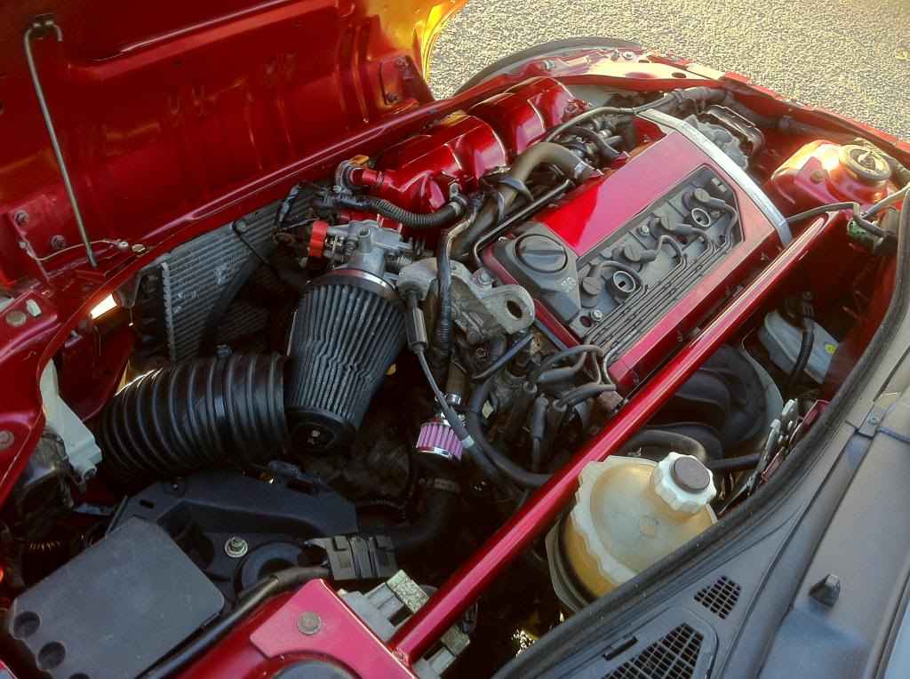

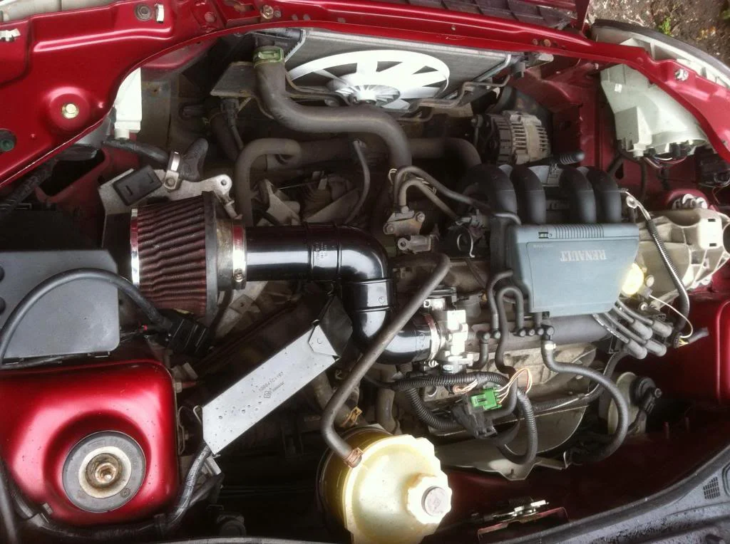

Also picture of what's going on under the bonnet :)
