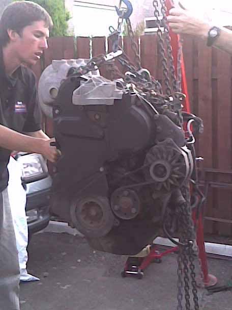

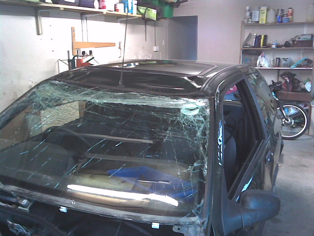

This lasted for a good couple of months and lasted for a month after passing my test, till the head blew. o in steat of shelling out on a new head i desided to buy a new car, a 3 door 1.2 green. Well it lasted a day untill this happend:
Little mis-hap on the way from work. So now i was stuck with 2 cars. So the cheapest thing to do, put the engine, and running gear from the green car, into the silver 5 door. So set about stripping everything from the green car, whitch wasnt that hard (and forgot to take pics :o). Then set about stripping the silver 5 door. Whitch did mean i had to compleatly re-wire it, change the tanks, and lose the electric power steering as i couldnt figure out how to wire it! But changeing the racks to manual wasnt hard.
Some pics:
After all this the petrol engine was ready to go in, whitch, with some luck was a desent one, only done 62K and sounding sweet. Put everything in and she fired up first time! Well proud!

What happened to the Green car? what did you hit?

The green cars gone to the scrap, A pilars were bent out of shape, couldnt open the door! I put it on its roof! bit of shiny tar caught me out on a soaking summer down pour, hit the hedge and over! and stoped on its roof,sort of a half roll!
