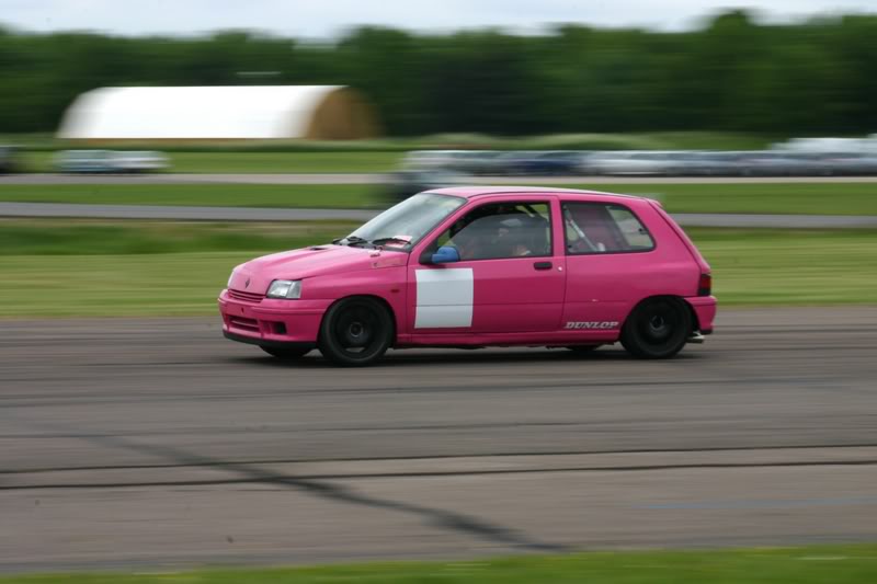

I've got a mk1 16v and in it its got a 172 engine/box/clutch and also the bottom arms, Hubs, discs/pads/calipers and driveshafts. Effectively its a 172 in a mk1 shell. You can leave the 1.8 engine in if you wish and still run the rest of it with 172 parts.
Handles good! lol.
If you get stuck, theres a few people on here with mk1's that will be happy to help. I built mine by just copying two members on here and harrassing them with emails. (f0xy and Whiteley)
Hope that helps.
