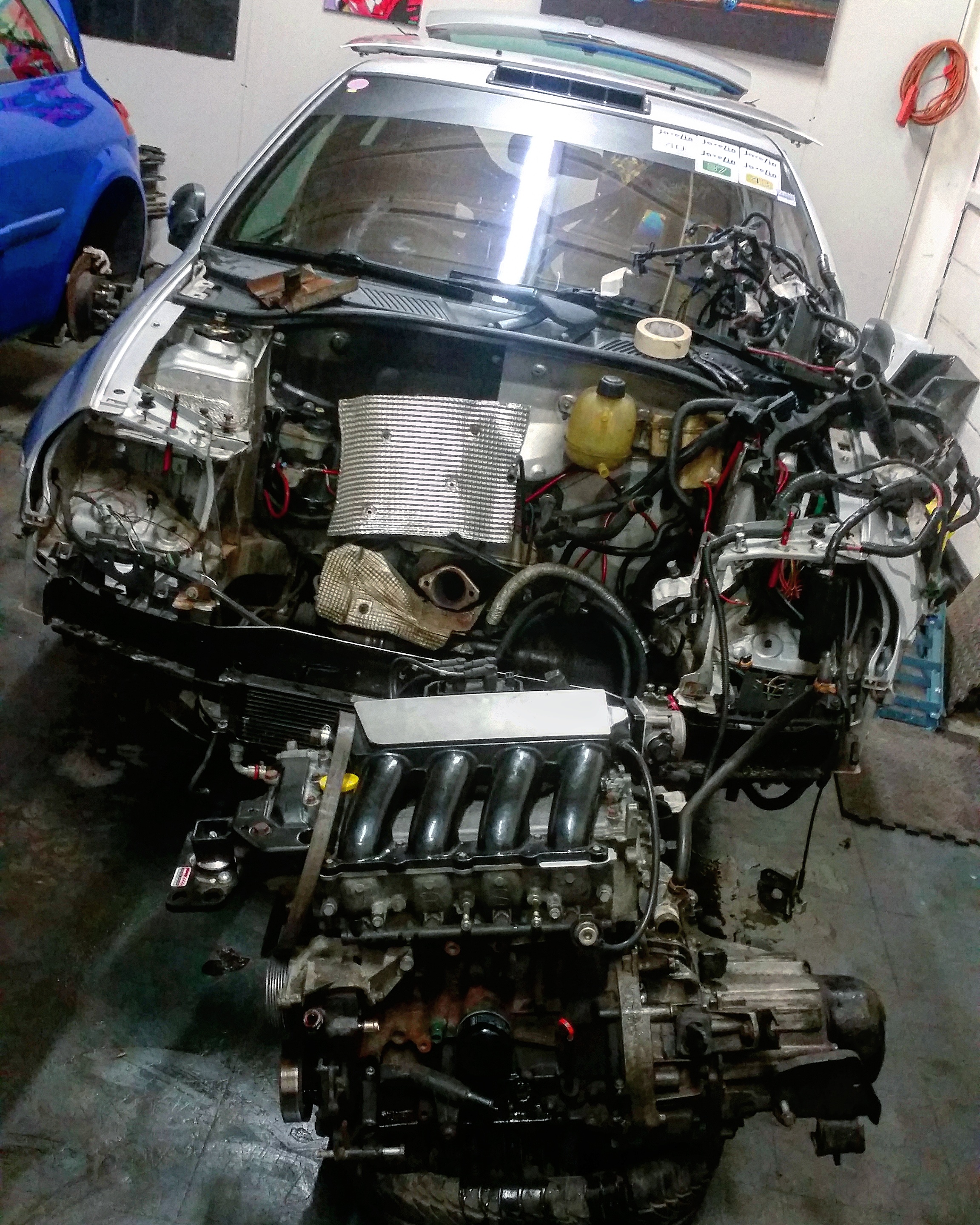

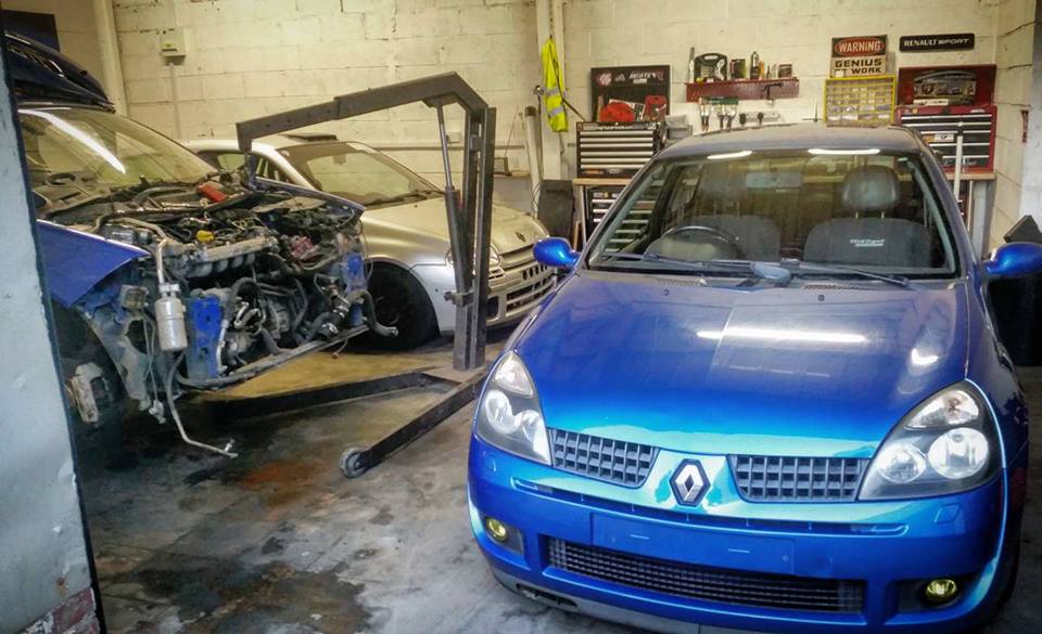

So, popped the engine into the bay tonight to try and see how much of the chassis leg needs modifying so will get on with that. Annoyingly the vibratech mount from the clio fell into a load of pieces. So jigsaw puzzle of Megane spider mount and clio top half need putting together too.
Another little update:

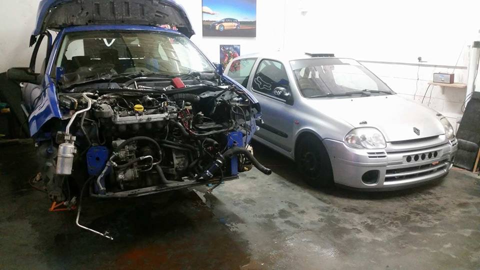

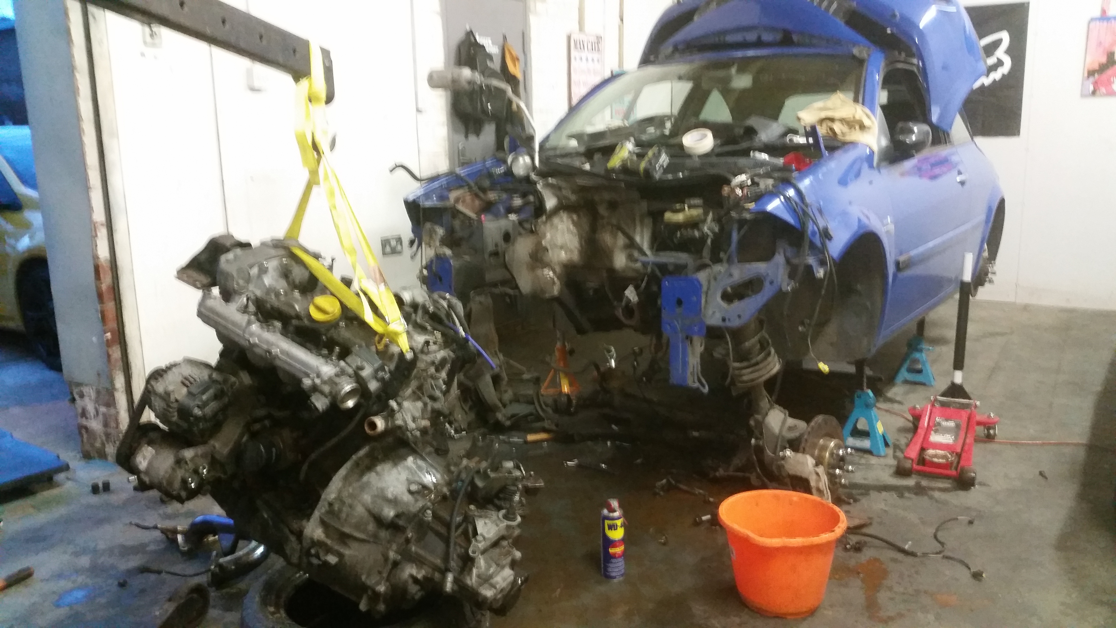

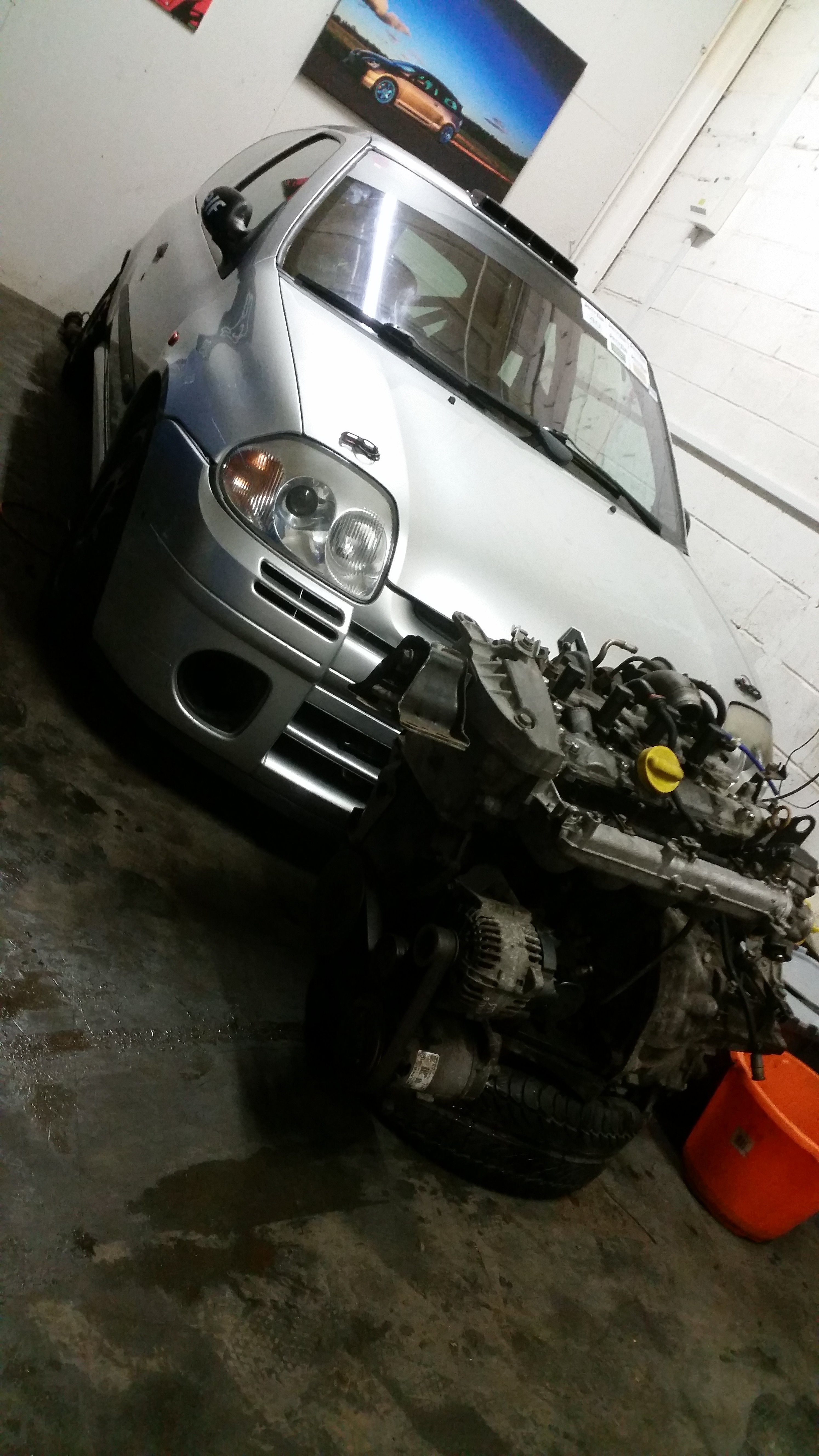

So I managed to get the vibratechnics mounts off the clio tonight and onto the megane engine and block tonight, I then set about getting the engine in and positioned roughly to see how much of the chassis rail needed manipulating.
After putting the engine in and out a few times and marking the area with a sharpie I had managed to mark out and indent the area enough to allow the gearbox to clear the chassis by enough the get the engine bolted up on its mounts properly.
So now I need to mock up a front torque mount and rear dog bone. The engine will then be removed again, painted and finished off to hopefully be fitted for the final time.

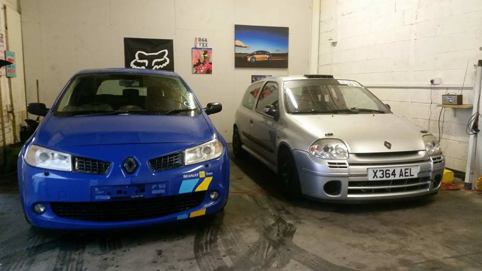

Not really a progress update as im waiting on parts to arrive but interesting all the same. The lad i bought the megane off assured me there was good history with the car with invoices for a full engine rebuild around 30k miles ago. I took this with a pinch of salt as he didnt have the history to hand but said he would get a hold of it and message me....to my surprise he came through and the history was genuine, result!
