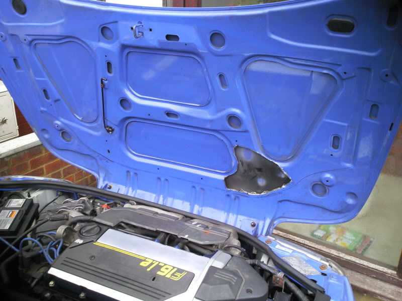

The bonnet doesn't rub as I have trimmed the inner skin.

Prilliams spec.
Engine, gearbox, loom and ecu from a williams 3.
Manual steering conversion, pas pump replaced with Renault 5 gtx alternator brackets.
K&N panel filter.
Full standard williams exhaust and manifold (silenced decat to be fitted).
Polished rocker cover.
Clio 16v front suspension struts, hubs, brakes, arb, wishbones, Bilstein shocks etc.
Rear is standard 1.2 apart from williams shocks (torsion bar to be adjusted to match the front ride height).
Interior is standard down to the 4 speed gearknob. Only change is the dash clocks to rt clocks which have a rev counter.
Set of clio 16v steel spare wheels.
Removed spare wheel, rear wiper motor and interior sound deadening material to reduce weight.
The 1.2 rl shell has no sunroof, manual windows, no central locking, etc
