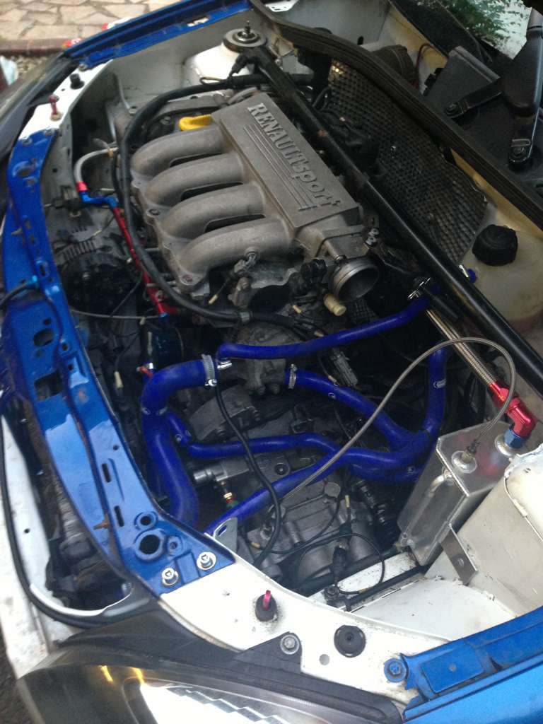

update time! but unfortunately not a good one, after a lot of hard work the last couple of weeks to get this car ready for the track day today all ended in tears this morning,
last night after doing a couple of last minute jobs we tried to start it but with no joy, it's just kept cranking over and wouldn't start, which we wasn't to worried about as its always difficult to start from cold. so as the drive way to garage is very steep I decided to push it out the garage and tow up to the house to get it ready for the trailer in the morning. Finally got it up to the house and left it there until this morning.

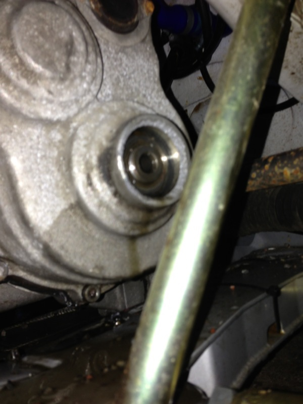

Anyway woke up at 6am and went outside to try starting the car with a little help with 'easy start' ,as soon as I got to the car I could see gearbox oil on the floor, stuck my head underneath and at first glance I thought is was just the seal on the drain plug and then I realised it was much much worse than that

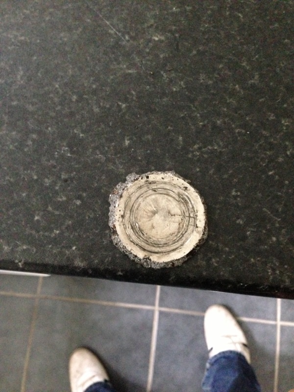

As you see the end plate has a massive hole init where the end of the final drive pinion sits. I couldn't believe it, i was absolutely gutted!
I haven't got a clue how this has happened, I didn't even drive it as wouldn't start, went for a walk up road to see of I could fine the metal piece and found it right next to garage door, so didn't even happen while towing it!!

Not good Andrew. Has that had glue or some type of sealant on it? Doesn't look like a fresh break from the pic.
  Clio172cup rally car
I think your right, I've just had a good look at it and you can see some kind off black sealant on there. and the rubbing marks on it don't look fresh either. As if its been damaged and repaired before. I just can't believe I didn't spot this earlier!!

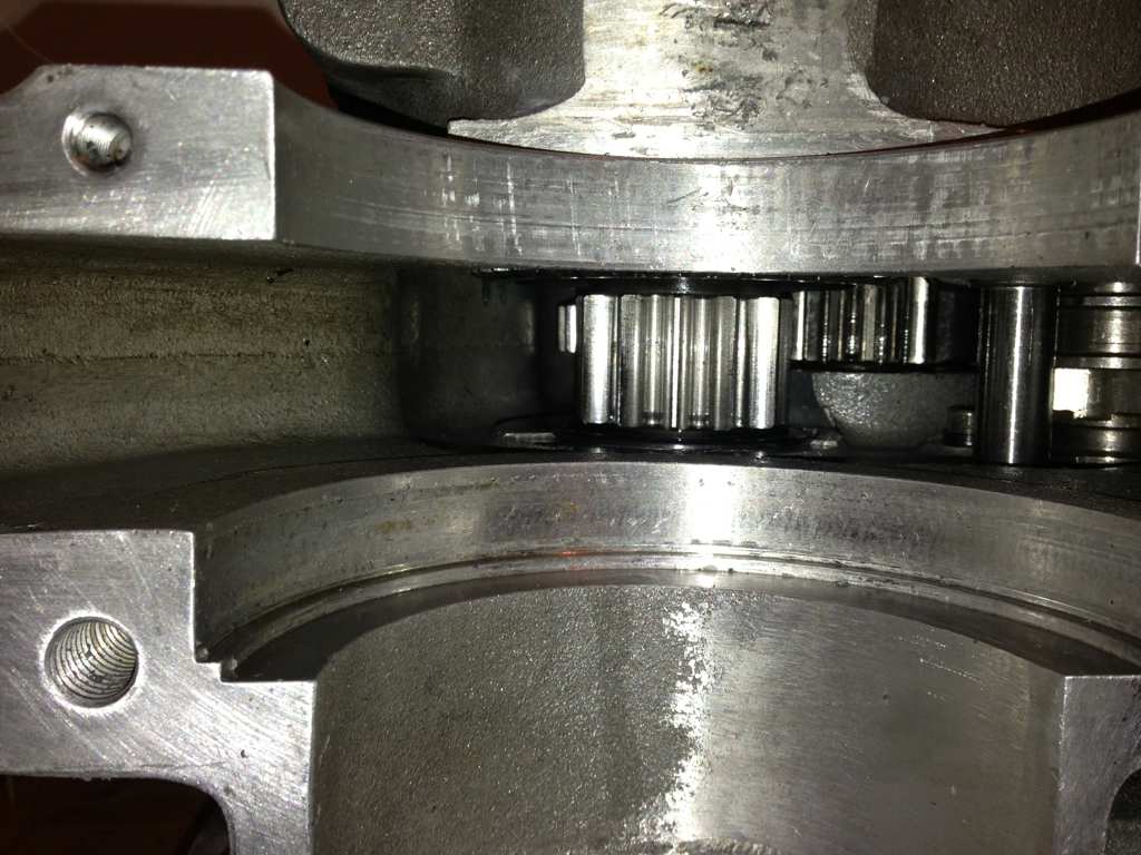

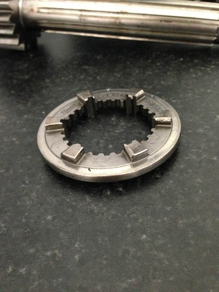

Its been quite a while since the gearbox broke down, turned out the wrong bearing was fitted to the final drive which caused 'end float' in the shaft which in turn punched a whole in the end casing!

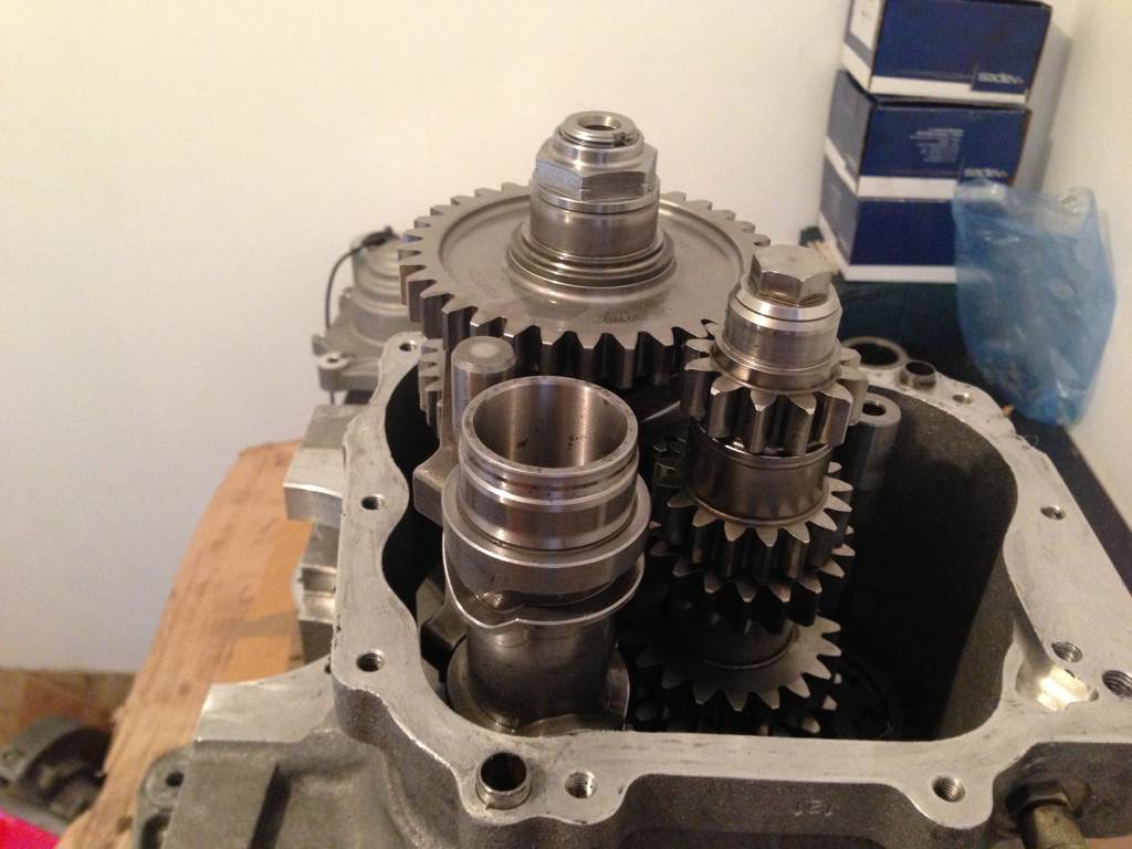

When I finally got the gearbox and the lid off to inspect it, it wasn't a pretty sight! Nearly all the gears needed to be replaced as the dog teeth where smashed to bits, including the all dog rings
Also had to change one of the dog ring gears and one of the needle bearing hubs as they had both worn, causing 4th gear to become solid when refitting the gear set! been such a hassle to fix, I must of taken this thing apart about 10 times!

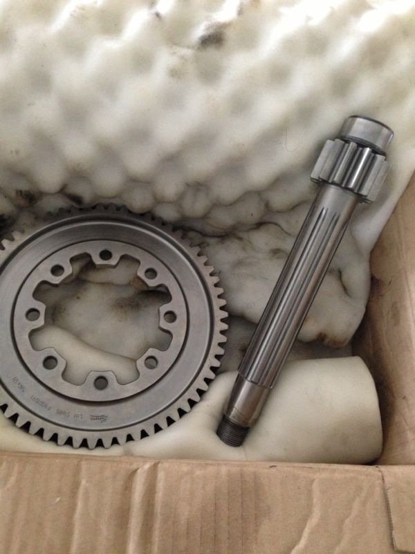

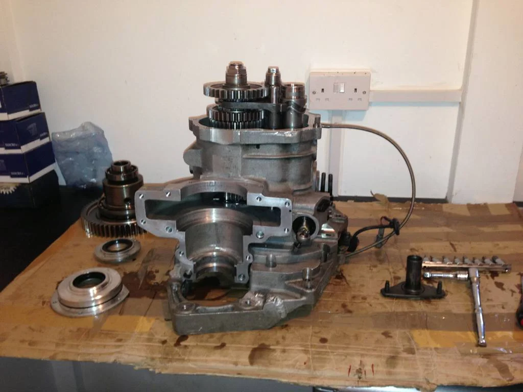

While the box was apart I decided to change the final drive, as the 3.2 which was init was far to long for rallying, I managed to source a new much shorter final drive from France for a really nice price :)

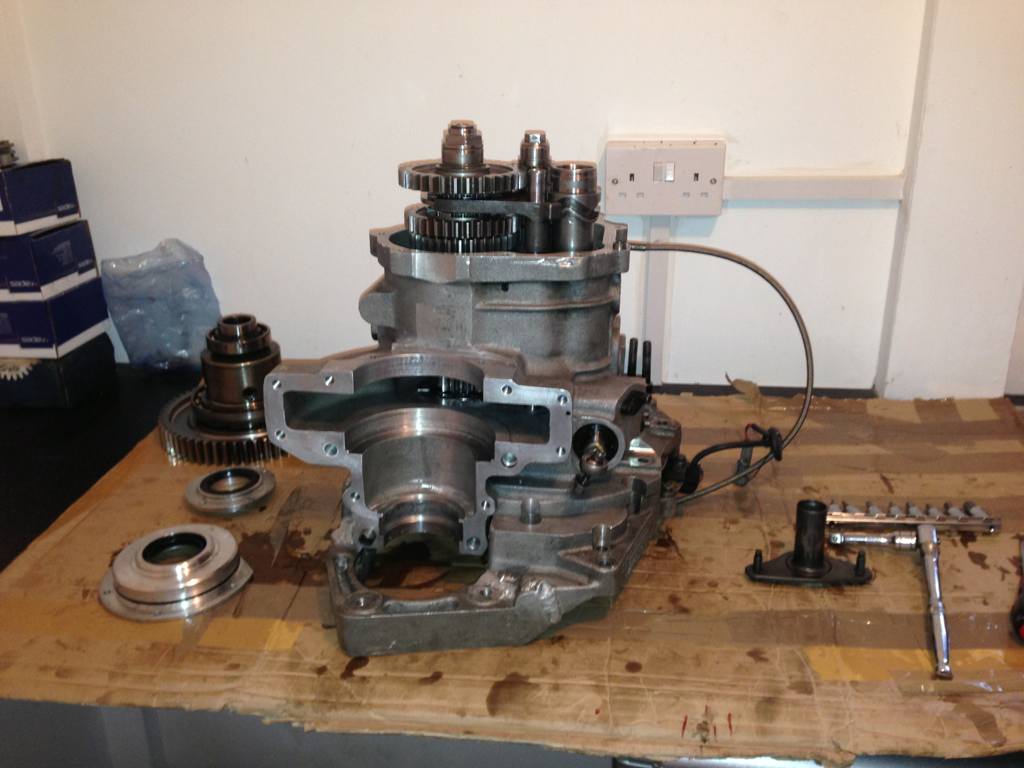

here is a few pictures of the build, all in my utility room of course ;) ( the Missus wasn't impressed lol )
a few pictures of the gearbox back in and the car out the garage
