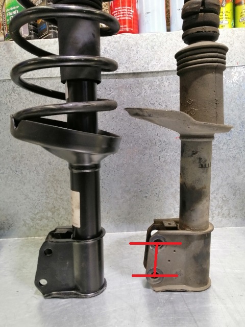

I have a Renault Clio sport 2003, 2 litre 16V, and the front struts are totally shagged. I have been trying to get after market replacements, but keep getting shown, sent the wrong bits.
Attached is a pic of mine on the right, and the replacement ones sent on the left. Note the different spring/ ride height, hole diameter and Placement.
I am sure this is a simple issue, but I am struggling to find any parts to suit

Cup and non cup doesn’t really matter. It’s the bolt spacing that matters.
I suggested Renault Parts Direct. They are based in the U.K. and it’s basically an online shop for a dealership parts counter here (or at least that’s my understanding)
I’m not sure if they post worldwide. I suppose another option is to get the part number and take that to your Renault dealer in Australia if they can still supply them?

Measure the bolt spacing on your current shocks to work out if your running cup or non cup dampers. Distance between the centre of each bolt hole
