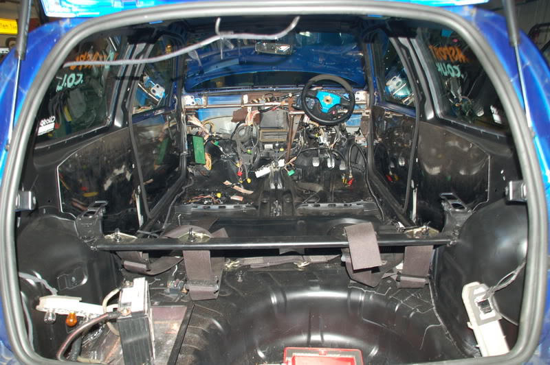

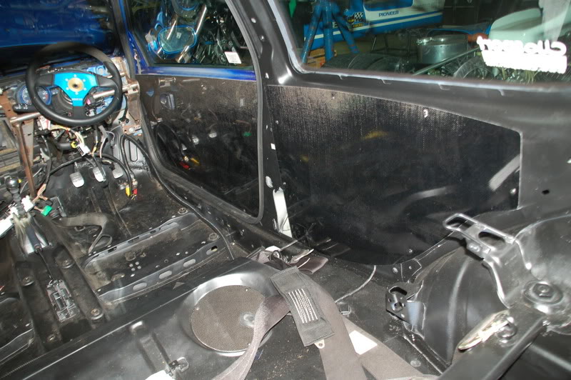

What you've bought sounds just like mine, and what you want to achieve with it is exactly what I set out for, 200 bhp/ton and cheap reliability.
I ended up with 205 from taking it down to the metal everywhere except the dashboard, standard passenger seat, and a Cobra Imola S for me. 917kgs.
Same exhaust and a homemade Maxogen effort have given me 186 bhp, 106k from new, beasted every single day, still pulling like a train, and returns almost 45 mpg.
You'll have a blast.

yeah it had a rear harness bar welded in, but that was about 12months if not more before we put the cup racer rear coilovers on it
they were standard cup racer rear shocks ie HARD! his car was COMPLETELY stripped though! we did something like 10-15K miles on them, the only problem we had was when i snapped the wee little rose joint on the bottom of the passenger side rear (sideways over the curb at bedford with some bloke from r-sport france in the car LOL!!)
apart from that and a sore back it was fine!
