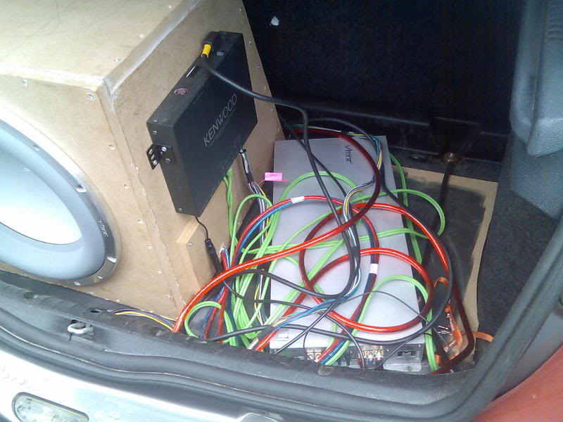

The car is 2 tonnes due to the Audio system. The 7 massive batteries in the back are 52 stone on their own without any of the MDF wall and the subs and 8 amps. As you can see i'm well into my ICE.

I built the system to an over engineered spec really. The MDF wall is the entire back of the car and fixed to it directly. It is over 100mm thick in places and braced with steel rod etc. The car with the old system (3 RE XXX 15's) hit 153db on the termlab with a genuine 6kw and when the Orion HCCA's went in i upgraded to 12kw to the subs so needed the extra juice and the bigger alternator capacity to play for long periods when showing (hence the engine change) It hasn't been tested yet but its got a good chance of at least a 156-157db this time around.

The walls of the enclosure are between 54mm and 108mm thick plus 3 layers of fibreglass all around the inside of the box. The fibreglass makes the box incredibly strong and prevents any kind of air leaks. 5mm thick steel angle iron has been used to strengthen the corners and front and rear faces of the enclosure. It has also been used to strengthen the port top and bottom to prevent "db robbing" port flex. The enclosure itself is built to every side of the car meaning no box or car flex at all. Any sort of flex in the box, car panels or the port will mean a quieter system. The box has also been strengthened with 3x 12mm zinc plated steel rods running from front to back. These reduce box flex as the subs try to push the rear of the box away from the front when under load.

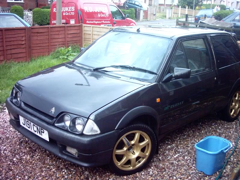

you used to be on the chilled cruising website years ago didnt you, i didnt think the clio would still be about now, always loved the wheels, i had the same ones on my AX GT500, dunno if you can remember me lol, this was my car back then..

Bonkers - Yeah i remember you on there. Chilled Cruising was a great site. Its a shame it went pear shaped. I still have my T-Shirt from a show we went to once with our usernames on the back...lol
  2003 Clio sport 172
haha, i aranged one of the wednesbury meets once when i had my blue AX, good old days lol, i still talk to nick every now n then on facebook
