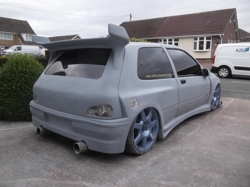

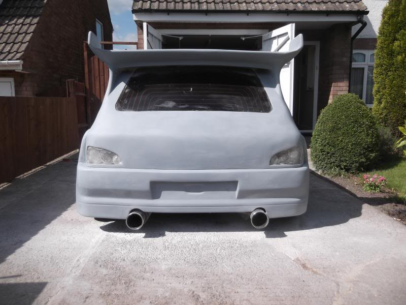

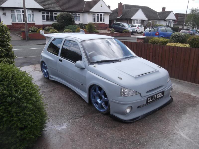

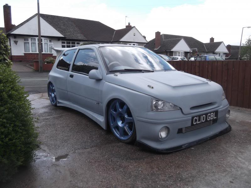

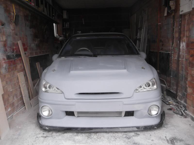

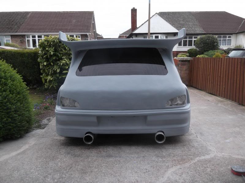

​Well the first primer guide coat is on. Its uncovered some areas that need some work but it looks nicer as it is than in bits of colour everywhere.
2 sets of 5000k HID headlights have been ordered for when the lights have limo black tint on them (The rear lights have already been converted to full LED)

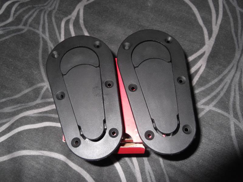

Some new flush fit black bonnet pins are also on the way from Hong Kong.
What do you think so far? I think you get a better idea of what it might look like now.
It pains me to say it but I've seen a lot worse tbh! The wheels look good and really suit the car.
Does your boot open?

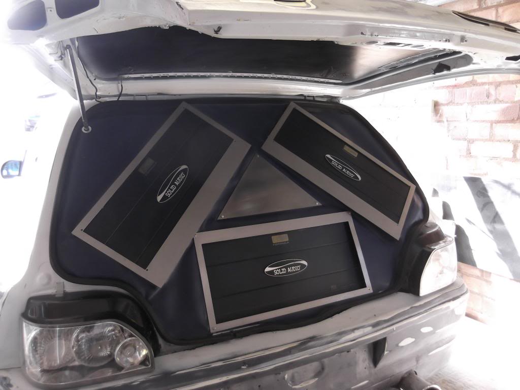

It does indeed as i need to get to the amps and battery charging point inside.
There is a lot of work going in to the boot to make it as smooth and flush fitting as possible

contrary to what the majority probably think, i really quite like it. the only thing i'm not a fan of is the spoiler :p however for what it is... i like. :)
  Clio Widearch
i did once do a photoshop of it with no spoiler or a small one. It didn't really suit it too well. Plus this one is film memorabilia :)
Hats off to you mate you've put a lot of hard work into this and getting it just the way you want it. I'm looking forward to seeing it finished :)

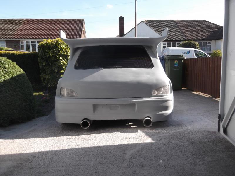

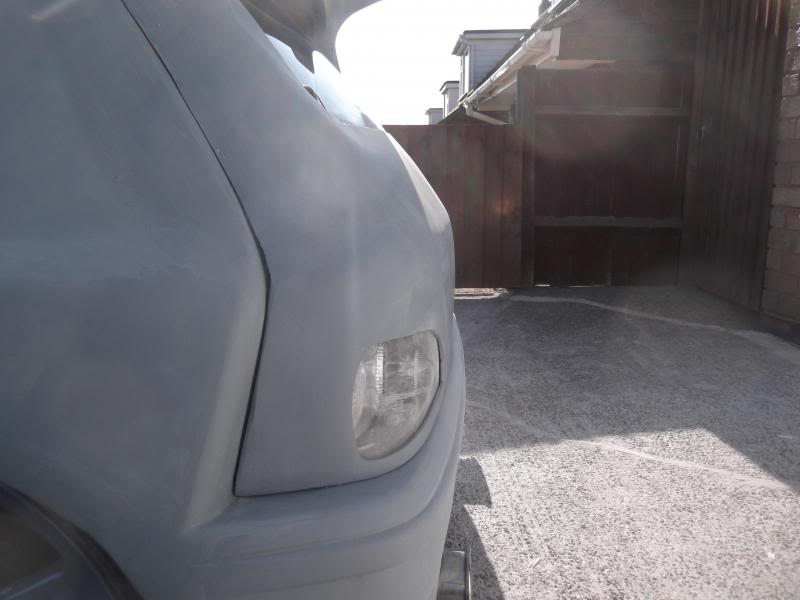

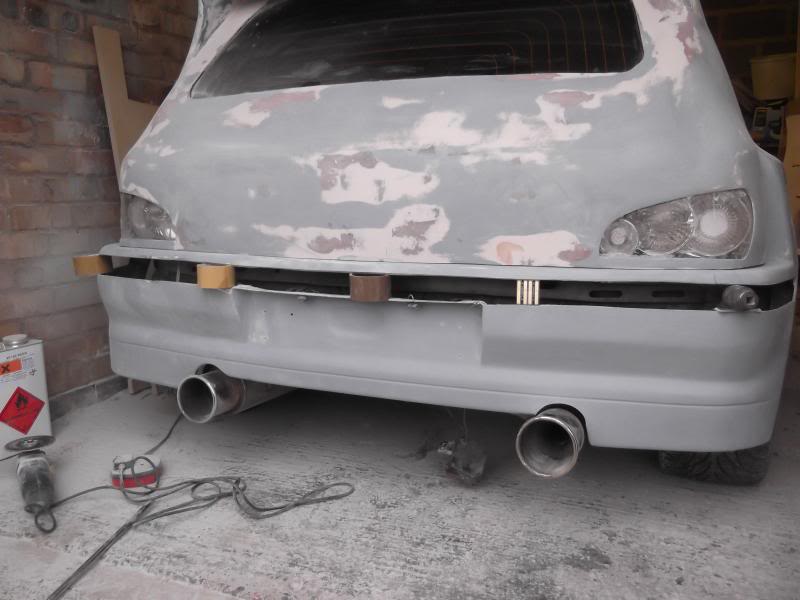

​done a bit more smoothing work on the boot and other areas today as well as bits and bobs that nobody will probably ever see. The tailgate now looks flatter and the boot line looks a bit better..still got some work to do here but its looking much better i think.

I'm sorry, but that tailgate is dreadful. Looks like made of wax, got too hot and melted in places.
I like the car though strangely enough! I do admire your determination.
  Clio Widearch
i'm hoping when the car eventually goes for paint, the boot will blend it to the rest. I still have some work to do on that as it's not fully flat yet and the dreaded job of getting the panel gaps right still has to be finished. Also there will be some graphics involved which may break up the vast space that is there at the moment.

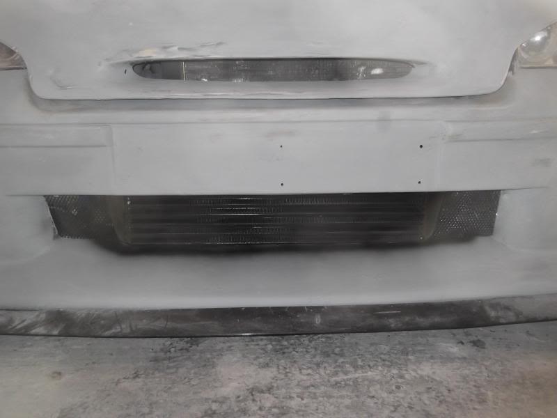

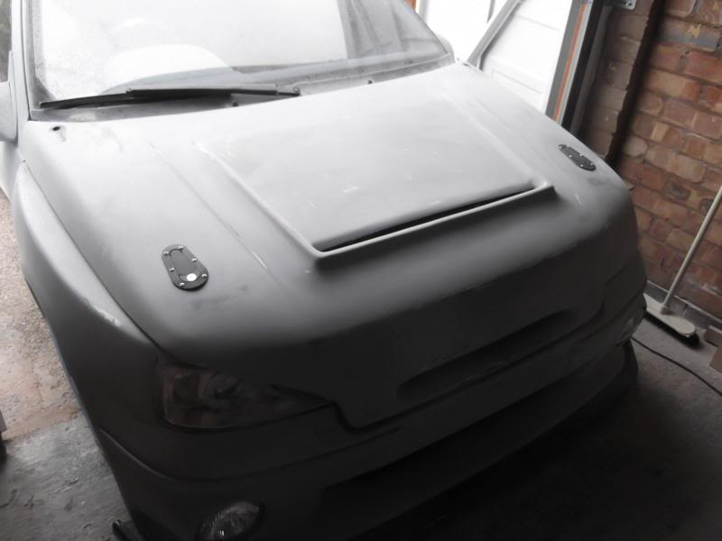

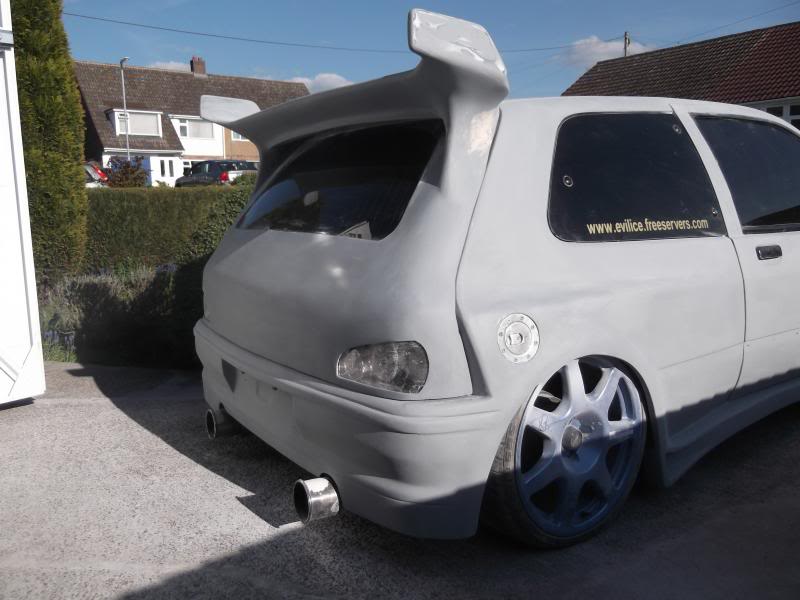

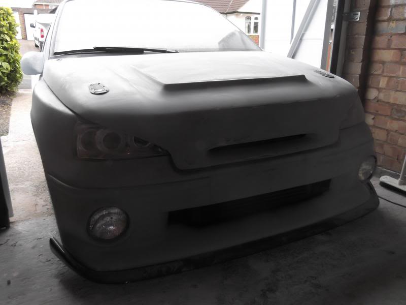

​bit more work done
The front flush fit bonnet pins are in. The second set are now here from Hong Kong too so will be going on soon.
The FMIC has been painted gloss black

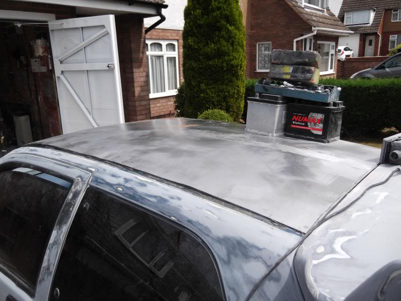

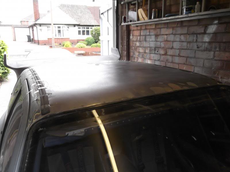

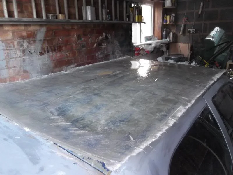

After a proper look at the roof i'm a bit worried about it cracking and moving about and damaging the wrap when the bass gets cranked up. The roof is also not smooth at all. I decided to make a false fibreglass roof from a direct mould of the roof to bond onto the top to stop the problem..very early stages yet though.
I have also decided to smooth out the bits on the front and rear bumpers either side of the number plate etc. All these hopefully will be finished in the next month.

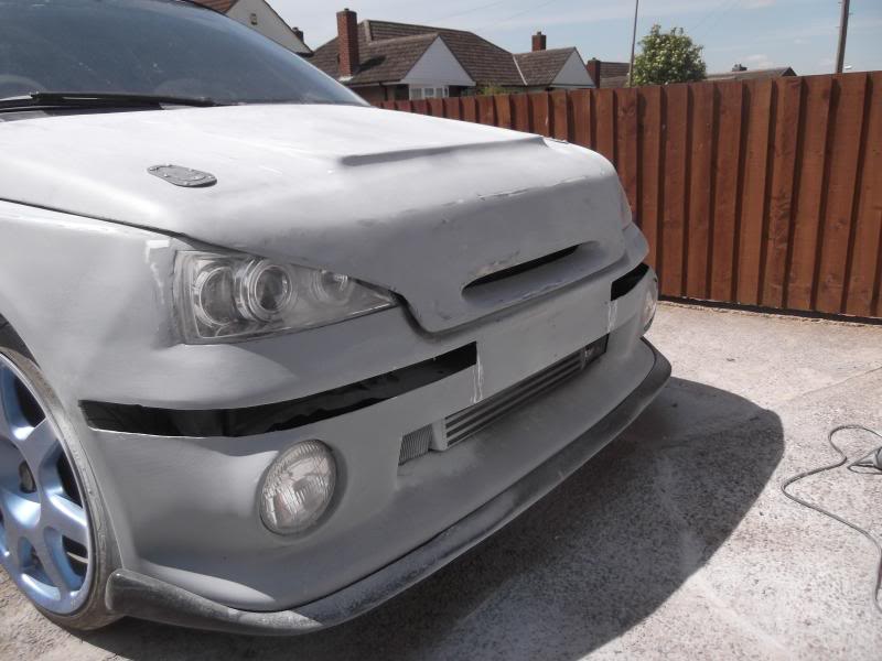

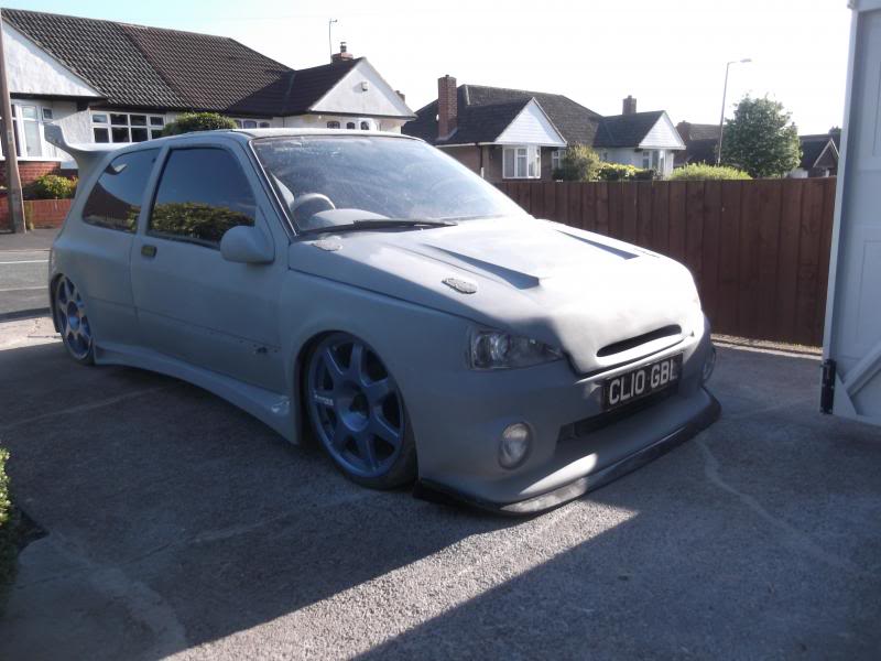

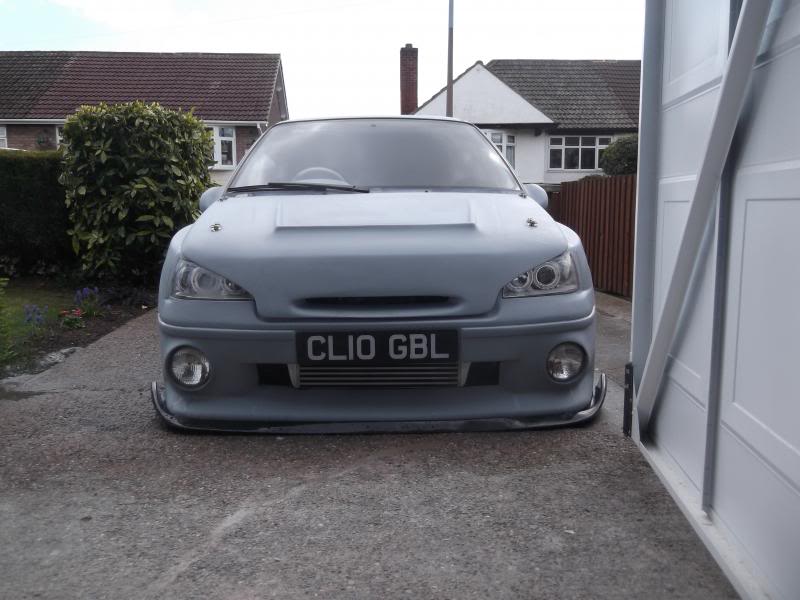

​A few mods done lately
Rear bump strips removed and boot flatted a bit better..still work to do with the latter
And front bump strips removed

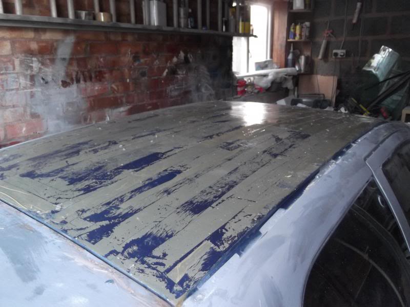

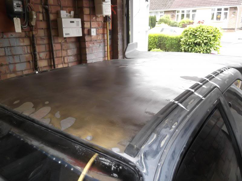

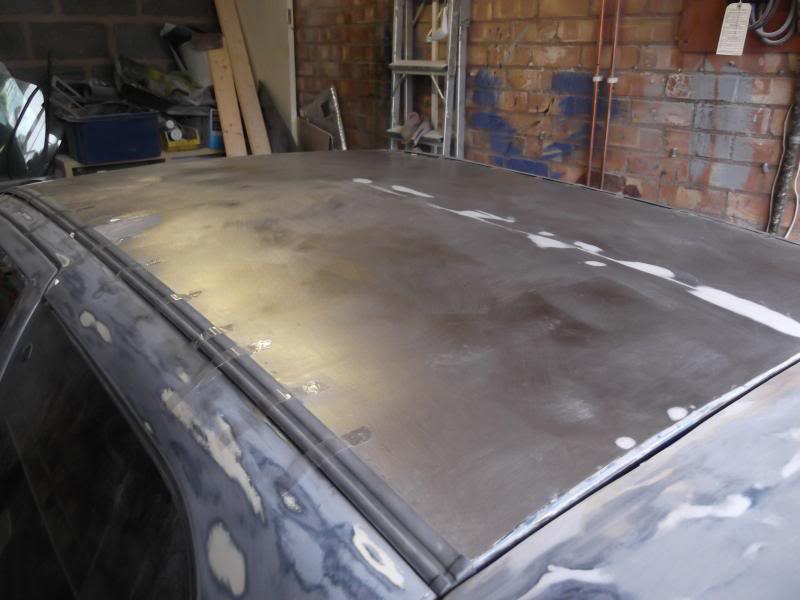

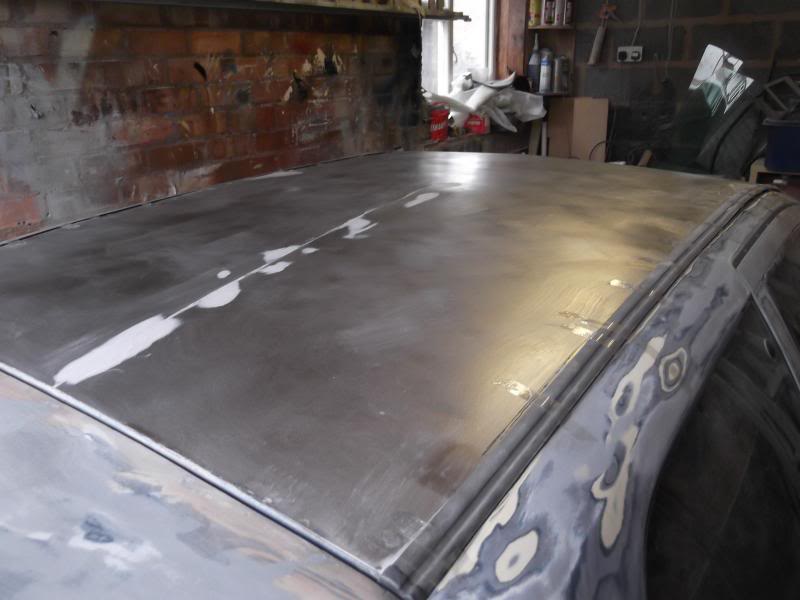

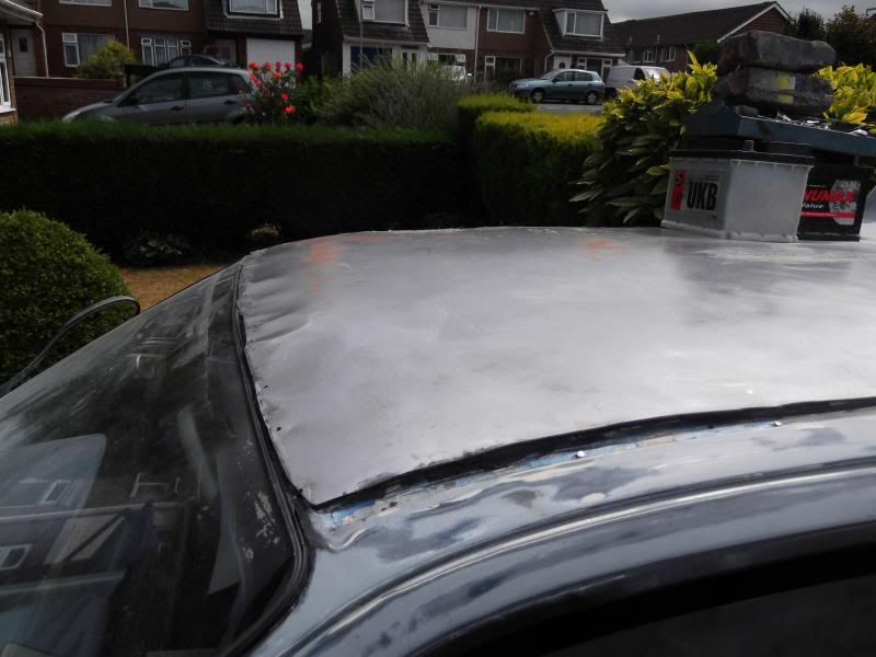

​Haven't posted on here for a while as i've not really done anything that's of any interest. Still i thought i'd show you the new roof.
I ditched the fibreglass idea as it just wasn't working so made it in 0.9mm steel instead. It's still not totally flat and never will be but is a lot better than the fibreglass one and as it was before. Due to the rood curving the way it does it was very tricky. I'm happy with the results
As it started the weekend...whilst being bonded
And the finished item ready for wrapping

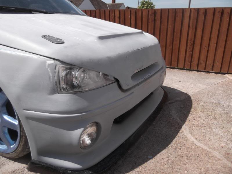

respect for effort thats gone in, but worksmanship looks piss poor from the pics, but they could be deceiving i guess.
just take more time when rubbing the filler down, constantly feel it, whats high, whats low, where to rub from and get those edges nice and straight. at the moment it looks all over the place
