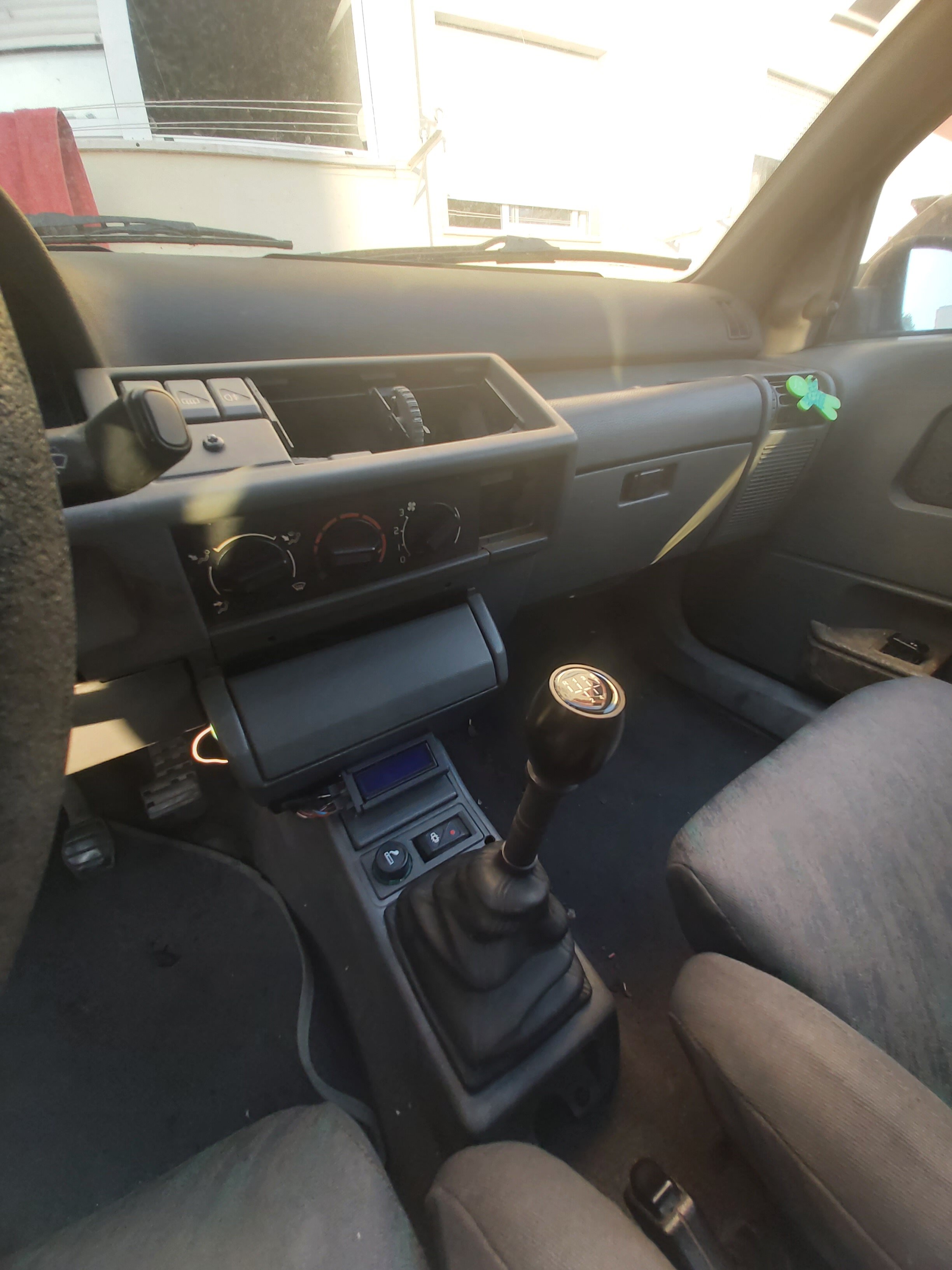

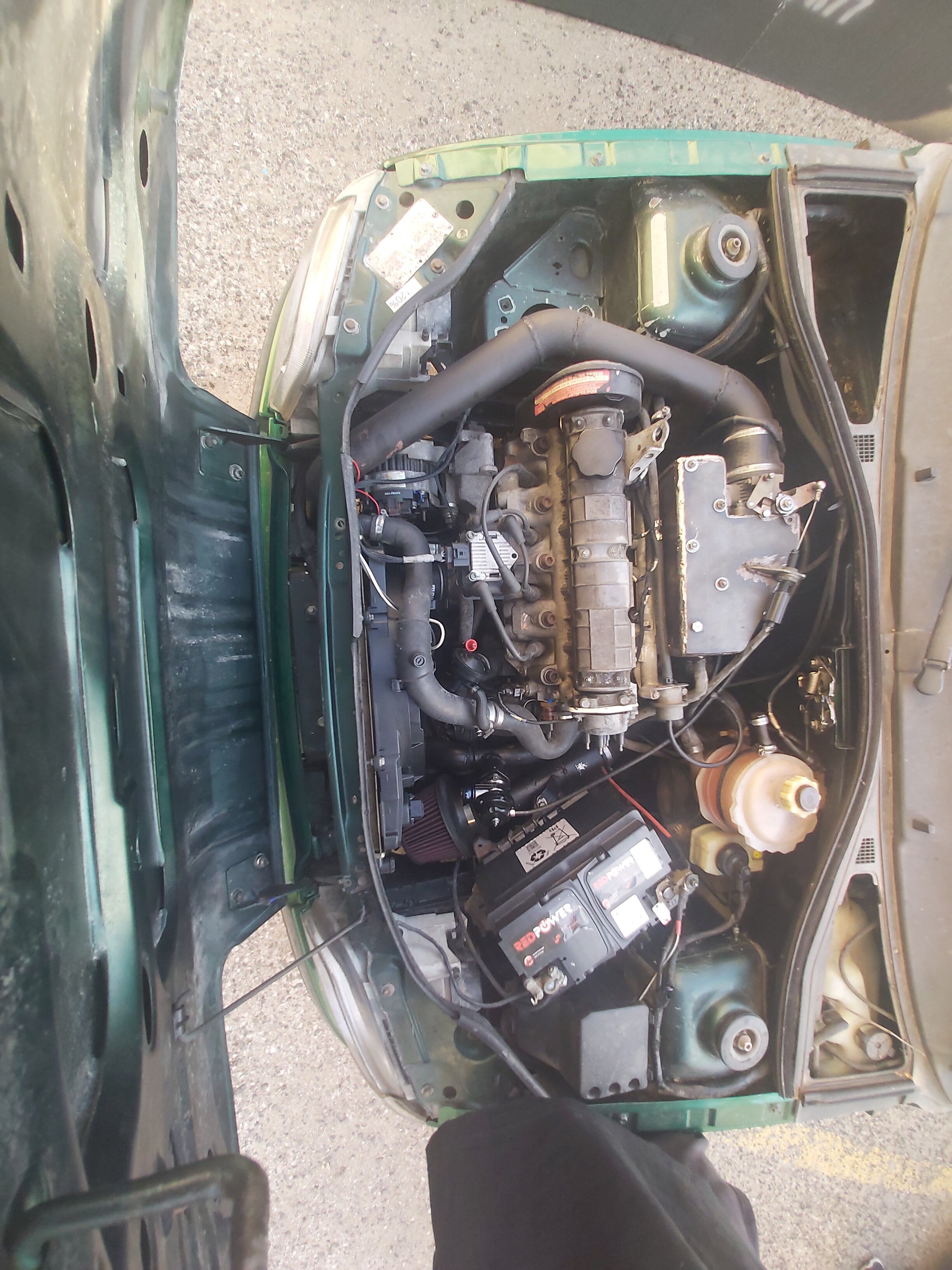

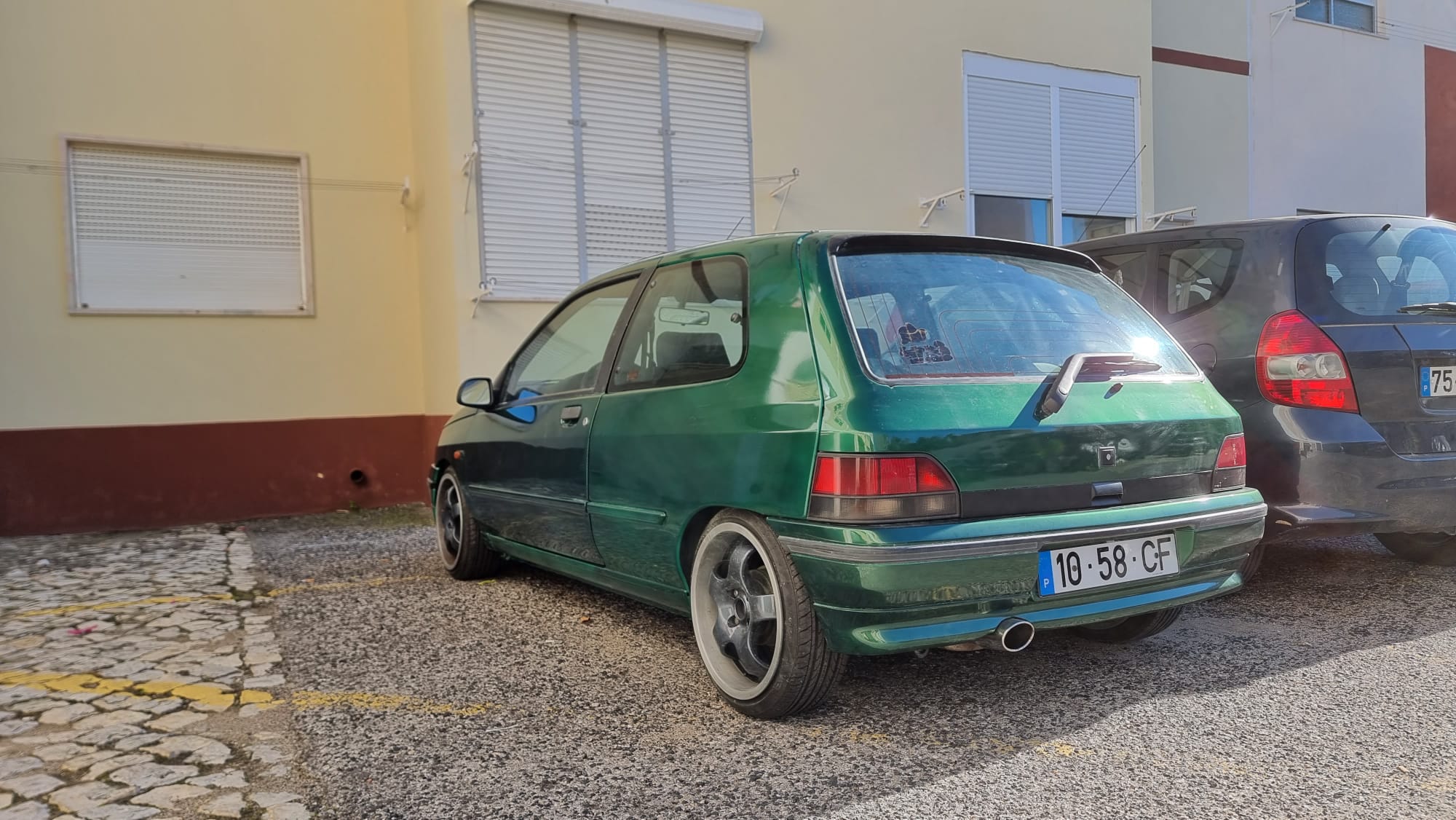

Hi, Im new here, I have 1993 Clio S with a Volvo 480 turbo swap and I want it to have Williams Front Track, Does the Subframe Add up to front Track or is the wishbones that makes it wider.
I will leave it here some pictures of my Clio
