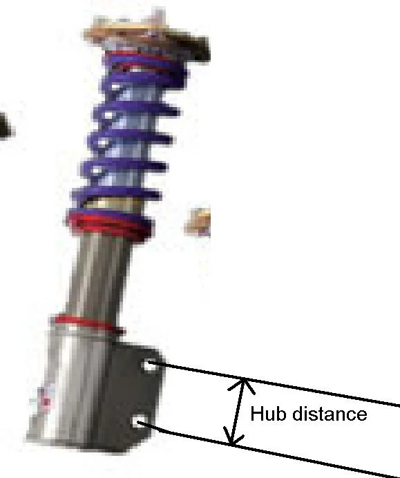

Just stick the wheel on full lcok and measure the bolt distance on the hubs only take s asecond or whats your cars details all Mk2 2 clio none RS are 58mm apart from some early 1.2's.

Nope only way to be sure it to measure the distance from the center of these two bolts on your damper.
