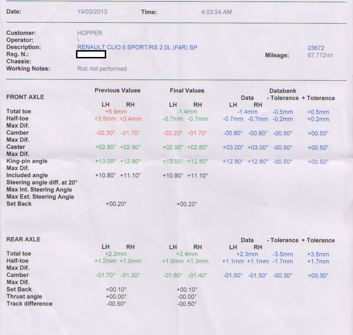

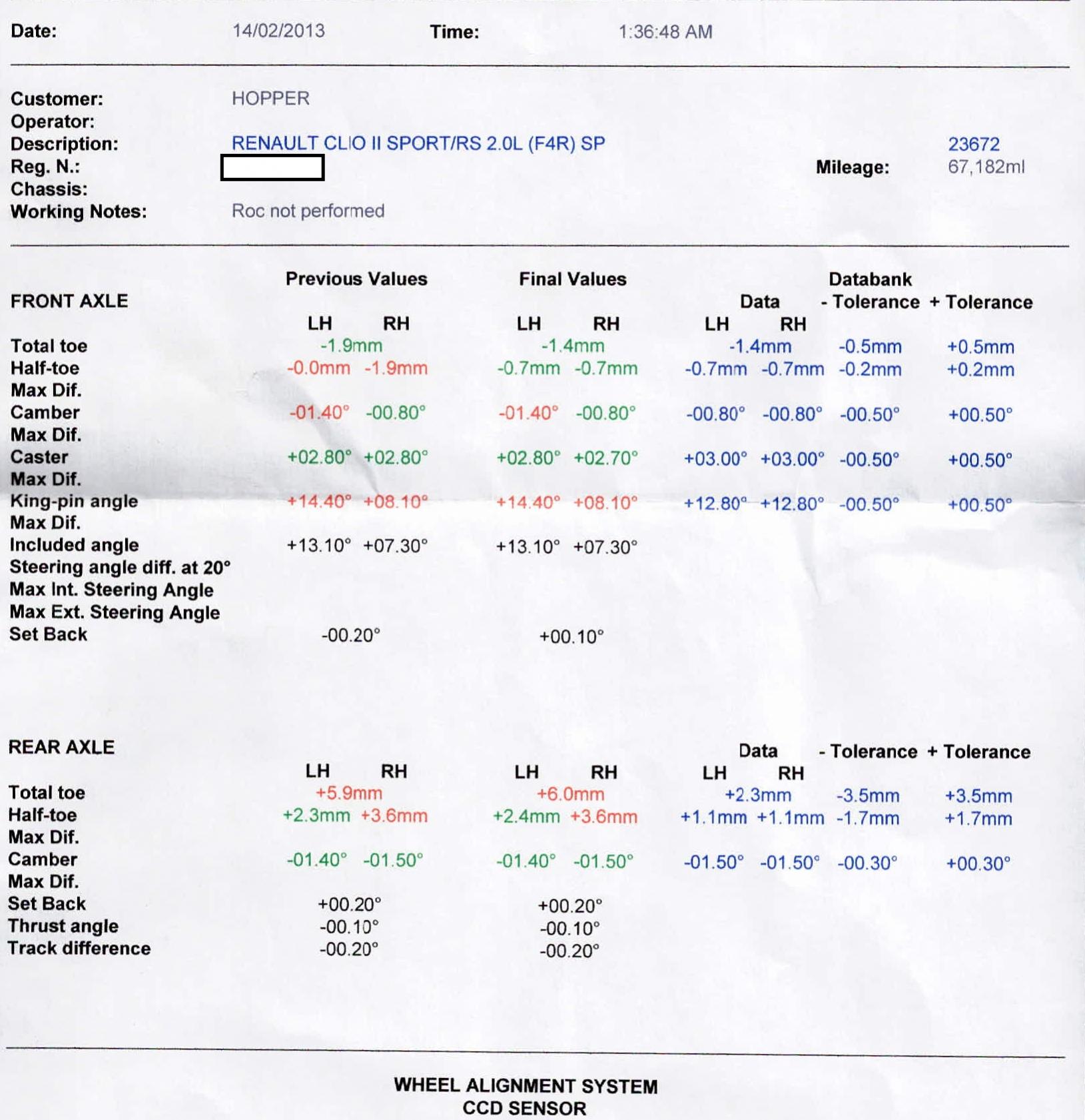

Hmm........something is amiss with wheel alignment results. :S
I am scanning it now and will upload asap
J
Feb_Alignment - before any suspension work
Mar_Alignment - after shocks, top mounts, inner track rods, tre's, bottom ball joints
Why is the camber so borked after the NEW suspension is fitted when one side in Feb was within tolerance? :S
Why are the rear axle measurements so bad in Feb yet in march they are fine, when i did NOTHING to the back?
Hellllllllllllllllllp
J

The fact the rear has changed so much (unless you have had a crash) proves to me that they arent getting accurate readings, Im convinced that the main thing wrong with your car is they have done the tracking wrong TBH.
I would take it somewhere else and get it tracked, after checking the wheels are straight.

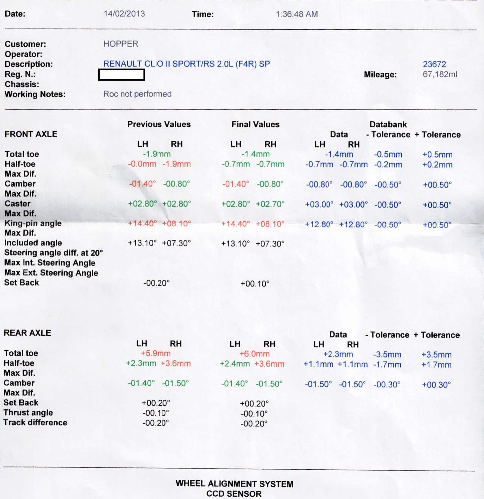

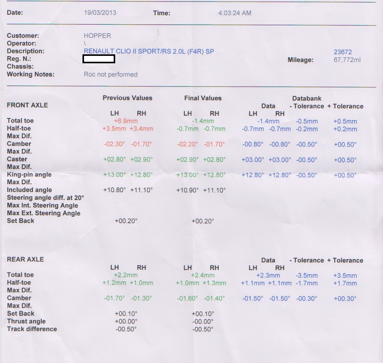

J

Tempted to put the above charts to the company who did the tracking and ask for my money back......why should I pay for that?
J
Would be reasonable thing to do IMHO, nothing to lose by trying as lets face it you probably will not go back there again anyway. Although not really their fault if your wheels are buckled, so I wouldnt go being all shouty about it.

But would that have affected the crackerjack values on the rear and would such a small wobble affect this?
Just to be clear, the front face of the wheel doesn't move at all.
Its the inside lip at the back of the wheel where spokes dont live that has a bit of action.

Sorry I just realised I was reading your printout wrong and the rear hadnt changed.
So -1.5 deg rear and -0.8 front is recommended camber?

Right, just back from the tyre place.
They stuck it on the machine and spent a bit of time on it. They really are trying to help.
Car is still wandering. And the camber is still bucked :/
So, what am i left with? Something surely has to be bent if shocks were replaced and i have a camber issue, top mounts and bottom joints replaced too
Hub carrier?
Bottom arms?
Subframe?
​J
Am I going to have to resort to camber bolts to fix this standard suspension setup or is that a pikey fix?
What would be the most likely candidate?
Could the KYB top mounts cause this?
That and the shocks are the ONLY thing that has been changed on both sides
​J
Check you have a matching pair of bottom arms, ball joints and check the subframe. Other than that its bent hub (unlikely) or the front corner has been in a bash and not jigged right.
FYI a new strut won't and can't affect camber unless its like a banana which your going to notice pretty quick.
