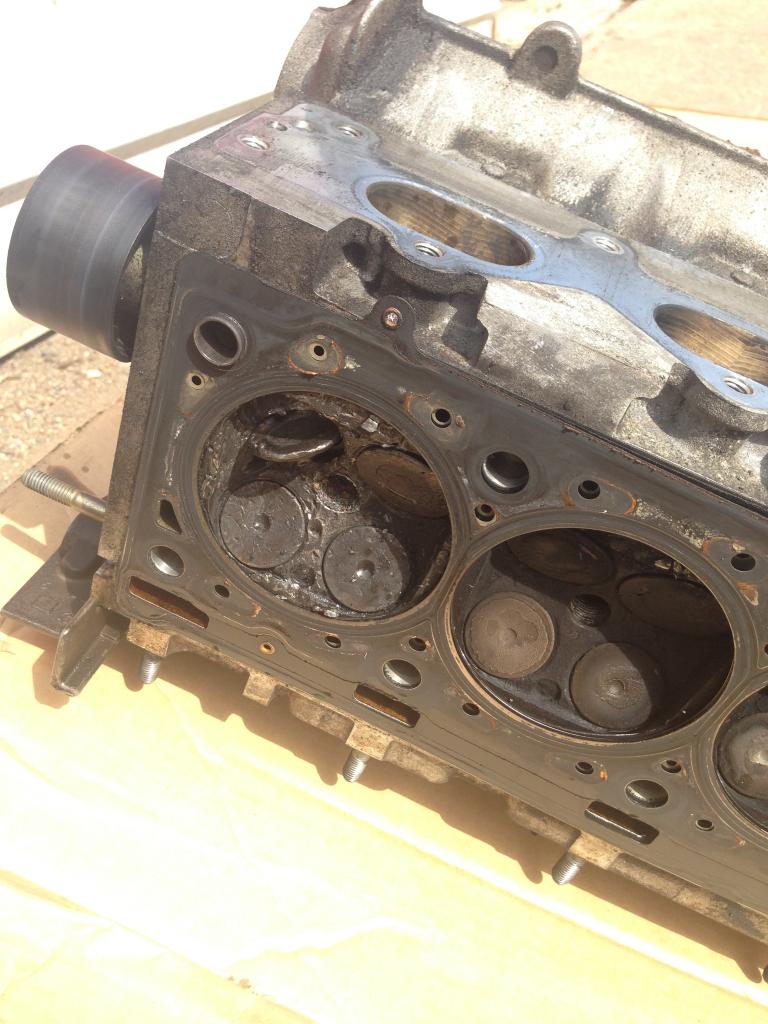

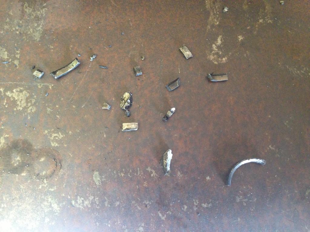

Well all is finally good, new engine fitted and mapped. So I thought I would share a couple of pics of the damage with you...
I will be buying Supertec valves for my head.
Gutted for you matey but glad you've got it sorted.
