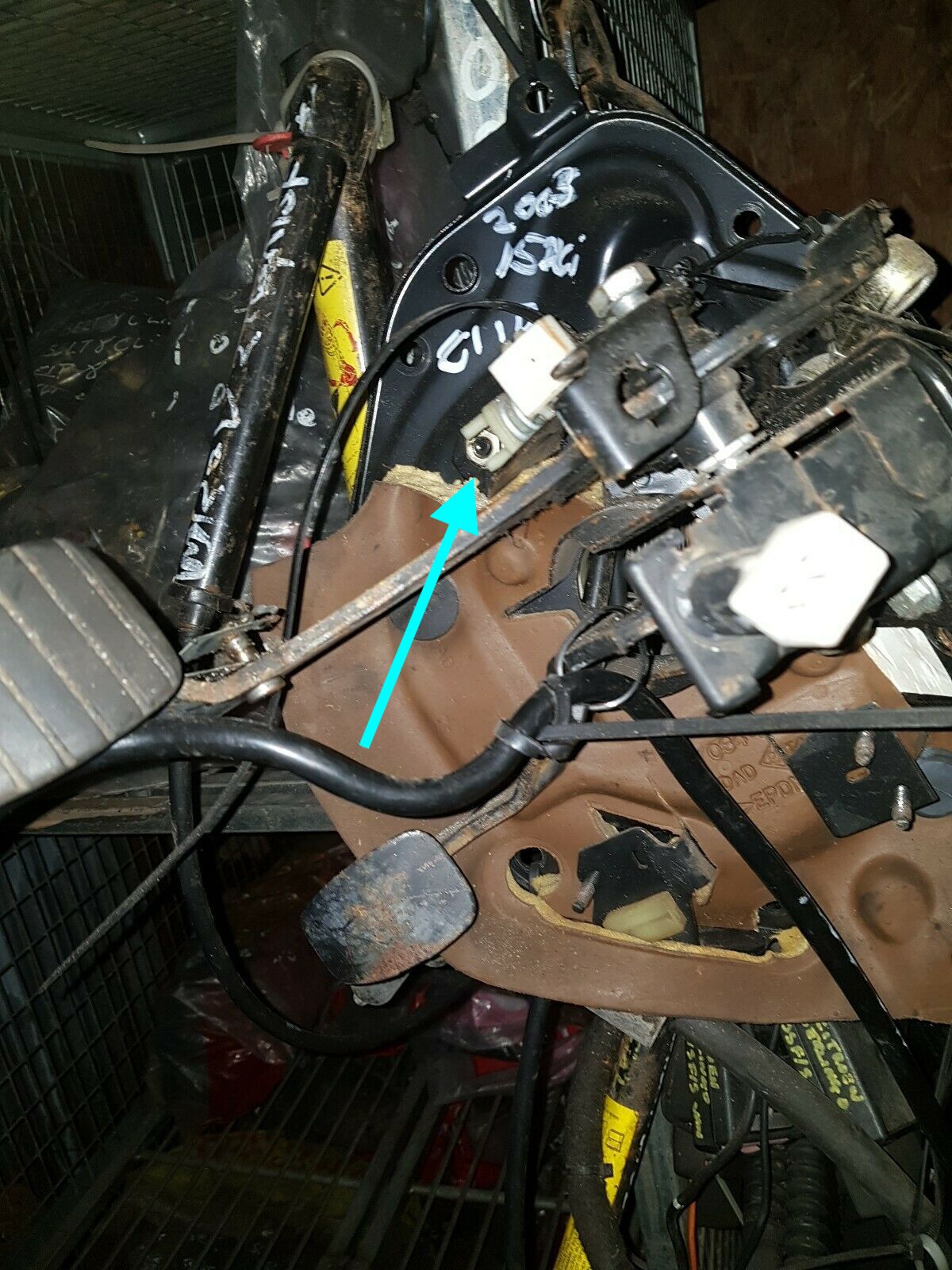

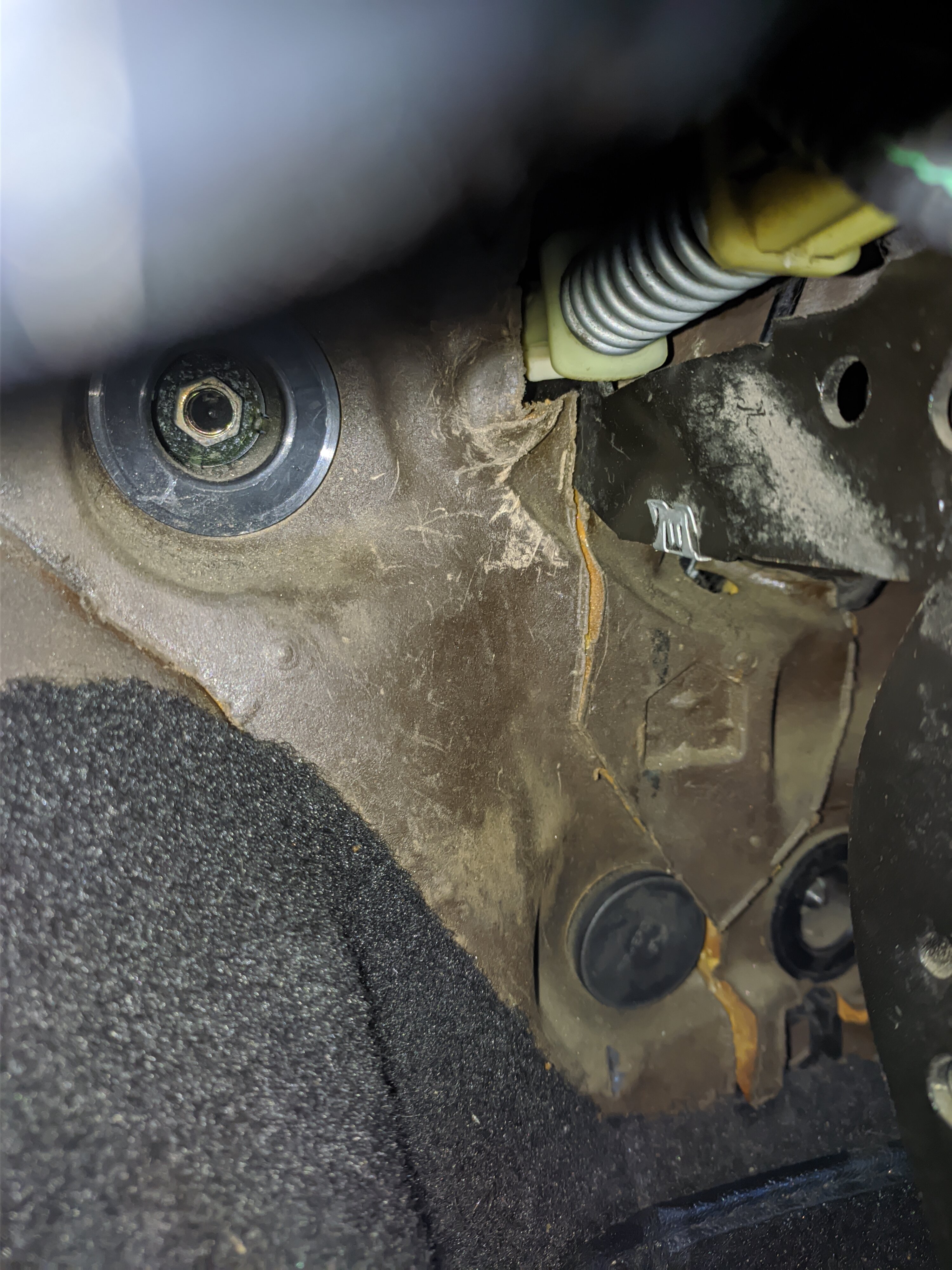

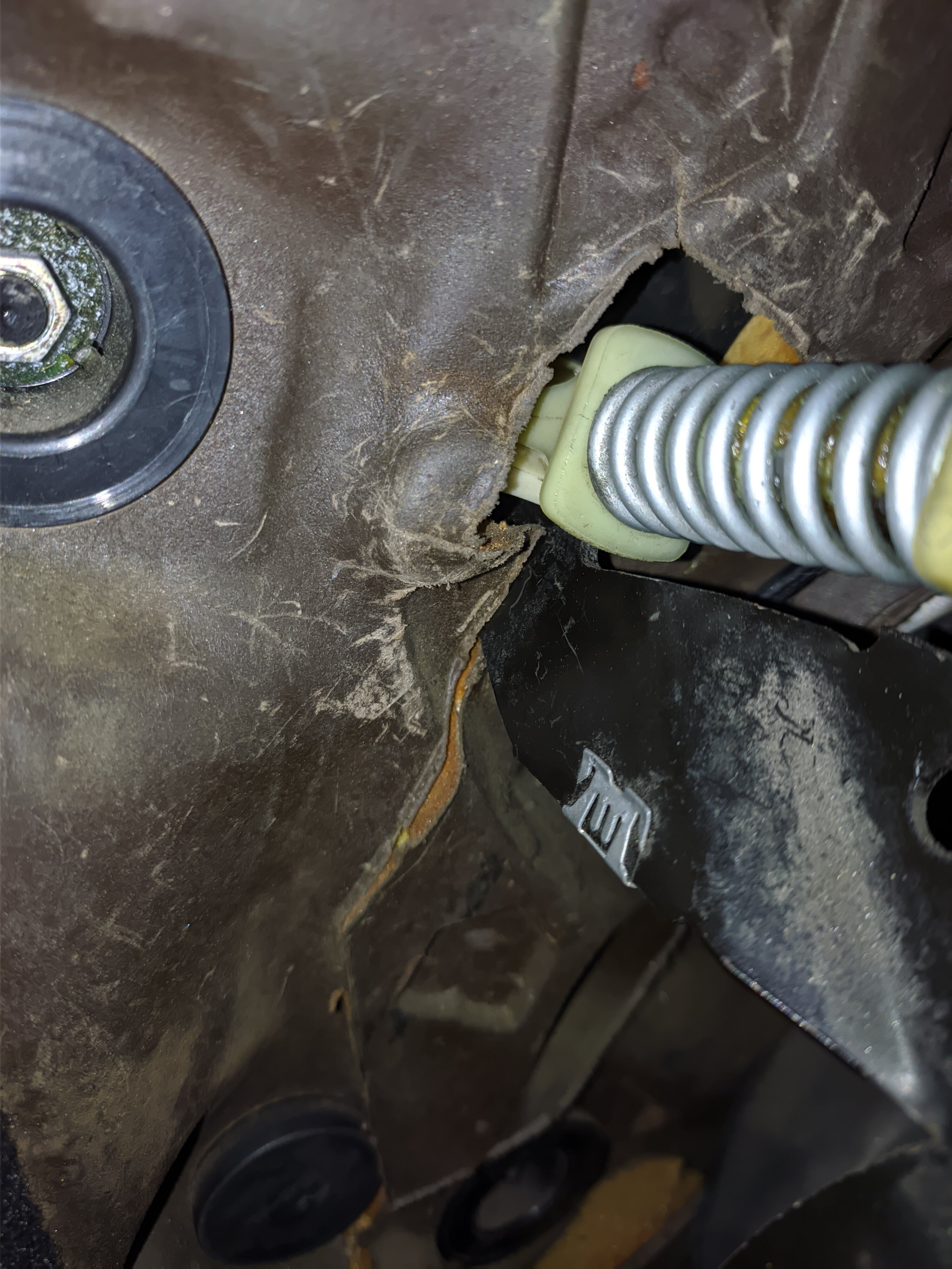

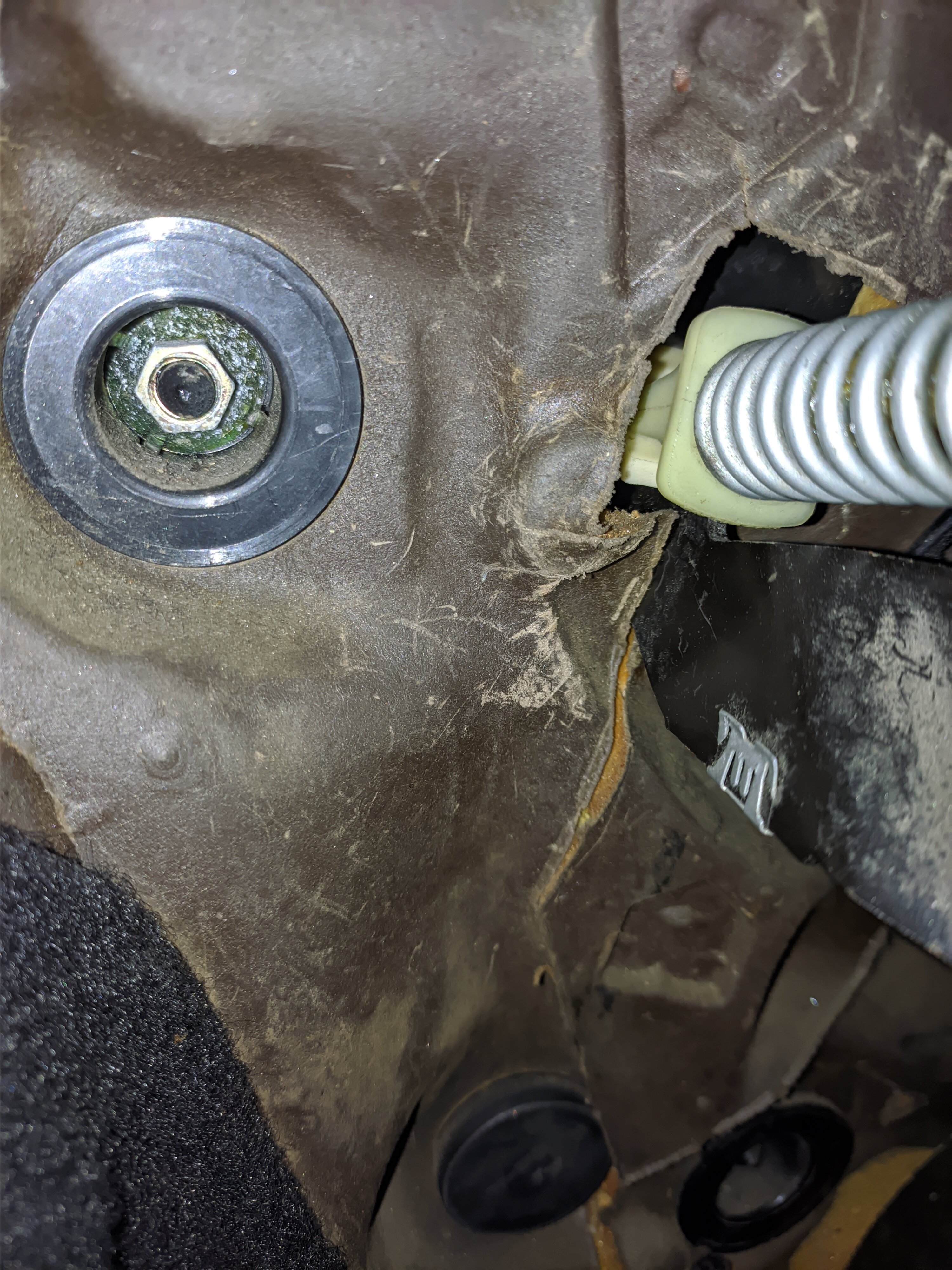

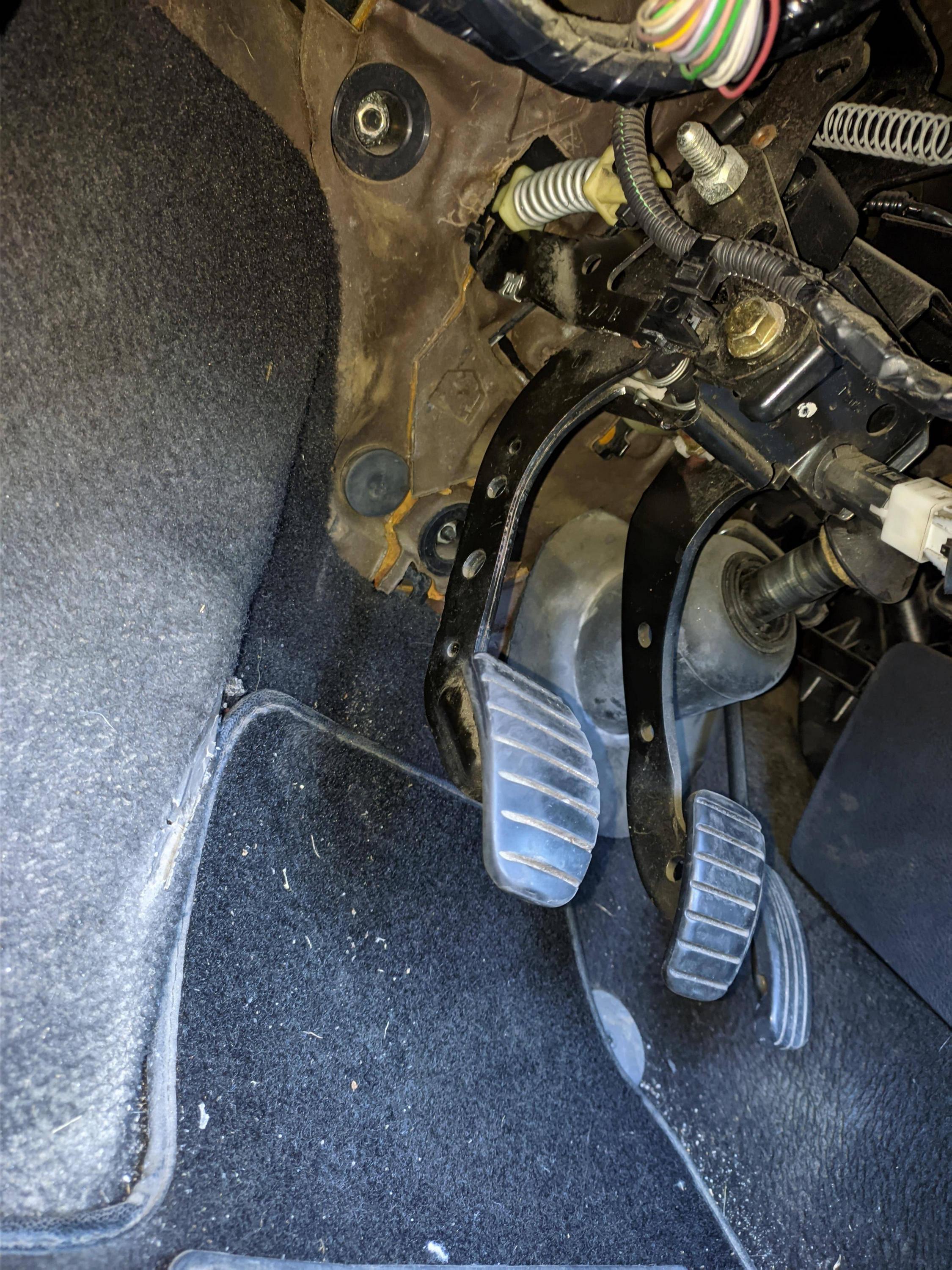

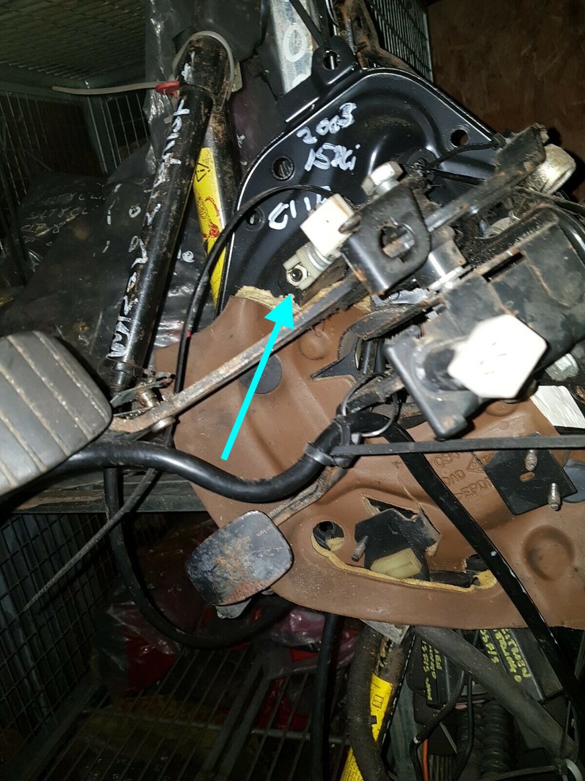

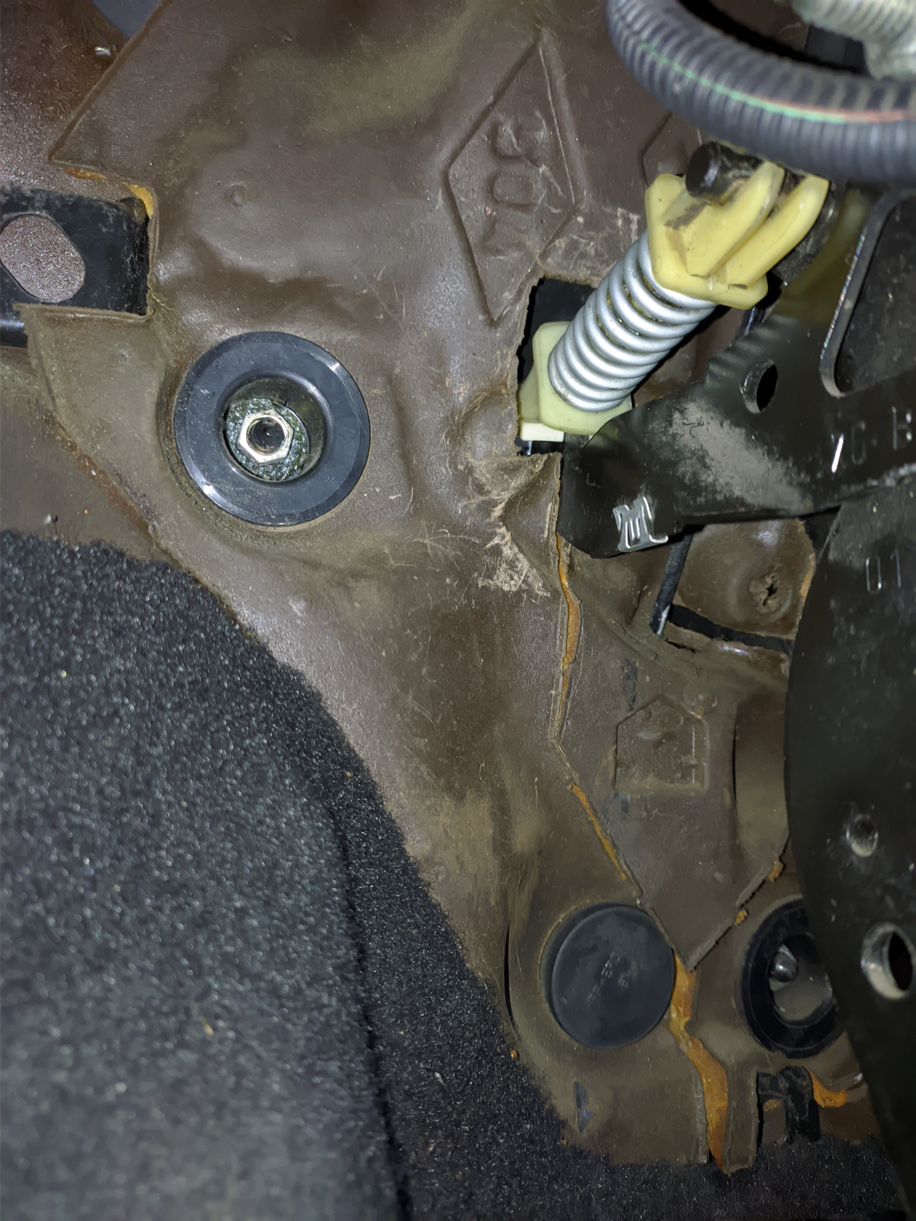

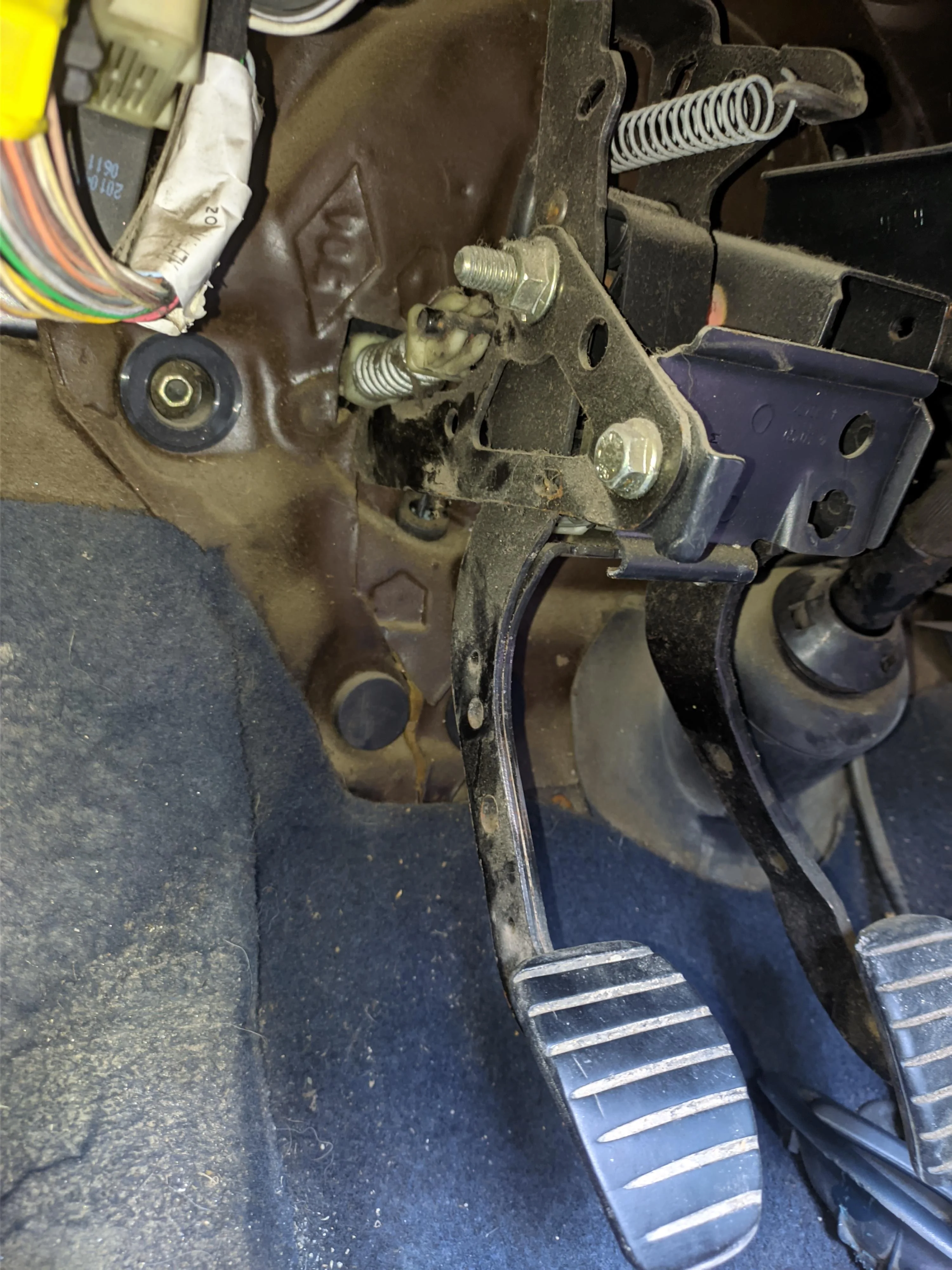

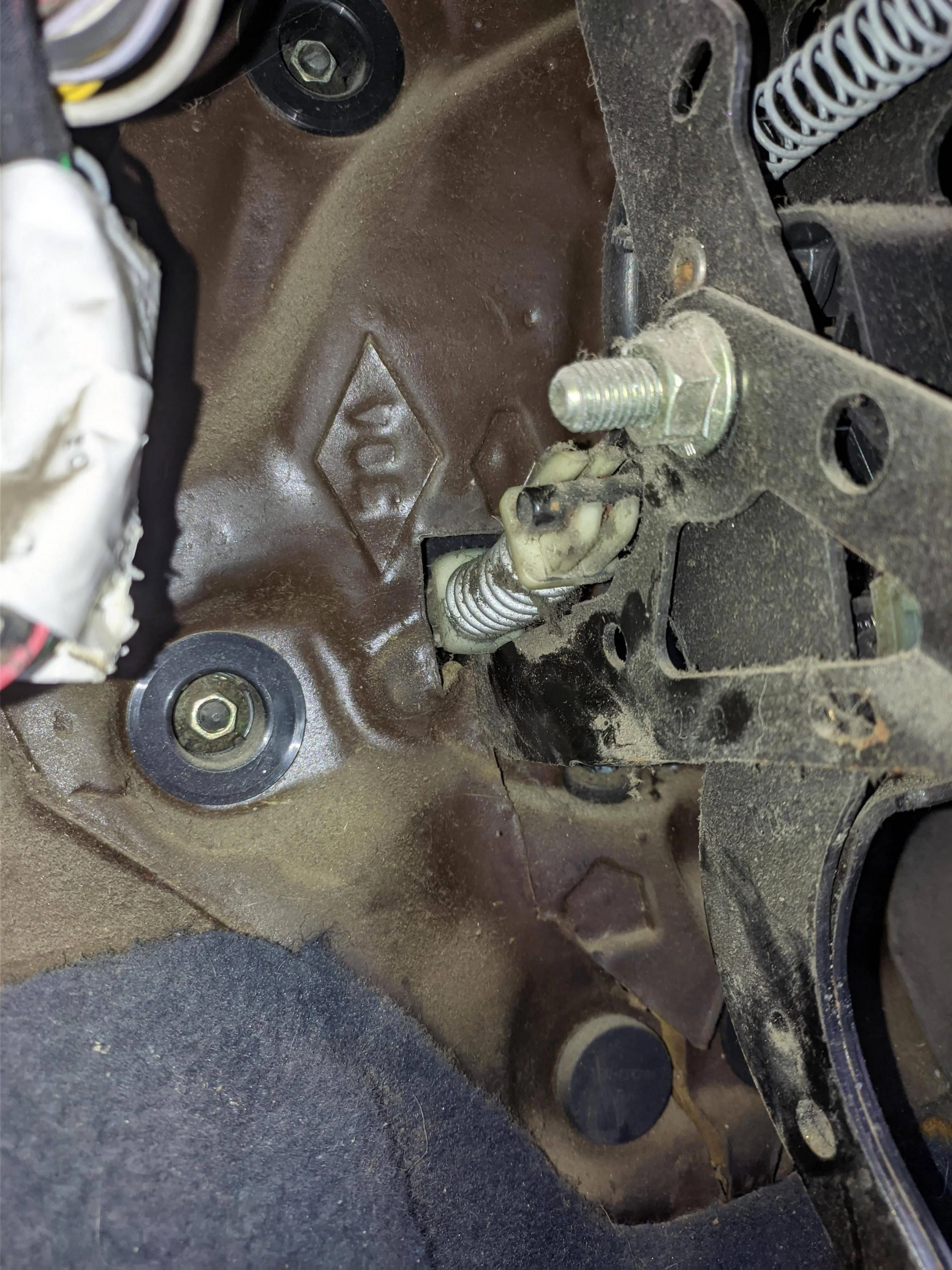

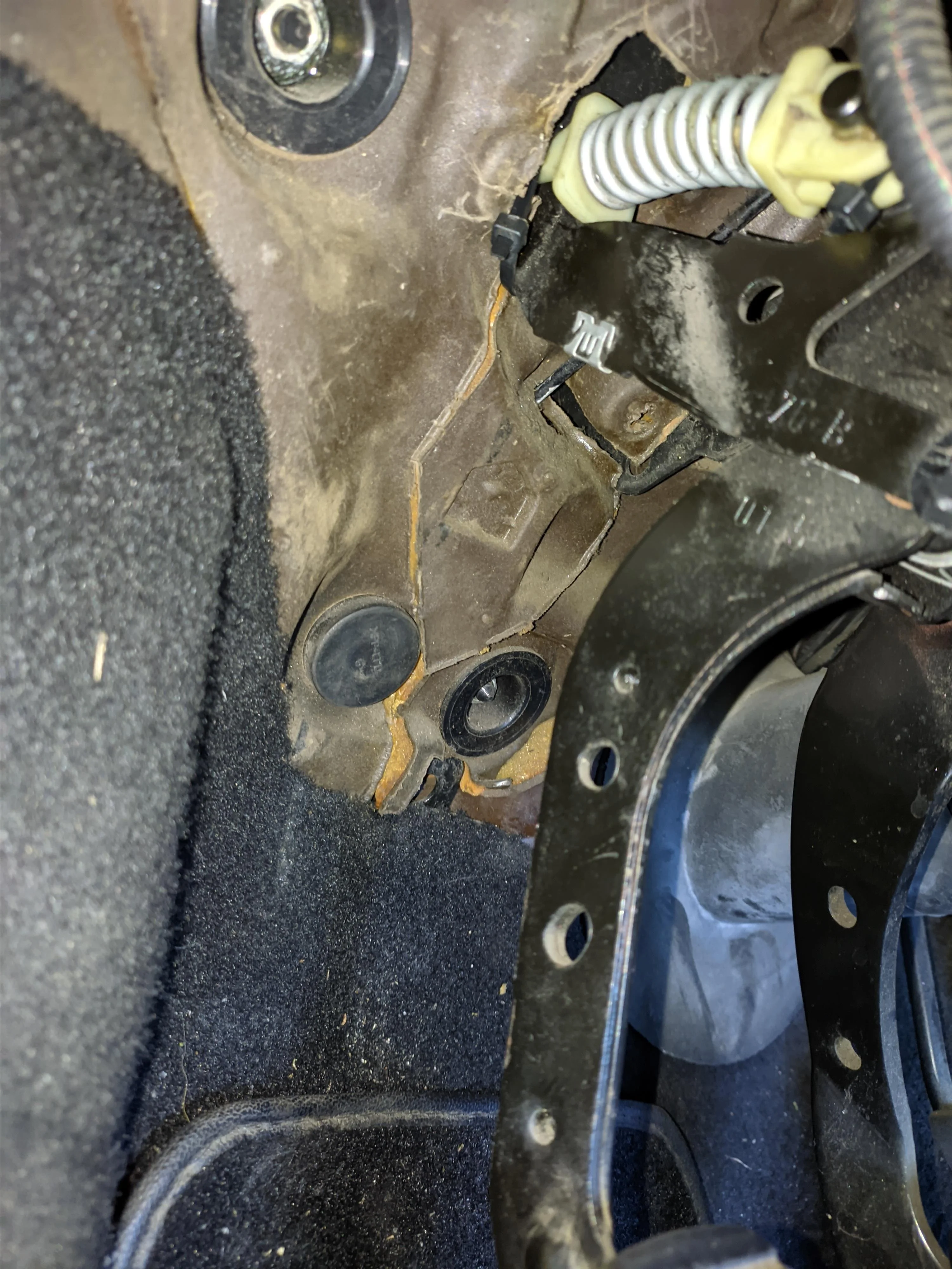

Problem solved, pictures for future readers because i could not find this info anywhere online, got the part at a scrapeyard for 2€ because renault said it was discontinued and no stock was available. (it was 5€ at renault if it had stock apparently) . P/N confirmed: 8200700275
3 pics how it looked on the scrapeyard car BEFORE removing it.

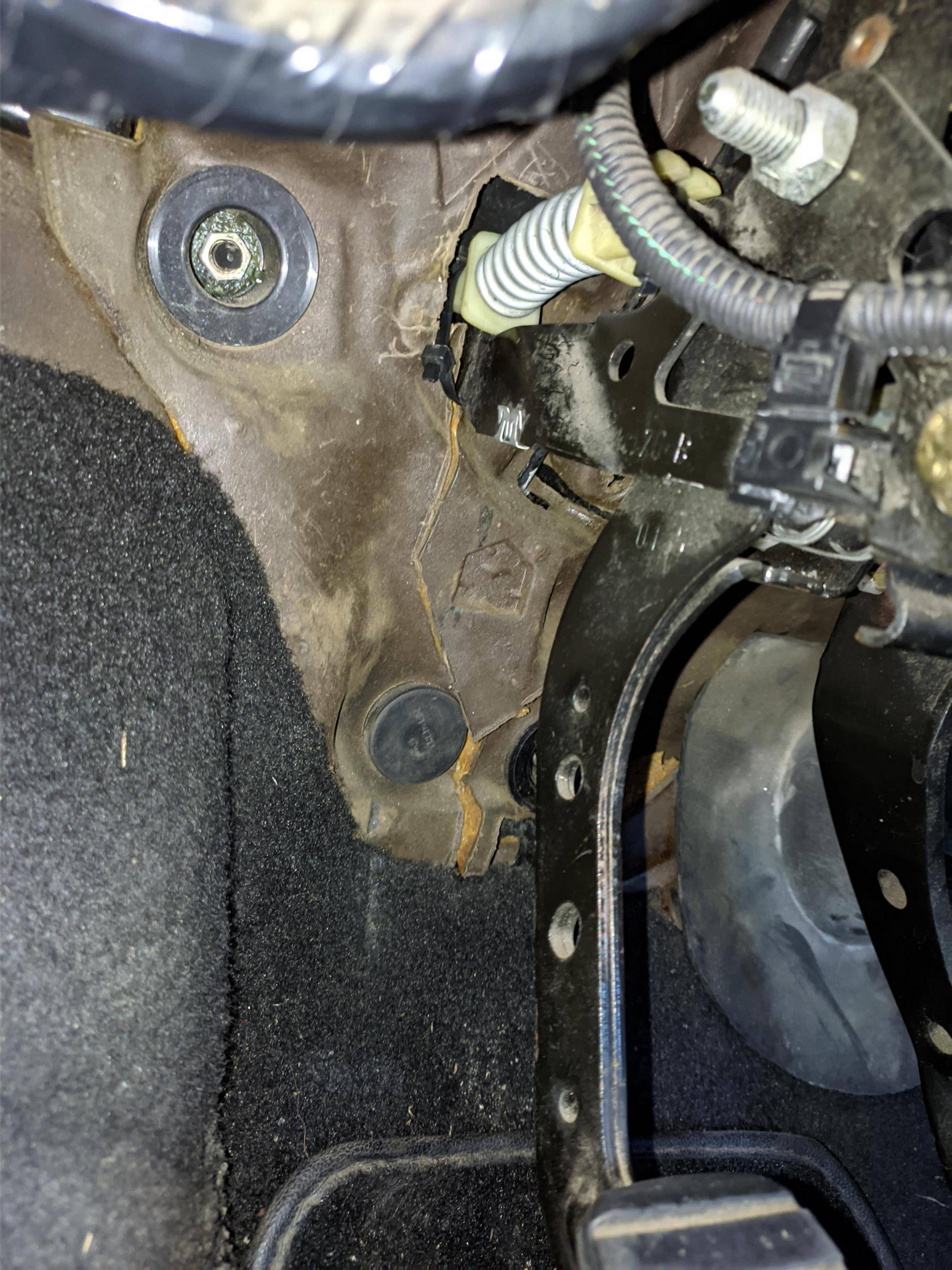

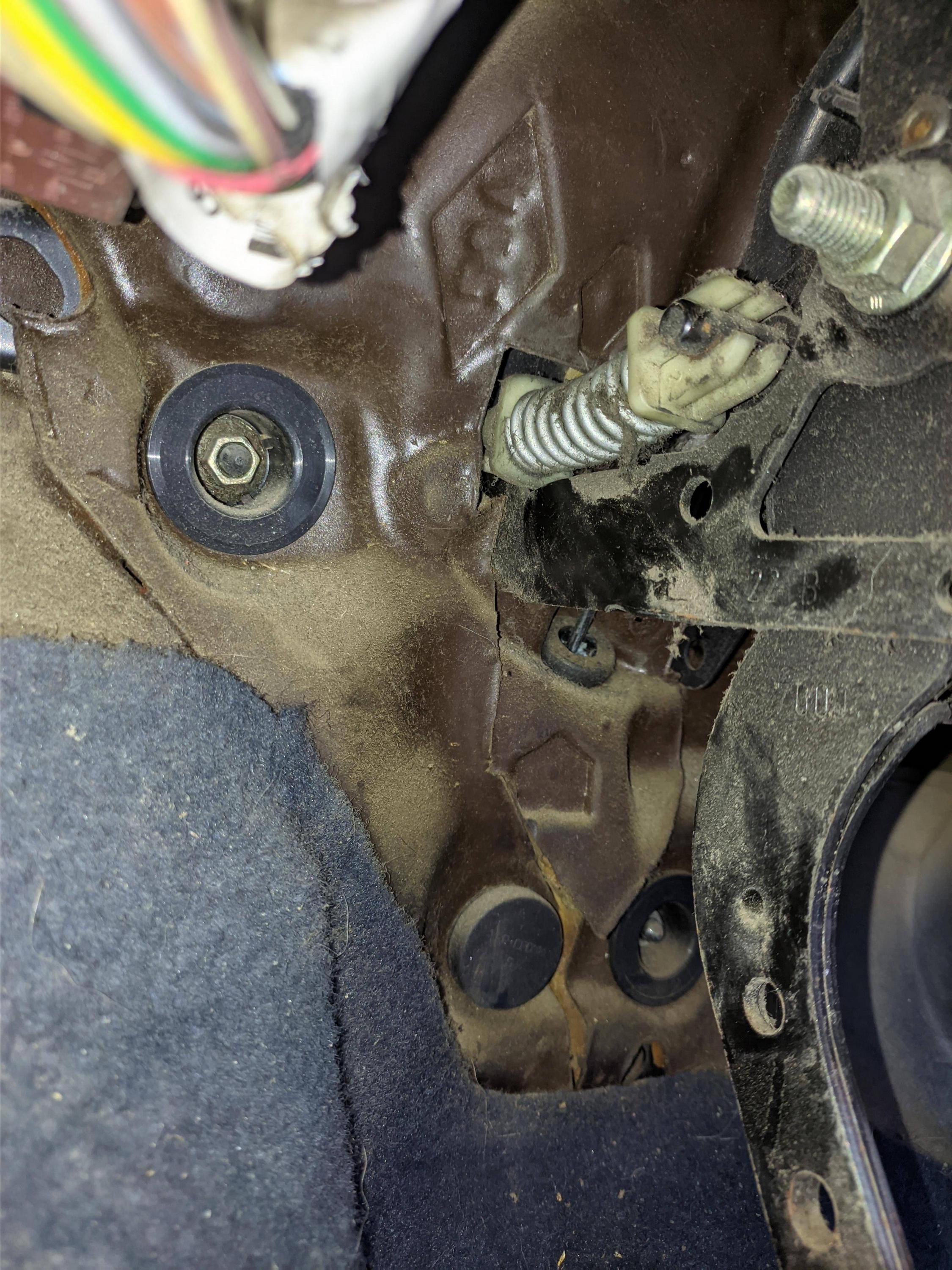

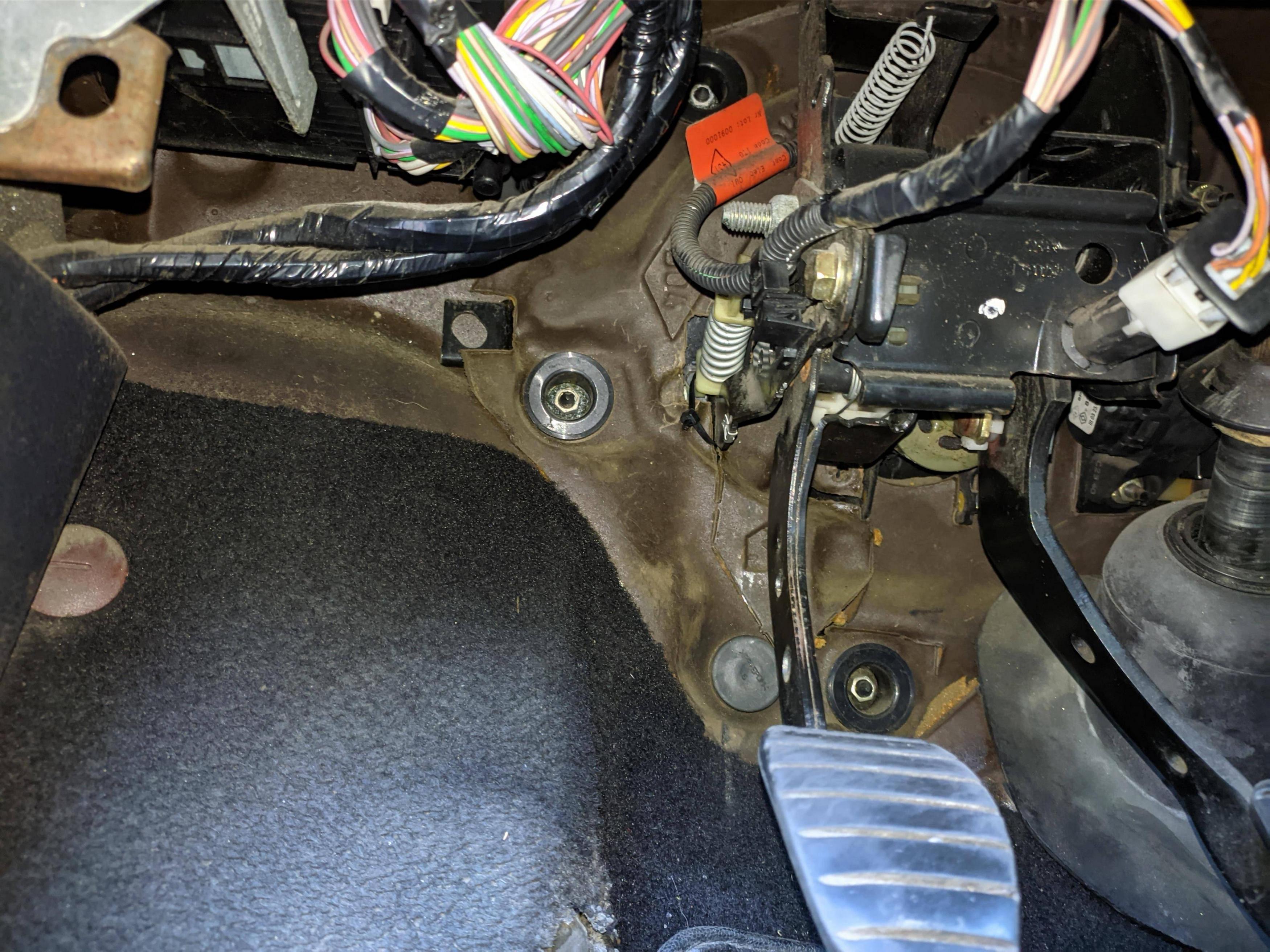

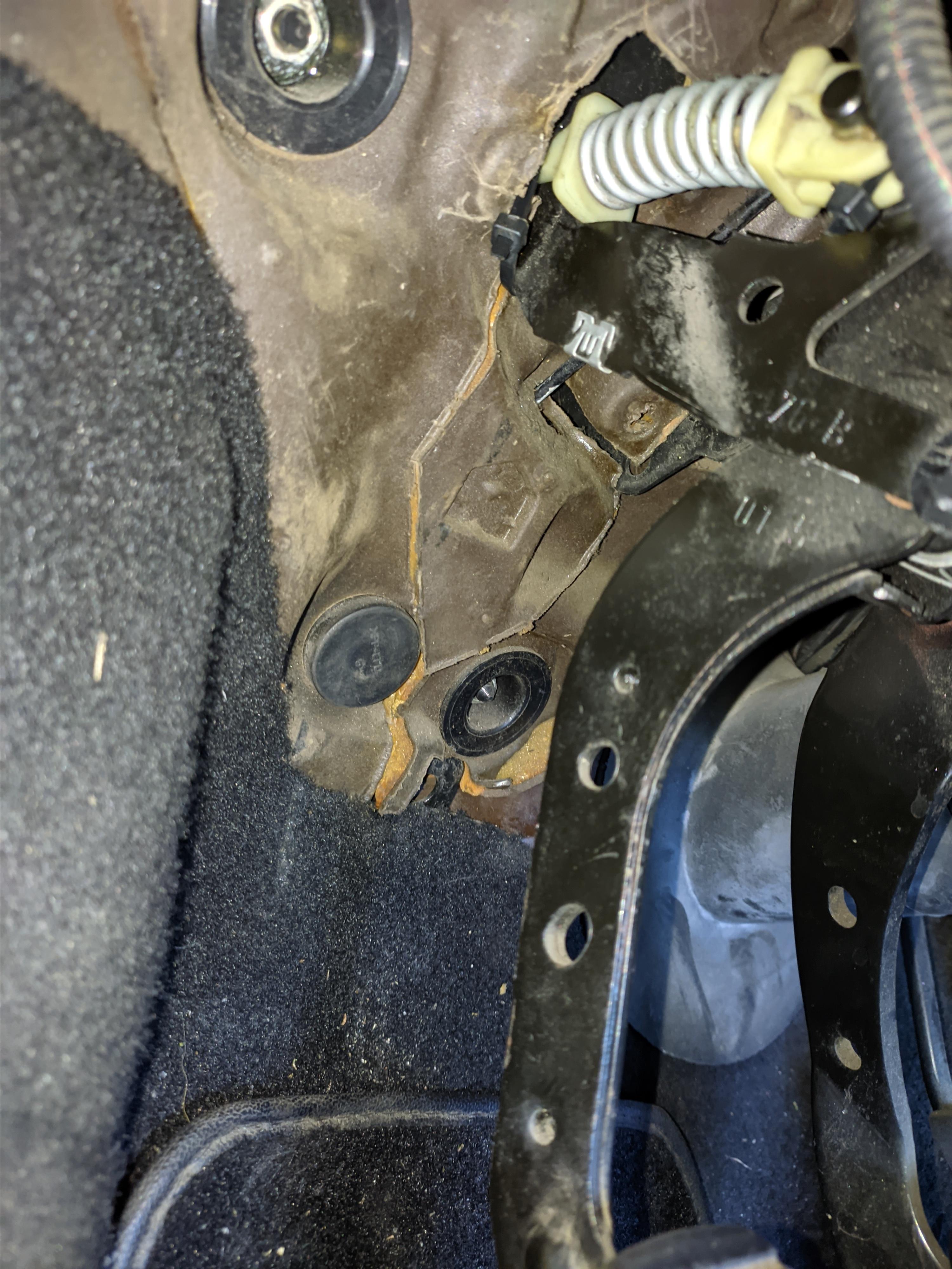

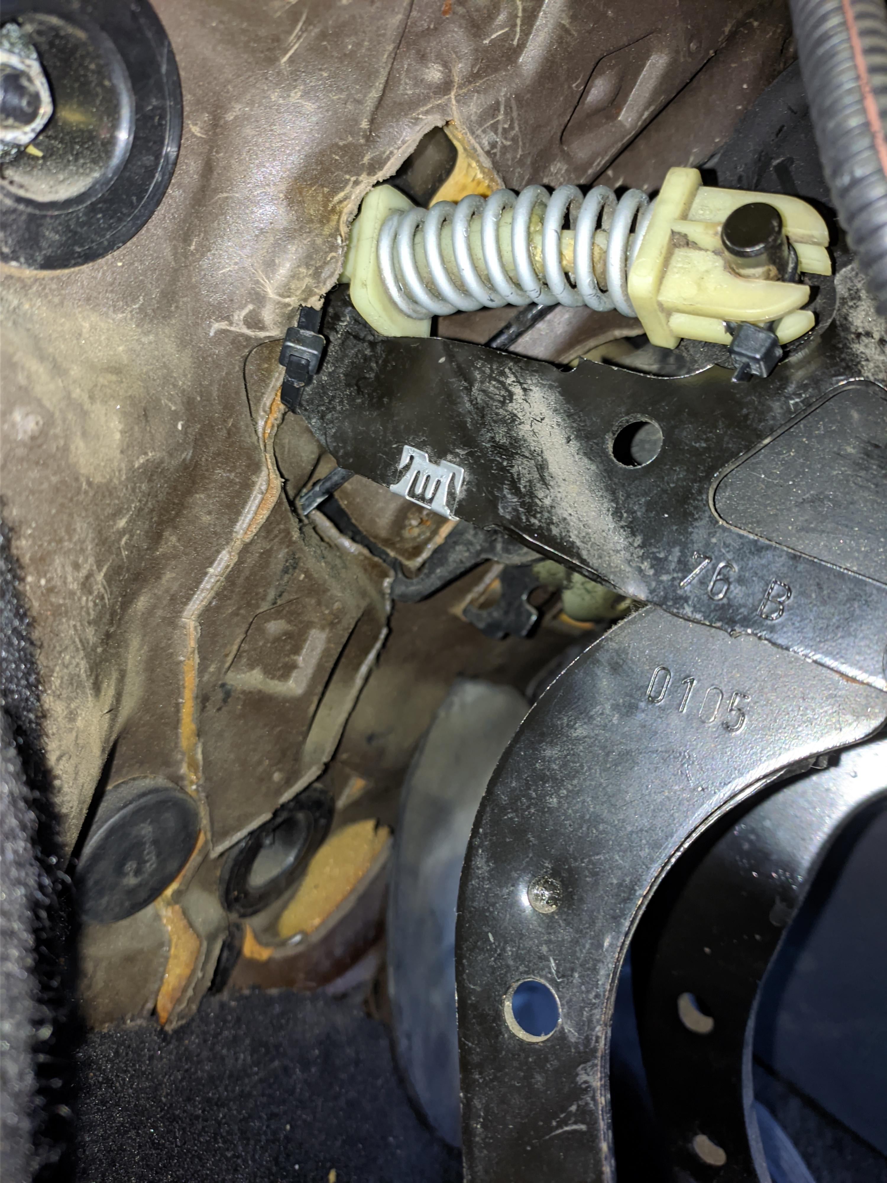

Now 5 pics in my Clio mounted;
It was easy mounting it (idk why the 2 mechanics i went didn't seem too interested... anyway, you just pull the pedal down and the spring mounts without you having to do any pressure on it (spent like 1h trying to put it doing pressure, finally did it using a ziptie while pressuring it :D (after realized i didn't have to do it)
Now... i added 2 zip ties, one on the bottom to try to force the spring to not move because apparently that's the spot but there's no "clear mount", there's a piece of like a *mount* but when you decompress the spring by pulling the pedal down it allows it to jiggle a little bit (maybe the spring is a bit worn out idk) , and it would pop out out of place while testing it, (same thing that happened with the original i had probably, idk if something broke on the mount but i can't remember at the time) .
So, after mounting it i went to test the car and my god it's a f**king difference when putting the gears, that bit of spring makes the 2nd and 3rd gear mostly even more smooth than it was, and i don't have to go "easy" on the pedal and rev-matching all the time for it to seem smooth...
Strange thing how a part this important for the clutch gets dismissed by 2 mechanics in my area... goddamn, my clutch has almost 2y and has been suffering since then, i remember the spring fell out like 5y ago when i had a bad clutch which was heavier and finally got replaced like 2y ago.
Writing this to close the topic on this misterious spring only DCI's with cable clutch have between 98-04' (this actually came from a ph1, mine's a ph2.

There is a bit of plastic (the other end) that is the support for this spring, there's no zip ties needed, it fits perfectly.
To put the spring there, i had to force the spring down, hold it with one ziptie (ziptie is strong asfu**) , then put it in place with the support, and cut the ziptie and let the spring release like in the pictures.
It hasn't fallen off yet and it's been like 2months
