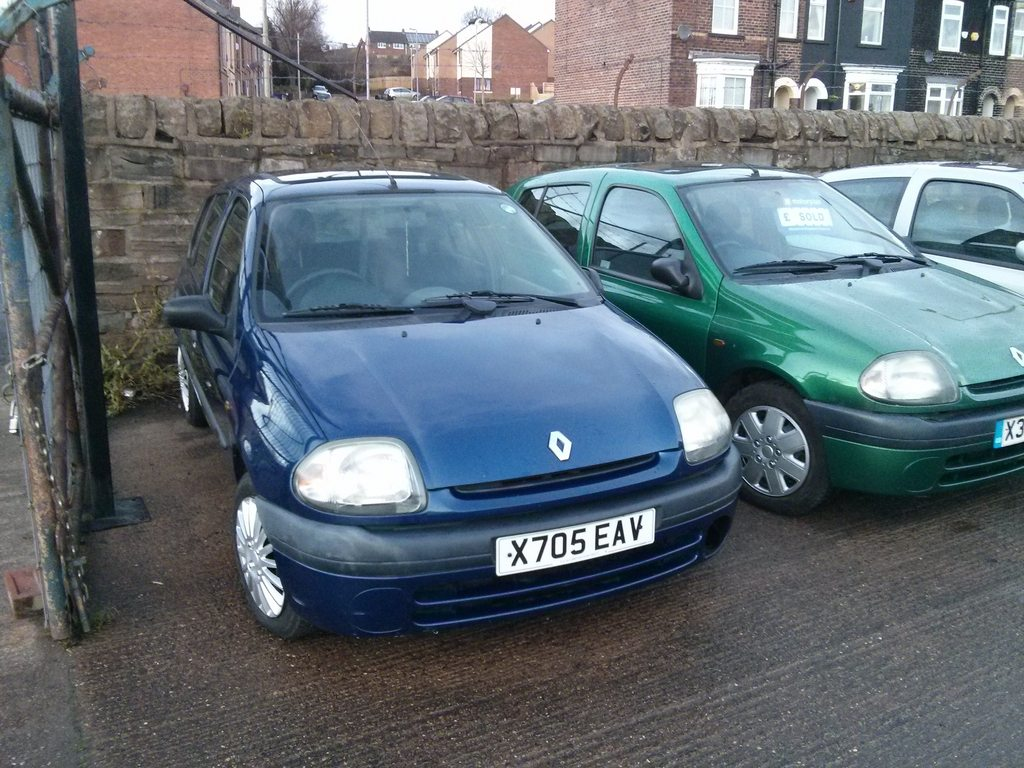

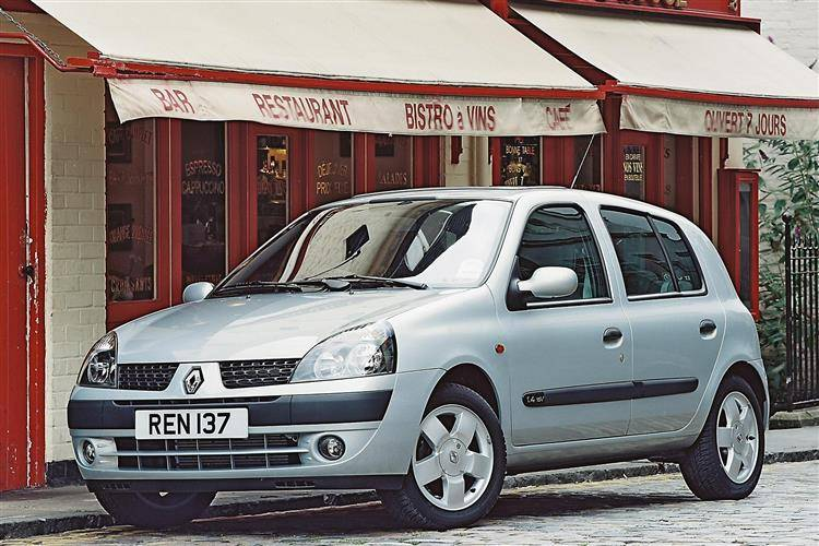

Mk2 ph1 has a front bumper like this:
Mk2 ph2 has a front bumper like this:
Easiest way to tell.
