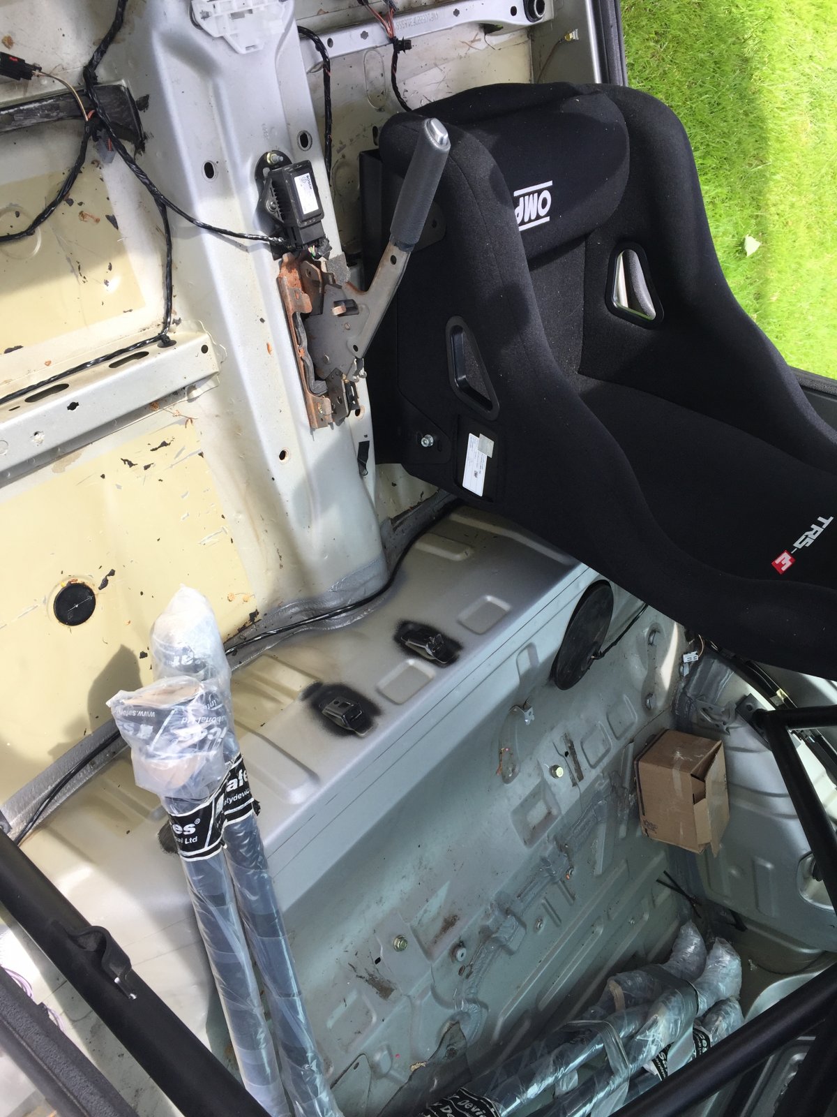

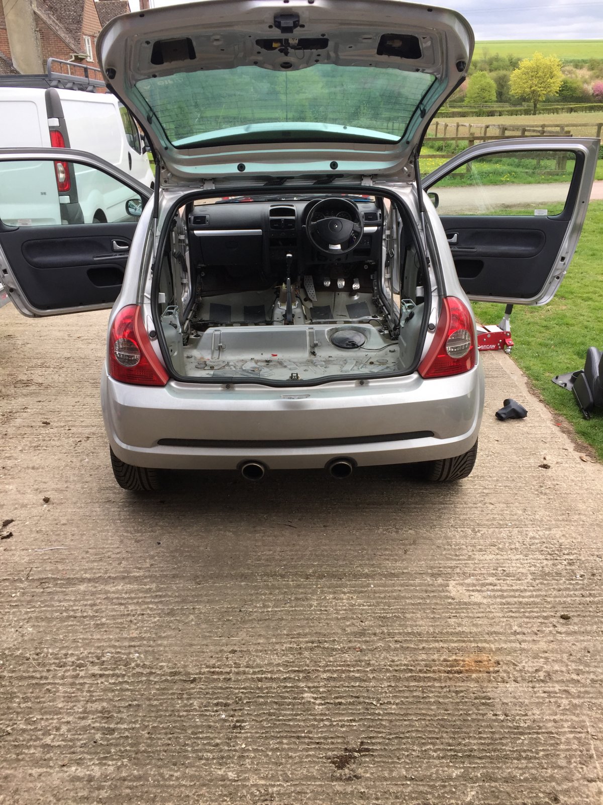

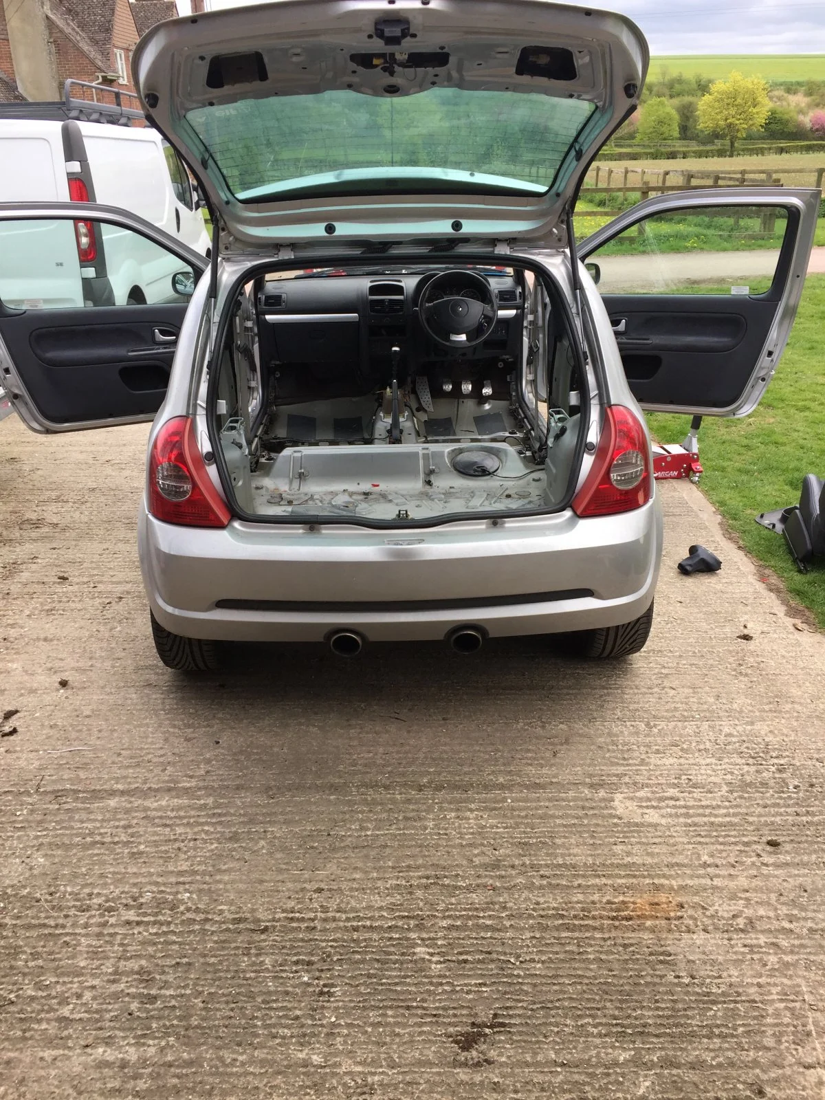

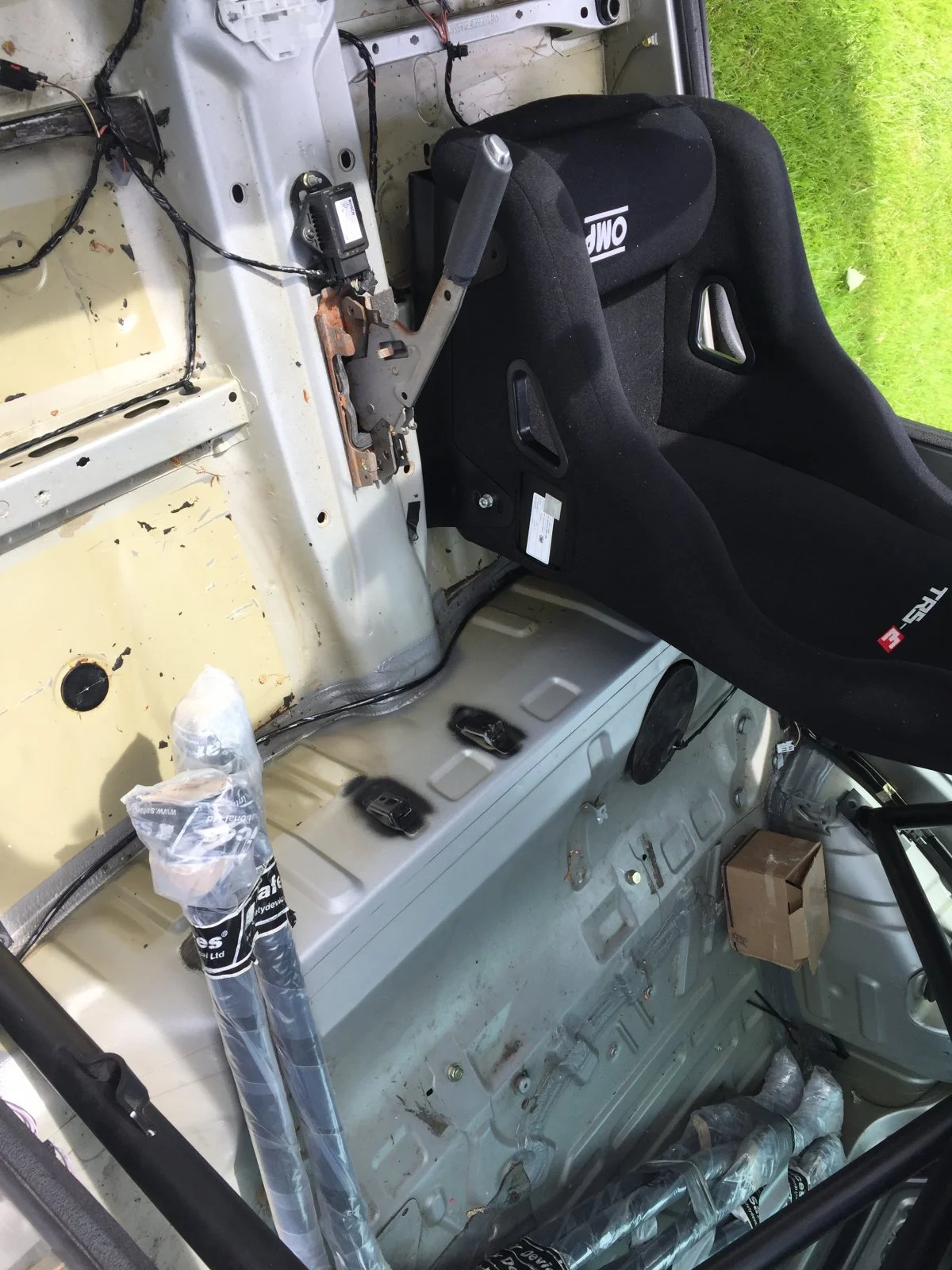

My 182 was my daily for a year then it came off the road and sat in my garage. Then I decided I needed a track car to go alongside my race car. It's currently away having the safety devices RO17 cage fitted. I decided this would be sufficient for me as I don't have a desire to race this one as I've got the ZR for that!
I've got ready to fit an OMP bucket seat with scroth 6 point harness and Sparco 330mm steering wheel. It's going to be a fast road/track day car so I'm going to be keeping the cup suspension with cooksports for now. I've fitted some Pure Motorsport 10mm stub axle spacers, and running 15mm spacers on the front. I've fitted some camber bolts on the front. I need to order a stud/nut conversion from PMS. I'm going to be running standard 16's on track primarily because I've got a surplus of used Dunlop direzzas from the race car in the right size. It's being setup by Preptech UK who are also fitting the cage. It's also already for brembo hc discs with ferodo DS2500 pads.

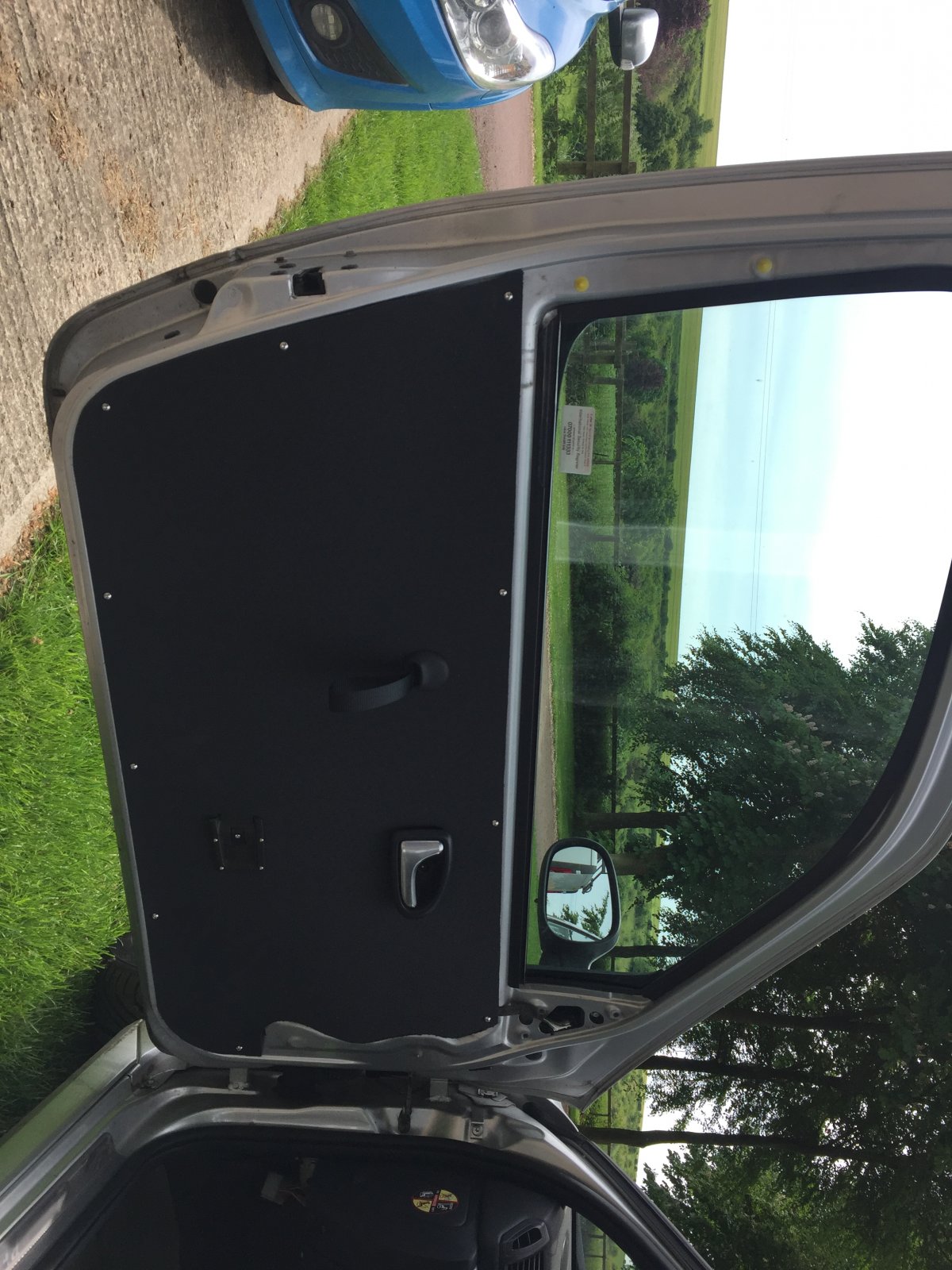

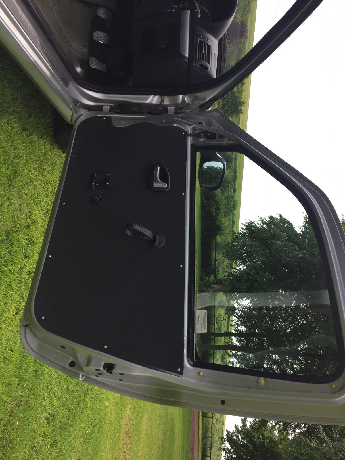

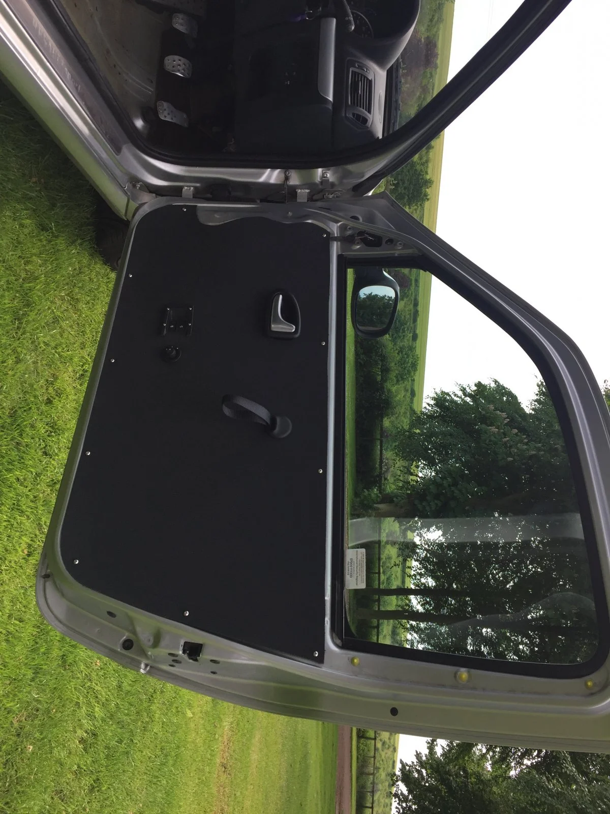

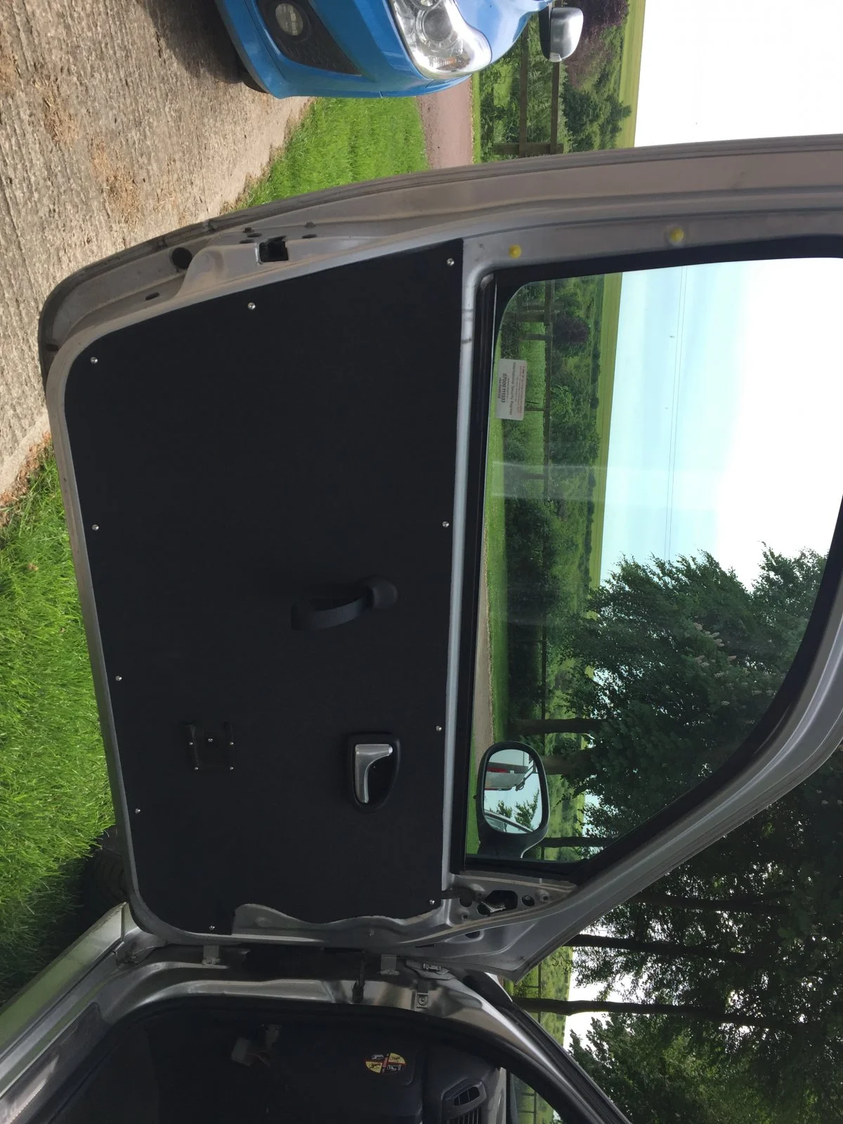

I've fitted new door cards from @RS-doorcards. Really easy to fit and look great, recommend them!
Once all the interior is done and cage is in I'll whip the engine out, sort the leaky sump, maybe fit some arp rod bolts and fit a new clutch.

Picked the Clio up yesterday from having the cage fitted, it's the older RO17 safety devices full cage. Perfect for my needs!
Also while there it was there I had some harness mounts welded in and flush aero catches fitted!
