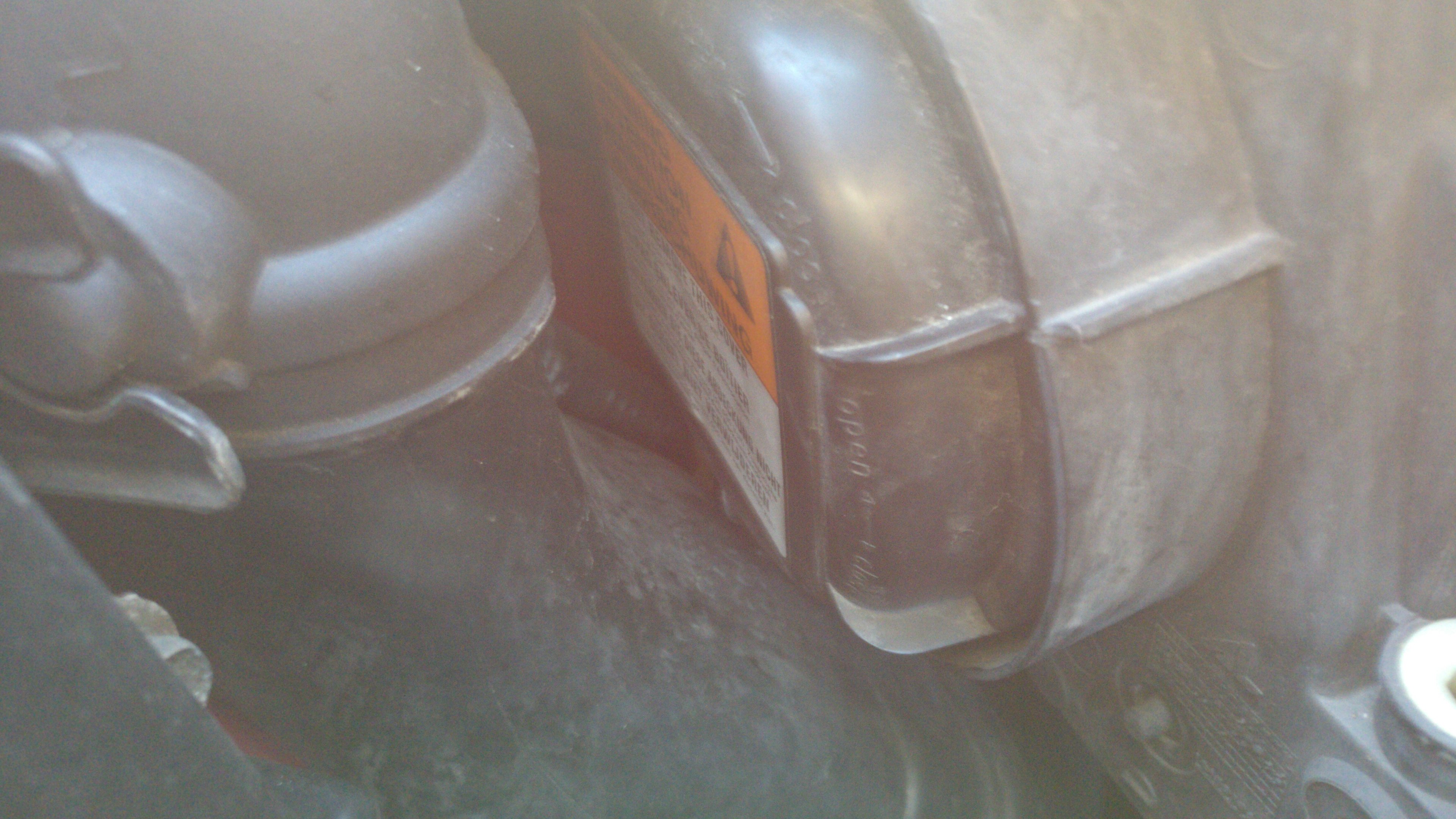

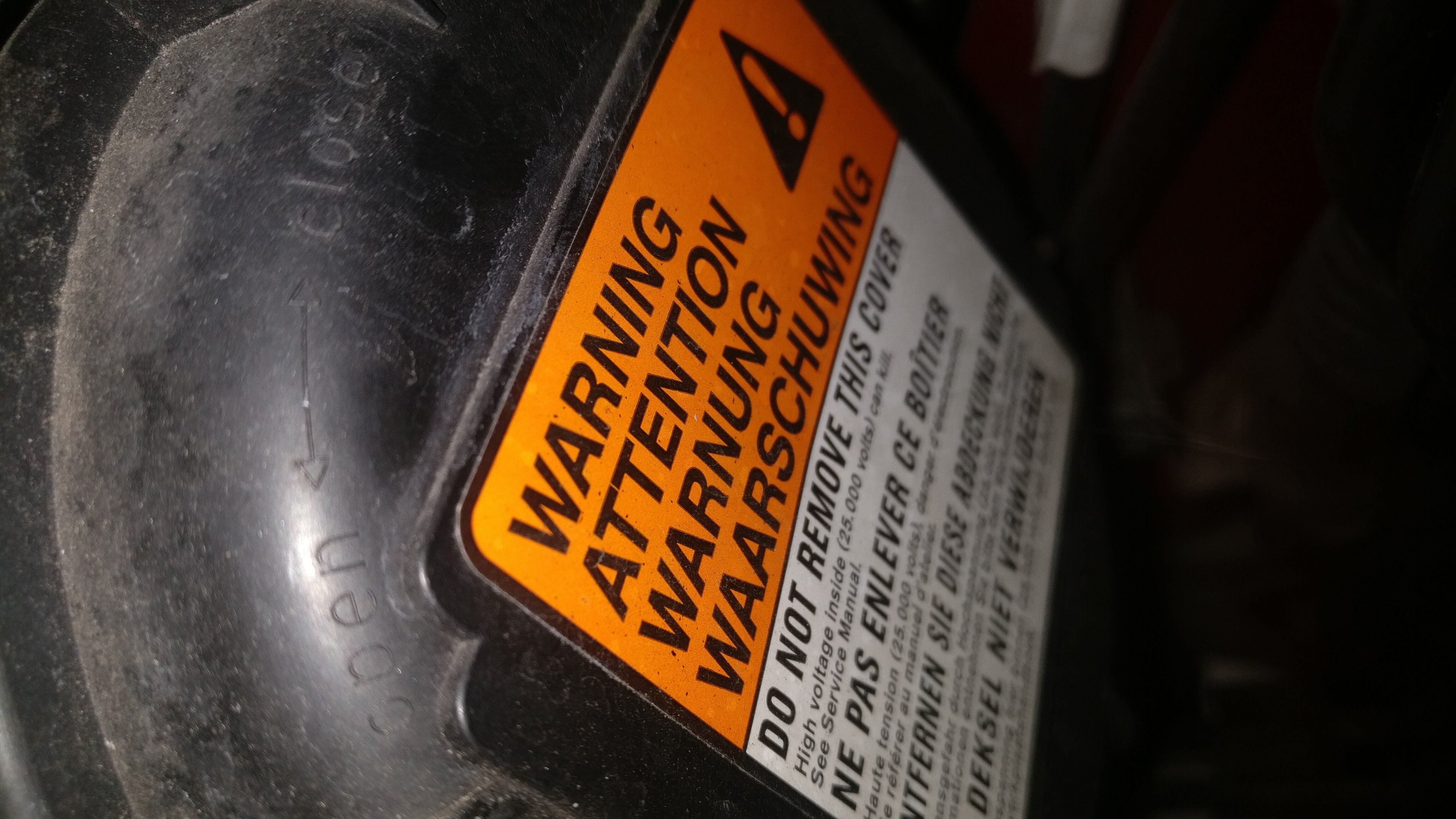

Took this picture of the cover (in the dark, outside Halfords) last night

Piece of s**t now has 2 functioning lights (for now)
The drivers side one seemed to be the wrong bulb, which wasn't the issue (wasn't blown up either). Looks like the connector on the back had just come marginally loose so wasn't firing.
The one in there was a D2S, but there's a D2R in the passenger side.. so I swapped the D2S for a new D2R and the light pattern now matches both sides.. probably been blinding people a bit.
Car is f**king cursed, though.
That whole design is absolutely awful. It's worse than 172 levels of inaccessibility to lights. The passenger side one to get decent access you need to take part of the intake out!
Once again, don't buy these cars. Although do buy mine, I need something I can actually work on
