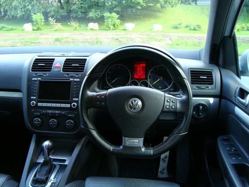

Thats the multi-function steering wheel (standard on the DSG), does yours have the full on board computer in the instrument binnacle or the pikey half thing? Mine also had the speaker upgrade (larger grills in the front doors), folding mirrors, cruise (retrofitted), cd changer in the armrest & satnav.
This is full OBC with MSFW.
Perhaps post some interior pics up so i can advise you on your spec.
I'll take a picture when I get the car back later, but it has that full sized red panel thing in the middle like yours. It has a slightly pikey aftermarket double DIN radio that I will be replacing with something OEM.
Don't think it has folding mirrors, definitely doesn't have cruise, not looked for a CD changer yet. It does have the arm rest that extends to almost touching the handbrake, which is nice.
Oh and it has cupholders in the back

I took some quick pictures of various things in the interior for @Sir_Dave and others (and I apologise for the state of the interior, aside from vaccuuming briefly I haven't had a chance to clean it - also the pictures are s**t)

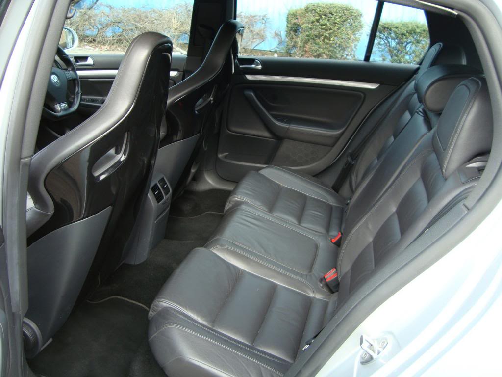

More recaro pics needed.
Also, that hu looks so awkward.
Double din touchscreen badman ting definitively needed
I don't have Recaro's, Dave's did though. I prefer the standard seats. The only thing the Recaro's have over them is looks! They aren't as comfortable.
Knuckles
Oh! I thought those bolsters in your last pic were recaro ones. They're f**king huge!
That last bit is 100% correct though. Even 197/200 seats are as supportive as recaros. They just don't look epic.
