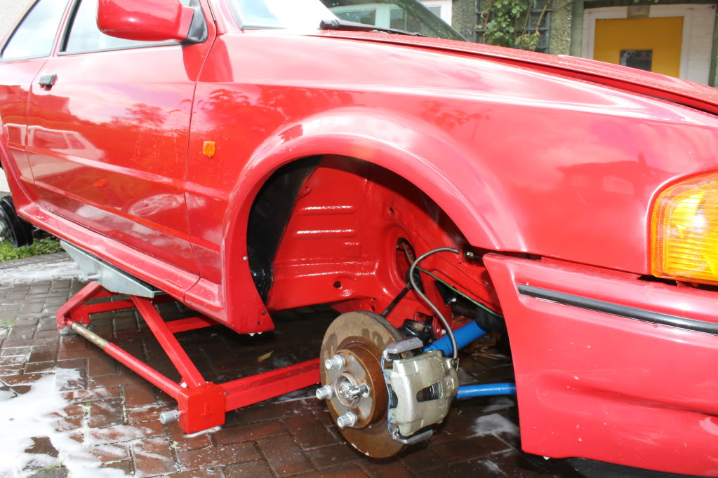

This was my RS Turbo when nearly done and it took all the fun out of driving it! So the goal with the Clio is just to get it clean and as protected as possible ready for using.

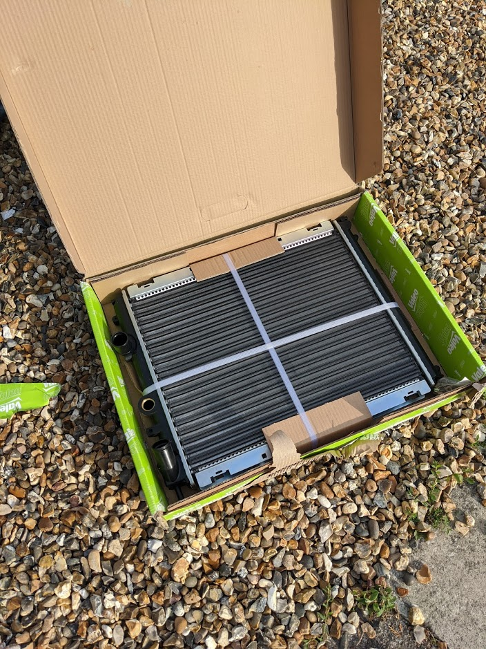

New rad in - can't find the pics of it actually in in but it is!
Once the rad was in I gave the engine its first start in several months, fired into life without complaint - no exhaust on the car yet so pretty loud but seemed happy.

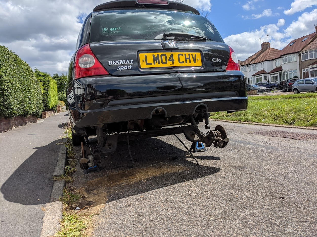

At this point I should have just finished and enjoyed the car - I was begining to rush to get it running as the MOT was due, however Boris gave it a 6 month extension (cheers mate!) so instead I turned it round and started taking things off the back end 🤦‍♂️

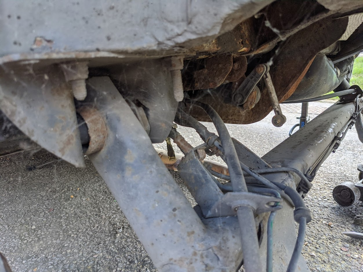

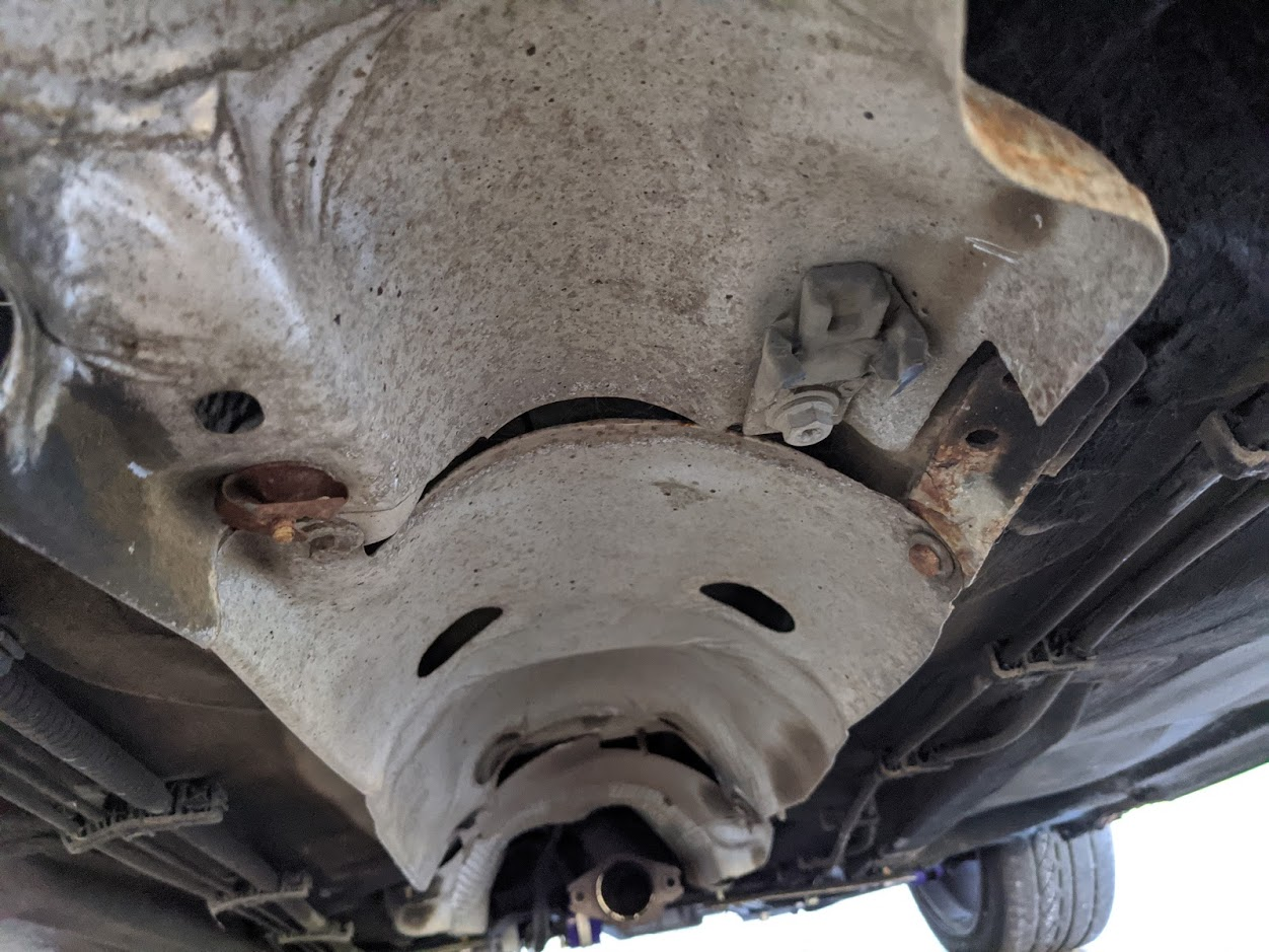

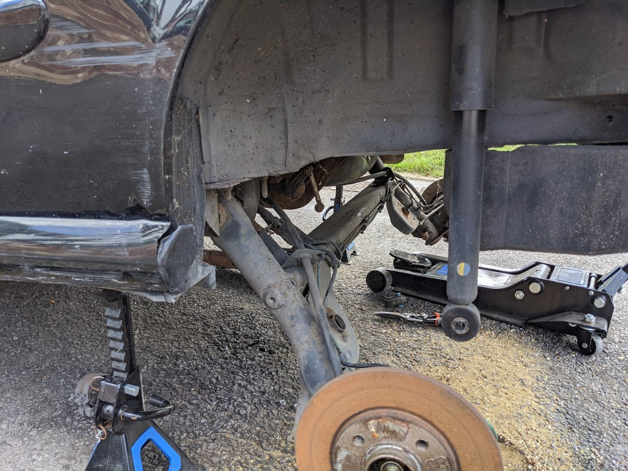

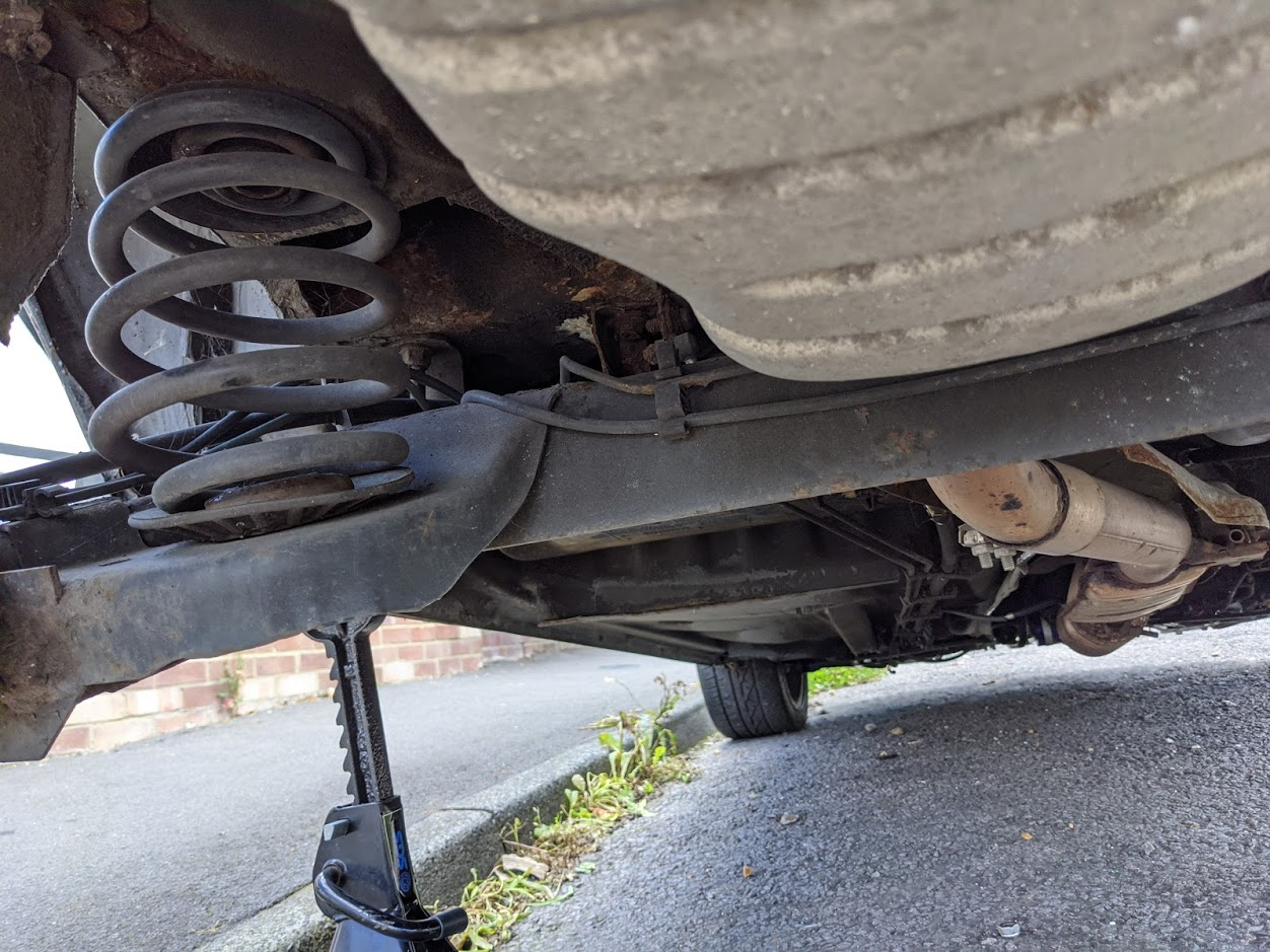

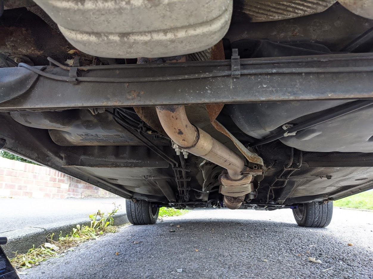

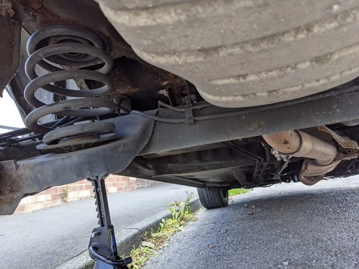

A few pictures of the general condition
Rear shocks are genuine Renault ones and only a few moths old so they will get a clean up and put back on

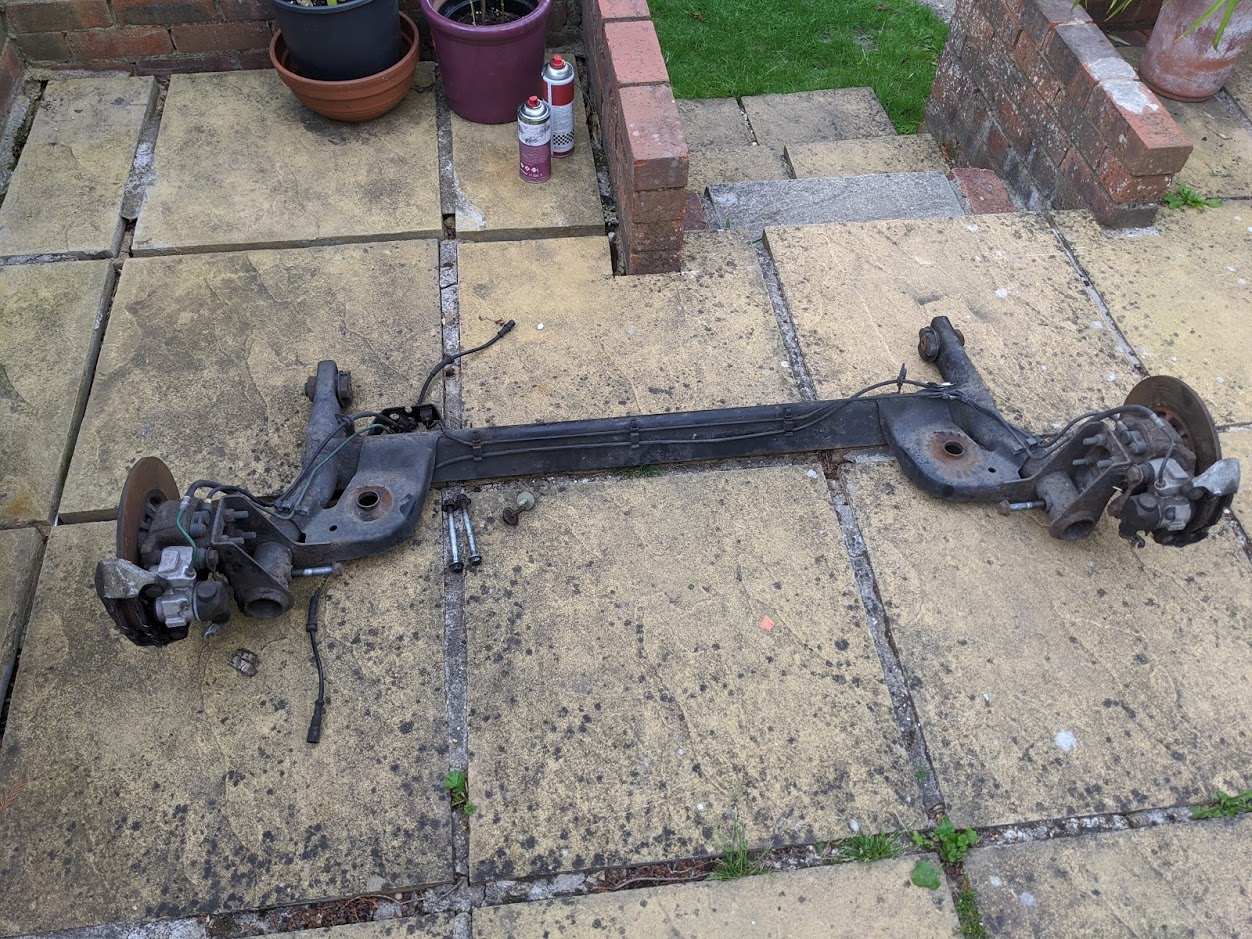

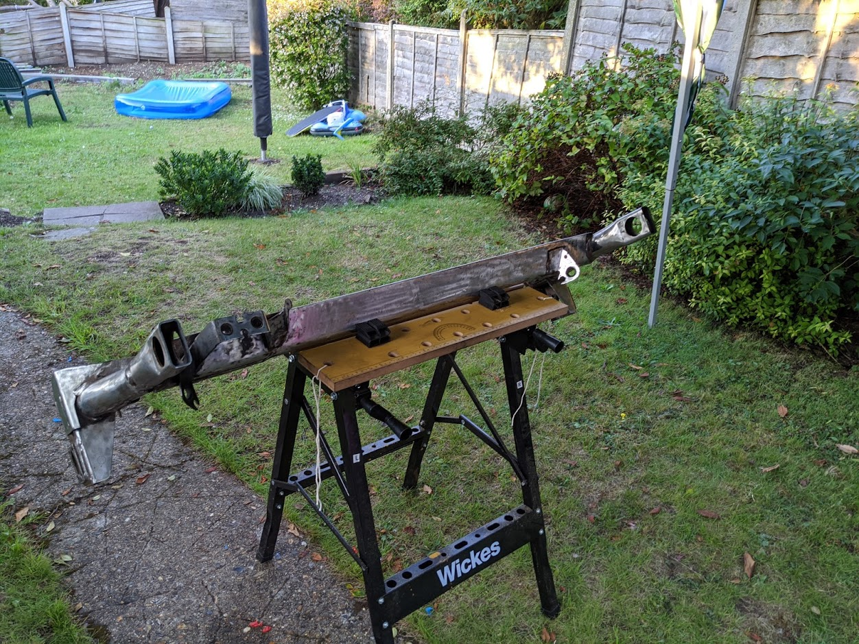

Beam out, heavier than it looked but carried it round into the garden.

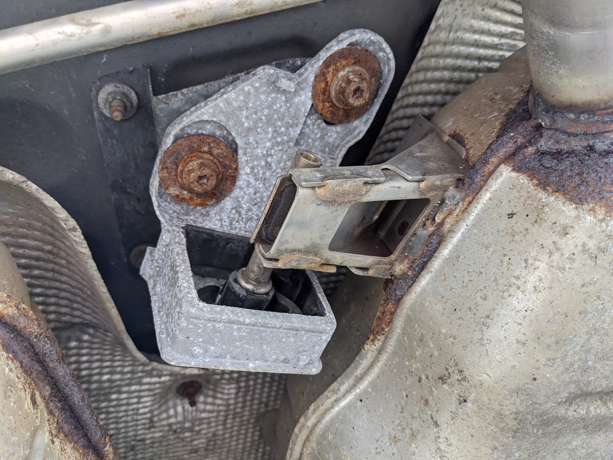

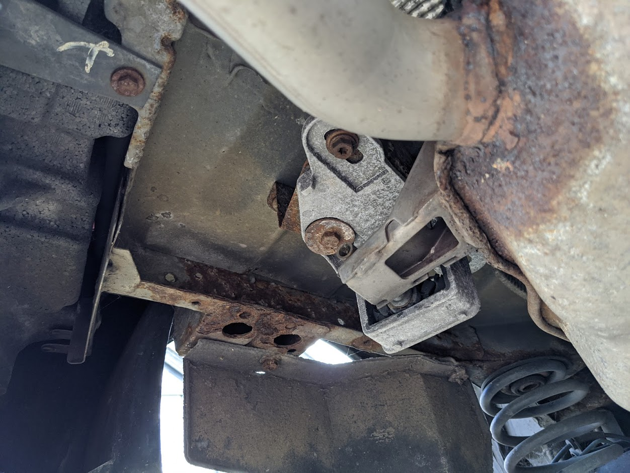

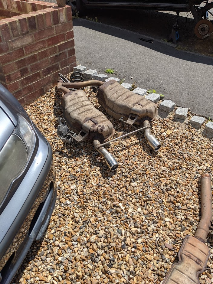

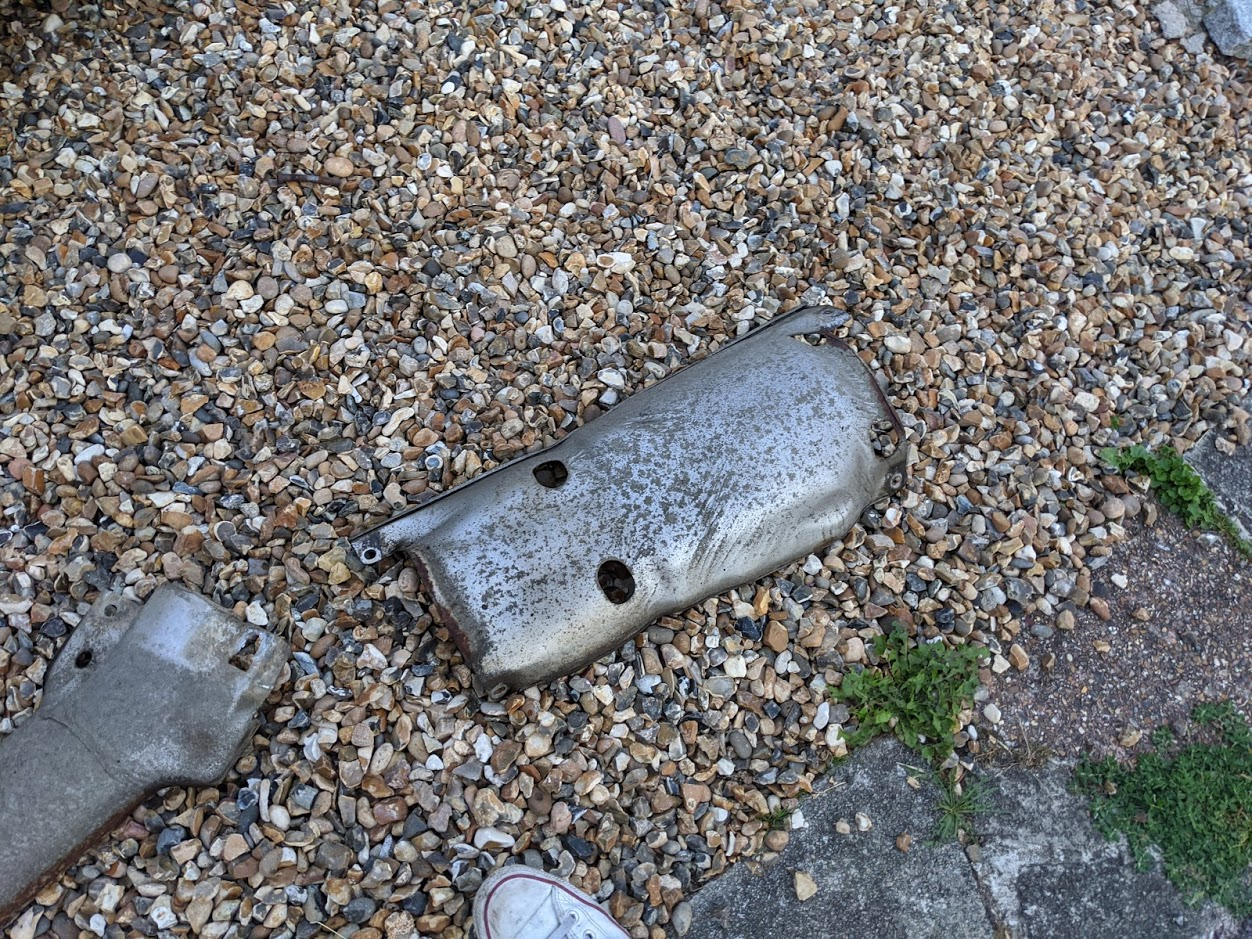

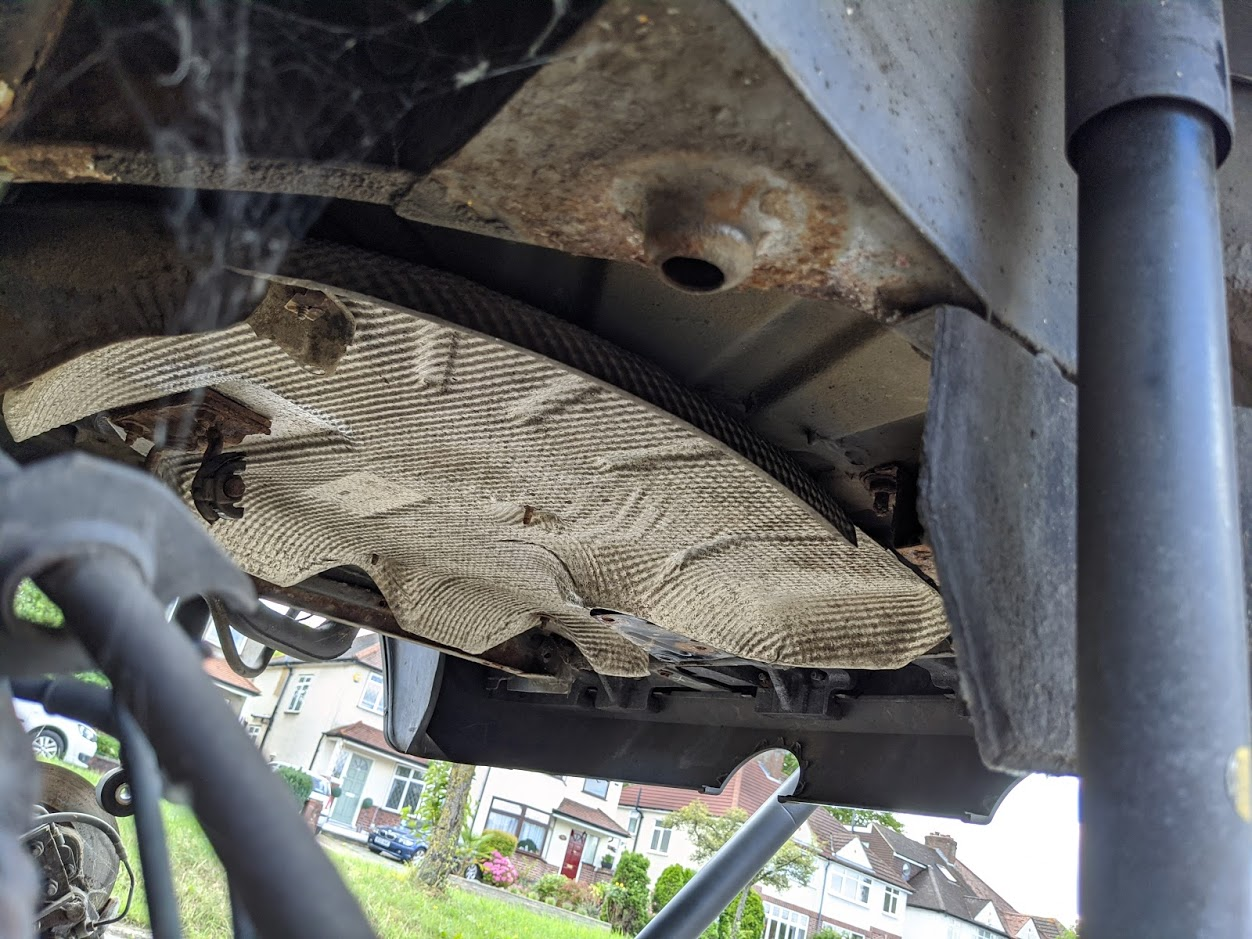

Heatshields off next
One above the back box is going straight in the bin.

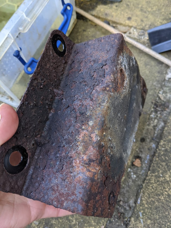

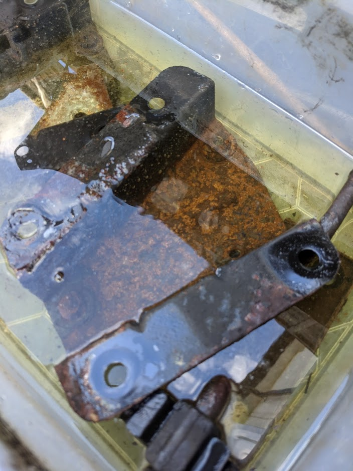

Got the exhaust mount brackets off, fairly scummy - so will give them a dip to see if they can be saved. One has a broken bolt so will have to extract that with the welder

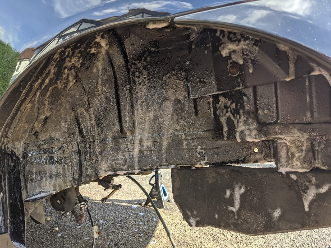

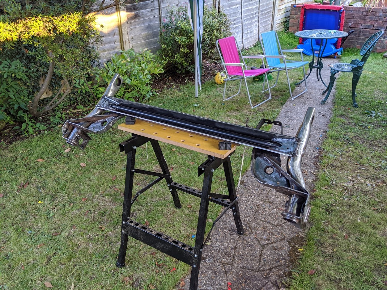

Then onto some scrubbing with TFR and a jetwash
Same for the beam

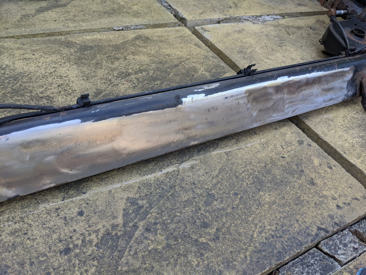

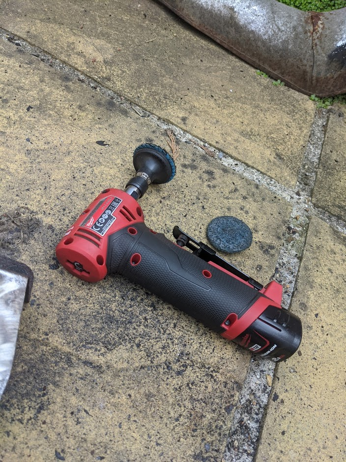

Bought one of these and set to work on the beam - really impressed with the grinder

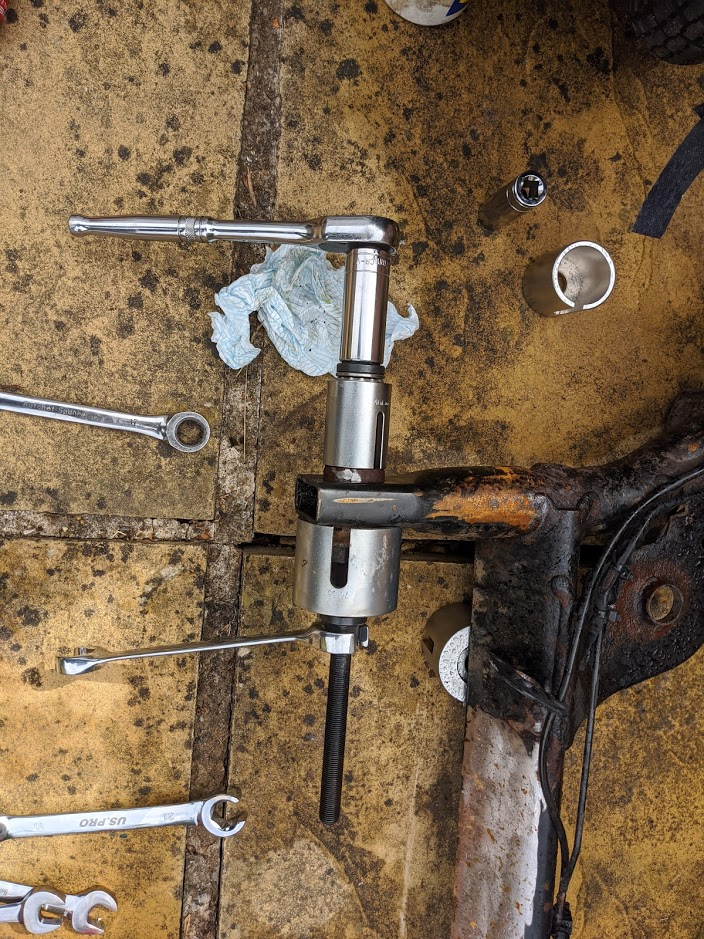

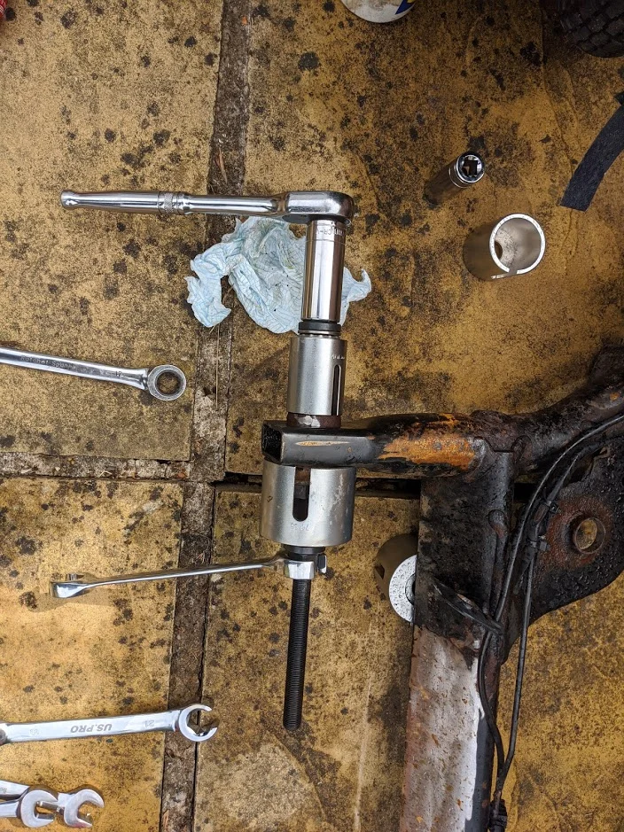

Bushes out

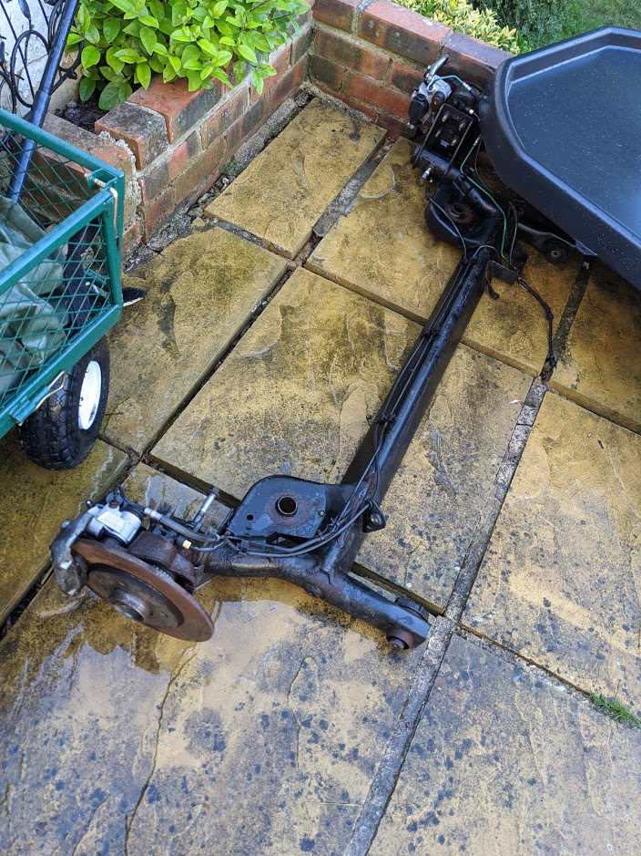

Here it is basically totally stripped

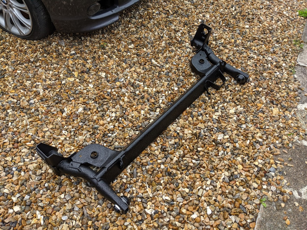

Once again, forgot the pics - probably had epoxy covered hands. The beam got a high zinc primer, then brush applied epoxy mastic 121 then a liberal coating of dinitrol. Came out looking good, surface finish suits the aims of the car (ie not perfect but functional).

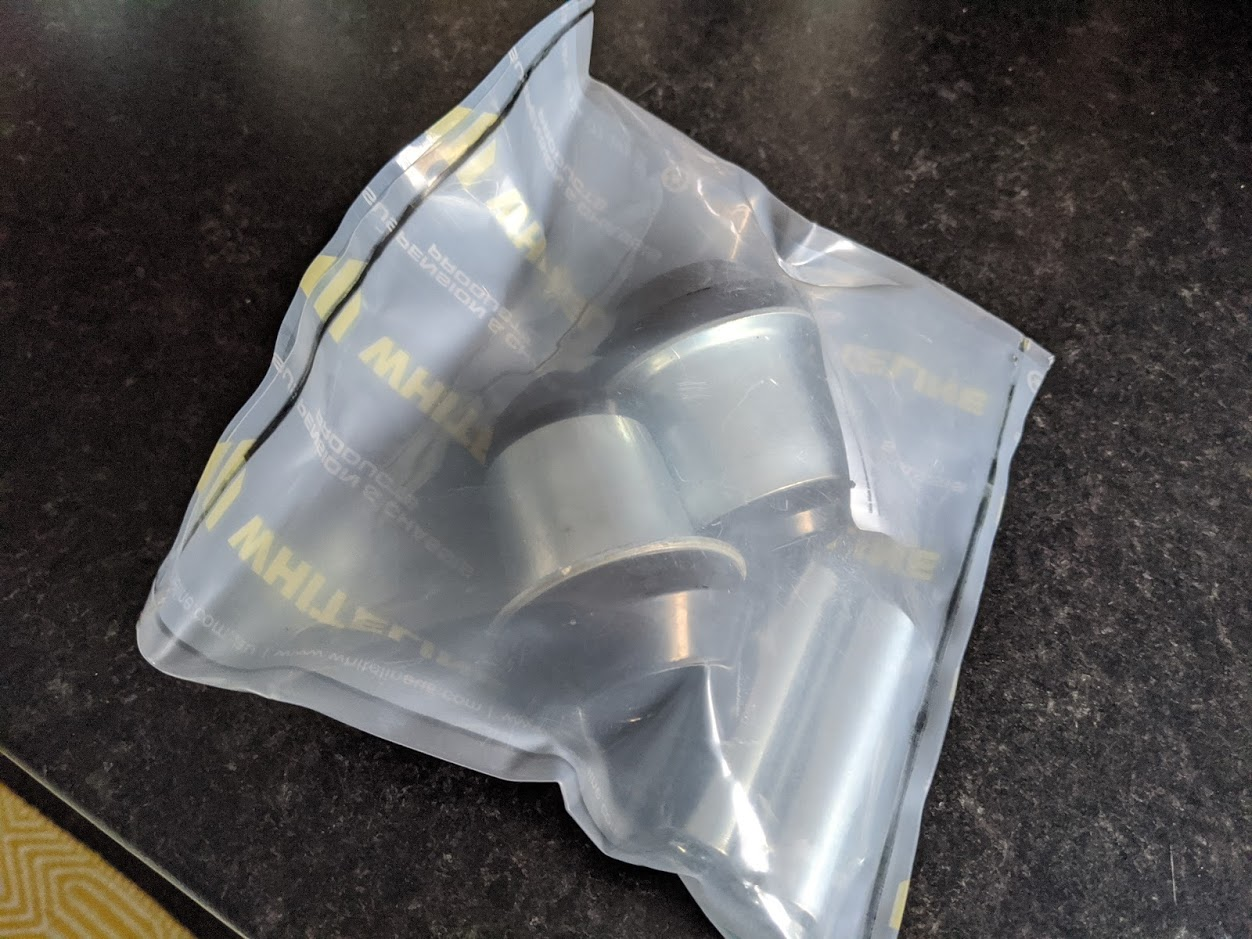

Whiteline bushed ready to go in - good deal on these at driftworks
Beam ready to go back in after being rained on
Thanks James - I may still do that however they came out 'ok' after a dip plus some grinding, welded up a crack and then epoxy coated them. Basically I should have just got some nice stainless ones and saved the time :rolleyes:
Should be mint then really.
If i ever need to touch mine, i'll be going the stainless route for the sake of £40-50 whatever they are.
Another great update. Majority of clio II on the road will have that type of surface rust on the underside rear beam and exhaust mounts. I'm sure there will be a restoration parts market long term when more people start trying to save these cars. As values for the good restored ones will creep up surely.
